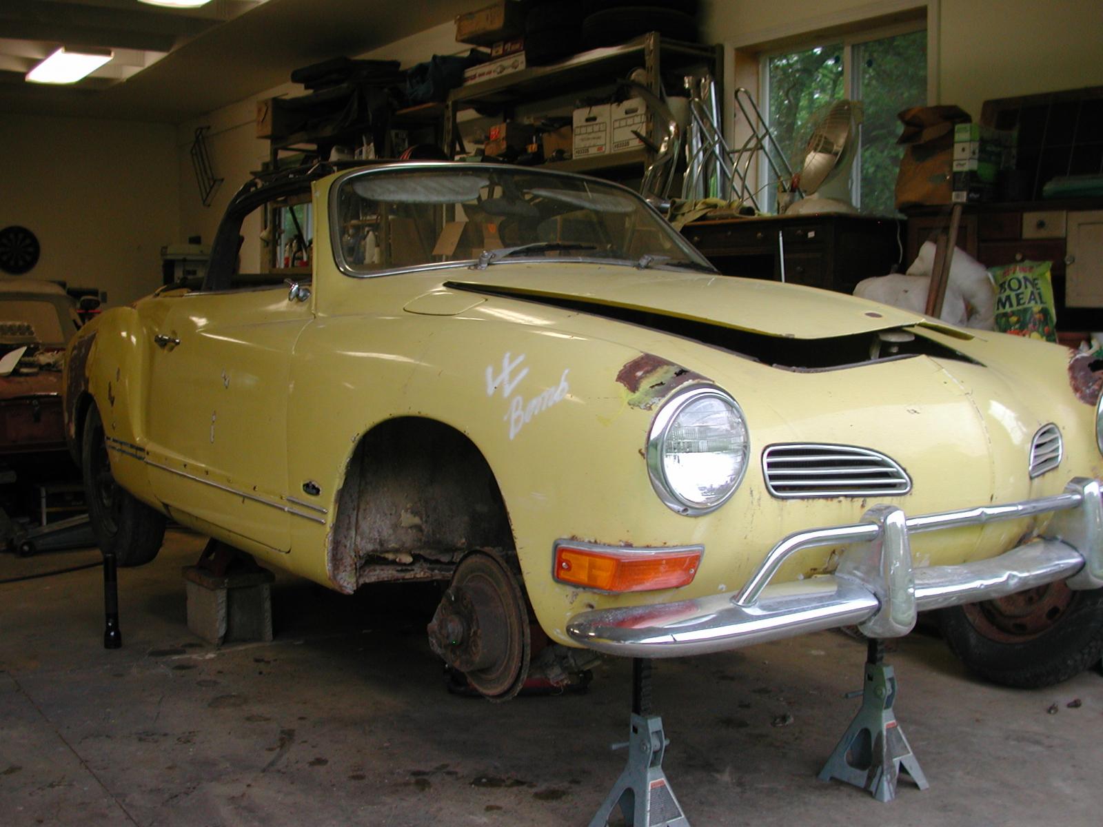

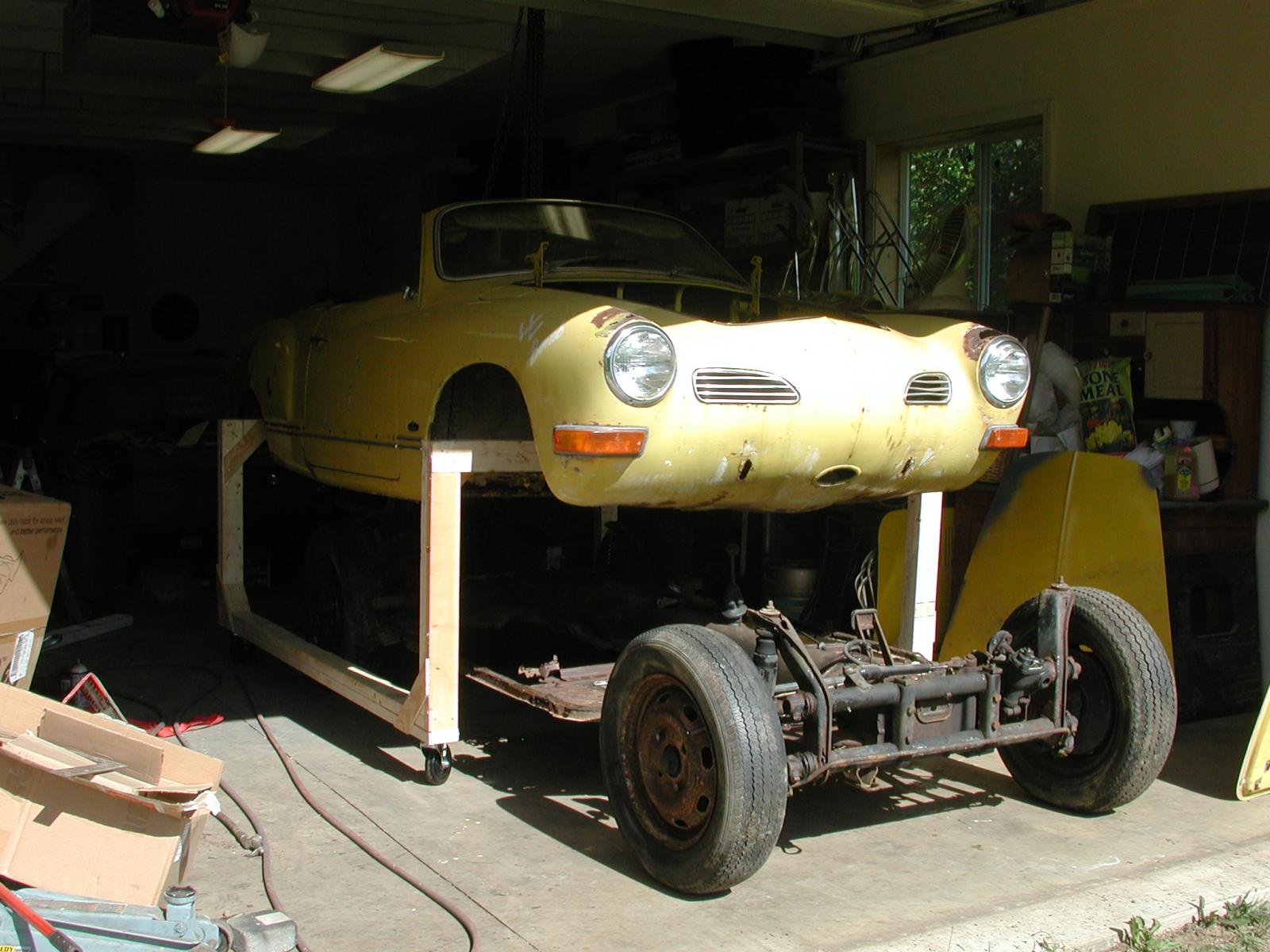

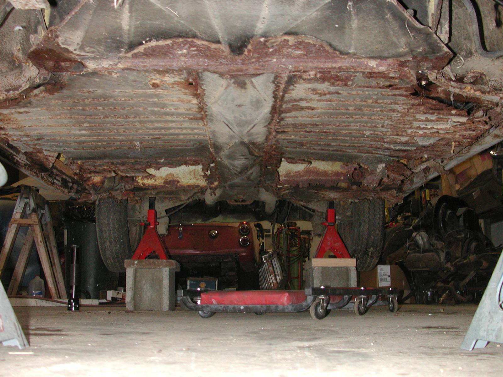

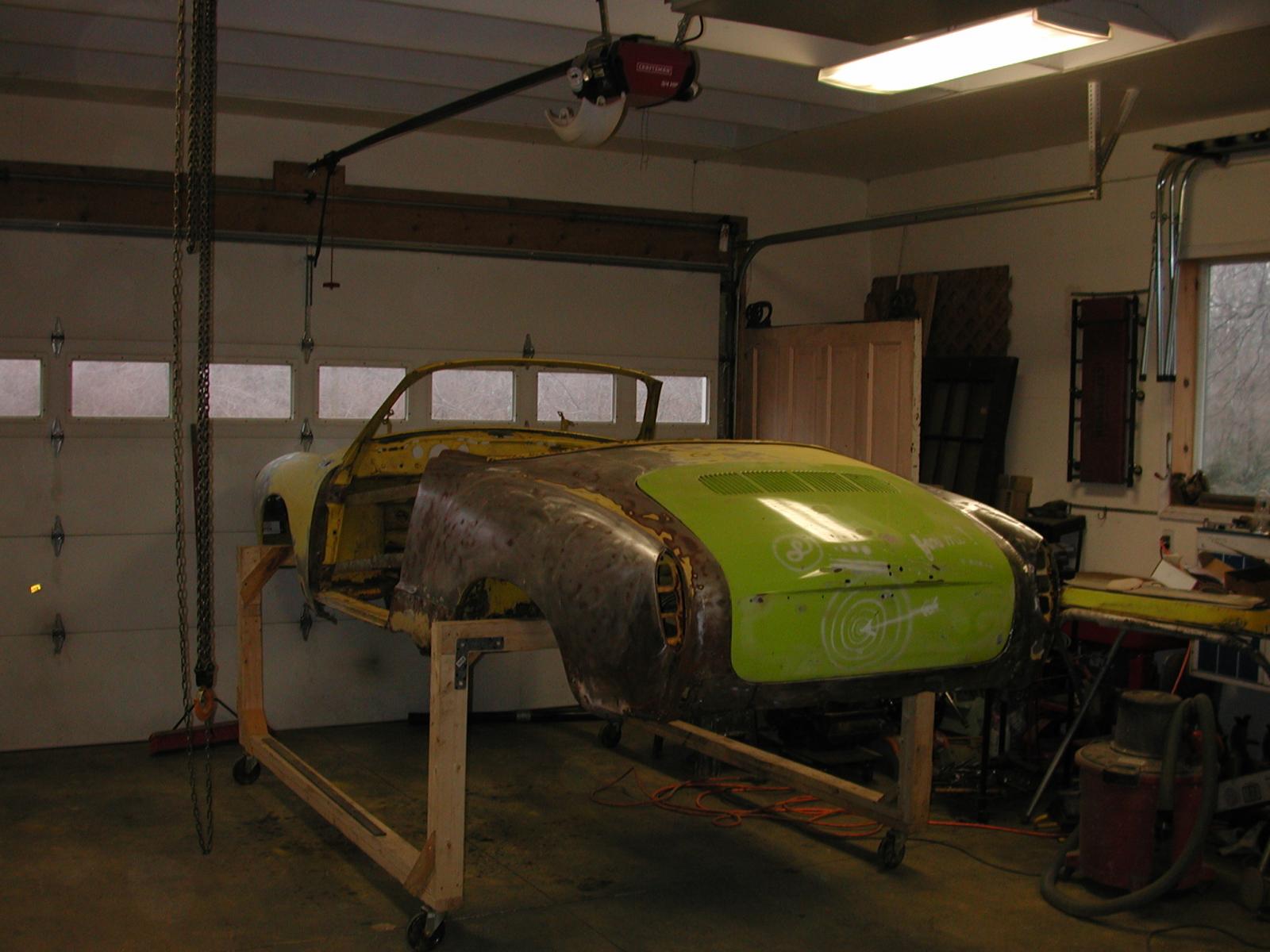

I've had this 71 Vert sitting around for 7 or 8 years. I came to the conclusion a few years ago that it was a lost cause, but circumstances lately have found me with more time than money. That means fixing what's there, only replacing what is absolutely necessary, and making what I can.
So far so good. At least I have the tools to make it happen. I am going to get a lot of practice in metalforming. I should be an expert by the time I'm done.

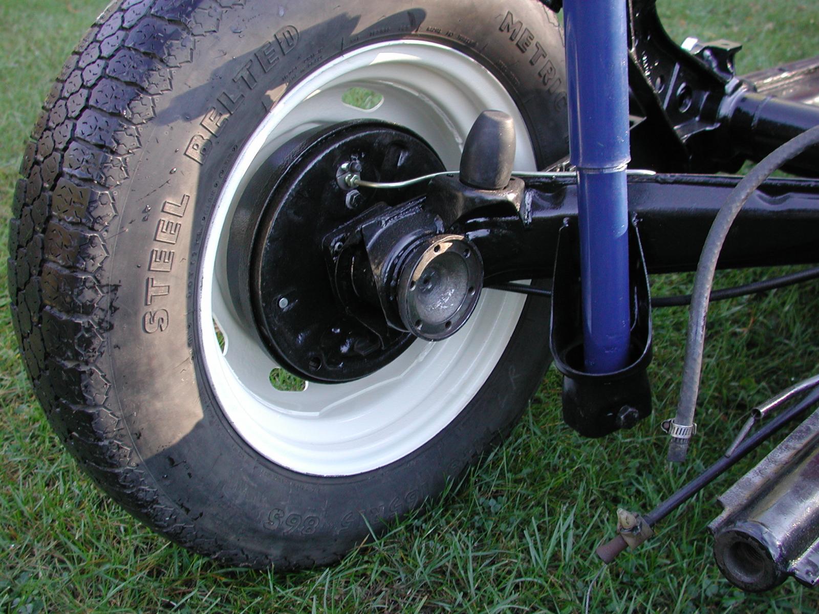

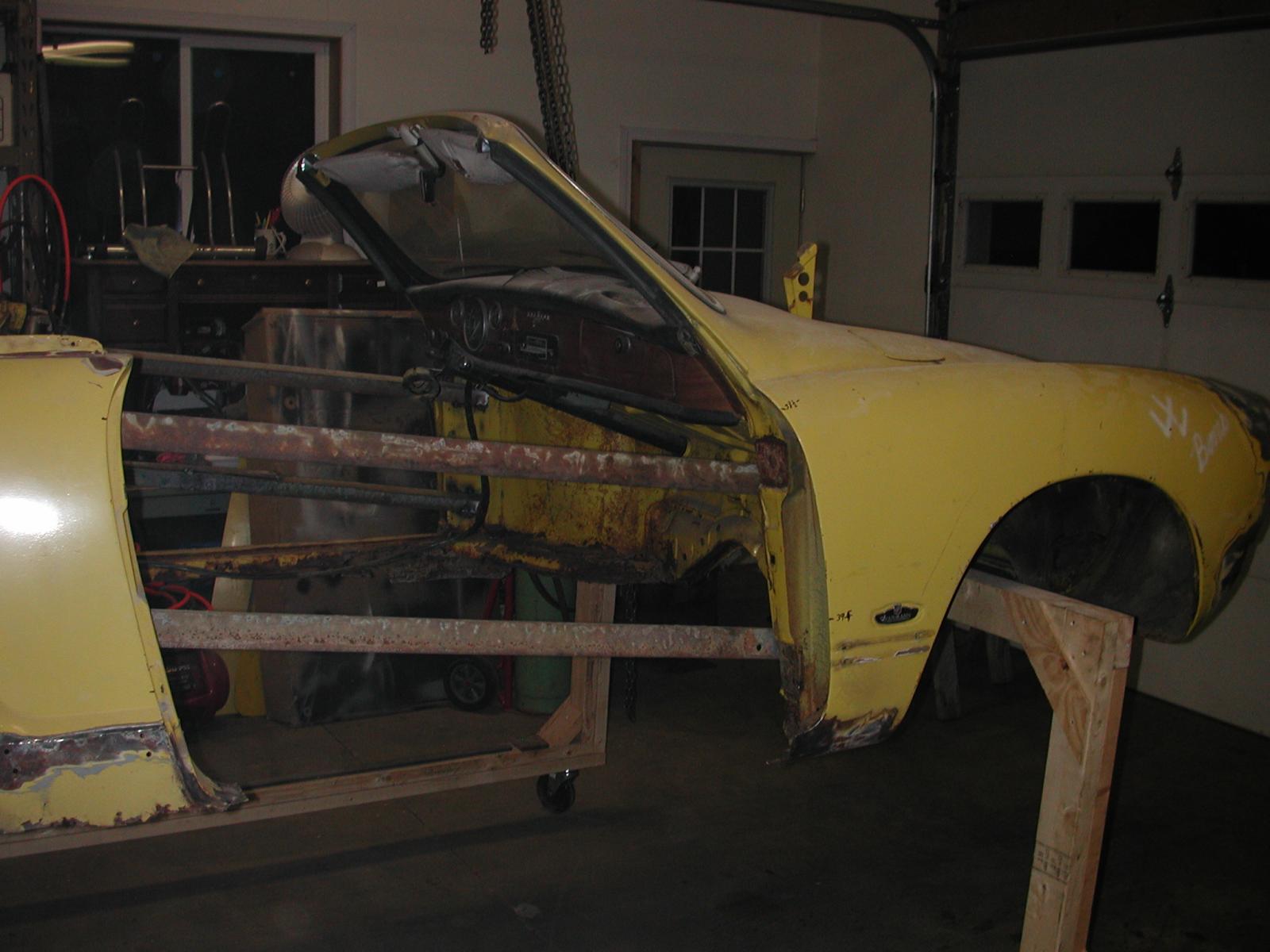

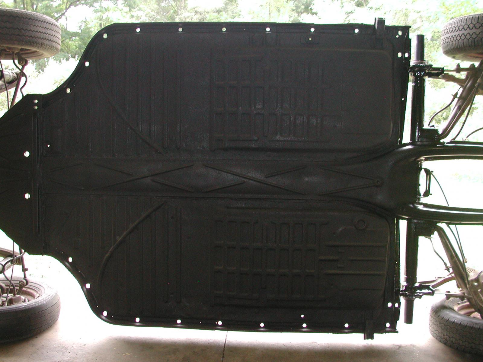

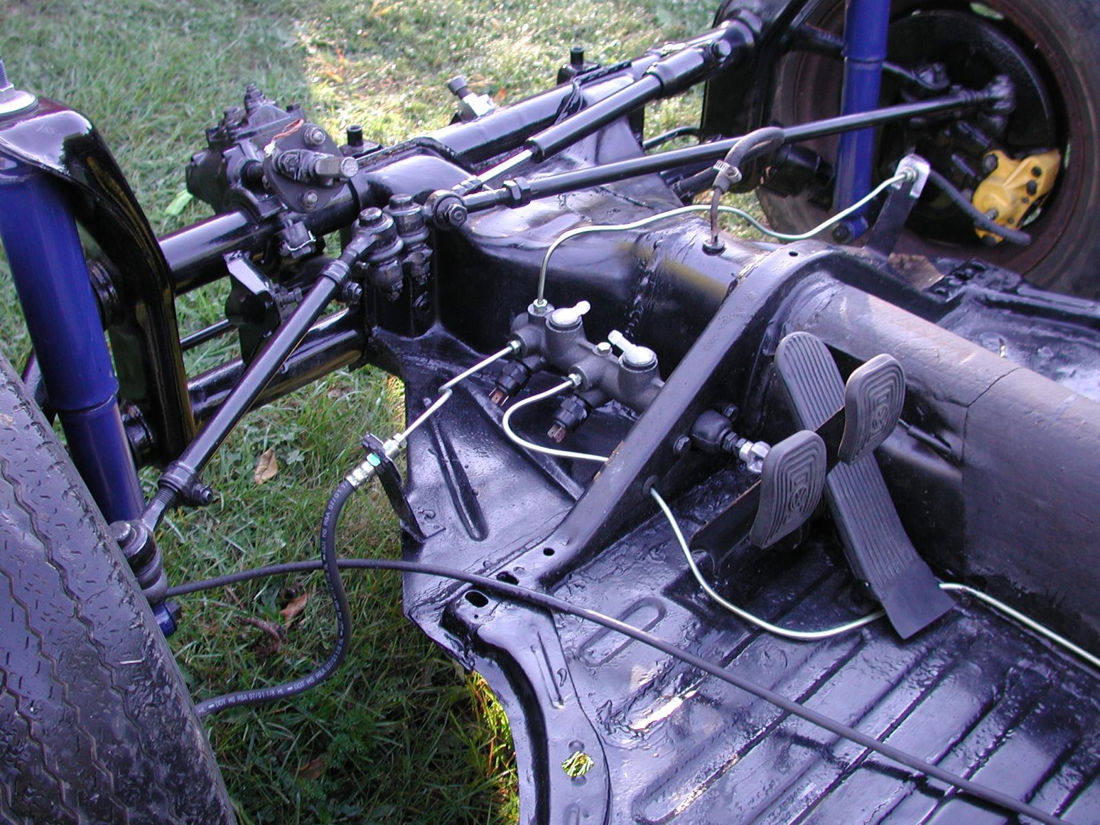

It can only get better. I pieced together different floorpans until I had metal all the way around. Made me wish I had the $400 for new ones. I fixed up and put adjusters on a used beam. The one from this car was a gonner.

Wow, that looks scary. And I fret about the little spot behind my headlight that needs cutting out....

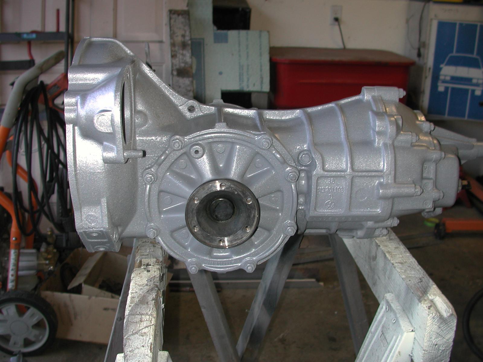

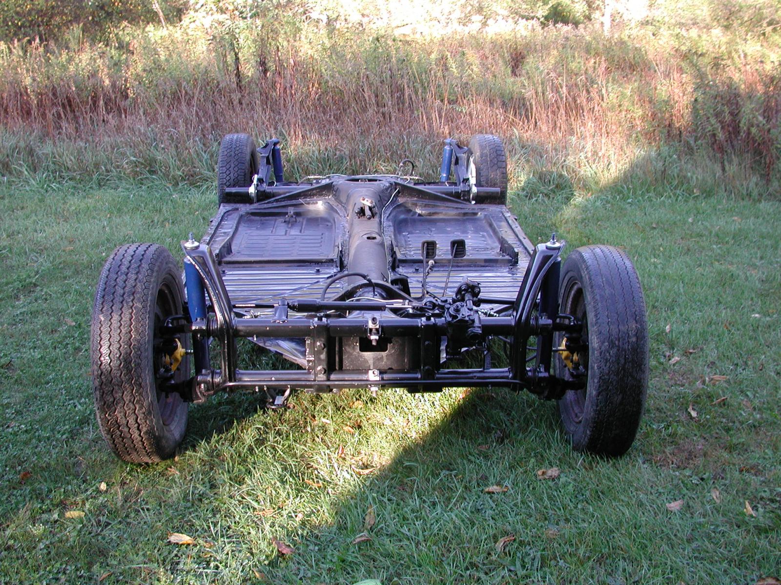

Put on a brake reservoir and filled it. Brakes work. Mounted transmission and put in a new plastic clip on the shift rod. Goes into all gears. Replacing heat adjustment cables. Repacked axles and gave good boots. Mocking up engine and mounted. Going to test its condition and then fix up all its pieces.
Backstory- This was an autostick but I never got the transmission or engine for it. Many parts of this build are off a manual coupe which was just as rusty but didn't have a title. What it did have was a working tranny and engine. So this car it being built with the best off of both cars and new bits as needed.
Hopefully I can drive the chassis around when I can get back to it in a couple of weeks.

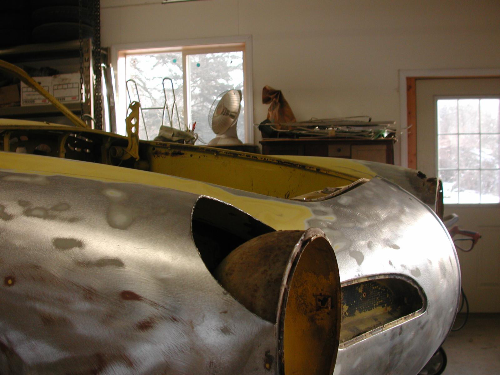

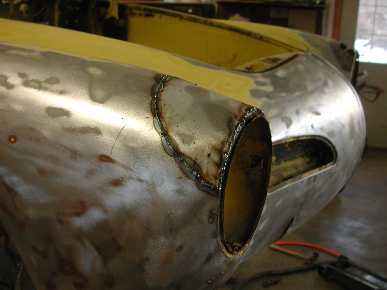

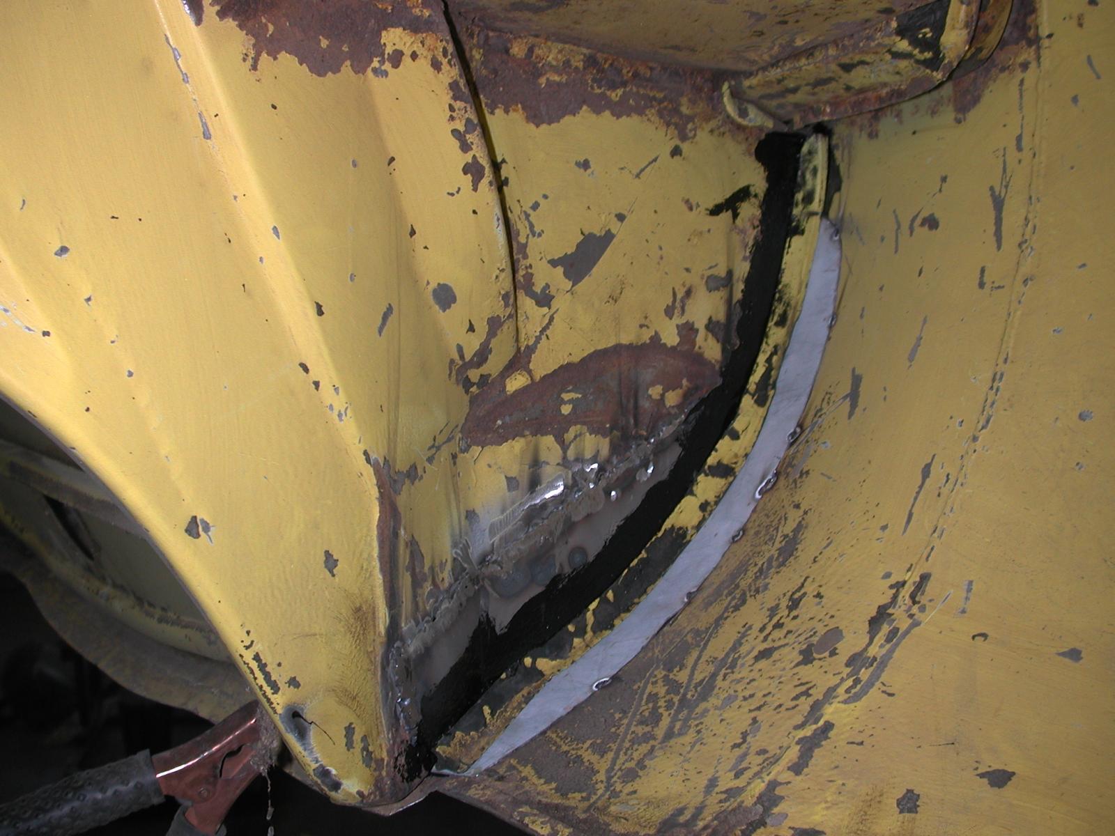

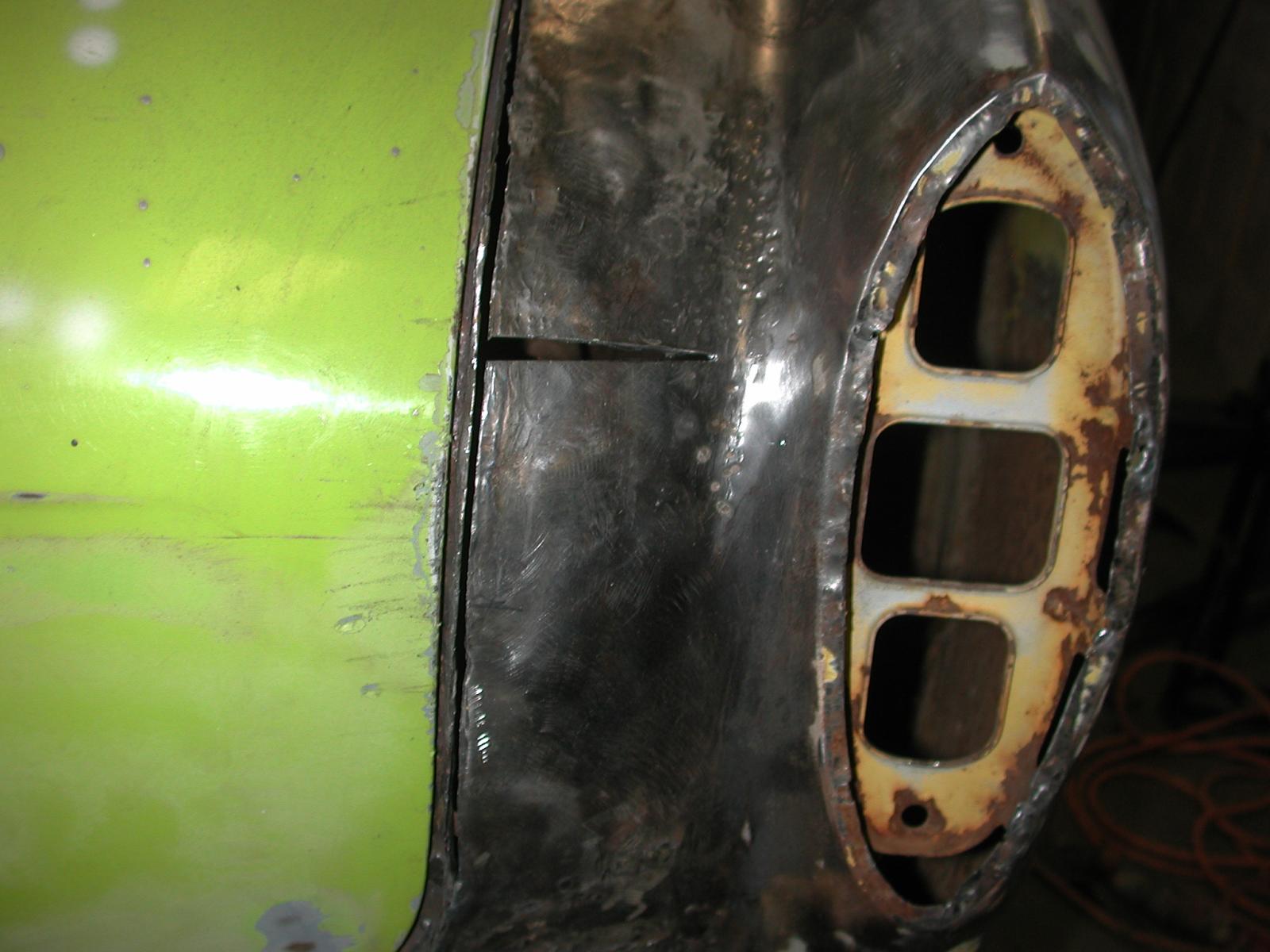

Removing paint and doing some body work. I wasn't able to sandblast underneath before it got cold and wet, so I'm going to work around that and blast it later.
Relief cuts to help the decklid fit better

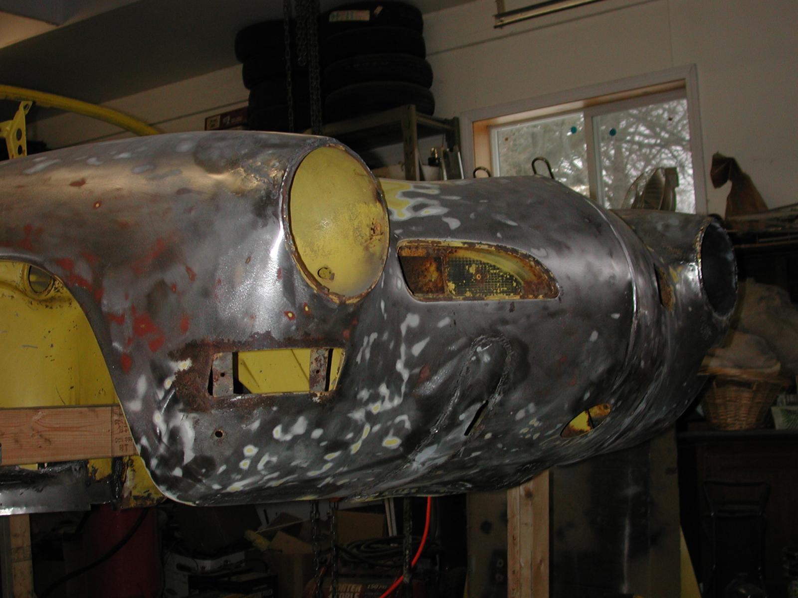

Some front end metal work. I plan on eliminating the 71 square turn signals and put in 69 bullet turn signals that I have. Don't hate.

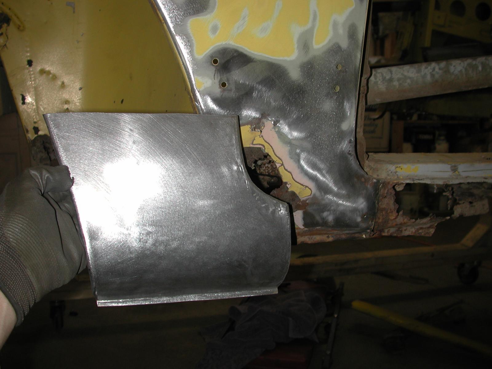

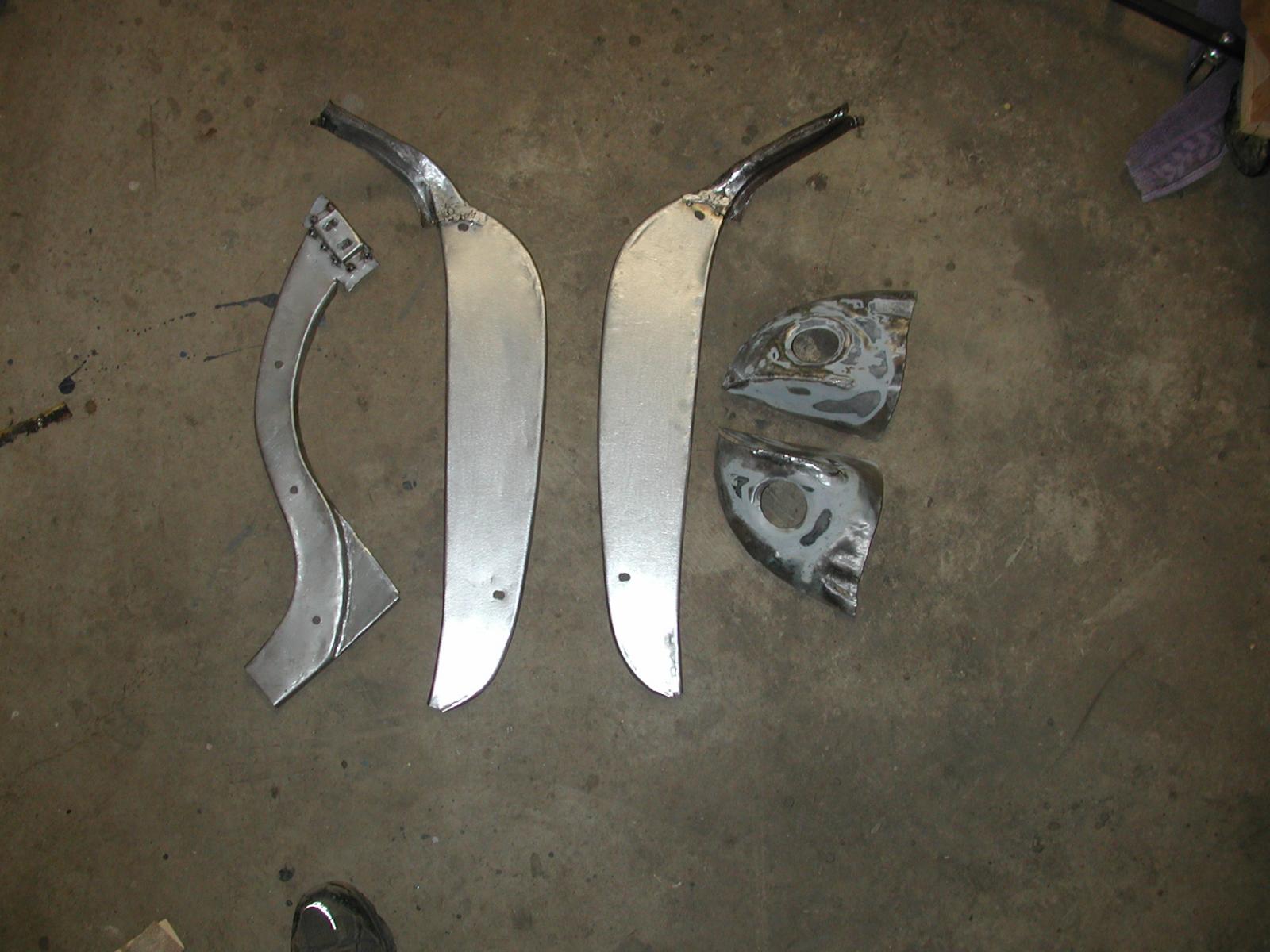

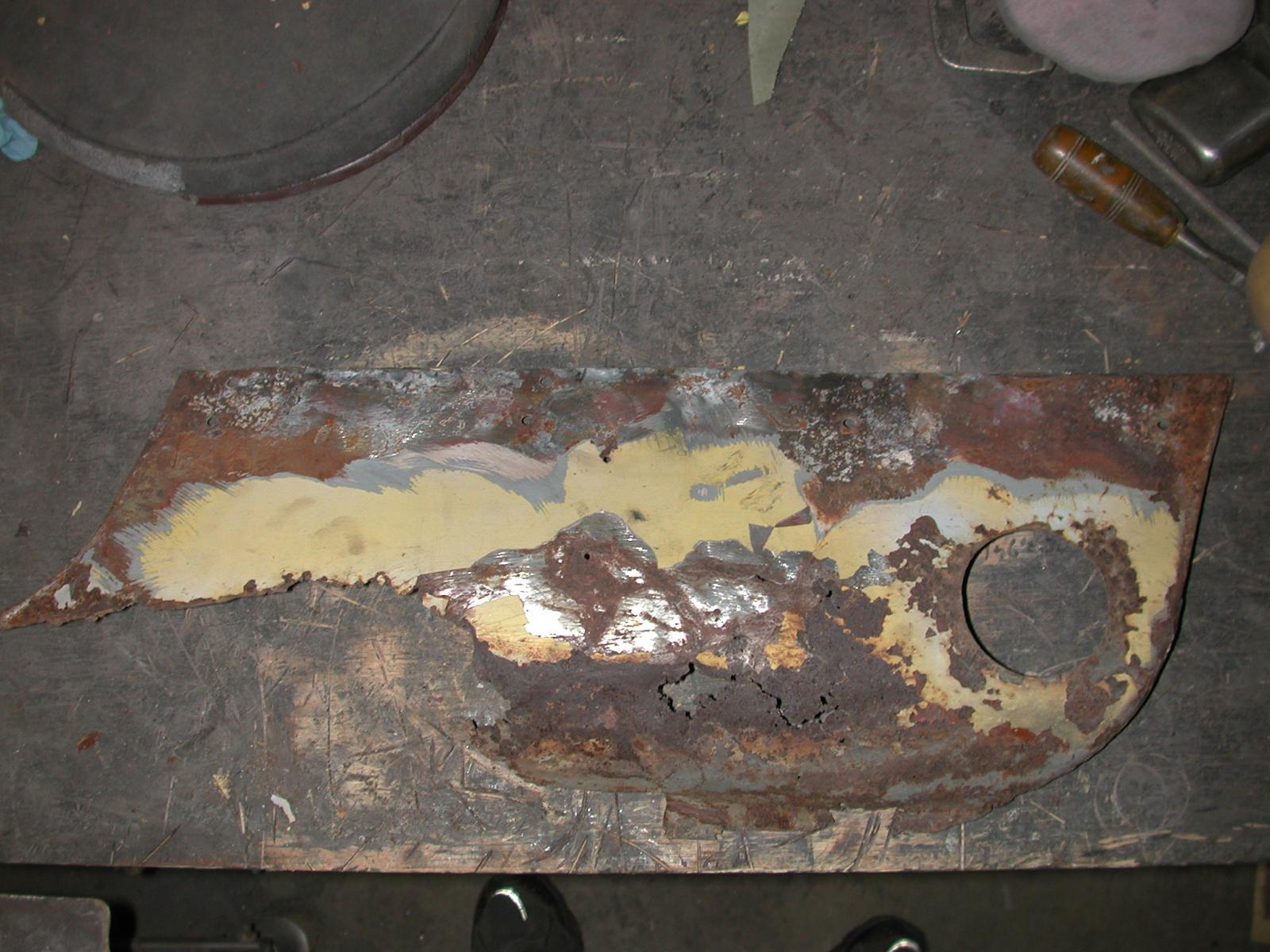

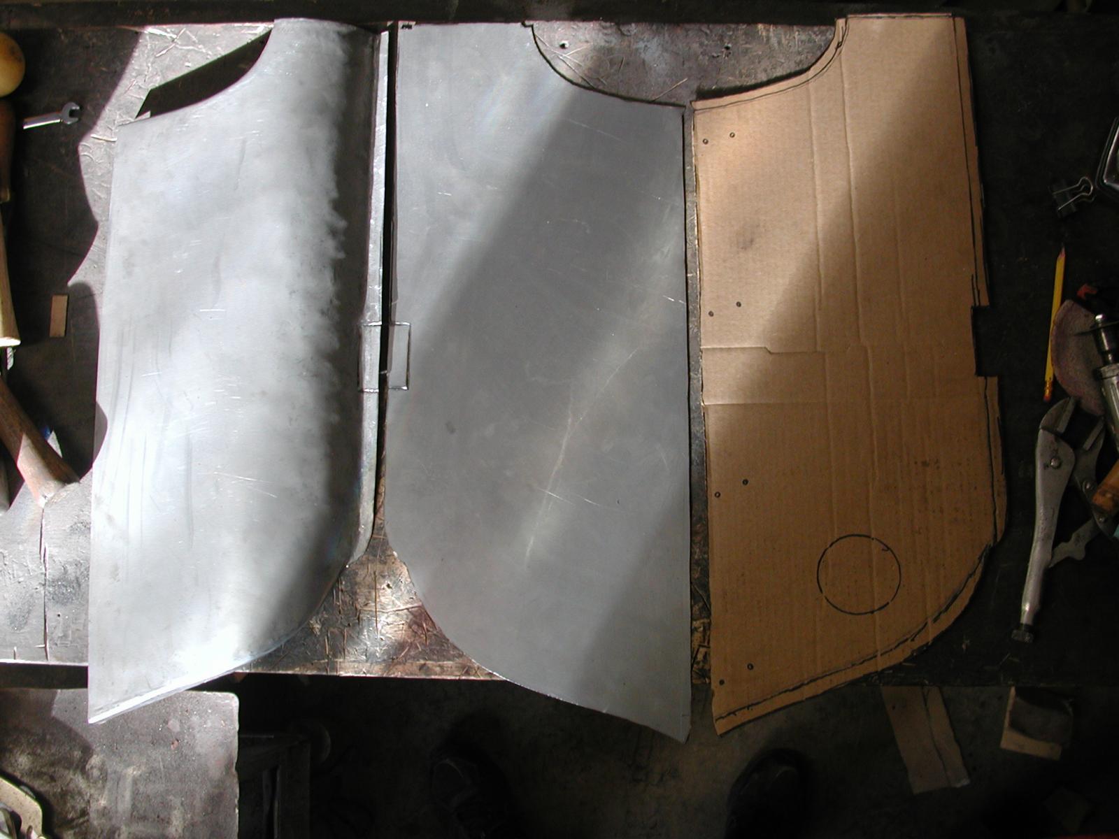

Making Parts. A little more time spent on the parts you see. A LOT more of this to do.

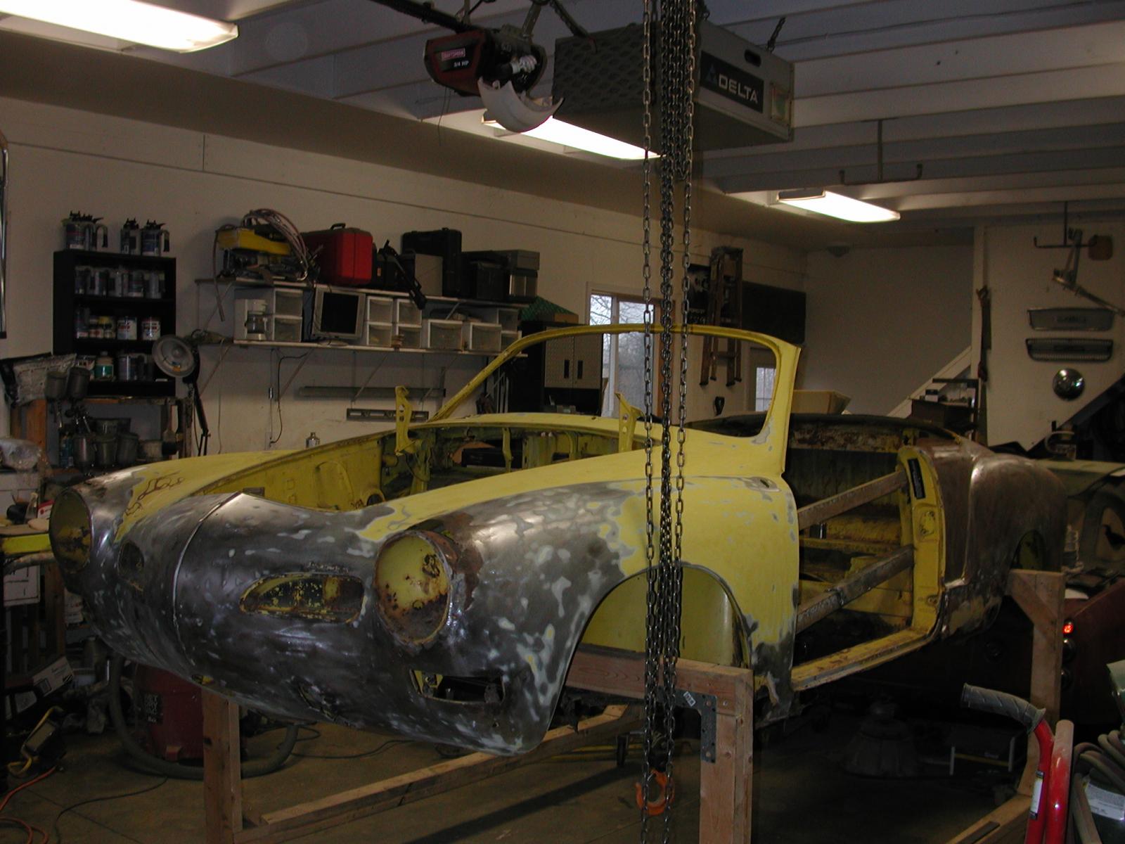

Making more parts. I decided it made more sense to go from the outside in so I can make sure everything fits as I go.
You can see I have a lot to go by.
Some of the process toward a finished part (NO, it's not done yet)

You're doing great work, mate. Keep going and have a merry Christmas and a happy Ghia New Year. I'm learning from you, so keep the posts coming. I agree with you on the corner flasher lights. They look much better in the old style.
