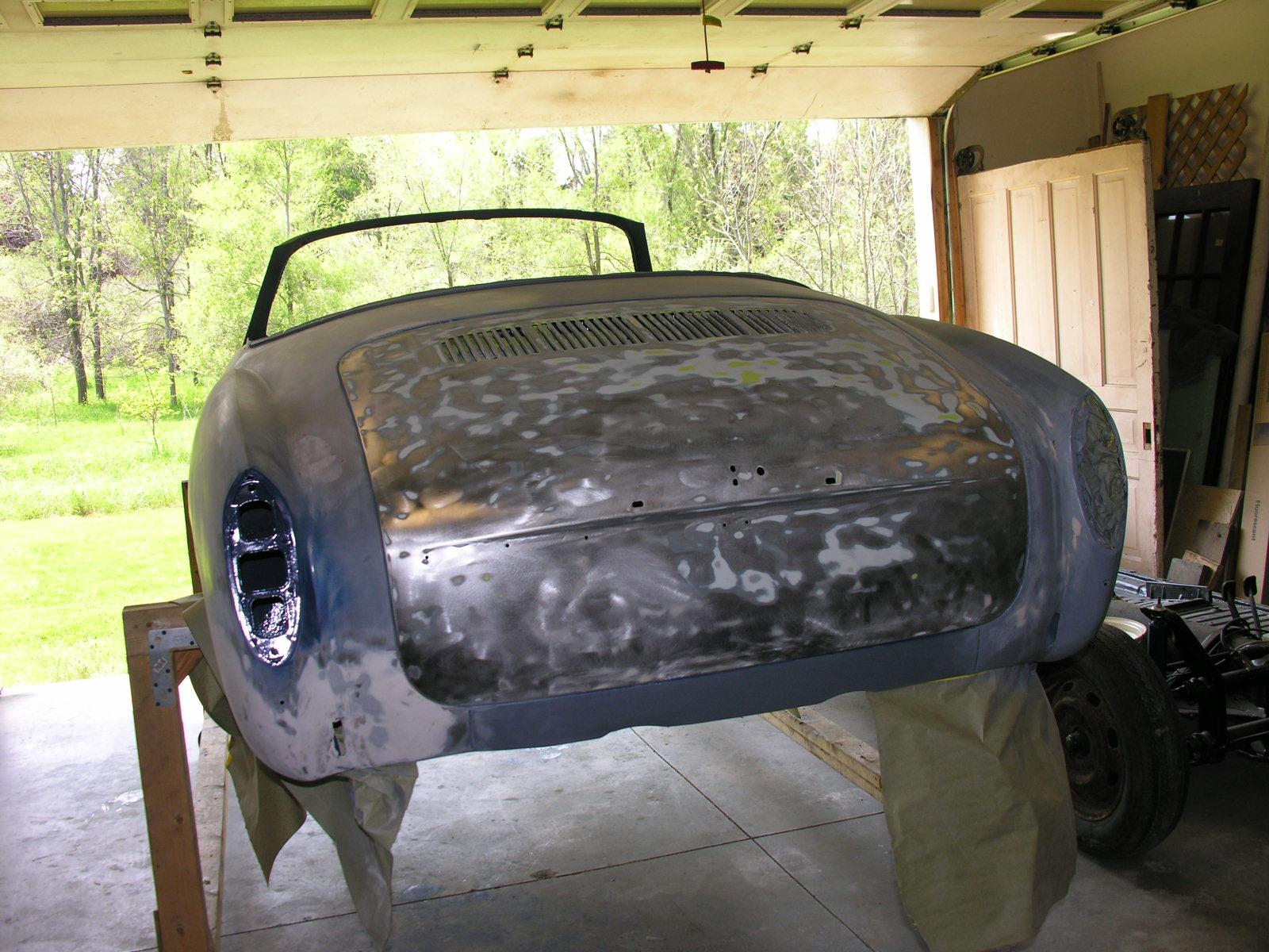

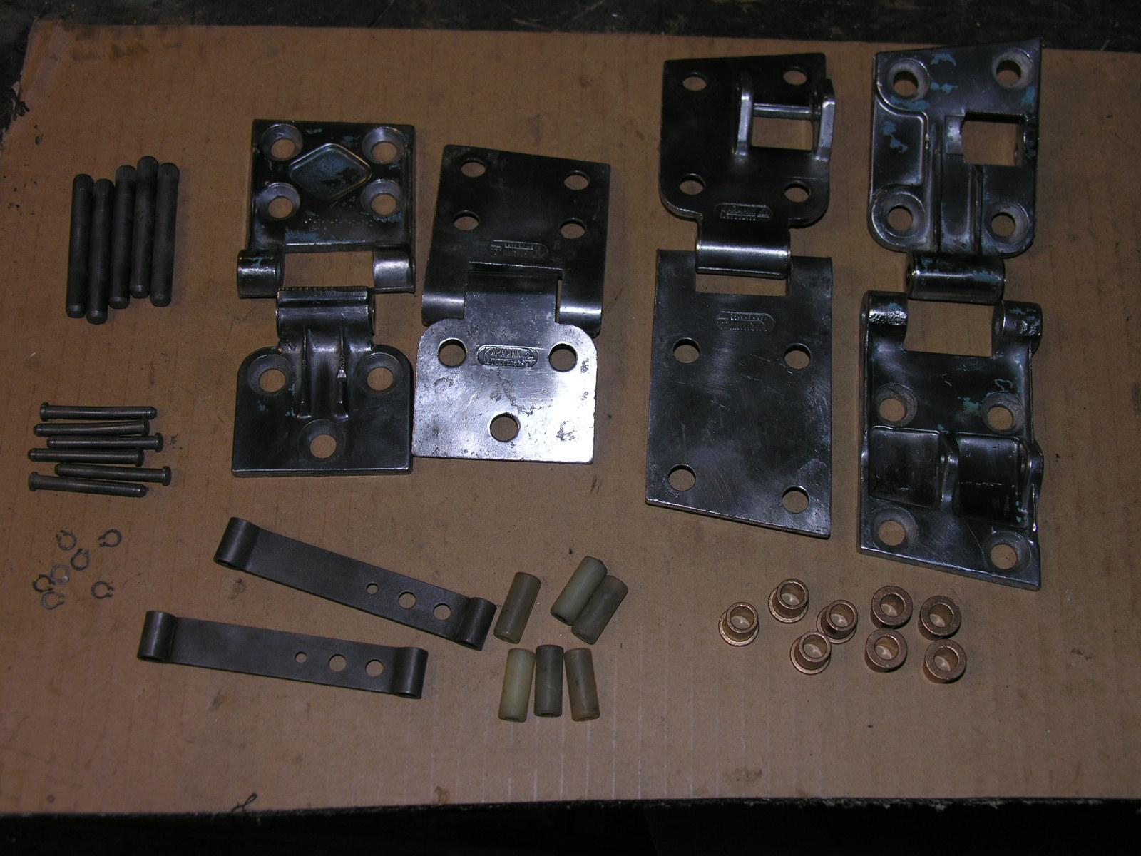

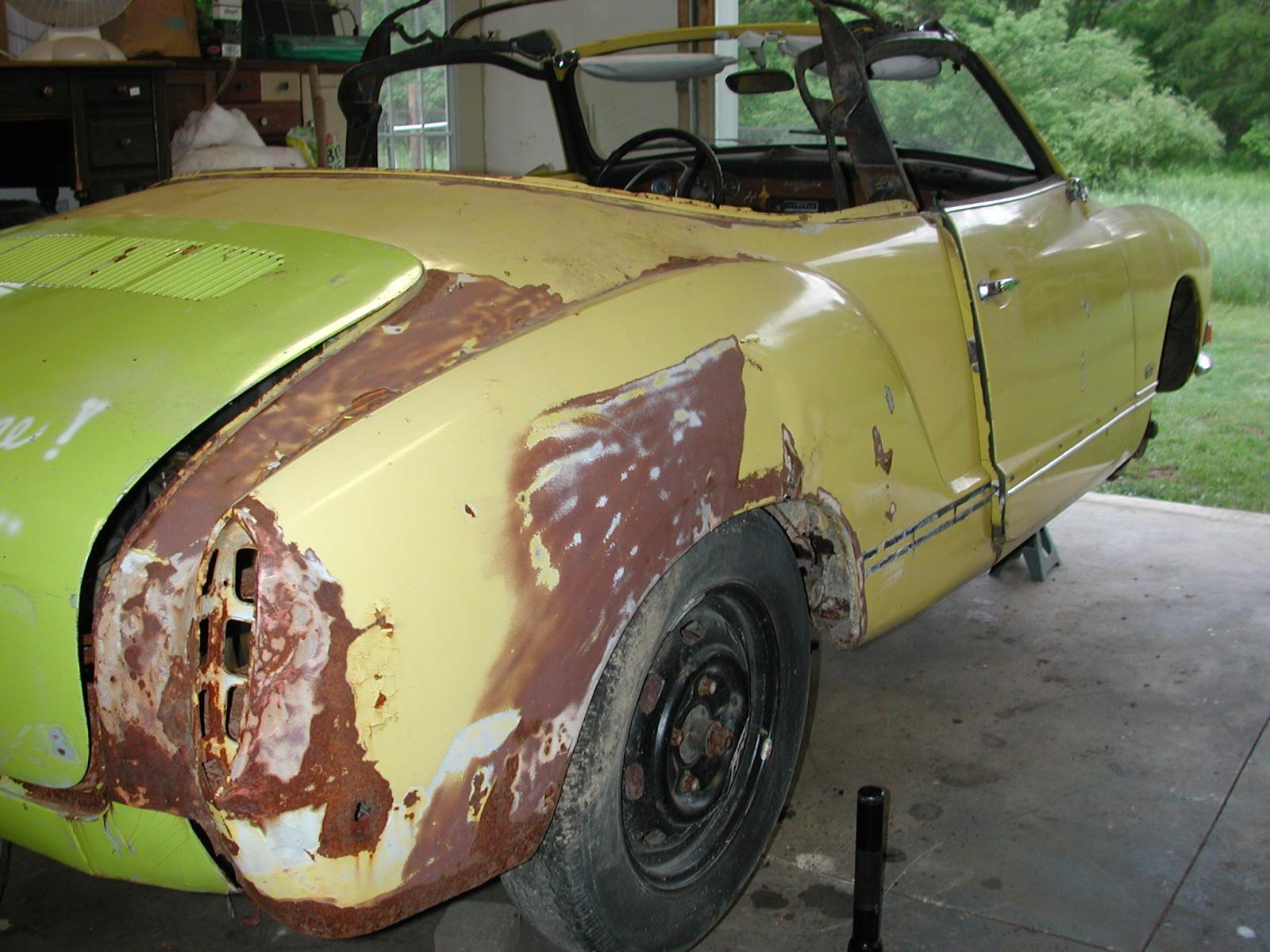

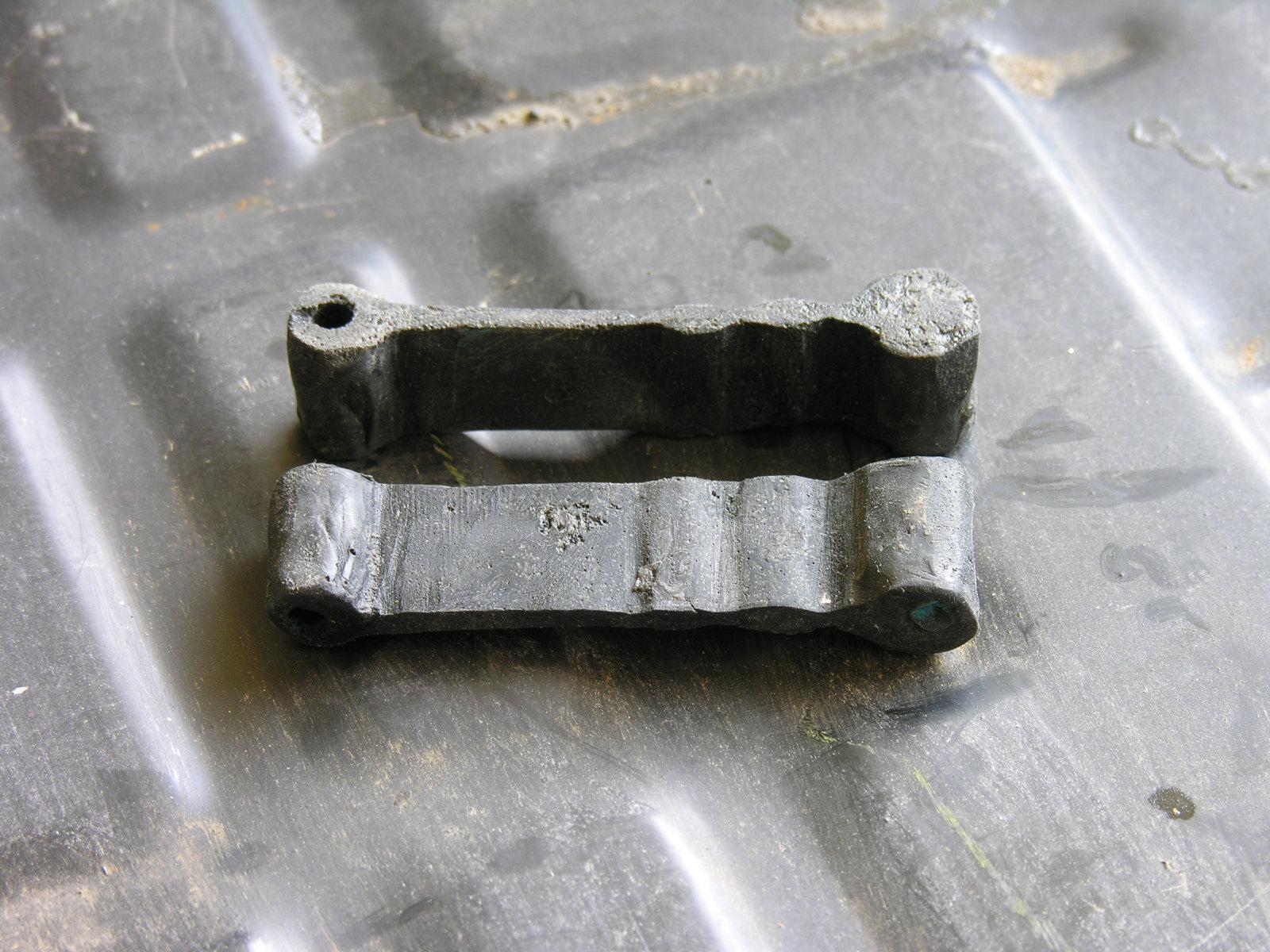

PostPosted: Tue May 20, 2014 1:41 pm    Post subject: Reply with quote
Been a bit since I posted. Still working on it. Went through a round of filler. Then a bit more epoxy. Fitting the doors, hood and decklid before I fix them and cut them in. The door fits need a bit of work, but better now than after I paint the car. also cut the holes for the earlier front blinkers.

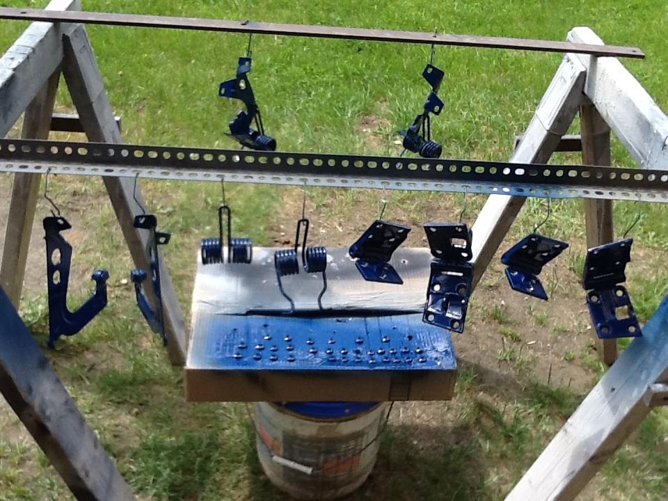

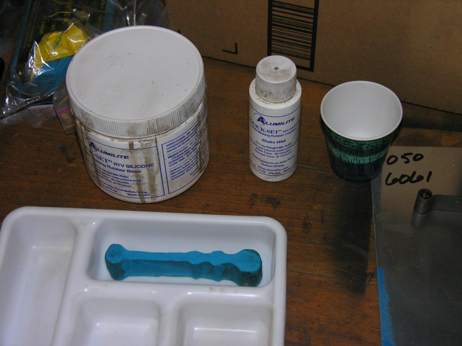

Redid my hinges and made door check straps by making a mould and pouring high impact polyurethane around the old metal straps. After a bit of filing they work good but who knows how long they'll last. The hinges ended up nice and stiff with no sag.

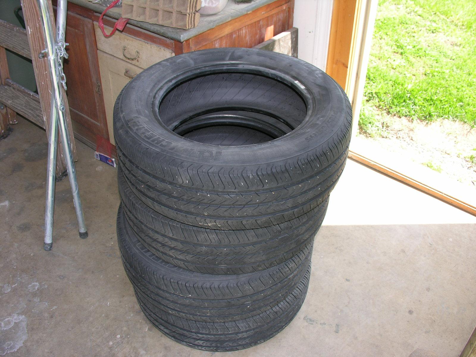

Got a set of used 185/65/r15 Michelin tires for $75 with a bunch of life left in them. Soon I won't have to inflate the tires every time I want to move the chassis. This is also the exact size I was looking for. Good deal all around.
CiderGuy

I bought a set of 5 185/65/r15 tires on American Eagles and put two on the rear of the 70 Ghia I bought to move it. They are a tight fit. I plan on adding small flairs to my 73, which is the car I bought the tires for.

I got room. At worst I'll roll the lips over steel rod. It's going back on the chassis before the outside gets color.

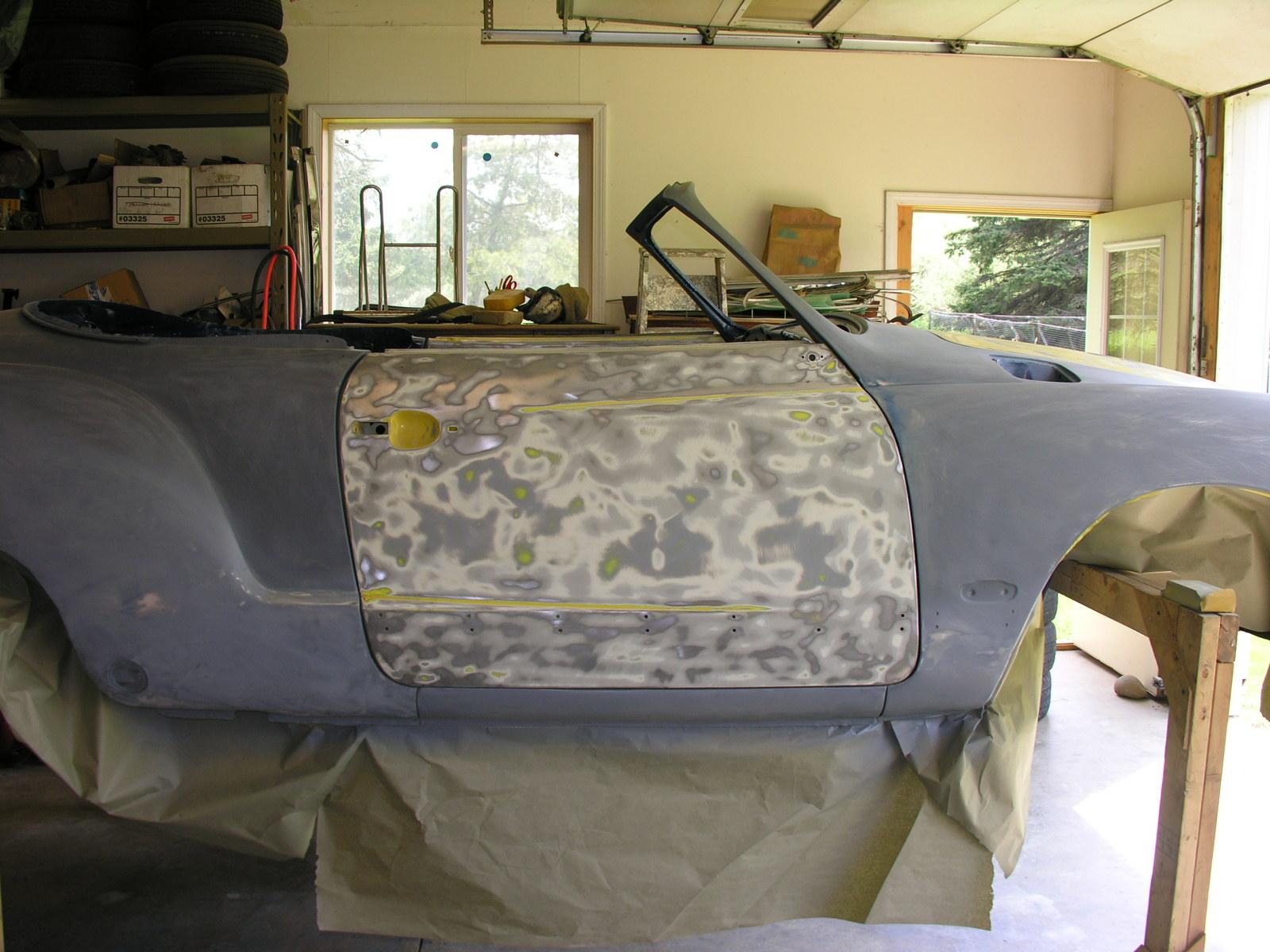

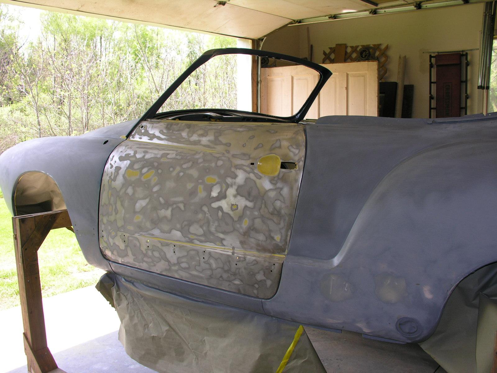

Spent some time reworking the fit of the drivers door. I can live with this.

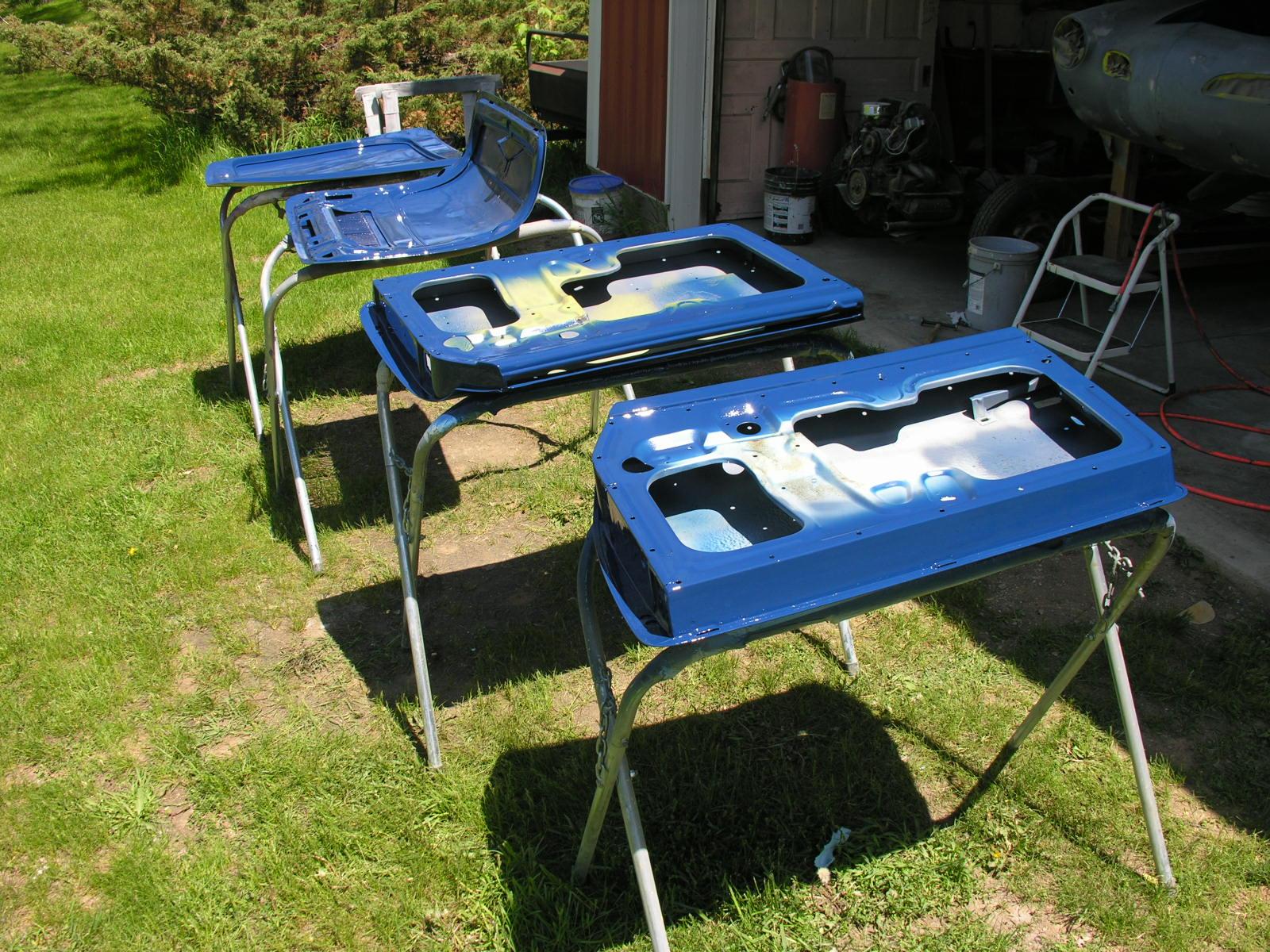

More painting

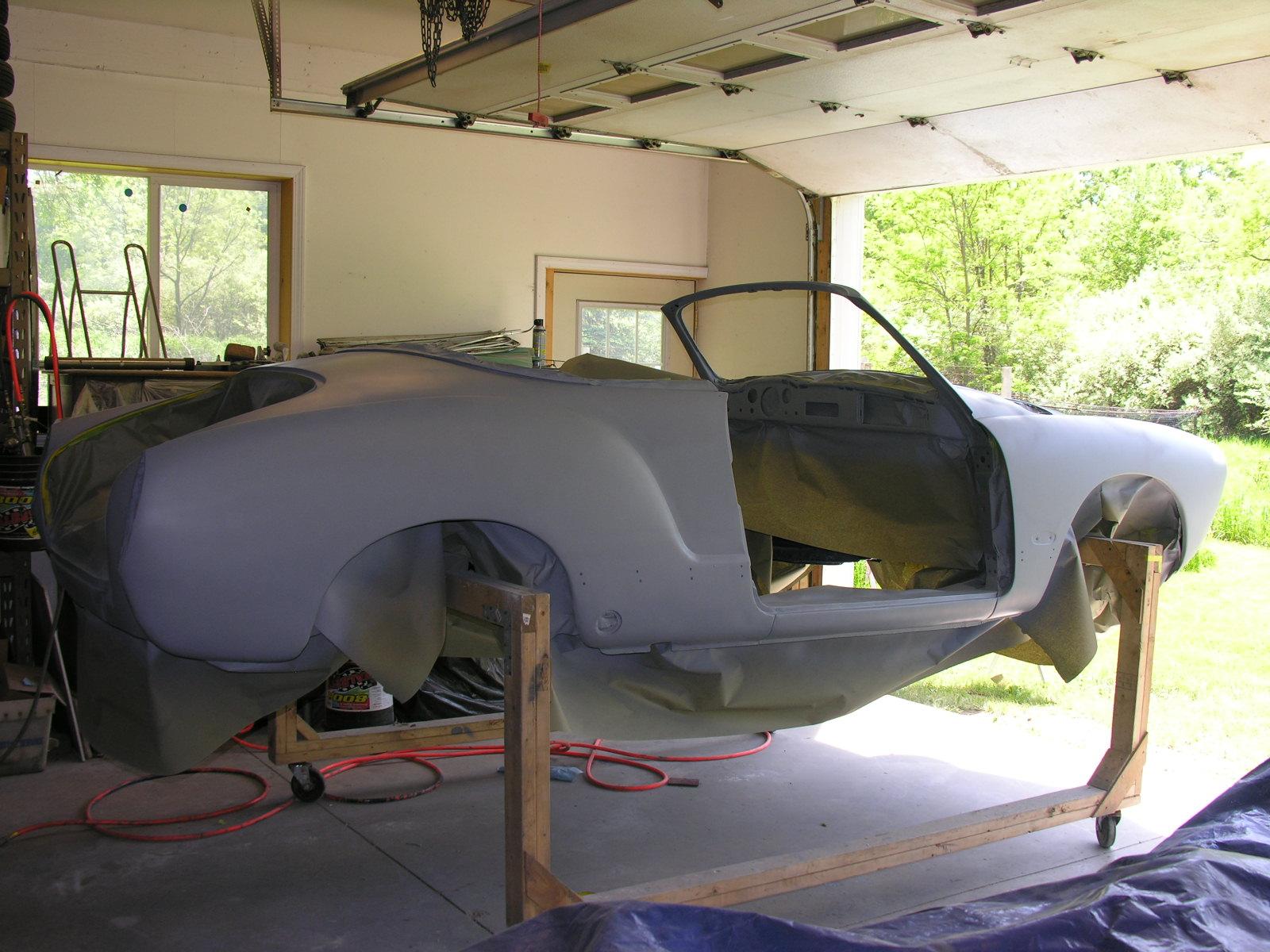

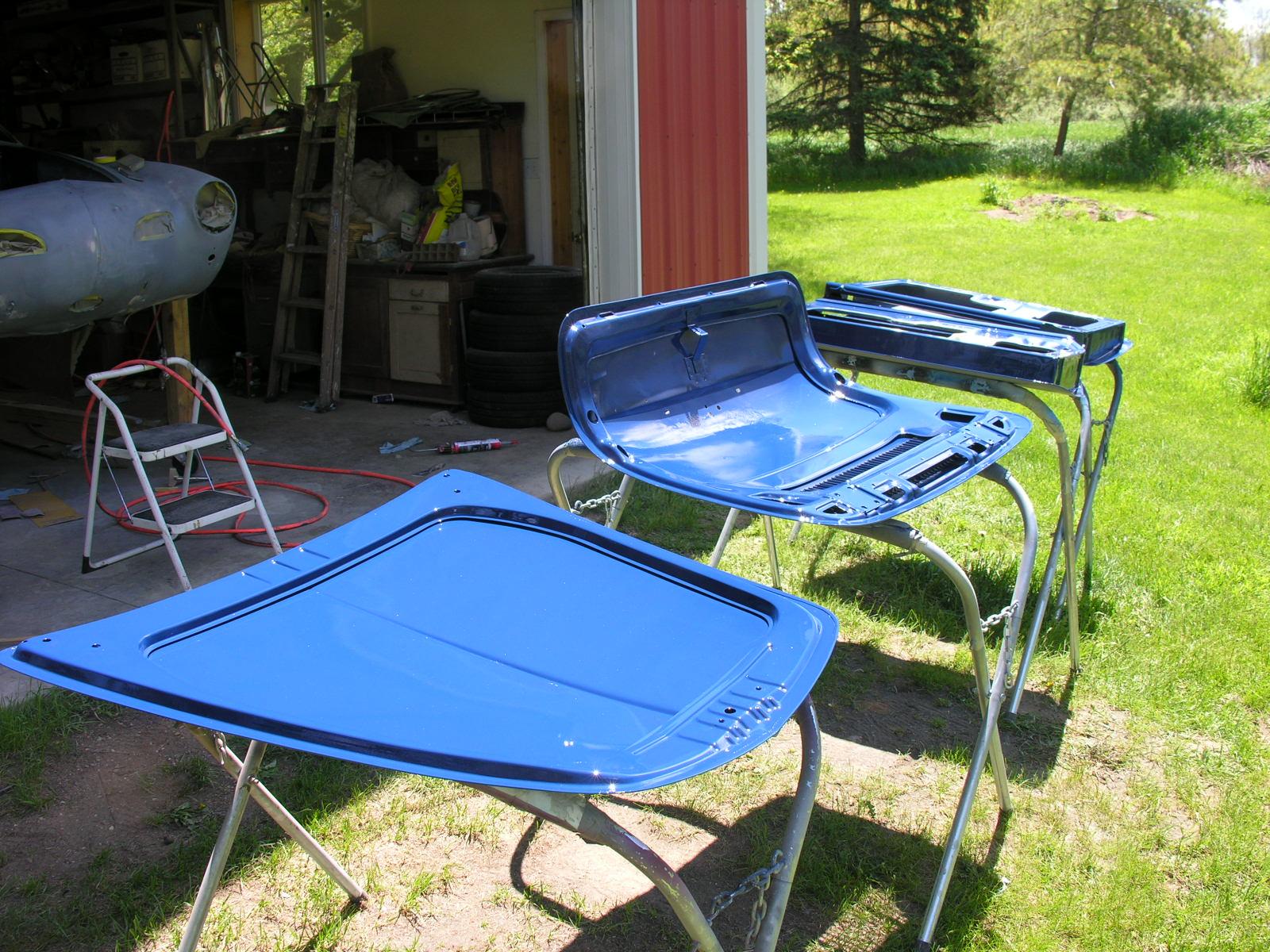

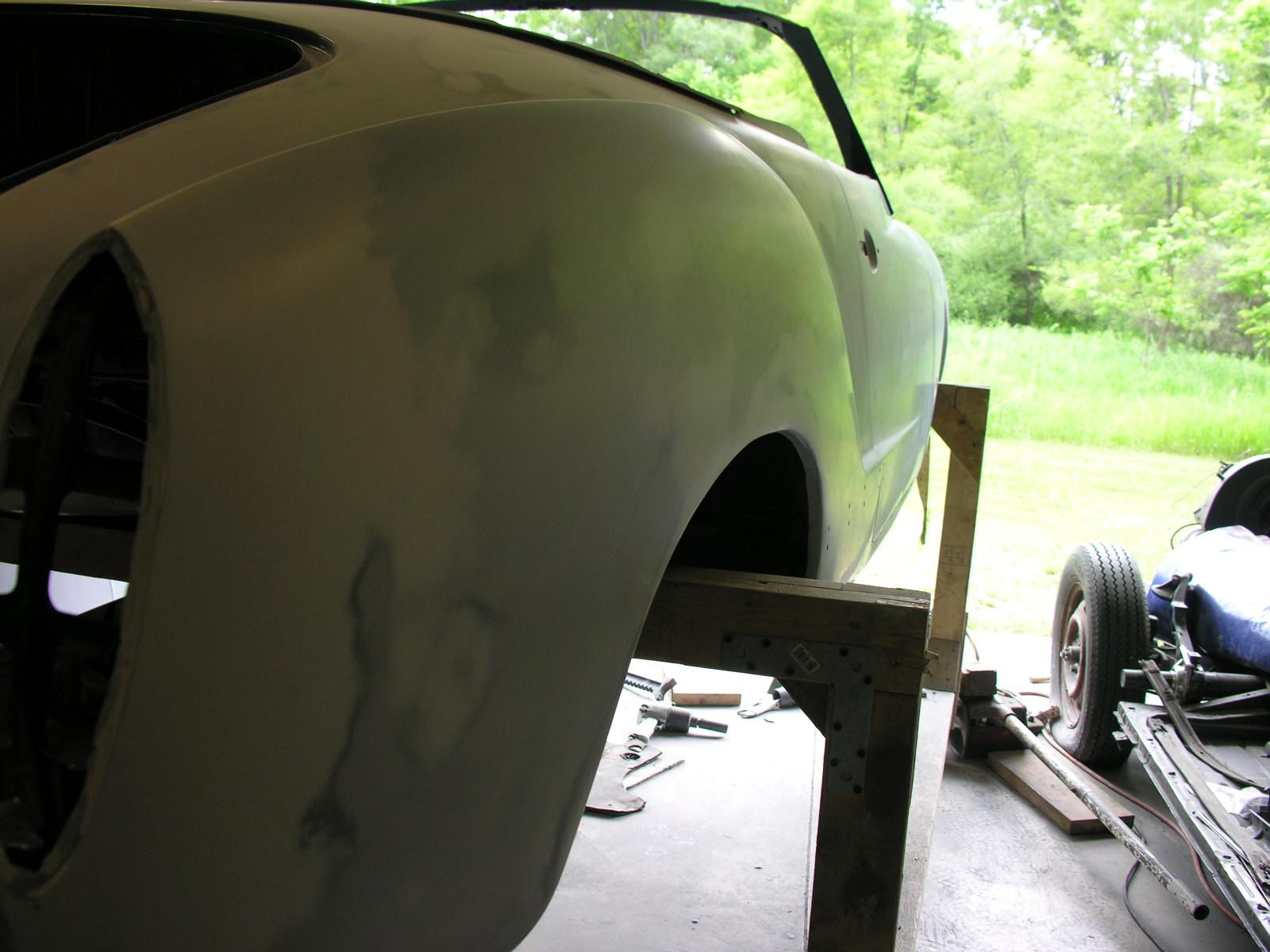

I managed to get to primer stage today. Ive been using some less expensive products since this in a budget build. I will say I've been very happy with Kirker enduro epoxy and their single stage urethanes. I've been using another brand of clear but I forget the name. My main requirement was that it have UV protection.
However Kirkers Perfect Prime is way too thick as mixed even with my 2.2 gun. had to thin it a bit. It also starts to thicken in the gun in no time, It would be fine for spot priming and it sands easy, but trying to prime a whole car with it is a nightmare.
I put down an epoxy sealer coat today and three coats of primer
I don't think I've seen the last of the filler I still have a few spots that will need attention.

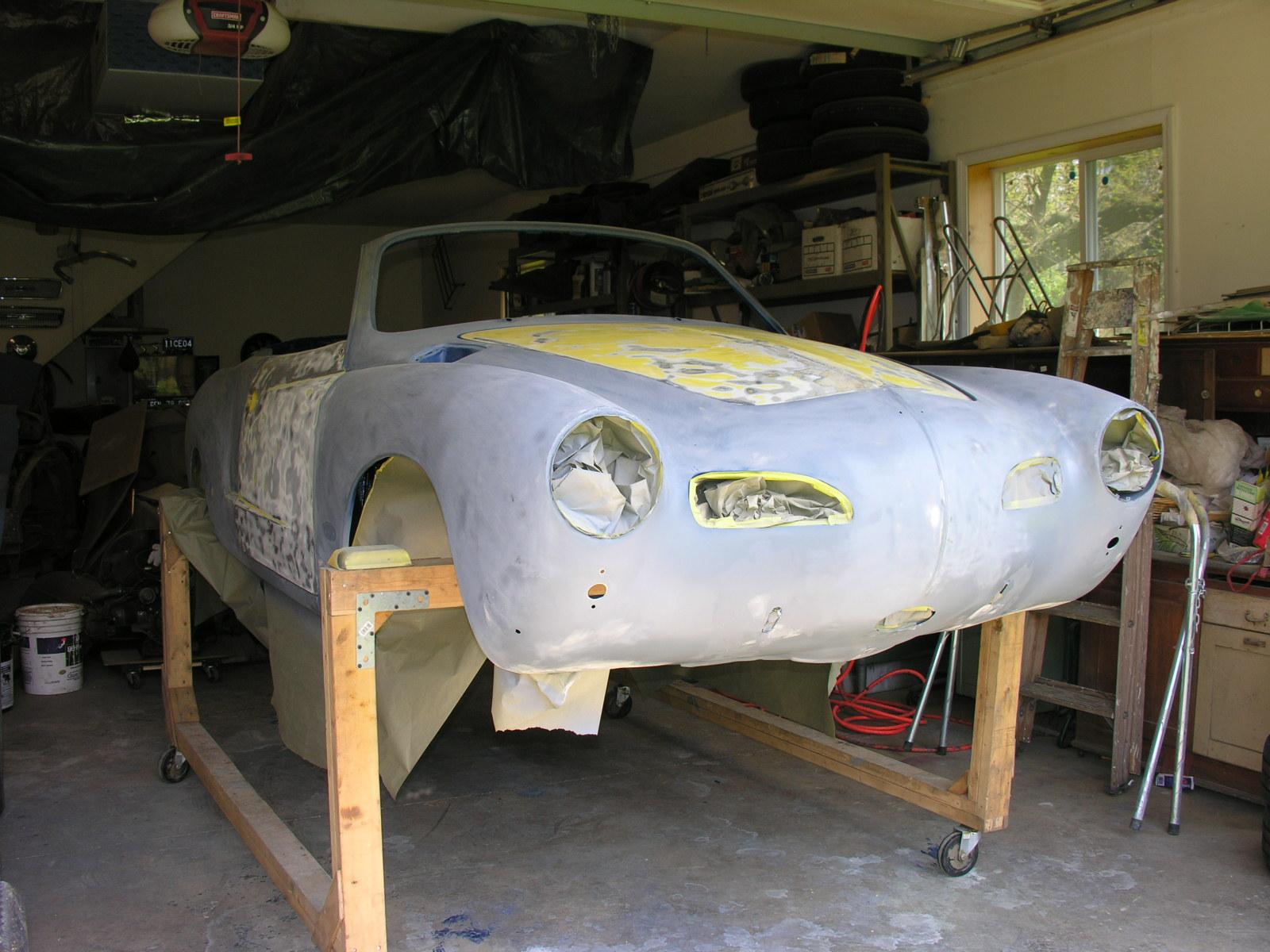

PostPosted: Tue Jun 10, 2014 2:50 pm    Post subject: Reply with quote

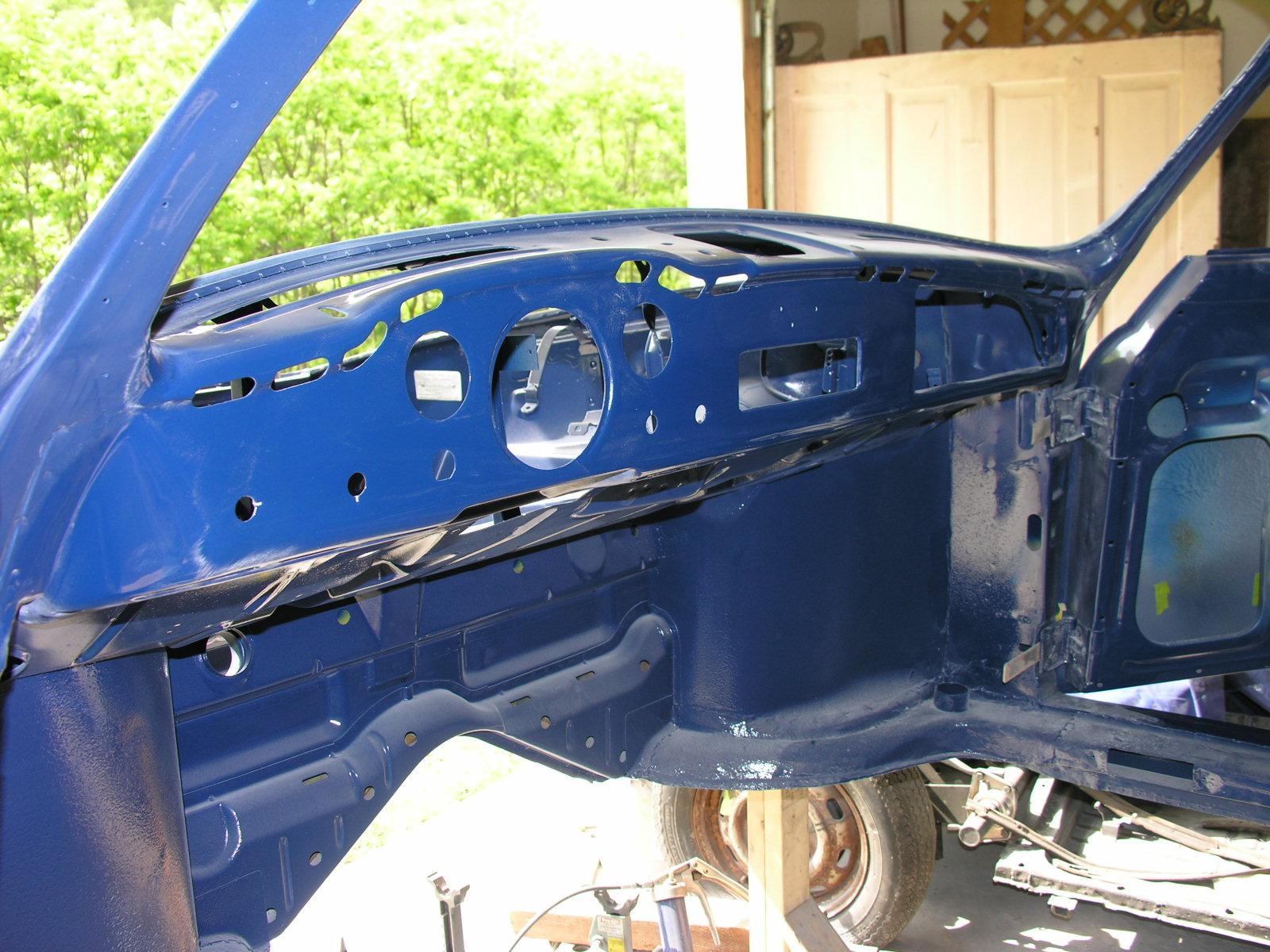

I'm almost ready for paint but it'll be a while. I need to go back and do a few things to the chassis, blast and paint wheels, put on tires. try to get a running engine. plus my truck needs some attention so it'll be awhile. It's best to let primer sit anyway so that any shrinkage happens before you paint.
I painted the dash. It's a bit dusty in there.

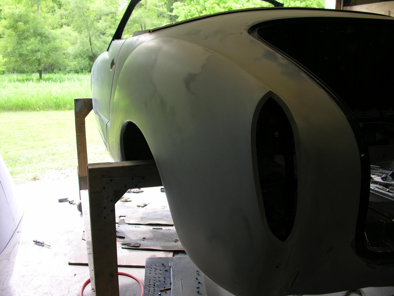

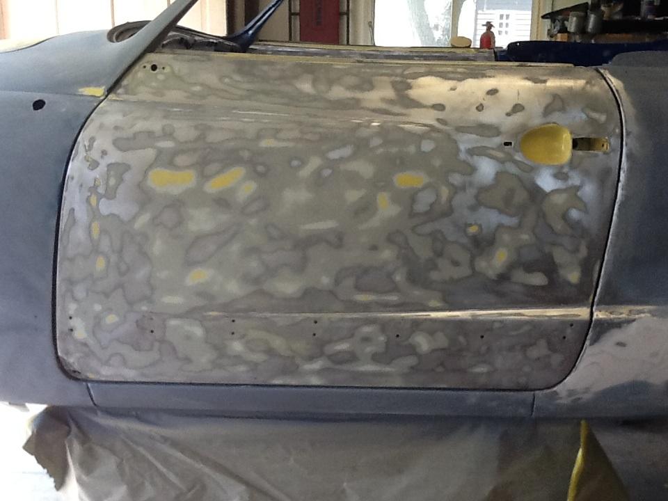

A view of both sides primed and sanded. I blocked with 150 then 240 then went back and did some spot filling and priming, took it back to 240 then DA'd with 400. I need to scuff edges and sand one more time with 600-800 but, it's close.
Here is another before shot. Looks a bit different now.

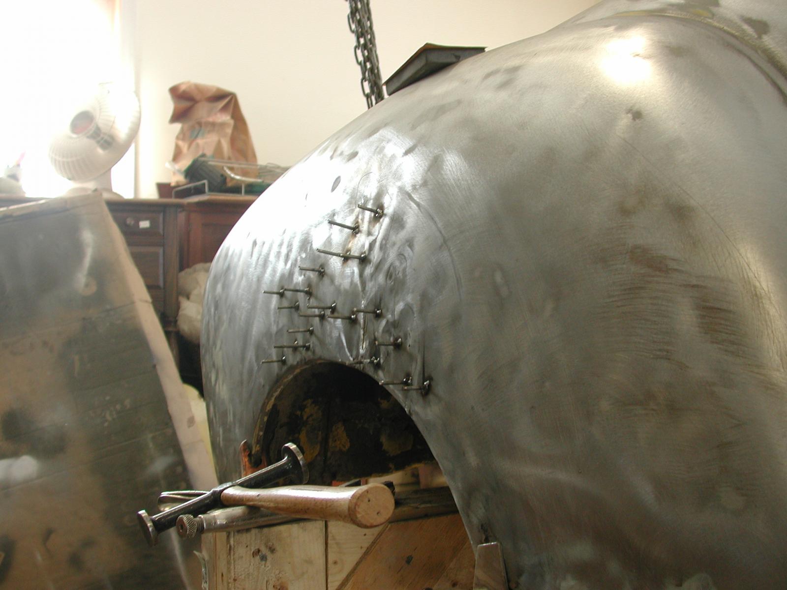

Here is my ghetto method of pulling dents when you can't get behind the metal with a dolly. Or, my substitute for a stud welder. I weld the head of 12 penny nails to the dents and cut them off short. Then I grab the nail with vice grips and pull on the dent while hammering gently on the high spots. Works for me.
