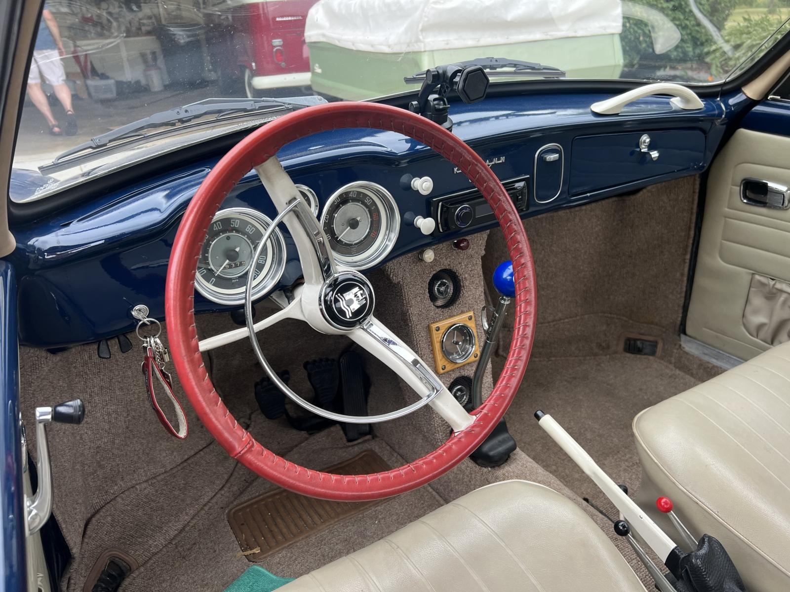

'65 dash in my '67 Ghia. No dash pad. Filled the speaker opening and squirted paint on it.
View user's profile Send private message Facebook Gallery Classifieds Feedback
Braukuche
Joined: September 03, 2004
Posts: 11180
Braukuche is offline
PostPosted: Wed Oct 26, 2022 9:11 am    Post subject: Re: Painting the dash Reply with quote
Looks like you also filled the other holes as well that are punched into the face and underside of the late dash. Looks good.
