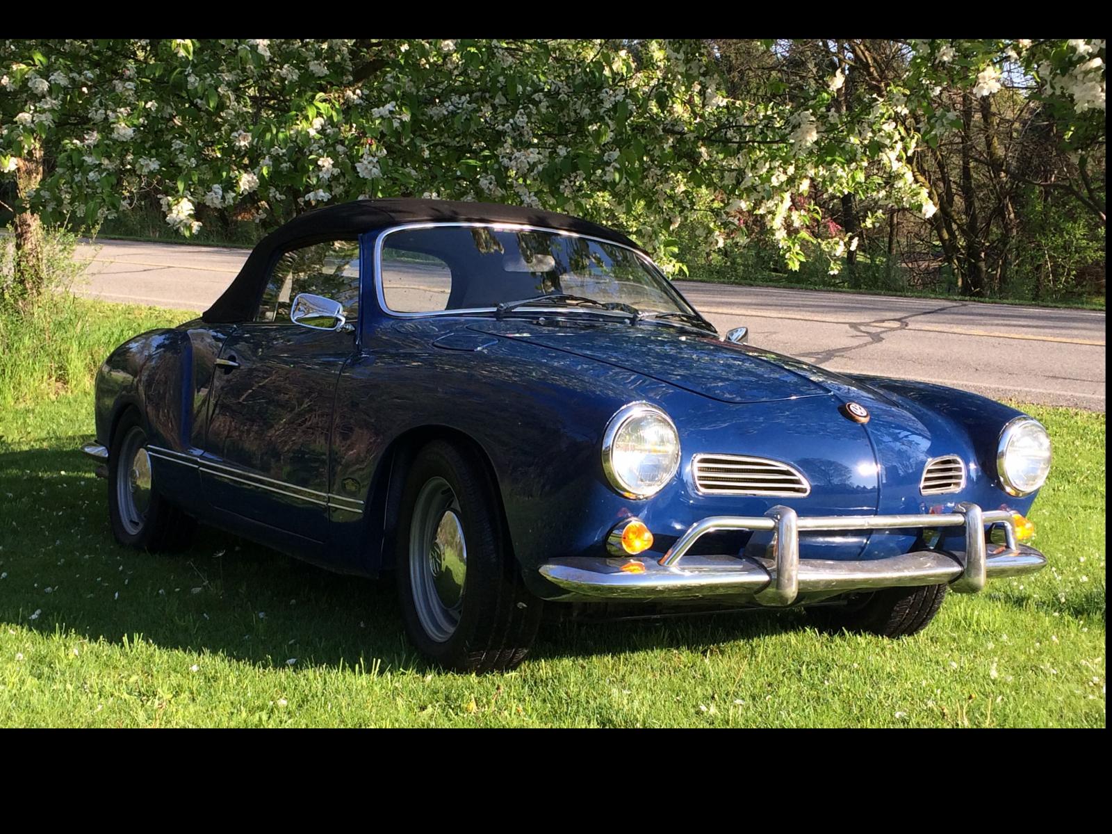

Are those 914 stock wheels on the ghia? They look a little wider than stock, makes a nice stance

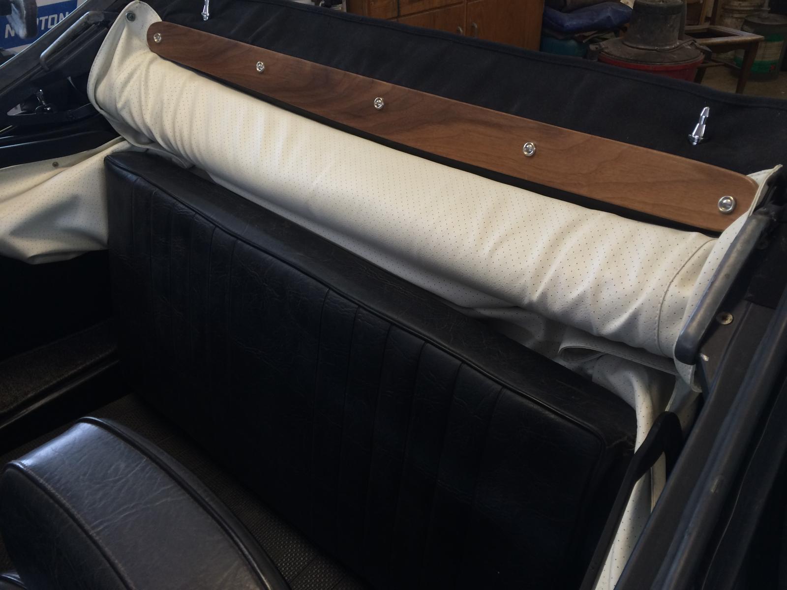

NOVA. If you mean the staple cover I am going to make one out of a piece of walnut I have lying around. If you mean the convertible top cover I would be interested in buying it off of you. Thanks.
The rims are the 5 1/2" wide steel ones that I bought at cip1. The original rims were so rusted that they would bend just taking the tires off. I would have looked for a used aluminum set but I like the VW hubcaps. It is a tight fit at the rear wheels and you may have to bend the lip up. the tires are 185/65r15 and the front is lowered about 1 1/2 inches from a set of adjusters that I welded in the beam.

It was the staple cover. Walnut should look really nice.

Here it is. It's a decent match for the shift knob.
