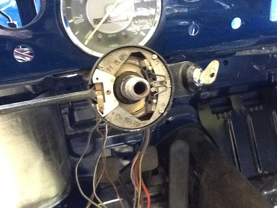

I'm trying to get to a point where I can turn a key and drive it under its own power. I installed the steering column today, and hopefully made a working turn signal switch, plus I added the drivers seat (fortunately I have two seats in good shape).

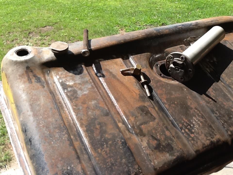

Next is to sort out the fuel tank which is in decent shape but needs a good derusting and painting.
I noticed an aluminum washer in the outlet and when I got it out I realized it was a long bronze fuel filter. Not sure I should put this back in due to possible clogging issues. What do the masses think?

You can replace the filter with the new plastic ones, they can't do any harm by being in the tank seeing as VW designed the tank to have one.

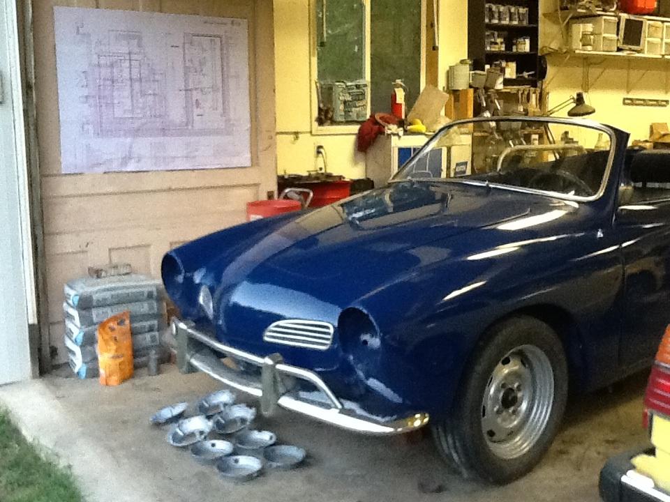

Getting ready to wire. I have 2 sets of harnesses to make one work. Do y'all think I printed the wiring diagram big enough?

looking good! great idea on the diagrahm.
Great idea. I did one on a laminated A3 sheet that got dragged all over the car whilst installing my wiring. Now I'm done the thought is to frame it and put it on the wall in the WC along with similarly treated maps of the London Underground, Paris Metro, Tokyo Rail Network and BART. Laughing
Well let me know if you need an extra pair of hands or eyes anyway. I can be open Wednesday and Thursdays after work, and I still feel bad that you did so much and I did nothing. I changed my muffler, so you won't be able to hear my approach as well this time Wink
I see your Honda is there with the Ghia, hope all is well with it.
Good idea on the printout. I wish I had that when I was sorting out my electrics. It was such a mess that you turned the engine off with the headlight switch. Seriously! No turn signals and the lights were malfunctioning too. I've replaced a number of terminals because they were loose and had no tension, and some would crack when you tried to close them a little by squeezing. Are you going to use brass terminals like the originals? I used the modern silver ones because the goal was to get it running well, but I'll replace them with proper looking ones when I get around to it.

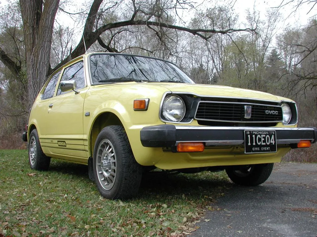

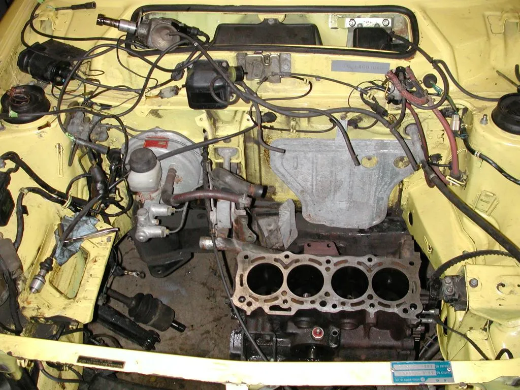

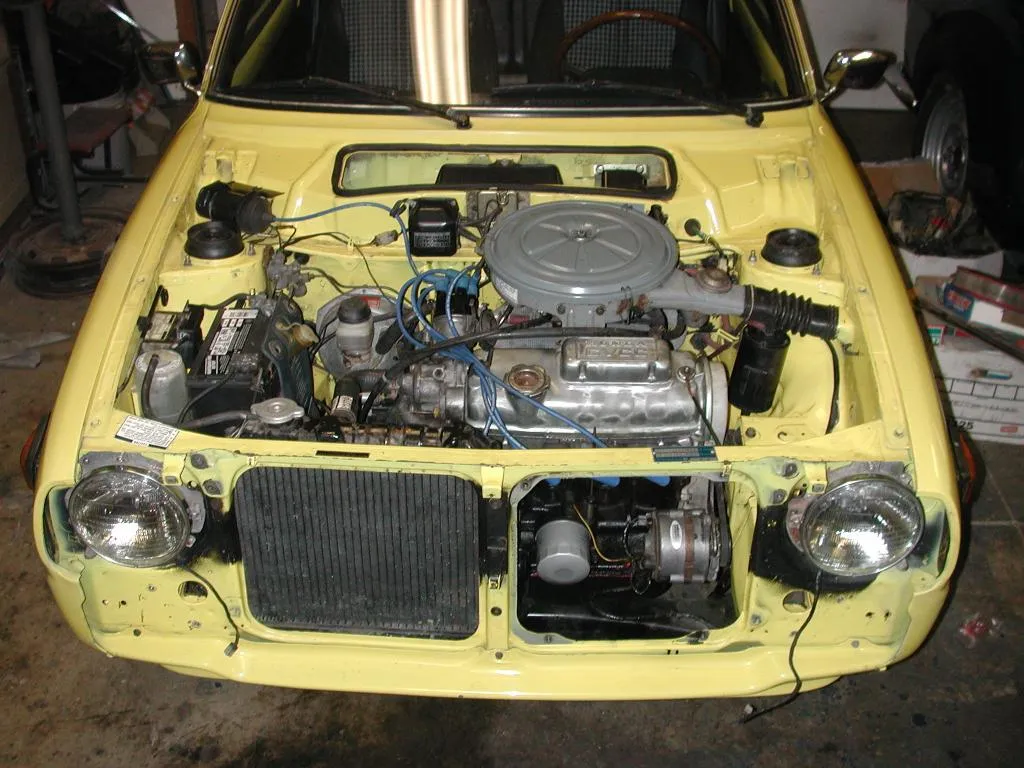

The Honda blew a head gasket which is common on that model. I've had to change one before on another car, and the 3rd time I've done that on a CVCC civic. The 1st time in 1989 it cost me $1000. Why I didn't give up on them at that point I have no idea. It likely needs a new timing belt anyway and that's a good time to do it.
So. The plan is to install what I can in the ghia and then clean up the area and fix the civic. maybe sell the civic in the spring.

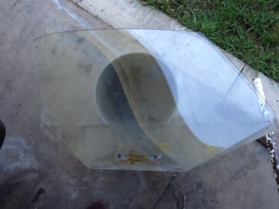

I was putting the door windows in. I thought it would be good to see just how different coupe and convertible door windows are. The answer is dramatically. The mounting holes are lined up in this photo.

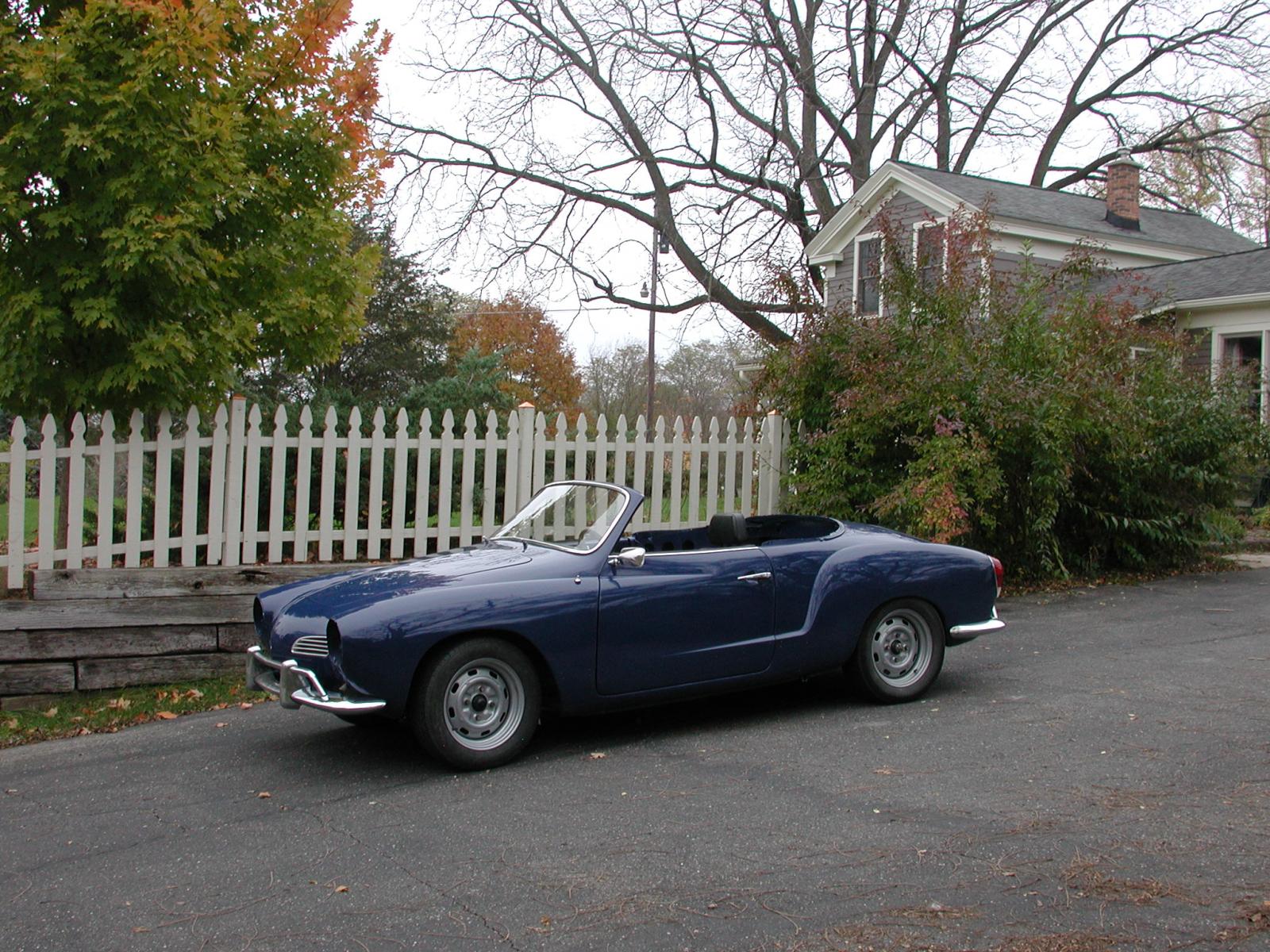

REBORN!
I put a key in the ignition, started it up and drove it around the yard today.
Like most zombies it needed a jumpbox. (have you seen the price of batteries lately? I'll get one in the spring)

She sure looks pretty...... What kind of headlights are you planning on using?

looks great!
I replaced two batteries this year, couldn't believe how high they are.

Round Very Happy
I have the 4 from the two cars. 2 of them are General Electric and match so if they work I'll use those. I only have the minimum wired up to run. The headlight harness needs a little surgery still.

Rebuilding the Honda engine.

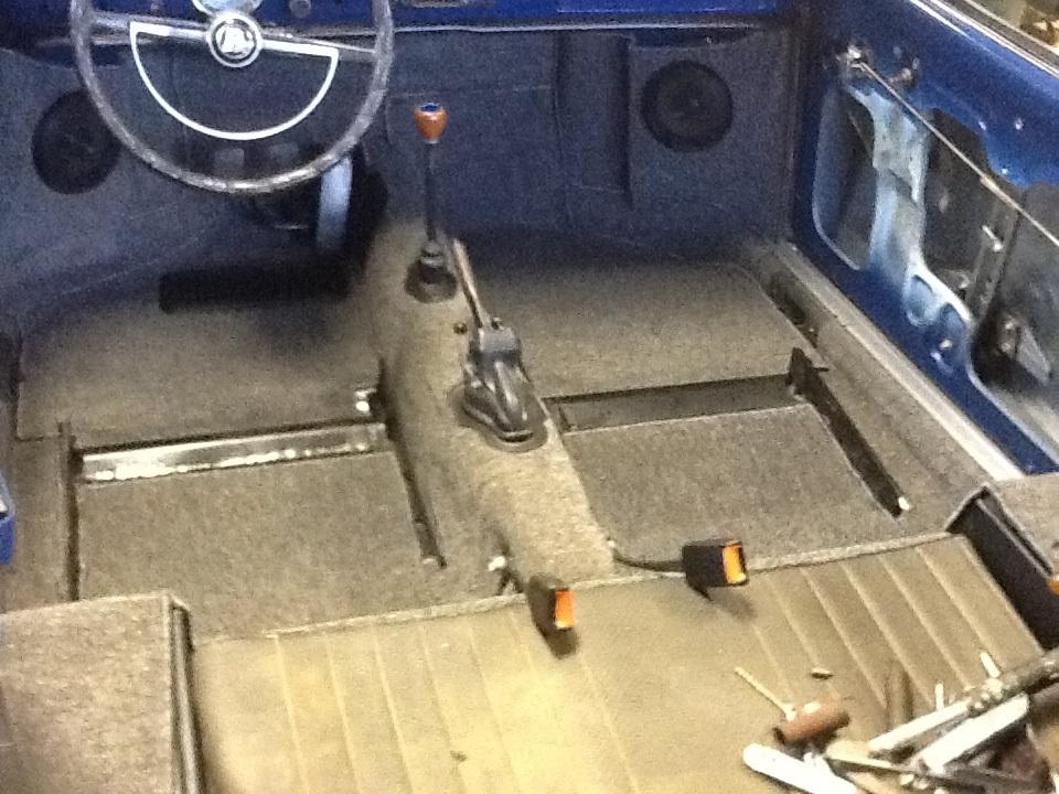

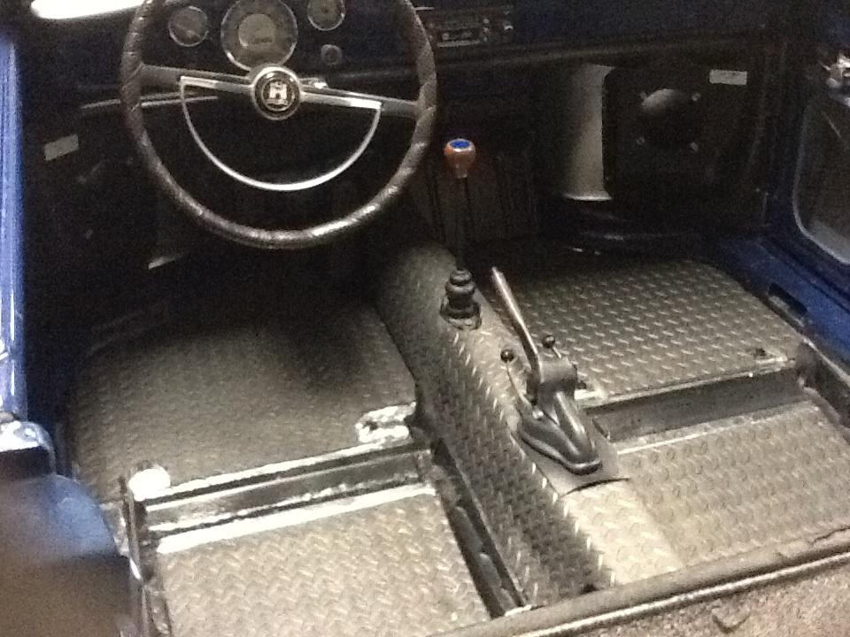

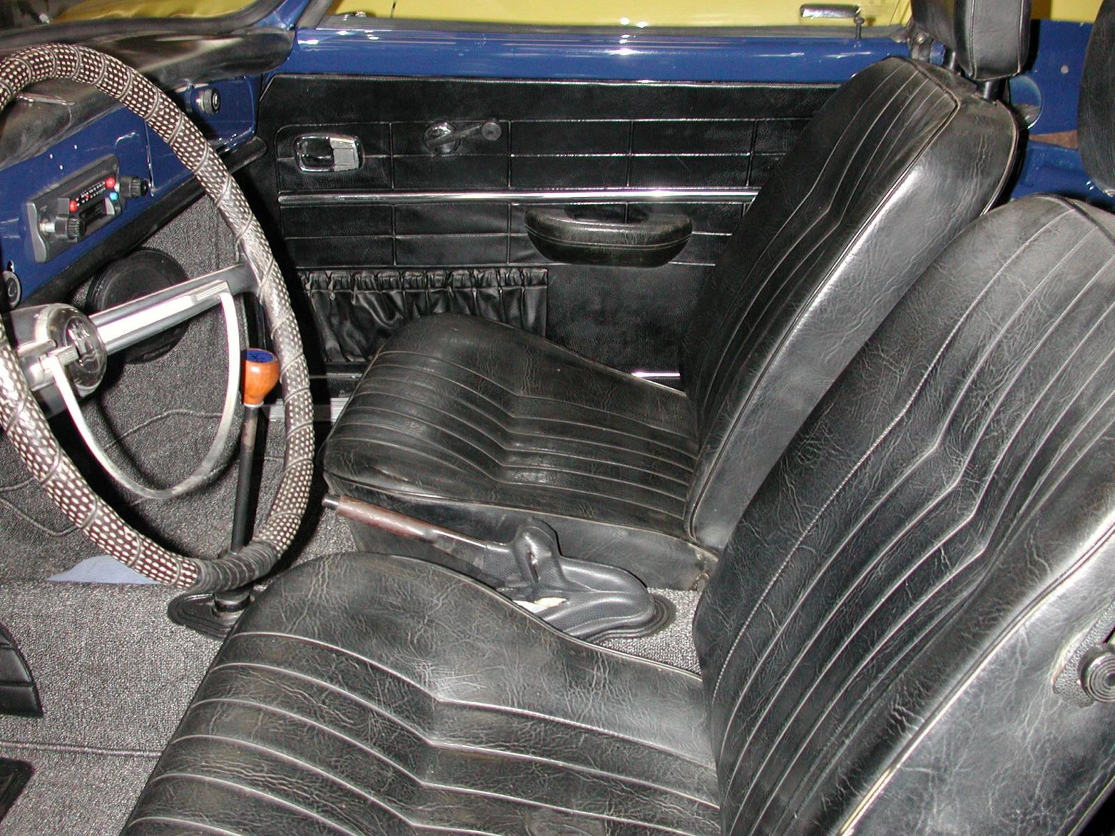

Not the best pictures. I put down some padding for under the carpet. I just used a couple of $7 harbor frieght walking pads. Closed cell poly foam, about 3/8 inch thick. The carpet is TMI salt and pepper gray loop. The fit is pretty good. A good price point. I wanted something that would hide a little dirt.

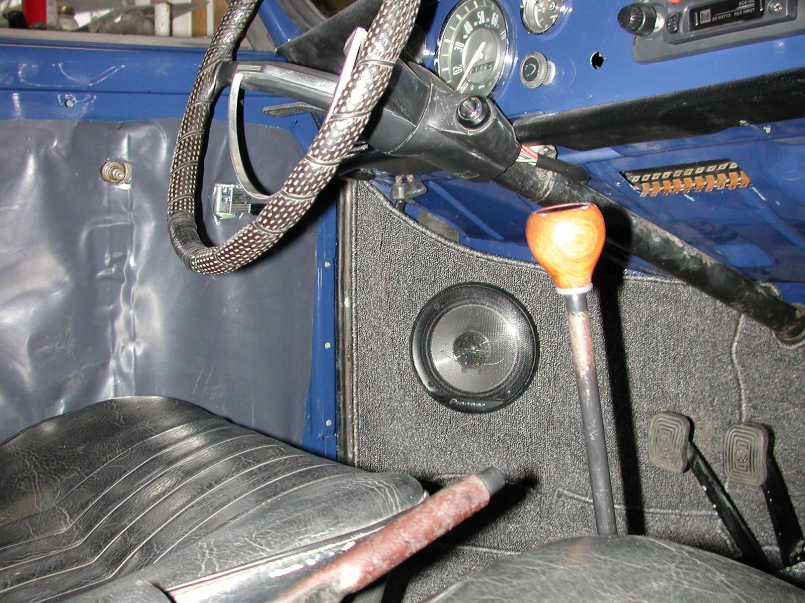

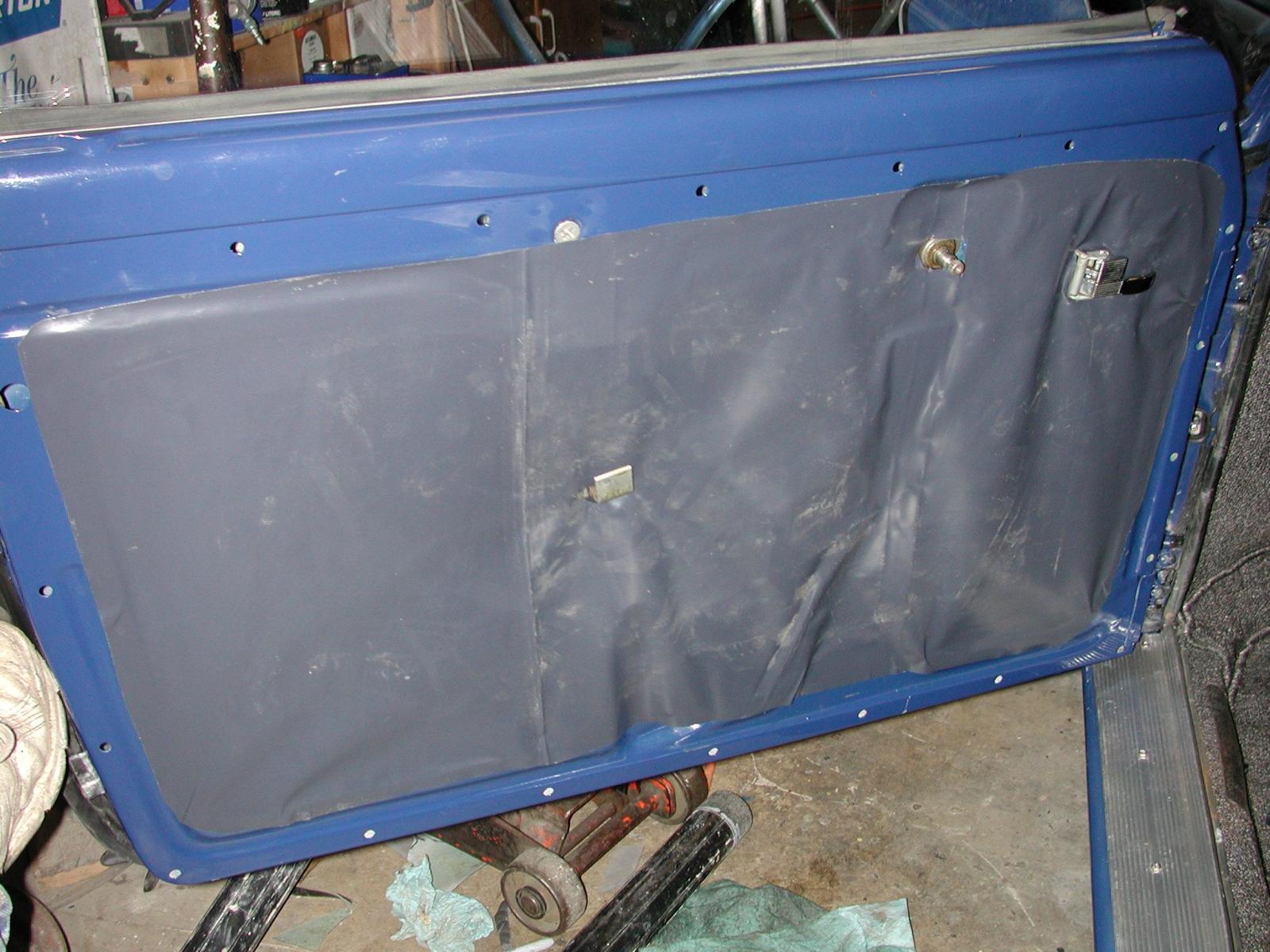

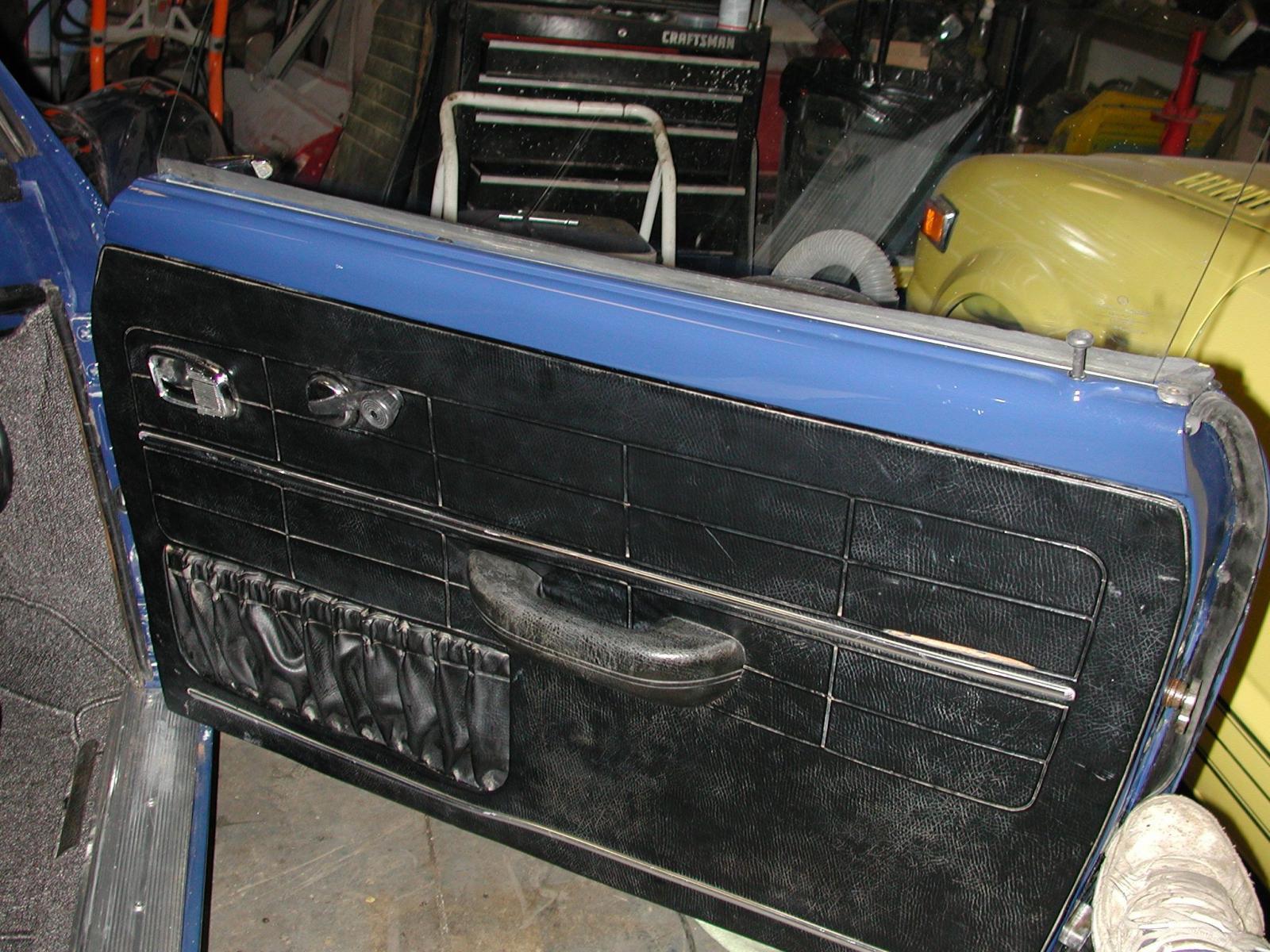

Worked on the interior a bit more today. Slow going. Used some 8mil black plastic and contact cement for the inside of the door panels.
The in cleaned up and installed the passenger panel (I reglued the pocket in).
I wish the Left door panel were in as good of shape, its waterdamaged, dried up at the bottom and has a speaker hole cut in it so I'm going to see if I can do some surgery to it before I use it.
I installed the seats and drove it around the yard a couple times. Hopefully the last time I need to do this (fun isn't it).
I've been leaving the patina on some things. I hate to erase all the character a car has. The emergency brake handle and shift rod aren't really this brown looking. The flash kind of did that. The electrical tape and steering wheel wrap are kind of growing on me.

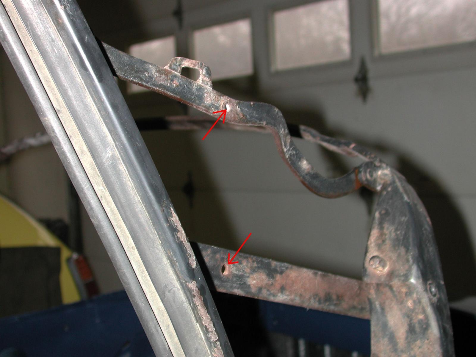

QUESTION: I've begun to fit the convertible top frame and I've noticed that I'm missing a bracket on each side of the assembly. I have the hollow curved rod/tube that goes between but not the brackets that go between these 2 holes marked with red arrows in the picture below. Does anyone have a close up picture of this area or can direct me to one. Thanks

Searching around a bit. It appears that it's just a 4" twisted bracket that pivots at just the top hole and welds to the round headliner support tube.
I should be able to make those OK.

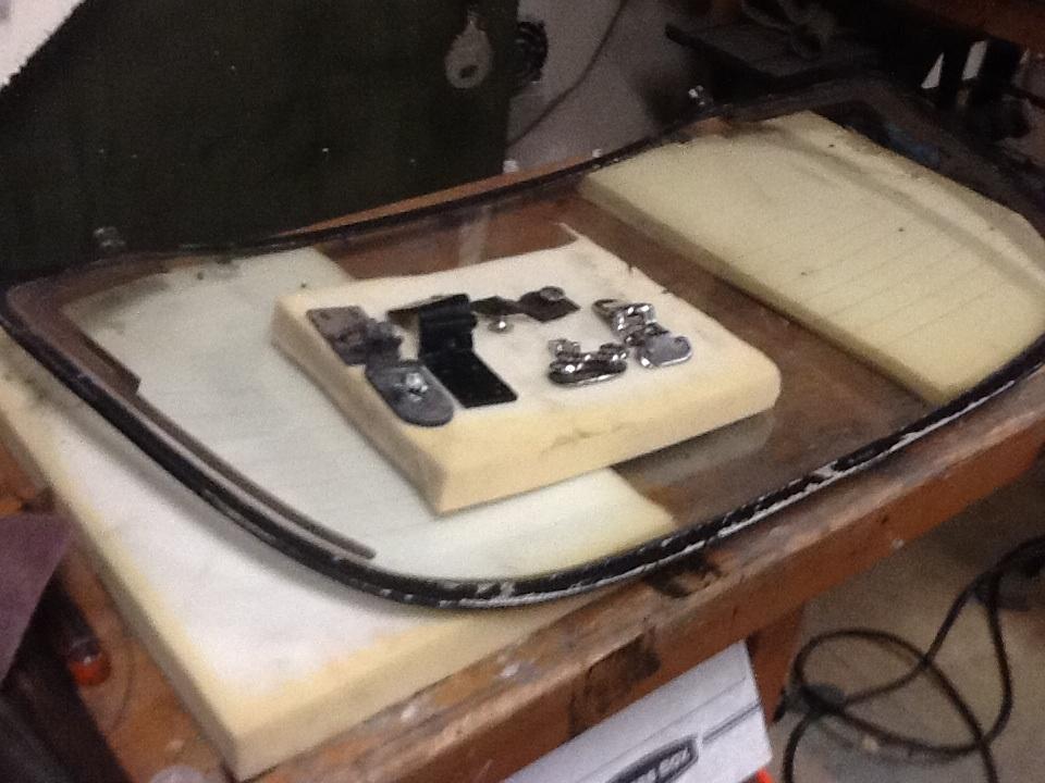

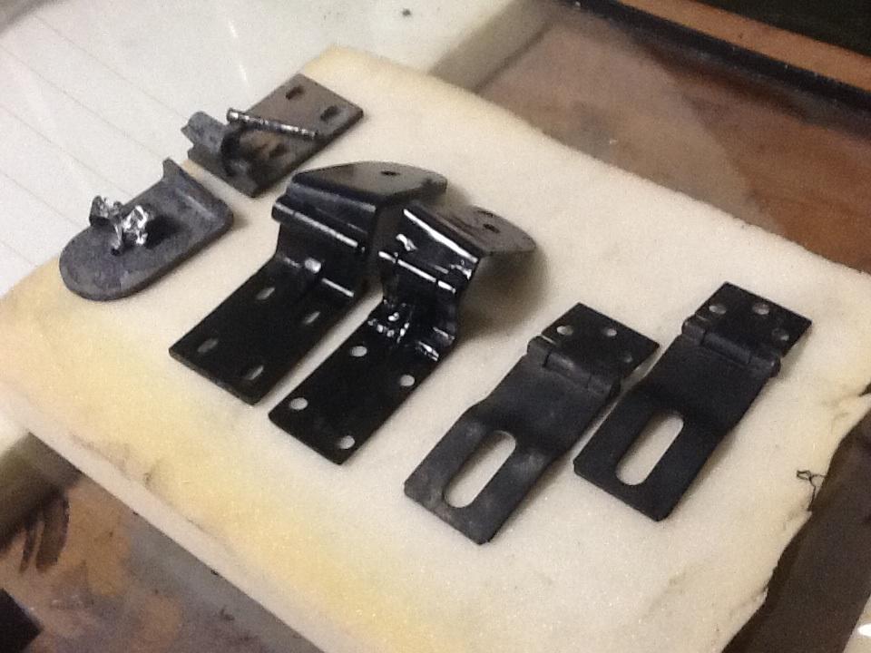

I did not realize that all the rear window parts were made of gold. Lucky I have them. The vert I bought was a rusty mess but apparently this little pile of parts is worth more than I paid for the car.
I started another thread before about the rear window hinges. One of them broke on me when I was trying to unseized it, just with hand pressure. Upon further investigation I found that they are made of zinc! Some people call it pot metal. Anyway it seemed the only option was to buy another or recast the part. Ummm, no.
With the help of a drink or two I got busy on making another out of some spare gate hinges I had sitting in the basement. The function is the same even if it doesn't look quite the same. From what I can tell it is not very visible after it is installed. If it bothers me later I can always fork out the $ for a used one.
So soak these hinges for a good while before putting force on them!!!
