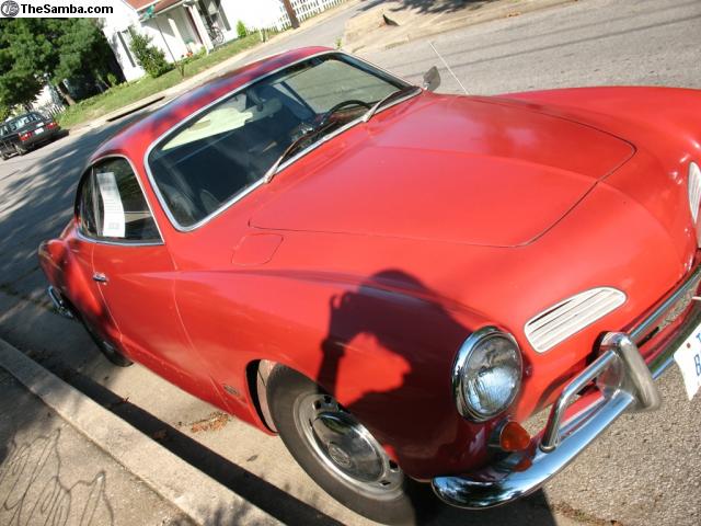

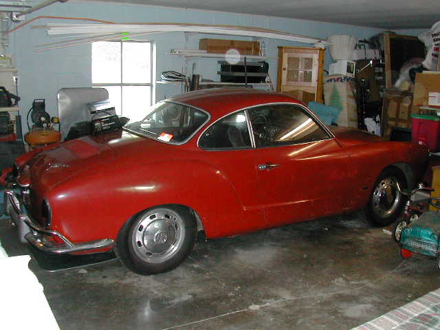

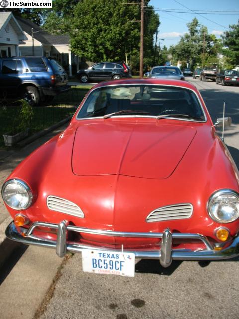

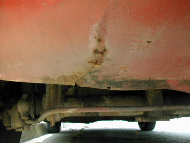

I had been half-ass looking for my wife a Ghia for about a year when this one popped up in the classifieds.
It was close (90 miles) and it appeared to be in decent shape body wise with no major rust issues, plus it was a running driving car. Since I'm knee deep in rust repair on a '62 beetle I was definately looking for a solid car. I contacted the owner (Hi Grace) and made an appointment to go see it on Labor Day. I had every intention of bringing it back with me but my wife reminded me that I had sold my pickup that had the hitch on it so I was able to leave a deposit and pick it up the following Saturday.

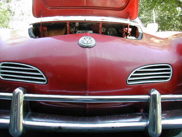

Here are a few pics that came from the ad and one that the owner sent me in an e-mail.

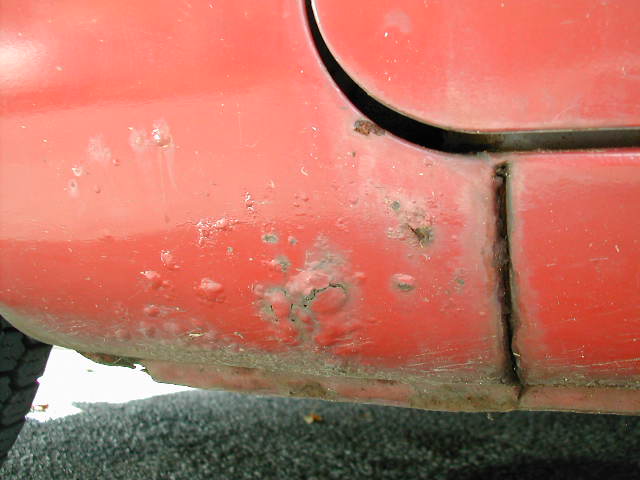

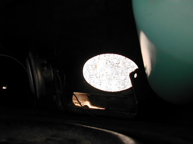

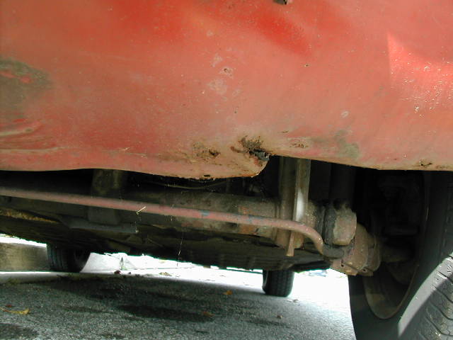

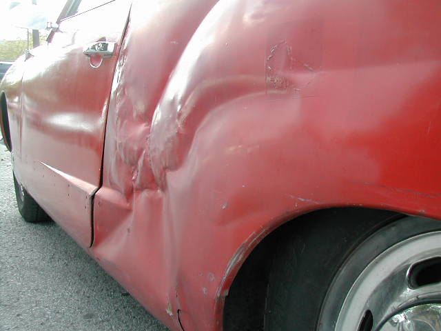

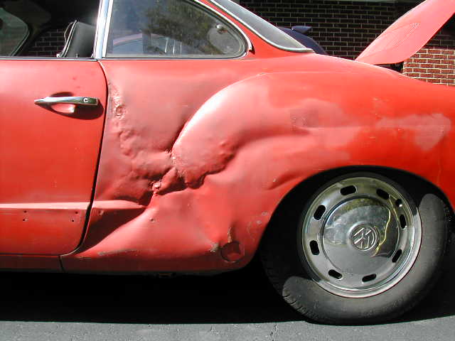

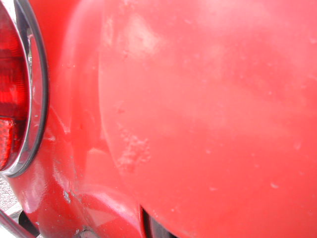

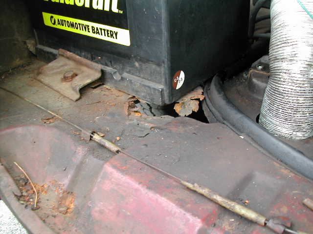

From the ad you could tell it has some issues in the rear quarter and battery tray areas. The engine is in the right group of numbers to be the original. Overall it was what I was looking for. I went and looked at it and made the deal. Here are some additional pics I took.
starting at the passenger side front and going clockwise

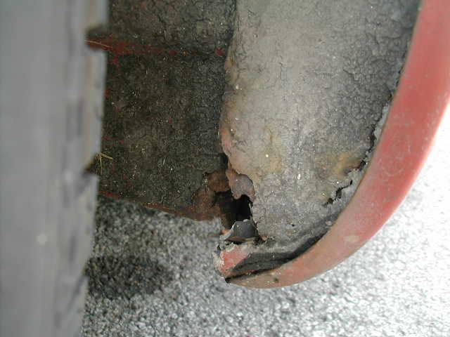

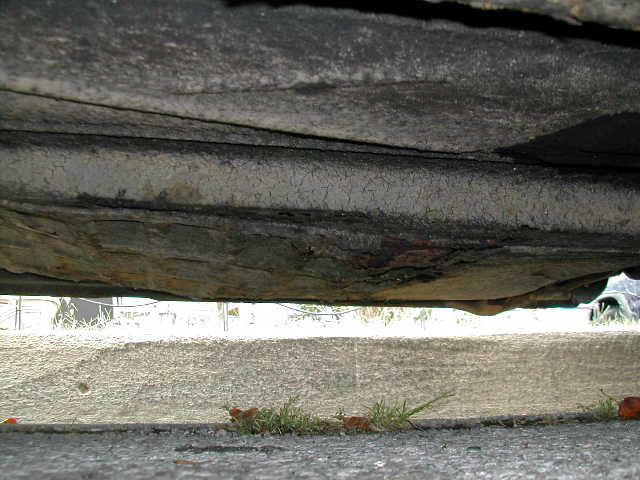

Here is a closeup of the rear quarter and some other areas that will be needing some attention

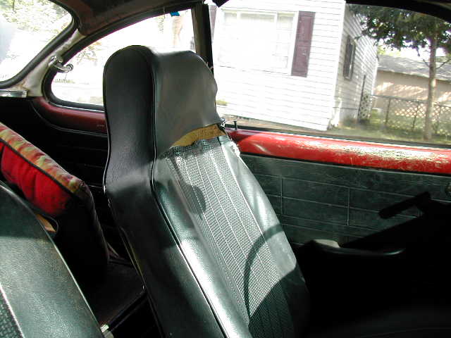

Along with the bad a few pleasent surprises

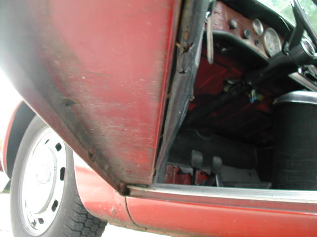

Some more issues

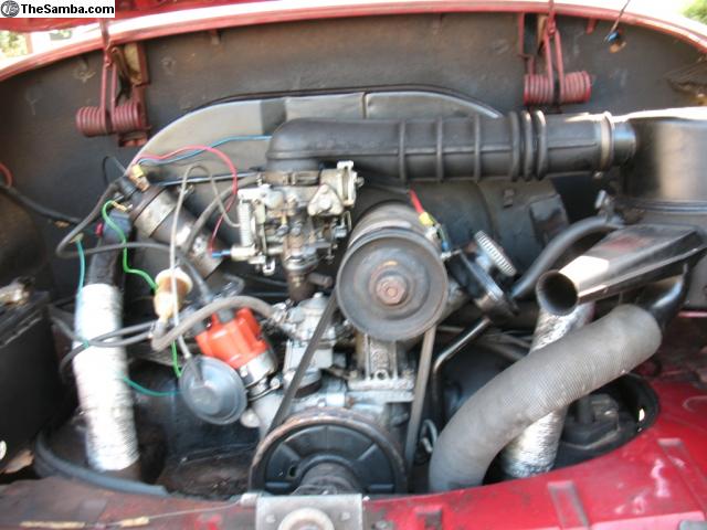

Overall it ran fine (forgot my compression tester ), steering was tight, brakes needed adjustment, it was a little hard to get it in gear and shifting was tight, and finally it suffers some of usual wiring problems of a 41 year old car. Nothing major just a bunch of little small things.
Things that I'm going to do right away:
Move the fuel filter out of the engine compartment

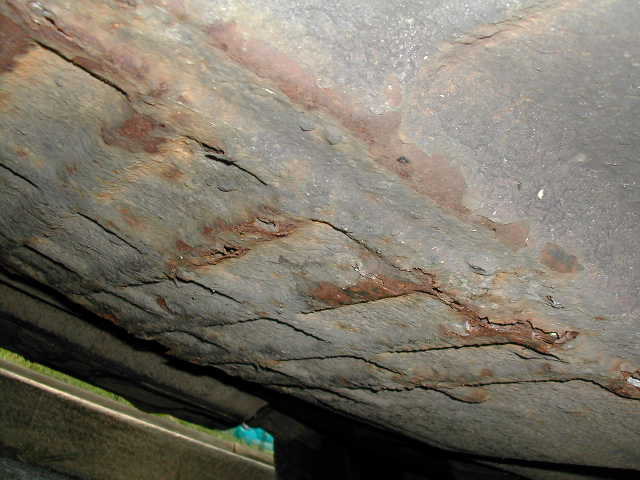

Pan halfs both sides
Battery tray

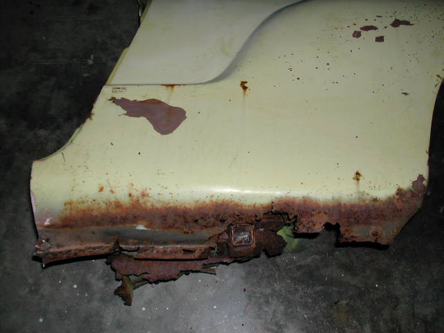

Wow, that quarter really got messed up. Otherwise the rest of the car looks good. You might even get a shine out of that paint with some buffing. |
Back to top |
AndrewStapp Samba Member
Joined: August 29, 2009 Posts: 179 Location: Springfield Mo
Posted: Tue Sep 15, 2009 8:14 pm Post subject: |
70 140 wrote: |
I have done some body work and trust me, the rear quarter is goning to be a mofo. Other than that, not to bad, pans will be pretty easy, and the rest of the metal work should be a pice of cake if you are doing rust repair on a Beetle you will have plenty of practice. Big question for me is, how much did you get it for? Looks like you have a solid start for a real nice car. Congrats. |

I considered taking a look at that car. Seemed like a decent deal. _________________ '65 Deluxe bus long term project |

I wouldn't waste any time trying to reshape that quarter. It might have had a chance when it was originally dented, but whoever previously tried to bang it out totaled it. The good part is, the area you need isn't usually rusted out - I can think of a few sitting in fields that could give up that chunk. |

I wouldn't even bother with those floors now. Fix the battery rust, and you should be good to go for years to come, or at least until your 62 is finished. _________________ My 71 Ghia Been in my family since 1980

Floors will be an easy fix. I'm thinking a couple of weekends to knock them out. Since I just took the heater channels out of the 62 I really don't think a few weekends delay will matter much. _________________ The 68 Ghia

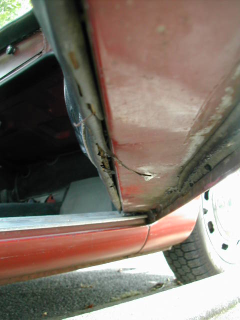

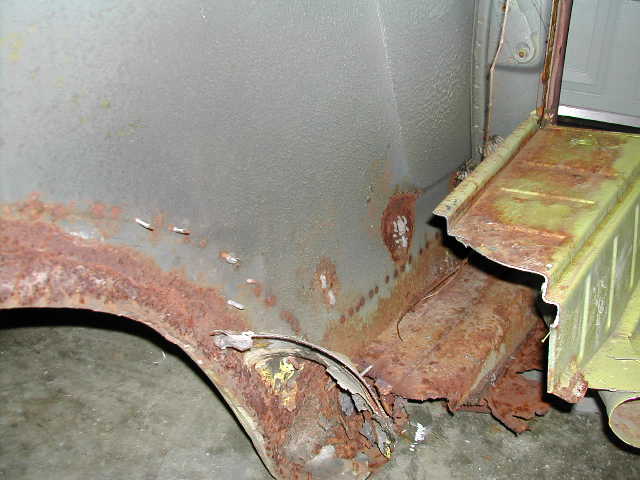

There are some issues on the bottom with rust and some previous attempts at repairs but I think the area that I need should , for the most part, be solid.

Depending how far you want to go on the restoration, you might want to check the rockers when you do the pans and the quarter panel. The rockers on the Ghia are a bit different than on a beetle and even that the outside looks good, the inside could be full of surprises. _________________ 60 Beetle Convertible

First order of business this morning was to install the nose emblem that came in the mail a few days ago.
One of the mounting holes had been bondo'ed over. Nothing a phillips screwdriver and a hammer couldn't take care of. Then came the task of figuring out the warning light. First I had to find out which light it was, generator or oil pressure. The wiring diagram shows it as the generator and the owners manual shows that the oil pressure light is in that posistion. I pulled the oil pressure wire off while the engine was running and the light stayed on, so generator it is.
After opening my cheap ($2.99) Harbor Freight multi-meter and reading the instructions I felt reasonably confident I wouldn't kill myself of catch anything on fire. At this point I should mention that I hate to mess with wiring. I don't understand it and the few times I've dealt with it before resulted in some burnt up electronics and a small fire. Hell, I've sold cars because of wiring issues but I had decised that I was going to learn. So with my trustee multi-meter I was ready.
I had done a search ( ) and found a couple of tutorials on checking a generator to see if it's charging. And sure enough it wasn't. It turns out that I've got worn brushes. Is that something that I can change or do I need to have an electric motor place do it? If I can do it where would I be able to buy the brushes?

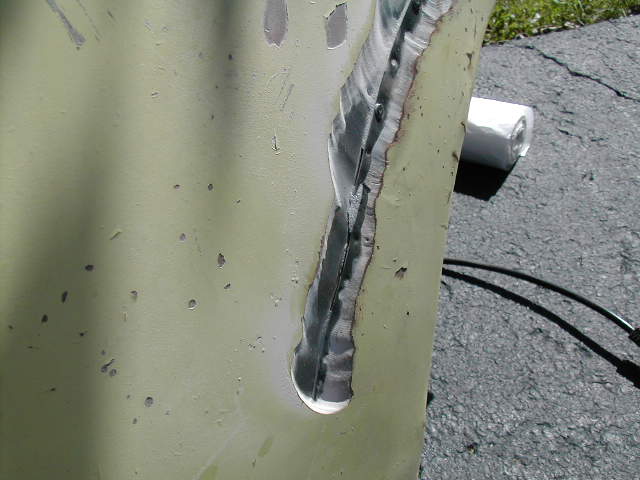

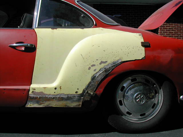

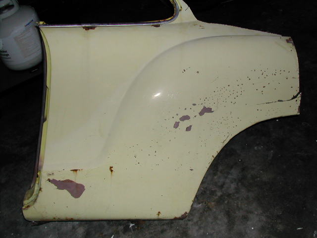

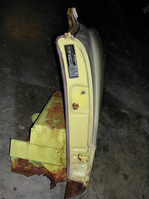

Next I decided to start cutting up this piece to see what all I could salvage out or it.
It had been repaired (rather poorly) in the past so I was going to cut it down to the good parts to see what I had.
There was a combination of pop rivets, pan head sheet metal screws, spot welds & self taping bugle head screws. The reason for the screws was that out of the 30-40 spot welds only about 6 of them had enough penetration to hold.
Here is the piece after it was cut down.
You can see where the two pieces were overlapped. I was surprised that the metal was in such good shape. I was expecting a lot more damage.
Since I had it all trimmed up I though I would just place it on the body to see if it would cover most of the damage. Here is a closeup of the damaged quarter and with the piece in rough place.
It covers up almost all the damaged area. A little clean up and some more trimming and it will be ready for whenever I decide to start cutting.

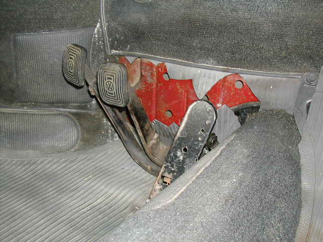

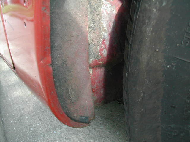

Now comes the part that I had been putting off, the hard shifting. The thing I had been dreading doing the most turns out to be the simplest fix of the day. I had imagined having to replace the shifter coupling, endless adjustments to the shifter and finally nothing working and having to replace the transmission.(Can you tell I was dreading trying to find out what was wrong?). After getting it up on jack stands and getting the wheel off the total repair time was less than 5 minutes. It's amazing what a properly adjusted clutch will do for you.

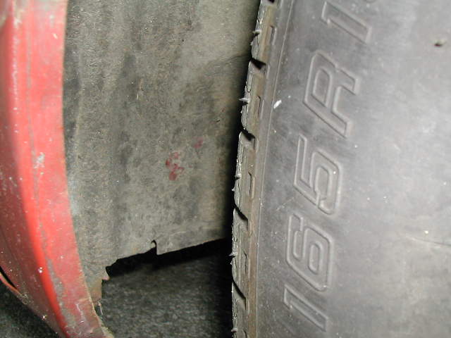

Also while I had it on the jack stands and the wheel off I noticed that from the center of the wheel arch back there was another repair that had to be addressed. The was barely a finger clearence between the wheel well and tire. SO it looks like I'll be searching for another patch panel.
I took it up the road of the subdivision to test it out and it shifted easily with no grinding. Tomorrow I think I'll work on the reverse lights and maybe start adjusting the brakes. _________________ The 68 Ghia
