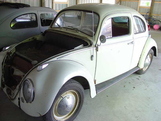

I just picked this up yesterday.
I bought it from Aggro Jo.
It's an all original car and is exactly what I was looking for. I was pleasently surprised when I arrived to pick it up because it was in a lot better condition than he described it. He even gave me a set of OG bumpers for it.
I made the deal with Jo on May 5th and made arrangements to pick it up yesterday (14th). On Saturday May 7th a friend of mine told me about an ad in the local paper " 1962 VW Slide back roof, (classic) with dual port engine, restorable, Make offer". So I called.

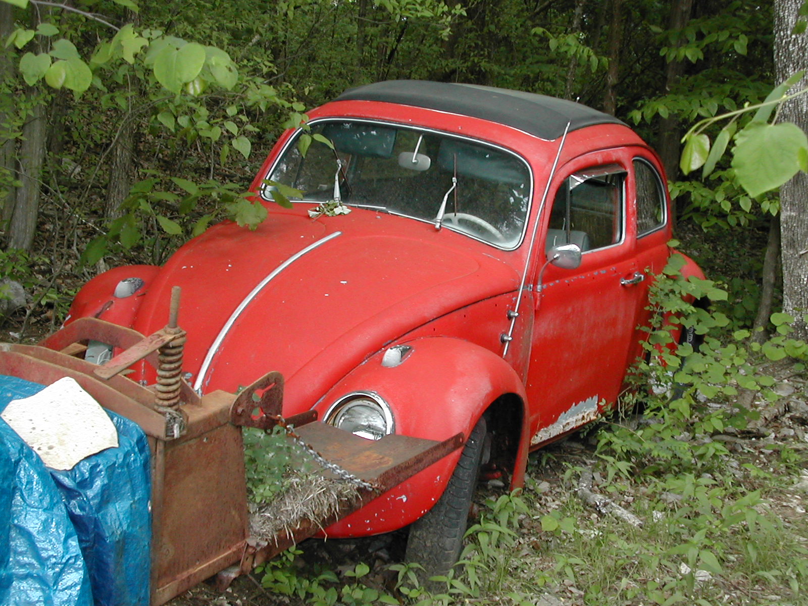

On Monday May 9th I bought this also.
A 62 OG ragtop. It has a complete ragtop, nice dash, the hood that I need and PERFECT OG glass. The down side is that it has been sitting in its present location (in the woods) for several years and the lower half of the body is almost gone. As I tried to explain to my wife, the price was so low I just couldn't pass it up. She was not amused.
I will be picking up the ragtop next Saturday.

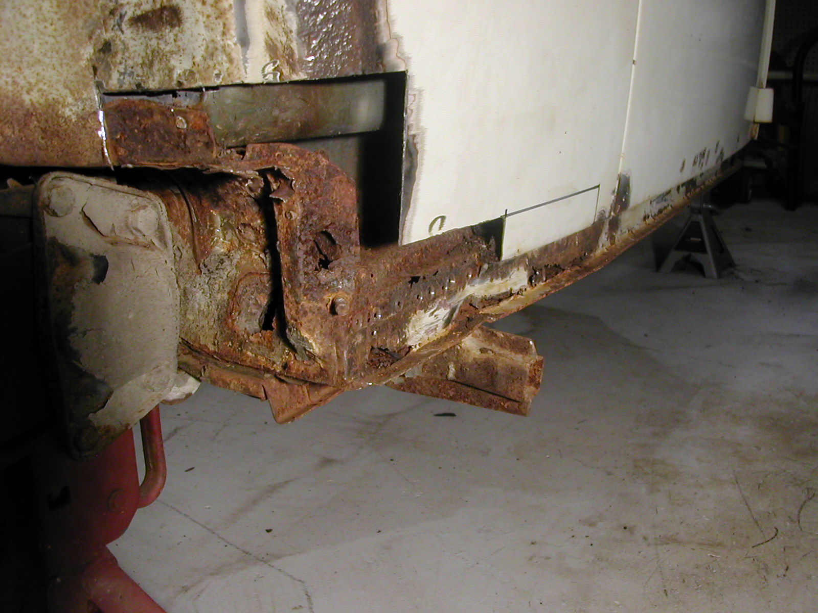

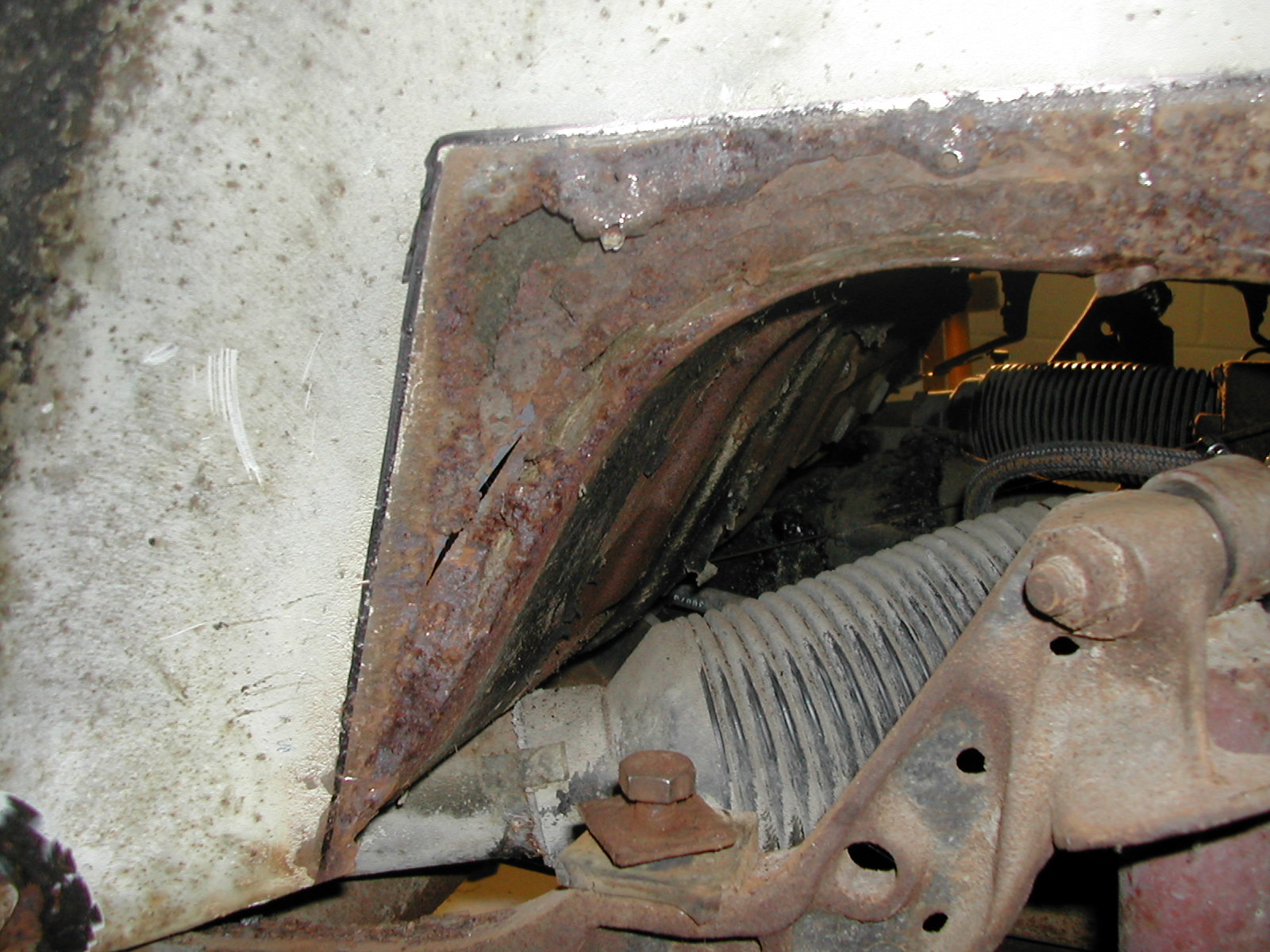

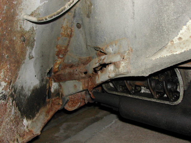

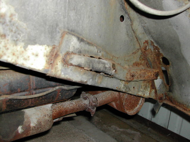

Here is a few pics of the damaged areas that have to be addressed immediately:
The front end took a pretty hard hit. It is pushed in approximately 6". I will be putting a new clip on as soon as I can find one. Who knew that finding a '62 clip would be so damn hard. I've been looking for 6 months!
The drivers side rear heater channel will need some work.
And the rear needs a little attention also. I'm hoping I'll be able to pull this out.
The car is surprisingly solid, but will need some small areas cut out over the winter and patched up. I will post updates as I go along. _________________ The 68 Ghia

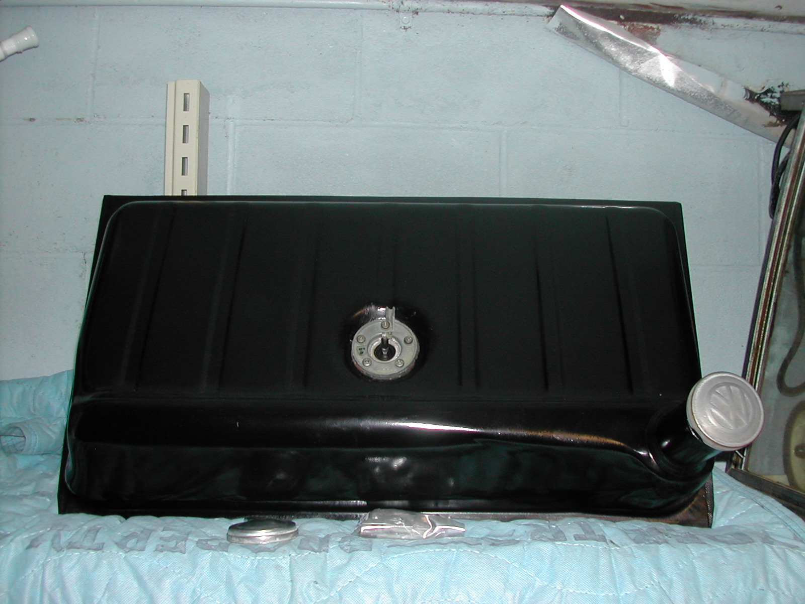

After 13 years (give or take a little), it runs now! There was the usual problems, nasty fuel tank, clogged fuel line, ordering the wrong parts .
The fuel tank has been completely redone using the POR15 kit, fuel line unclogged and all new lines run, fresh oil, complete tune up and new coil.
The first time it started it blew black soot out of the exhaust and covered my riding mower and filled the garage with smoke.

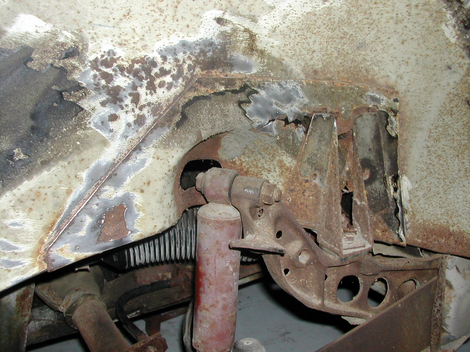

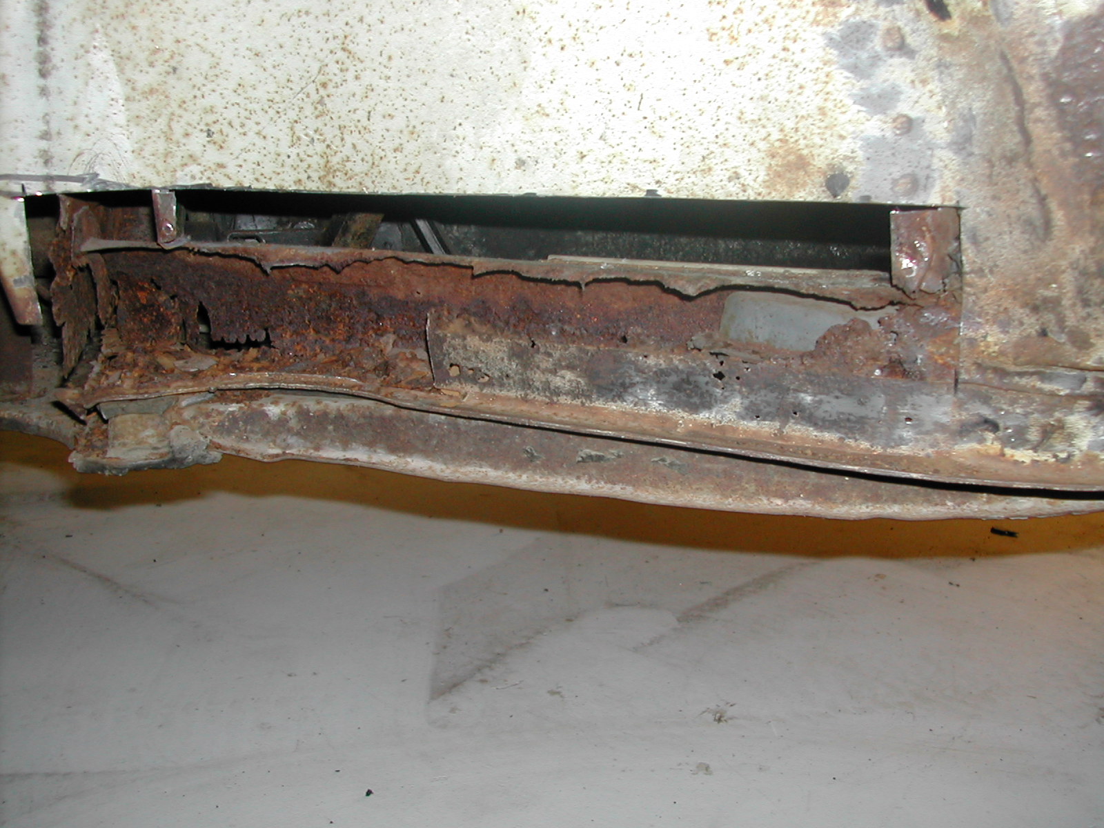

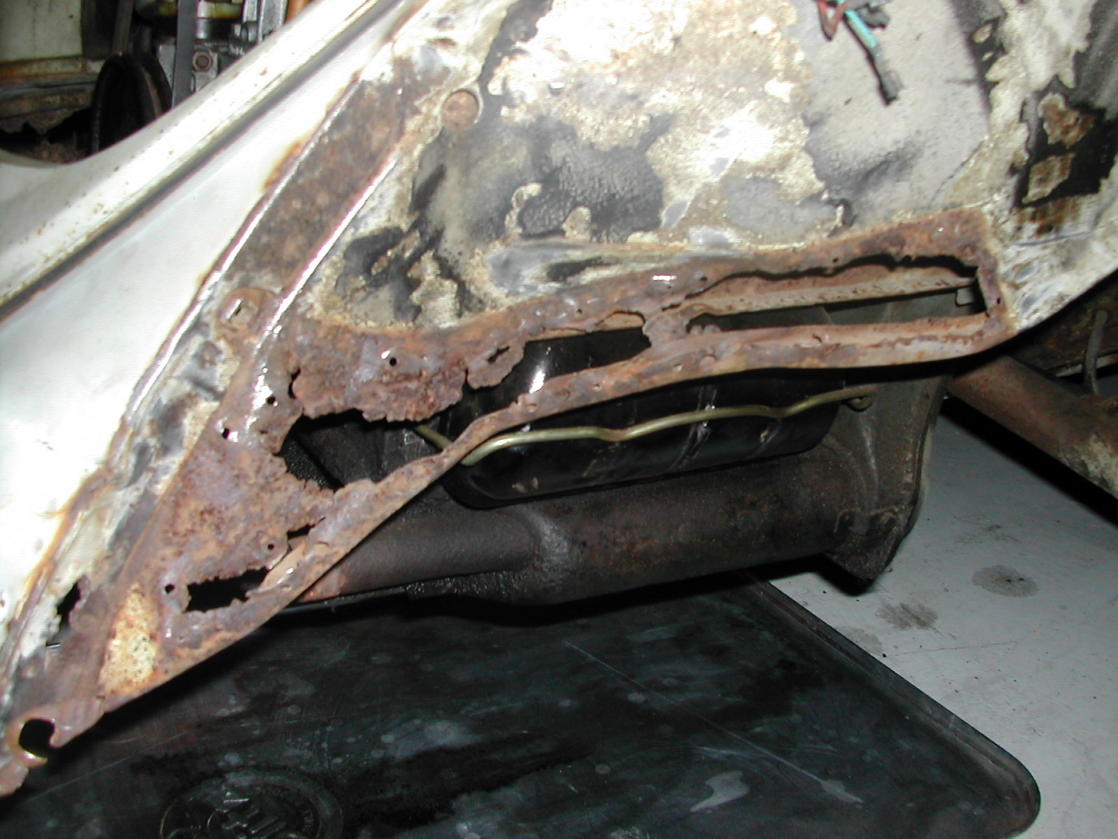

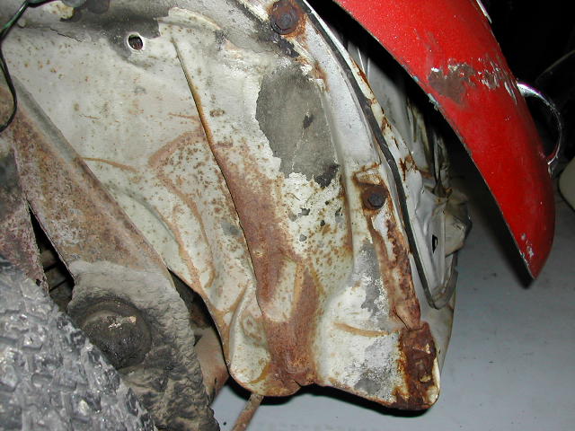

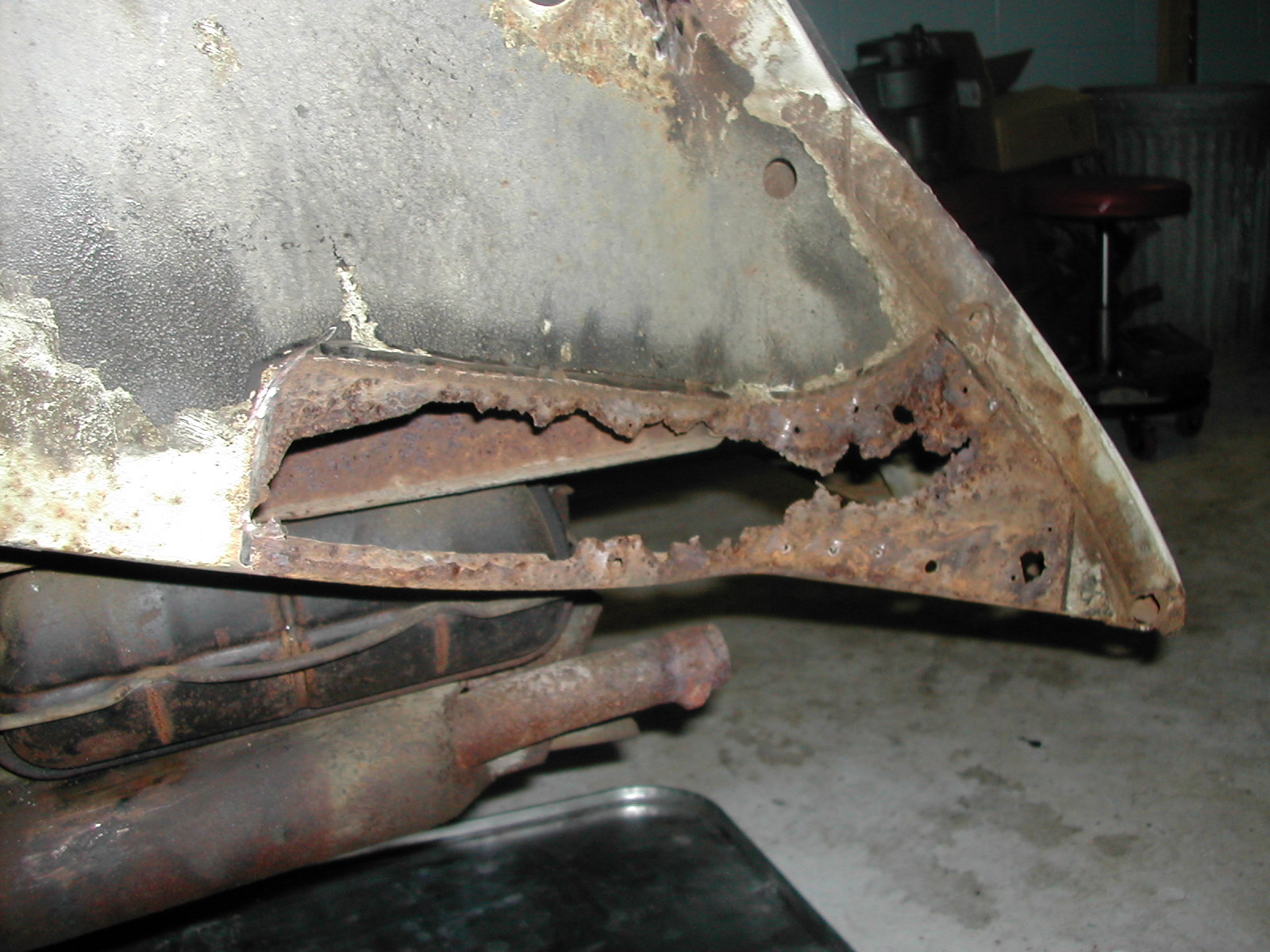

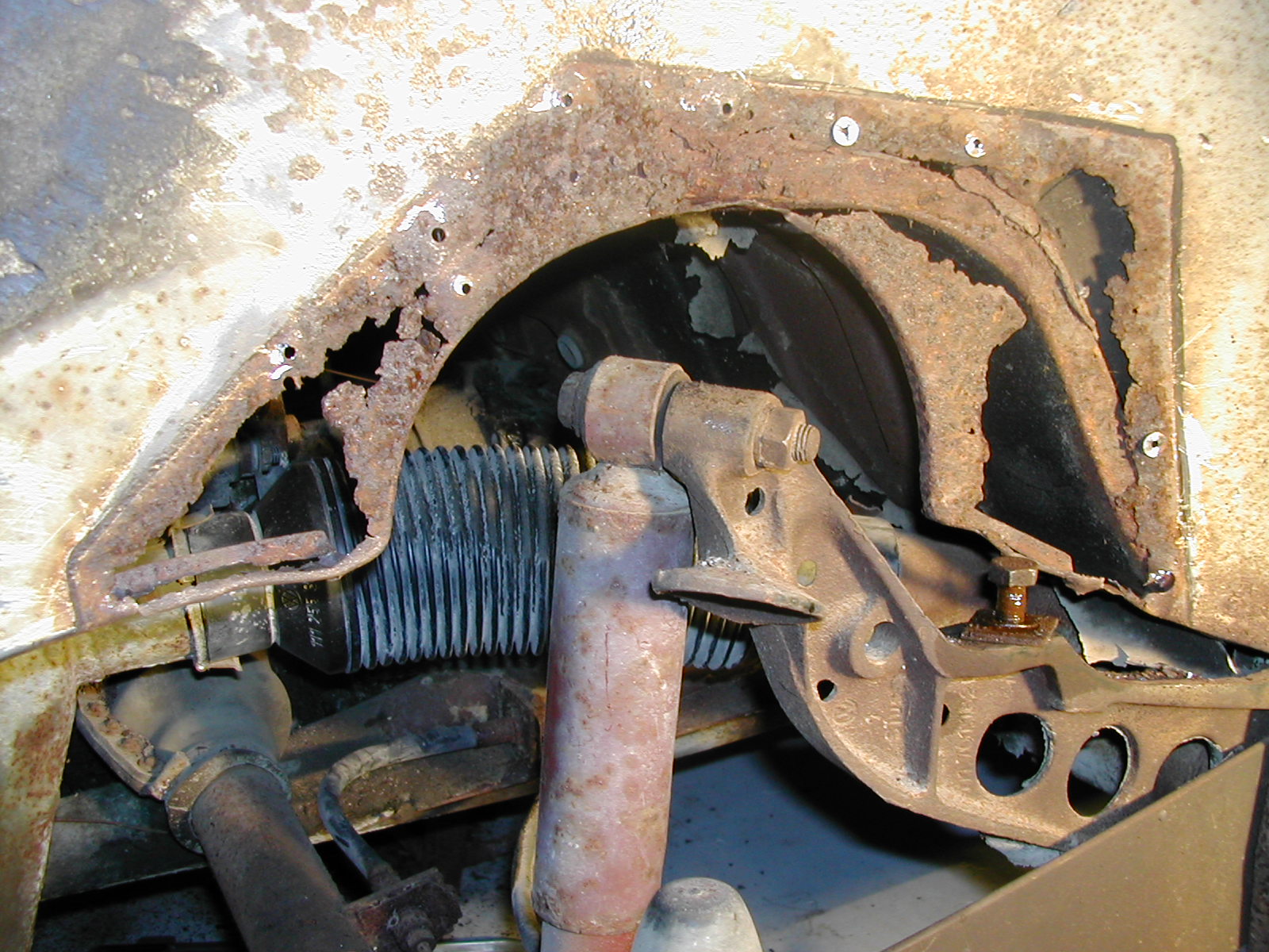

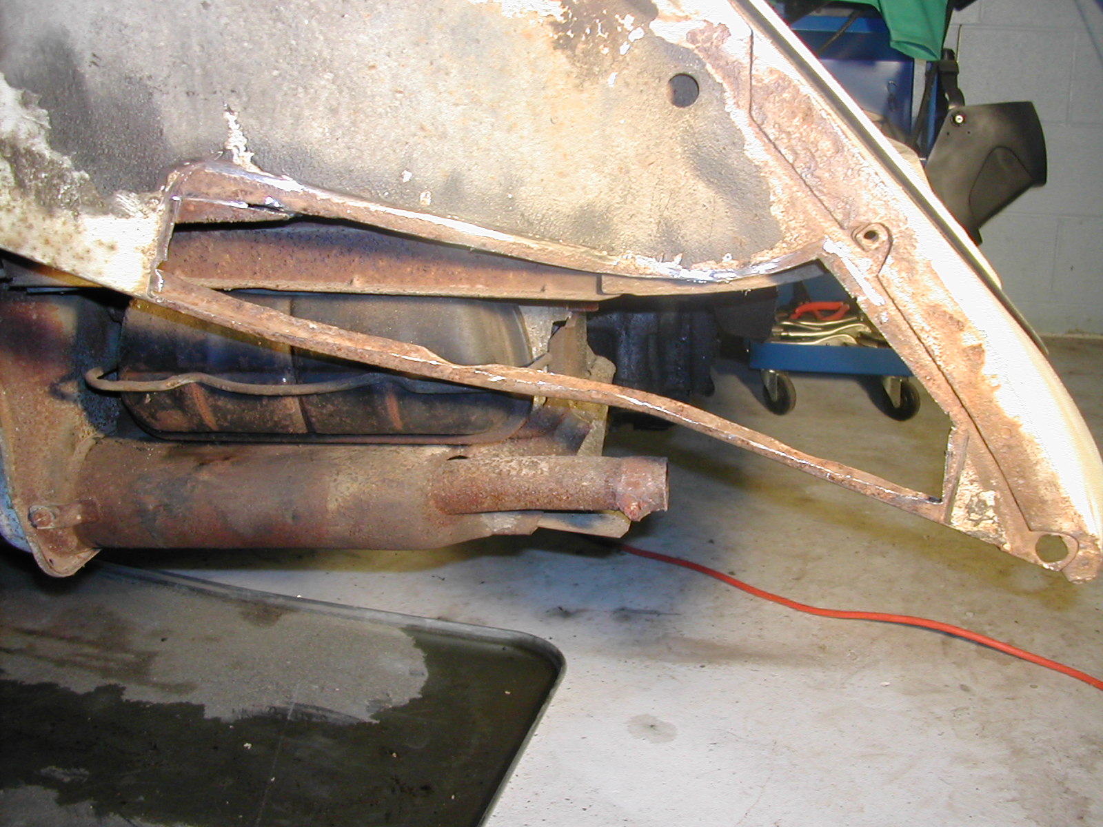

So now that I know the engine is good it was time to start on the body. Here are a few areas that need attention.

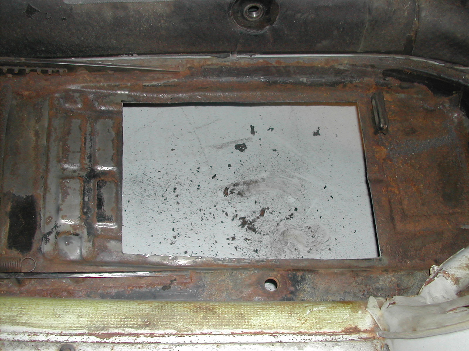

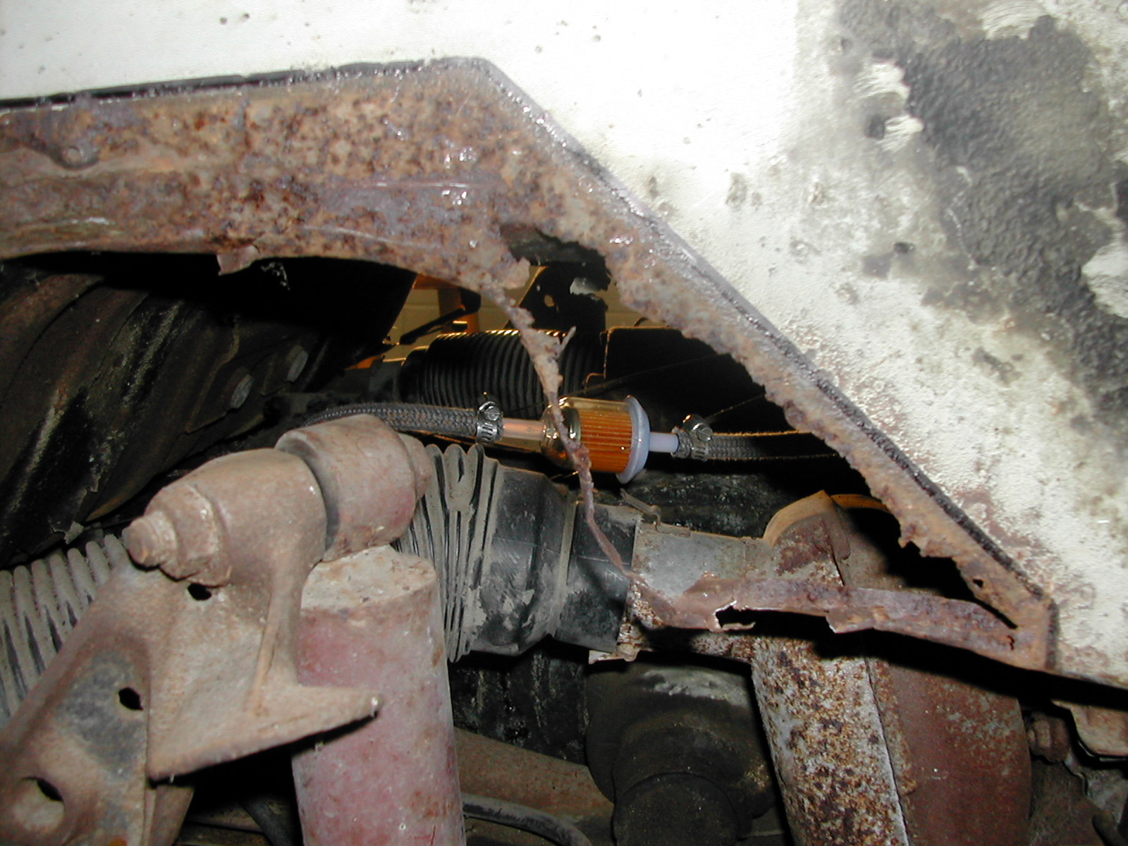

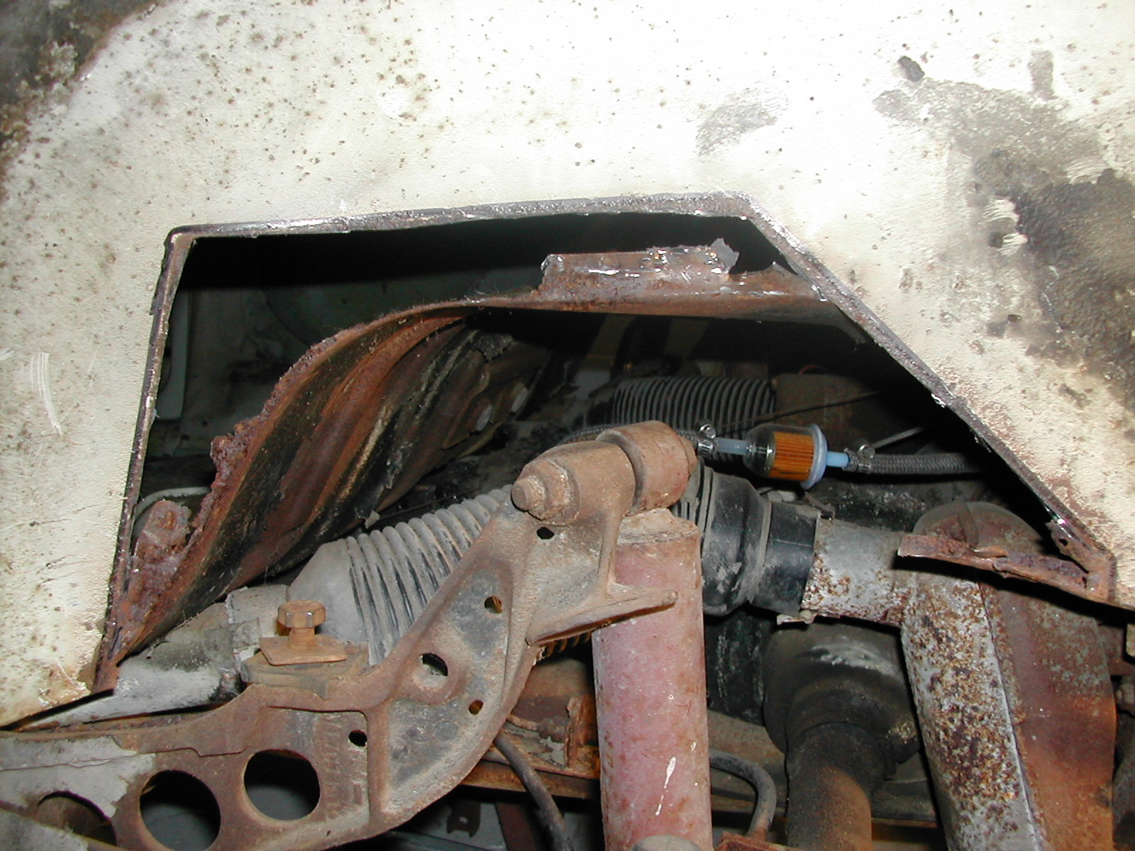

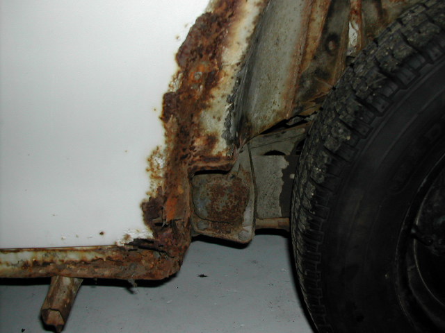

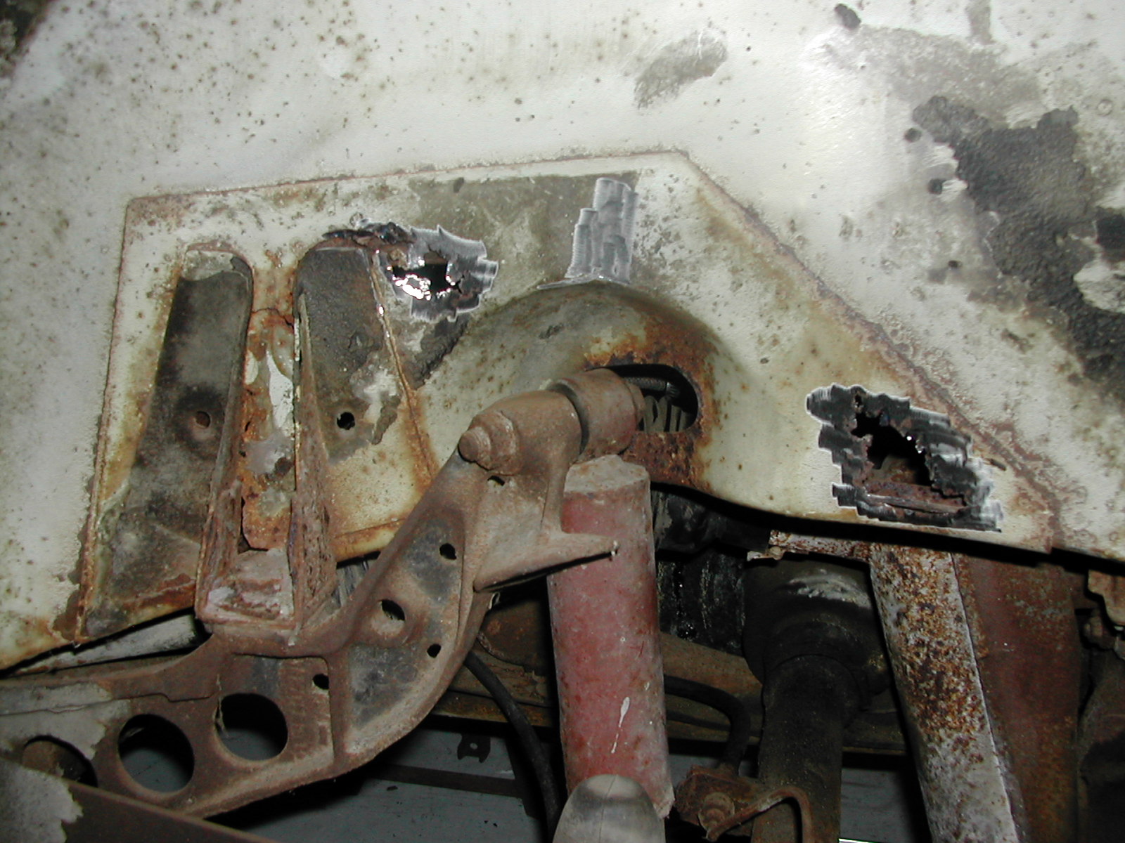

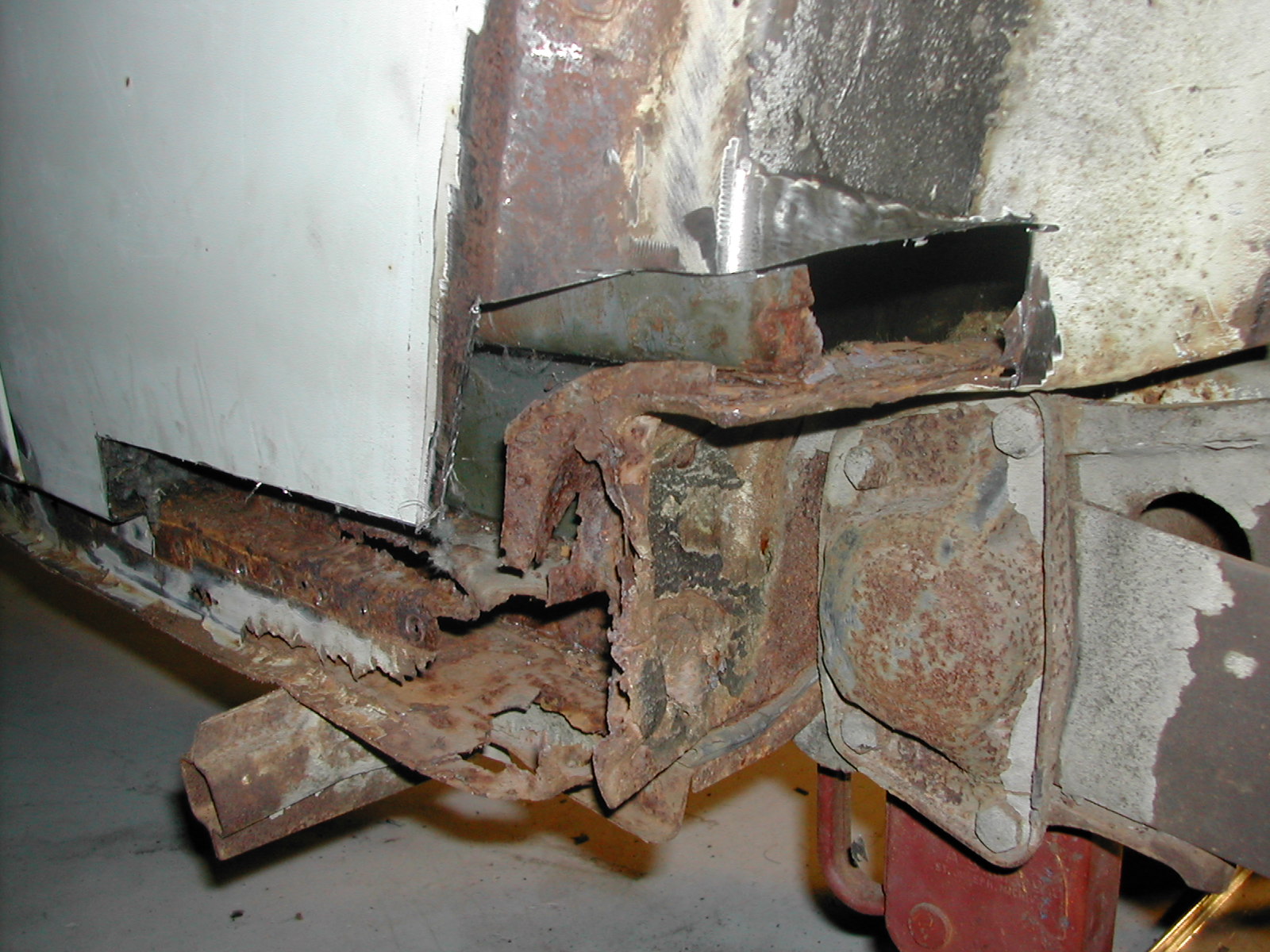

Well once I got started on it there was a little more hidden rust. Here is what I found.
I spent all day today with a twisted wire brush on my grinder going over every little rust spot on the car. I found a few more spots that will need some work but overall it was less than I expected. The worst spots are here:
From this
To this
From this
To this
I have enough metal on both sides to make a templete so I should be okay. This will give me a chance to practice ALOT with my new welder.

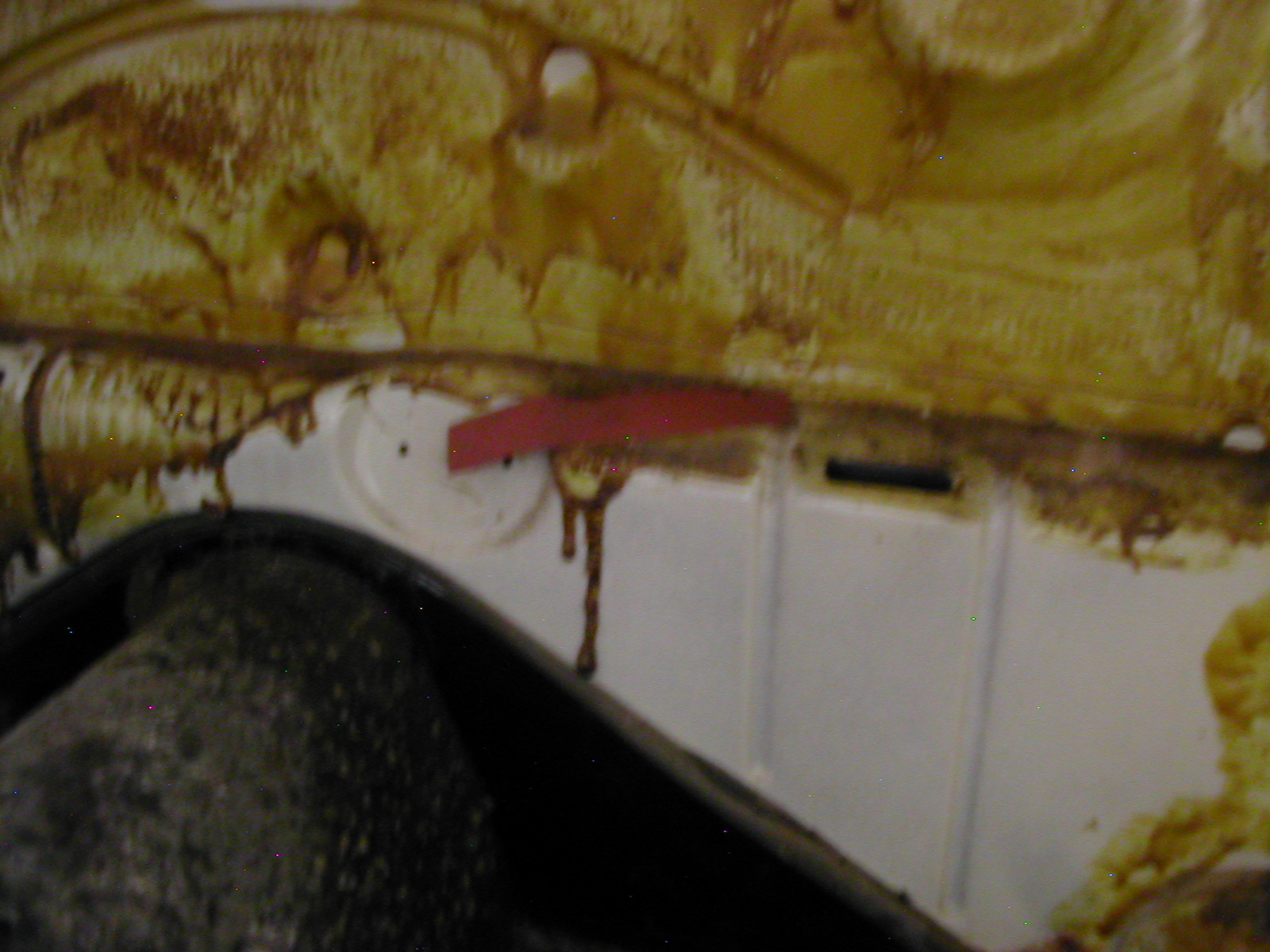

Well I finished the majority of the cutting out yesterday. It only took a couple of days. The good news is most of it is pretty straight forward and should be pretty easily fixed. The bad news is it's going to need heater channels. I was hoping it wouldn't, but oh well. I was hoping to be on the road by spring but that looks to be unrealistic now. Here are the pics:

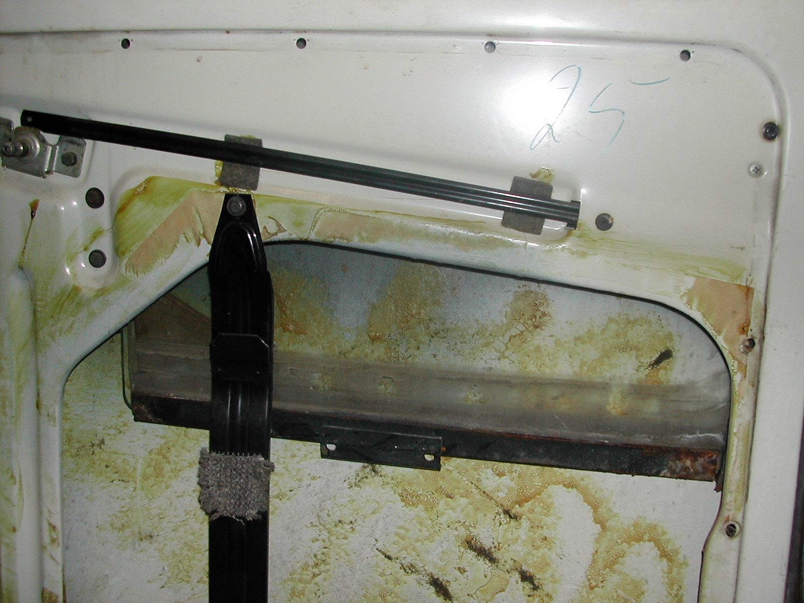

It all wasn't bad news. I found two very cool things while I was tearing it down before cutting. A piece of the original interior color placed by the factory for the line workers to know what color was going into it.
And a carpet swatch attached attached to the door.

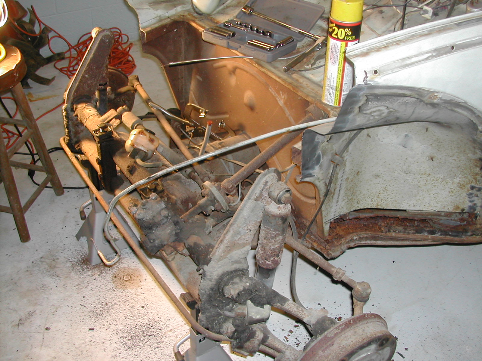

Just a little update.

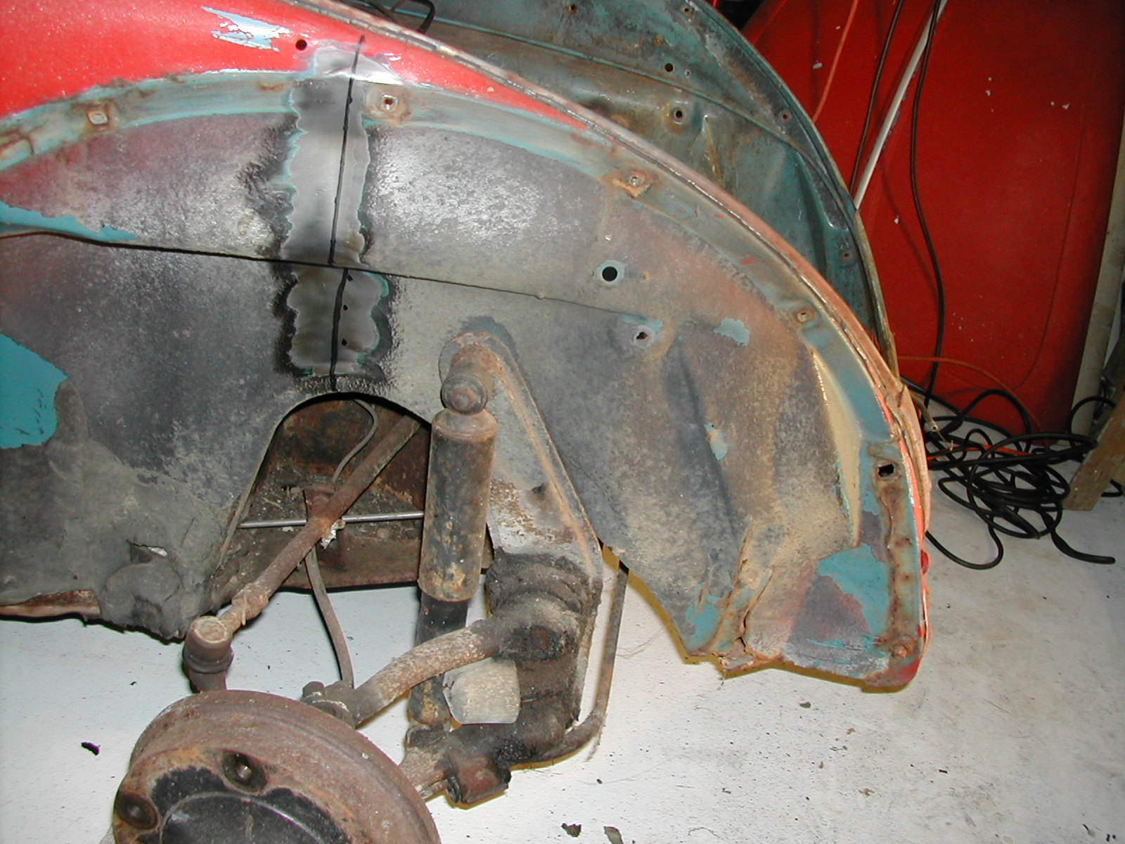

Today was the day of the point of no return.

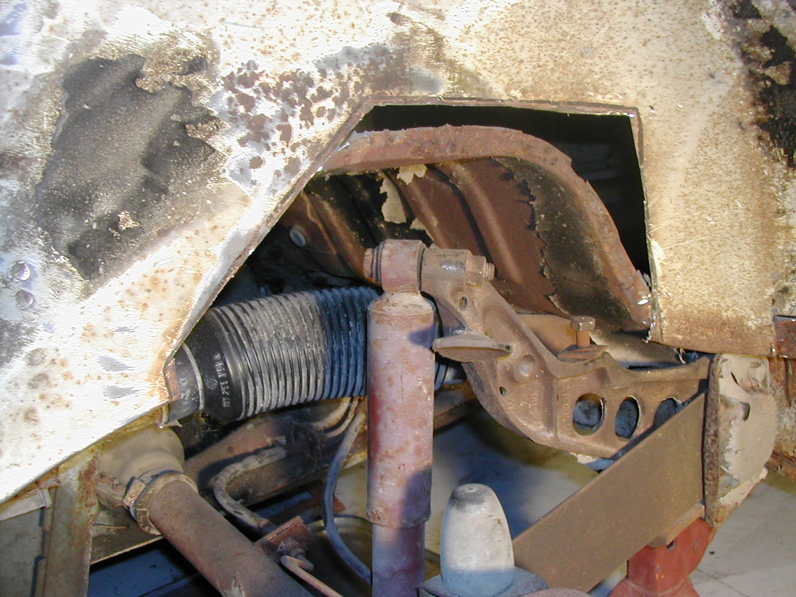

It took a couple of hours to make that line. I measured no telling how many times and finally decided I was happy with it. So here goes.

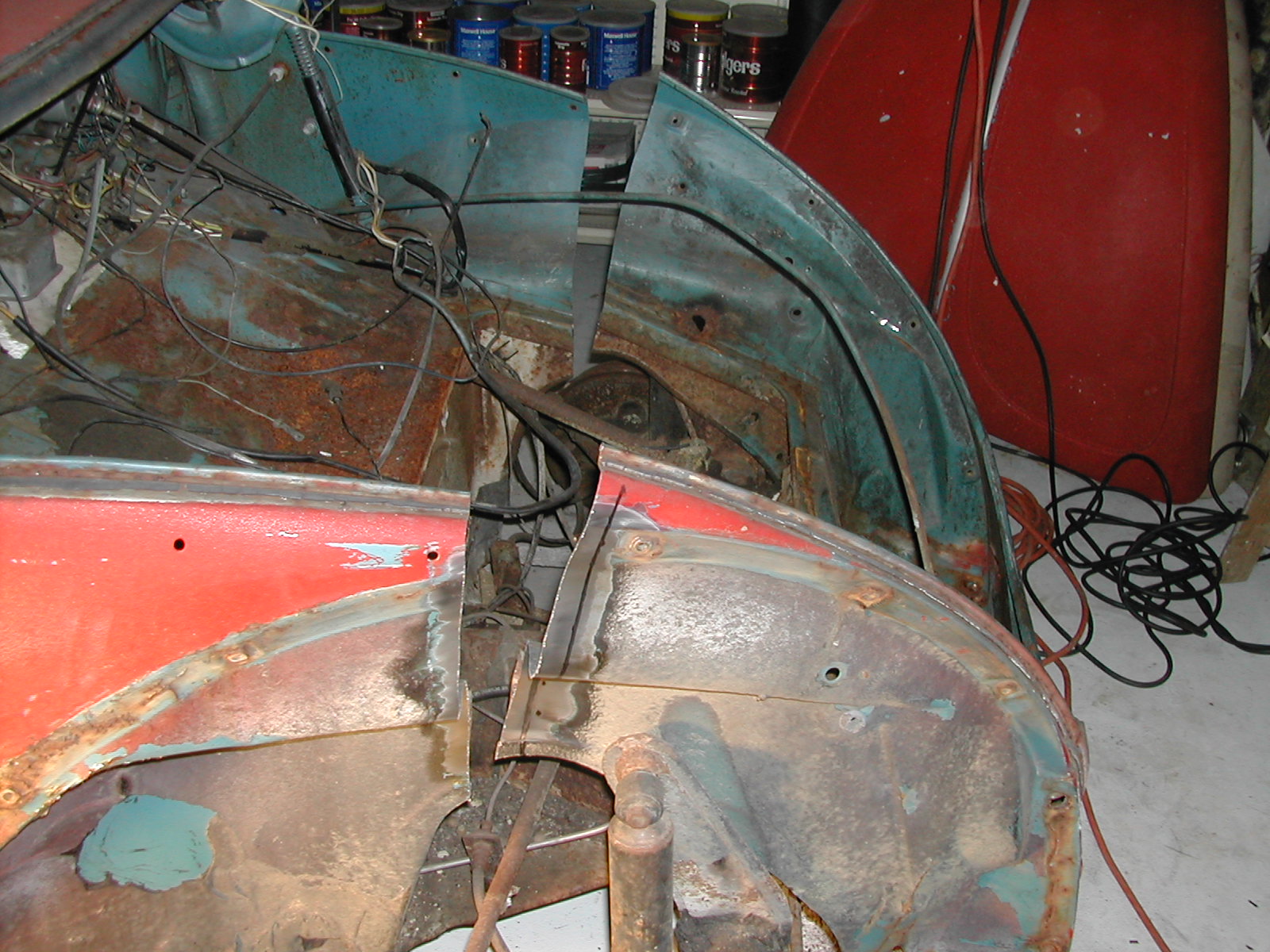

Well no turning back now. I had decided to use the front clip off the '62 ragtop that I have. I haven't been able to locate a good clip for it (I bought a clip, but it turned out to be a 64-66 clip) and I was wanting to keep the project moving, so while I had all the tools out
I left myself about an inch fudge factor since I haven't done this in almost 25 years. The clip will need some rust repair but I already have the panels to fix it.
So now I'll be working on the clip and fixing a few dents in the hood getting ready to make the final cuts. I also just ordered all the replacement panels for the rest of the car and they should be here in about 10 days.
I found a design on another car site for a lift that will allow one person to remove the body from the pan and get it high enough to put on sawhorses or a body dolly. I should have a price on the steel the first part of next week. If it is cost effective I'll be making that also. _________________ The 68 Ghia
