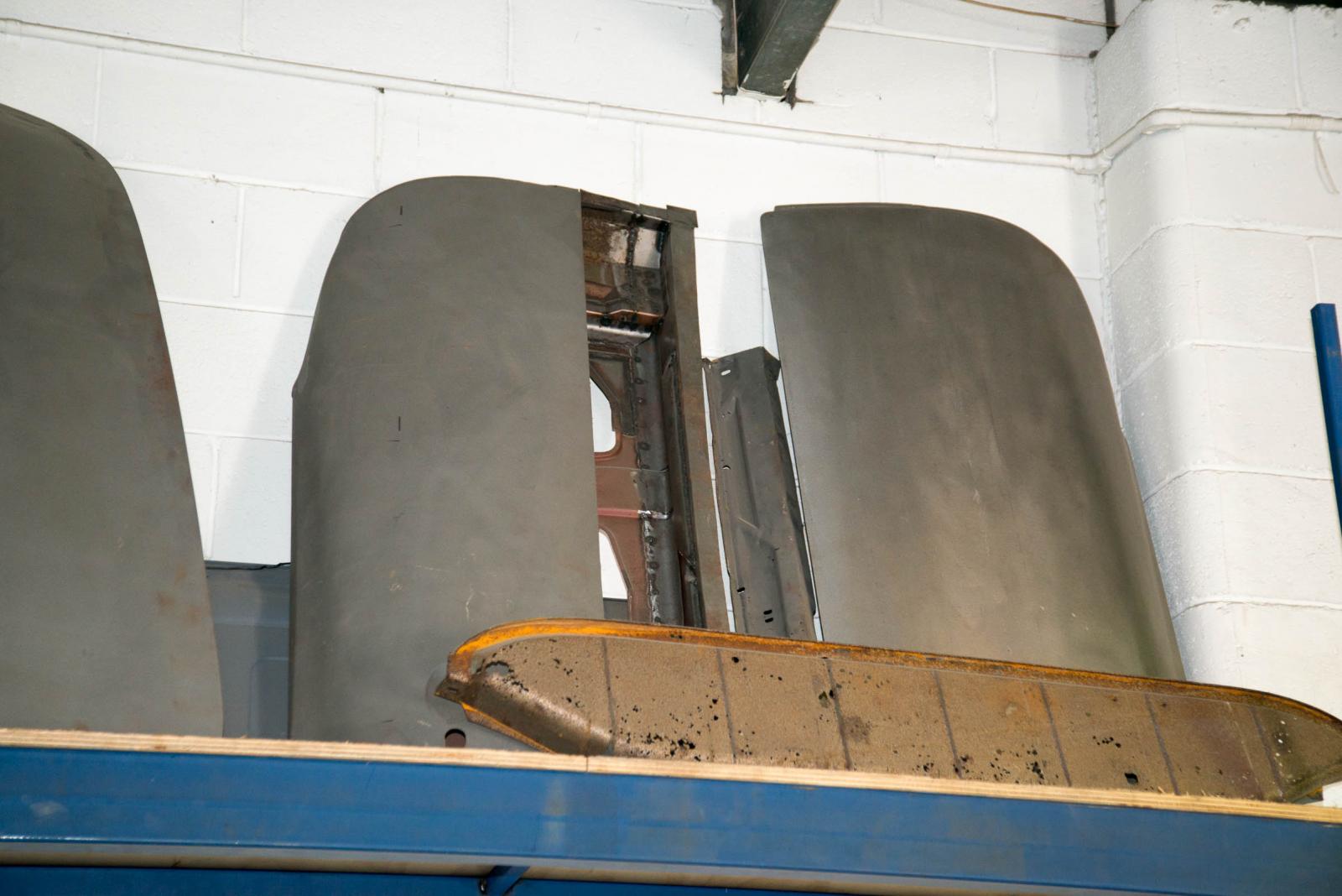

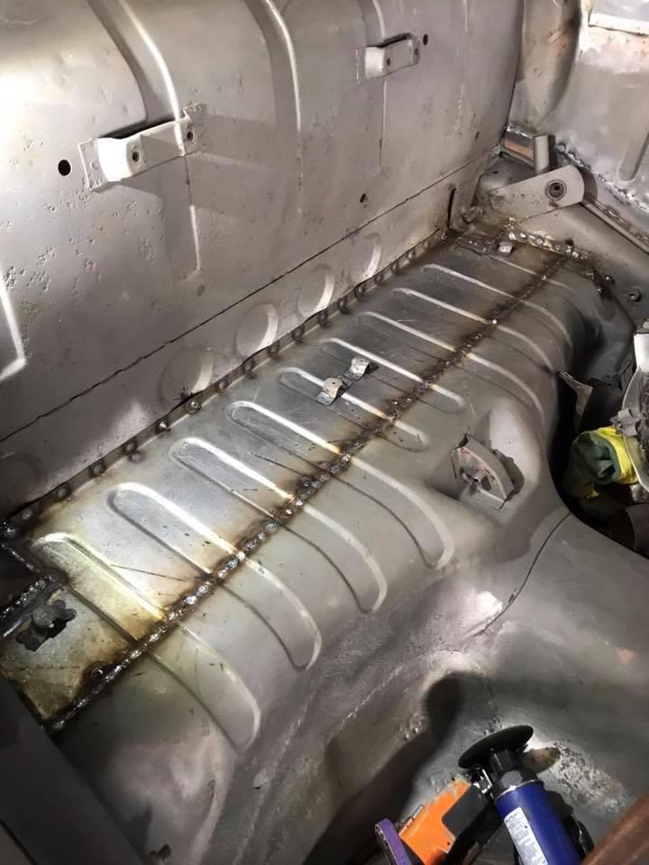

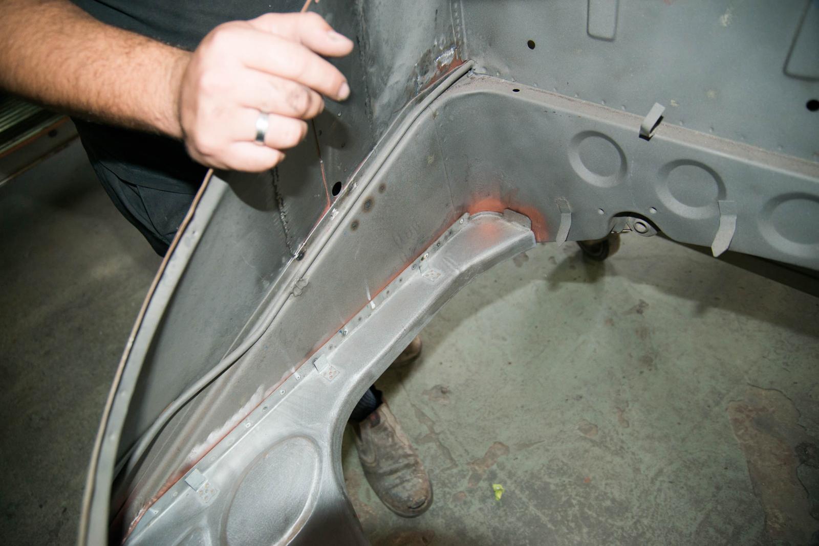

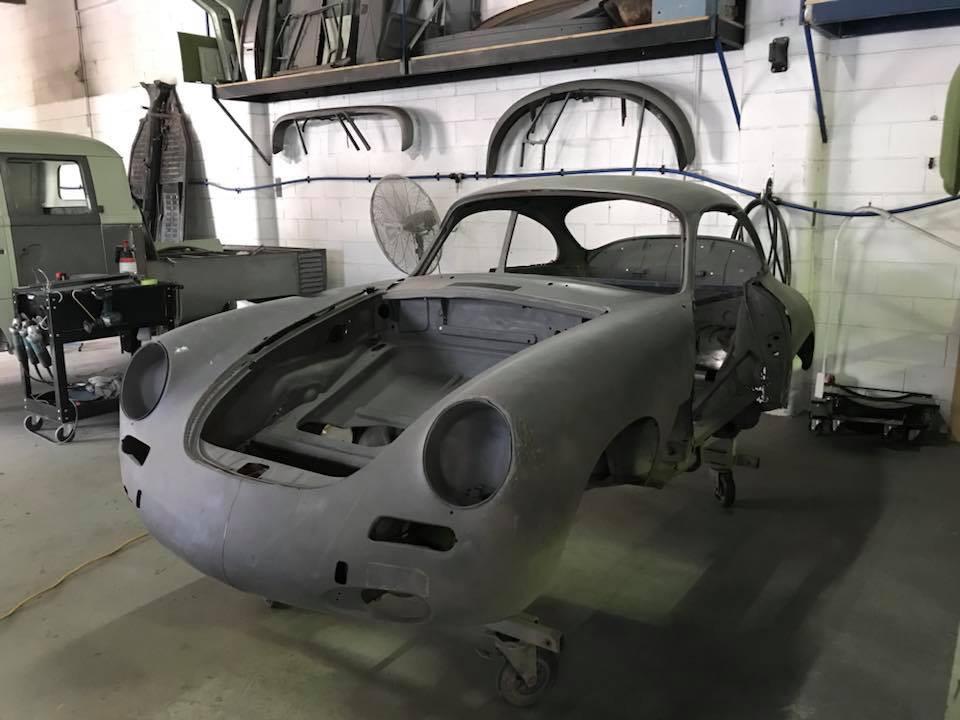

Back seat run repair with a new locally made panel

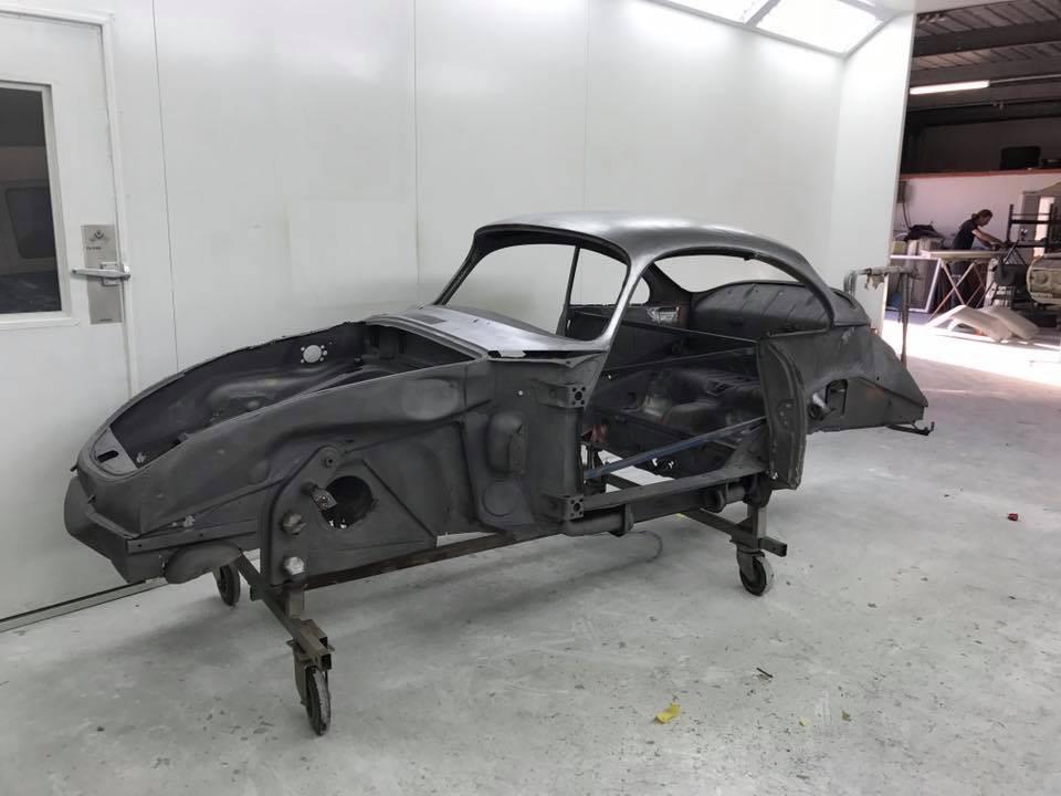

view of the front portion of the car's skin
The skins removed show very little crash damage and mostly rust repairs

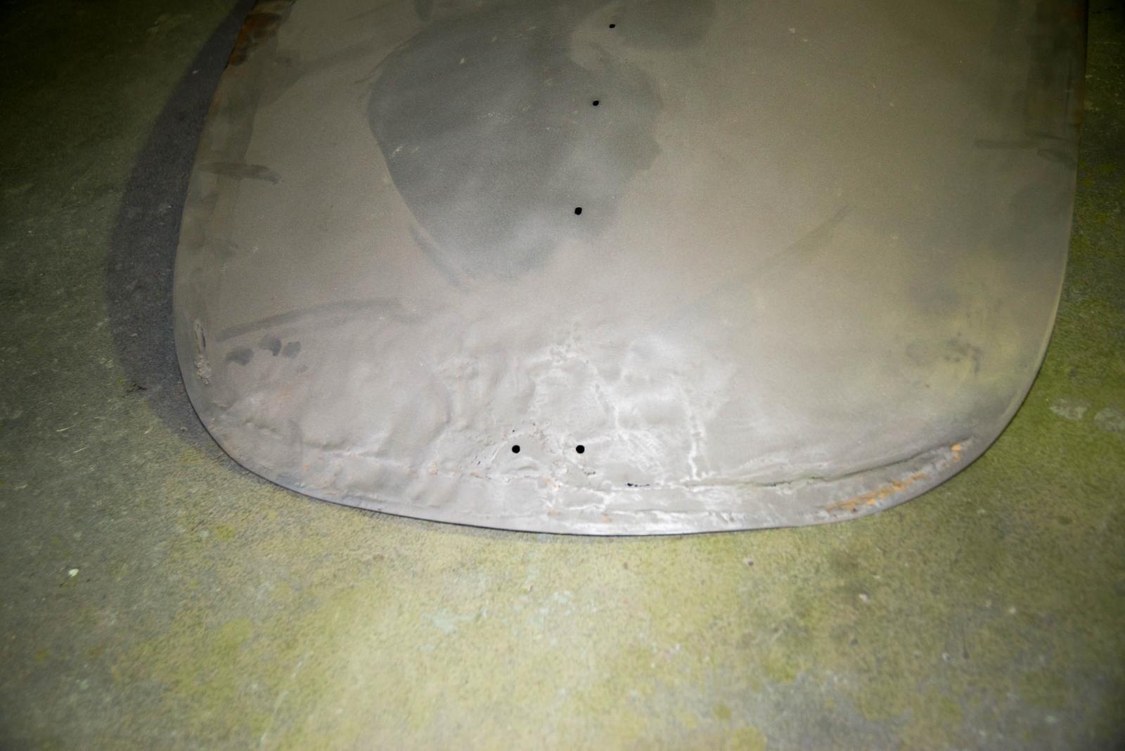

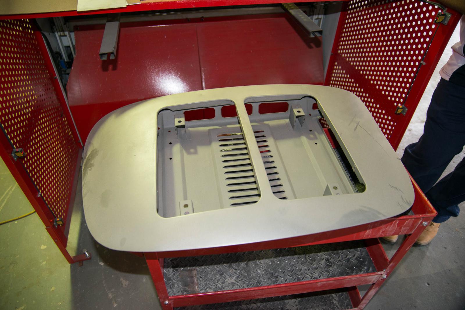

The engine lid is nearly perfect save a tiny dent in a flat portion that'll be easy to knock out.

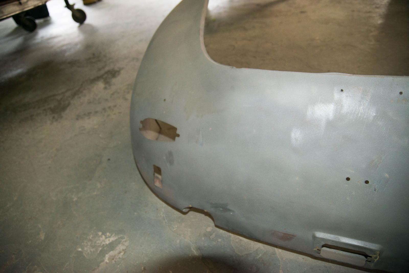

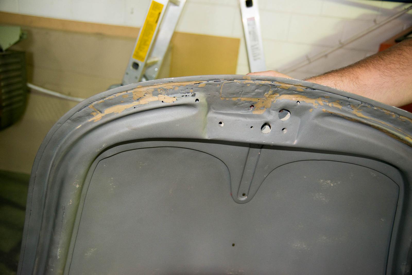

front trunk lid needs the front edge replaced. I've seen original Porsche parts available but those come at quite a high price.
Doors are mostly OK and just need lower skins added.
rear skin is mostly OK and just needs some shaping

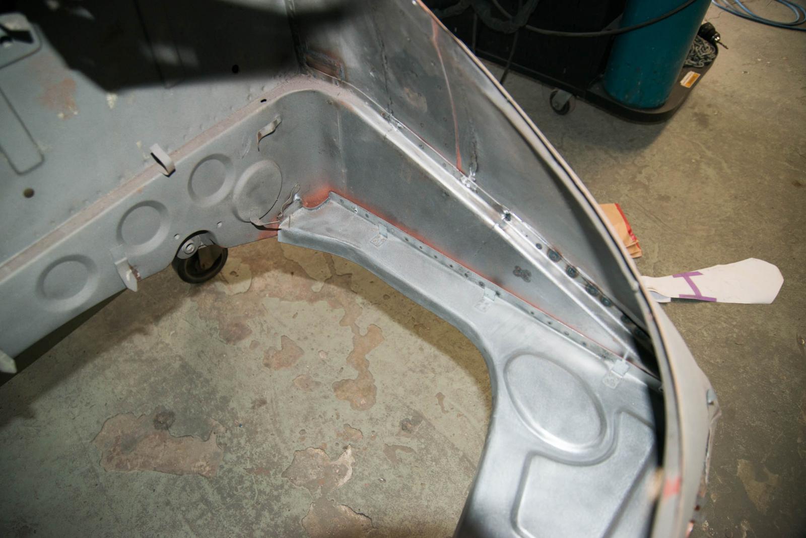

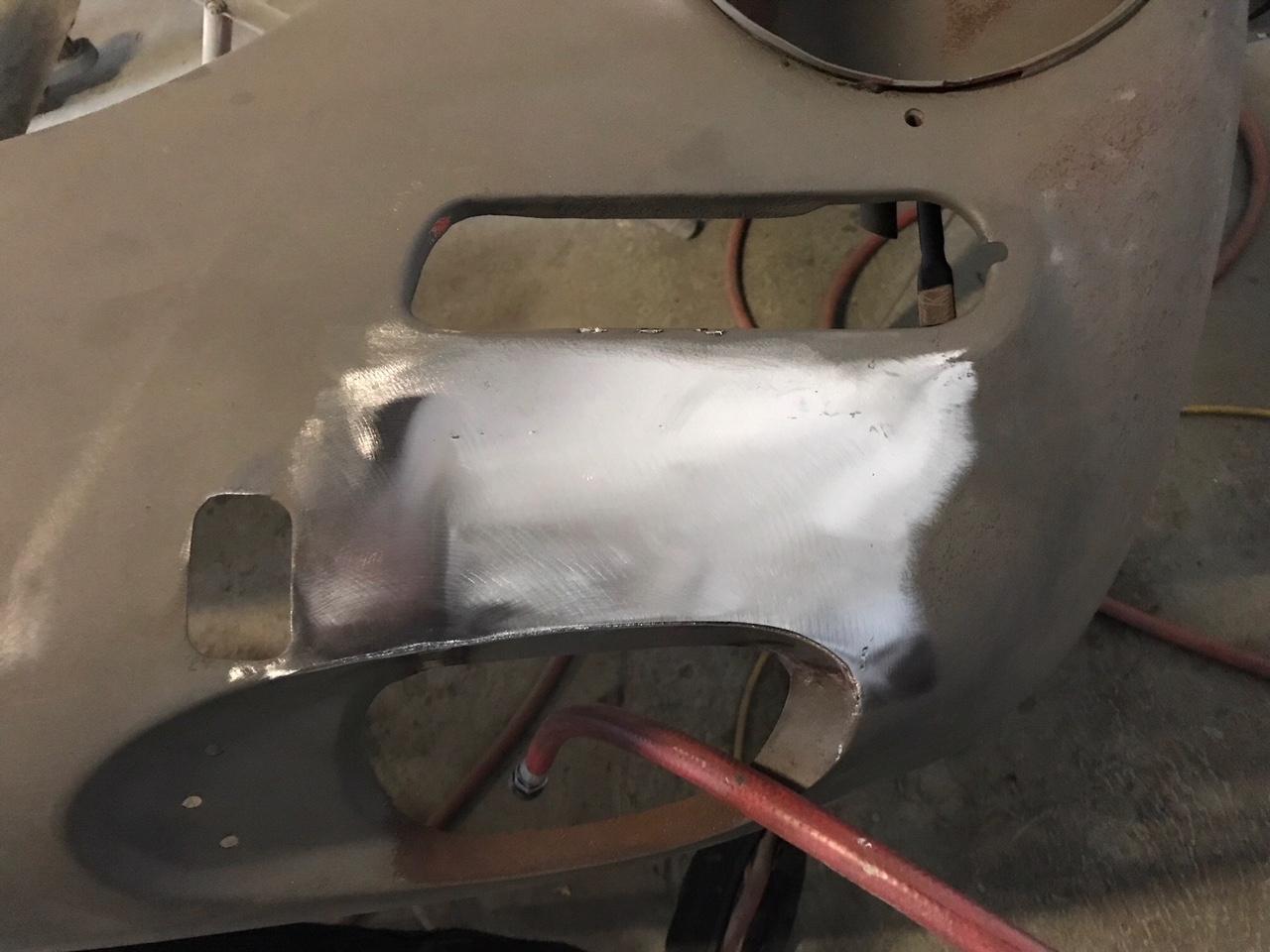

Head light needs new metal.

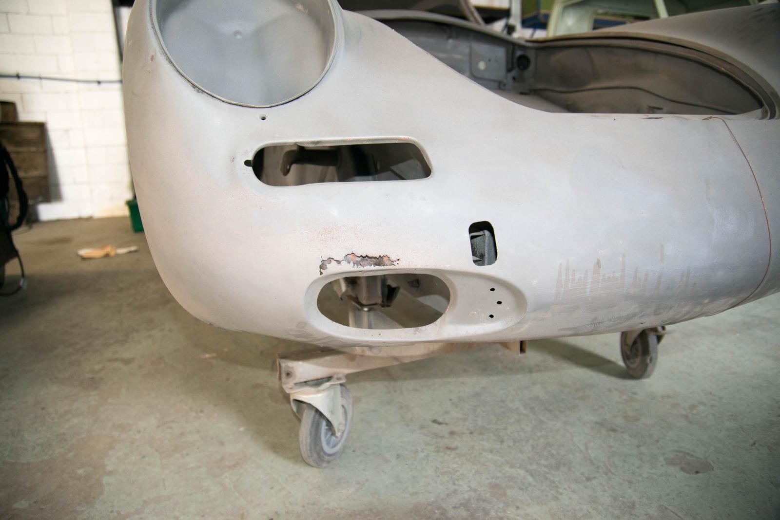

Usual rust around the front lights and vents
Tinwork in the engine bay is completed with new metal

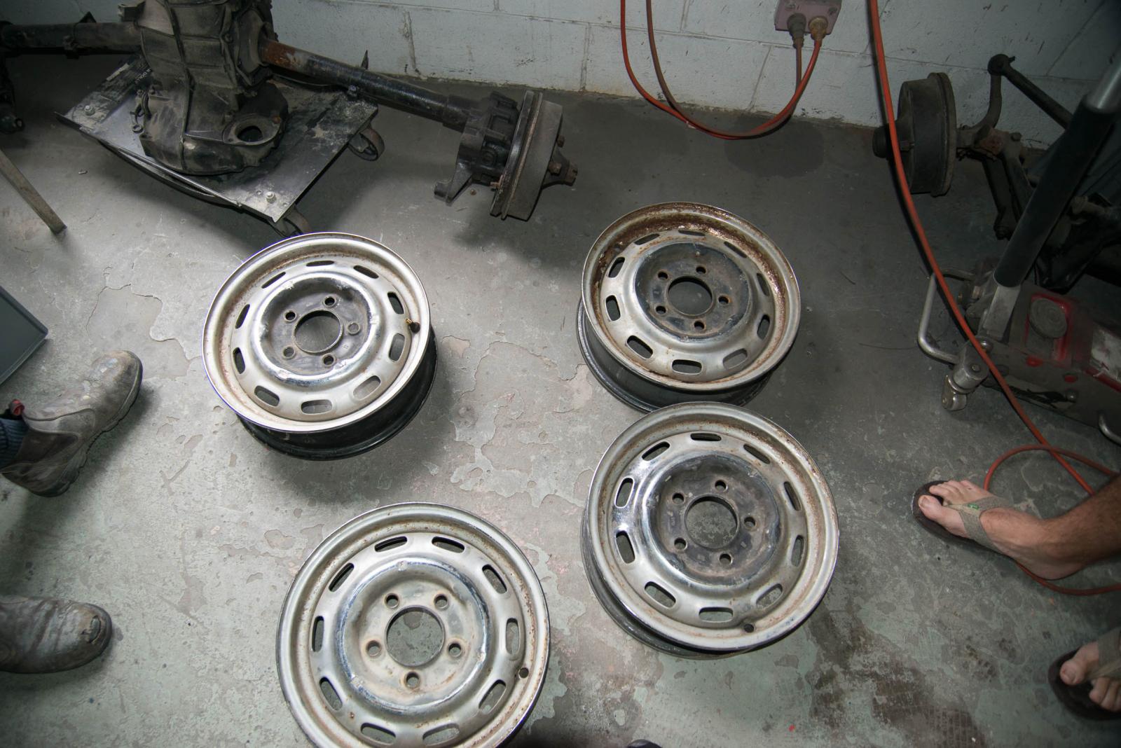

The wheels should be from Dec 64 or a little earlier, but three are Lemmerz from Dec 65 and one from Oct'68 is Kronprinz. All are 4 1/2 J15. I'll have to swap them out with something more correct.

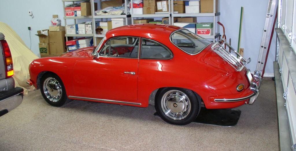

So it would look a bit like this photo from the Gallery, but with a black interior.
So I have a defined target Laughing

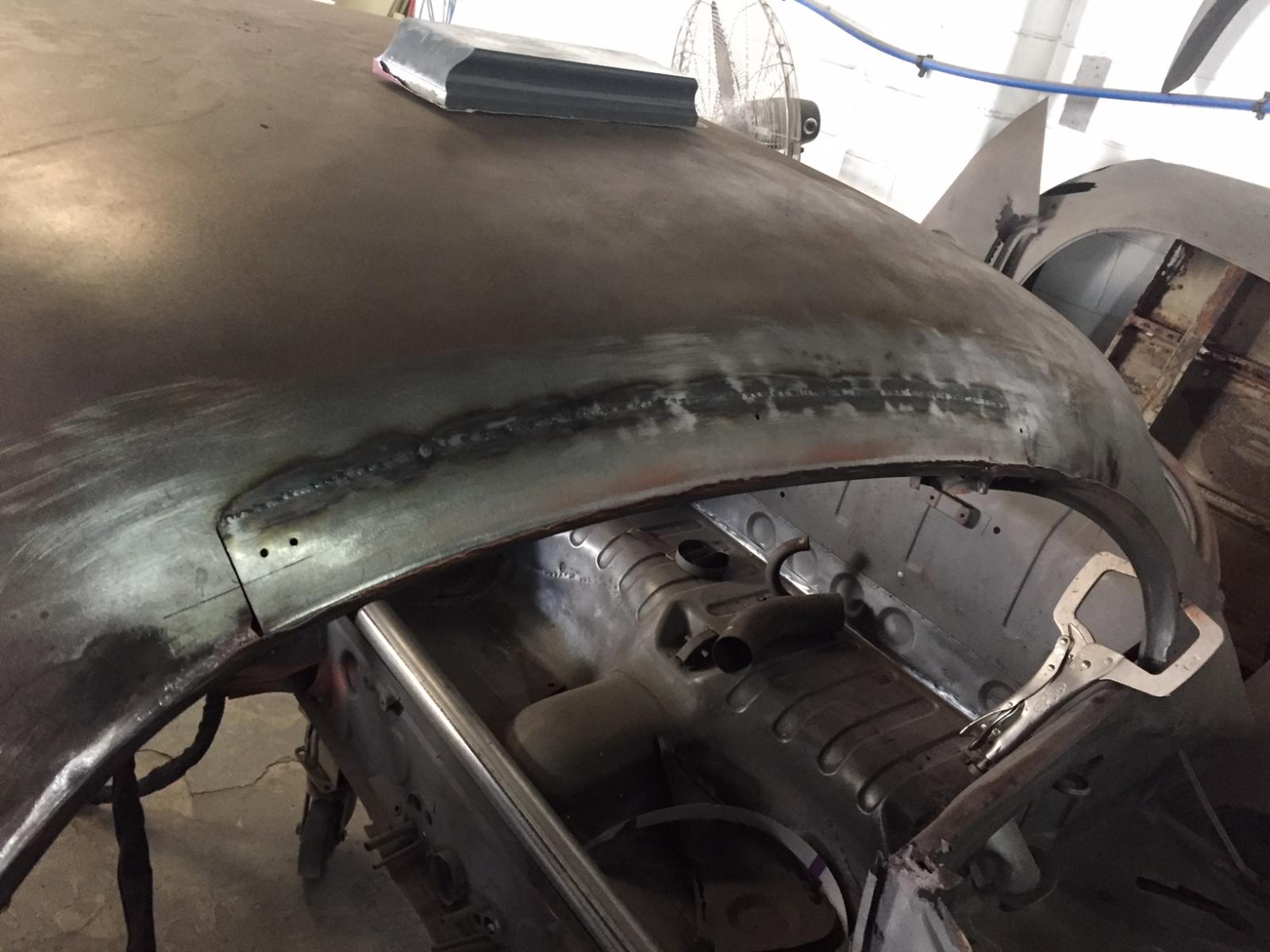

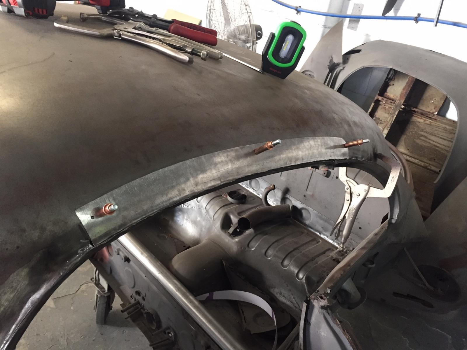

Progress updates

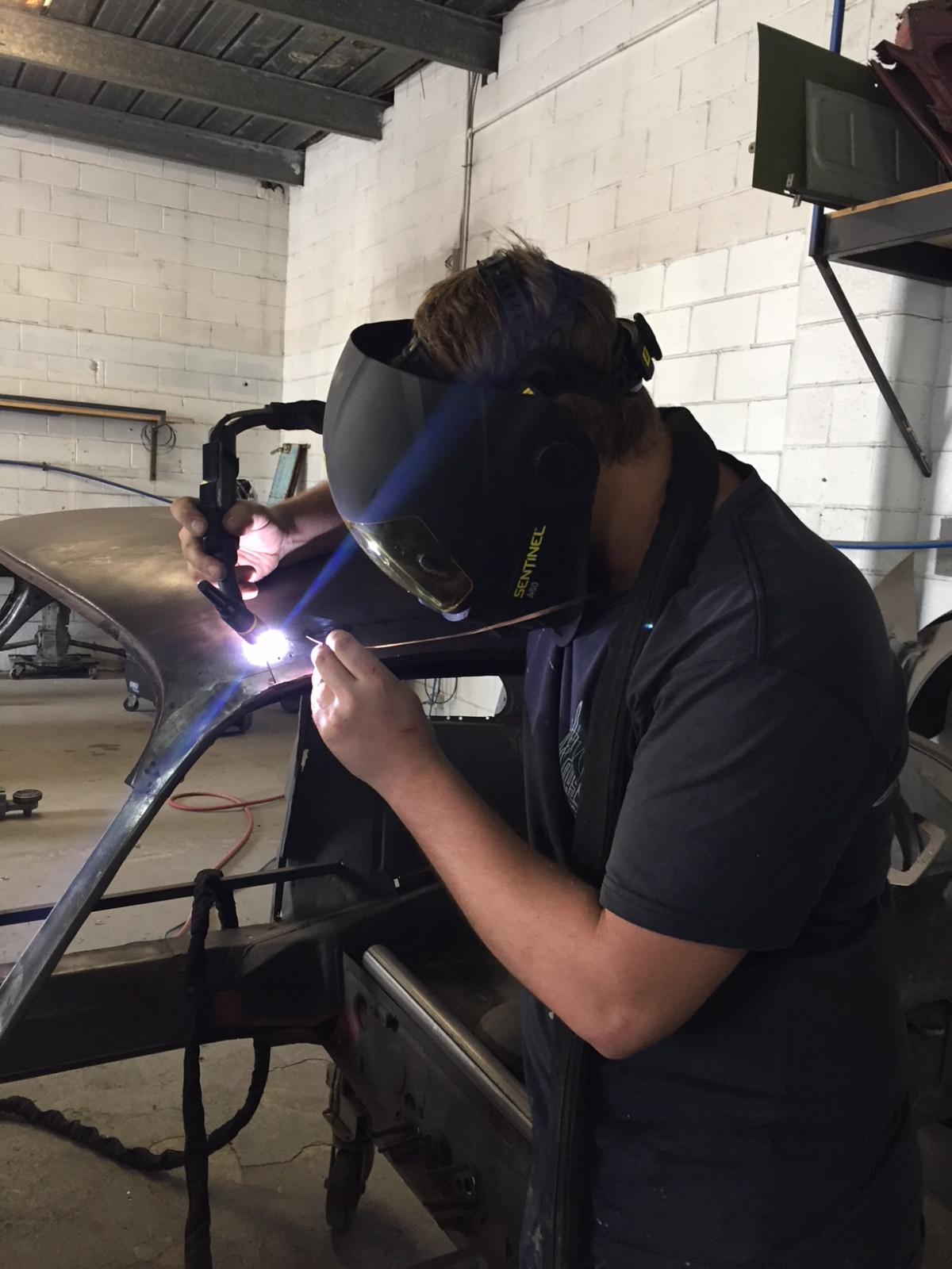

Here is the roof being patched to repair the rust holes in the gutters.
Nicholas

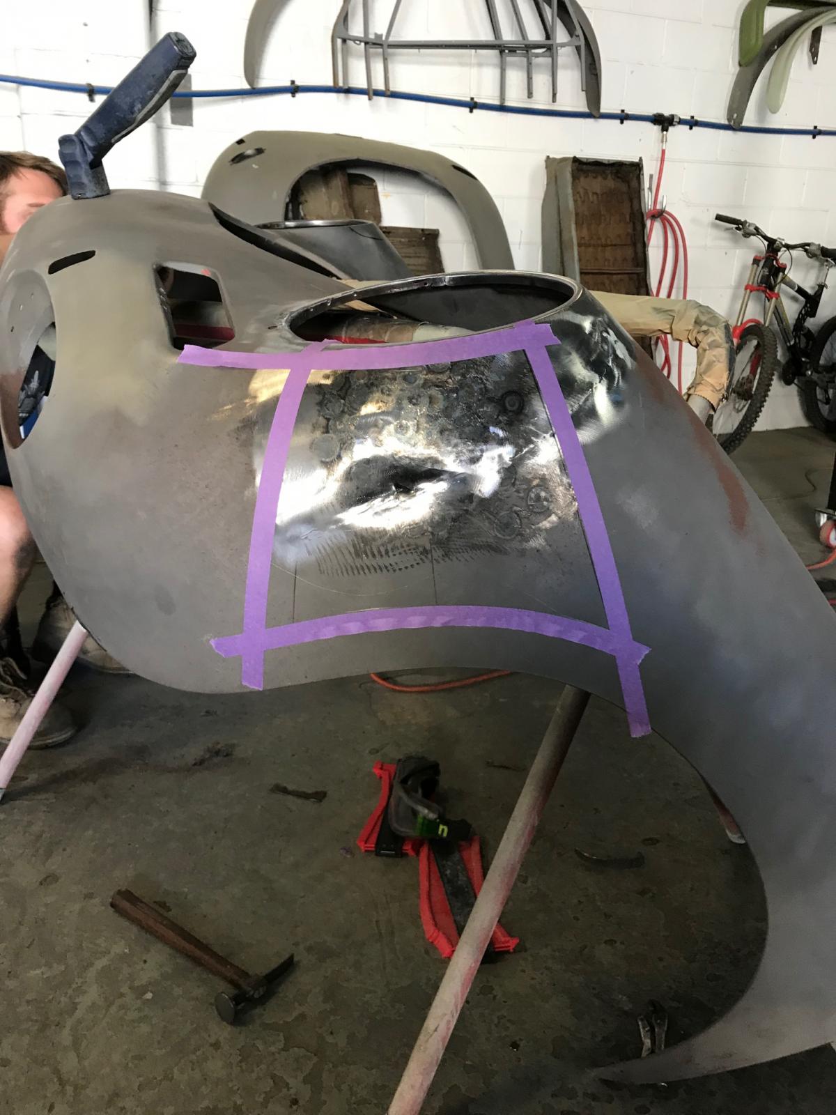

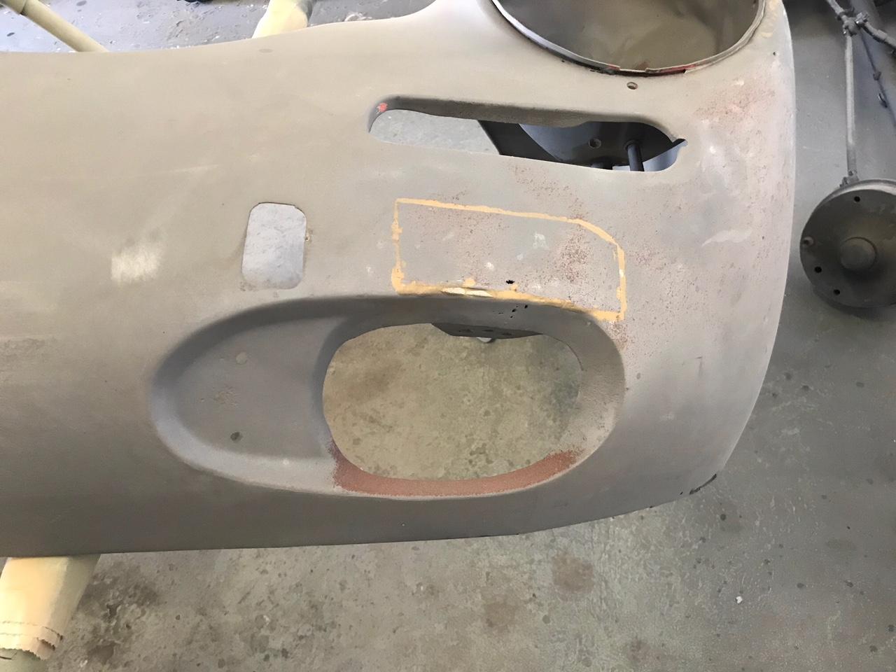

Attention has been up at the front.

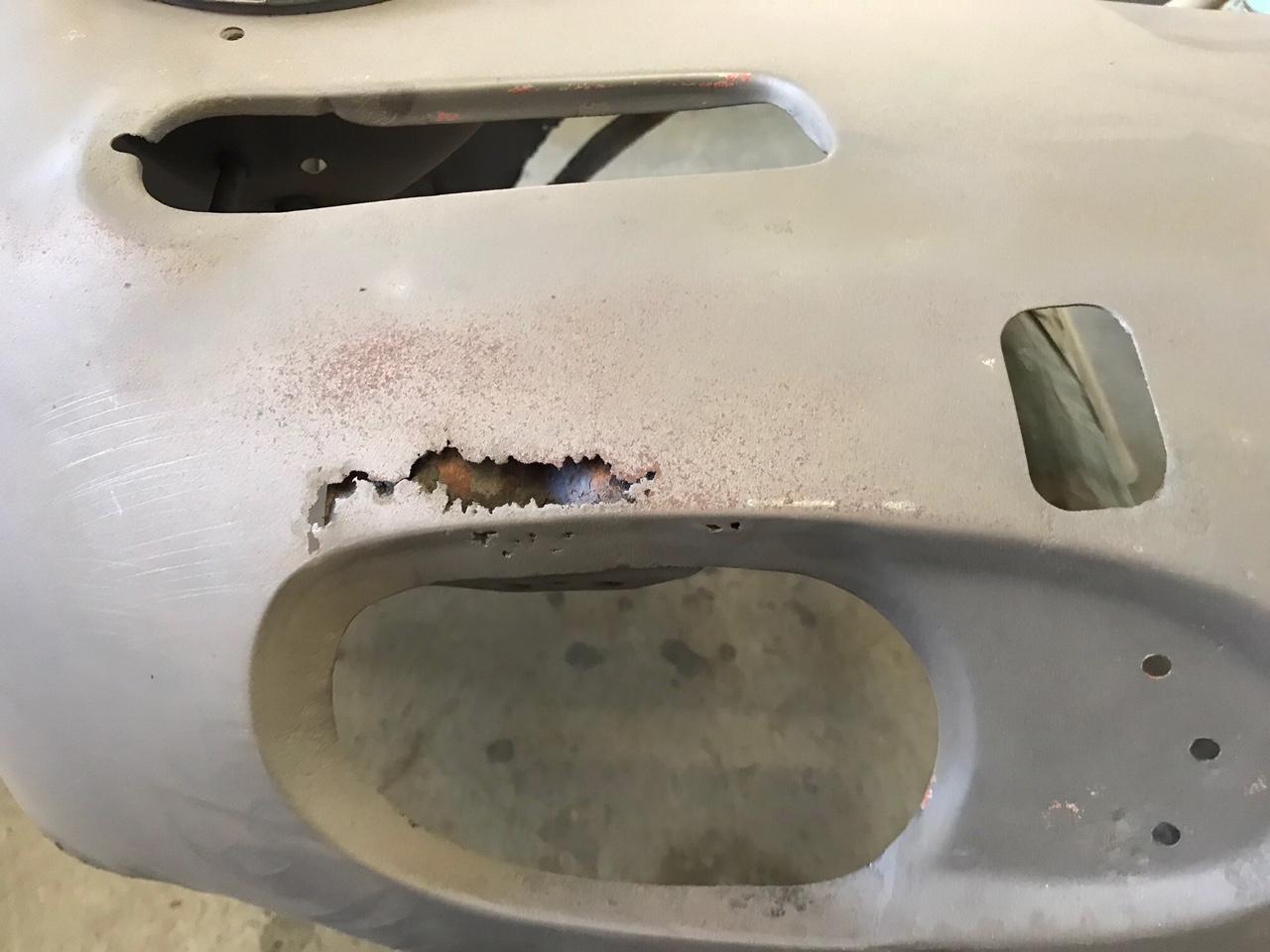

This how the vents appeared at first
Then work started to fix those extra holes..
Nicholas

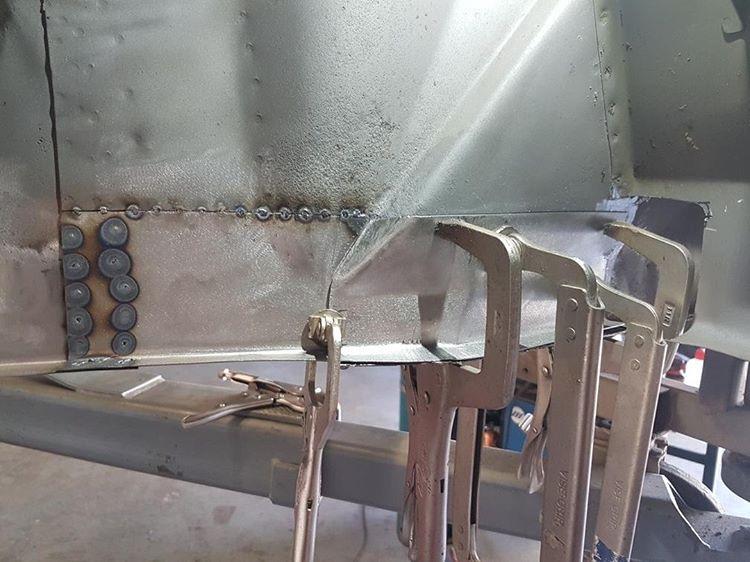

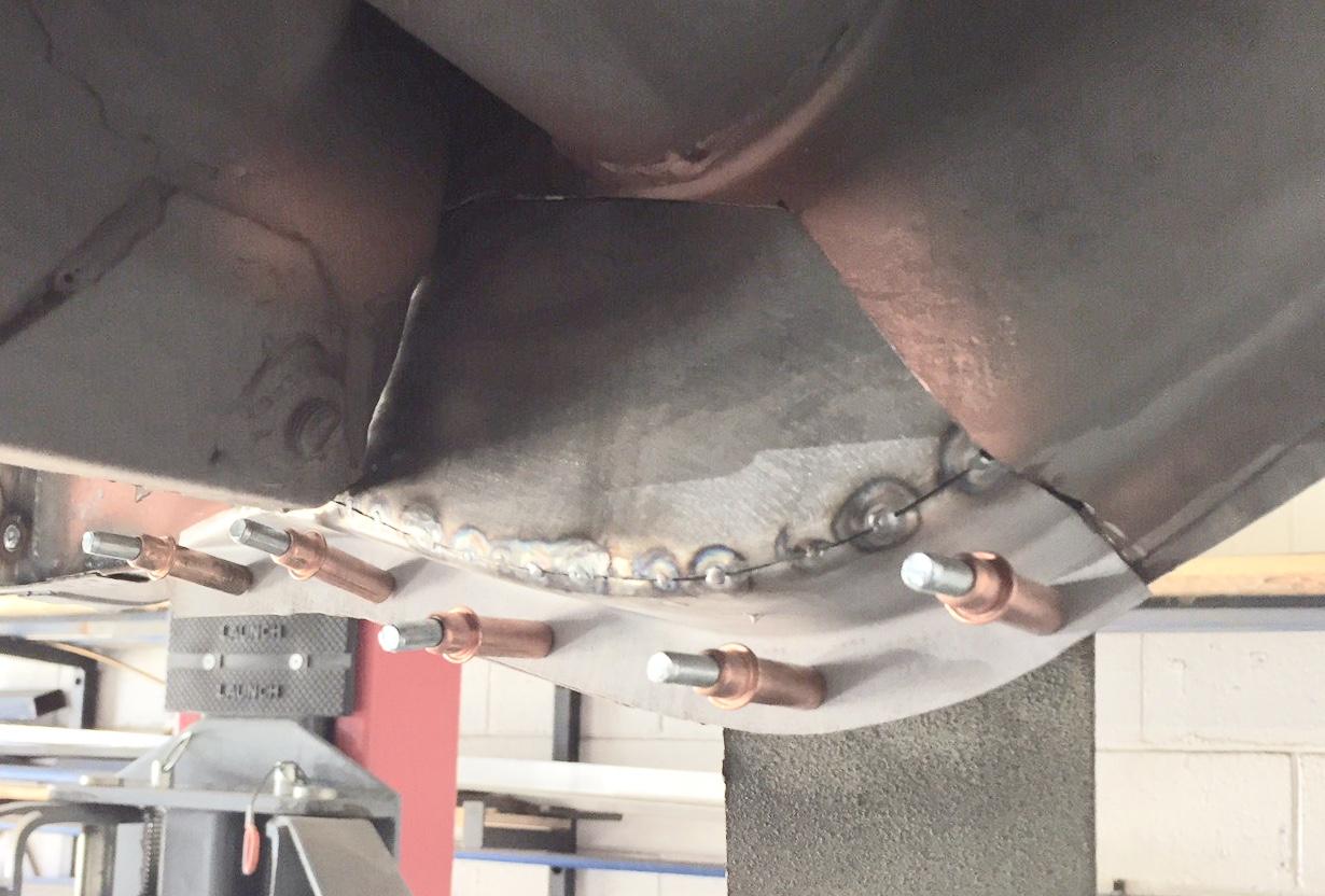

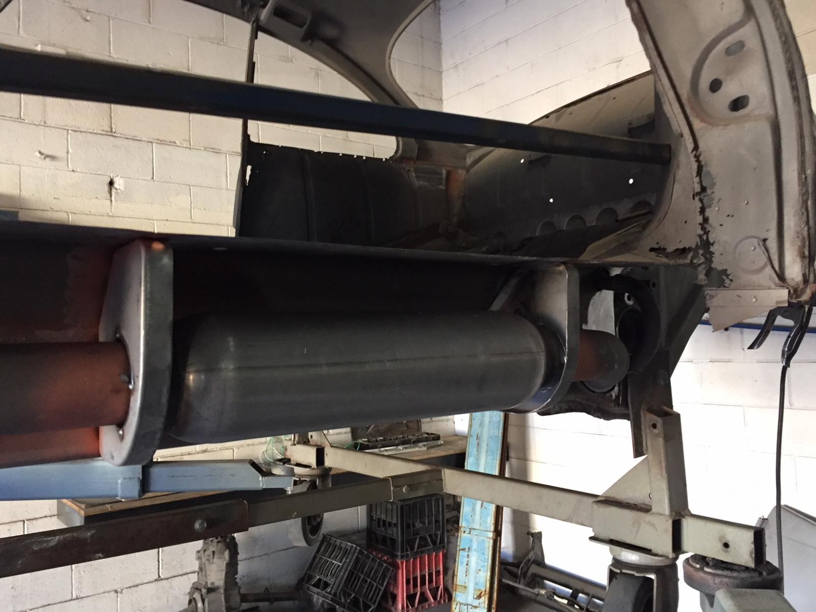

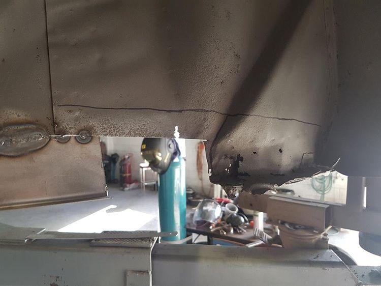

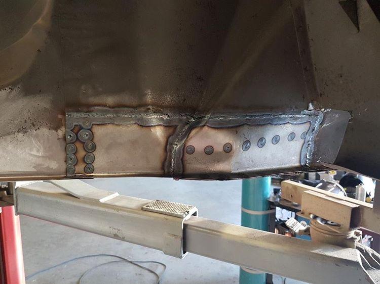

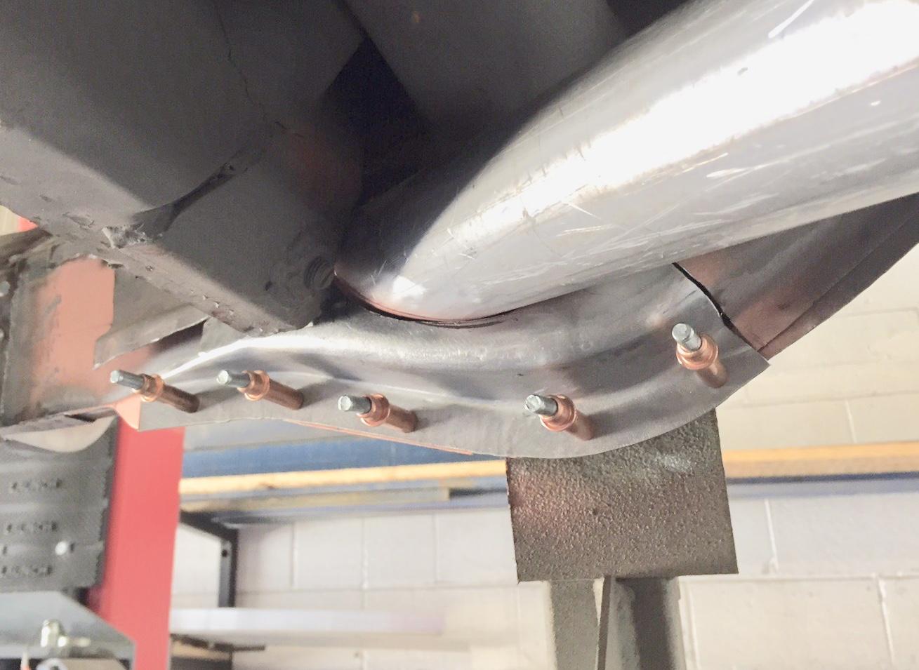

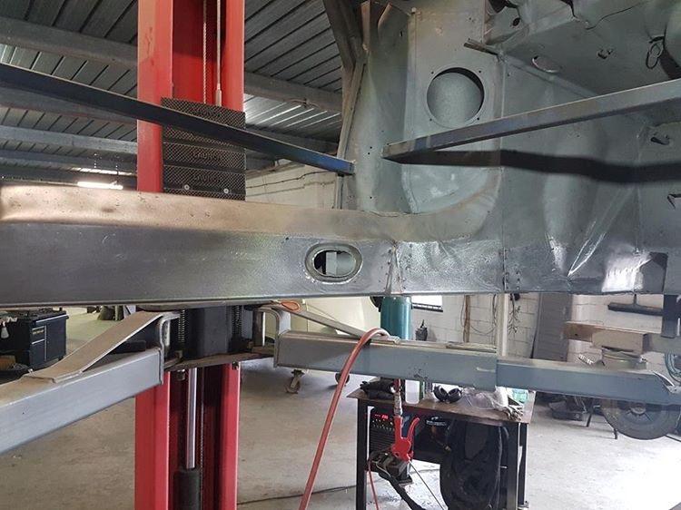

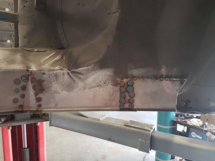

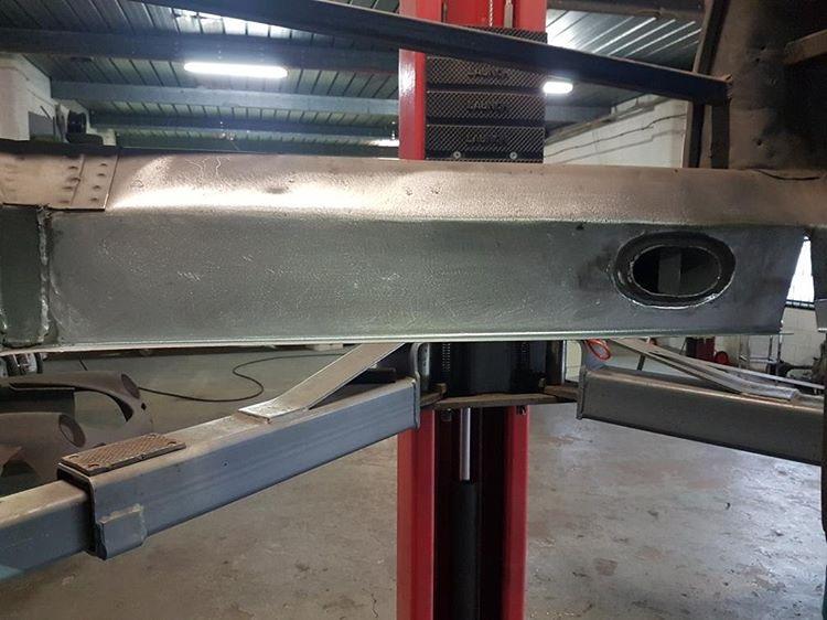

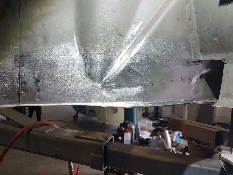

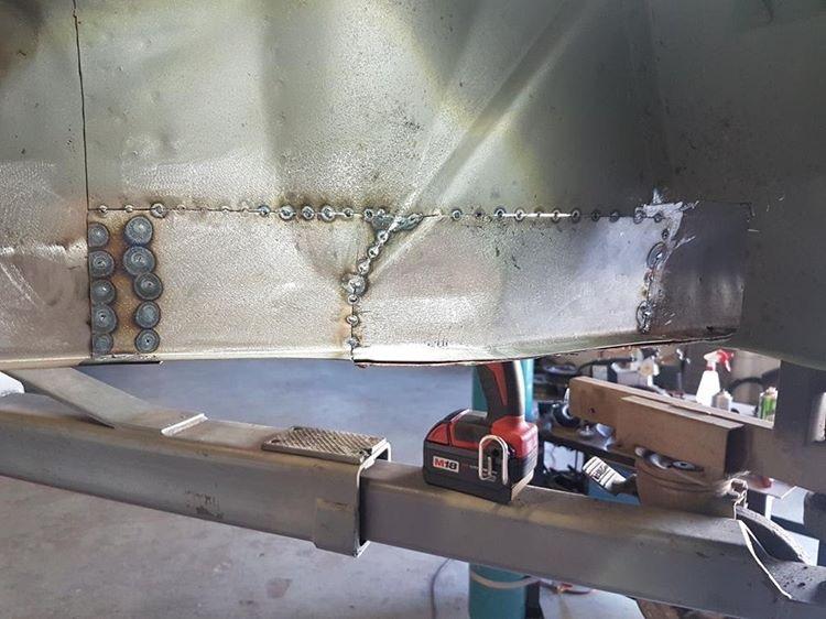

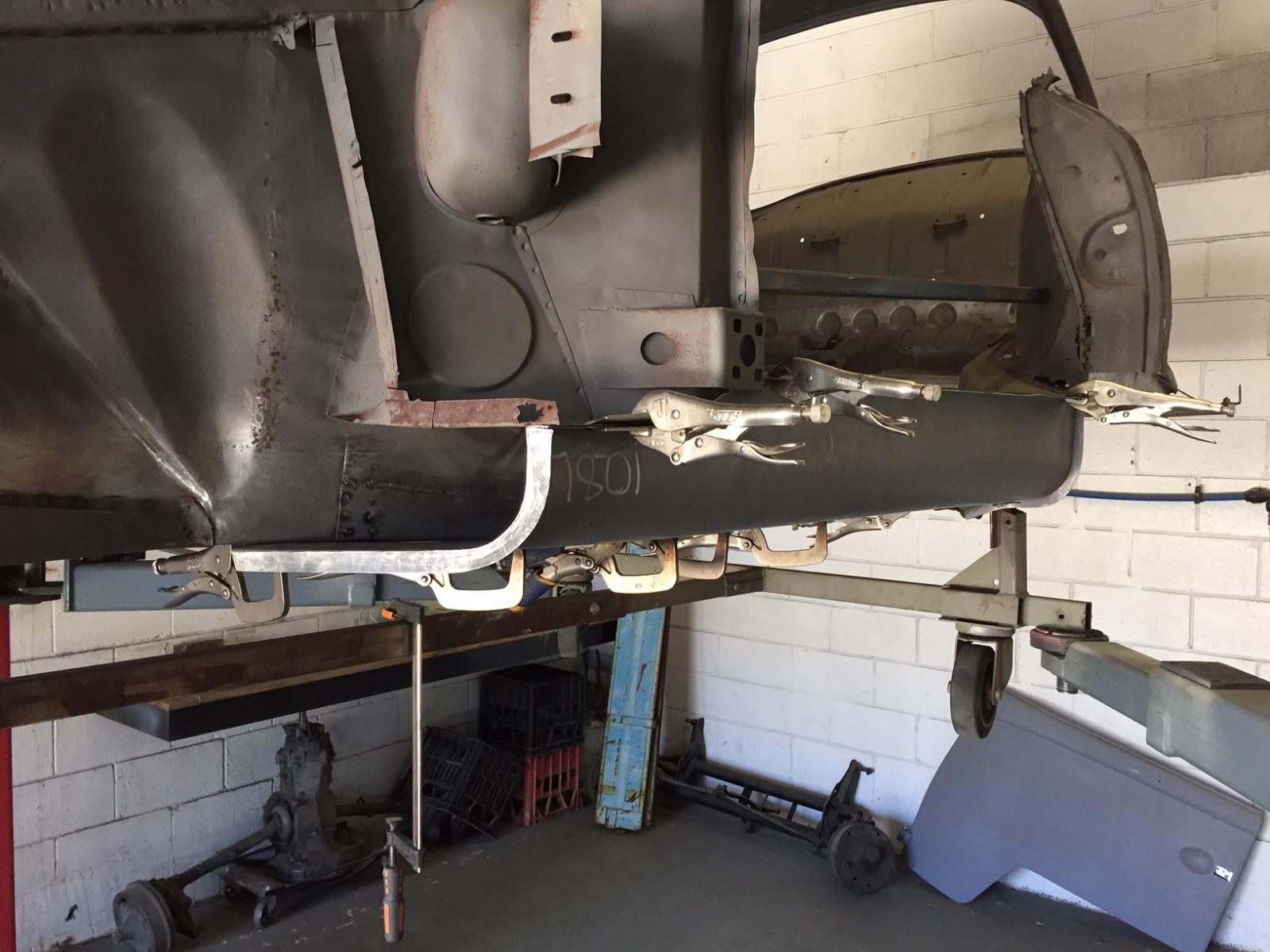

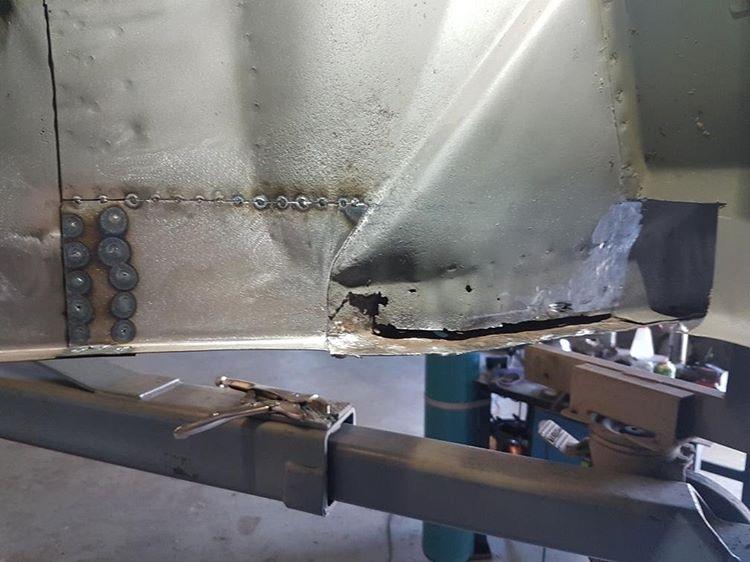

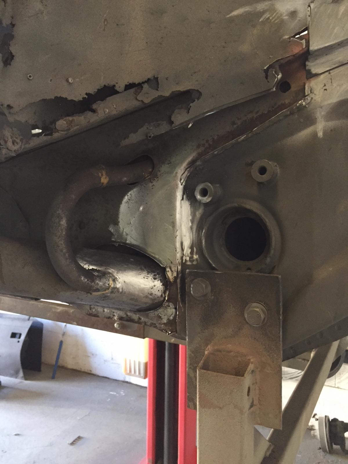

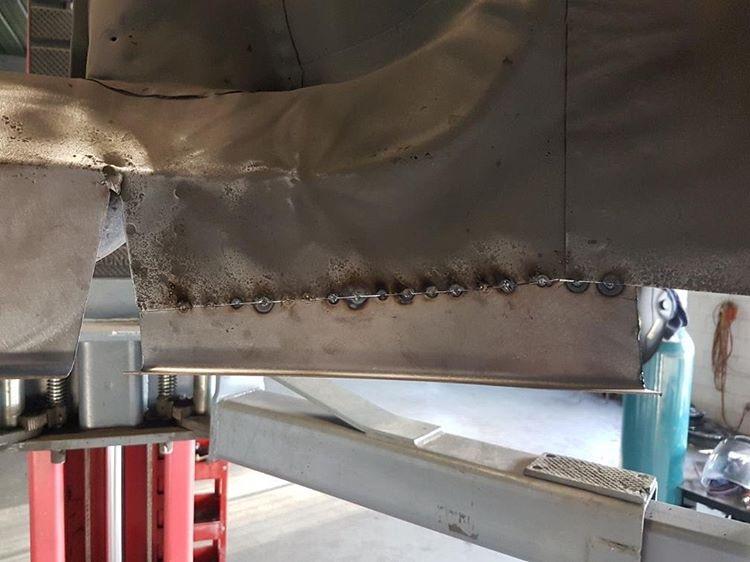

More work forging ahead. We are working on the Heat tubes and under the sills
There will be small pieces added in the lower guard, later.
Muffer added to keep down some of the noise.
Trial fit for the outer sill piece. This will all get a protective sealers and epoxy to stave of rust in the future.

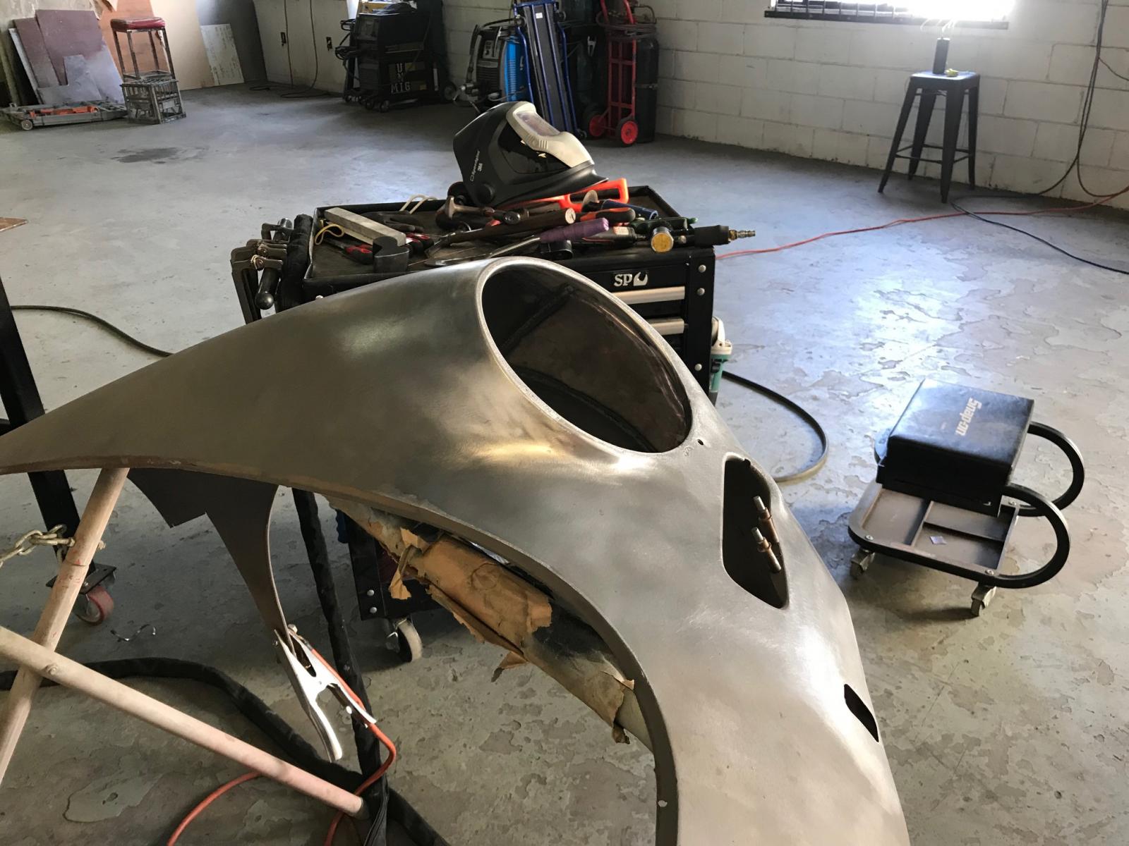

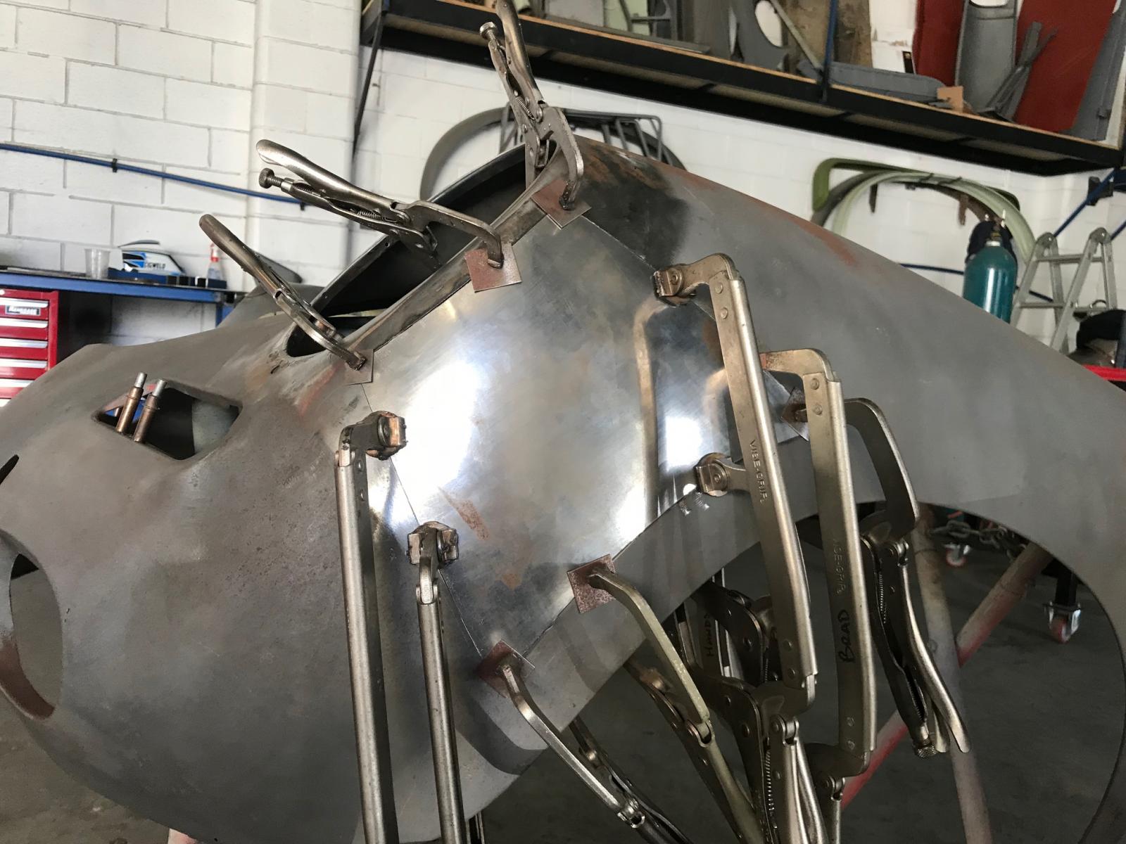

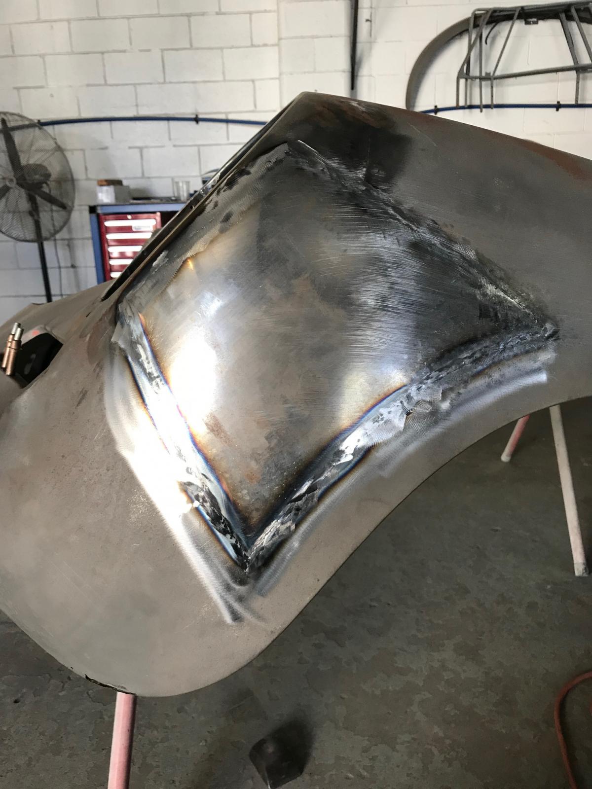

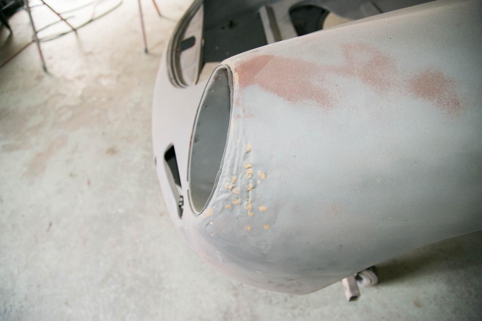

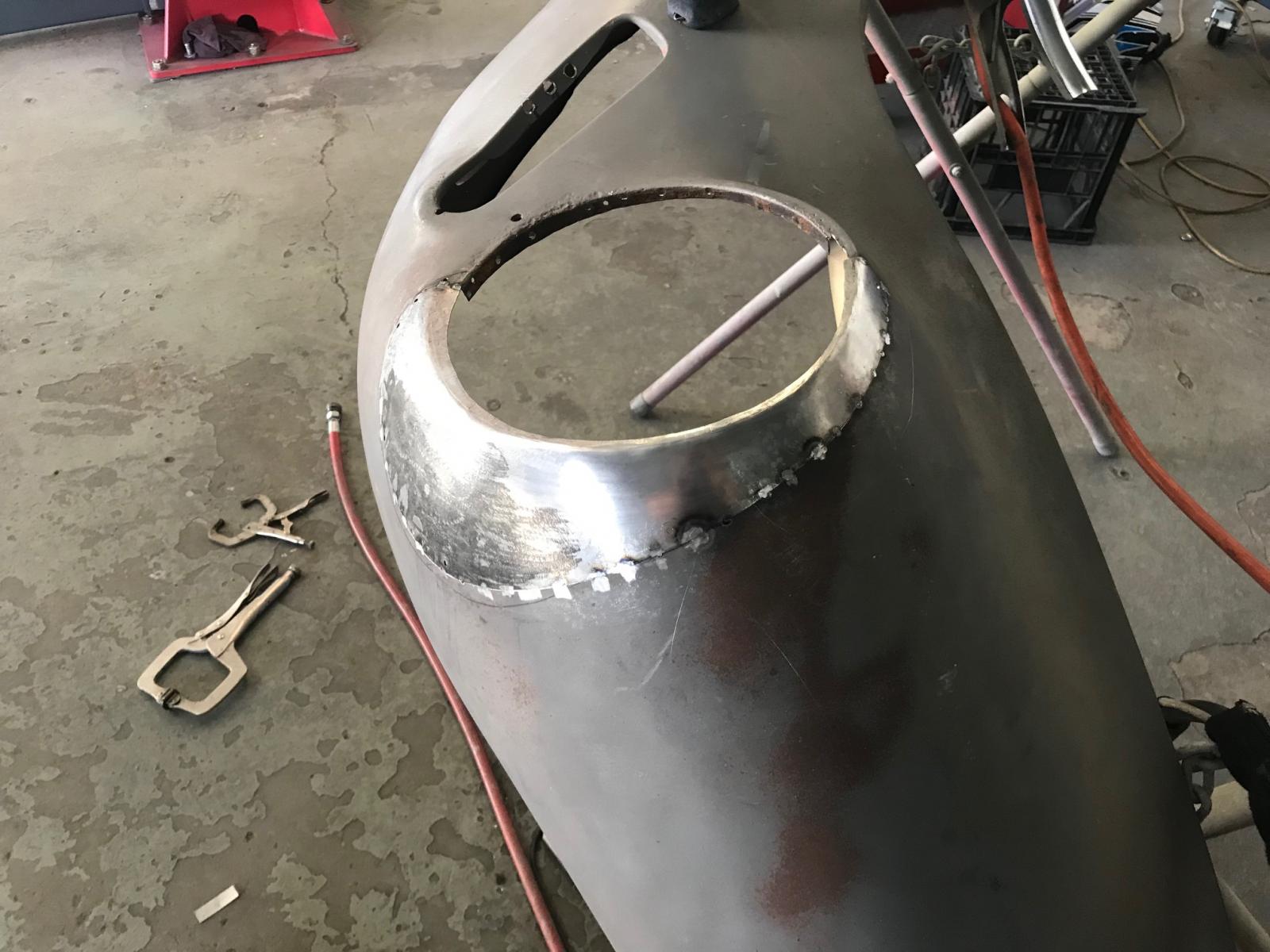

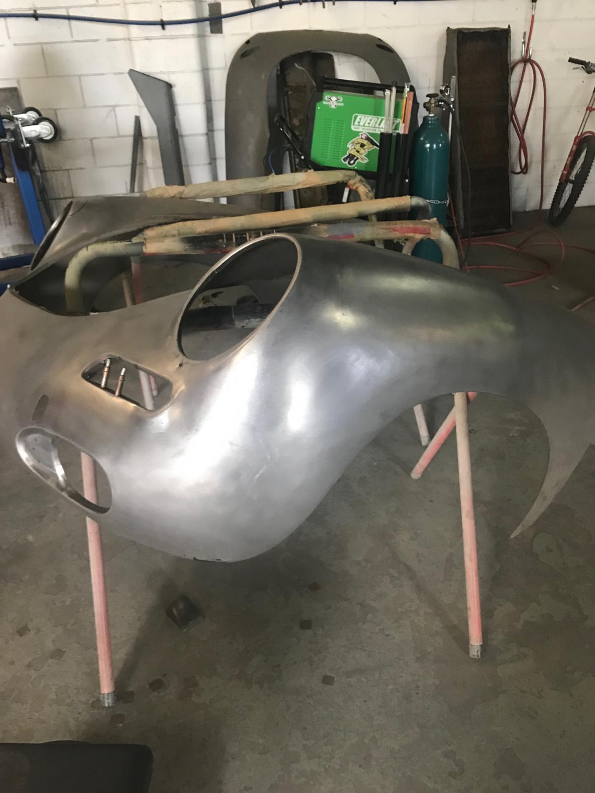

The RHS headlight needed more attention than expected. It started off well enough.....
.....until a crack developed with the heat stress. Further poking showed the metal was too far gone and it was systematically replaced.
This looks pretty good now.

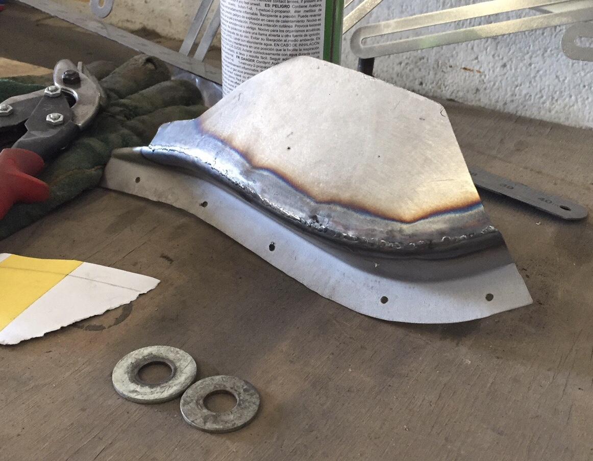

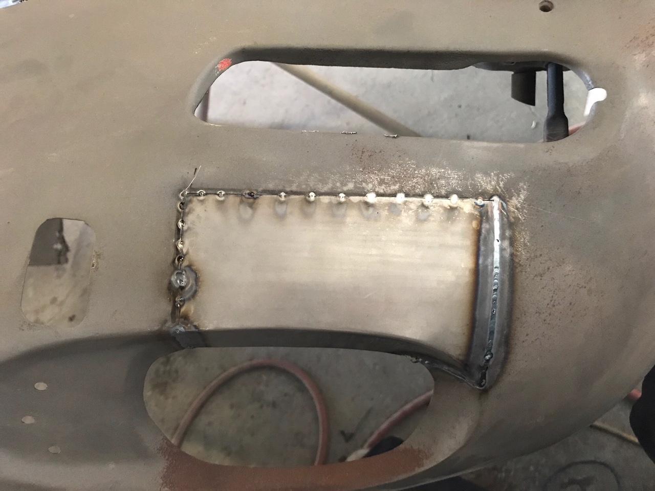

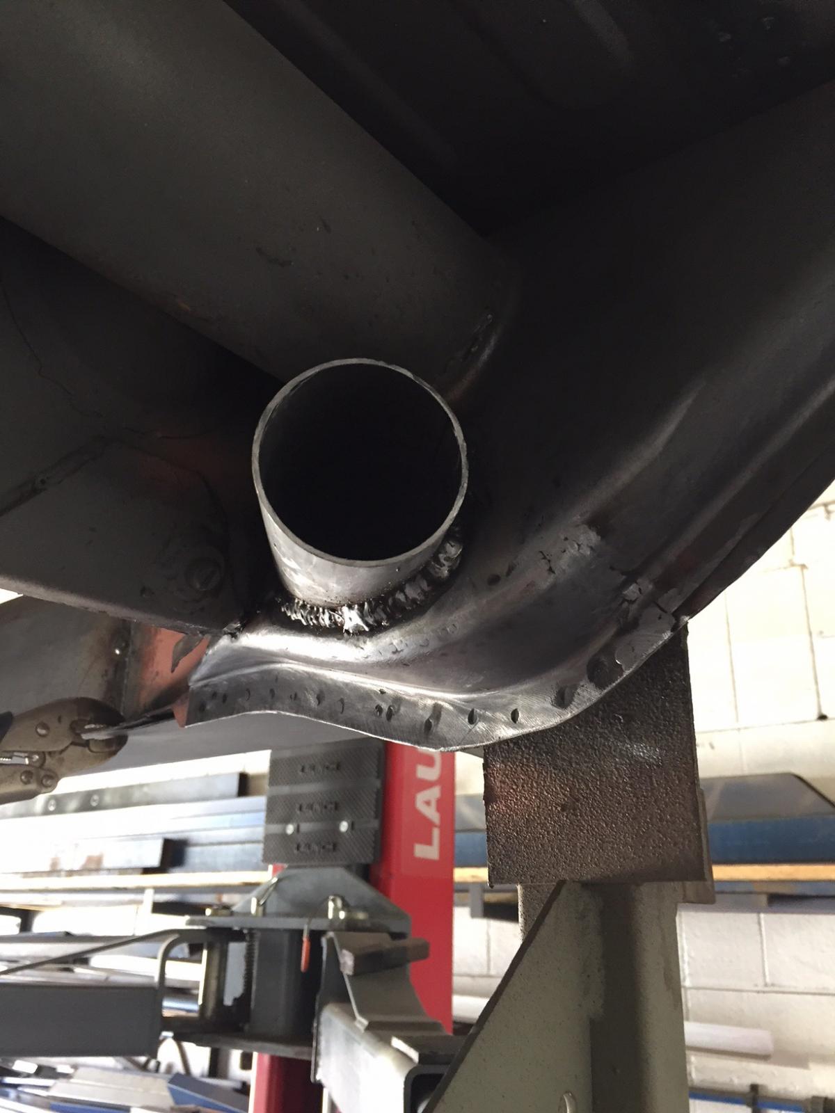

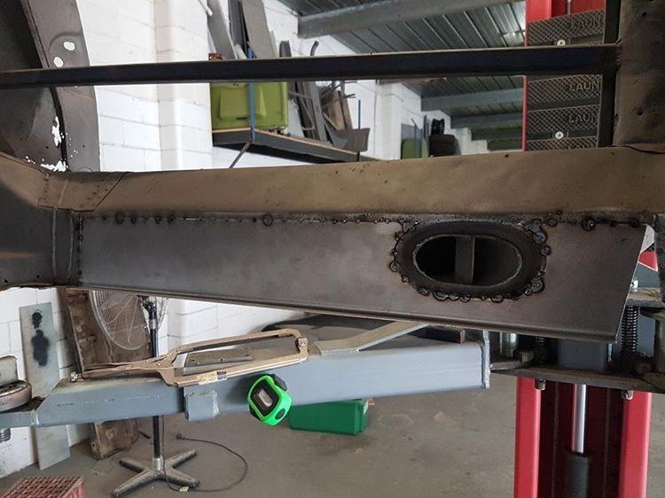

Anyhow, the tasks are being done and the remediation continues. This week we are dealing with the heat pipes in front of the rear wheel house region.
The piece is fabricated from two bits tacked together on the car
Then welded together on the bench
the welds are filed out, the hole added, the piece attached to the car and the heat pipe slid through...
....and finally the pipe welded in position
That’s a day’s work in itself.

Would you be interested in selling the wheels you have?
Im interested in them because they are 4.5 inch.
Thank you.

No problem with asking. I need five wheels and I’ve got four. My 100% perfect would be five wheels all of the same type date stamped late 64. However, until I find my perfect set its better to hang on to these. But then I have a buddy with a 356sc seeking exactly these, so in keeping with the principle of “a priori” he has first right of refusal. It seems everone wants these wheels Laughing

Contact Adam Wright at Unobtanium and tell him which date code wheels you need. He should be able to get back to you with what he has available for sale. [email protected] He is located in New York so I don't know if the shipping charges will pencil out for you. Good luck.
PostPosted: Tue Jun 05, 2018 7:09 am    Post subject: Re: Picking up the Pieces. Reply with quote
Thanks for the lead there Jon. I have a guy in Australia who can do similar for me ... but I'll keep this contact as a back up plan.
