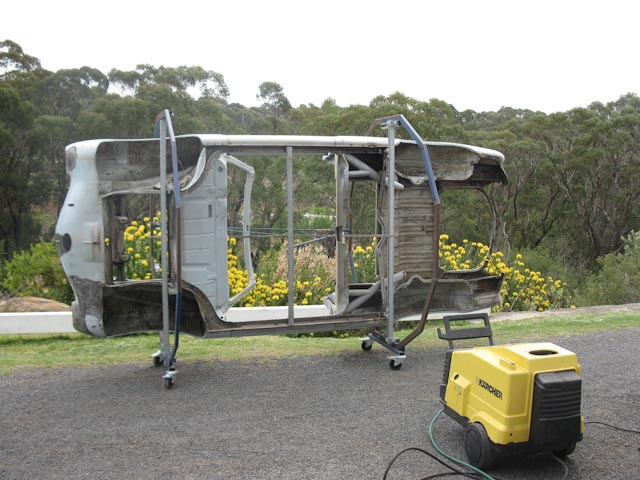

This is what I've been up to during the past few weeks...

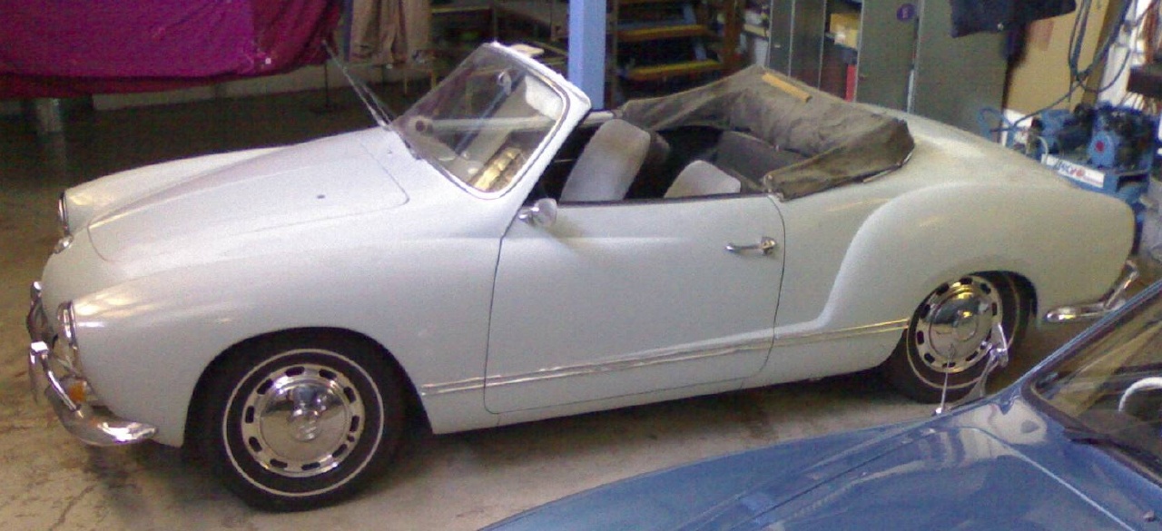

I started with this 1966 cabriolet I spotted in the samba last year.
...Then with a mix of lengthy reading of this forum, my trusty Bentley workshop manual and a bit of chaos theory....we have a orderly scattering of the components......into labeled bags and boxes.
I managed to separate the body on my own, just used a block & tackle with slings around the wheel arches. It came apart without a struggle. Most of what I needed to know was in Icy's FAQ..(so thanks for the shared help).
When I got it up on the Rotisserie I had a mild panic....."Oh Gosh! What I have I got myself into?" I thought. This is the start of a long push against the natural order of entropy......I hope I make it through to the end and get a lovely cabrio out of it.
I'll keep you posted here

PostPosted: Tue Dec 25, 2007 6:54 am    Post subject: Reply with quote
Post plenty of pictures, so I can learn from your "mistakes" Very Happy
I have a 66 vert also, so I will be watching closely,thanks for sharing

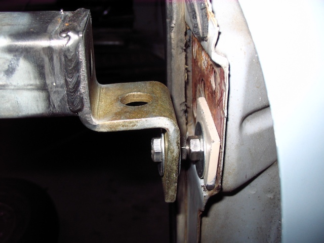

Did you weld the cross brace in the door, or is it bolted in?

Fantastic ! It looks like you started with a beautiful Ghia to begin with Cool

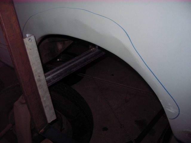

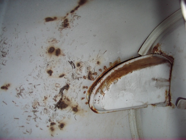

Looks great. That left rear quarter arch has issues, which I am certain will be very surprising once the clean-up of the body begins.

the doors are braced with a short sections of square tube I had lying around. I welded a unistrut piece on each end. Then I used a long stainless bolt with washers, nuts and plates to make an attachment that can be adjusted to length and locked up nice & tight. I won't use it as a lifting point so a single point is all I think I will need. The Rockers are totally rust free and will not require work so this brace is merely a precaution.

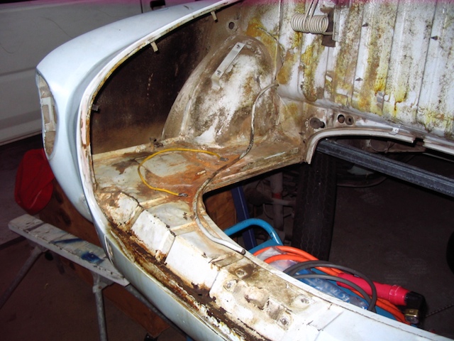

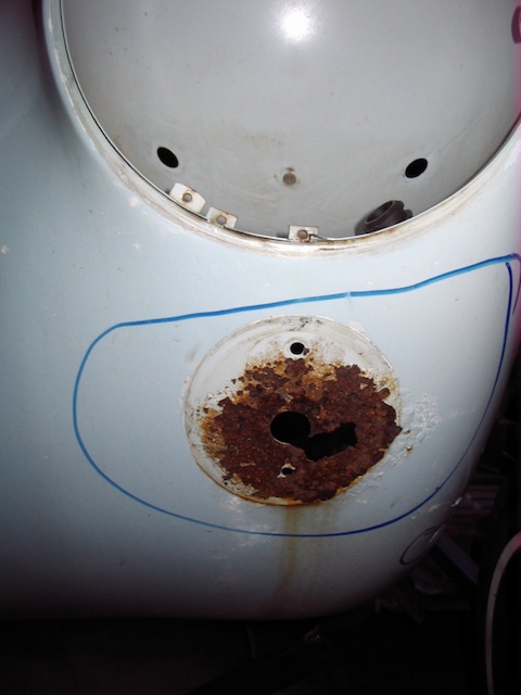

and finally Icy. Well spotted. vwmark reported this at the time of purchase. It seems a PO was shunted quite heavily in the 70's. the incident pushed in the the rear LHS and rolled the car forward into its front RH corner. This collision damage was repaired rather poorly so I have to cut it all out and do it again properly. The wheel arch has buckled and the "push has continued in to the bottom of the firewall.
There is only collision damage and hardly any rust..which a good thing. The trunk lid doesn't fit properly and neither do the tail lights. This is where the replacement quarter and a spare trunk lid I have might be a way to resolve those fitments.
You can see the engine bay sheet will need to be pulled out and swapped with the best I can muster from replacement pieces from CIP, and KGPR and from this quarter I bought from VICSBAHN
I can't find the Lip that surrounds the engine so I'll have to unpick this one and straighten it on an anvil or something. I have replacement steel to go all the way around the rear apron but the centre engine bay steel is the later type with 4 drain holes, not the 2 hole type...I might have to splice the old one with the new one..especially since the hols for the release don't line up.
at the other end, the nose I have replacement steel for the area around the RHS headlight and the bucket itself

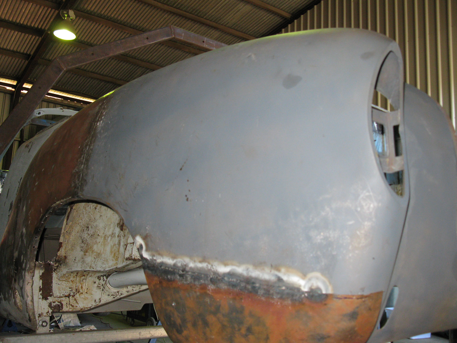

And sadly the nose is showing a bit of slide hammer work the might need to be cleaned up. You can see the air inlet has been damaged as well.
I expect that this might need remedial work too
Once I get the paint off I might try to unpick the welds and see if I can slide in a replacement. I've seen a source for these inlets on a European (Danish?) web site...but I might just be able to tap out the ripples.

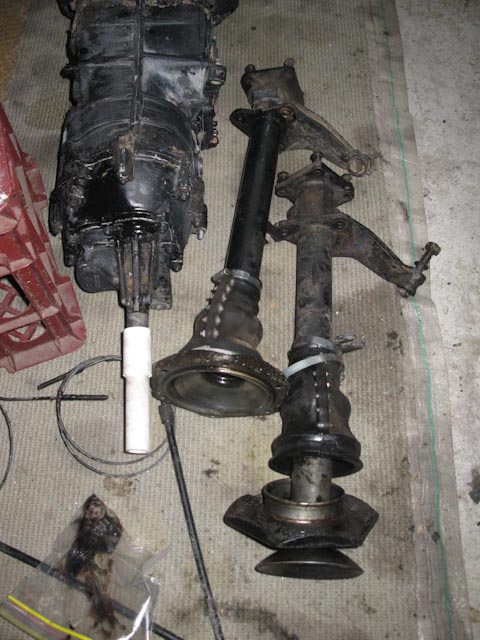

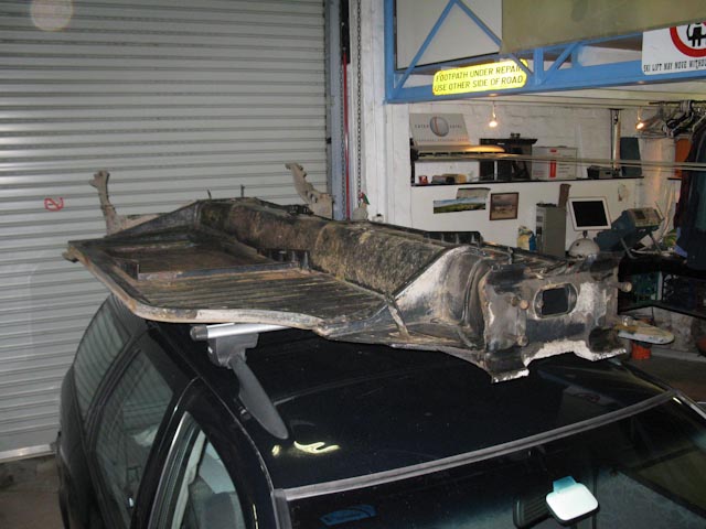

Here I've dismantled the transmission and axle tubes. The transmission is now replaced with a Rancho freeway flyer. The axle tubes are sitting in an acid bath with most of the rest of the suspension in preparation for painting.
Here the chassis is on the roof of the Opel about to get taken to be media blasted.

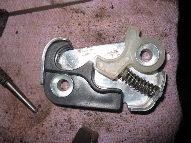

Here I've cleaned out and replaced the broken bits in the striker plates.

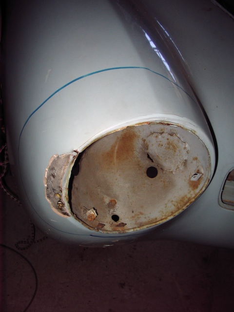

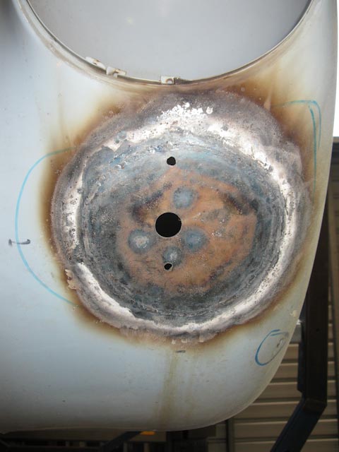

and here the patch of rust around the blinker has been cut out and replaced with new metal and a little bit of work with a hammer and dolly. I can't take credit for that..... Chris Rolfe of Innovative Body Works is looking after stuff where I lack expertise.

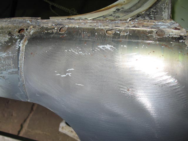

At the moment I've got a heat gun on the underside of the body and using a scraper to get off all that tar sprayed on the body. I have to do that since the media blasting bounces off without removing a thing.

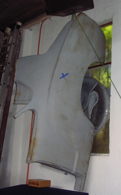

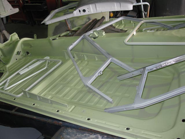

I got the spare rear quarter back from Ready Strip after alkaline dipping. It looks good as far as stripping goes but it turns out to be a little bit of a disappointment as a spare part. what's got me bothered is the smashed up inner arch. I thought I bought a collision free part, albeit with rust along the bottom. Oh well, them's the breaks. We'll just have to make a hybrid between this and what's already on the car
On a brighter note I've managed to get most of the tar of the bottom of the body and have given the whole thing a good wash with the Karcher pressure washer. I figure the better job I do ahead of the medium blasting, the better the job they will be able to do.
And finally the Pan has been cleaned and blasted and sports a nice new coat of epoxy primer. Before it gets painted black, I'll have to drill a few holes for the RHD conversion.
Those frames sitting on top are for a split window Kombi also in the workshop. The Pan seems to work nicely as a drying rack Laughing

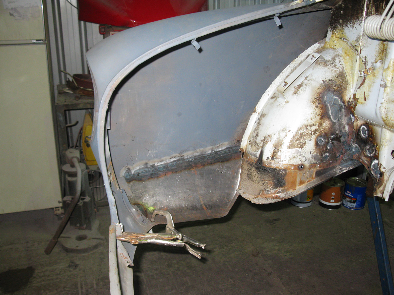

So things have been busy in the last week. We've been working on the body and have eradicated a few problems.

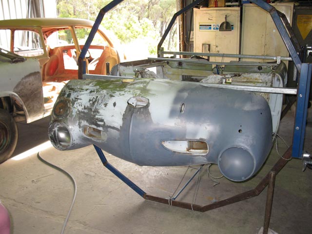

Here we see the new headlight bucket and headlight surround installed in the RHS guard. It has a coat of etch primer to protect from surface rust. Next on the agenda is a bit of filing to smooth over the welds. The wheel arch is back to shape and the small dents throughout have been beaten out with a hammer and dolly
This is the view from inside the same guard... seems we've forgotten a quick spray of primer...Ooops Razz
The area around the air box was bad. Lots of slide hammer holes and other abuse. So Chris chose to splice a patch instead. Smashed before, previous repair work included sufficient filing to make the metal very thin and giving us a risk of making a big hole. Now with this extra meat it will file out nicely enough. Although it is a little hard to see in the photo, the air box itself is looking a lot better with the hammer and dolly work in and around the area
Standing back, in this photo, you see the whole nose is looking quite OK. The bottom edge at the front looks reasonably even, whereas before they were markedly different. It seems to spend a lot of time inverted like this. Is it not yet accustomed to life in the southern hemisphere? Laughing Or is it some kind of Bat mobile? Rolling Eyes

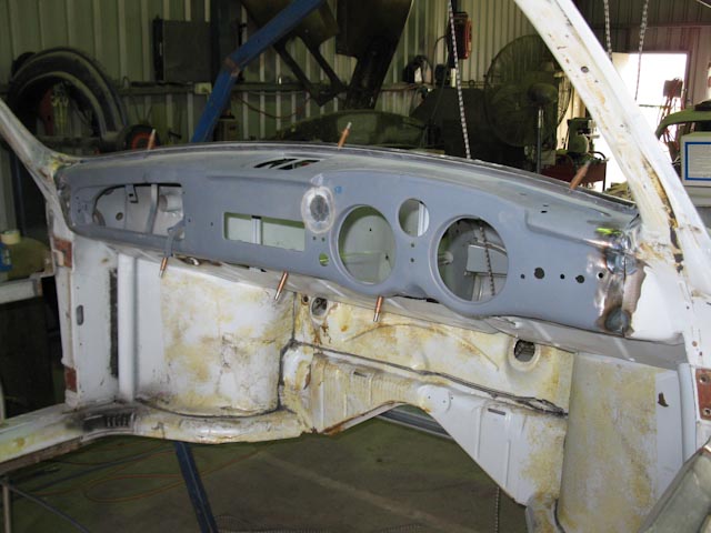

And of course the other big change is the Dash panel from South Africa now inserted into the car. We have a RHD car now. It lined up OK except for a small section along the bottom edge. The old holes have been filled and new ones opened.

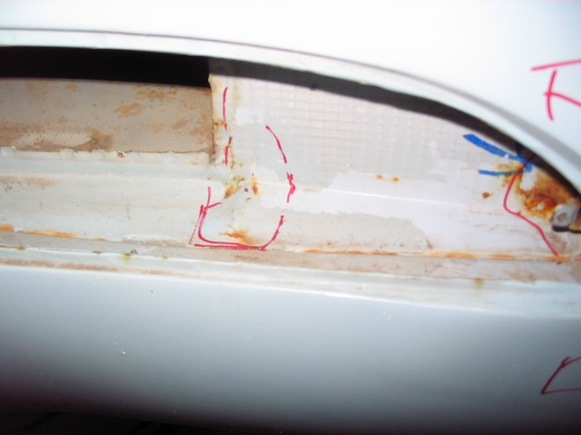

This photo shows the spot behind the front wheel arch just where the heater channel dog legs. This zone is notorious for rust but showing here under the stripped paint we see just shinny metal. If anyone doubts the value of a dry climate vehicle then just look here and see where the value lies.

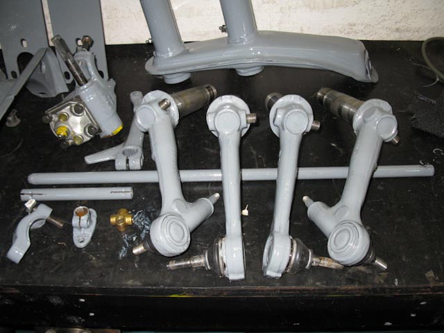

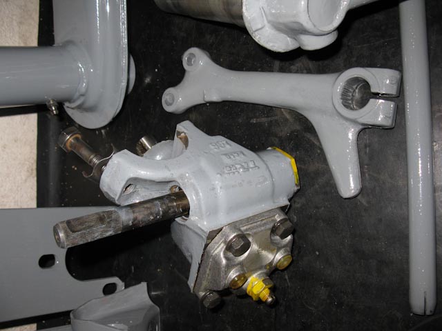

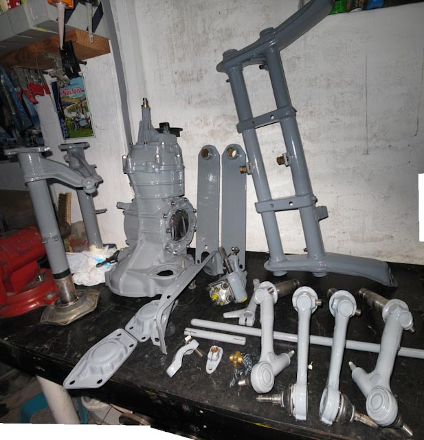

I've been doing stuff at home... and have had the paint brush out.
Basically the scheme is to paint all the bits that bolt to the pan a mid gray. I've sand blasted, marine cleaned, metal readied and POR-15'ed these parts. Hopefully this will be sufficient to protect it from rust and stones. Being a lighter colour will make it easier to see and clean dirt, oil and grease build ups. The car isn't going to be a daily driver but it will be used regularly. So for those moments when I wish to be alone in the garage with her.... I'll be able to clean and polish her deep insides with ease Rolling Eyes
Steering box and pitman arm. The clean-up is yet to occur, so finger prints and drips will get wire wheeled off where it isn't meant to be...
Front trailing arms and steering. I asked my mechanic to not install the ball joints just yet......so he when right ahead and installed them.Confused It made the paint job a whole lot harder.
The whole lot is sitting on the bench awaiting the chassis to arrive home. (Photo is made with a super wide angle lens that distorts the shapes at the edge.)
The gearbox is a Rancho Freeway flyer and the front beam is 5 cm (2 inch) narrowed with adjusters and converted to RHD.
Note: there is a subtle difference between LHD and RHD pitman arms, in that the holes are tapered towards opposite sides. It might look the same shape but it ain't.
Soon the chassis will start to come together. It is waiting some more holes to be added for the RHD brake cluster.... which is measure twice, cut once sort of work. It requires attention. And then it too gets paint.... Black paint
