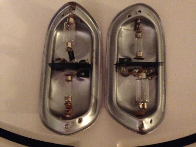

The two holes you refer to are for the up to mid '57 bulb housing. These use festoon type bulbs . If you have later bulb housing with bayonet bulbs these holes become redundant.

PostPosted: Sat Jan 02, 2016 3:50 am    Post subject: Re: 1958 rear tail light seal Reply with quote
52 BD Deluxe
57 Ghia golde
54 Ragtop
