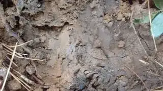

The pictures are of the tree inside; a close-up of the root ball in the pot; the entire planting hole; and a close-up of the bottom of the hole. The soil in the bottom of the hole seems clay-like. It's thick and slimy. It almost feels like mud, just not quite as wet.

  • It depends on the soil type, and what the current moisture content is. I can go onto details in an answer if I have time. Do you have a clay based subsoil? – J. Musser Dec 25 '16 at 06:51
    @Sue pretty much looks as expected, a bit wetter. My answer will be the same (also, I think I may do a q/a on how to plant a b&b tree, so people can see how I've done it for so long) – J. Musser Dec 26 '16 at 05:58
  • I meant, my answer would be the same as before I saw the pictures (they were just how I imagined). Writing up the answer now, although it's kind of short, The question isn't complicated. – J. Musser Dec 27 '16 at 19:55

Based on the picture, your soil looks quite moist enough already. By watering, you could cause problems in winter with constant saturation, because of the ground freezing. I'd say, if the soil holds its shape when squeezed into a ball, do not water. If the soil is crumbly and dry, then yes, water it even in winter. Sometimes I water a root ball before planting, because the root ball is dry and the soil it's going in is wet. In your care, the root ball has been kept moist so I also do not see any watering necessary.
Spruces have comparatively shallow roots, and generally grow much fuller if the top layer of soil is watered when dry, especially in the fall/early winter before the ground freezes. This year, the northeastern US had a wet fall. Waiting until the end of March was probably an estimation for when the ground would be drained and start drying out (you should never water soil when there's a frozen layer). Whenever that happens, you can water it.
It looks like your arborist knows what he's talking about. All of his instructions are good, for the conditions and situation you have. I'd just say that about using shredded leaves or light mulch in the backfill soil, if those are the materials you use, don't let pockets form, they will not only settle later, but could decompose improperly and slow root growth. I'd just sprinkle it in as the soil's going in, with no heavy layers. (I usually use near finished cold-compost for this).
