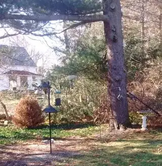

As I said, we'd like to replace the dead tree, which is just sitting there, and was never planted, with the Blue spruce. (In the top picture, it's to the left of the big tree, not the dead branch that's leaning against it on the right.)
Rather than try to calculate a dripline formula, I'll just report the trunk measurements and tree distances. All references to the trees are from looking at the picture from the front.

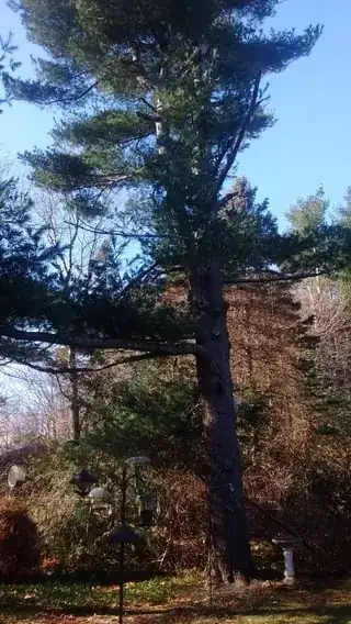

The big evergreen on the right is about 60 inches in diameter. The "dead tree" is about 15 feet to the left of that and back about a foot. A few feet to the left is a bush. Directly to the left is another tree, about 10 inches in diameter. To the left of that is another bush (azalea I think) that measures around 11 inches at the widest point and blooms in the spring and fall. To the left of that (about 15 total feet away from the dead tree) is a tall deciduous tree that's about 20 inches in diameter. Approximately another 5 feet to the left of that is the great big evergreen tree (Norway spruce?). That trunk measures about 70 inches in diameter.
My husband has now dug the hole right where the dead tree had been. It's 36" round and 24" deep, as we were instructed. He only had to break a few roots from the tree to the right. They were shallow and not too thick, hopefully not enough to damage that tree. There were also a lot of large rocks beneath the surface, which he took out.
Now that the hole is prepared, we're back to the question of how well a Blue spruce will thrive in that spot, and whether or not it's a threat to the health of the trees around it. Slow growing is fine with us. In fact, that was the original goal because we have no evergreens that are short or full, and we wanted something mid-sized. If possible, we'd like to keep it pruned to about 6 or 7 feet. We'd be fine about getting rid of the nearby bush, if there's a question of fighting for root space.
The first pictures are from last May-July when everything is in full foliage. It's dark and shaded there most of the day.
The second group was taken in December, a few weeks ago. The leaves from the deciduous trees have fallen, putting the tree in full sun for most of the day.
Click on pictures for closer views. These were taken between May and July:
This group was taken during the first week of December:

In my opinion, it is not a big deal. Six hours are enough. You can cut some branches of the other tree, and wait the spruce to grow, so it will get more sun.
In nature, young tree tend to grow in semi-shadows (most will die or be dormant also for decades in shadows, waiting a old tree to fall).
I just expect that it will grow very slow, but (also in my opinion) this is a nice feature.
Contrary of most deciduous plants, spruces don't tend to extend in order to find more light (thus giving a skinny form).

Blue spruces only need full sun to reach their top growth potential, they do not require it to be healthy. They will grow very well in shade, if they are not under another tree's dripline, and if there aren't many other tree roots in the soil.
Under a dripline, and in dense rooted ground, a spruce will grow much slower (sometimes less than 6" a year), and will perhaps not have the pencil straight trunk that is easy to achieve in full sun. Fertilizing can help with that.
In the shade, Blue spruces do not lose color, but the branching habit will tend to be lighter, more airy. And the tree may have a taller, thinner growth habit. I actually like to work with these better. Below are pictured some 15 year old blue spruce that only receive 3 hours of direct sun per day. They do, however, recieve dappled sun for some of the day as well, and the shade is light.

Go for it! This location is absolutely a perfect place for Picea pungens!
I personally planted one last spring (and in a similar position to yours), and it endured unusually hot and dry summer extremely well, and looks nice and healthy. Needless to say that it can endure very low temperatures as well. Its natural habitat is high in mountains, and at the edge of forests. This means that, in nature, they do not get sun at least half a day, so no need to worry about sunlight.
It definitely has an uncanny magical feel. I spoke with several people that have this spruce, and all feel something special and misterious about it. It grows slowly, but you feel that it does grow. I heard that it doesn't like artificial fertilizers - basically you need only to water them during first few years, and infrequent but generous watering is the best. Pruning is best avoided altogether - only if you want to have denser crown, you need to pinch leader and main branches from time to time. And the rule is: do not remove lowest branches - the crown of this tree looks the best if it starts at the ground level.
