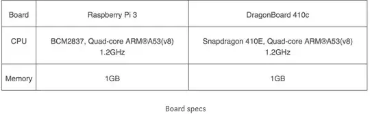

Both of those CPUs are ARM processors as shown here:
ss1
So my expectation would be that you'd be able to use the same binaries on both. Lastly I'd likely as a follow-up question on the Raspberry Pi Stackexchange site. There are numerous questions along the lines of what you're asking there, for example:
