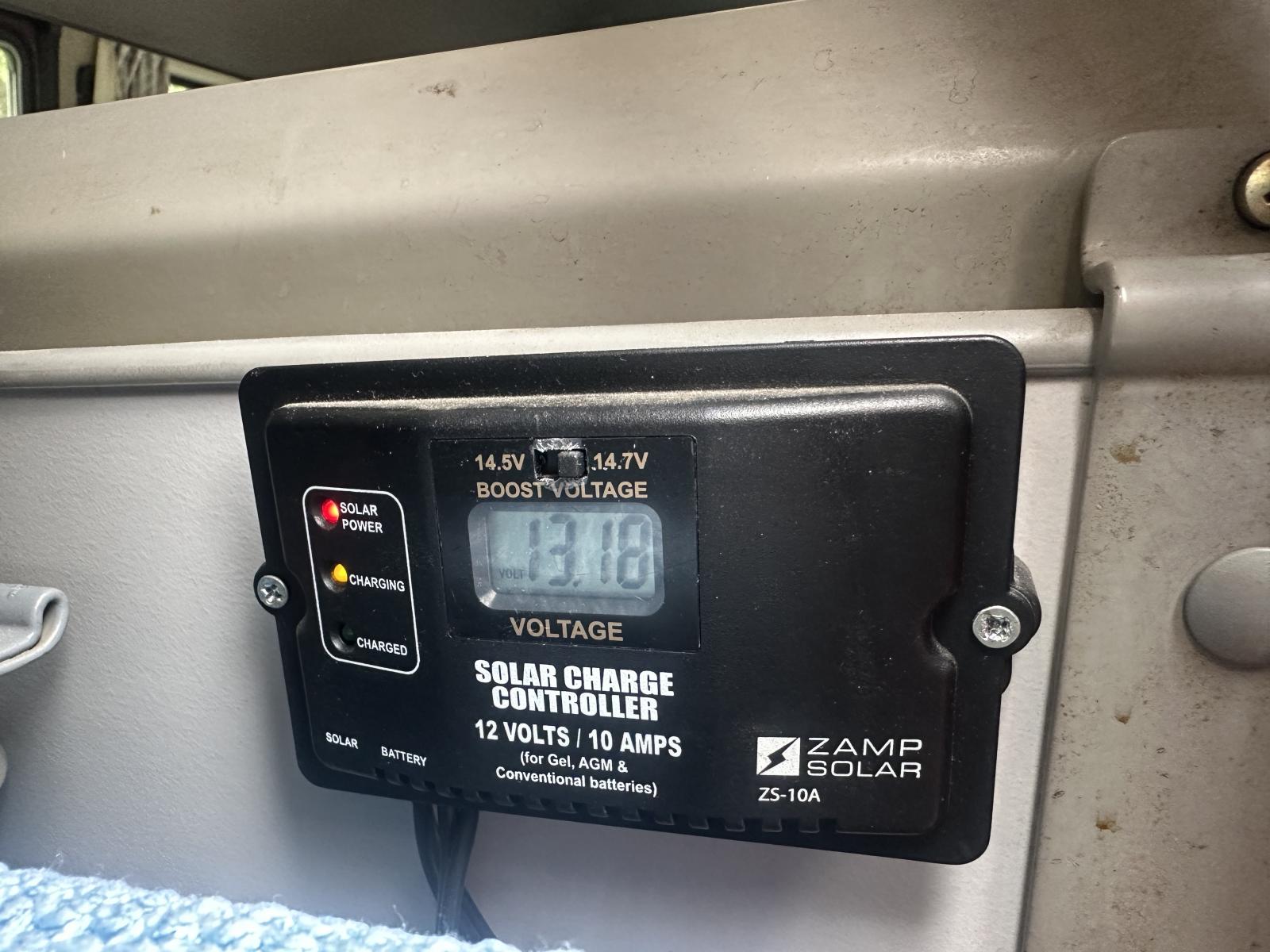

My question is, as I don’t have the Renogy DC/DC charger yet and likely won’t be able to install anyway till back home (that is the plan) what is the danger/issues with installing in with the current ZAMP SOLAR solar charger meant for AGM and conventional batteries? (100w portable panel - GoWesty kit from about 7 years ago. We also have a 100w fixed panel newly installed)
Will it overcharge? The X2 power has a Bluetooth BM system built in - would that protect it?
Or will it just undercharge?
Will it try to burn up the alternator or overheat the wiring from the alternator?

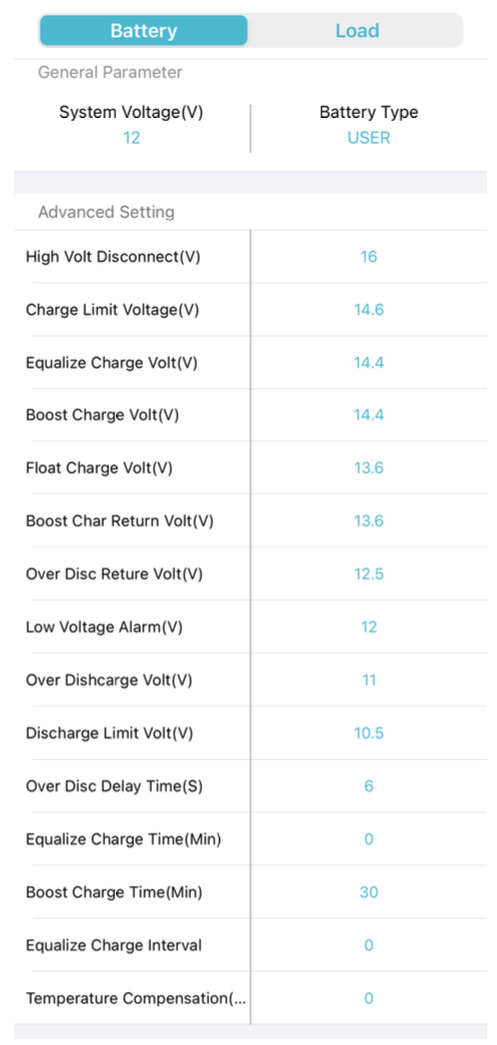

Even if the Zamp does not have a lithium setting, if it has a manual mode where you can assign values, you should be good. I think you want 14.2-14.6v for bulk charging. I think that's the important one.
I have a Renogy Rover 40 MPPT solar controller and Battleborn 100ah LiFePo battery, but here are my settings per parameter I get from the Renogy app.

Thanks. It doesn’t look like the ZAMP has that option - very basic unit it seems, no switches. Just lettering identifying the two sets of wires “battery” “solar” and for “AGM and Conventional Batteries “ “12v 10amp”

It does have a 14.5 or 14.7 boost switch I see.

If you leave that set to 14.5 you should be fine to use it with the LFP battery. The BMS in the LFP should prevent overcharging.
