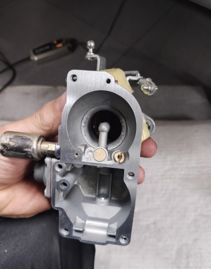

"Okay, time to blow off the dust... After a few short rides, it became clear that there was already too much play on the left throttle valve again. And this after a rebuild, unfortunately... I sent everything back to the company—thought it would be a quick fix! Unfortunately, they came back and a part around the throttle shaft had broken off. So I sent it back again, and now they seem okay—I thought! But after a closer look, I noticed there was a gap between the two halves, both left and right. This became clear when I used a thinner gasket. I’ve now leveled them myself using a glass plate and 320 wet and dry sandpaper. Let’s hope we’re almost there now... I’ll put them back on soon, check the levels, and readjust everything. Bit of a bummer, but I guess that’s just how it goes sometimes..."

He just needs to run smooth and safe — not chasing perfection here, especially knowing not everything’s original.
I leveled the carbs on a glass plate and cleaned up all the imperfections. Float height is set at 13mm for now — we’ll see how that holds up. Everything’s back together and the carbs are synced at both idle and high RPM. Planning to go over the rest tomorrow and double-check
everything.
