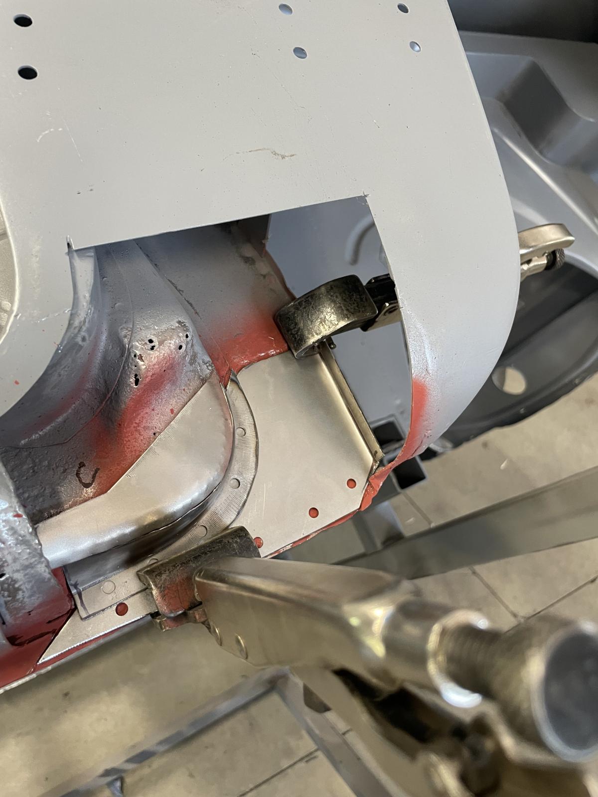

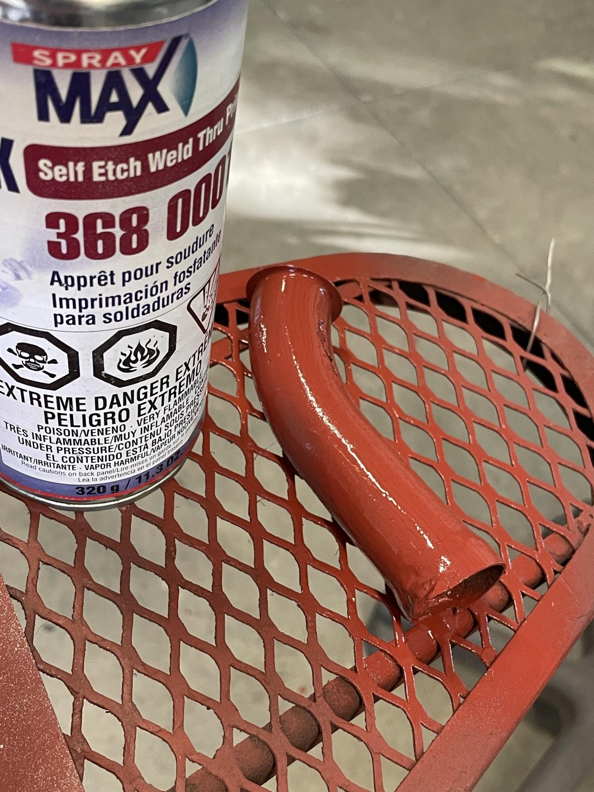

Wonderful work to watch Smile
I was wondering what is the red primer you use and is it a 'weld through'. kind of primer?
Keep up the great work
WrennMetallWerks
Joined: December 06, 2007
Posts: 3314
Location: Rescue ca
WrennMetallWerks is offline
PostPosted: Fri May 16, 2025 4:42 pm    Post subject: Re: 57 Kab Reconstruction/Restoration Reply with quote
^^^ Hey There. Yes it is. Works very well.

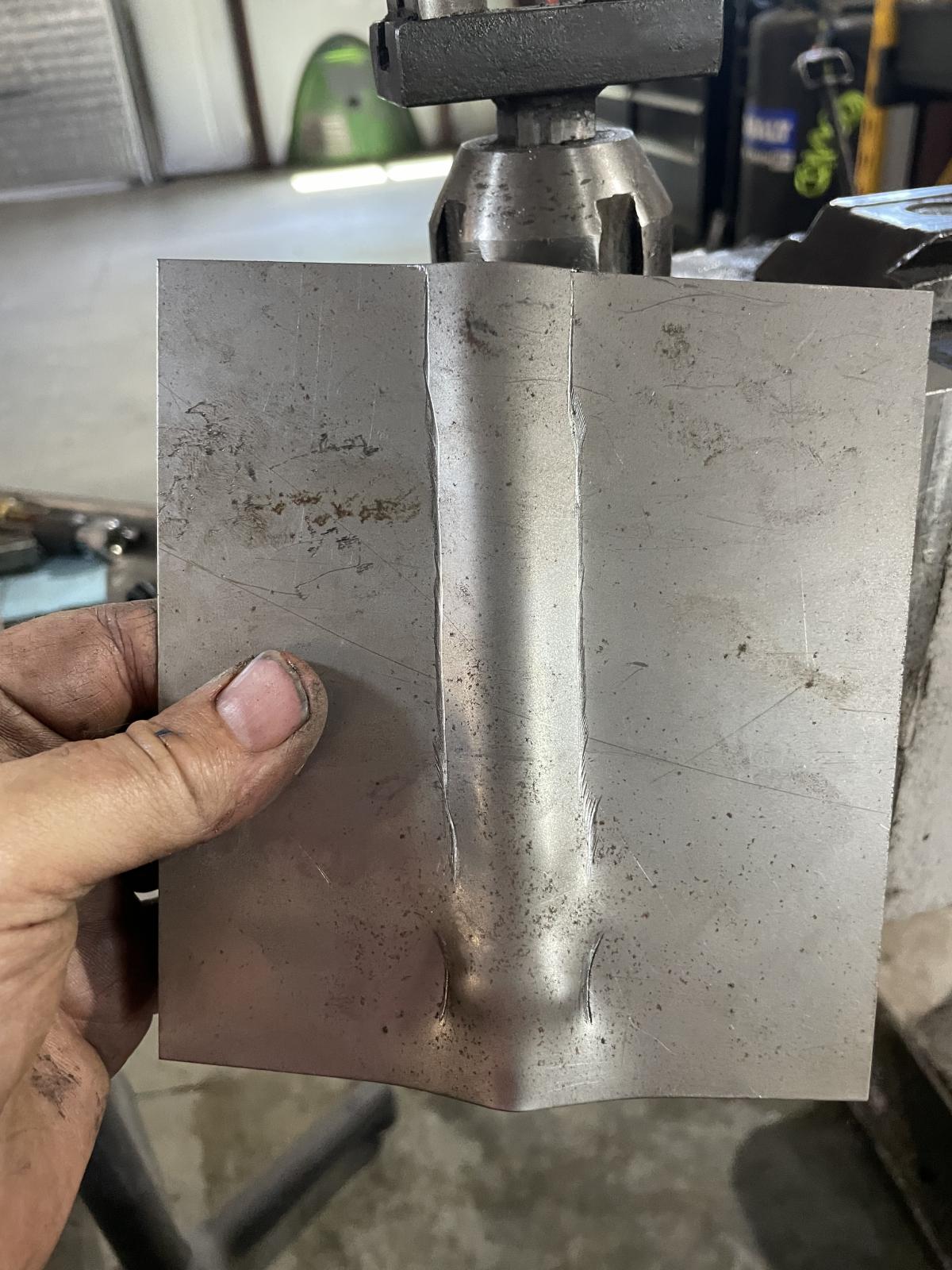

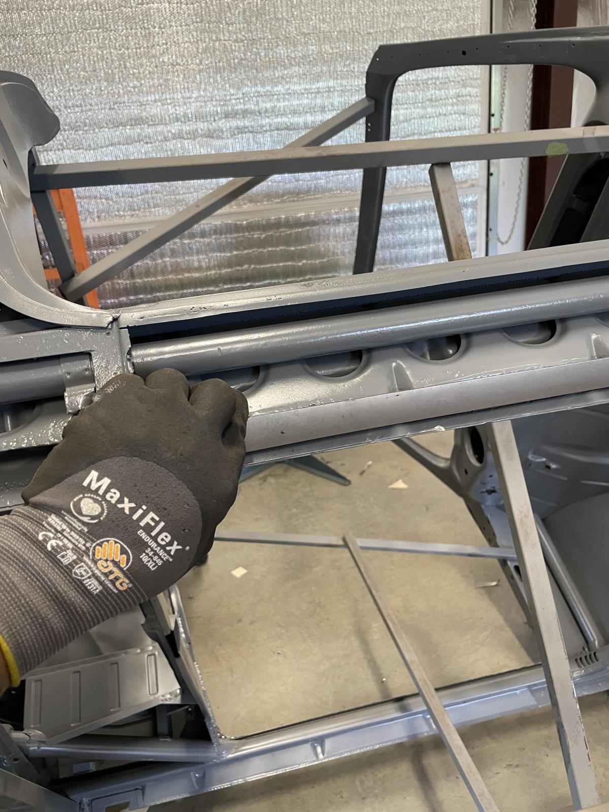

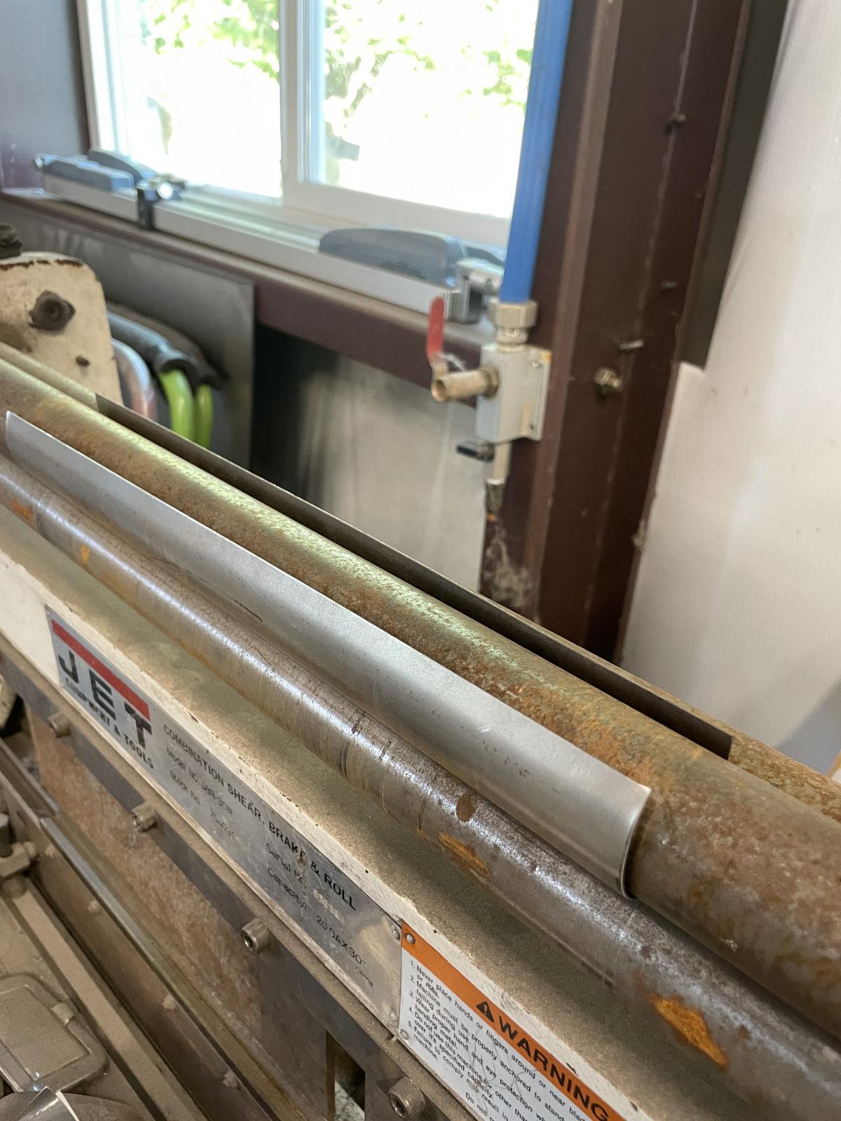

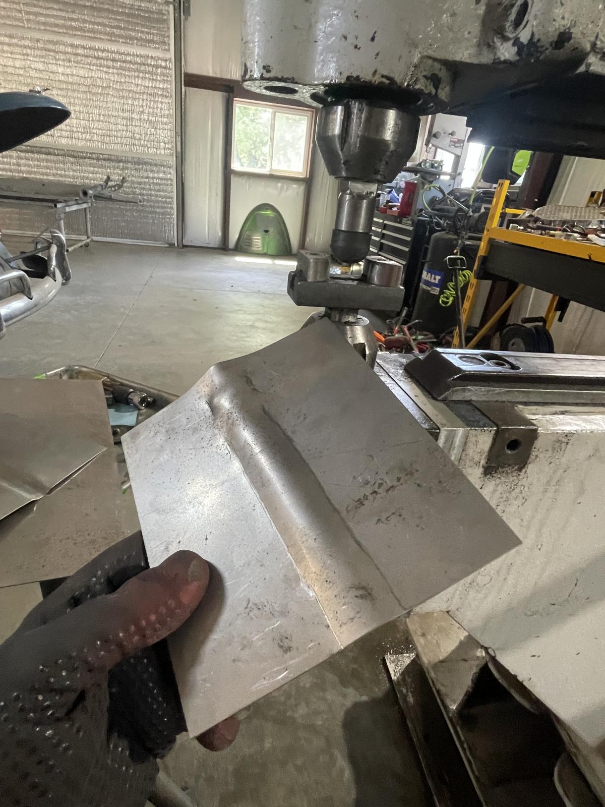

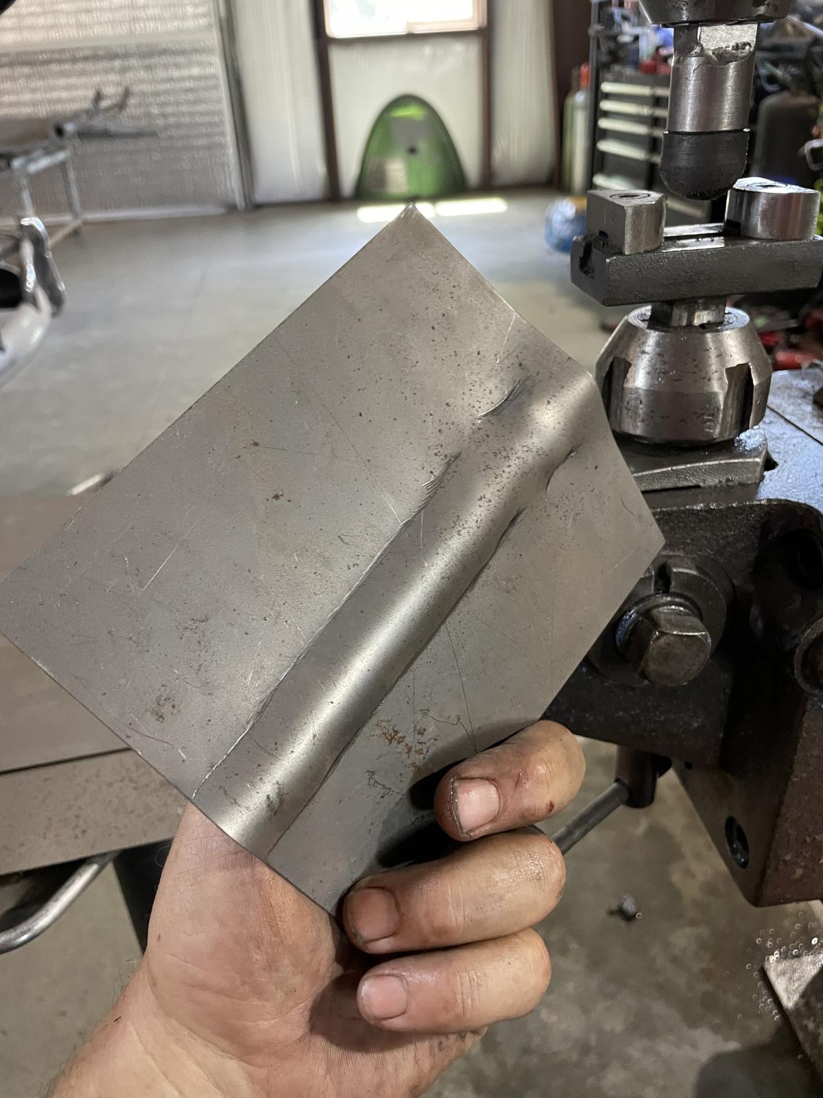

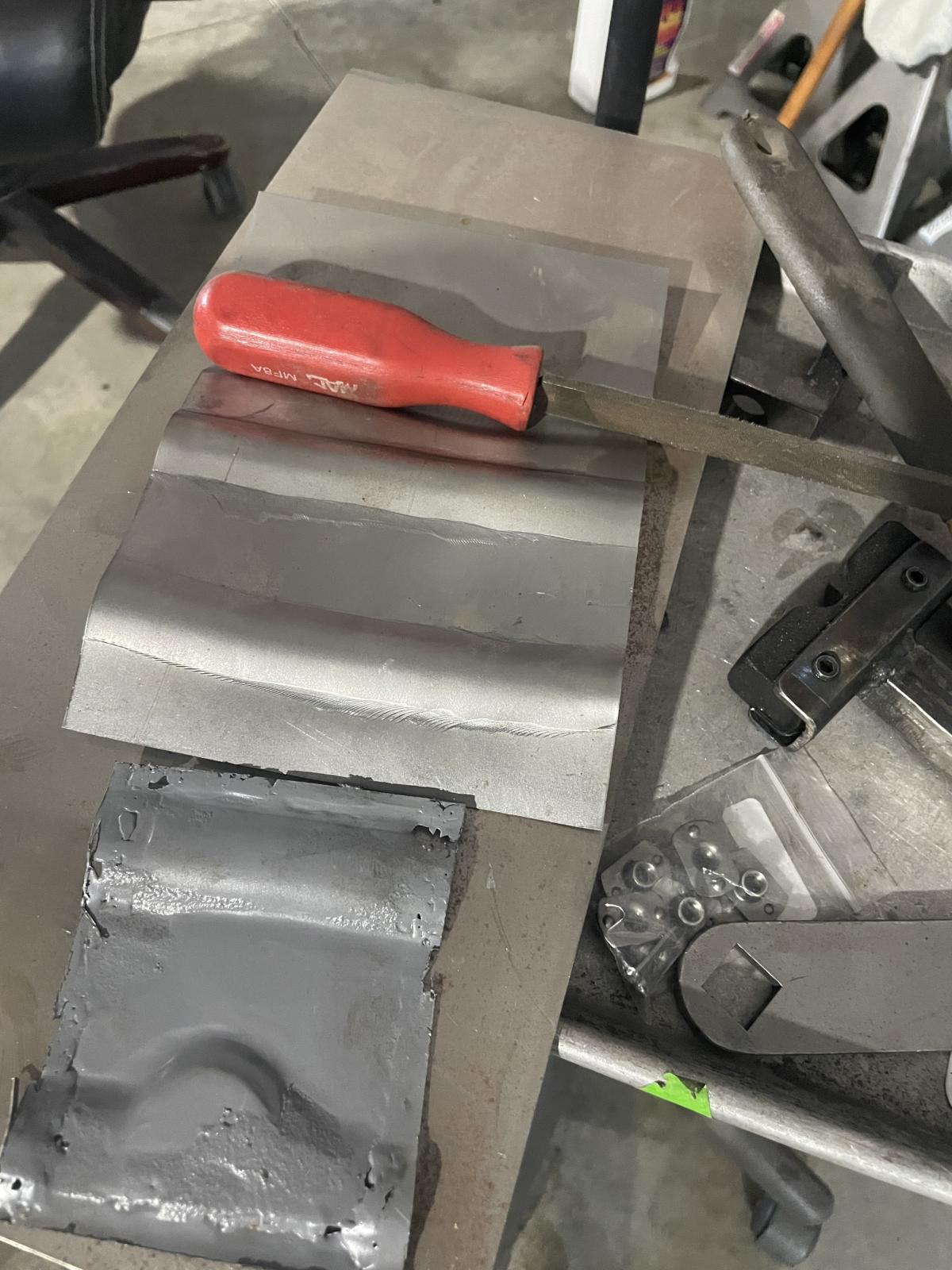

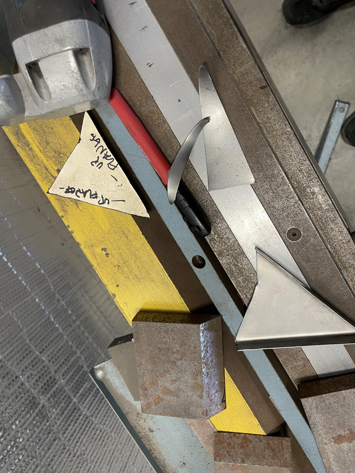

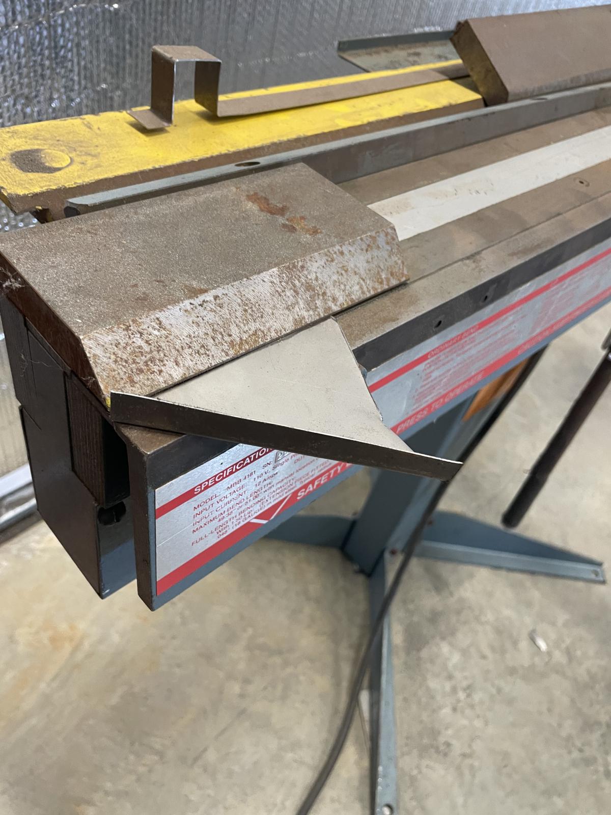

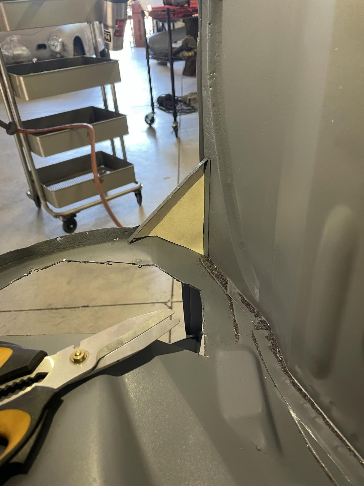

Pull Max Werk
Working out the correct profile.

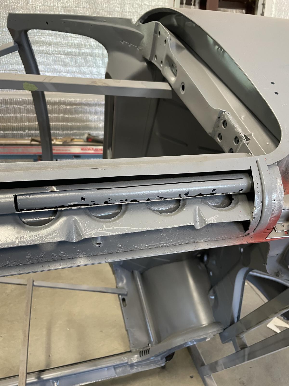

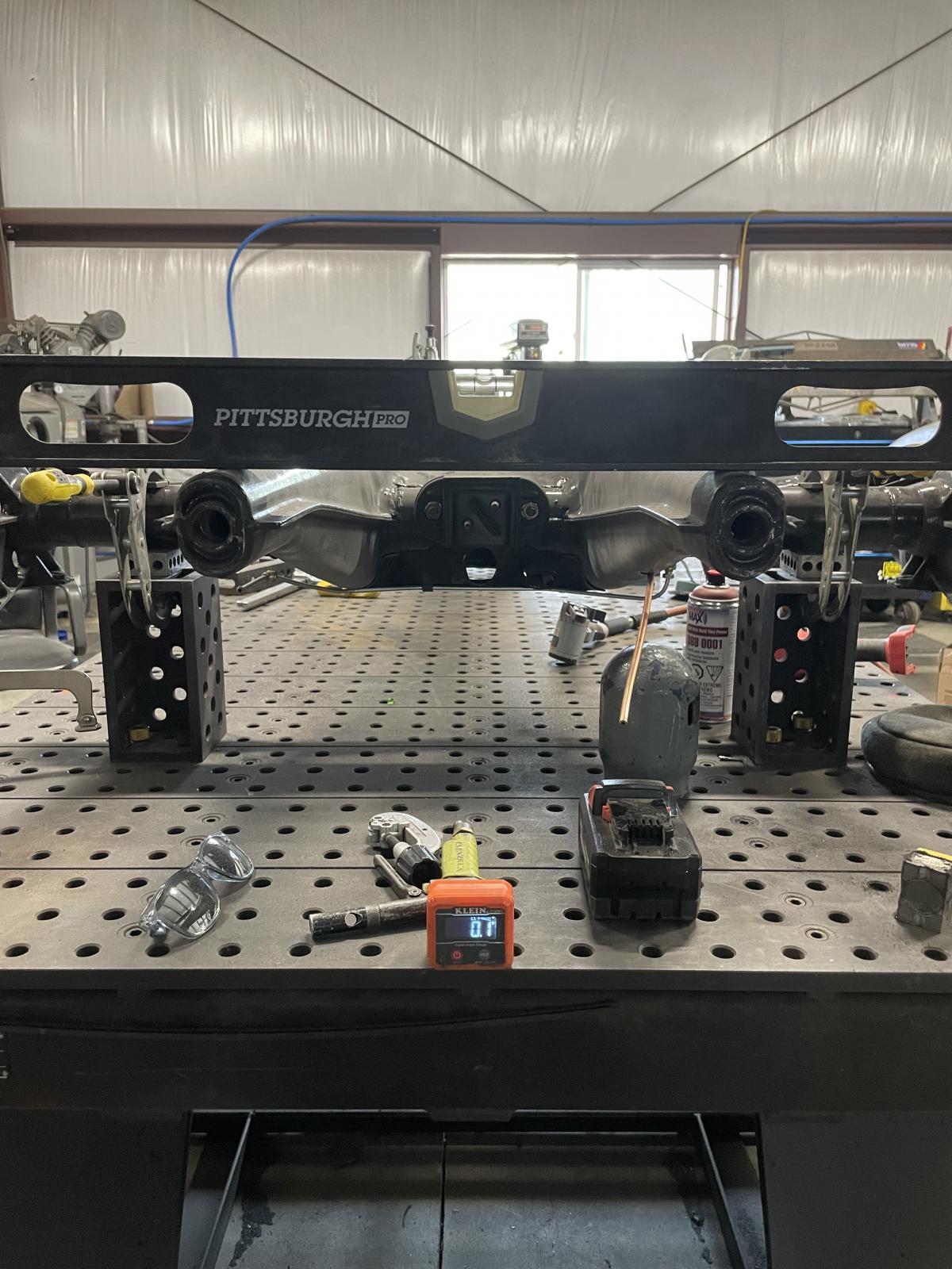

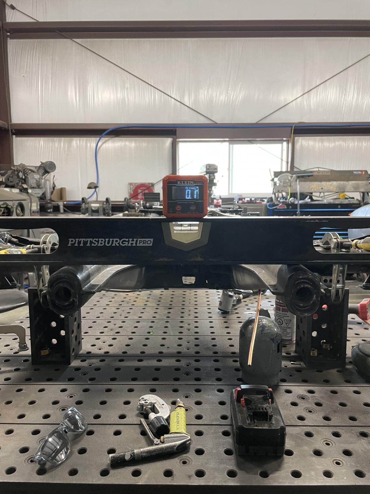

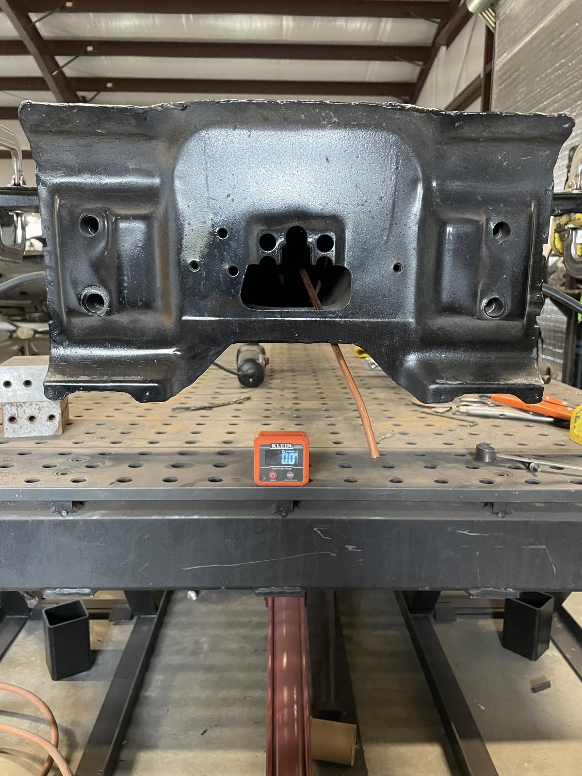

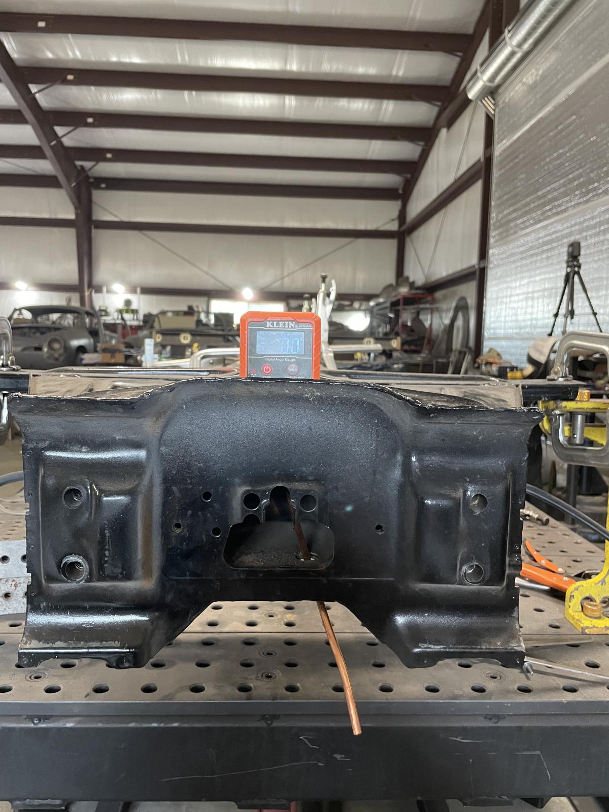

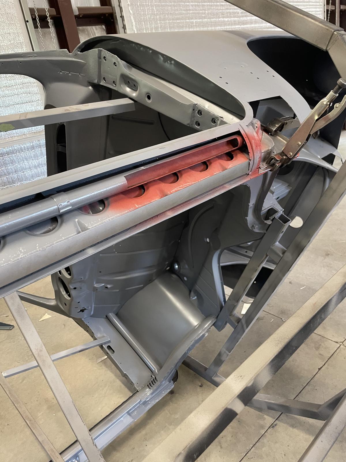

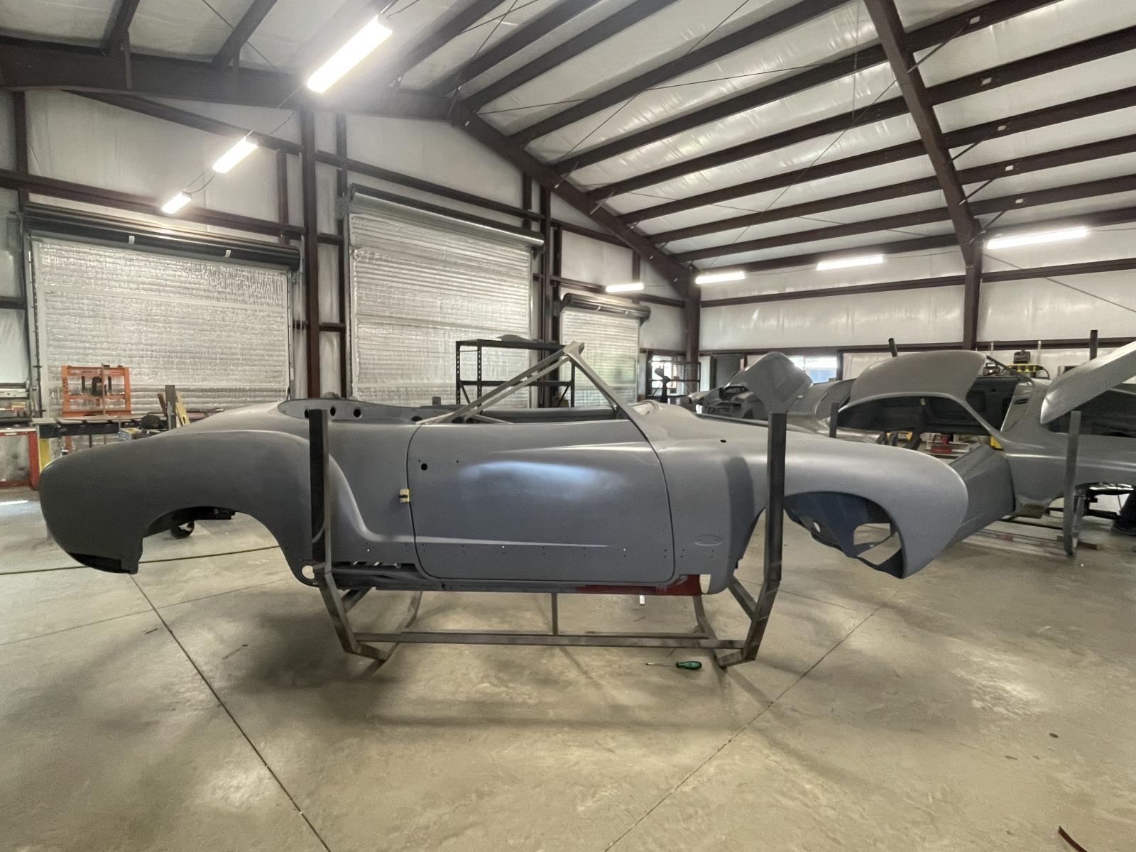

The Layout Table doesn’t lie.
Only 0.1 degree difference front to back.
It will stay pinned down like this while we weld the cap on , when we flip it over to do the pan halves we will pin it down again while welding them in.

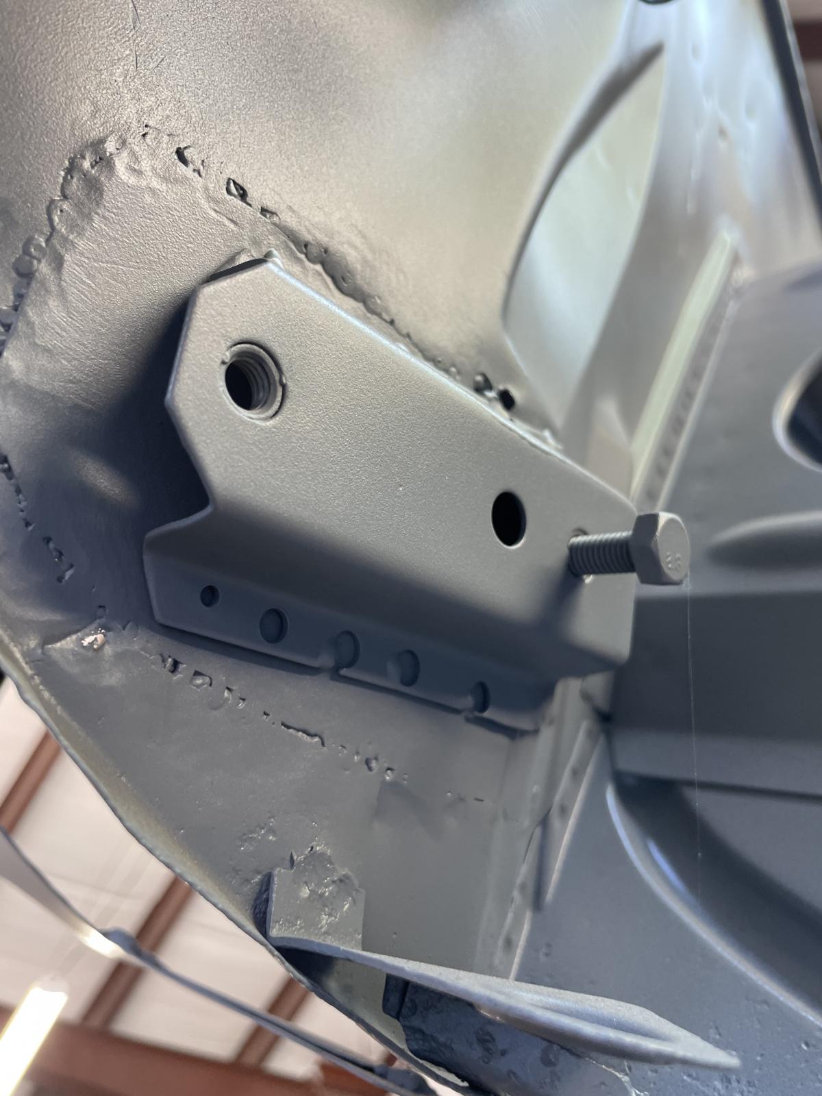

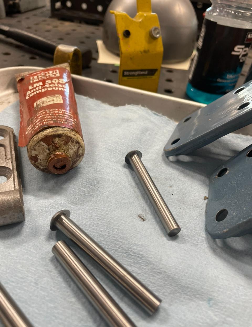

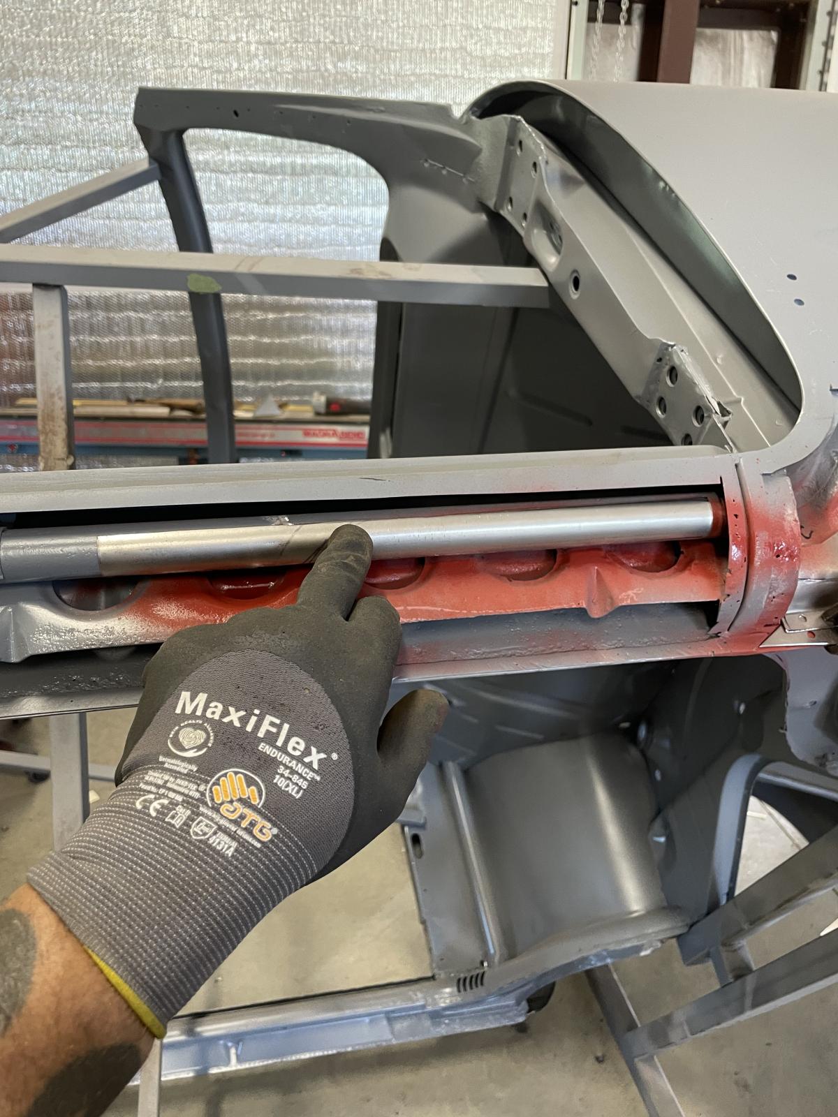

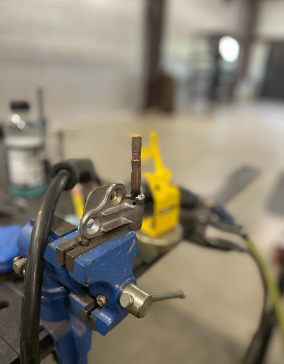

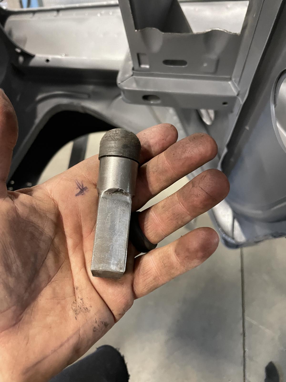

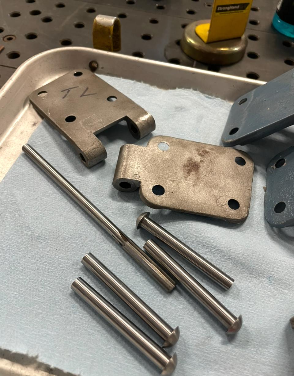

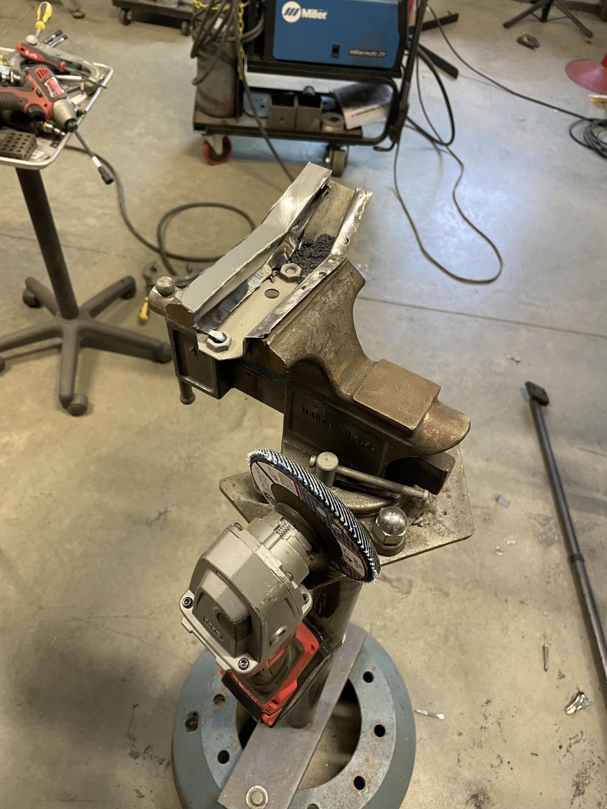

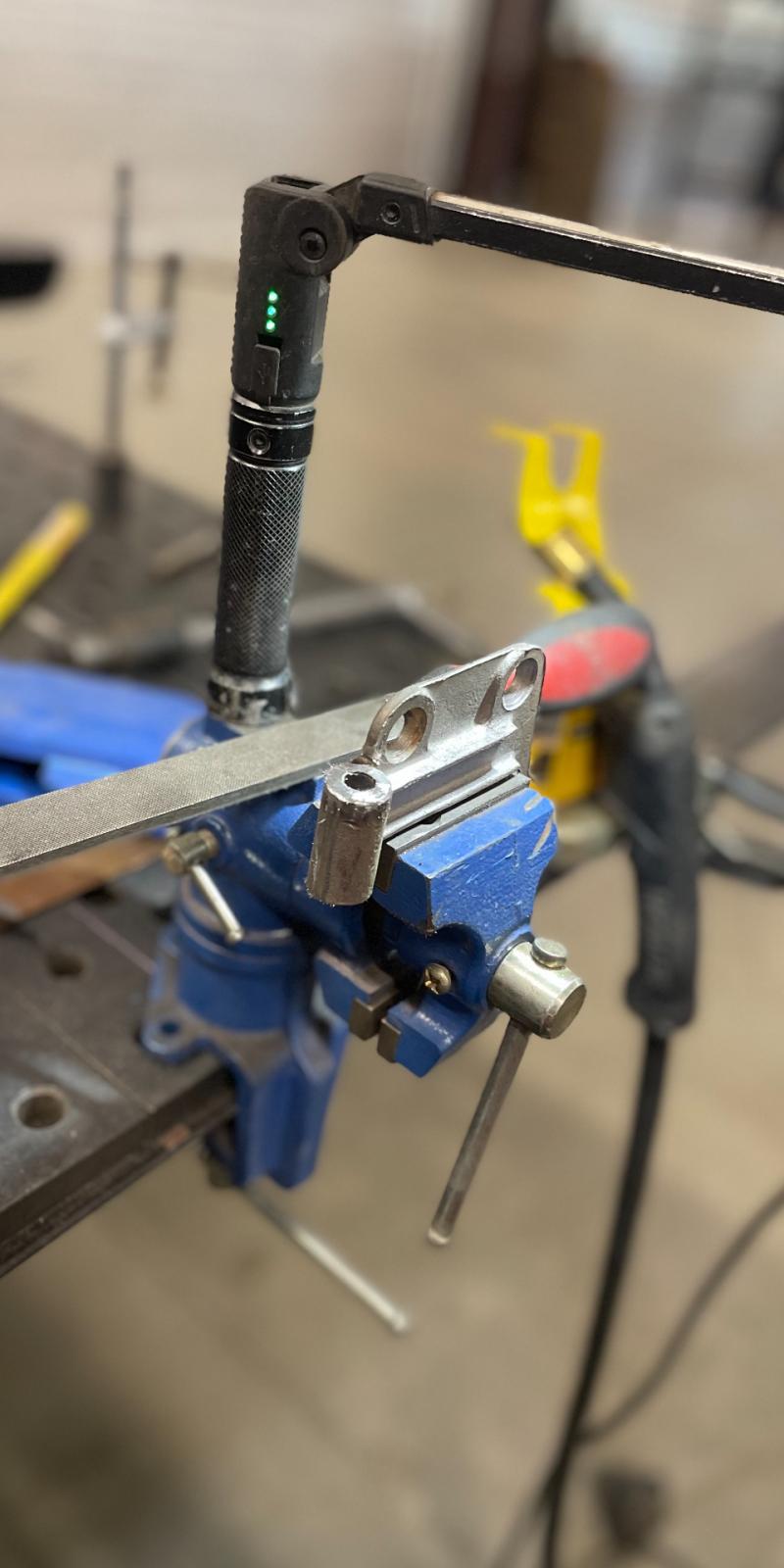

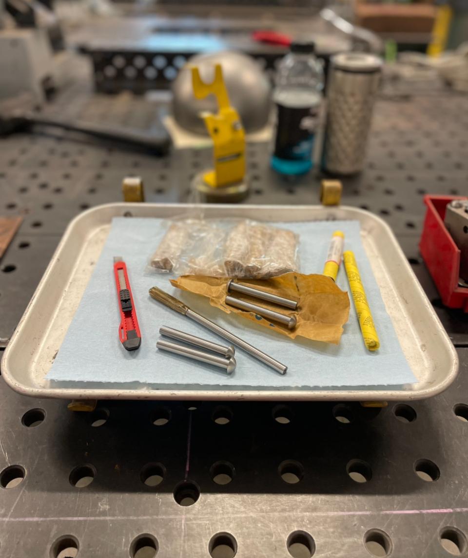

Rebuilding with Washburns pins

Building multiple Ghia’s at one time I got to stay

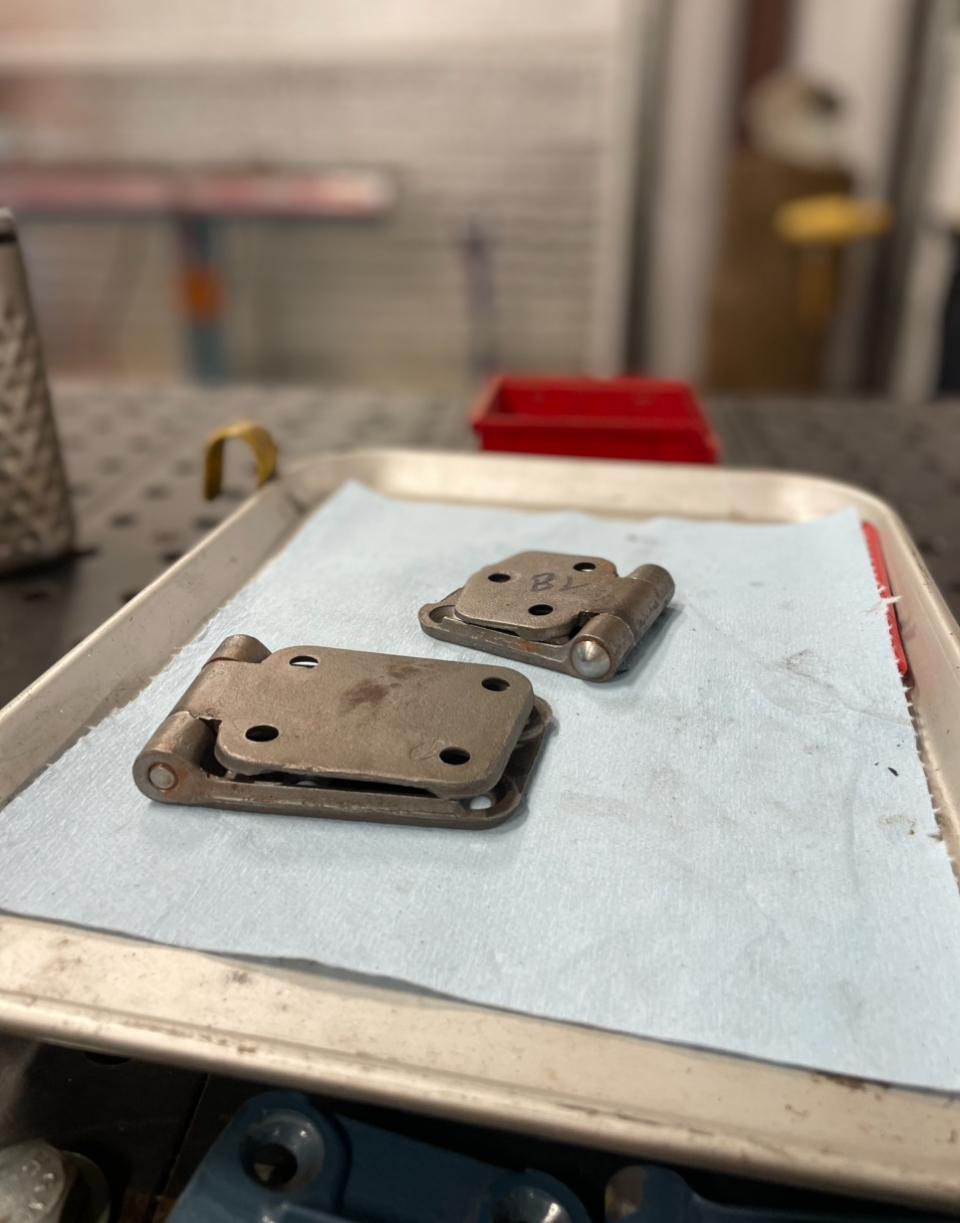

PostPosted: Wed Jun 04, 2025 7:14 am    Post subject: Re: 57 Kab Reconstruction/Restoration Reply with quote

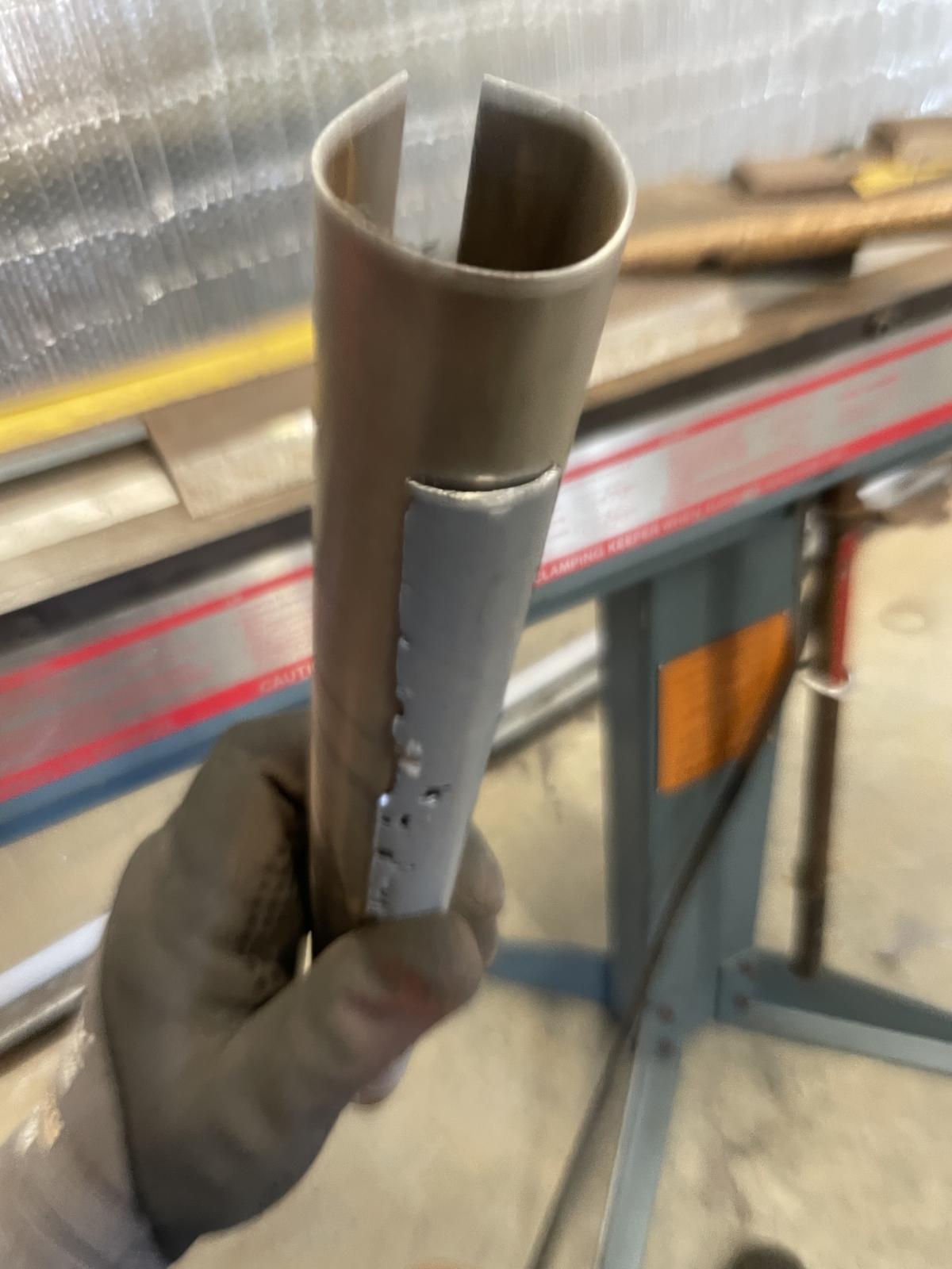

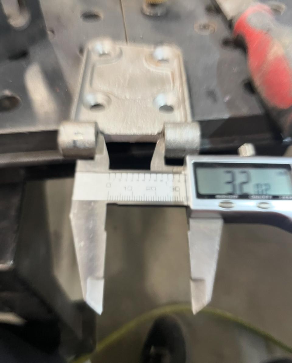

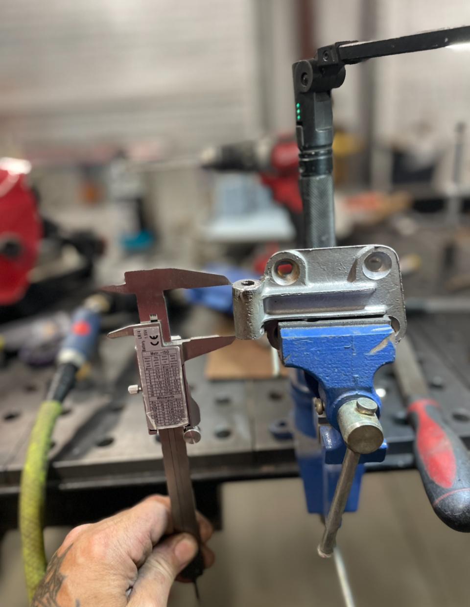

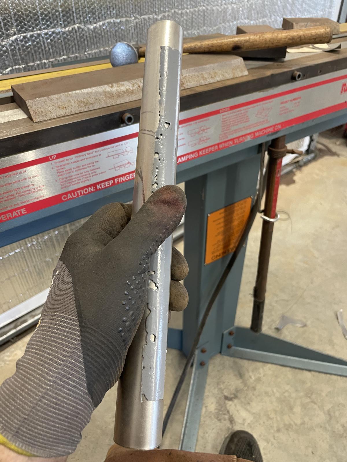

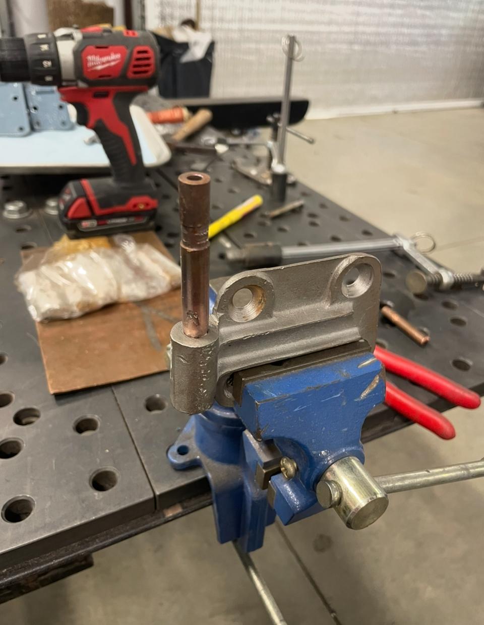

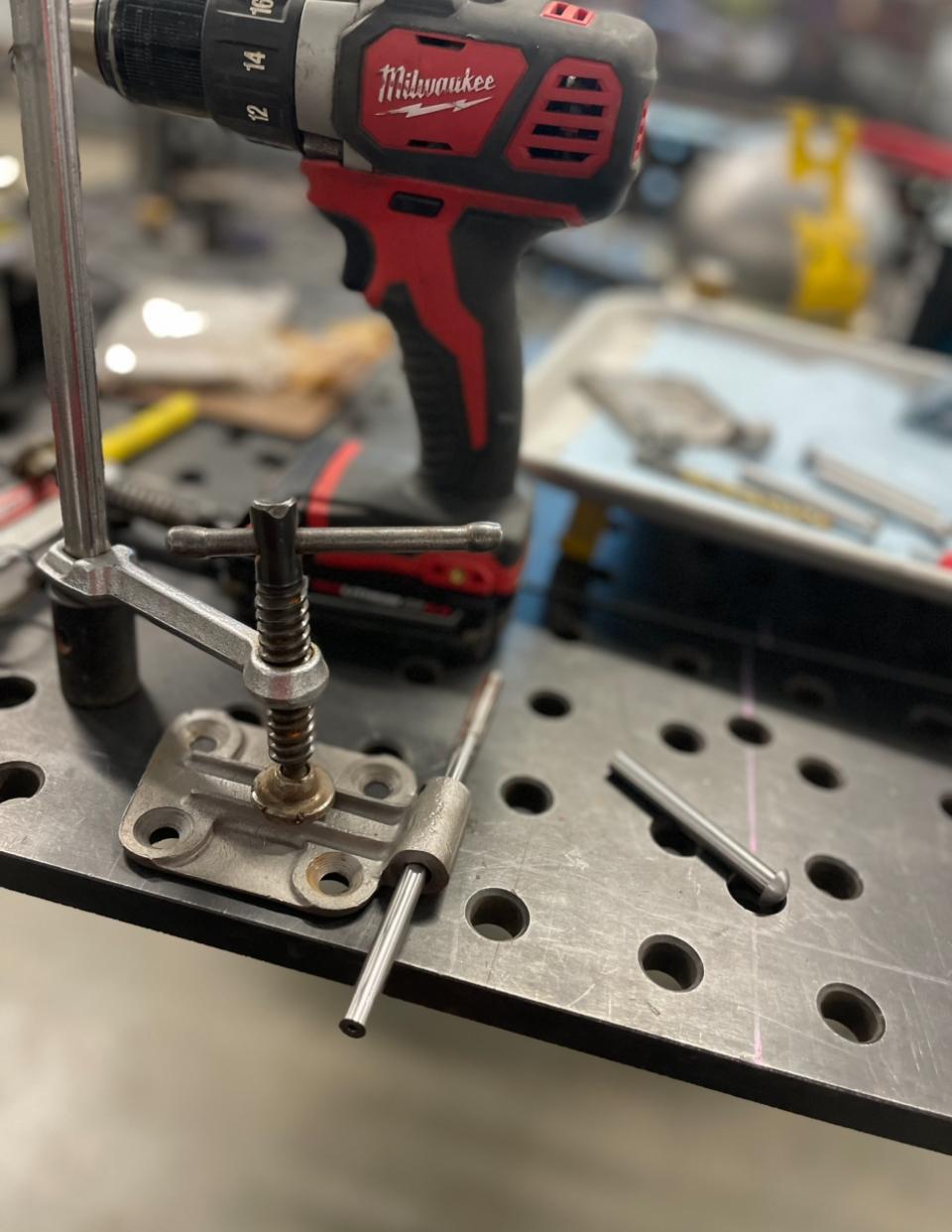

So what I discovered when I first stared rebuilding hinges whether it be bug , bus , or ghia is that 9 times out of 10 just doing the pin is not enough. The slop between the male and female counterparts almost always needs to be built back up and taken back down again to make a tight fit. I use this copper rod when welding so that the center stays nice and circular.
I do not have a mill but have found doing this by hand with the micrometer is very achievable. When it’s all said and done the two halves are very snug.

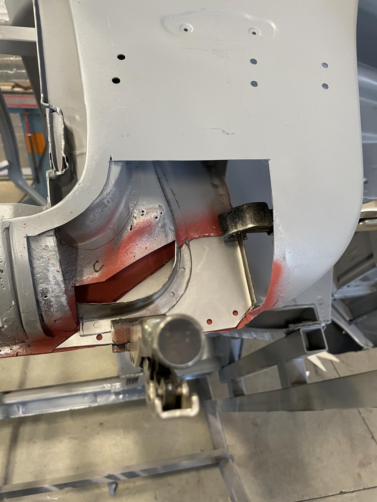

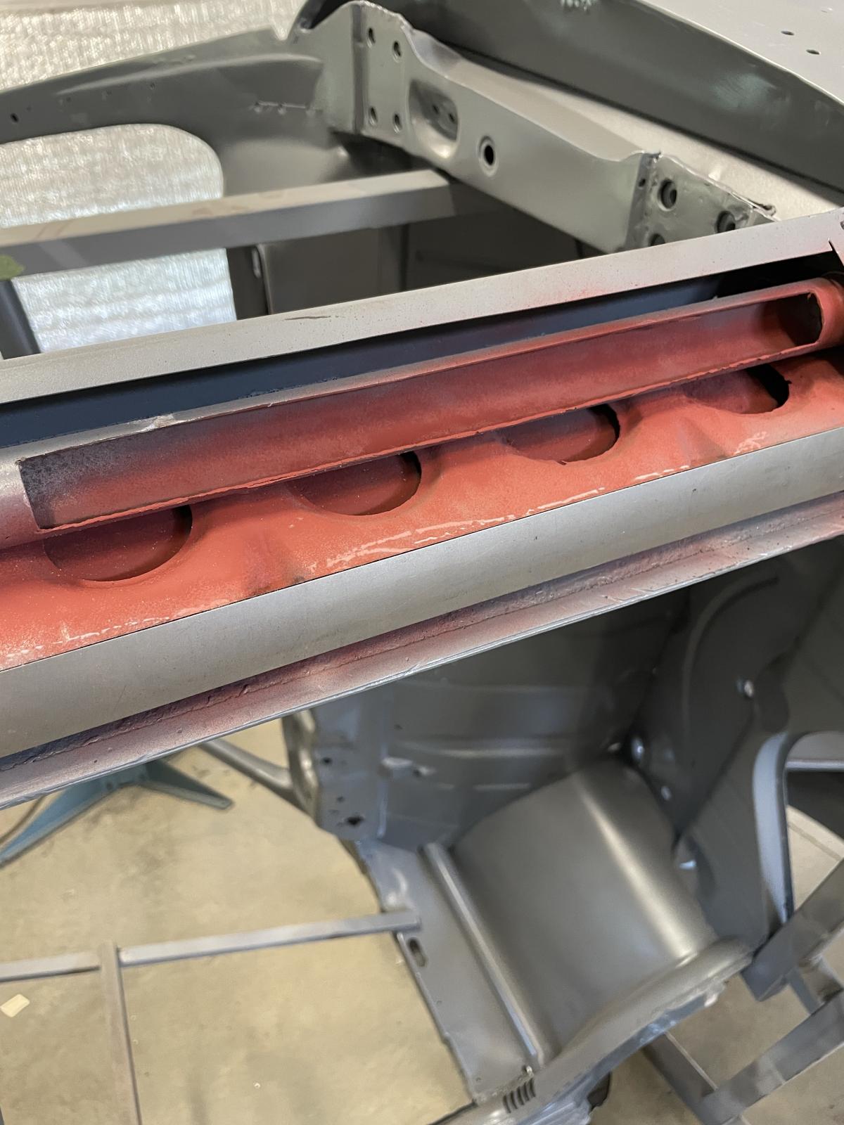

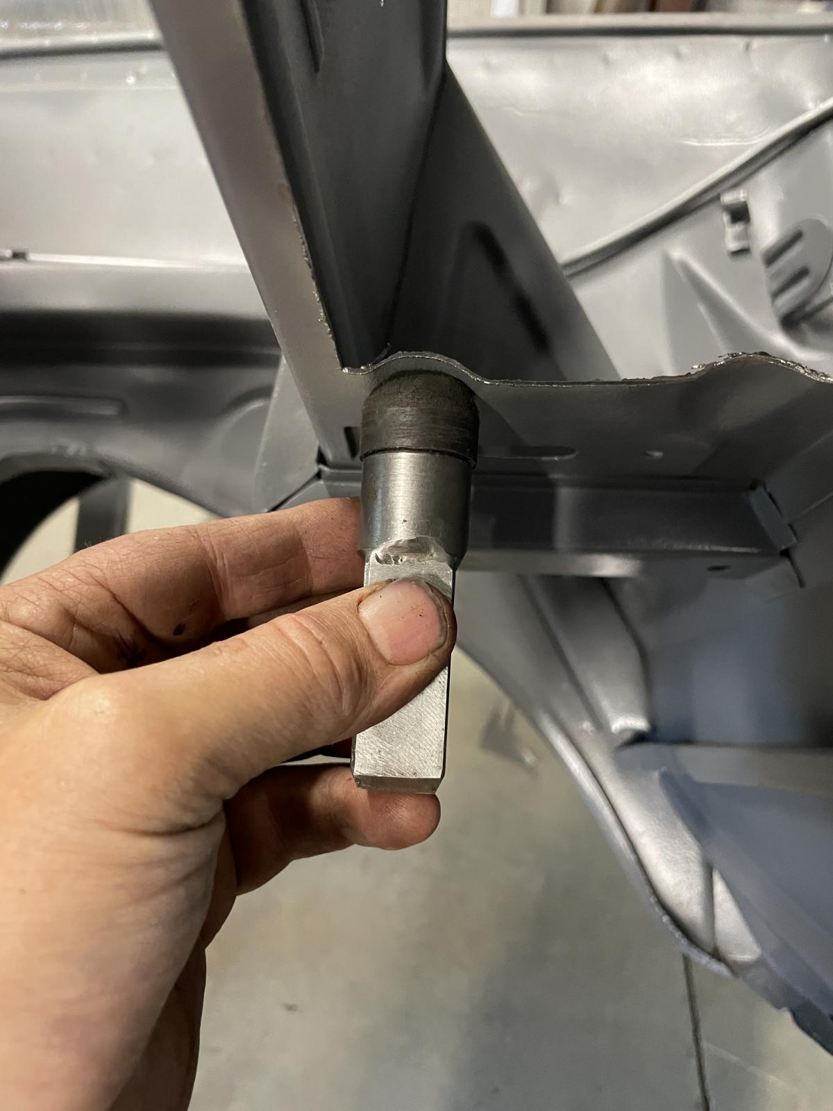

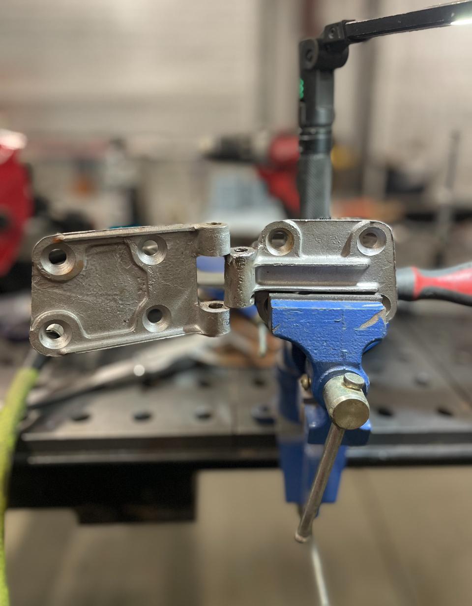

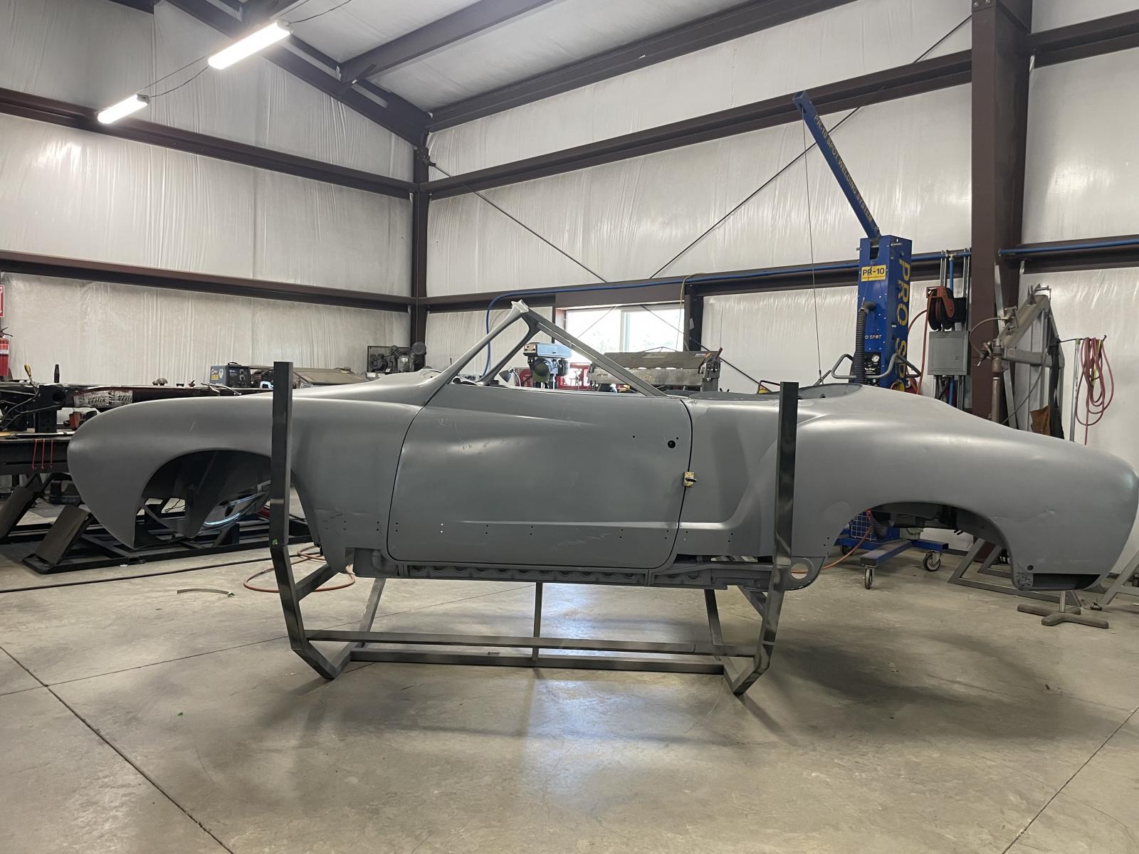

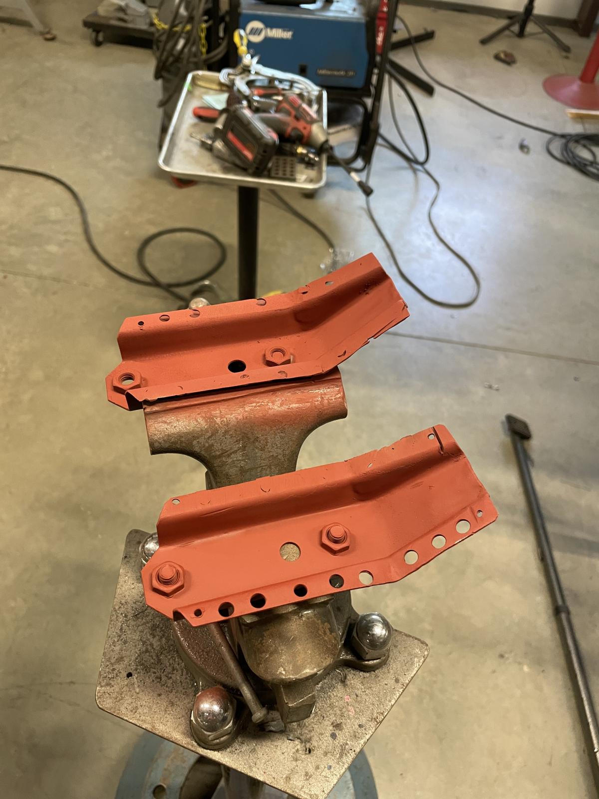

Time to hang the doors again and see how the look and fell after the hinges being sorted out.
We will also be leaving them on as we install the adjacent panels so we can make the appropriate gaps as we go.
They look and feel great so we are off to a good start.
