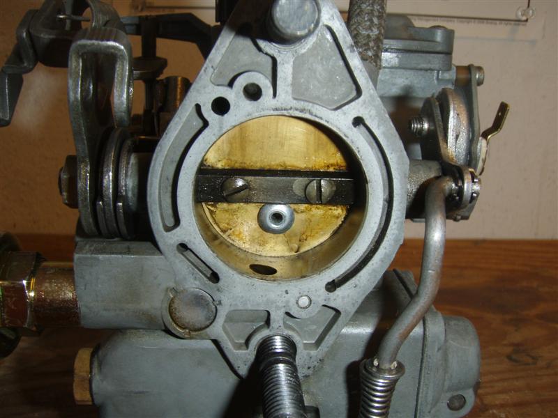

PostPosted: Sun May 04, 2025 4:38 am    Post subject: Re: exhausted all adjustments to get car to run right Reply with quote
The issue is the size of the hole in the throttle plate. All other things dialed in you would be left with a slight hesitation which is where you are at, so nice work. Not being a carburetor guy I don’t recall wether you just need to enlarge the hole or wether it’s already too big.

PostPosted: Sun May 04, 2025 4:35 pm    Post subject: Re: exhausted all adjustments to get car to run right Reply with quote
tasb wrote:
The issue is the size of the hole in the throttle plate. Not being a carburetor guy I don’t recall whether you just need to enlarge the hole or whether it’s already too big.
A DVDA distributor needs a 5/32" hole in the carb's throttle plate, and a SVDA needs a 1/8" hole.
A common 'quick-fix' for the hesitation when running an SVDA distributor with a carb intended for a DVDA is to reduce the hole size by inserting a pop-rivet and punching out the center mandrel.

PostPosted: Sun May 04, 2025 5:42 pm    Post subject: Re: exhausted all adjustments to get car to run right Reply with quote
I did see that 'fix' - it turns out that my new EMPI was flawed. The choke plate was not machined properly and was jamming in the throat of the carb, it wasn't moving...I am returning and will spend the money and find the correct carb for the car/distributor...thanks for all the input. C
