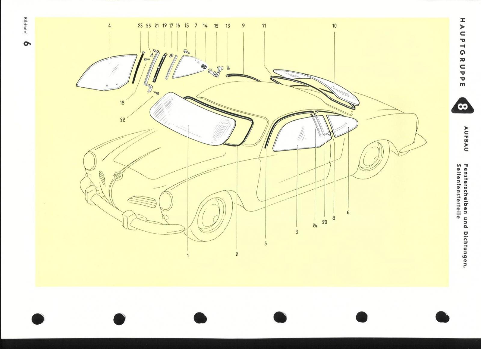

Hello experts. I was asked by a Lowlight Coupe driver from Austria whether a door window from 1960 can also be installed in a Lowlight. In my opinion, the contour and the mounting are different. The disks after the lowlight have two holes at the bottom, right? And the lowlight panes don't. I don't think they are so easily interchangeable. Now I don't have a lowlight disk to compare the contour with a later disk. Who of you has a lowlight windshield from the Coupe and a later version and could compare the contours? Or do you have any experience of this? Greetings, Udo

They are different indeed. Lowlights use windows like position 3 in the diagram and later use position 4 (that apply to Coupes and Cabrios). Further - later door windows also varies in size (not shape) through the years, but in general the later the window, the smaller the size - I'm talking 3-5 millimeters.

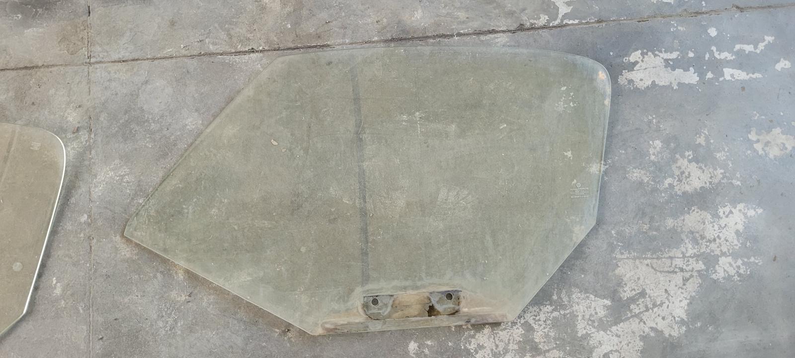

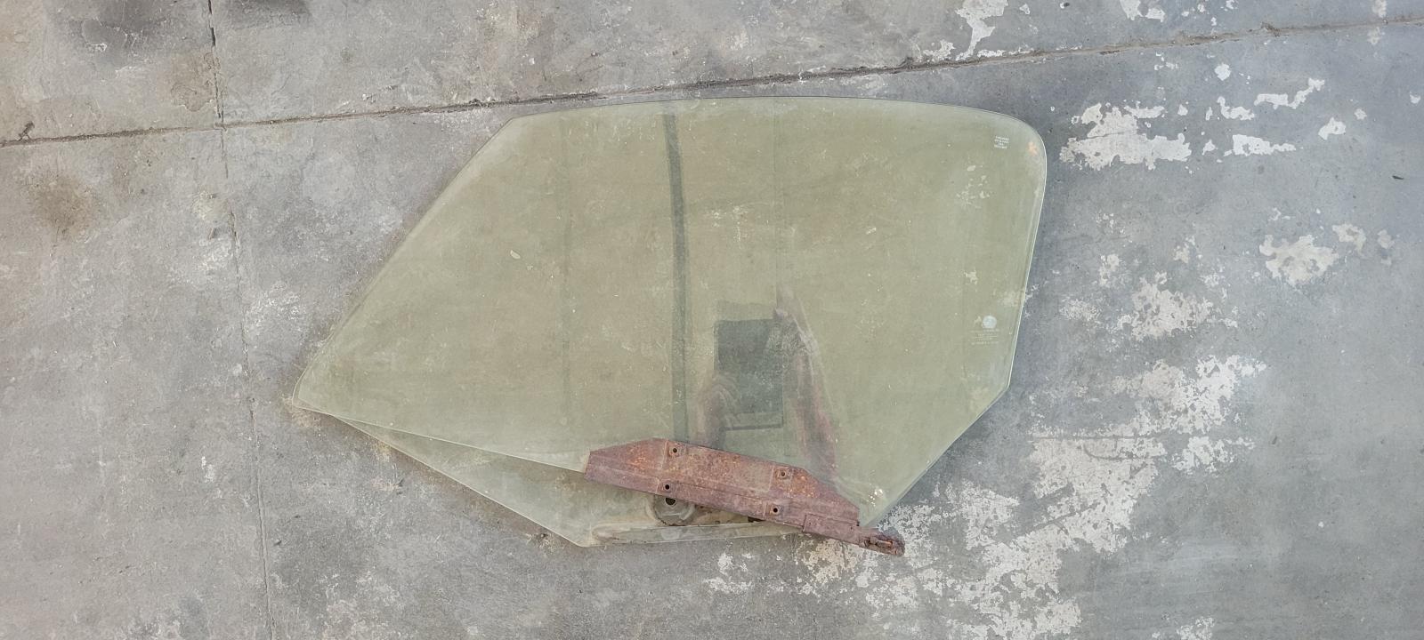

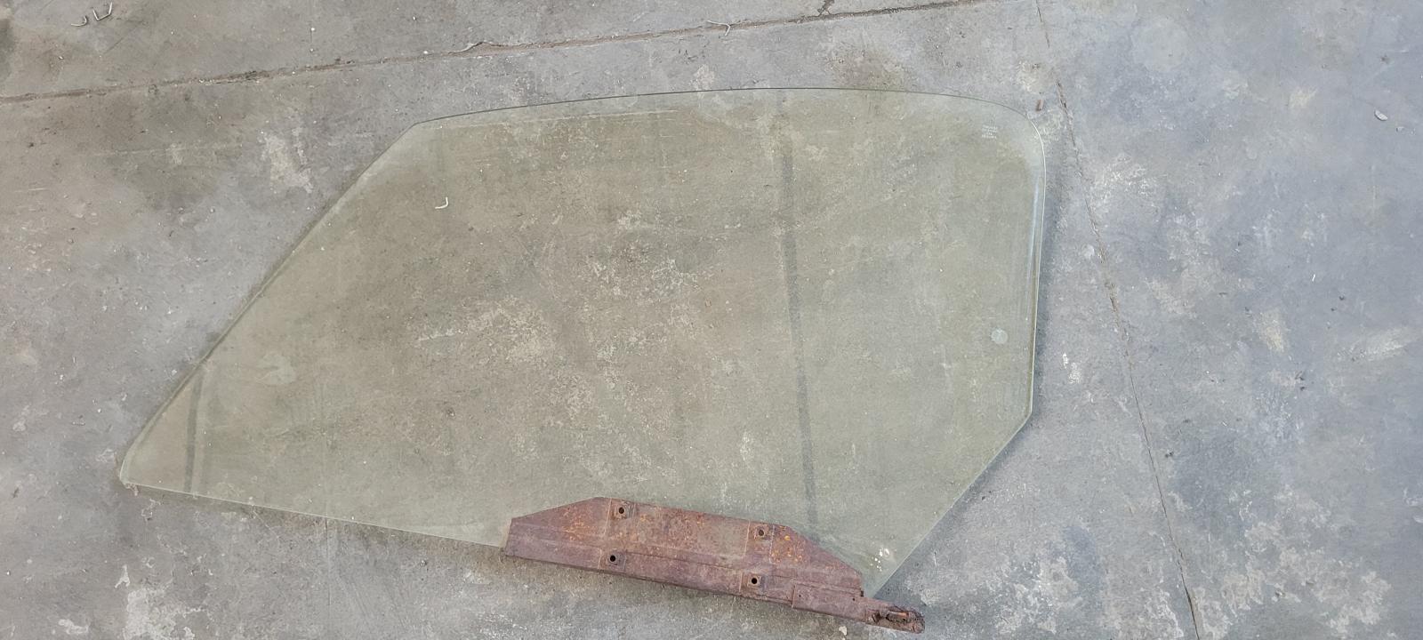

As promised.
These are Cabrio glass but Coupe's glass function the same way.
And one photo to see the differences in a easy way:
I must say that in this case the Lowlight glass is 99% the same contour except a tiny portion in the front (the longest part of the glass). No holes in the Lowlight glass. The metal part is "crimped" on the glass.
As I previously mentioned - the later the glass, the smaller the size. And that is a good thing esspecialy if you restoring a Cabrio, because on a Cabrio you can easy "fill" the bigger "hole" for the door glass in a factory way, with some rubber bands under the seals. I can't imagine if you need to do it the opposite way.
Nick

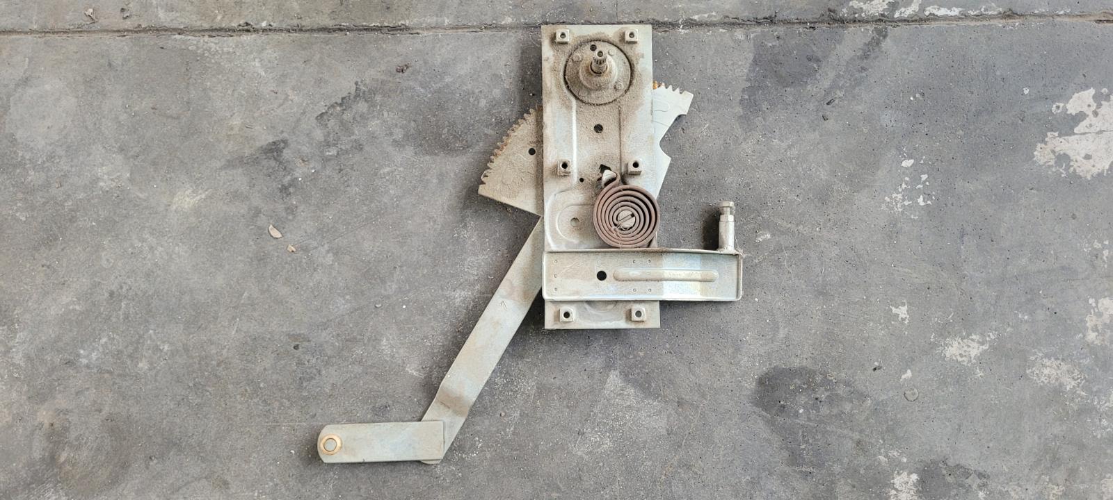

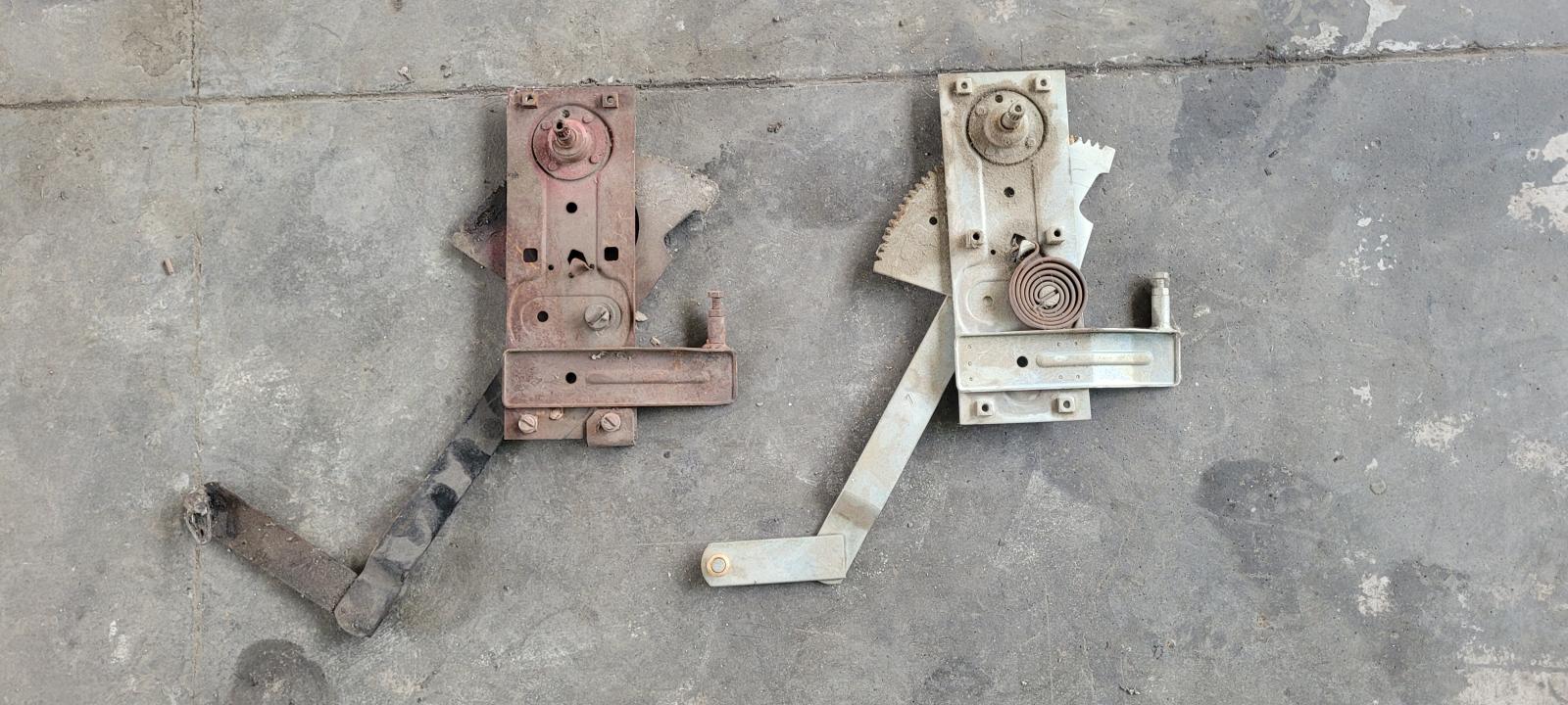

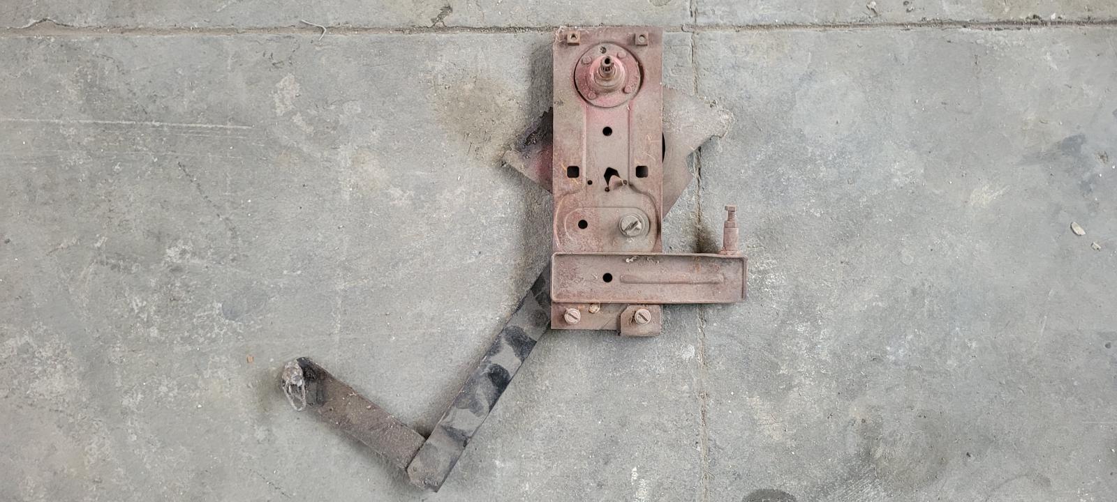

Lowlight vs. later door glass lifter mech
Lowlight:
Later one:
One can easy convert later mech to Lowlight spec. The one in photos above is such "converted" mechanism. We wanted to use the original glass and we had one rusty Lowlight mech. After some meauserments we found out that we can convert later mechs and we done that. Later decided against Lowlight original glass because was way to scratched and not usable in the restoration that we performed.
