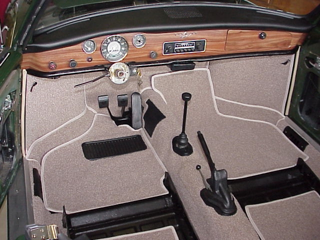

Here's a pic, 1969 KG convertible, underdash levers, cables
properly hidden behind kick panel carpeting:

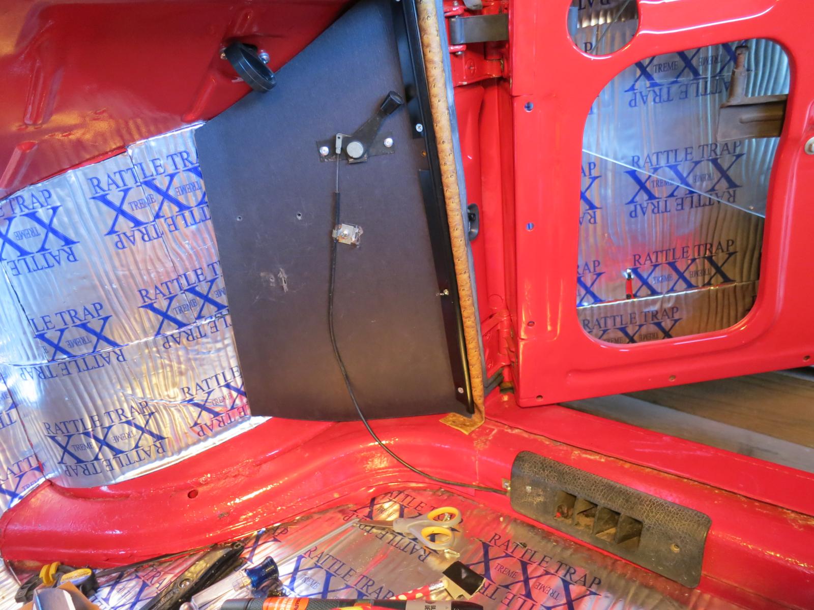

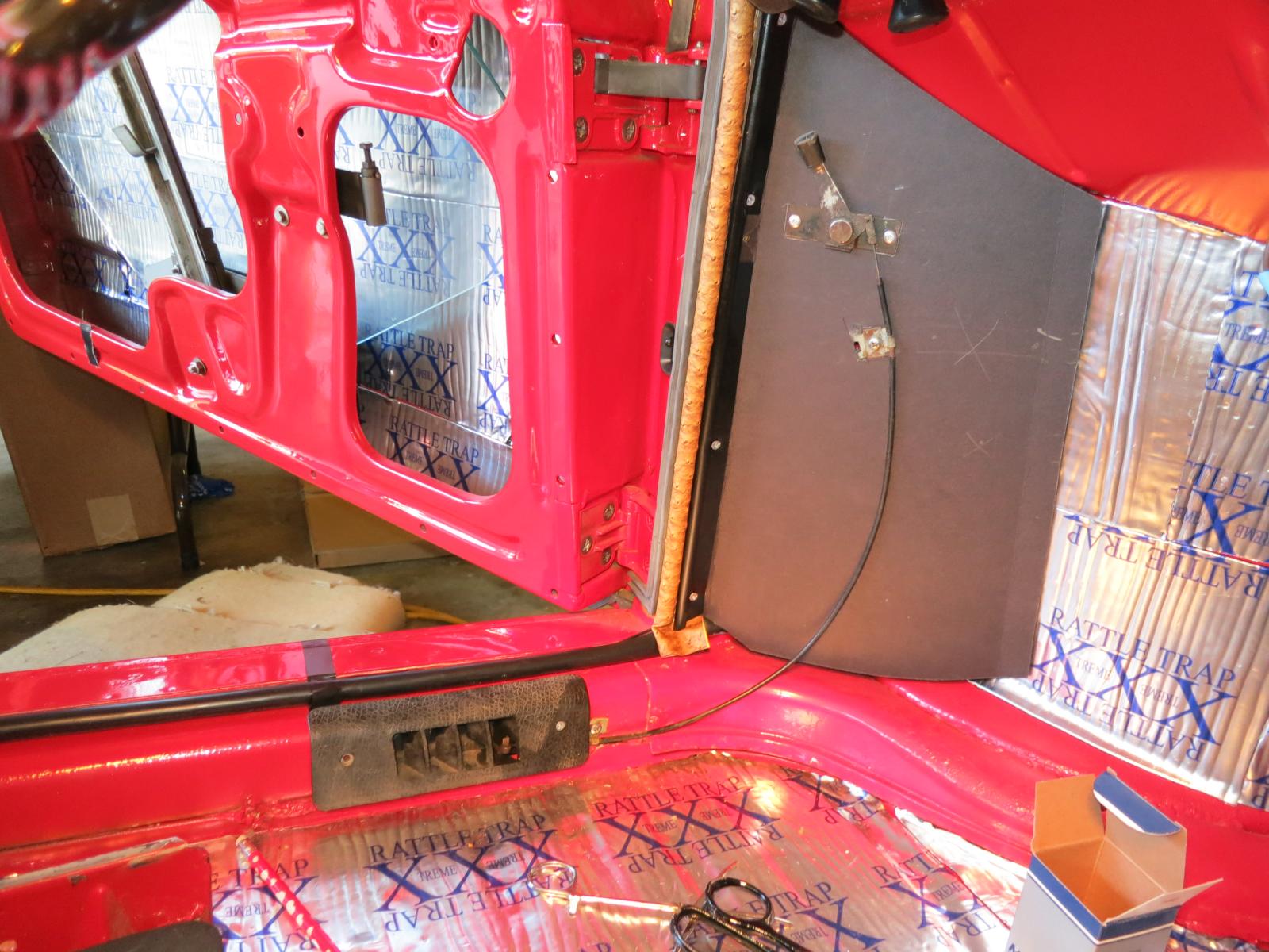

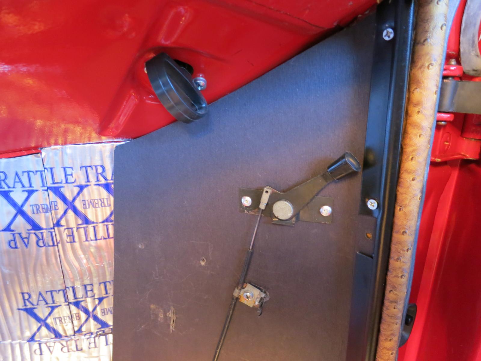

I had a hard time figuring where the cables/levers routed, so thought I would share. Neither end of the cable is adjustable, so you need to "dry fit" it before it's hidden behind carpet.
