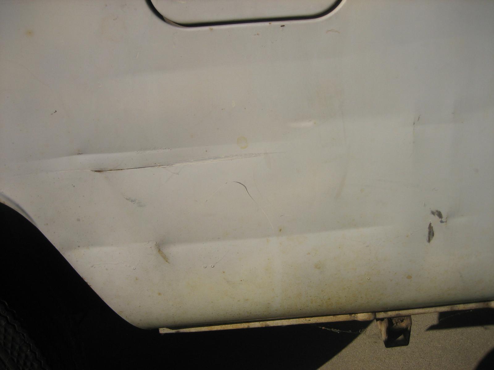

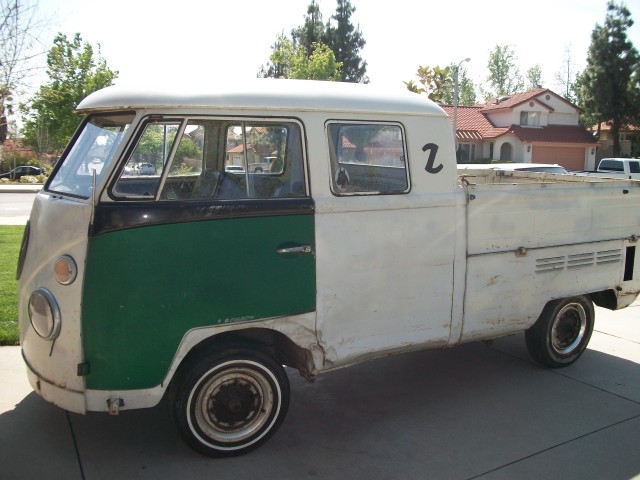

Im not really sure if the tenant stole the busses or they were stolen while he was there or what. the owner did not live at the property.

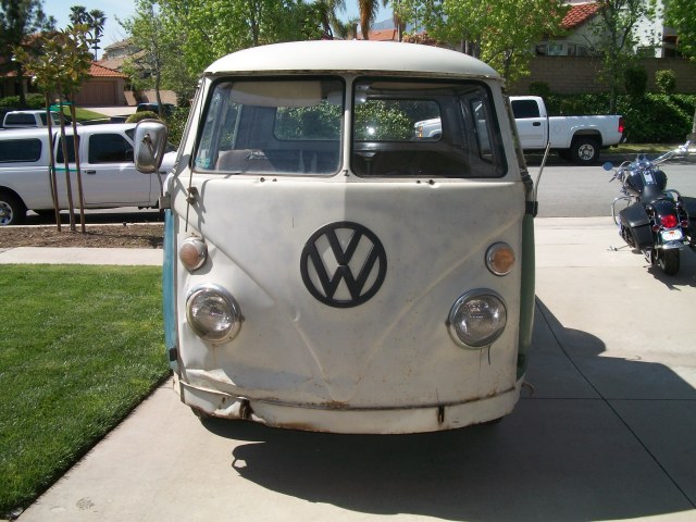

The 2nd day I owned the bus i went on down to AAA to handle the calif registration, it had not been registered in decades. This ended up working out really well. As I was at the counter the clerk was calculating my fees. He asked about value...I told him I bought it from a lady who happened to work at this AAA office. He went and got her, she gave me a big hug and told the clerk she gave me the bus, no sales tax. Smile Least expensive car i had registered in a long time.

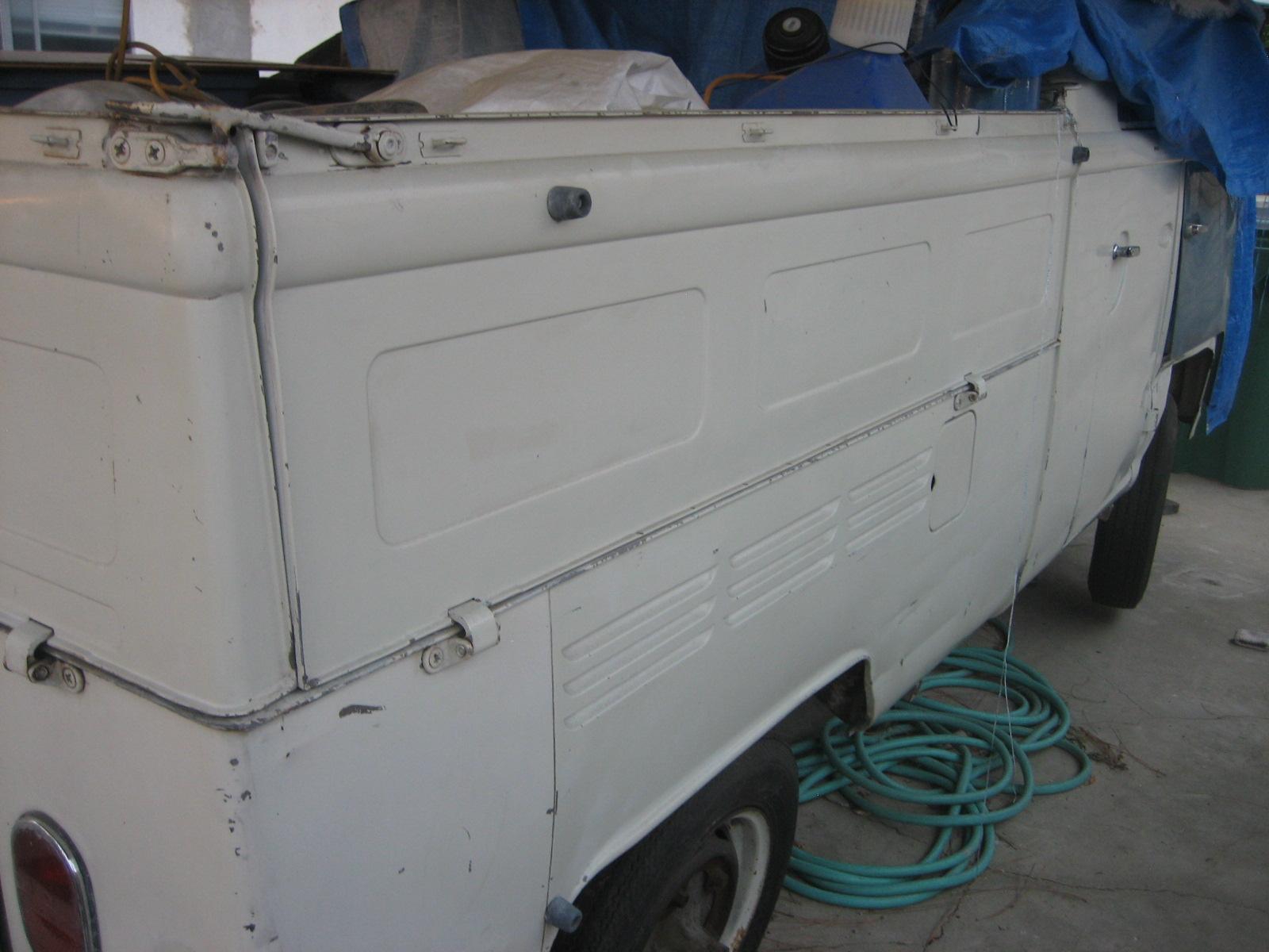

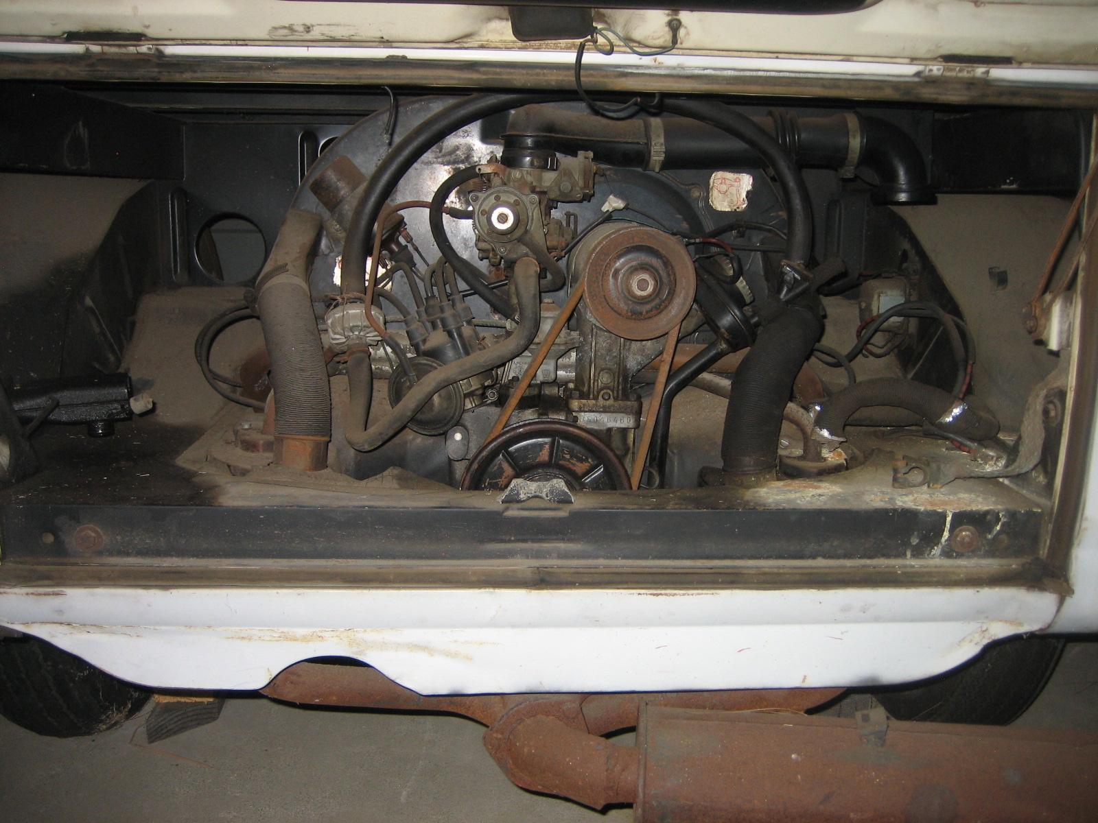

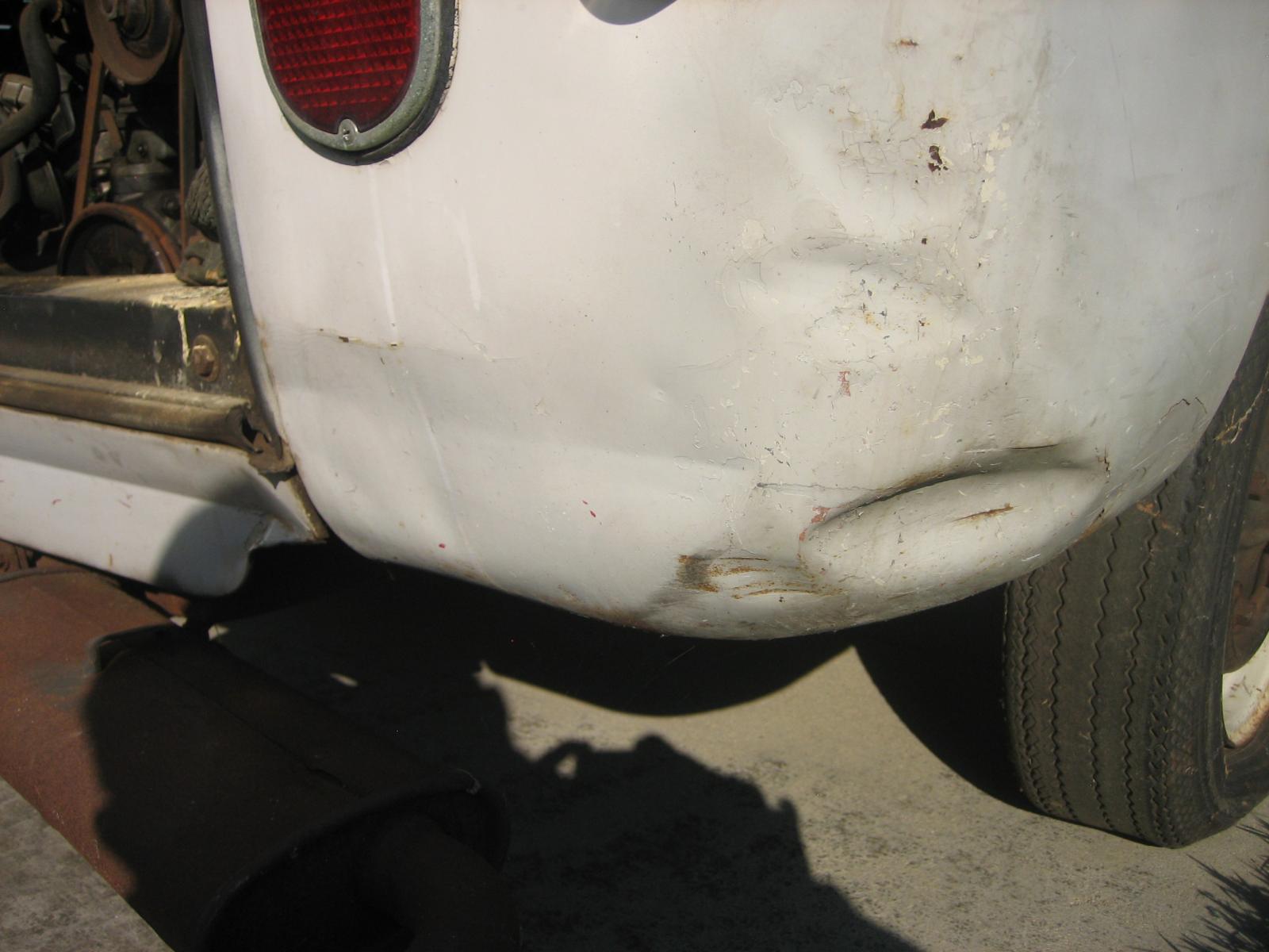

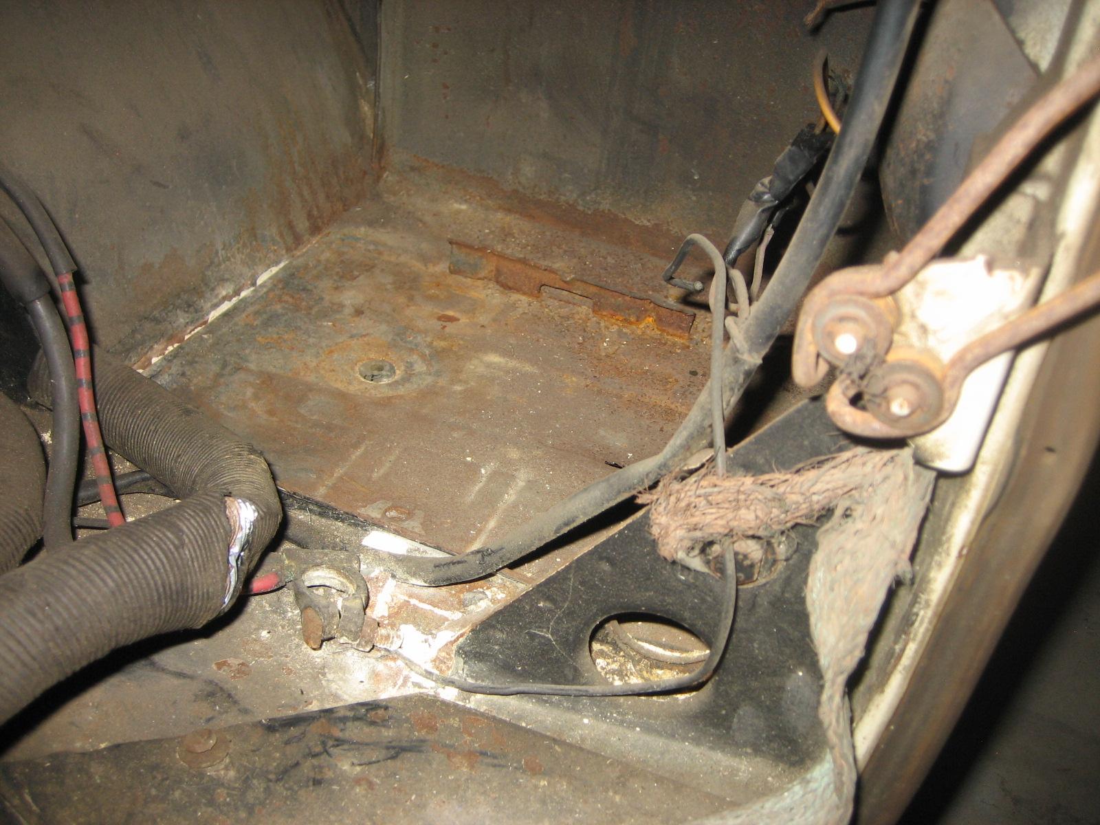

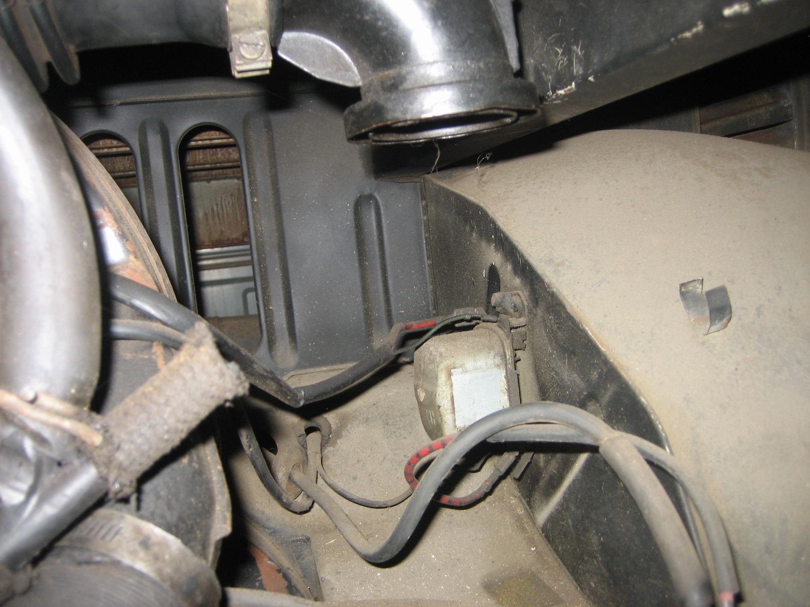

So trying to bring this up to 2018...but it will be slow. More pics of "as purchased".
The whole engine bay had been painted black, and the did a very good job, damn them.

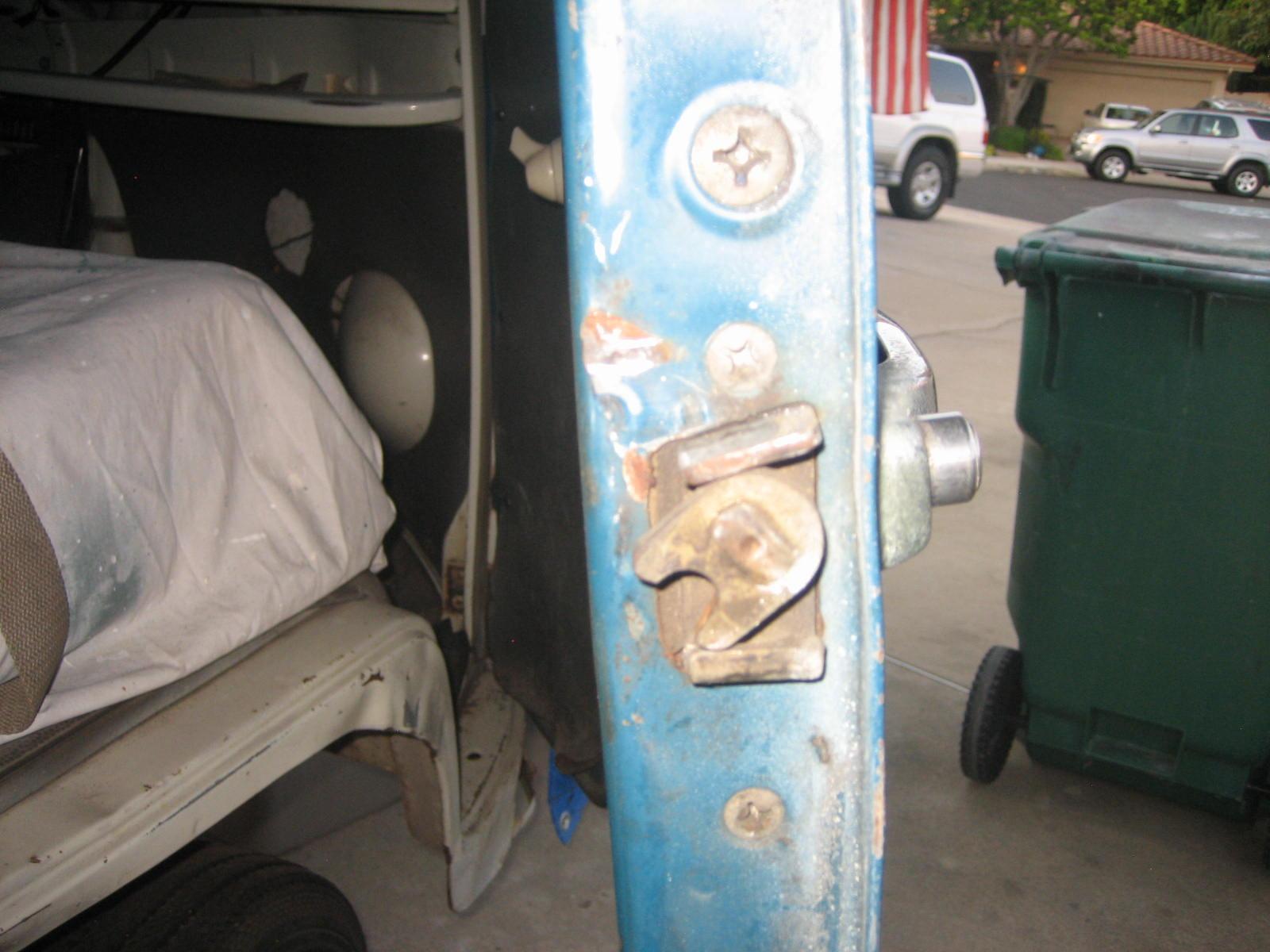

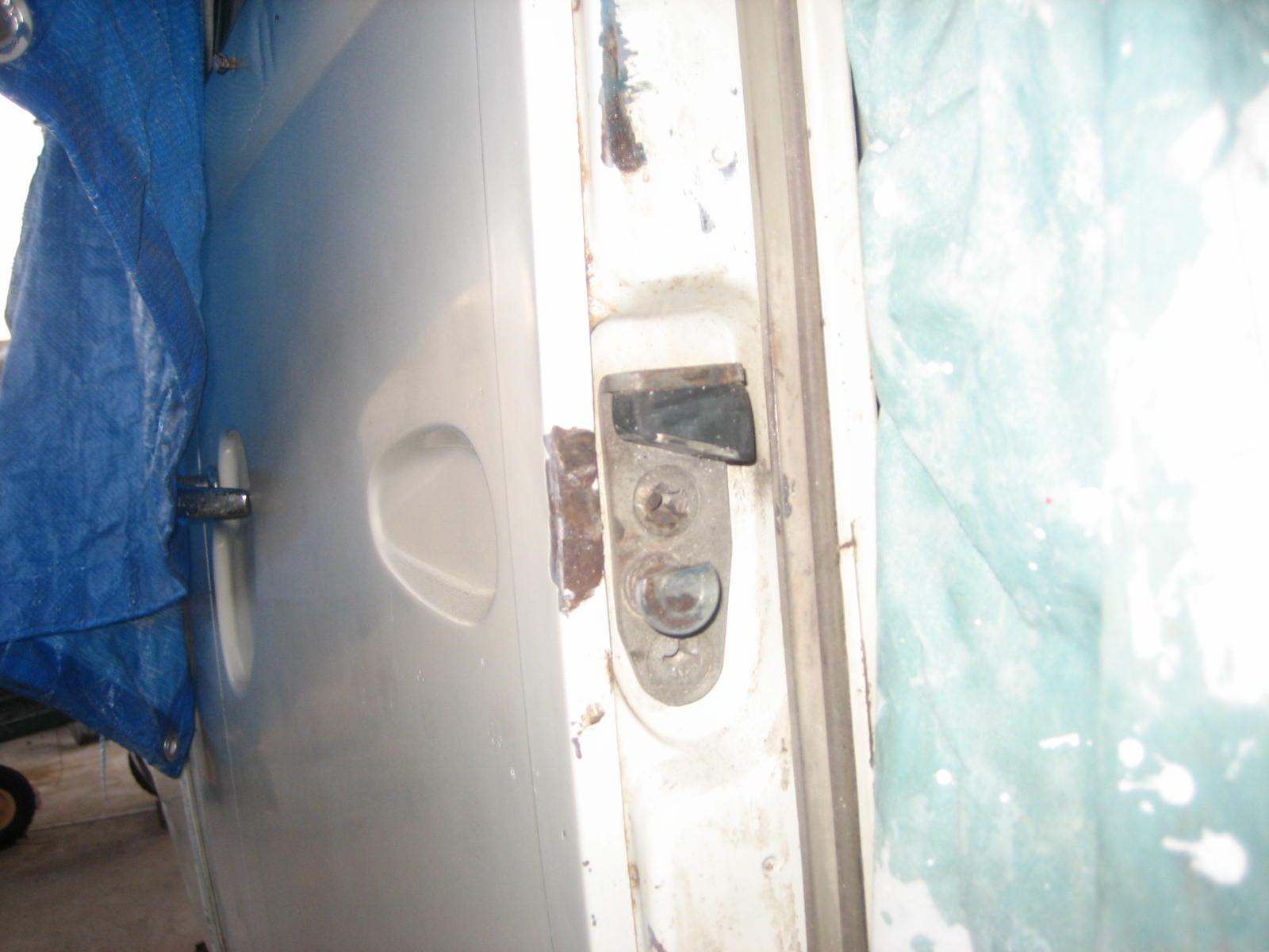

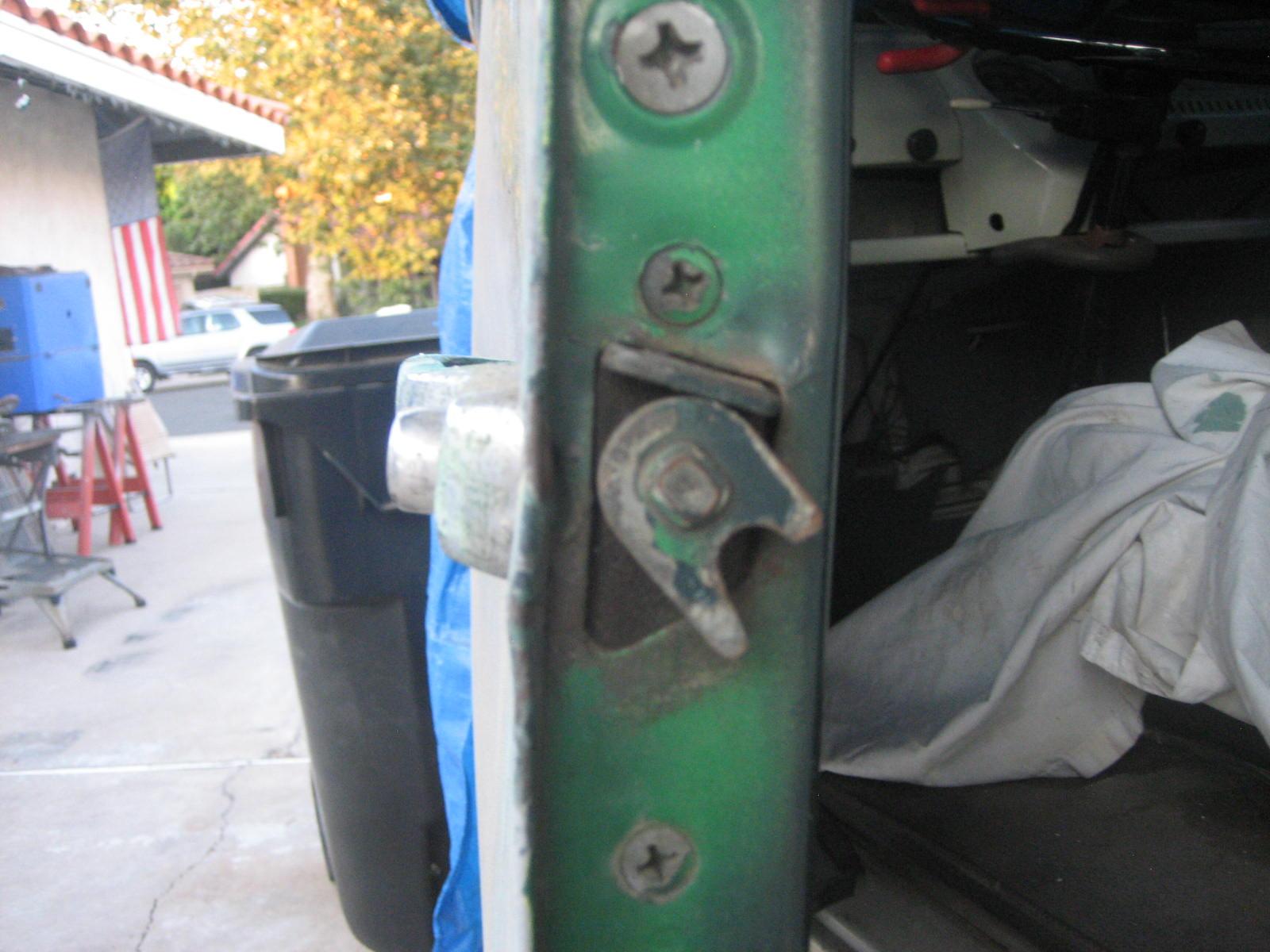

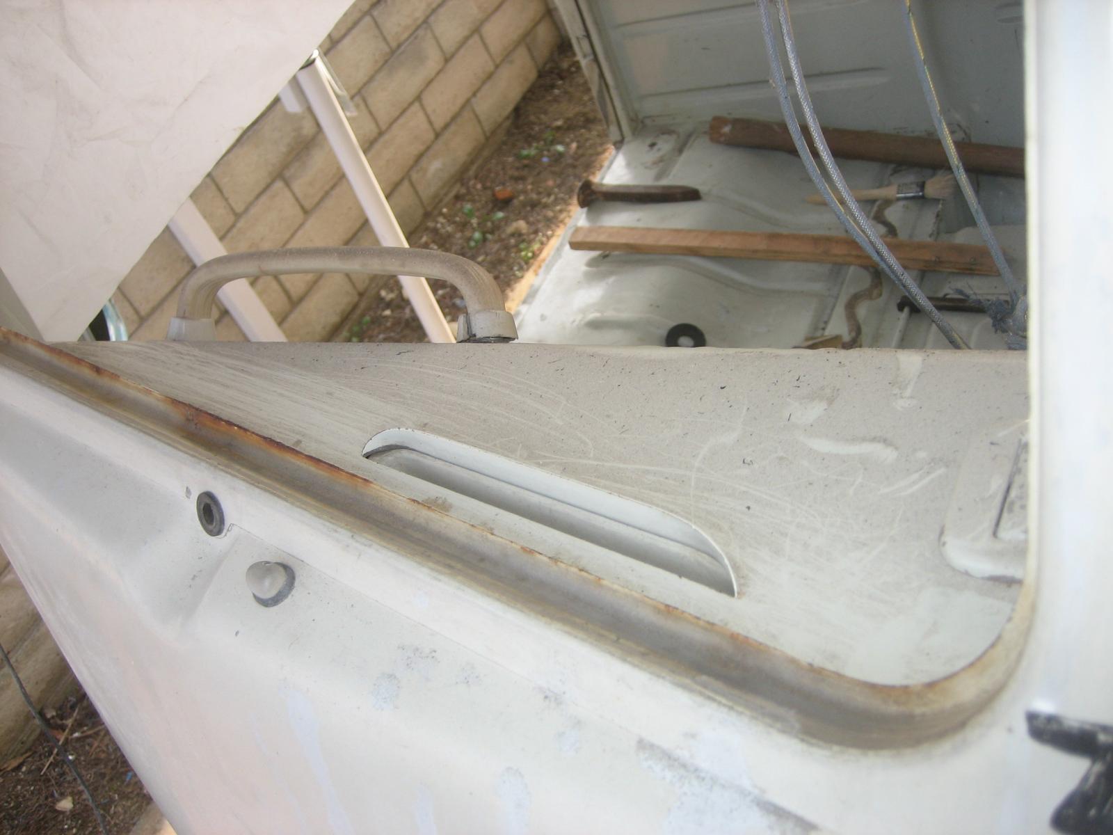

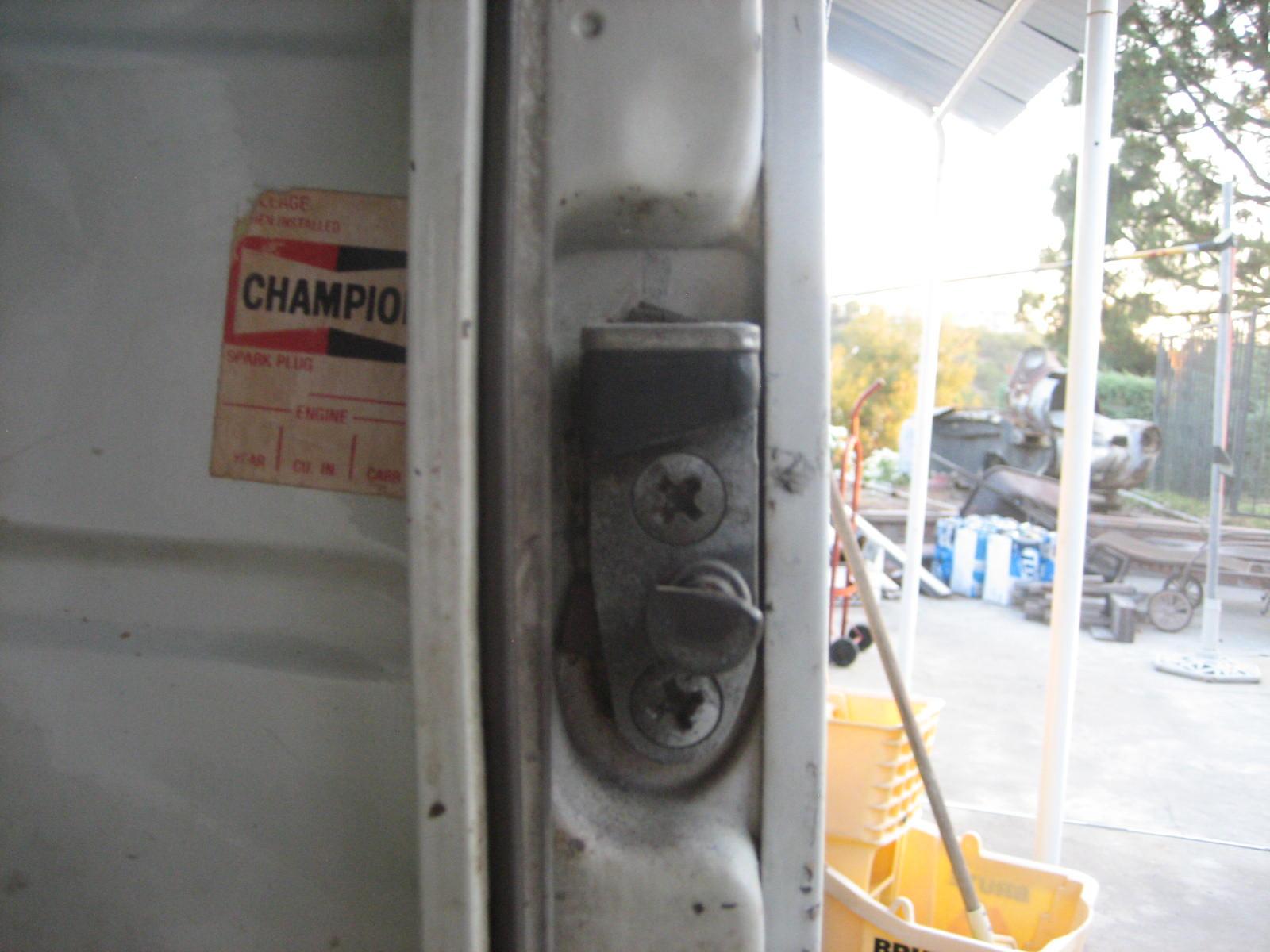

I think the sea blue door is a 66 and the green door from 67. The latches were shimmed all over to get things to work.

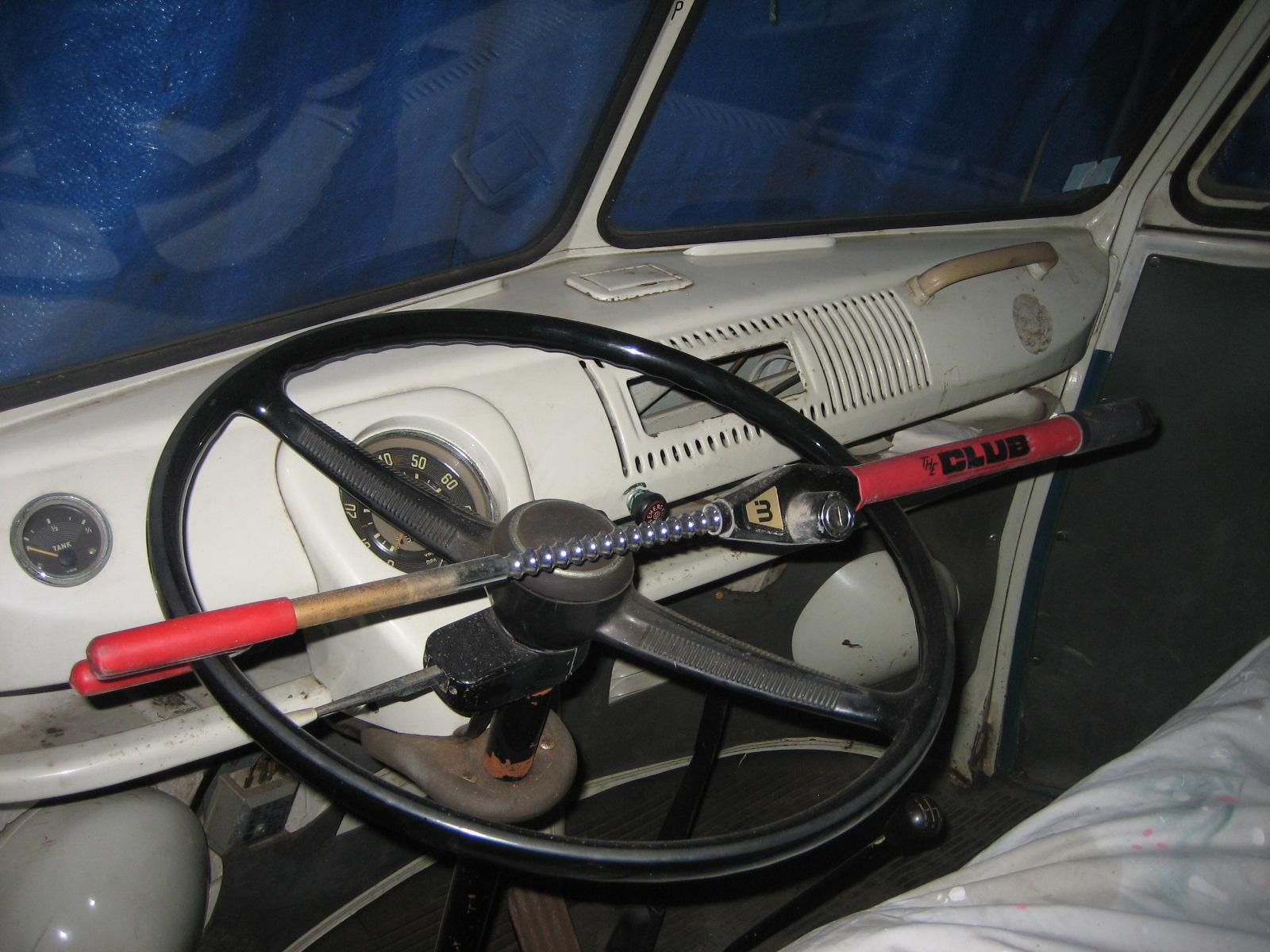

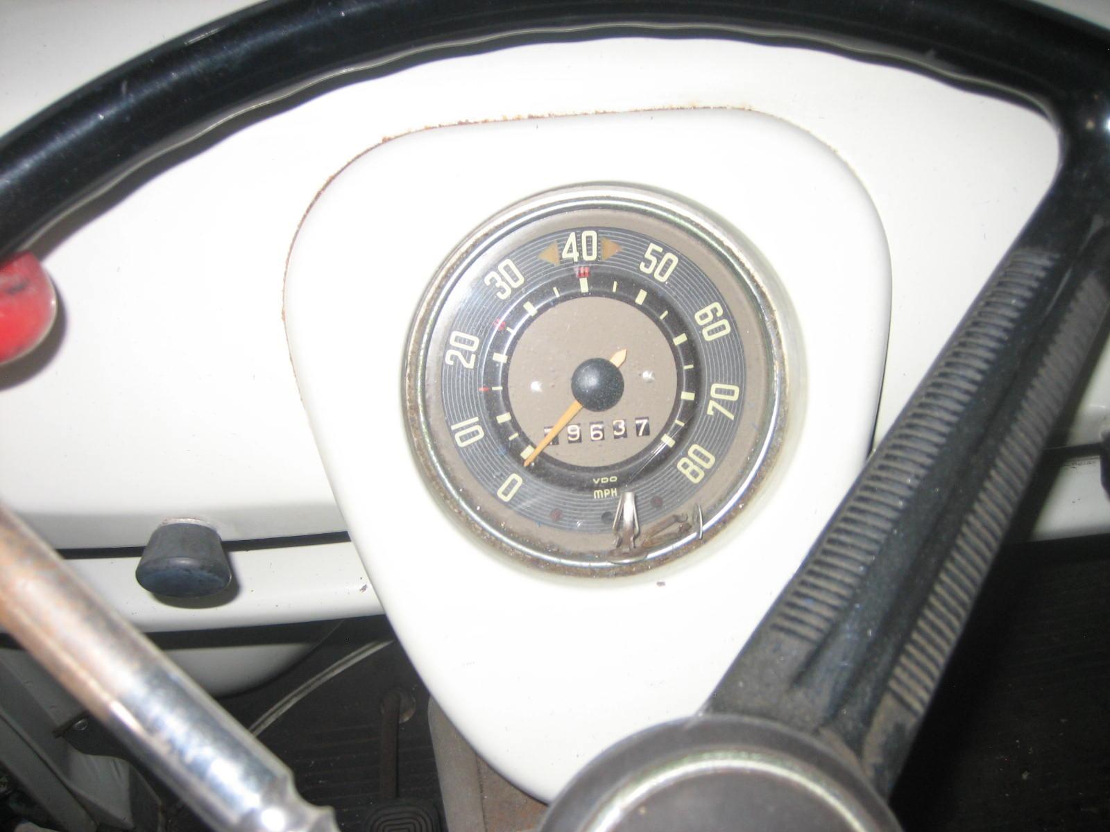

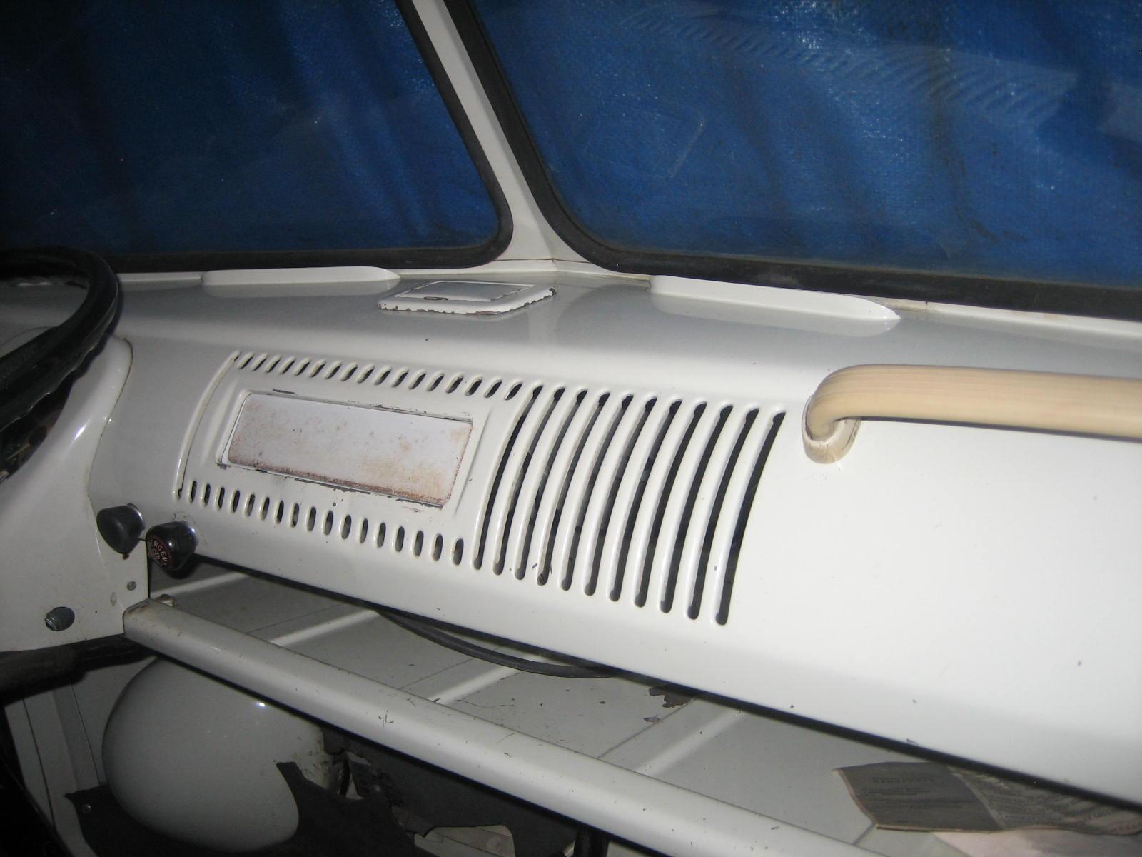

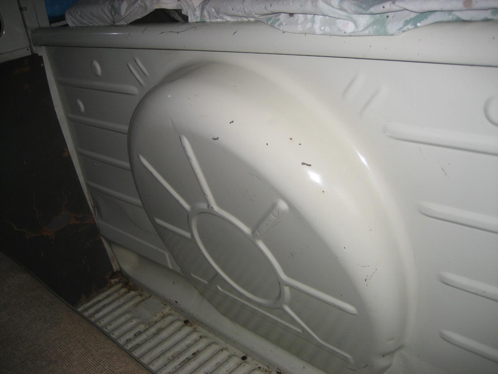

Last post this week, interior

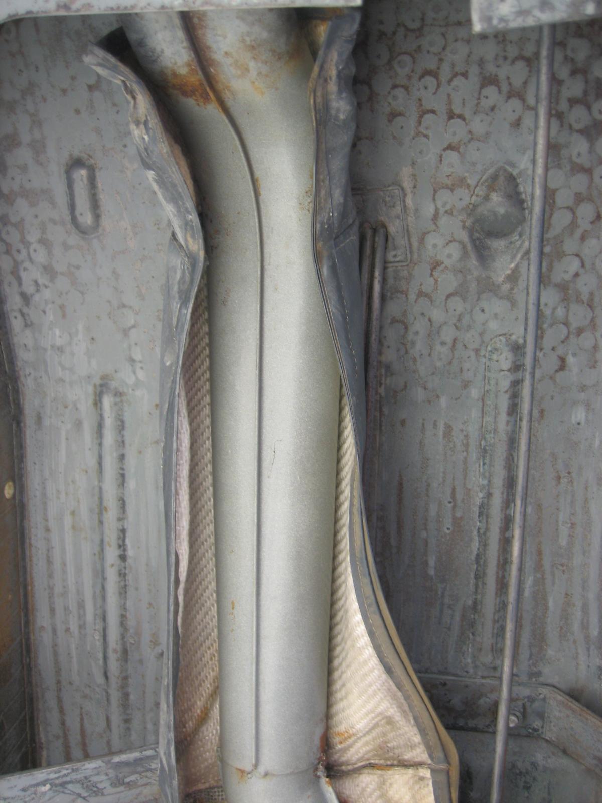

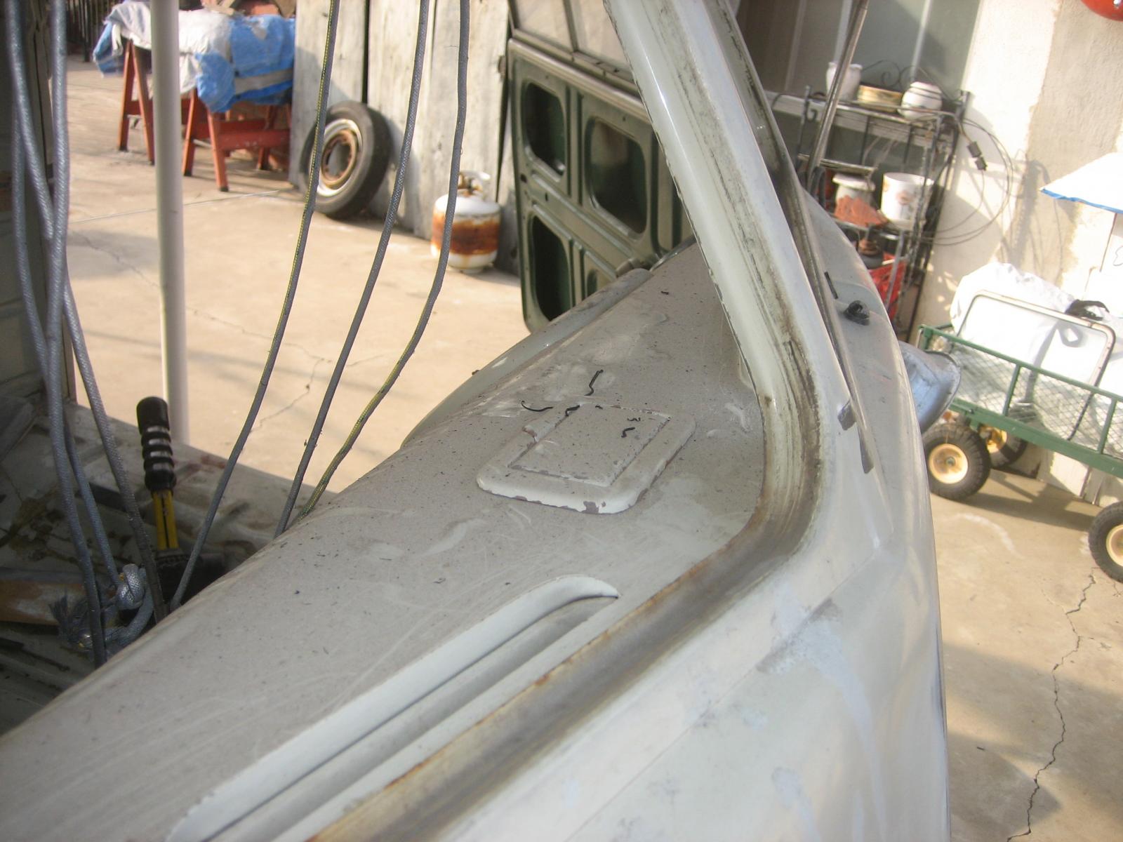

OK, these are probably the last of the "as bought" or real close to it pics. You can see the crease on the frame rail. This bothered me.
Plenty of original paint left.

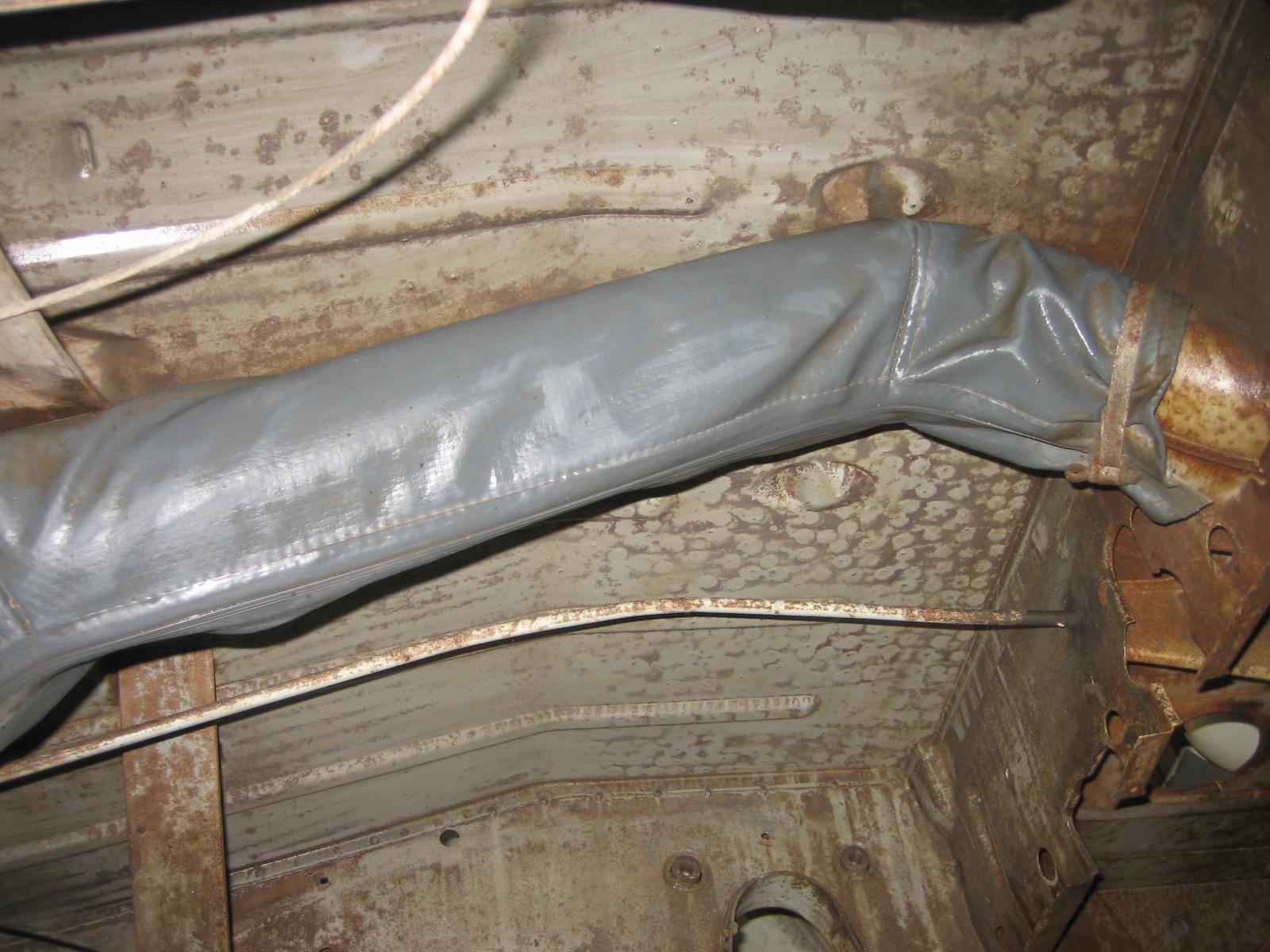

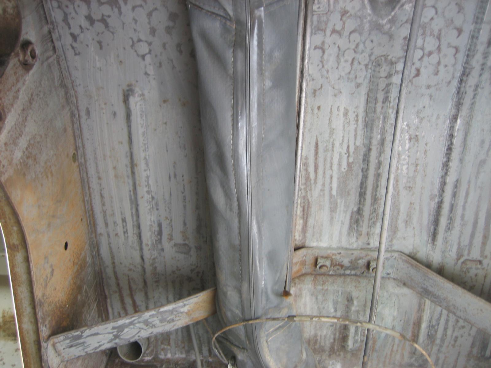

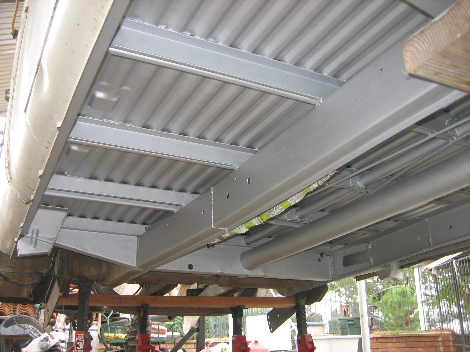

Underneath looked pretty clean

PostPosted: Wed Feb 07, 2018 9:29 pm    Post subject: Re: 1967 Double Cab Reply with quote
crewcabs really never look like that underneath. you are a lucky man

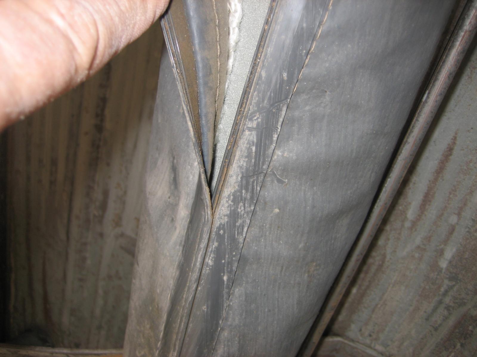

Agree and thanks Uli.

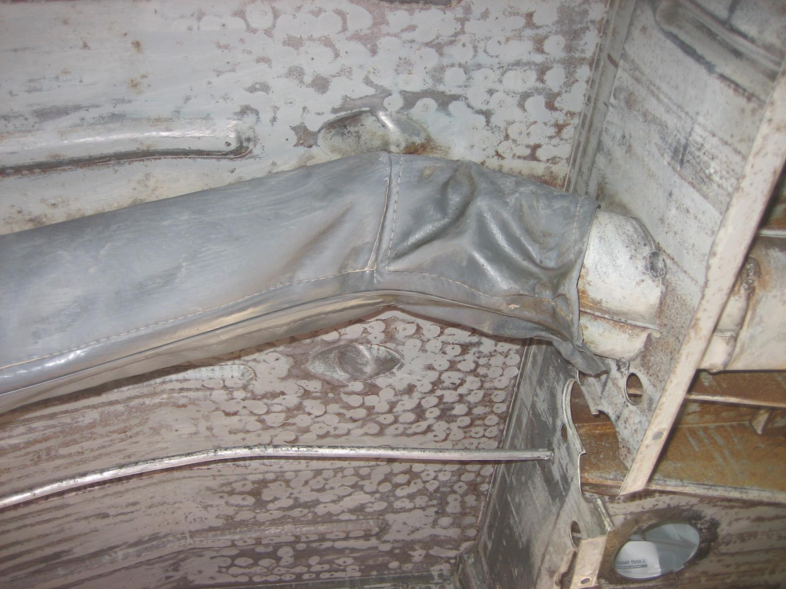

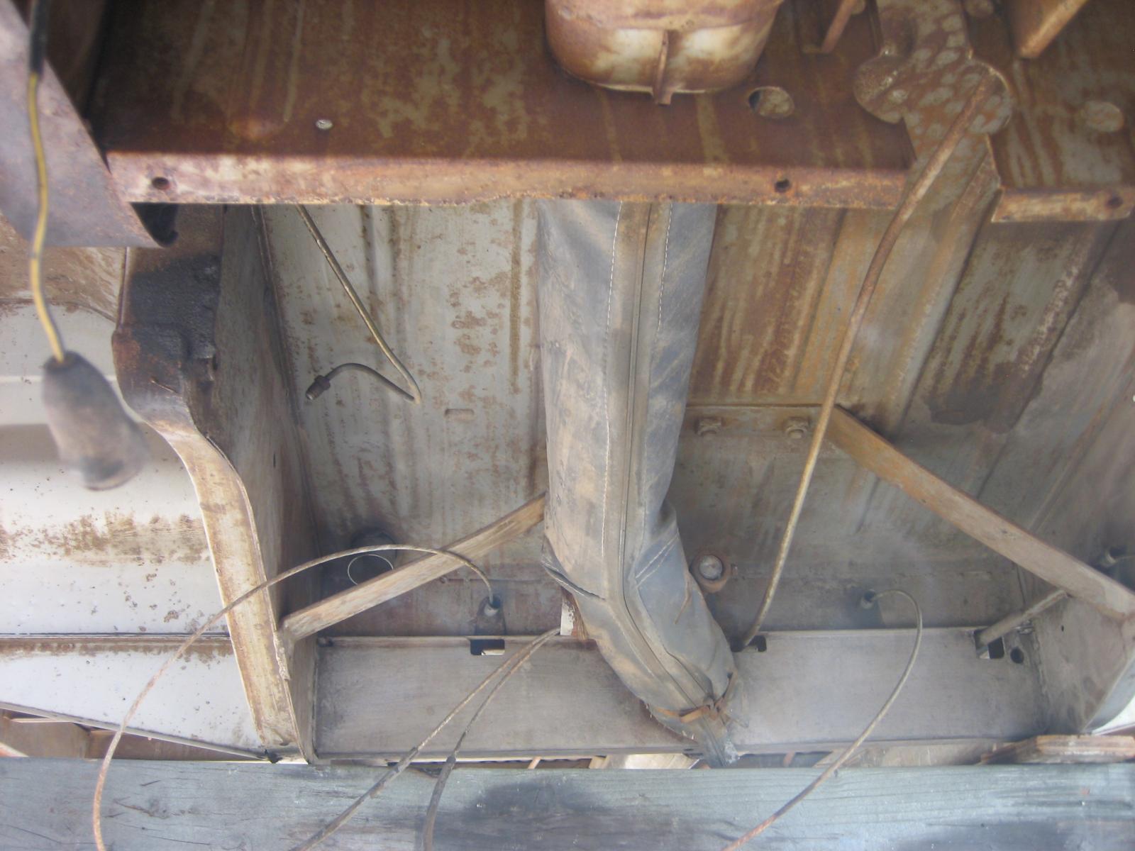

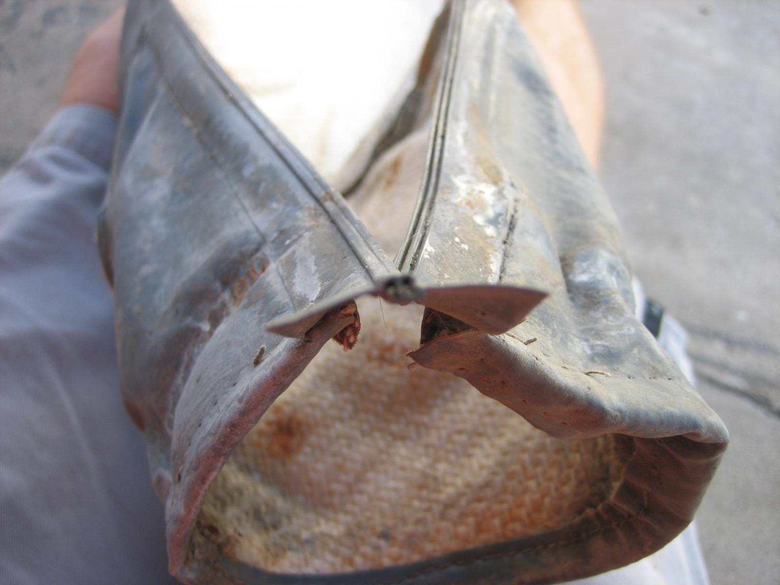

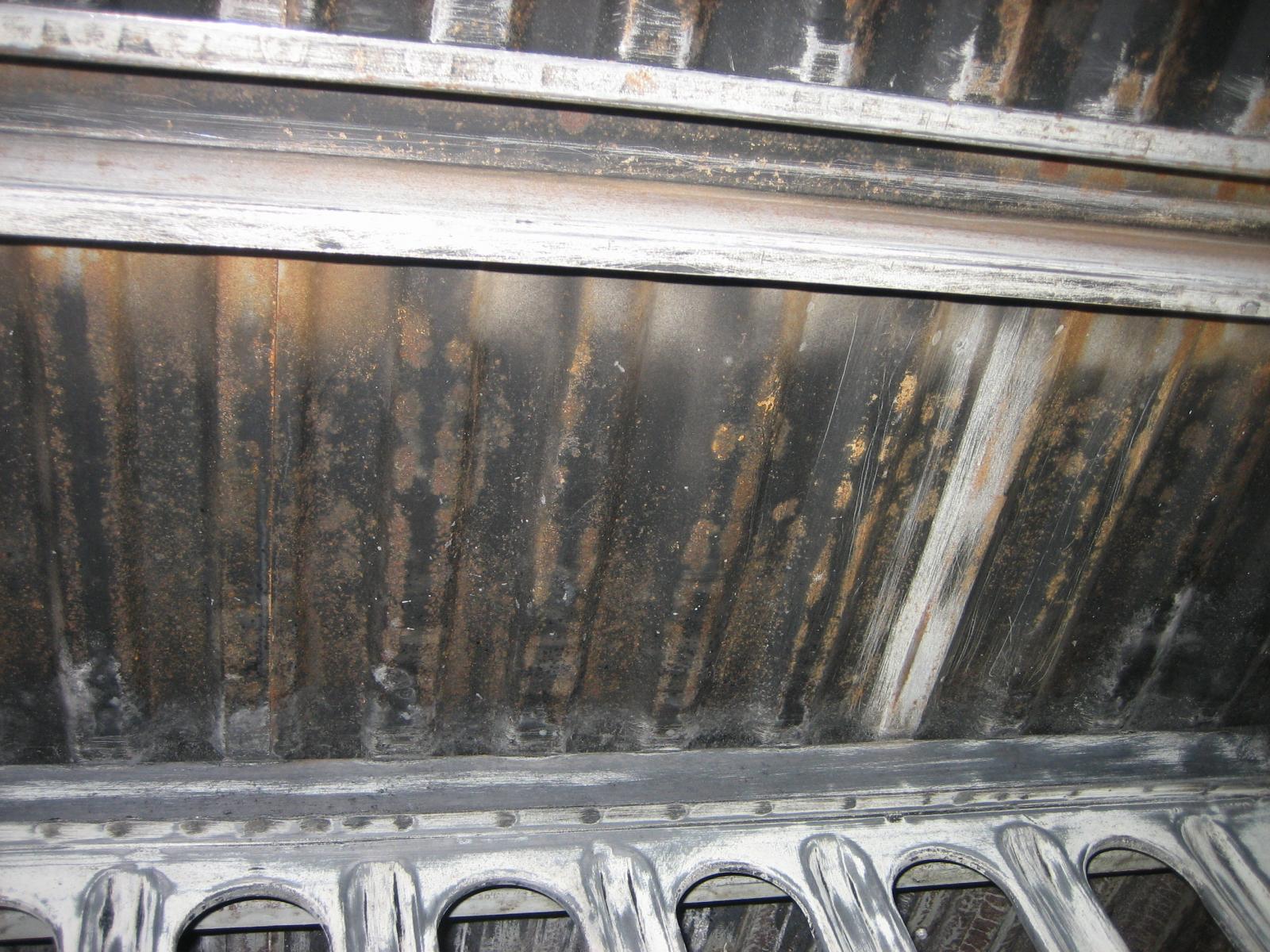

The bottom had been covered in a cosmoline type substance. Gummed up sandpaper immediately but full strength "Purple Power" would thin it down a little at a time. Here is more.

My '66 Sc had some kind of that grease/undercoating stuff on it, I scraped for days, ended up w/ 90#s of gunk, then used Gas Shocked to wipe off the residue.

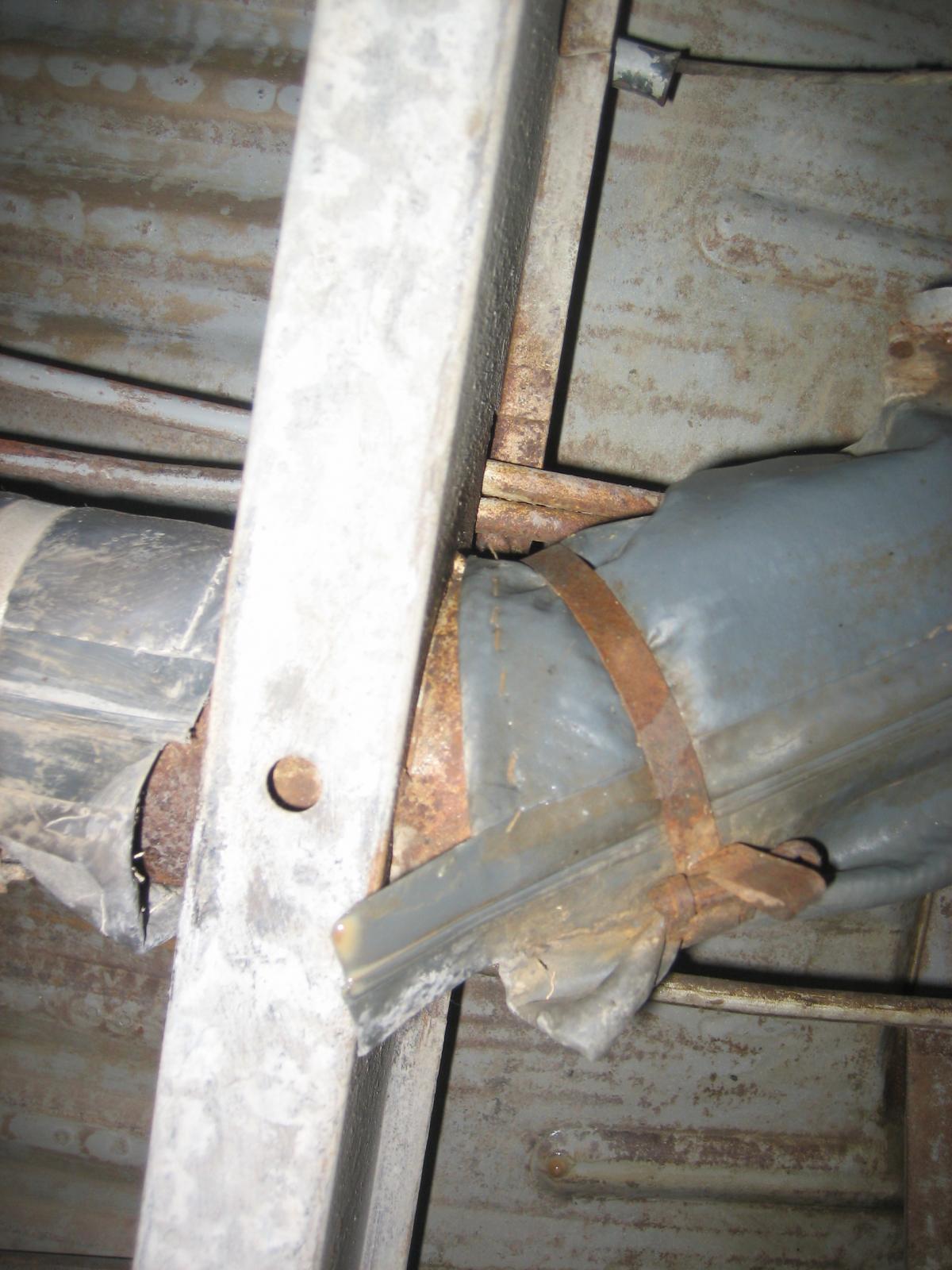

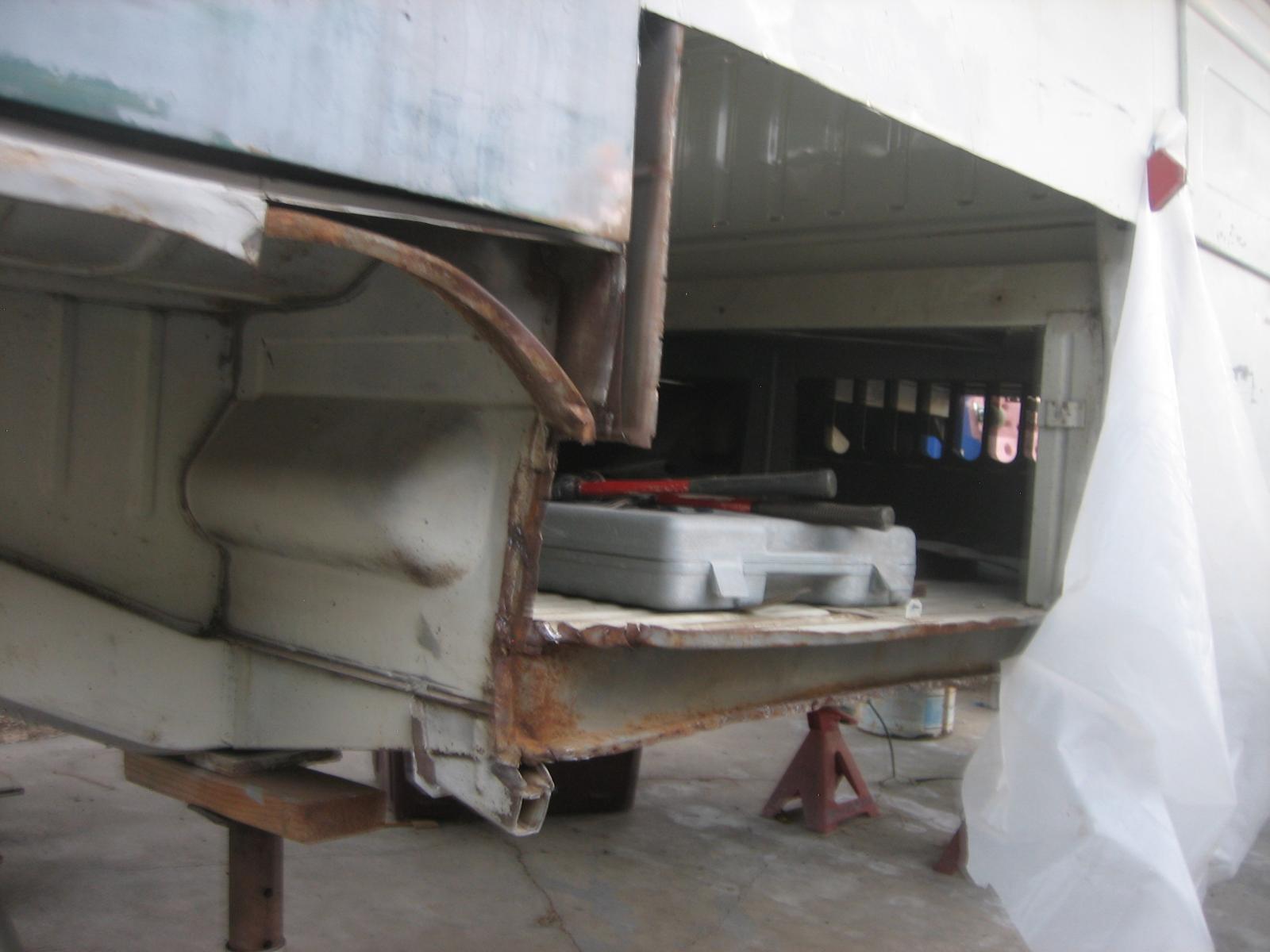

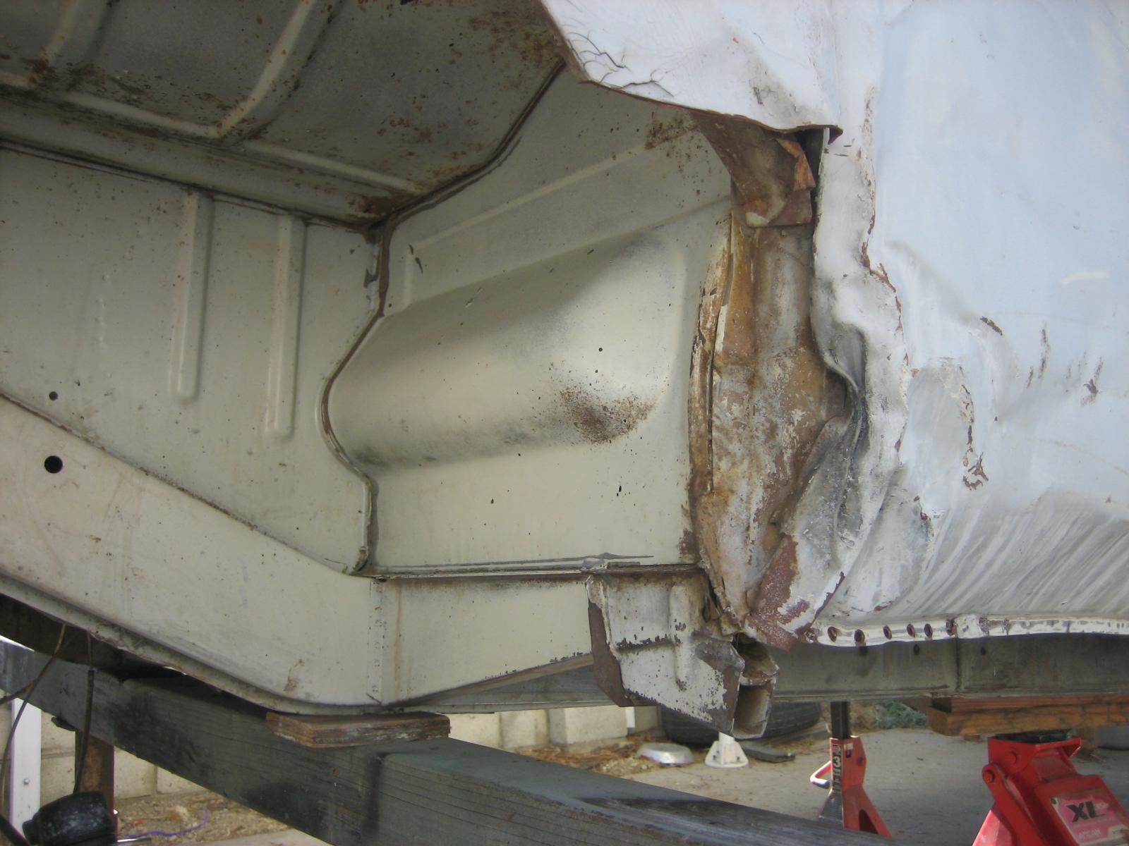

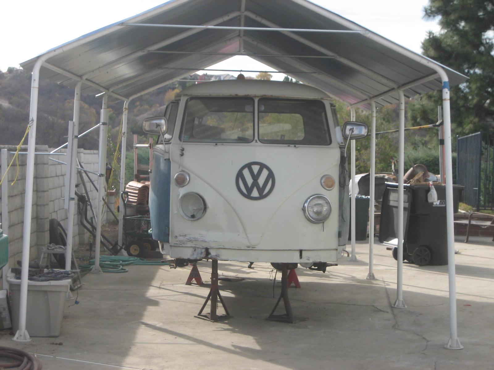

Plan was to clean, get brakes and motor in working order and drive it while fixing the body. But...

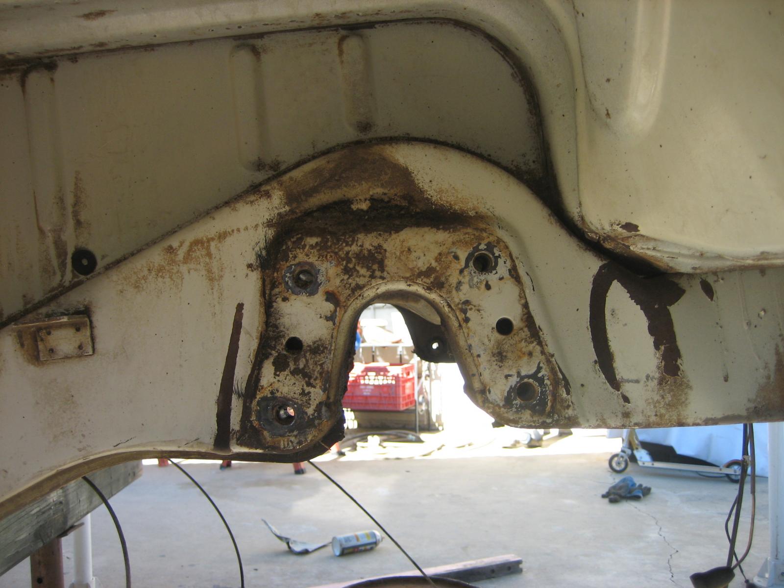

The crease behind the beam was a concern. this pic.
so, I pulled the beam. I think that right there was the beginning of the end. Sad
I have a friend with a pretty beat 23 window that at one time had a V8 in it. He said to come over with a sawsall to get my replacement front 3 ft of frame. So I cut up his already cut up bus for the frame piece.

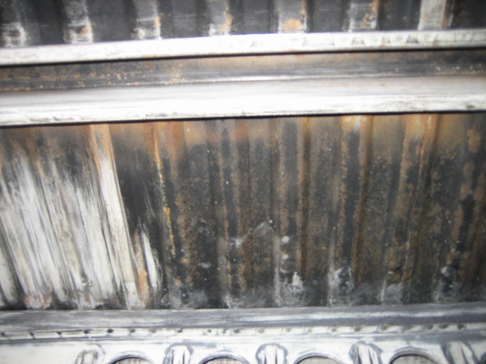

And i started cleaning the black engine compartment.

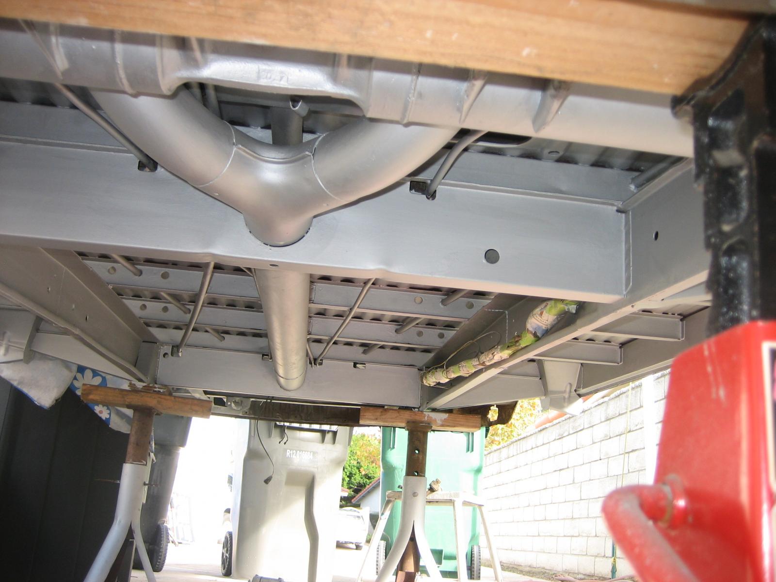

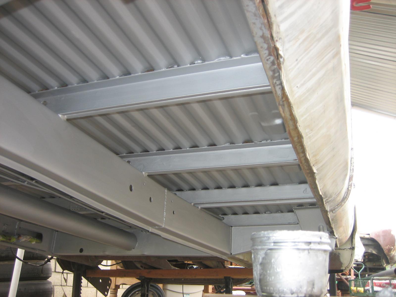

I like Masterseries primer so once the engine upper was clean i put down two coats of MS.

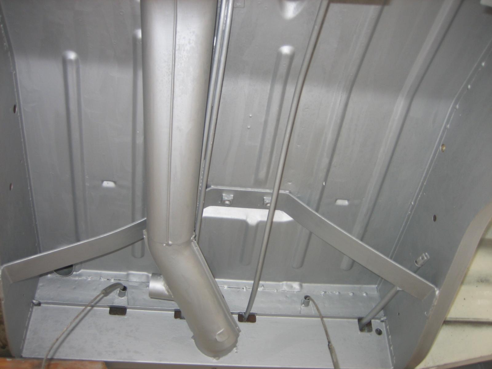

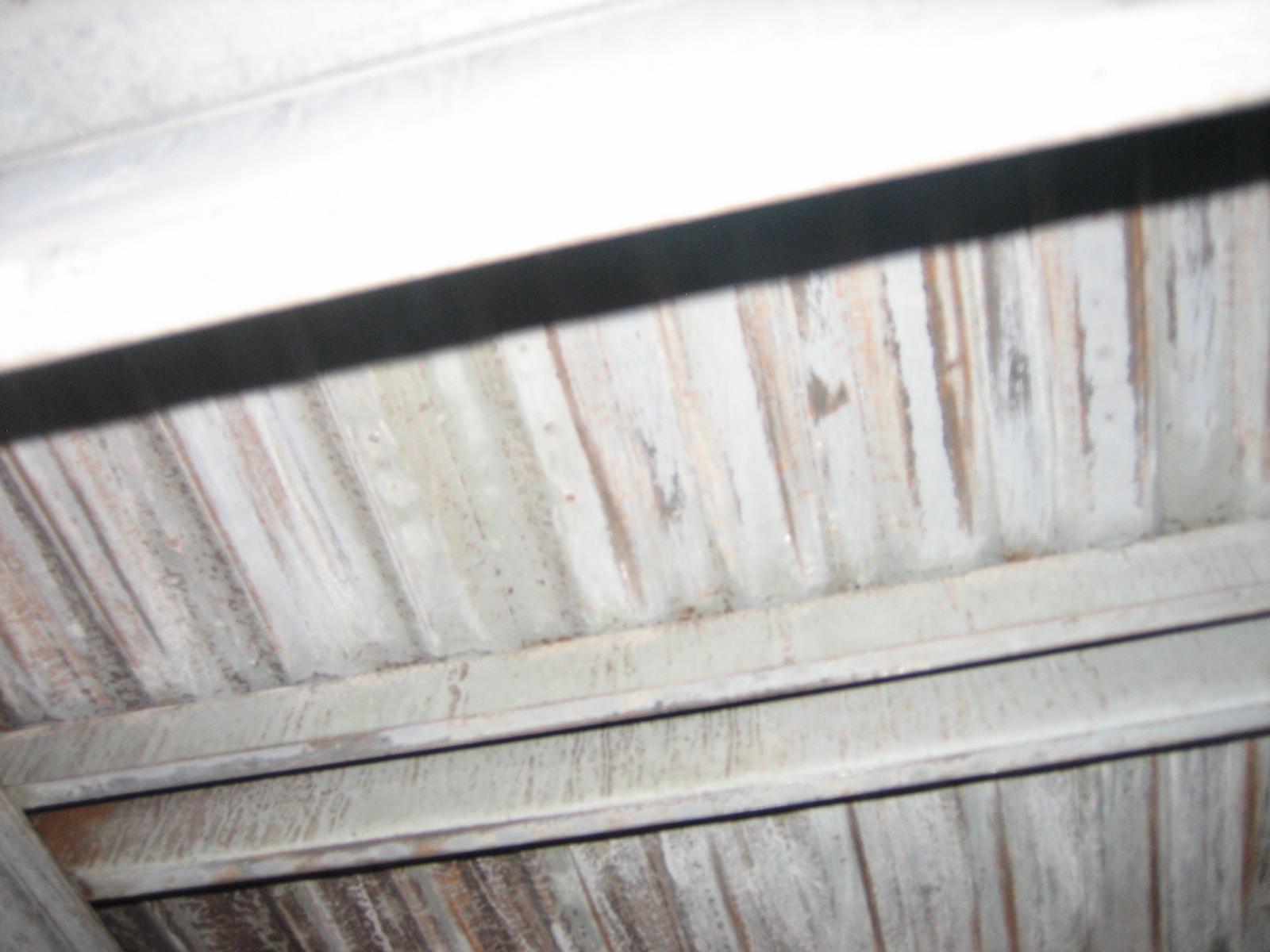

Then with the assistance of my rotisserie I spent 2 months cleaning and sanding the whole bottom of the truck. This may not have been the best idea. I would spend weekend after weekend cleaning, sanding its summer, 100* ish degrees and everything I sand off falls in my face and mouth. Week after week and what was even more frustrating is when any one looked at my progress..., it looked like had done nothing. You cant see the F'n bottom. I also carefully un-zipped and removed the heater tube insulation Once done i got 2 coats of Masterseries on it.
Pretty muck zero rust on these things.
Oh, did I mention I broke my leg waterskiing that summer. So I had surgery and was in a cast summer 2014.
This is 2 coats of Masterseries front to back.

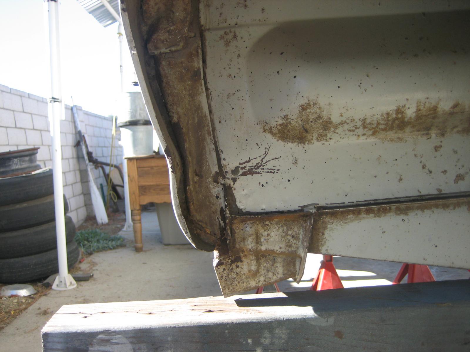

Started removing the bad metal.
I pulled all the windows, I kept seeing why i bought this one, no rust.

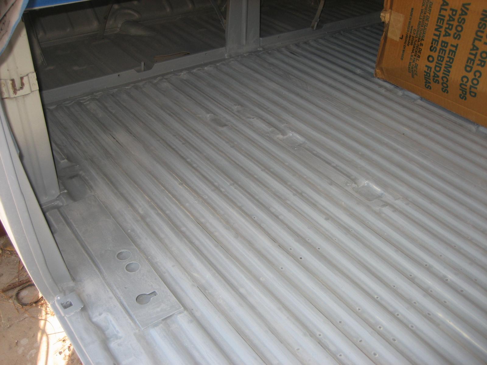

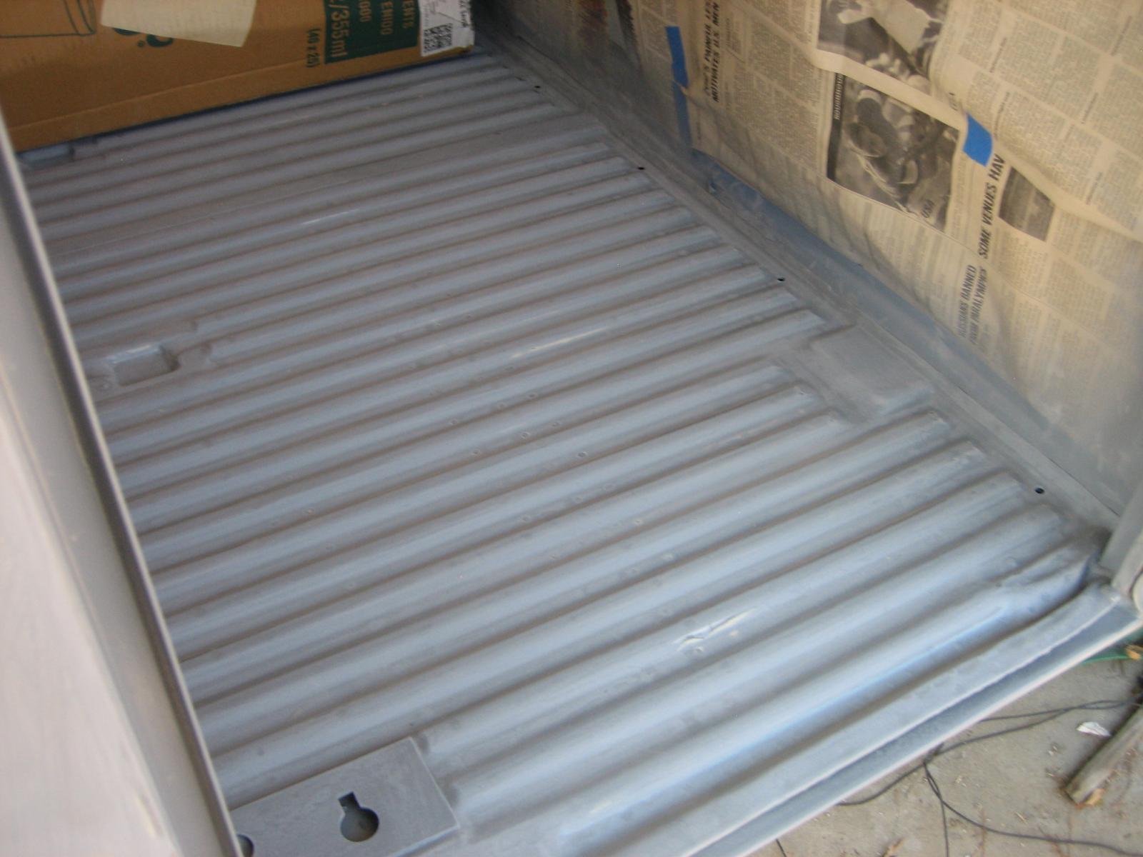

I stripped the floors and front seat area to bare metal and shot DP (DP40 epoxy primer). I DP'ed the nose. Yes, i removed all that OG paint. Crying or Very sad

PostPosted: Fri Mar 02, 2018 11:36 am    Post subject: Re: 1967 Double Cab Reply with quote
Unless you have a pretty good chassis jig, I would recommend to straighten the car FIRST. That is not bent that bad. if you have access to a frame machine you could pull and heat that to near perfect. I'd not put a chunk of frame into it, Unless it was the whole right front half.
