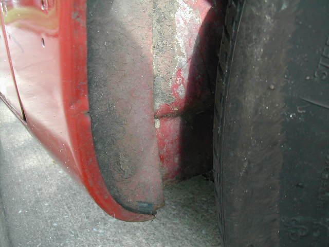

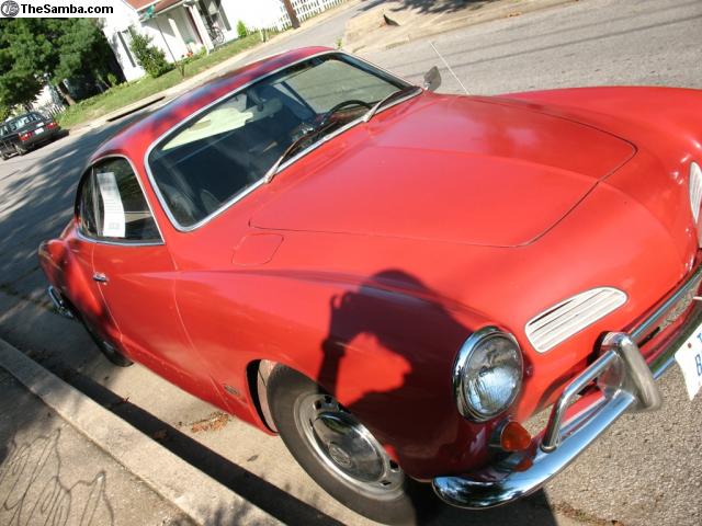

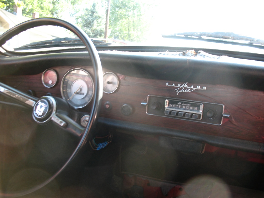

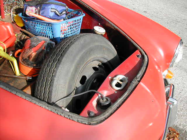

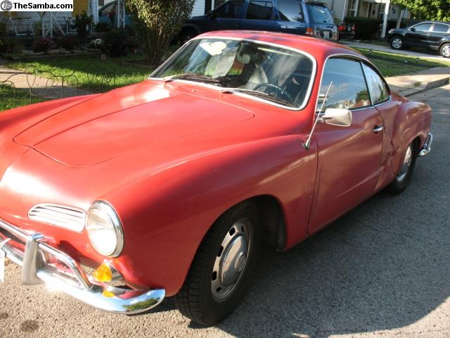

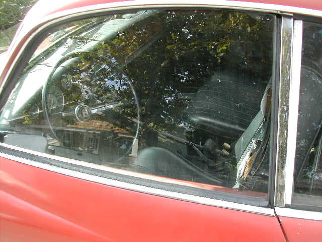

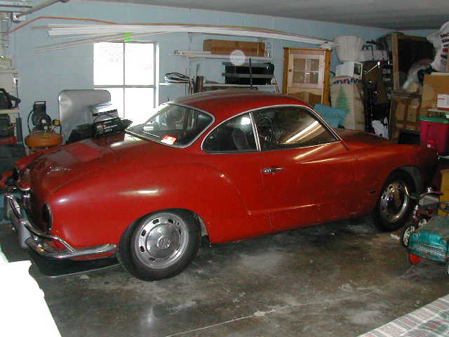

I had been half-ass looking for my wife a Ghia for about a year when this one popped up in the classifieds.
It was close (90 miles) and it appeared to be in decent shape body wise with no major rust issues, plus it was a running driving car. Since I'm knee deep in rust repair on a '62 beetle I was definately looking for a solid car. I contacted the owner (Hi Grace) and made an appointment to go see it on Labor Day. I had every intention of bringing it back with me but my wife reminded me that I had sold my pickup that had the hitch on it so I was able to leave a deposit and pick it up the following Saturday.
Here are a few pics that came from the ad and one that the owner sent me in an e-mail.

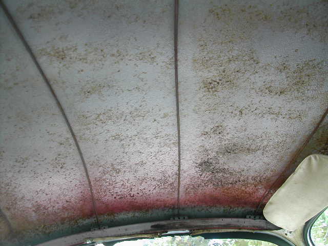

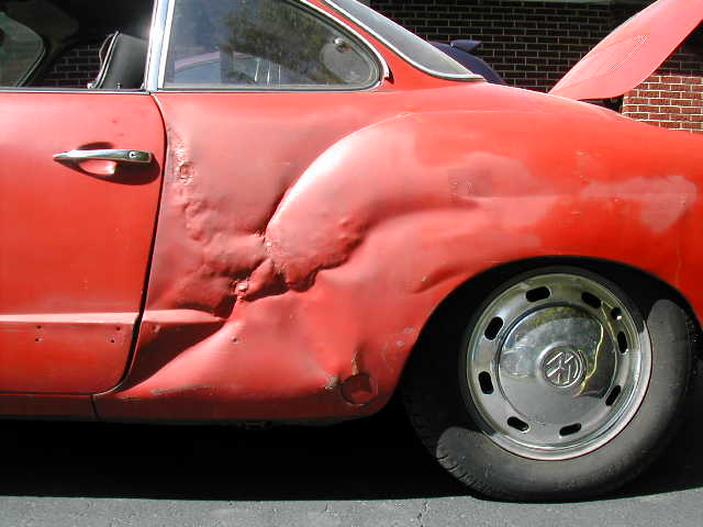

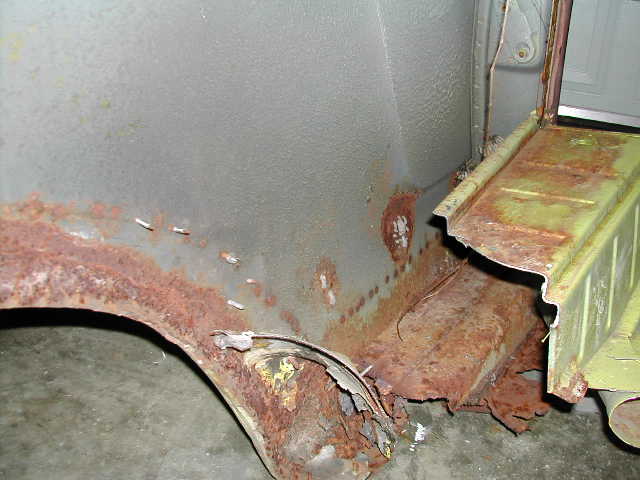

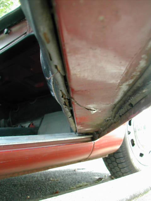

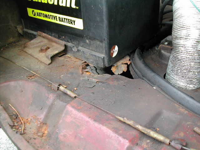

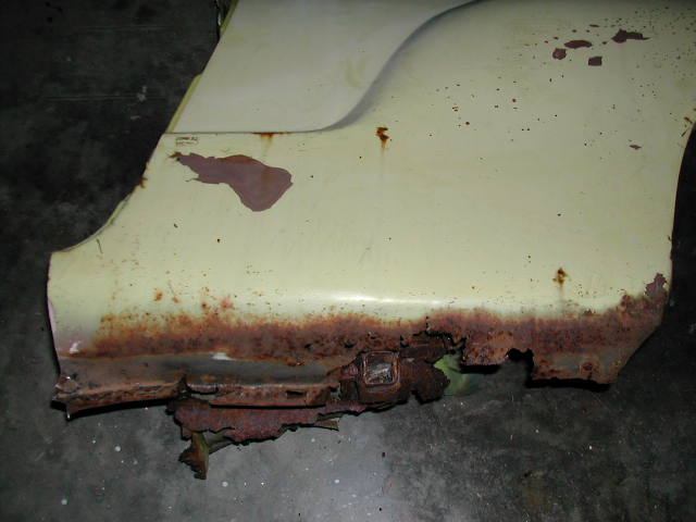

From the ad you could tell it has some issues in the rear quarter and battery tray areas. The engine is in the right group of numbers to be the original. Overall it was what I was looking for. I went and looked at it and made the deal. Here are some additional pics I took.

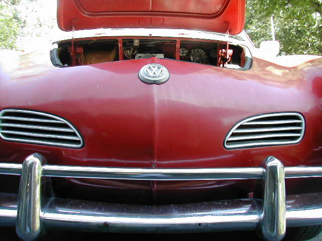

starting at the passenger side front and going clockwise

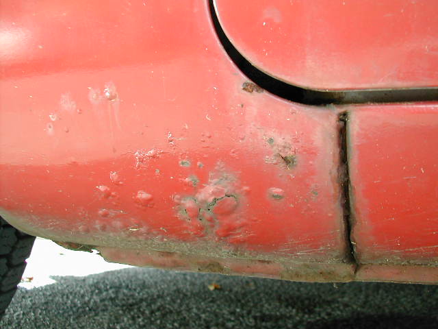

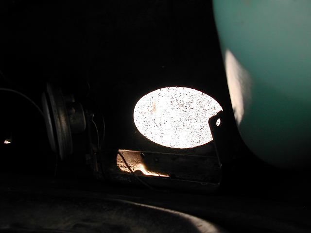

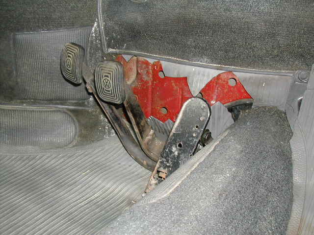

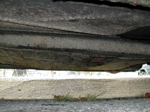

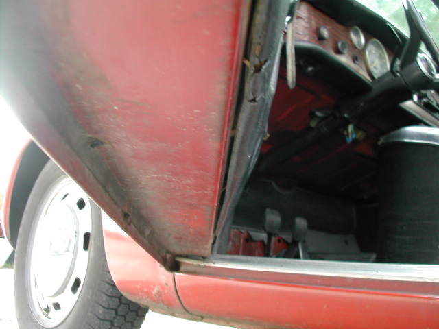

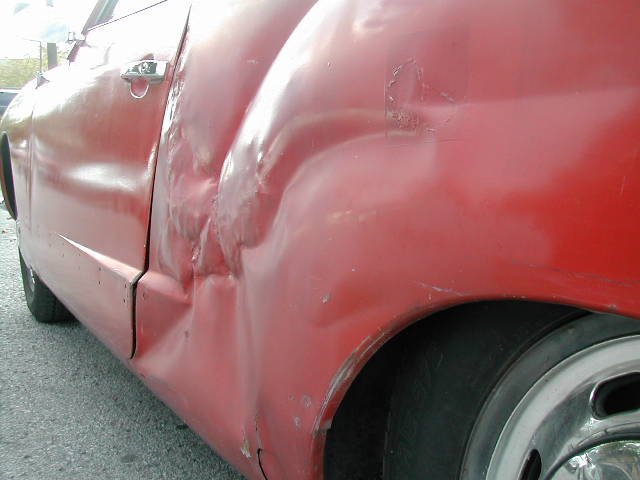

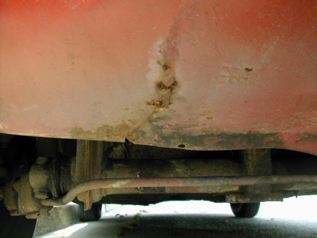

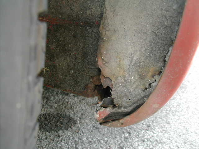

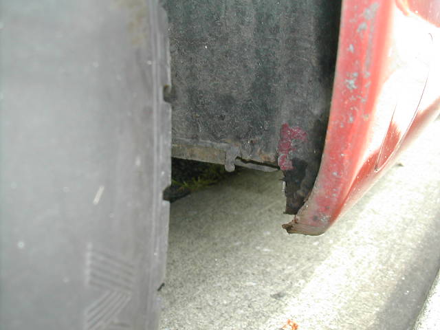

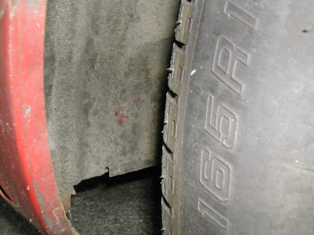

Here is a closeup of the rear quarter and some other areas that will be needing some attention
Along with the bad a few pleasent surprises
Some more issues

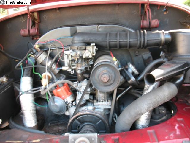

Overall it ran fine (forgot my compression tester Rolling Eyes ), steering was tight, brakes needed adjustment, it was a little hard to get it in gear and shifting was tight, and finally it suffers some of usual wiring problems of a 41 year old car. Nothing major just a bunch of little small things.

Move the fuel filter out of the engine compartment

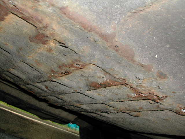

Pan halfs both sides
Battery tray

Here are a few other pics that I took.
Since I'm new to Ghia's I have a lot of reading to do and I'm sure I'll have tons of questions. Any suggestions on parts suppliers or anything that jumps out in the pics that need immediate attention just let me know.

Wow, that quarter really got messed up. Otherwise the rest of the car looks good. You might even get a shine out of that paint with some buffing.
I have done some body work and trust me, the rear quarter is goning to be a mofo. Other than that, not to bad, pans will be pretty easy, and the rest of the metal work should be a pice of cake if you are doing rust repair on a Beetle you will have plenty of practice. Big question for me is, how much did you get it for? Looks like you have a solid start for a real nice car. Congrats.

I considered taking a look at that car. Seemed like a decent deal.

The paint should buff out nicely. As far as the quarter goes eventually I'll try to see if I can straighten it, if not I'll just cut it out and weld in a new one. The only other thing I thought of to put on my short list is to upgrade the seat belts. I'm thinking of putting retractable ones in. Until I can do some research anyone know any good sources?

I wouldn't waste any time trying to reshape that quarter. It might have had a chance when it was originally dented, but whoever previously tried to bang it out totaled it. The good part is, the area you need isn't usually rusted out - I can think of a few sitting in fields that could give up that chunk.

I wouldn't even bother with those floors now. Fix the battery rust, and you should be good to go for years to come, or at least until your 62 is finished.

Floors will be an easy fix. I'm thinking a couple of weekends to knock them out. Since I just took the heater channels out of the 62 I really don't think a few weekends delay will matter much.

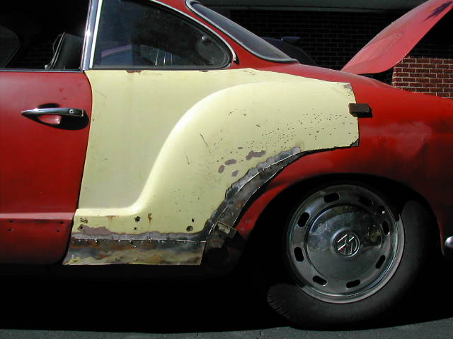

That turned out to be today. Very Happy

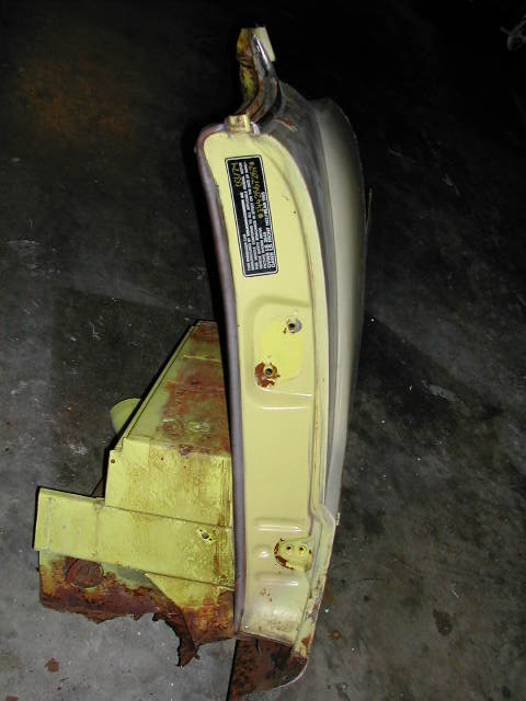

There are some issues on the bottom with rust and some previous attempts at repairs but I think the area that I need should , for the most part, be solid.
I had called Dave to see when I could come and cut out that quarter. It turns out he was free today so I loaded up my tools and went after it. While cutting it out he mentioned that he had just about finished picking it clean and that he would soon cut it up and haul it off. So since I was there with sawzall in hand we went ahead and cut it up.

To my surprise most of the electrical works. The only thing that I could find wrong was the reverse lights didn't work. That was a huge relief since I hate to mess with electrical.
My immediate concerns now are the hard shifting problem and I have a small fuel leak in the engine compartment somewhere around the carb. The gears grind when shifting into reverse and it takes significant effort to put it into first and to shift from first to second. I'm hoping all it needs is a simple clutch adjustment and maybe a slight tweek at the shifter.
I'm going to start searching for other possibilites so if anyone can think of something else to try in the meantime I'm all ears.

Thanks again for helping me chop the old yellow rust bucket.
It is so much less of an eyesore now. Jim and I looked the parts car over and there a few panels that are salvageable.I should be able to get them off
the remains before it goes to the scrapper.

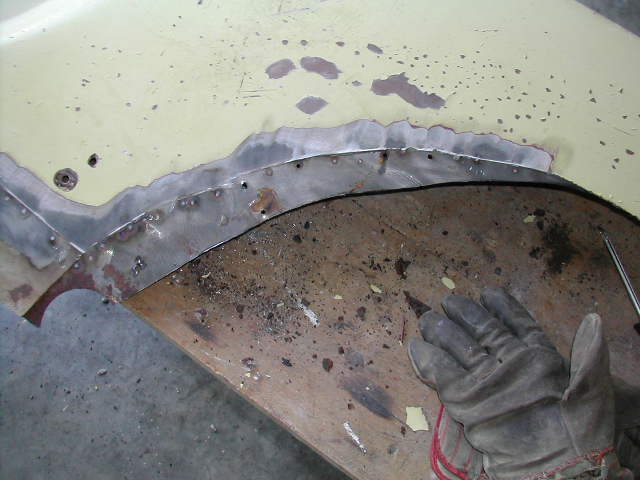

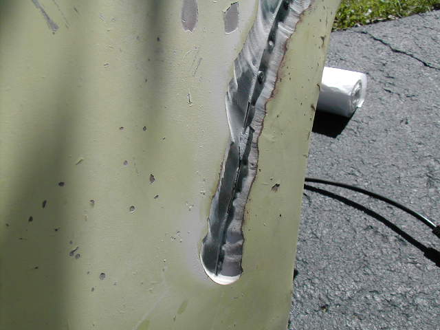

Next I decided to start cutting up this piece to see what all I could salvage out or it.
It had been repaired (rather poorly) in the past so I was going to cut it down to the good parts to see what I had.
There was a combination of pop rivets, pan head sheet metal screws, spot welds & self taping bugle head screws. The reason for the screws was that out of the 30-40 spot welds only about 6 of them had enough penetration to hold.
Here is the piece after it was cut down.
You can see where the two pieces were overlapped. I was surprised that the metal was in such good shape. I was expecting a lot more damage.
Since I had it all trimmed up I though I would just place it on the body to see if it would cover most of the damage. Here is a closeup of the damaged quarter and with the piece in rough place.
It covers up almost all the damaged area. A little clean up and some more trimming and it will be ready for whenever I decide to start cutting.
After the generator and quarter panel work I had to take a little break and do my weekend chores of mowing mine and the neighbors yard. He had a heart attack a few weeks ago so I'm helping him out a little. He helps me out by pulling up a chair while I'm in the garage working on the car and giving me advice. Laughing
After mowing it was back to the garage.
