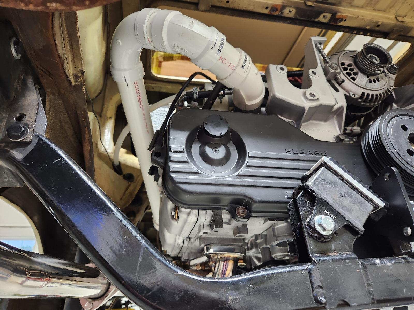

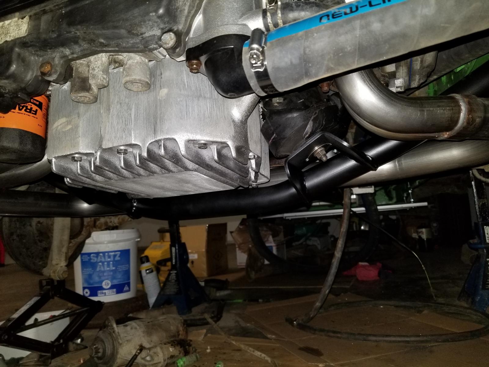

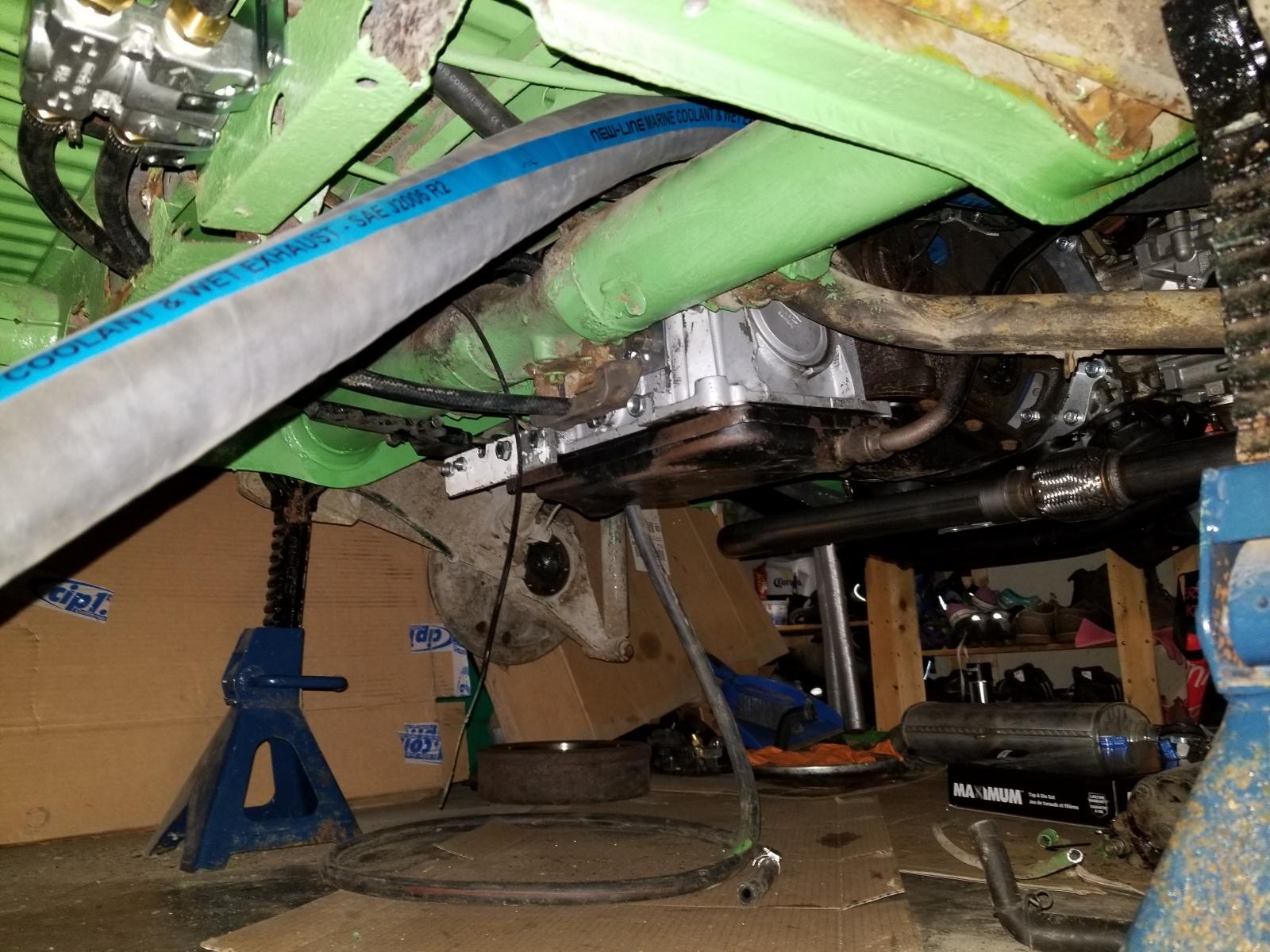

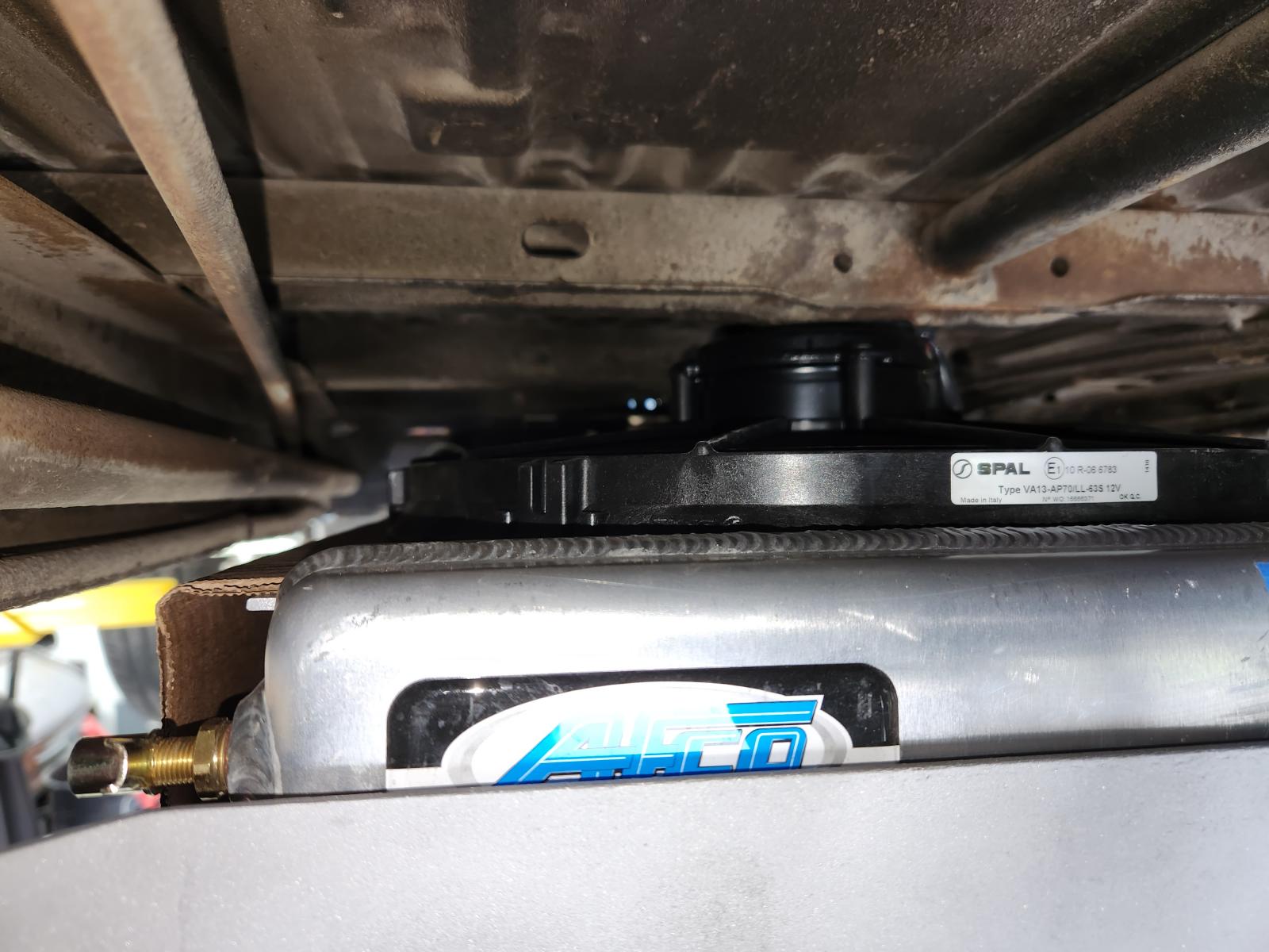

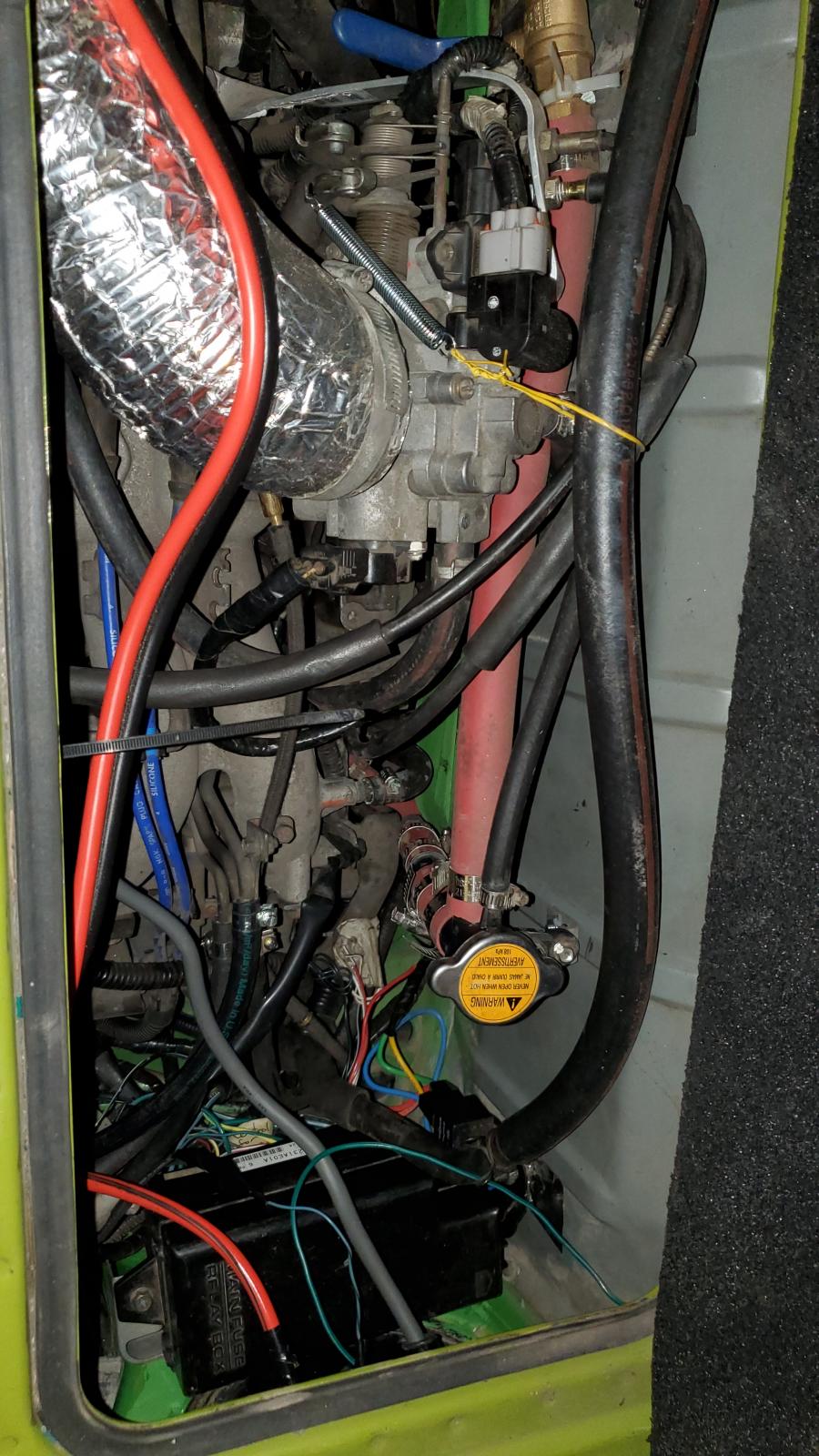

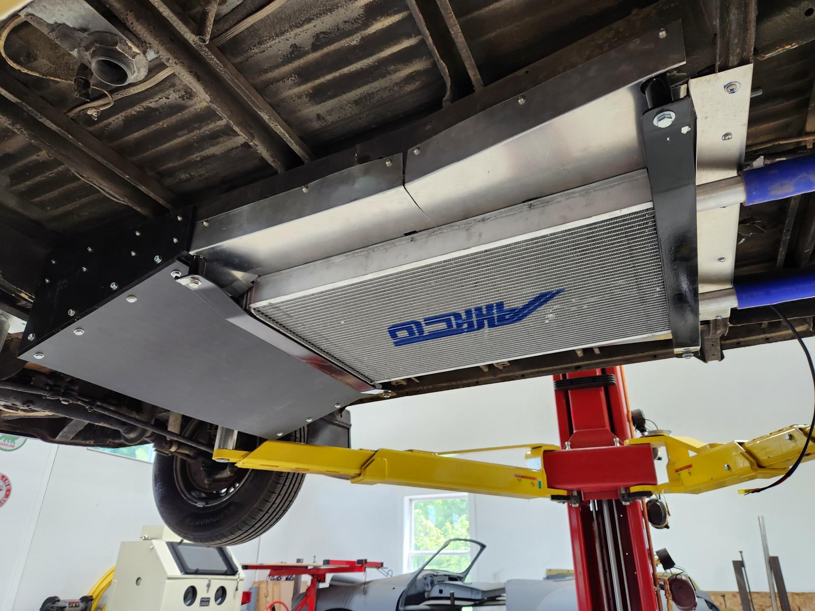

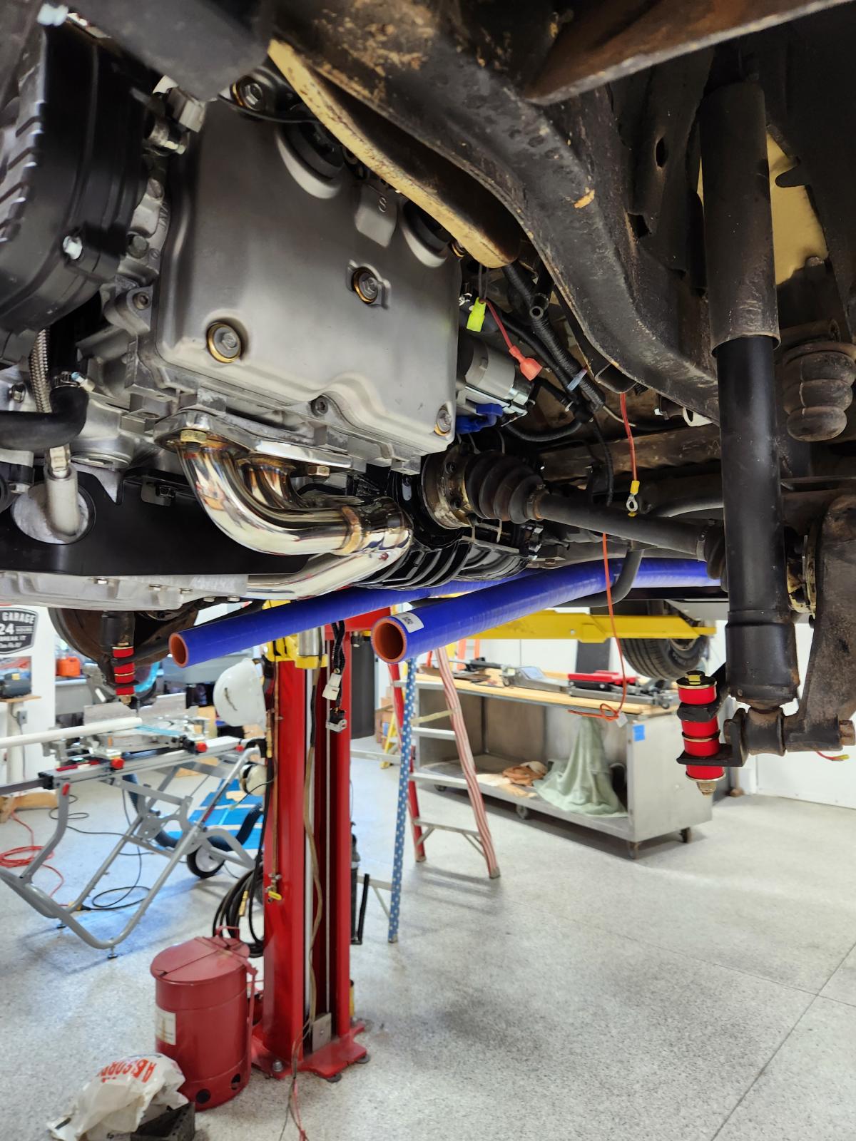

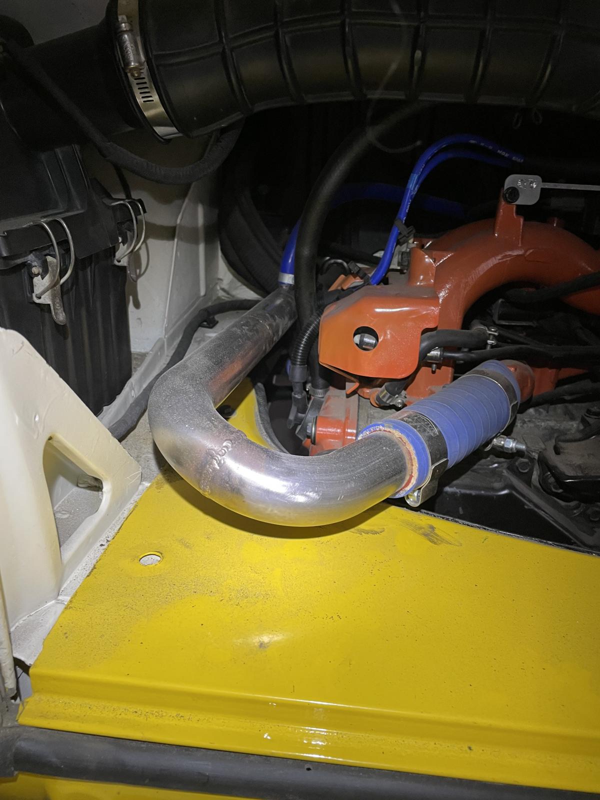

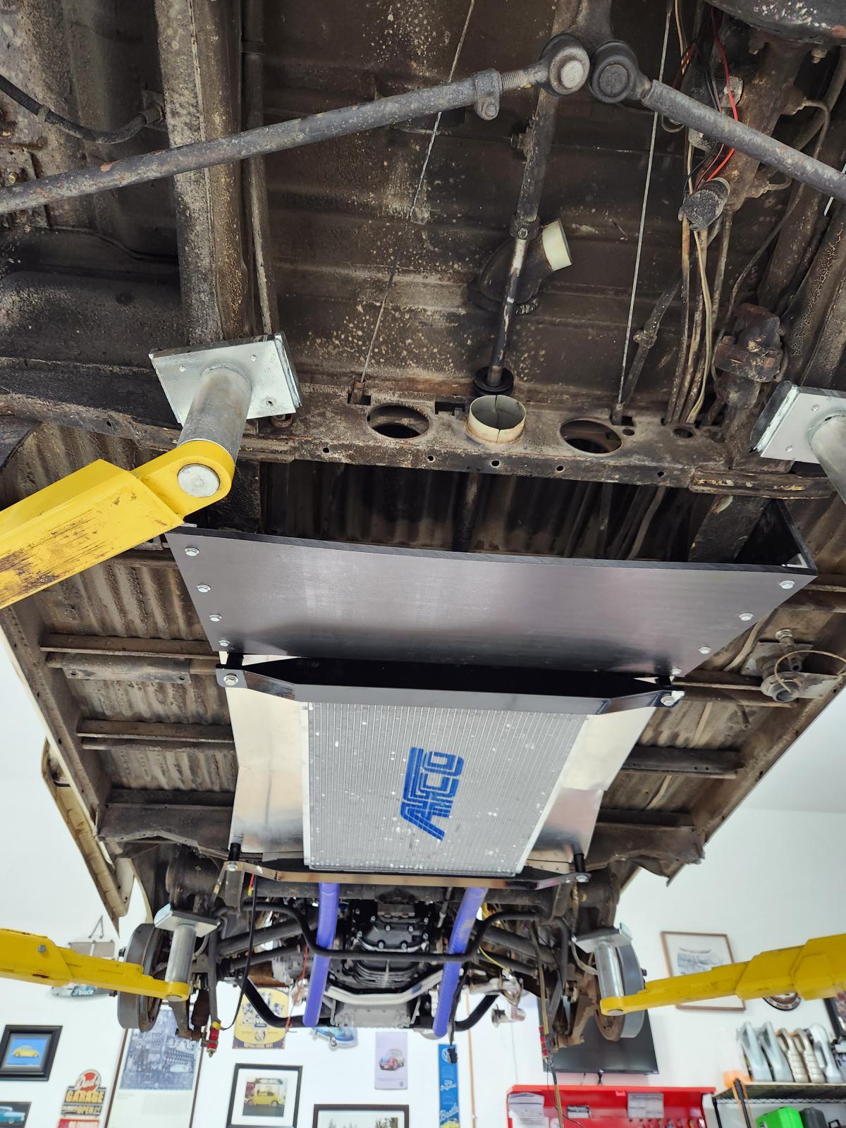

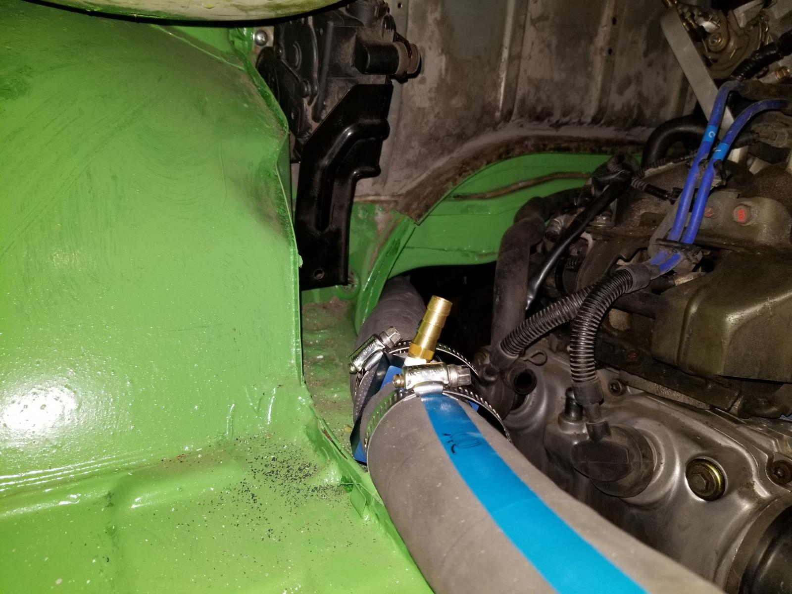

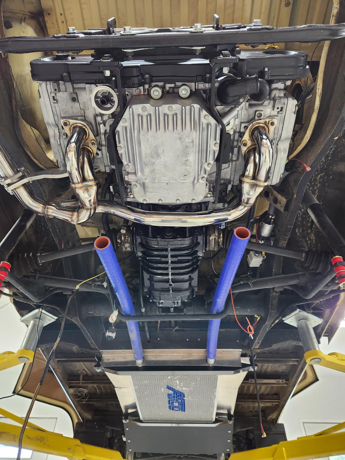

PostPosted: Tue May 27, 2025 9:04 am    Post subject: Re: Subaru conversion Reply with quote

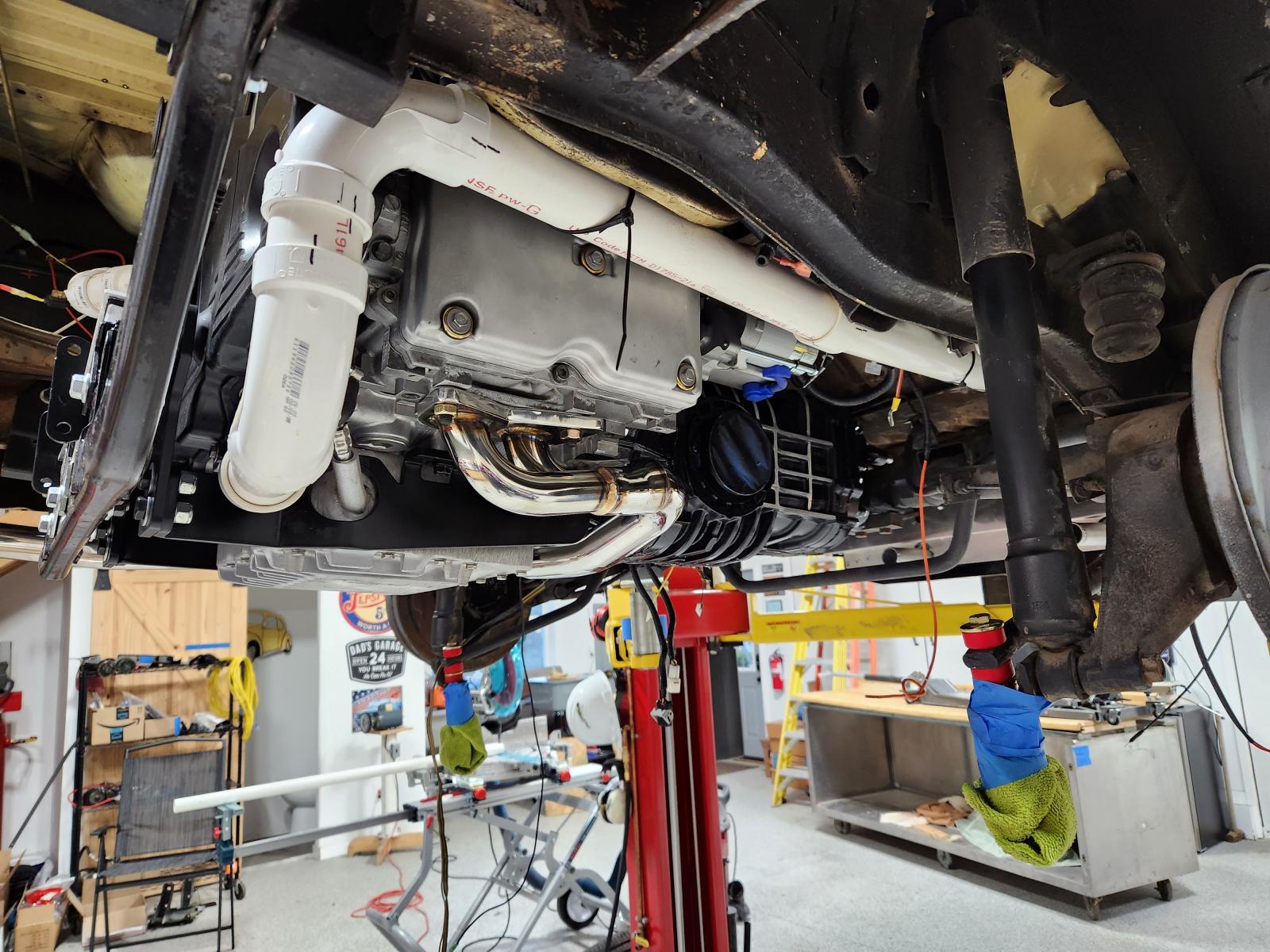

It’s been a while since I posted any updates on my project and I’ve been busy.
I assembled the engine using a new short block from Subaru. I used only genuine OEM Subaru parts for the build. I had a local machine shop go through the heads and rebuild them. The transaxle has been rebuilt by Leduc Racing Components with a new 4.13 R&P and a 0.82 4th gear.
Following Vee-Dub-Nut’s example, I’m going with a belly mount radiator and using a modified AFCO all aluminum radiator and two Spal 13-inch fans. I used a NAPA, a 5/8” diameter molded ”U” shaped rubber hose to connect together the feed and return pipes for the heater core.
So, at this point the engine, transaxle and radiator are installed in the bus. Now I'm starting to connect the cooling system, and I have a couple of questions:
1. Has anyone used copper pipe for the hard lines between the engine and the radiator? The Big Box stores have copper pipe and fittings at reasonable prices, especially compared to pre-made stainless steel coolant pipes. Copper pipe and fittings will allow me to custom fit things as needed.
- I don’t believe galvanic corrosion will be a problem, as the dissimilar metals
will be separated by rubber/silicone coupling hoses.
- Would using mild steel exhaust tubing be a better choice?

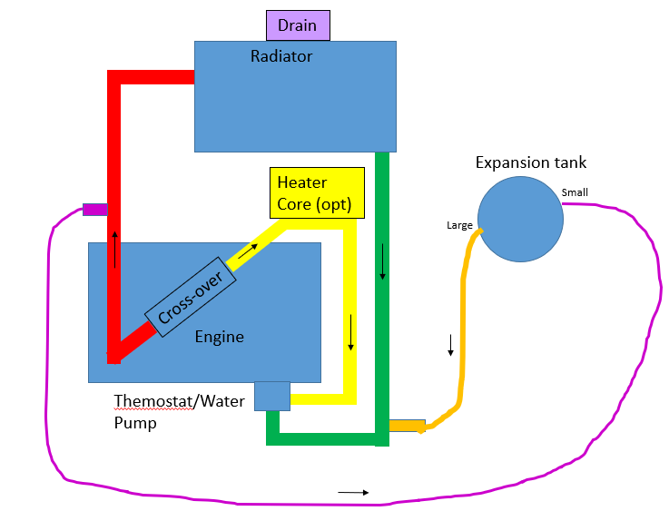

2. How did you route your coolant hoses to the radiator; did you go over or under the torsion housing? Do you have any pictures you could share?
3. Expansion Tank. I know I need one, but I don’t know much more about it than that . . .
- Where does it go?
- What size?
- How should I plumb it in – Coolant manifold side or Thermostat side?
- Tee in at the high point of the cooling system?
Here are a few pictures of my progress to date. Note that the white PVC coolant pipe is just for mock up purposes.
Interestingly, I found a Subaru dealer here in Michigan that gives a 23% to 35% discount on parts. They do provide shipping for a nominal fee. Here is a link: https://www.subaruparts.online/productSearch.aspx?...5627642738

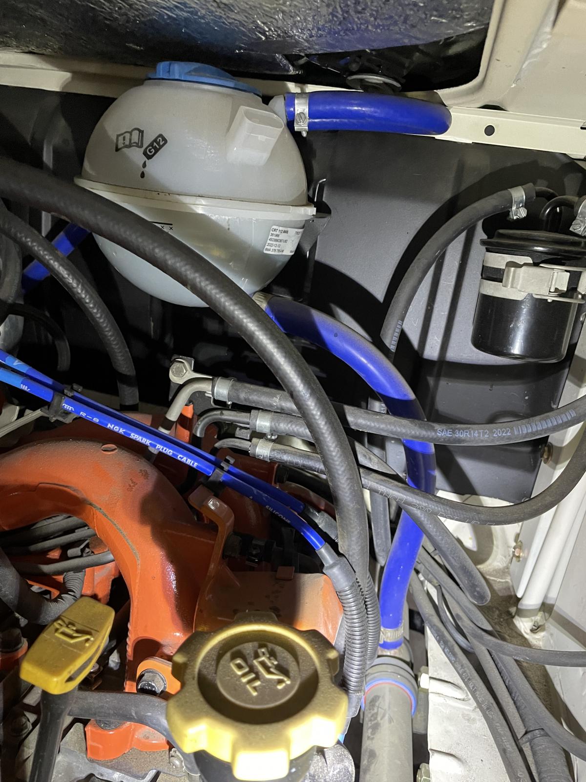

W1K1
Joined: March 04, 2004
Posts: 5264
Location: Southern AB
W1K1 is offline
PostPosted: Tue May 27, 2025 10:12 am    Post subject: Re: Subaru conversion Reply with quote
i bought 1.5" stainless exhaust tubing off amazon and built mine, i tacked it with the mig and a buddy tigged it for me
drivers side is the high side, tee goes to the top of the VW bottle
pass side tee goes to the bottom of the bottle

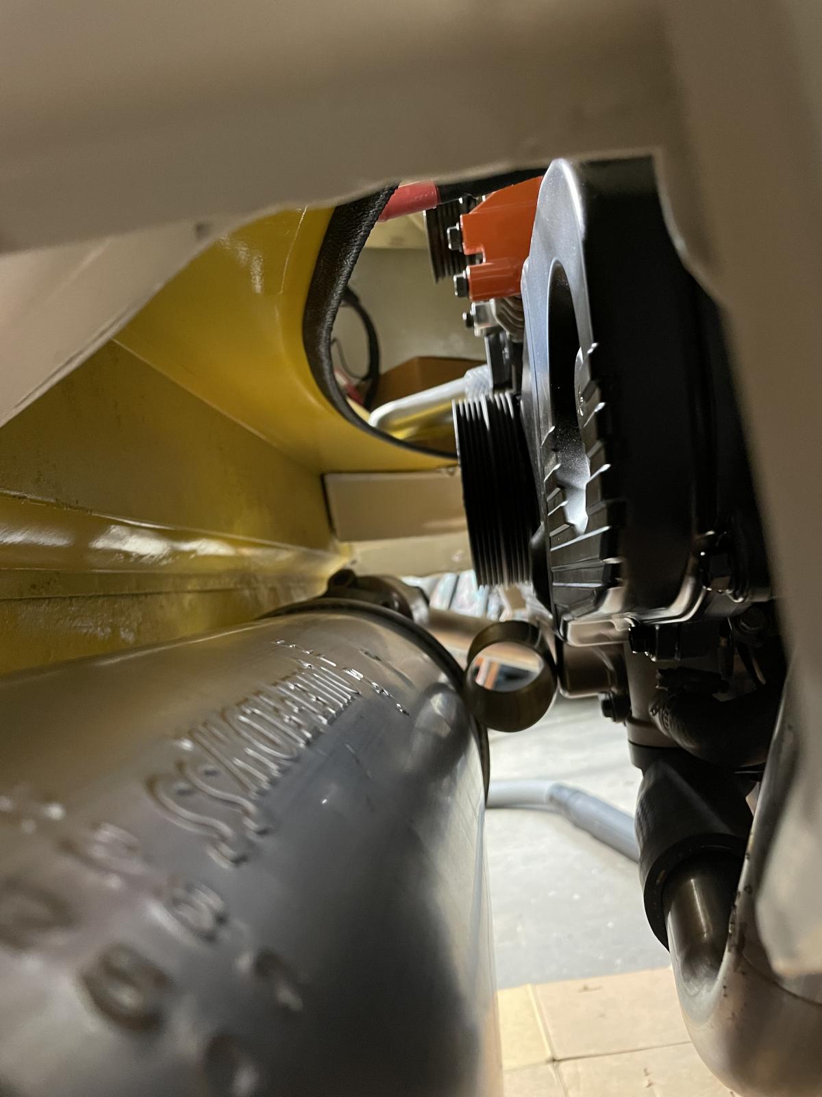

PostPosted: Tue May 27, 2025 12:32 pm    Post subject: Re: Subaru conversion Reply with quote
From page 1 of my build thread:
My build is not as "elegant" as others but functions well. I used the Subaru rad and fans out of my donor as well as the overflow tank. Used heavy duty marine exhaust hose rated for the temp, materials, and operating environment. Added 4 connecters: 2 at high points in the coolant lines for bleeding air that lead up to a filling point (with shut off valves) just under the rear access hatch and the other 2 at the inlet and outlet of the rad to install temp sensors, wired to aftermarket gauges to monitor temps before and after the rad. Added a temp/thermo (180F) switch in the outlet connector of the rad to control the cooling fans and ran the ECU fan control wires to the Small Car Code cheat board.
All coolant hose that touches metal (or anything else) is protected by 2" PVC pipe to protect from abrasion or damage.
Experimenting with where to run the coolant hose.
Dry run before adding the protectant pipe.

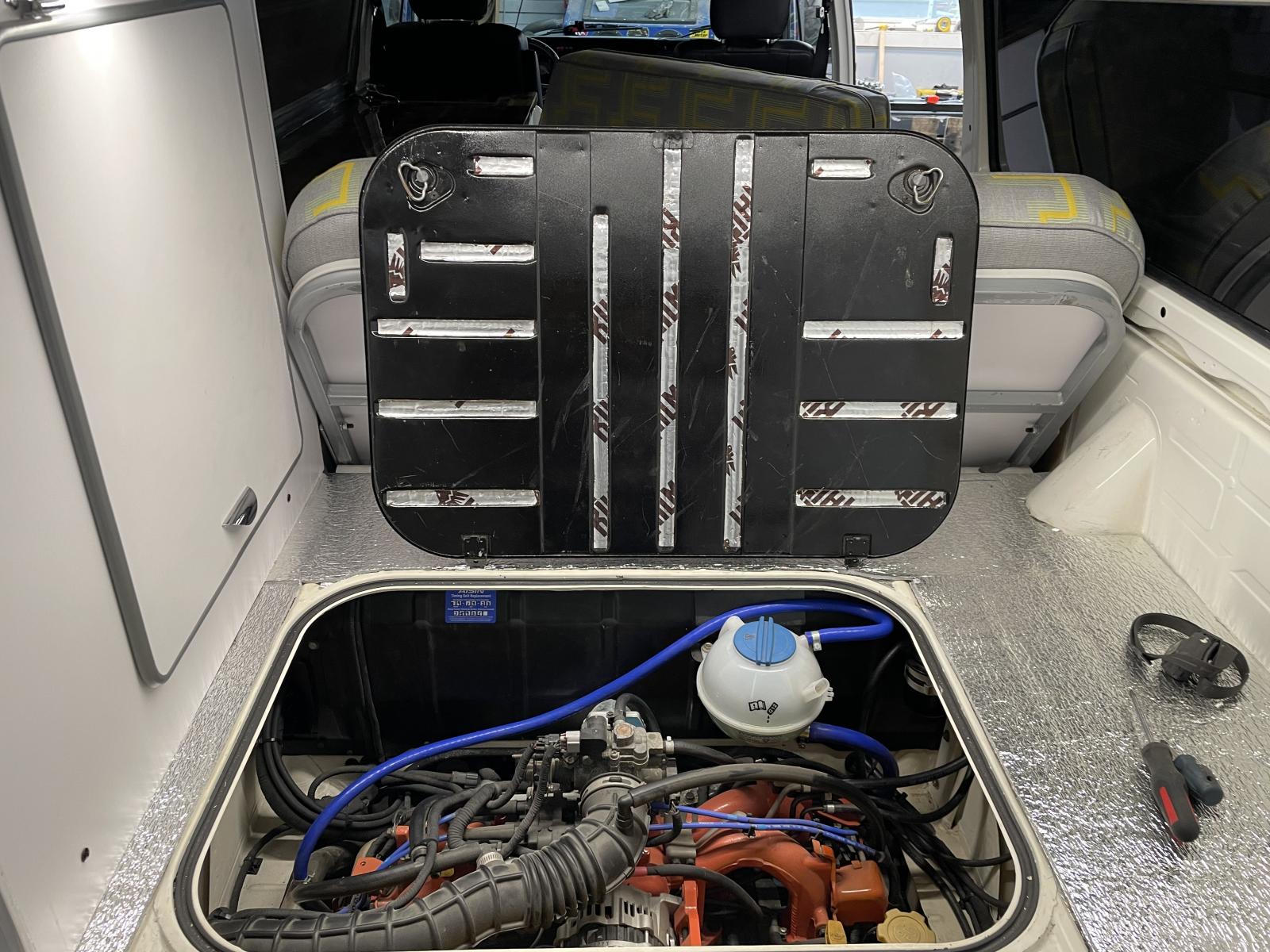

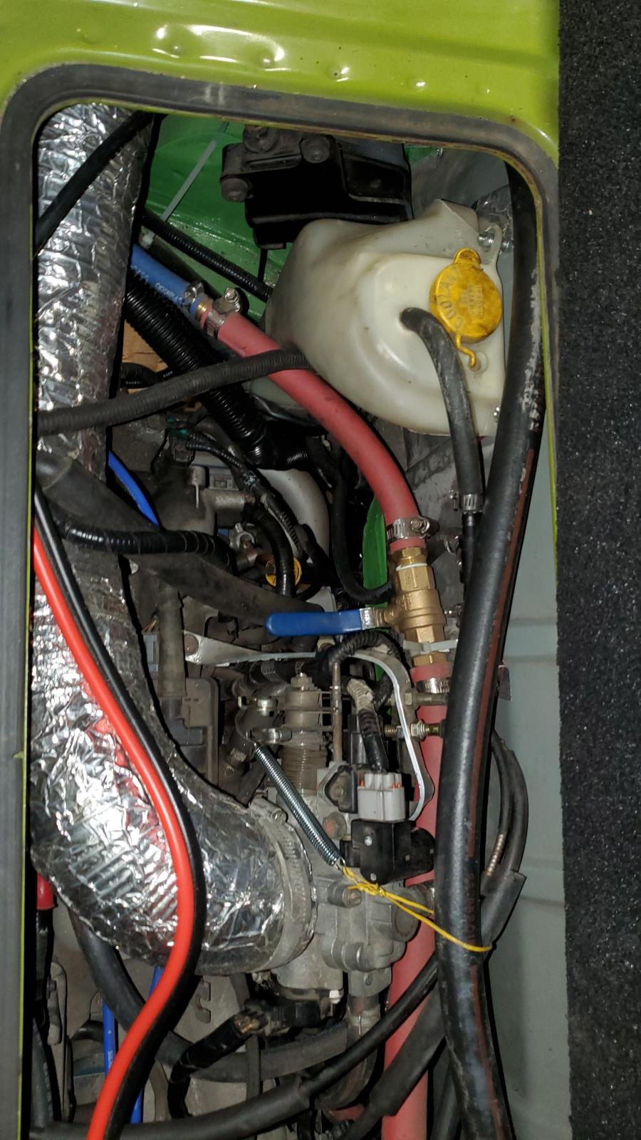

standard layout
make sure the red side is the high point of the piping so the air can escape, mount your expansion tank so you can see it and fill when needed. some mount it at the back hatch opening
my VW ball expansion tank is on the firewall but I have a hatch installed on mine, the LED light over the bed is handy for engine work as well
http://www.thesamba.com/vw/archives/manuals/jim_martin_engine_build.php
1973 super
1965 squareback 1500E
1971 bay window westy- subi swap
martyrg
Joined: February 29, 2004
Posts: 484
Location: South Lyon, MI. 48178
martyrg is offline
PostPosted: Today 11:37 am    Post subject: Re: Subaru conversion Reply with quote
I'm not familar with that ball shaped expansion tank. A couple of questions . . .
With the left side cooling pipe being the high point, then the blue hose going to the top fitting on the expansion tank is there mainly to vent air out of the system - is that correct?
The larger hose at the bottom of the tank handles the liquid coolant expansion and acts as a reserve to keep the system filled through the connection to the right side coolant pipe - correct?
Does this expansion tank use a pressure relieving cap that vents to an overflow bottle?
Is that the "VW Ball" expansion tank that others here on the Samba have referred to? Do you have a source for it?
jjvincent
Joined: January 11, 2016
Posts: 1418
Location: Bethlehem, PA
jjvincent is offline
PostPosted: Today 12:04 pm    Post subject: Re: Subaru conversion Reply with quote
It's probably this run of the mill VW expansion tank.
https://www.ecstuning.com/b-assembled-by-ecs-parts...gK-sPD_BwE
If you are looking to do the same thing but where it's a bit shorter and fatter, then get one for a VW Golf like around a 2017 model year.
