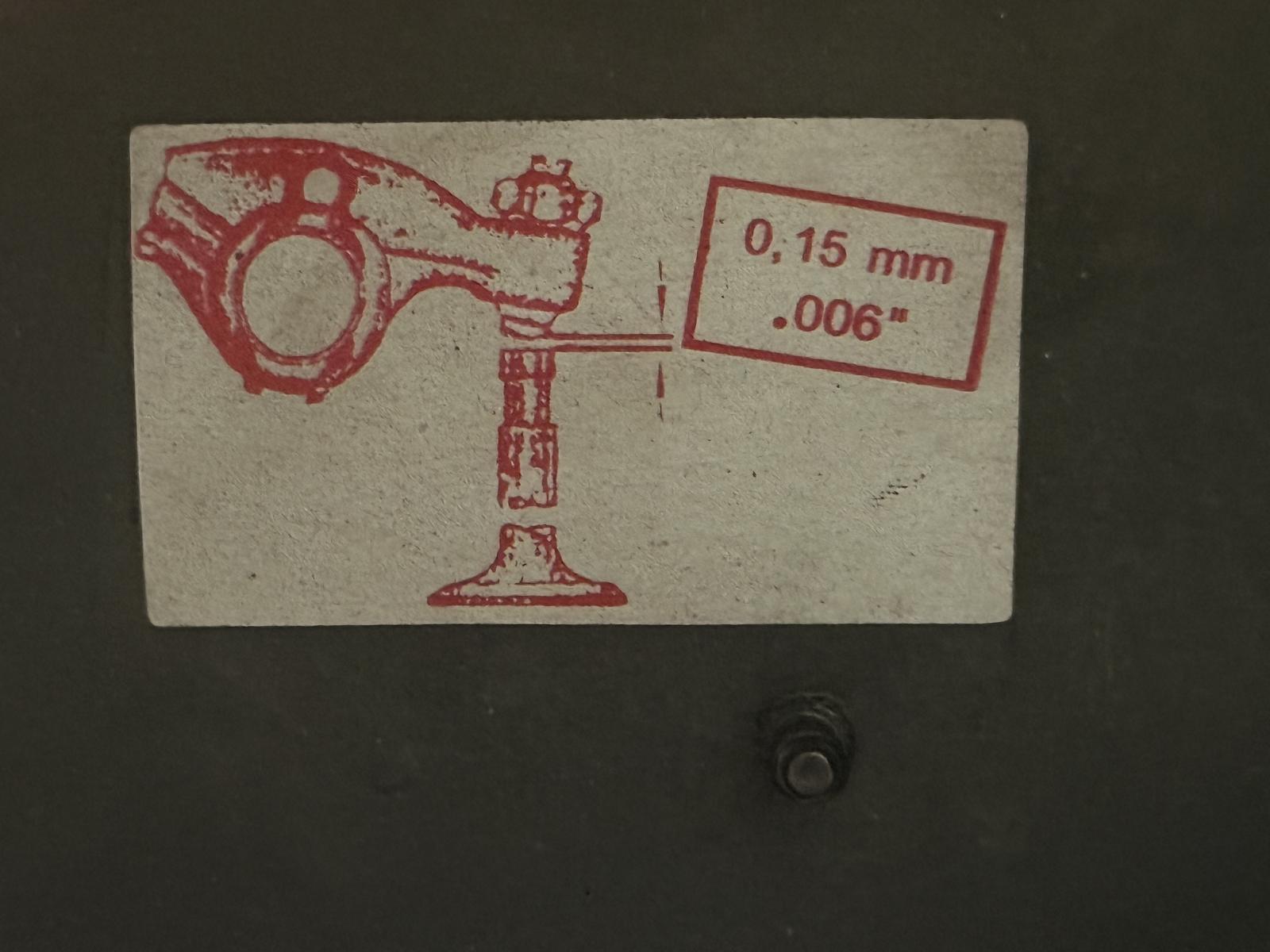

Has anyone adjusted the valves recently? See the sticker (top left side of engine housing in the video)

@77kafer - that sticker just shows the ideal gaps I think (attached), but the invoice from the "old school" vw mechanic says:
"Replace Necassary Worn And Loose |Electrical Connectors at Engine Ignition Coil, |Carburator And Alternator. Adjust Engine Valves, Clean Valve Covers And Replace Cork Gaskets (2)."
So I think the valves have been adjusted ok...

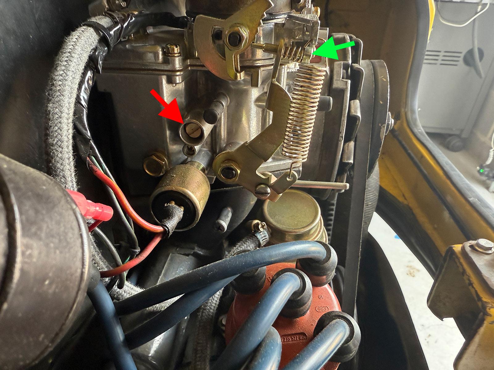

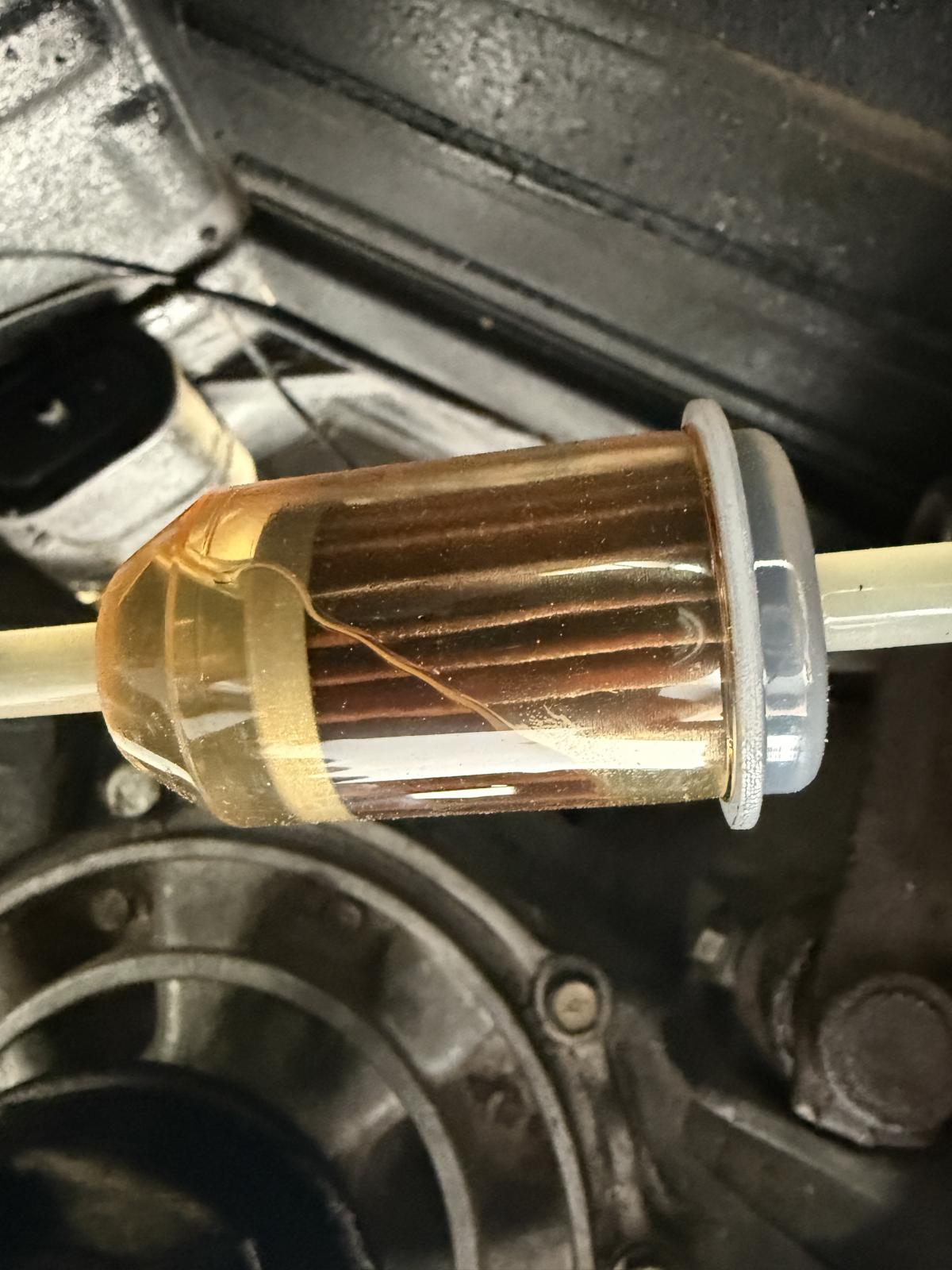

in your picture, the 'thing' in the side of the carb with the 2 red wires, below the red arrow, is the "anti diesel solenoid" to prevent the engine from running after key off.
It could be bad or very dirty.
Mine was gummed up severely bad, which caused stalling on stops, idle ran fine, driving was ok just stopping killed engine..

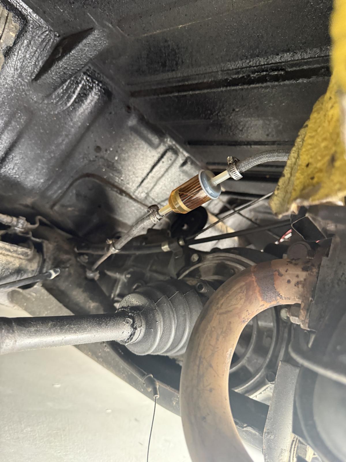

Also had major trash in the gas tank, prev owner had 'sealed' the gas tank but it was pre-ethanol sealer so the ethanol 'ate' it and I was getting
purple color fuel and rust bits in the filter to the carb.
Once all that got fixed the problem cleared.

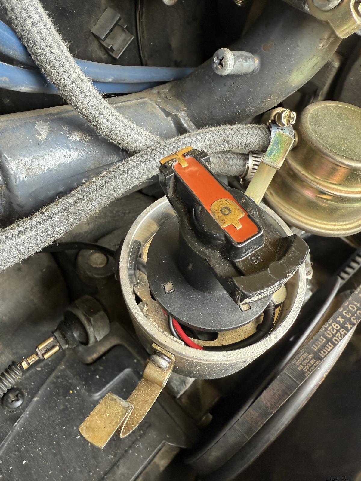

your underestimating your abilities.
a common saying, is if you think it is the carb. it is probably ignition.

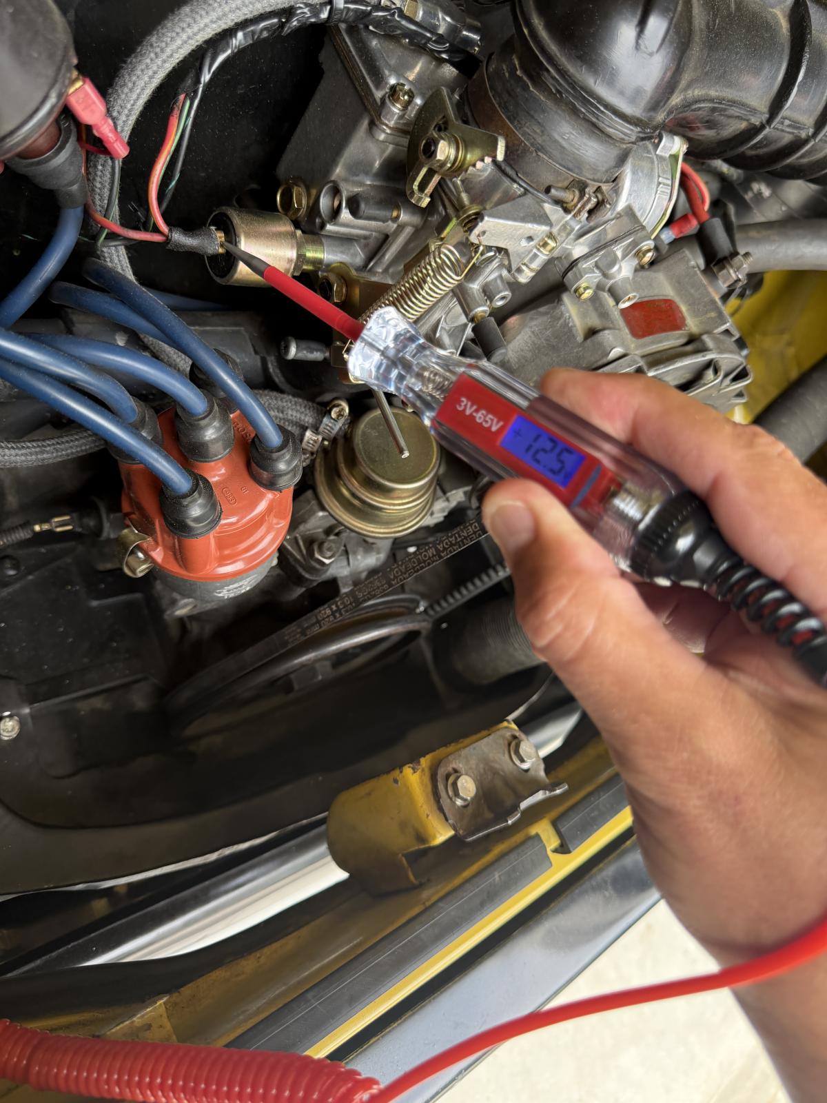

the cut off solenoid is pretty easy to check. 1st, does it get 12V with the key gets turned on. 2nd, with ignition off, take a jumper wire and jump 12v. you should hear it very clearly click.
if still in doubt, it is very simple to unscrew and test outside the carb.

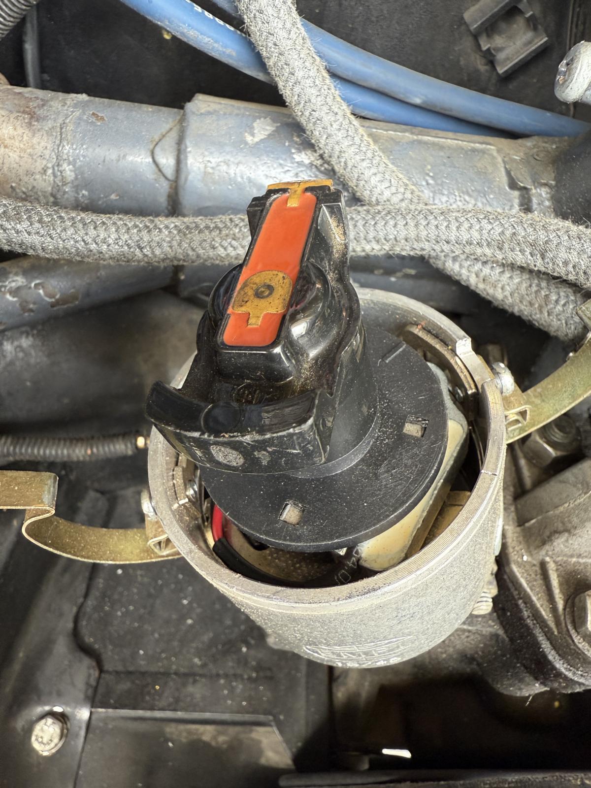

pop off the distributor cap. what does that look like inside?
check the easy stuff 1st.

@lqqkatjon.. ok.. see photos... the solenoid DOES get 12v when ignition is turned on and I attached a photo of the distributor with cap off (though it means nothing to me yet in life).
For step 2, you tell me to take a jumper wire and test 12v.. dumb question here, but is there a tool like my circuit tester (with an coiled cord) where I can clamp one side onto the + battery and touch the pointy side anywhere on the car?
Thank you for your patience.. I'll get there! (someday) (and be sure to help the noobs like me)
PS-@doublecanister - also attached photo of fuel filter (its under the back of the car near rear tire sort of). Seems like it's pretty clean to me...
