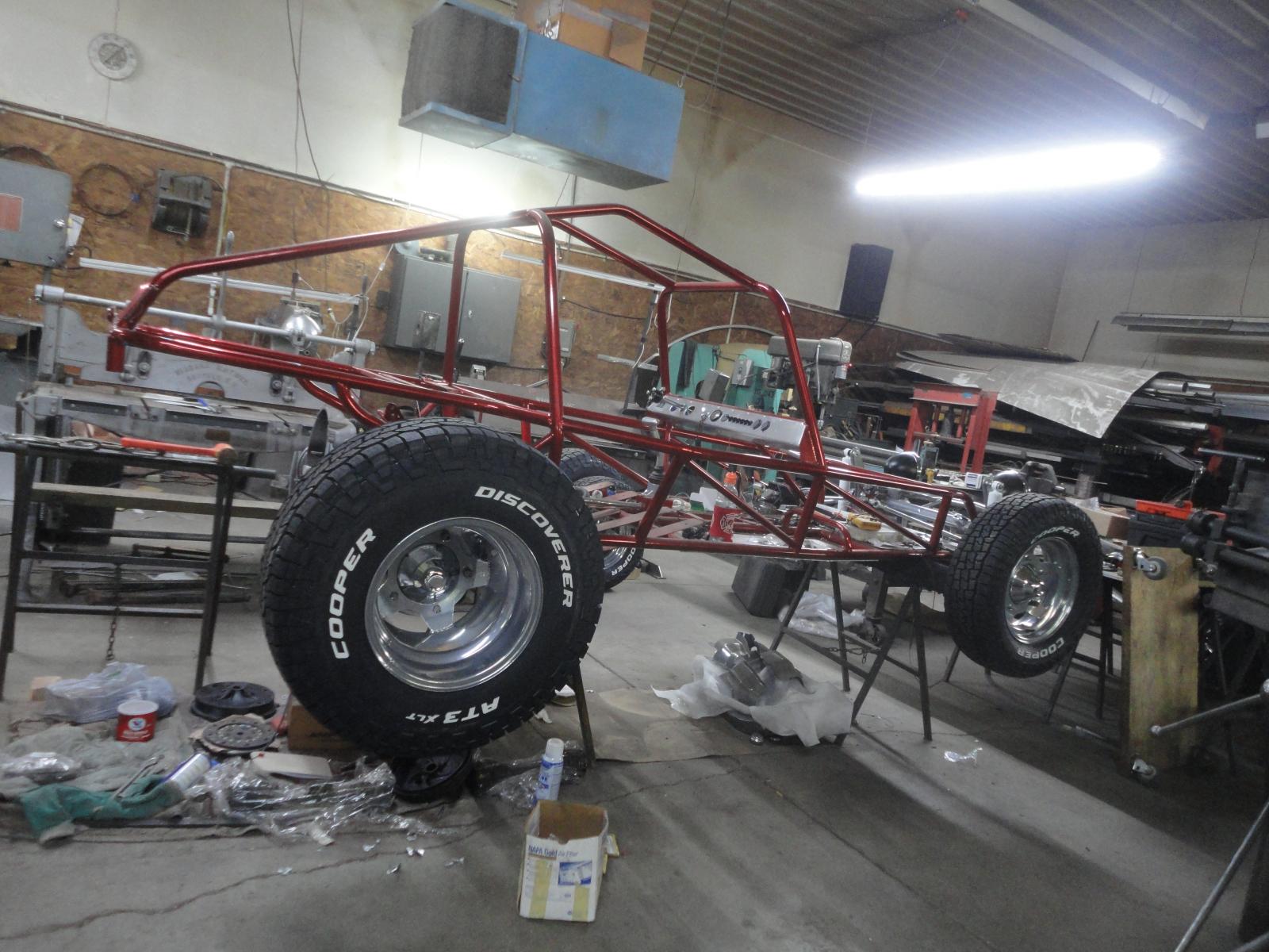

Skulptorchaz wrote:
Dasbliiwagon,
That is interesting!!! I am still contemplating what to do. I will look into that and see if I can find some. I assume they can still be bought. I'm hoping they also give the comparison.
Thanks!
A quick search finds AA Performance, Jbugs, and Dunebuggywarehouse has them available.

So, Wagon18, are those drums acquirable?
I'm sorry, I'm just trying to understand. I totally appreciate your time and help!!
Are the '72 onward still wide five? (which is the wheels I have on it.)
Thank you all!
Thank you all!
Chaz
Yes, all things have 5 lug wheels with LK 5 x 205 mm.
I´m thinking about one used drum, just for testing at first.
Find someone with a IRS thing, have a look, evtl. take one rear wheel off and do some measuring.
If it´s not enough, the shorter torsion bars and spring plates can do the rest.
https://www.csp-shop.de/raeder-bremsen/bremstrommel-hinten-501-615-181-13227a.html
https://www.seefeldt.de/de/bremstrommel-hinten-vw-...gLpSx_Pp7T
