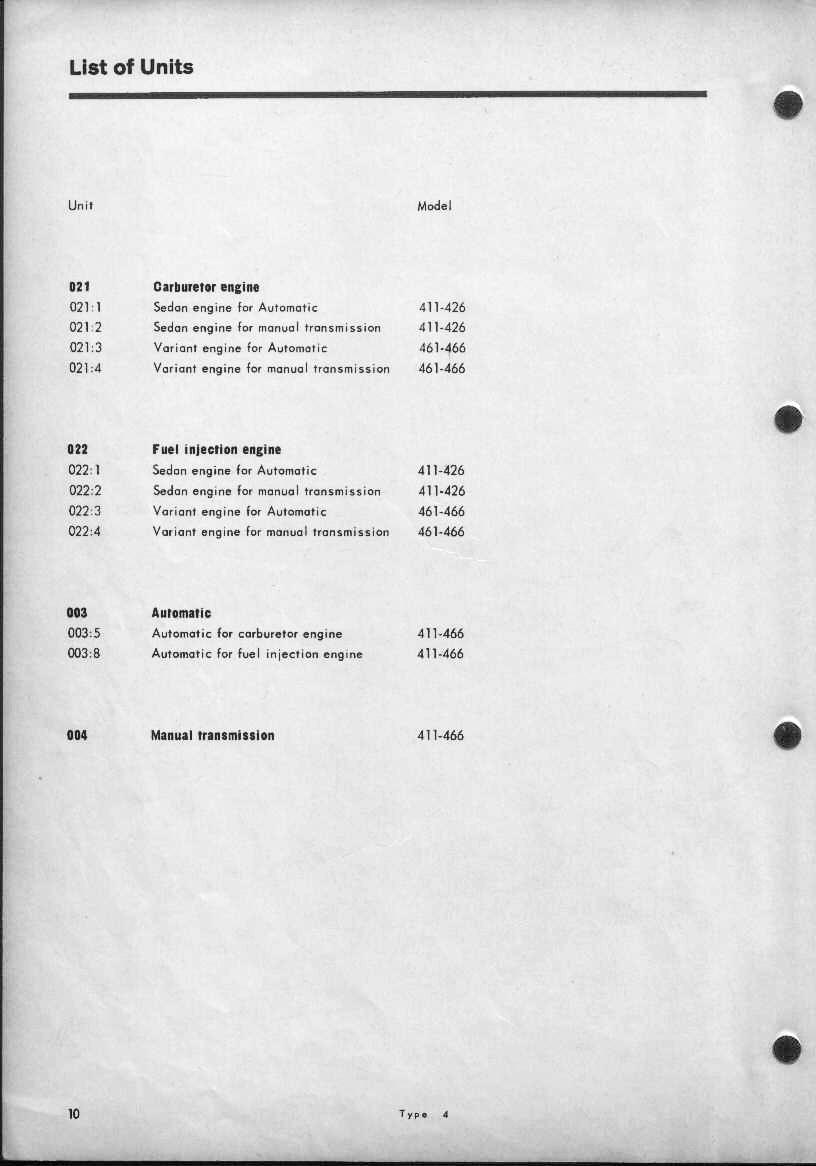

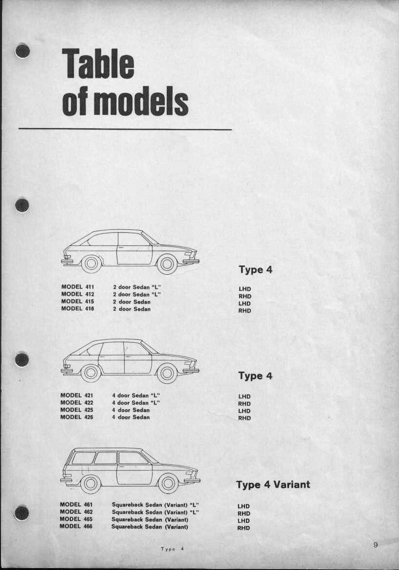

Sorry, I should have just posted these because it helps:
Here is the table of type 4 models:
This is the list of equipment/part number prefixes based on engien equipment class:
That one is interesting because it answers a few questions about part number prefixes in the parts book that appear to lead you to other VW CARS as the source of the part.
Ray

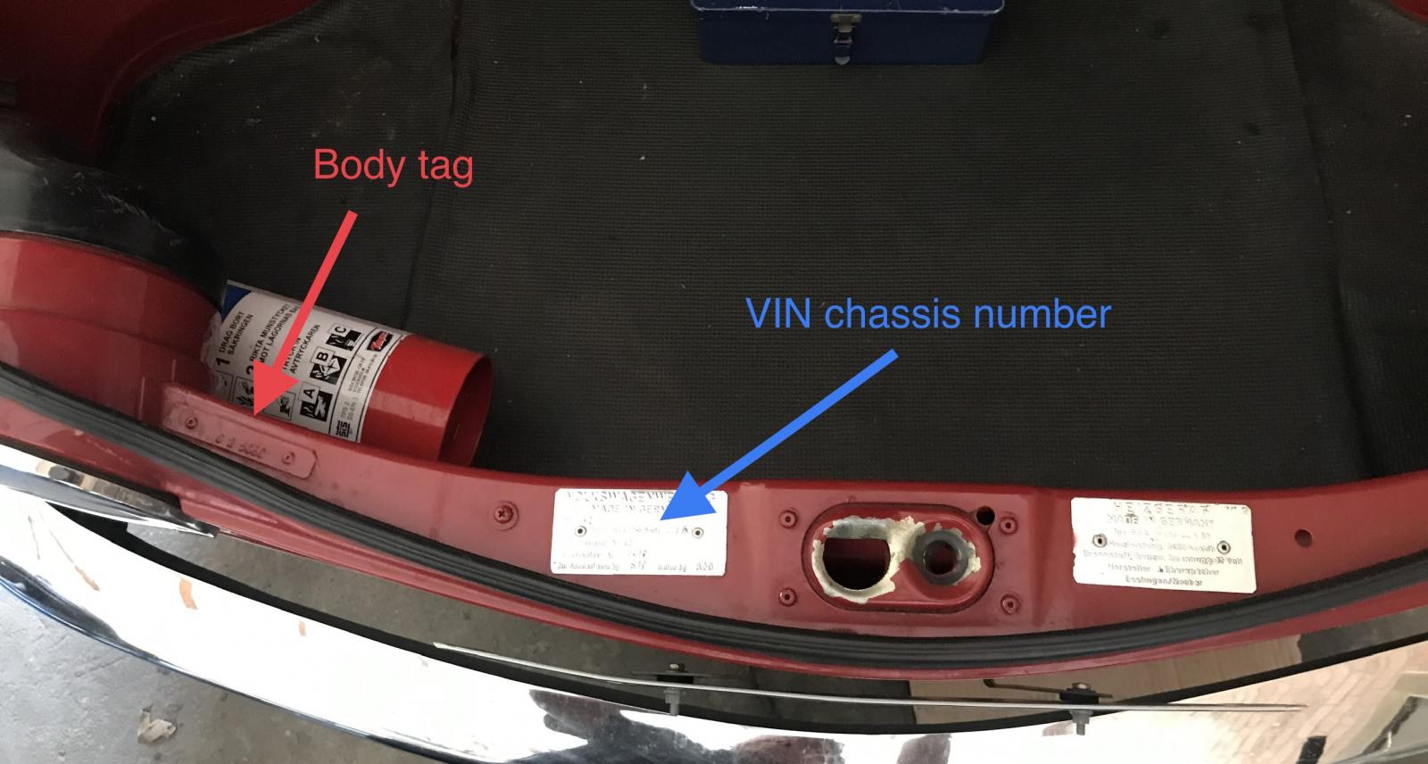

PostPosted: Mon Jun 02, 2025 1:32 pm    Post subject: Re: Strange Chassis number Reply with quote
Hi Greg,
What number show your body tag?
