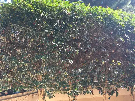

So after living in our house for 3 years there's something going on with our shrubs. In a previous post you can see the shrubs when we moved in.

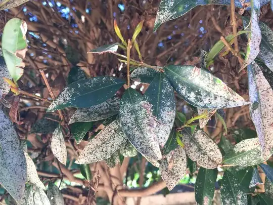

However now there are certain portions of the shrub that are not growing any more and the leaves have a white discoloration on them. (see pics) Is there any way to treat them (ideally I'd like a non-toxic solution)?enter image description here

Thanks Everyone for the posts. So here's the answers to the questions. I live in San Diego, CA so the climate is pretty mild here. The white discoloration cannot be rubbed off and the interesting thing is that there doesn't seem to be discoloration on the backside of the leaves only the side facing the sun.
I think may be the next thing to try is the fertilizer as recommended.

  • I don't the berries are correct to be a Photinia. @Bamboo now that you can see the berries, do you think it is still a Photinia. The berries of photinia come in bunches and are smaller is size. I can not tell if it is sun bleached or something is on the leaf. Does the white stuff wipe off? – GardenGems Jan 11 '20 at 20:43
  • What part of the world are you in, Schmudu? Can you please check beneath the leaves, and all stems, to see if there's anything there that shouldn't be, like insects or little shield shaped bumps - you might need a magnifying glass for the backs of leaves – Bamboo Jan 11 '20 at 21:39
  • @Bamboo seriously what do you think? Wouldn't you think if Photonia there would be a bunch of berries together. These come in sets of two. What do you think it could be if not Photinia? I'm not trying to discredit your original answer. Which was good for the facts it presented at the time? – GardenGems Jan 11 '20 at 23:43
  • If you look at the plant all the new growth appears to be nitrogen deficient hence the light green colour. – seedelicious Jan 12 '20 at 00:28
  • @GardenGems - there's more than one variety of Photinia - depending where the OP is, its possible that many berries either fell off or have been eaten by birds already. Need a close up really of the berries, but I still think its probably one of the Photinia. The leaves certainly fit with Photinia, as does the red new growth, but the most critical problem at the moment is what's wrong with it...its not the usual leaf spot. – Bamboo Jan 12 '20 at 00:42
    Can we get a close up picture of a leaf? – kevinskio Jan 12 '20 at 00:59
  • @Bamboo the reason I was trying to identify it, is to narrow down what might be going wrong. It always helps to know what the plant is. Do you really think I believe there is only one type of Photinia around? I use to sell Photinia by the truck load. None of them had berries like these. I thought perhaps you knew something I did not. Like I said was not trying to discredit you. – GardenGems Jan 12 '20 at 06:03
  • I want to know if it can be rubbed or removed or is it physical damage? – GardenGems Jan 12 '20 at 06:06
    I suspect an infestation - two possiblities, but it depends where the OP is in the world. – Bamboo Jan 12 '20 at 23:03
  • Looks like damage from either sucking insects or mites. – Polypipe Wrangler Jan 23 '20 at 09:36
If you examined the woody stems and can't find any shield shaped bumps attached to them, nor any other confirmatory evidence of scale insect, then I think this is a bad case of greenhouse thrips. The other possibility is lacebug, but the appearance of the leaves is strongly reminiscent of greenhouse (and other types of) thrips, though lacebug may be present too. If your weather was very hot this summer, greenhouse thrips would have thrived; it tends to attack mature leaves rather than new growth. It does not kill the plant (you can already see new growth at the top of branches which is unmarked) and usually, new growth is produced in spring on older stems if/when the old growth drops off, but it may be necessary to prune back to encourage new growth. Some control with oil based sprays such as neem is achievable, but monitoring during late spring and summer is a good idea to keep them in check by spraying when necessary. Further info here http://ipm.ucanr.edu/PMG/PESTNOTES/pn7429.html.
Keep your plants well watered during hot weather, as well as fertilising periodically during the growing season (but do not fertilize during late fall or winter).
For interest's sake, this link http://ipm.ucanr.edu/PMG/GARDEN/PLANTS/photinia.html lists all the problems Photinia are likely to experience, though it does not describe ways of dealing with them.
  • Bamboo appears to be correct. I found a video of the same damage on an Rhaphiolepis, closely related to Photinia. The damage is much worse in the video; https://www.youtube.com/watch?reload=9&v=Wj0uCtnMlOg ---Good Luck – GardenGems Jan 14 '20 at 22:41
This looks like a plant disease that has caused portions of the leaf to die, I suspect due to long term nutrient deficiency (nitrogen, potassium, phosphate).
Plants will sometimes sacrifice leaves in desperation to grow its fruit and seeds if it lacks enough nutrients.
3 years is a long time without any fertiliser for the plants.
Lack of nutrition leads to a weaker immune system.
You will need to remove the dead leaves as they are not helping your plants. Make sure you leave the un diseased new shoots and leaves intact to allow further growth.
And choose a simple fish emulsion fertiliser ask for (NPK 5-1-1) as it will have 5 nitrogen 1 potassium 1 phosphate which will be a safe dose when diluted with clean water.
mix a small amount of the fertiliser with clean water (1spoon per litre) and feed the plants by pouring it around the base but not on it. Do this for each plant once a month at first to avoid overdose as we still don't know the exact requirements of this plant. For that reason I'm suggesting a light dose to begin with, you will be surprised just how little a plant needs to maintain its size and health. Only do this during the growing season of that plant, Plants will not require any feeding during their dormant period(usually when its colder around winter).
Caution as it smells like bad fish so do avoid getting it on your skin.
Feed your plants. especially during their growing season, at the very least once a year.
If that does not help then it could be something beyond my experience.
As mentioned by @bamboo, do check for insect infestation as they would be treated differently by using very diluted neem oil. Simply mix a drop per 1 litre of water and spray all over the plant Caution as it also smells bad like rotten garlic!
