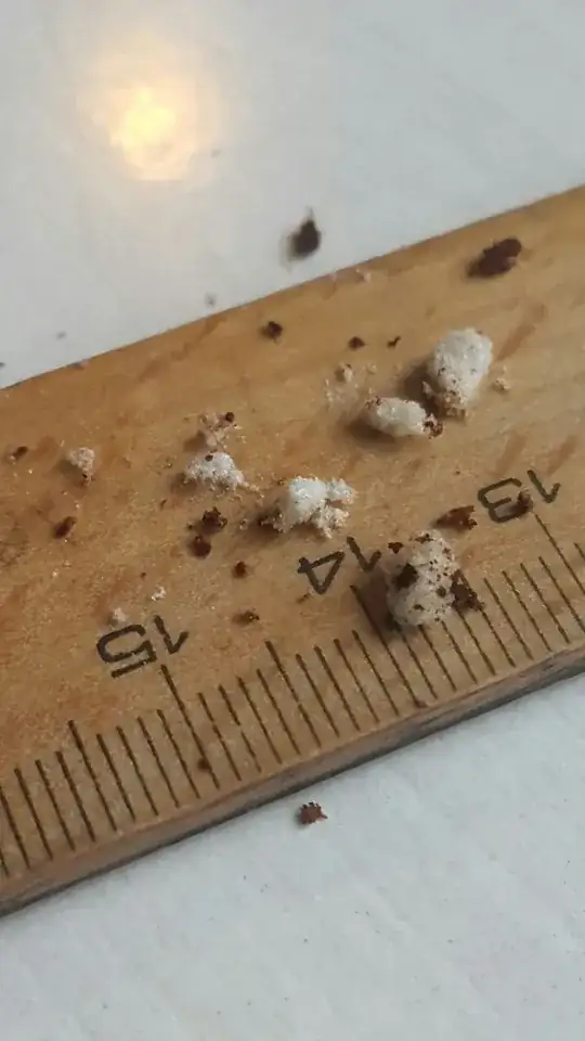

It has some white, salt like things in it, probably the minerals.
Figure 5: Minerals in the soil.
