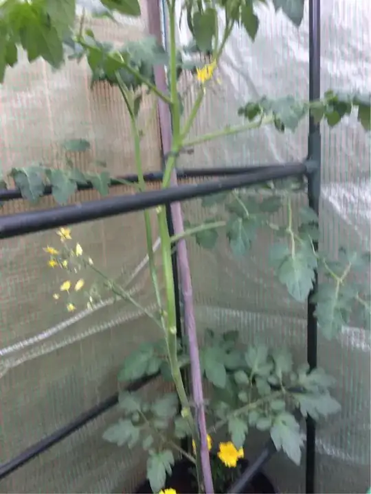

What I see is that all your plants are congested. Too much foliage, too smaller pots.
If it had been hot and you watered every day, the watering could have triggered the virus.
What I would do:
Trim your plants. Tomatoes have way too many stems. Take off the bottom stems unless you have fruits forming there. On the upper side stems, pinch or remove the small stem growing between the main stem and side shoots.
Same for all your other plants, too many stems. What your plants are doing is try to sustain stem growth, flower growth, fruit growth.... That’s exhausting and needs lots of water and nutrients to do it. These plants are hungry when less crowded.
Trimming will also bring air between the stem to avoid virus settling and fruits will be expose to more sun to ripen.
You must feed these plants with a tomato feed, high in Nitrogen.

Here’s a photo of my plants to give you an idea. I live in the uk where it’s not as warm as LA.tomato
