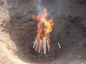

Open Pit Biochar
Open Pit Biochar Kiln

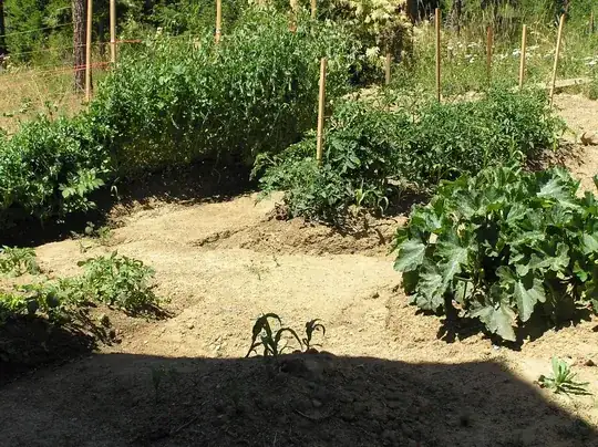

my caliche clay vegey garden first year
my caliche clay vegey garden a month later or so lets talk about commitment never had to dig again but boy howdy.  You bet I added a bit of fertilizer and decomposed organic matter...mostly to the top of the beds.
