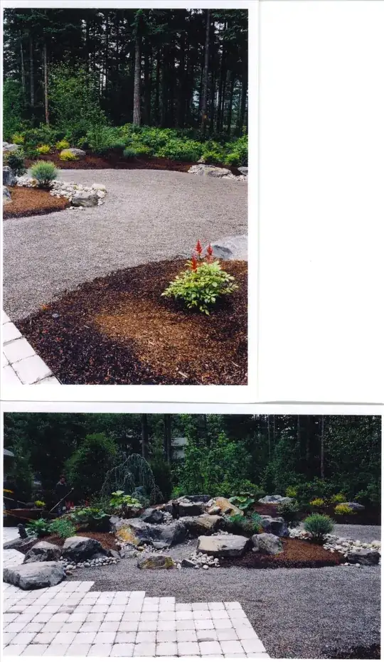

There are a few things you could do that would work; one would be a 'dry well' that collects the water to slowly be dispersed into the ground without creating mud out of the surface. This is pretty easy; dig a big trench in the middle of that lawn 10'X 2', install landscape fabric, fill with rounded cobble or 1 1/2" drain rock. Cover with landscape fabric and then more cobble. The water has a place to go, collect and still be allowed to filter through to the ground water system.
A little more expensive but not much would be turning this area into a graveled surface, 4" deep, using landscape fabric below the gravel. Rent a sod cutter, take out all of the sod (use that soil, mud and grass for creating plant beds), dig down another 2" use that soil on top of the piles of sod you've made into plant beds, use pt 2X4's secured with stakes where you need a clean edge, lay the landscape fabric down, install the gravel (5/8 or 3/8 minus crushed gravel no larger), use a compactor that you can rent and you'll have a nice new clean and usable outdoor room. gravel and cobble aren't boring
a dry well to drain a front yard that used to be a mucky mess
removed entire lawn elk were constantly ruining and put in gravel
  • wow, this is very nice work @stormy, this would be a little bit too much work for somebody with my skill set, – Jason Delaney Dec 18 '17 at 14:14
  • You are seeing too much then. You most certainly could fix this area correctly. Sorry, hate to say this, organic will not absorb moisture and fix this problem. If you spill something and throw paper towels on it and leave it there has the problem been fixed? A dry well is the cheapest yet very very effective way to solve your problem. I've got lots more pictures, almost all projects had drainage issues to fix top priority. Gravel is great. Dry wells are great. Organic matter will only make a stickier soup. Find out how much gravel is, LS fabric, rental of a sod cutter, compactor costs – stormy Dec 19 '17 at 07:02
