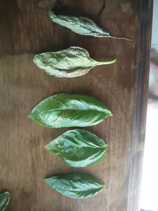

Stages of rotting
Image 1: These are the stages of the process. From left to right, healthy to dead. The last one is completely dry and often falls off just by barely touching the branch.

Looks like a heavy whitefly aphid infestation - they're usually underneath the leaves and suck the sap within, causing the leaf to shrivel and die. You can't treat with pesticide because it's an edible plant, so your only recourse is something like neem or insecticidal soap spray, I'm afraid. Further information on how to deal with whitefly on edible plants here http://homeguides.sfgate.com/kill-whitefly-basil-plants-killing-plant-40658.html

The leaf damage you are seeing is almost certainly thrips feeding damage, though it does not look much like the first reference here. For your next plant, you may want to replace the soil and clean the pot well (thrips can survive in soil). These may provide some places to start looking for a solution that will work for you.
http://mtvernon.wsu.edu/path_team/basil.htm#thrips
http://ipm.ucanr.edu/PMG/PESTNOTES/pn7429.html
