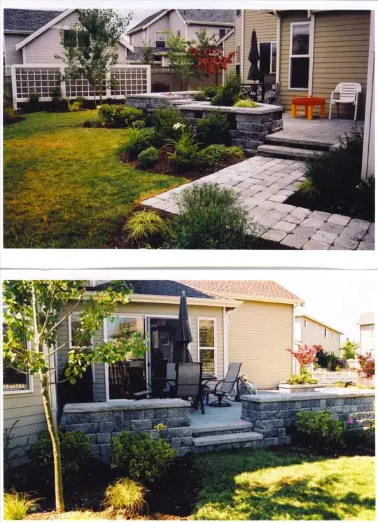

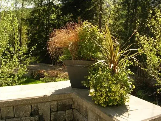

  • I take a different perspective on garden design to the others who have answered here. There's no right or wrong, just different opinions. I prefer the more complex original design with trees of different species. It depends on the style you prefer... minimalist or abundant? If you're seeing 1m shade now (in summer) this will increase to at least twice that distance in winter. If you're planning to grow vegetables I'd strongly recommend you avoid the back corner - too much shade - instead plant in the bed along the "sunny" fence. I like the "organic" rounded shape for your turfed area. – andrewbuilder Jul 24 '17 at 18:11
Fire pit and gazebo bottomsimilar screen can't tell there is garbage behindgarden wallI am sending pictures of screens that would be great for an espalier as well as break up your wall of fence. Also firepit pictures...also lawn edge curves, plant beds mounded...
screen to detract from fence and notice curves of set radius and notice garden walls made of CMU concrete modular units...and walkway
consistent radius mounded bed
  • The stone steps came with the picture of the firepit...great story behind the setting of those steps. – stormy Jul 22 '17 at 23:08
