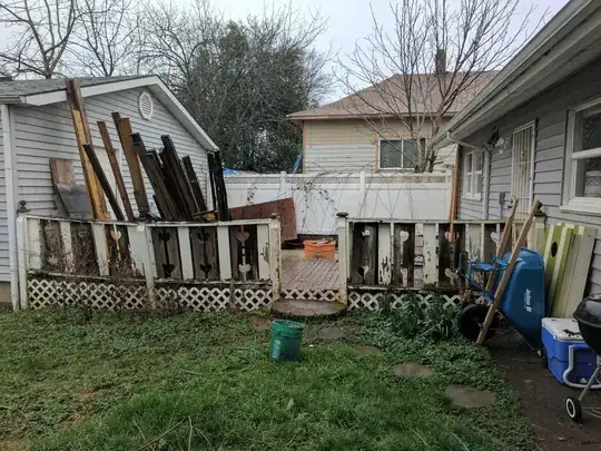

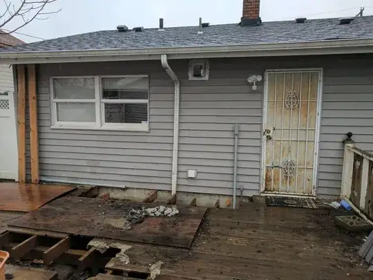

facing house

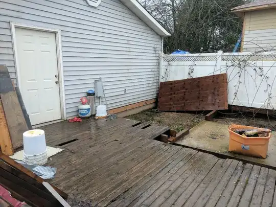

House&Garage1
House&Grrage2
facing garage
facing house2

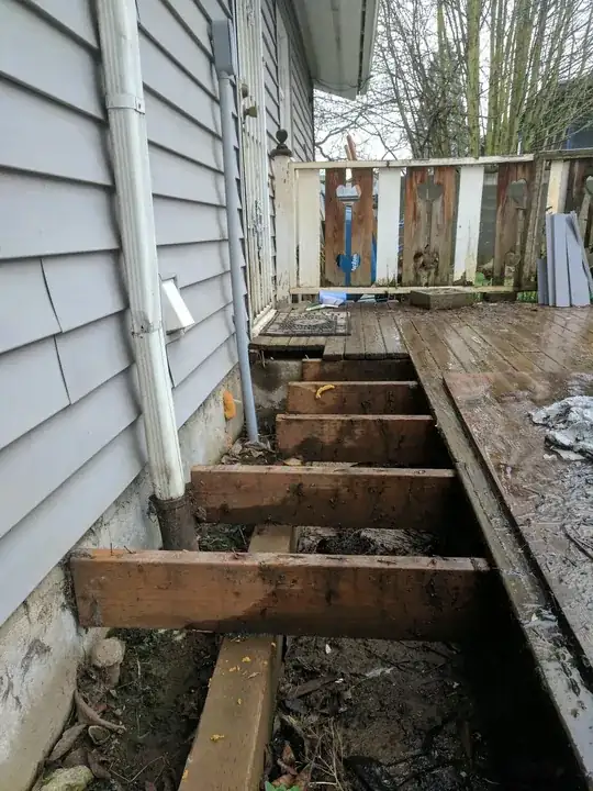

gap between deck & ground

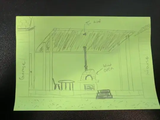

crappy mockup of pergola and patio

I think the most effective way would be to not fill it at all. How about a raised deck on concrete sono tubes if you are in a freeze are or deck feet in warmer climates?
If you change the grade you must ensure that any water runoff including downspout (gutter) water has someplace to go away from your house.
Raising the grade is a lot of work. To fill the area you could use stone dust compacted in layers. As a loose material you would have to have a retaining wall to prevent it shifting. This requires over 20 cubic yards ( 24' x 25' x 1' = 600 Cft or over 20 cubic yards). If you allowed for setting and compaction 25 cubic yards of material is not out of the question. At this amount you need a bobcat or front end loader and a compacter and a retaining wall that will need a base. It just starts to look like a lot of work.

  • For instance, where the heck is that water running to from the gutters? AAArrrrgghhh! No basement, check out your crawl space! – stormy Mar 09 '17 at 23:09
  • Thanks @stormy! I'm not entirely sure where the gutter drainage goes, but there is that pipe that all of the gutters go to. It is definitely not going into the crawlspace... I've basically rebuilt the entire inside of the home (myself) and have addressed any issues in the crawlspace and elsewhere. I will dig down at some point and see where those cast iron pipes go. I'm not sure if I'll have room for double doors on the house side of the patio. The kitchen counter and fuse box limit that wall to a single door. The garage side (my shop) will have a sliding barn door, tho! This side is facing NW – tbox Mar 12 '17 at 20:47

  • The outlet that is there and covered can be moved at that time to a better location allowing more room for a wonderful door. Later we could talk about a covering such as the one in your picture...your 'cabana'? – stormy Mar 13 '17 at 19:10
