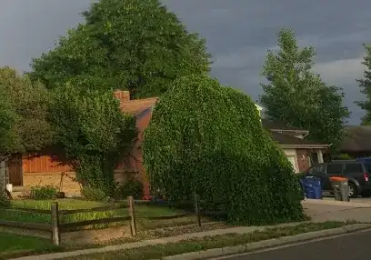

We have a wonderful weeping mulberry (Morus alba pendula) (male, so no fruit) in our front yard.
It's massive - probably 15' tall and at least that diameter. The problem is that it's growing larger and larger - every year it sends out a new layer of branches that hang over the previous ones, so the diameter increases. I'd say it's a good 3' larger in diameter than it was when we moved in 9 years ago. The fence used to be visible here, and the sidewalk was clear:
giant tree
At this rate, we won't have a sidewalk in 5 years. What's the best way to get this under control? It's mostly dead wood underneath. We've had a couple arborists out and asked about it and gotten nothing more than "just leave it alone", which unfortunately isn't working anymore!

Oh my goodness. Do you understand the treasure you have? Find a master pruner to create a covered walkway! How wonderful. If you destroy this tree I will haunt you when I am dead! (Grins). That tree should not be getting taller at all. Weeping trees are two trees grafted together; a prostrate variety of the same species grafted on top of an upright variety. The prostate part of the tree grows laterally, horizontally...not vertically. What was the height when you purchased this specimen?
I am drooling to come prune this tree and make an incredible pergola for your entrance. Are there any covenants from your division that concern 'line of sight'? This should be done in at least two or three prunings, not all at once. Nothing but hand tools should be used! An arch is made but set behind foliage that covers the cuts. Then creating an arched pergola to the house. A really good pruning artist will take a couple of years. And at least teach you how to prune this tree and the necessary steps that follow; thinning to allow more light and pruning to encourage denser growth behind the 'water fall' of foliage to make a denser structure. )
Just cut regularly the bottom green part (just like the ruminants).
But I would also consider to remove the entire tree. (No more, after reading Stormy answer).

Easy way:
  • two stakes with a level line between them and a sharp hedge trimmer
More work
  • pair of pruners to cut the branches back off the ground. Cut back to a leaf node
Just cut it back. Branches growing on the ground may root but will definitely kill off the grass and provide a hiding spot for small animals including skunks, rats and mice if they live in your area. Repeat once a year or when it starts getting too low and that's all you need to do.

I suggest two approaches:
1 Umbrella look
Umbrella haircut
This is simple, you just cut everything below set height twice a year.
2 Pedestrian tunnel
sophora tunnels
The tree in the image above is a Sophora pendula, but it doesn't matter, it is just for illustrative purposes.
You could train (by staking and pruning) your mulberry to 'jump' over the sidewalk, and by doing that you would create a tunnel for people strolling down your street.
Your tree would become a major conversation topic in your area. :-)
The dowside is that in 7-8 years, the tree would start growing in traffic lanes.
