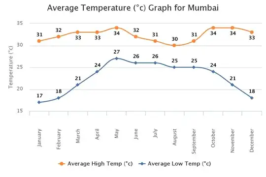

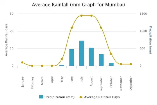

Mumbai Weather Information:
Average Temperature Graph for Mumbai enter image description here
