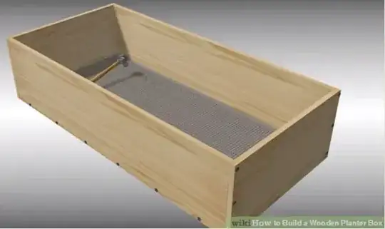

I have to build some 6' x 2' planter boxes, I'm not sure what's going to be planted in them; probably "garden-y" stuff like oregano, basil, etc.
I know how to build things but I know nothing about plants except that every one I touch dies (I even killed my cactus).
I'm basing the boxes on instructions I found here:
My questions are:
  1. How big should drainage holes be and how far apart should they be spaced?
  2. The screen at the bottom will be vinyl, nylon, or some other inert plastic. How fine should the screen be? Does it matter?
  3. How deep should the boxes be? I don't really care about minimizing volume, I just want to make sure the plants have a nice place to grow.
The box will be cedar (non-treated). Underneath the boxes will be a few inches of open air, then concrete.
I'm assuming the person I'm building them for will be filling them with a bit of gravel and some soil.

That looks good and of a decent size. If you're growing herbs depending on what type e.g. Mediterranean requiring good drainage I would expect to have about 12" depth of planter or thereabouts. That can give space for about 2-3" of good sharp drainage. Less drainage can be used if growing herbs that require a more moisture retaining soil. The container can also be used for small alpine plants as its deep enough to not dry out too quickly. The drainage holes about 9" apart across the bottom, but avoid where you think the supports will be placed, and approx 3/4" in diameter. The screen at the bottom? What is this going to be made from? Marine ply perhaps? If this is to be a mesh of some description make it a fine one so that the drainage doesn't drop through and get wasted.
  • Box will be untreated cedar. Screen is vinyl, nylon, or some other inert plastic. It sounds like just a plastic window screen will suffice? – Jason C Mar 04 '16 at 21:44
    That will do the job very nicely –  Mar 04 '16 at 21:48
