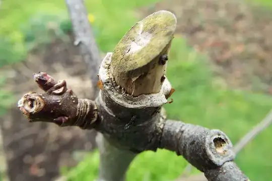

This has happened to one of my apple trees over the past few years, I'm now concerned because it is happening to other branches and there is very little one year growth on the tree. This is the shape of the tree, and ringed in red are the branches that are affected. enter image description here Does anybody have any ideas what might be causing this?
ringed tip
Here's another picture from a different angle, clearly showing the cambium layers and the profile of the edge on them. Nobody else has pruned the tree to our knowledge, could an animal have caused this type of damage? close up of 1 Here's a shot of the same damage having occured to another branch another inflicted branch

    Was this pruned? The cut looks mechanical especially around the bark line. Has the tree been pruned and then the inner cambium layers grown taller that the surrounding bark? –  Feb 29 '16 at 17:00
    I also think it looks pruned, but the angle on the cambium layer and the bark is not the same. Would it grow that way? Or would that indicate separate cuts for the two layers? – michelle Feb 29 '16 at 21:10
    The vascular cambium affects thickening of the stem and would not create a 'growth' like seen in the photo. I interpret the photo to show a stem that was pruned at an angle and that something or someone subsequently removed the bark to a lower level. That, in itself, wouldn't be a problem. –  Mar 01 '16 at 06:51
    I agree with the others, it wouldn't subsequently grow like this once pruned. Do you have someone who has access to your tree to prune it without your knowledge? –  Mar 01 '16 at 08:19
  • Do you have a picture from the opposite angle? – Escoce Mar 02 '16 at 15:21
  • @Rosie judging from the third photo, all the cambium layers have been damaged – Nic Mar 06 '16 at 14:47
    Could this be the slanted pruning cut followed by the shrinkage of the outer layers? –  Mar 06 '16 at 19:02
  • Have just seen your latest picture. Am still not sure to give a definitive answer, but I still think it may be mechanical damage. If you are a member of a horticultural society e.g RHS, they do an ID service for bugs etc., others may run this service if you aren't in the UK. you could try sending in into them –  Mar 07 '16 at 22:20
  • What part of the world are you in, Nic, and when were those pruning cuts, where the collar is missing, made, I mean what time of year particularly? – Bamboo Mar 08 '16 at 12:00
You have this kind of wounds of your apple tree because it was not pruned correctly. It cannot heal at the tip of the cut, so you must cut close to where the other buds or living branches are.
Opposite to other trees, you must cut very close to the buds.
Here is how to prune: very close to the parts that will go on handling life in them.

    I would say that apple is not particularly unusual in it requirement to cut close to buds. All woody plants will die back towards a node. The image on the left looks a little too close and the angle a little too steep. It's too close because there is always a small amount of dieback which in this case would threaten the cambium around the bud. It's too steep because it exposes and unnecessarily large amount of wood - the main purpose of angling a cut is to shed water which would be achieved with a cut half as steep. – George of all trades Feb 07 '17 at 14:18
