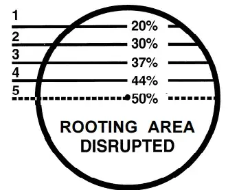

4. Walking toward the tree - percent of rooting area disrupted
  • enter image description here

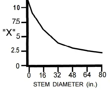

7. Root plate radius (in) (stem diameter (in) times "X")
8. Structural Critical Rooting Distance to Minimize Catastrophic Tree Failure. Root plate size (i.e. pedestal roots, zone of rapid taper area, and roots under compression) and limit of disruption based upon tree diameter at 4.5 feet above the ground (DBH). Significant risk of catastrophic tree failure exists if structural roots within this given radius are destroyed or severely damaged
