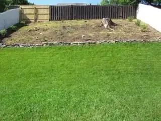

2010-11-01, Before Willow tree and area was cleared
Willow tree and overgrown garden area
2010-11-05, After Willow tree and area has been cleared
Cleared garden area
