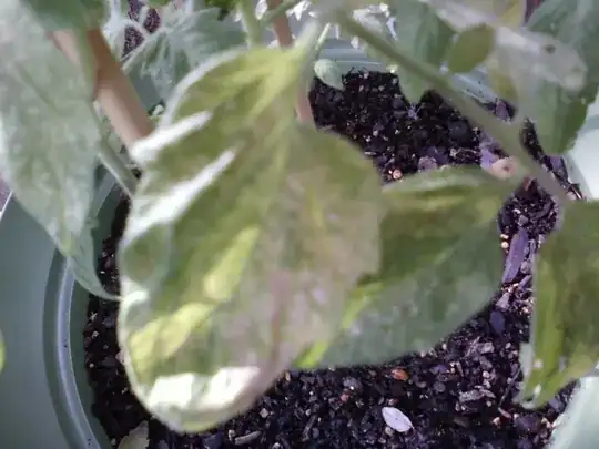

I have a threesome of tomato plants planted in on my porch. All three have some leaves that seem to be a bit white and powdery. One of the leaves has even started to turn a bit brown.
I don't think this is blight, I'm pretty sure I know what that looks like and it doesn't seem to be a watering deficiency/too much water as they are in self watering containers and I really only ever water from the bottom.
My biggest of the 3 plants seems fairly unaffected although a couple of its lower leaves seem to have some of this discoloration.
However the other two (on either side of the first) seem to have the discoloration on the leaves. Its mostly the lower leaves. Is this something to be worried about or is it normal? (pics to come if needed)

This is almost certainly Powdery Mildew (see Figure 3, here), and a severe attack can weaken a plant considerably. Tomato powdery mildew is apparently caused by two different fungi, Leveillula taurica (Oidiopsis sicula) and by Erysiphe (Oidium lycopersicum), and tomato leaves that are affected by the second variety don't develop any yellow spots; given that yours have not shown this symptom, it's reasonable to assume that they are affected by the Erysiphe type.
Control Measures
  • Removing old leaves from the bottom of plants reduces disease from both fungi, often to the extent that no other control measure is needed.
  • If symptoms develop early, multiple, early applications of wettable sulfur or dusting sulfur will prevent new infections. Sulfur should be used with caution on young foliage at temperatures above 90°F; read and follow label directions.
  • Applications of other contacts such as potassium bicarbonate products and oil sprays will kill the existing mycelium and spores on the leaf surface and are most effective when disease is in early stages.
