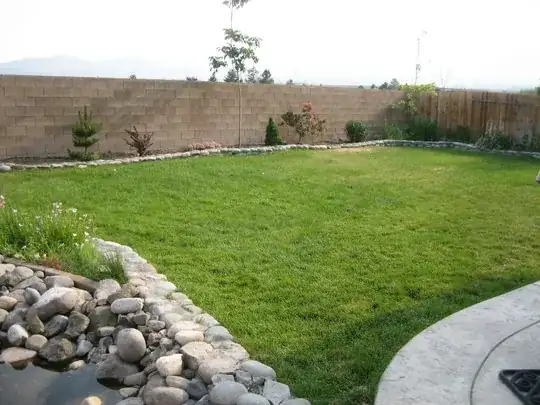

I have a depression on the side of my lawn where rain and sprinkler water collects. There used to be a plastic lined pond and a lot of rock (for the last 5-8 years) that I suspect blocked the water from draining properly on that side. I'm going to replace that pond with a decomposed granite (DG) patio with a concrete curb separating it from the lawn. Once I compress the patio, I worried that it will cause the same blockage, or it will affect the patio in some way. So my plan is to install a drain under the new patio, with the inlet and dry well under the depression. The only problem is that the depression is almost as low as the side of my yard where the water needs to go.
I think my options are:
  1. build the depression up a little bit so there's a slope
  2. dig the side of the yard down a bit and fill with rocks so it can percolate up or
  3. drain to the other side of the lawn (70 ft) where it appears to be lower.
And are my assumptions about the patio blocking the drainage or being damaged by it correct?

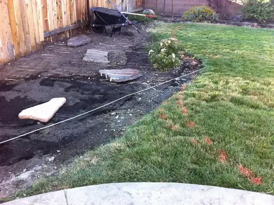

the string represents the proposed drain pipe
The string represents the proposed drain pipe (there's no existing drains or they're hidden very well and clogged). When it is taut, there is no slope.
Clarification: A level DG patio will take up the majority of the dirt area in the photo. That used to be a pond. The orange paint is the path of a proposed concrete curb.
Wider (older) shot of back yardenter image description here
