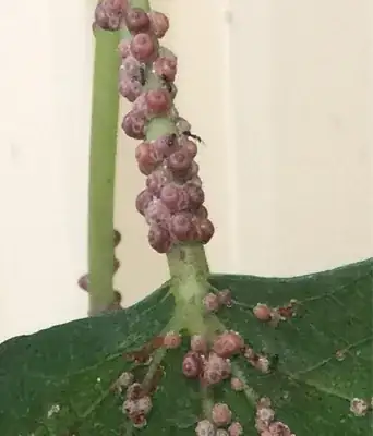

Just noticed this on a fig tree and these are everywhere. It's not just on the leaves but on the stems as well.
Is this an ant colony on this fig tree, Or something else?

You've got a bad infestation of fig wax scale. The ants are there for the honeydew, and are ant-farming.
You want to get rid of the scale, they're basically living off of your plant, using up resources. If it's a small plant, you can use a pen or other pointy thing and pop as many off as you can, onto a small drop-cloth, to be destroyed. The rest can be treated. From kevinsky's answer here:
  • Make a mixture of 5 to 10 ml of dish soap of any brand and one liter of water. Mix but do not make it too frothy.
  • Get a soft toothbrush or soft scrub pad and dip it in the solution and rub off the scale rinsing on a regular basis.
  • Once you are done, wait a few minutes and wipe all the areas you have covered with a clean cloth to remove the soap.
  • Repeat at least twice at six to seven day intervals to catch the ones you missed.
  • Consider repeating this process as required as this scale is hard to control.
If you have no patience for this you could also try buying a systemic insecticide like Cygon 2E, read the instructions, put on impermeable gloves and appropriate safety gear, prepare a two liter solution according to the instructions and pour it into the soil. A solution that is more dilute than recommended should be tried for the first application to see how the plant responds. As most pesticides smell you probably want to do this outside and catch the water that flows through the pot for safe disposal.
You can use other chemicals as well. I've successfully used dinotefuran (2-methyl-1-nitro-3-[(tetrahydro-3-furanyl) methyl] guanidine), a systemic insecticide (this mean the plant takes it in, transports it throughout, and that poisons the scales through feeding).
You may also want to read UC IPM's scale management article.
