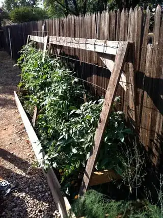

I used fence pickets and hog wire to make a tomato trellis:
Click image to enlarge...
I like the trellis better than a cage for two reasons:
  1. Easier access to tomatoes as they grow
  2. More stable than a cage
I hope this helps!
