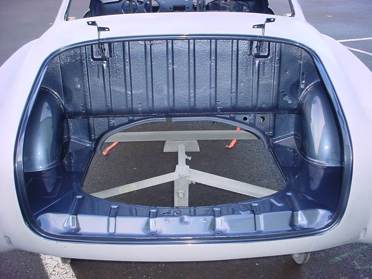

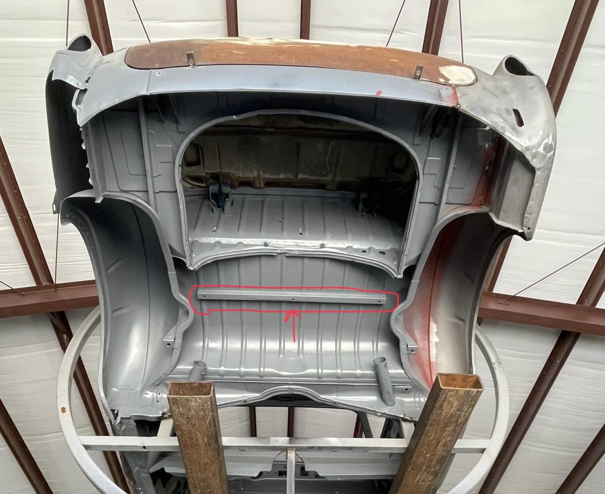

In this pic Iâve borrowed from WrennMetallWerks, you can see a support brace for the rear luggage floor. When did Ghias get that? My 65 does not have it. The car in the pic seems to be a 66 or later model.

This photo on page 1 of the thread, based on the dash, would indicate it's a pre-66 car, as 66 didn't have the small radio opening or the in-dash ash tray.

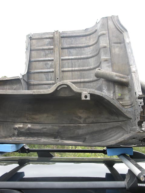

You're right! And from the battery tray discussion we had, the tray looks like a 63 or older version. So, this is a pre-64 car. Then, was this brace present on all 63 and older cars? I don't see it listed in the parts manual which only has one part number for rear factory floors up to end of MY1967.
Update: I found a pic from the gallery from a 57 lowlight which has this brace:
And a user on FB commented that his 62 has the brace. Wonder when it stopped?

Wonder if there was some change made to the panel that resulted in it being stronger and not needing the cross brace. Is the profile or depth of the bead different between the two?
To me it seems the profile was a bit more circular in the earlier cars with the later being a bit more squared off. But that difference may just be from the angle/lighting or other photo artifacts.
Here's a pic from a 64 showing the brace and what seems to me like circular profile for the beads.

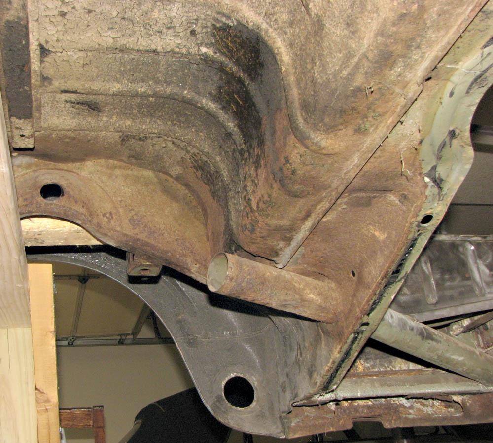

65 Seems to be the first year without the cross brace as seen in this pic (no my car)
There are also 3 extra beads vs the 64-earlier luggage floors.
The beads on the firewall seem to have a more squared off profile

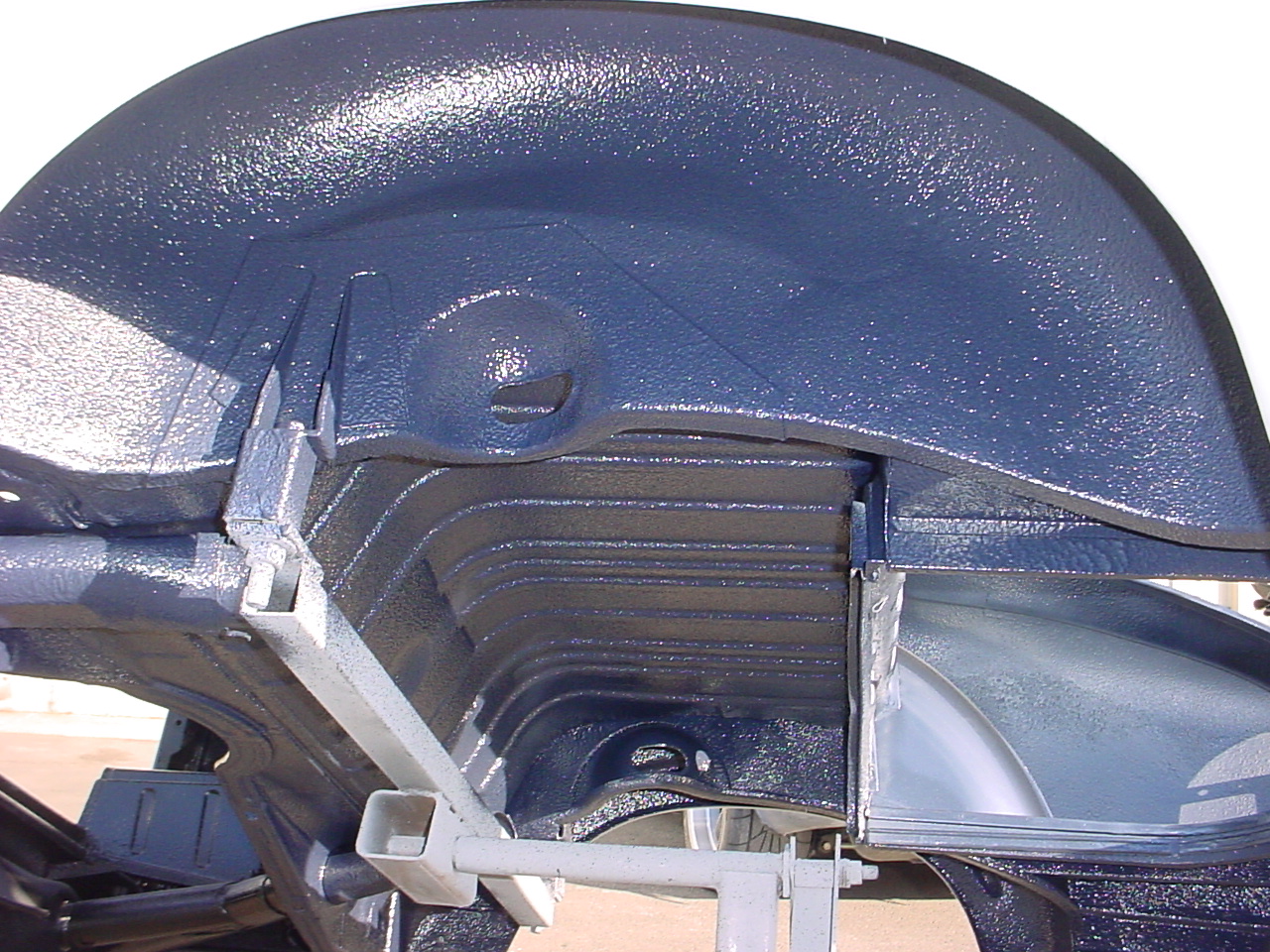

A pic of my 66 before the engine went in. The beads do have a squared off profile

So that confirms it. 64 and earlier had 10 rounded profile beads plus a cross brace. 1965 till 67 - 13 beads of more squared profile and no cross brace. Some other change then happens 68-70 and one last time from 71 on - based on part number changes.
Key takeaway for me, I donât need to add a cross brace to my car. It didnât come with one.
Thanks for help ing clear that up.
