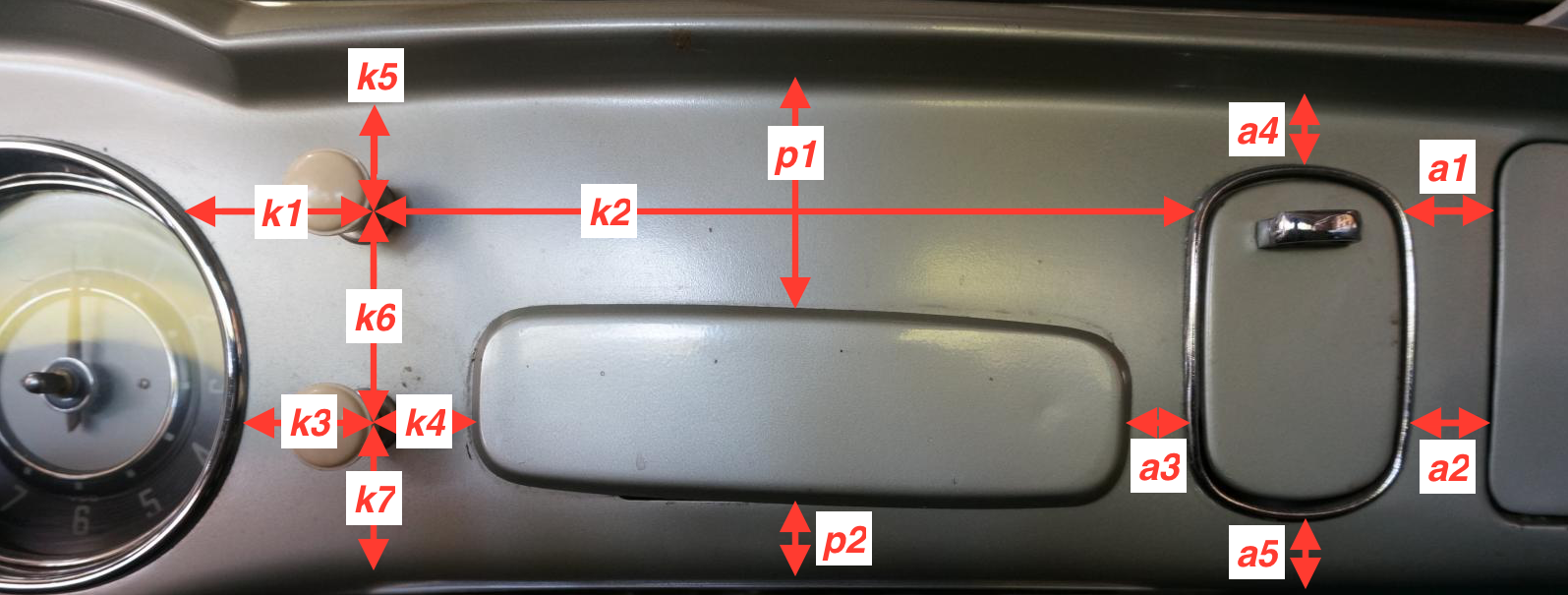

I need to redrill the opening for the headlight switch as the previously butchered hole had to be welded shut. Borrowing a pic from another thread. I need the measurement "K6".
Thanks,
Byas

Hello Byas,

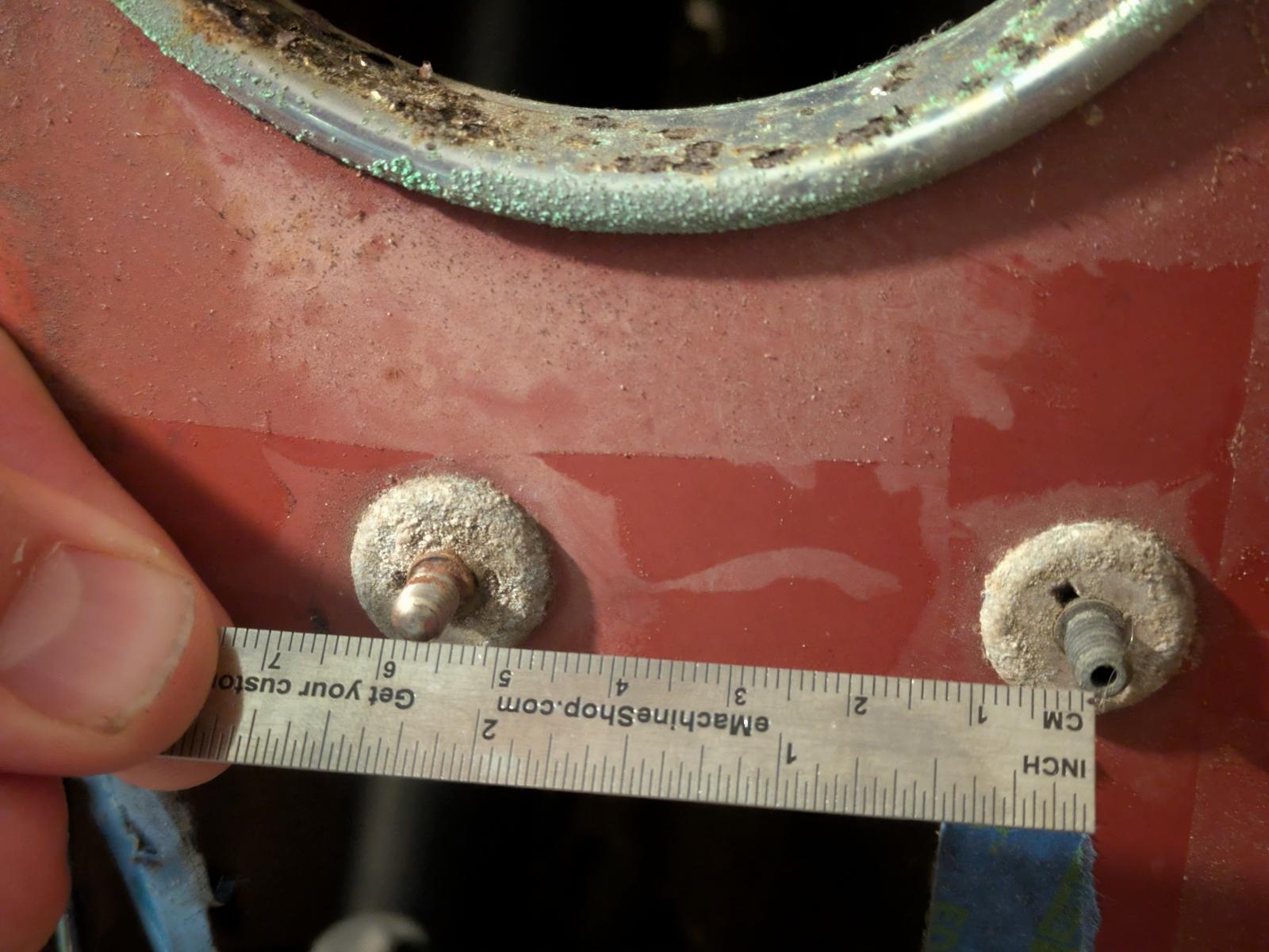

I have a 1958 Karmann Ghia. From center to center, the distance between each hole at K6 is 56mm.
Best regards,
Clayt

Thanks Clayt! On FB I got a response of 58mm from a 61 car. Wonder if this is within the error range of measurements or whether later cars were indeed a bit more separated.

I still have what remains of my 64 donor car's dash. 58mm looks right

K6 is also 58mm on my September 59!
