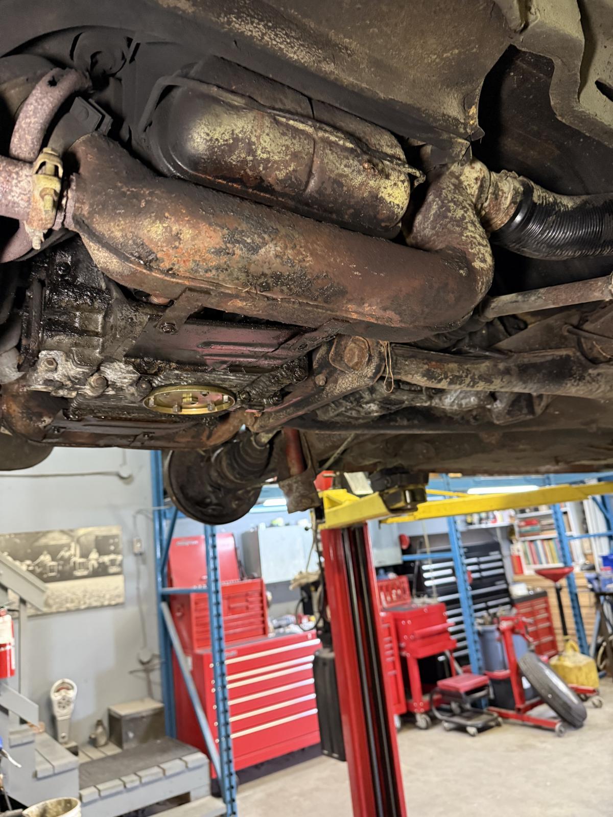

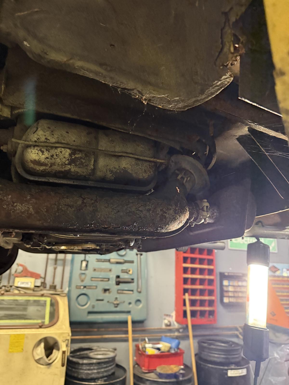

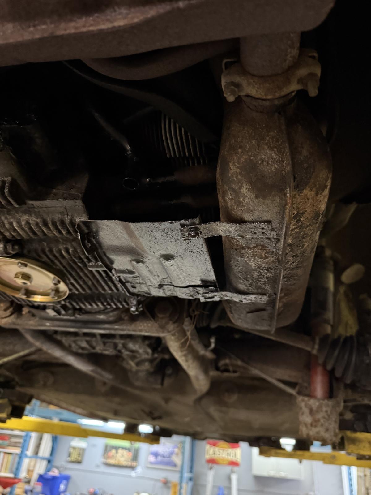

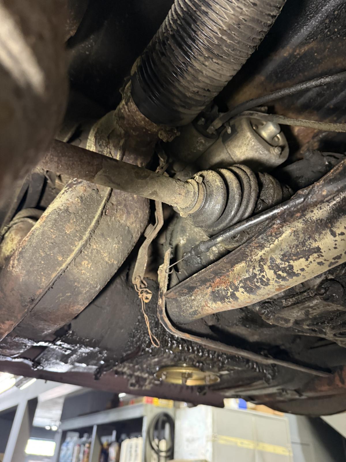

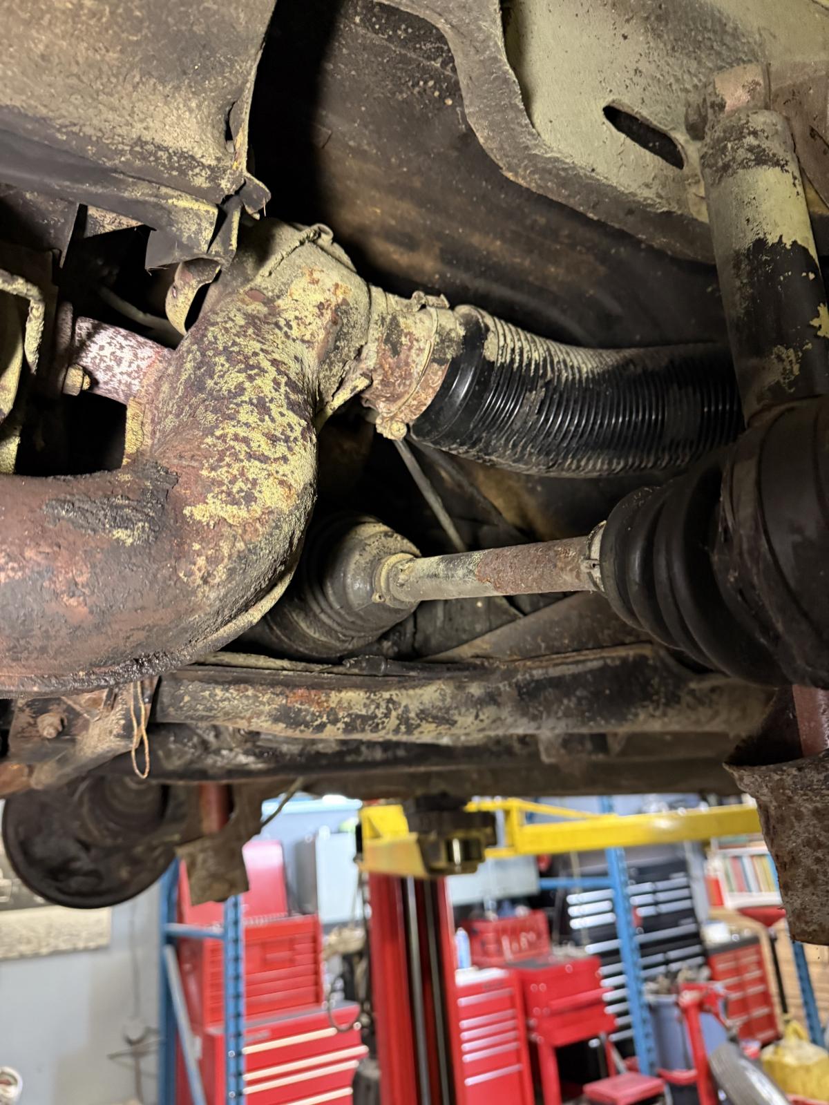

There's some of my pics showing the heater boxes from the rear, the muffler, and one of the disconnected cables. All looking very rusty, clearly some oil wetness coming down too.

PostPosted: Wed May 07, 2025 6:16 pm    Post subject: Re: Heater box and CO questions Reply with quote
Other than the oil gunk and needing a good painting up, those heat exchangers look really good!
Where the pipe comes out of the sheet metal of those HEs, can you wiggle that pipe and see if those are loose in the muffler seals. If loose might be the HEs pipes have worn and rusted down over time.

PostPosted: Wed May 07, 2025 6:21 pm    Post subject: Re: Heater box and CO questions Reply with quote
SYS64738 wrote:
Do get some bolts into that sled tin and torque them down to 6 Ft. Lbs., before you loose that rear section of tin.
You also need to get the oil filler down draft rubber vent boot.
How about some images up in the engine compartment??
Might be you are missing seals and tins.

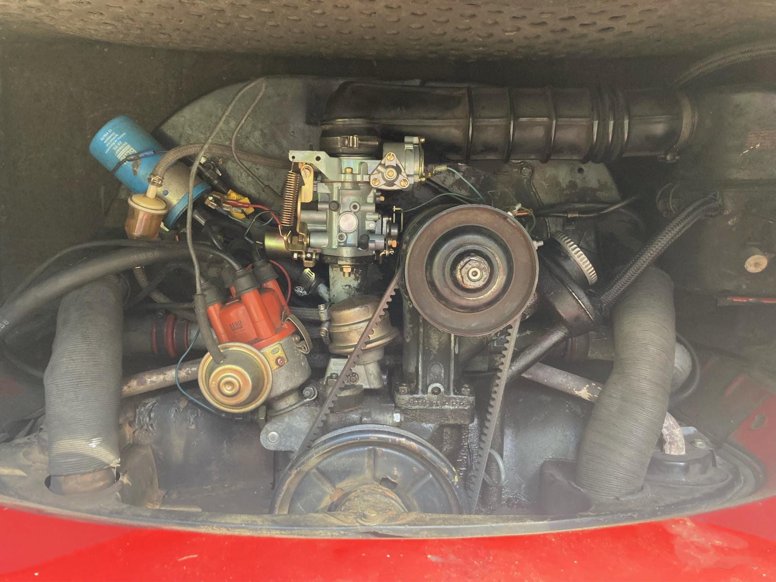

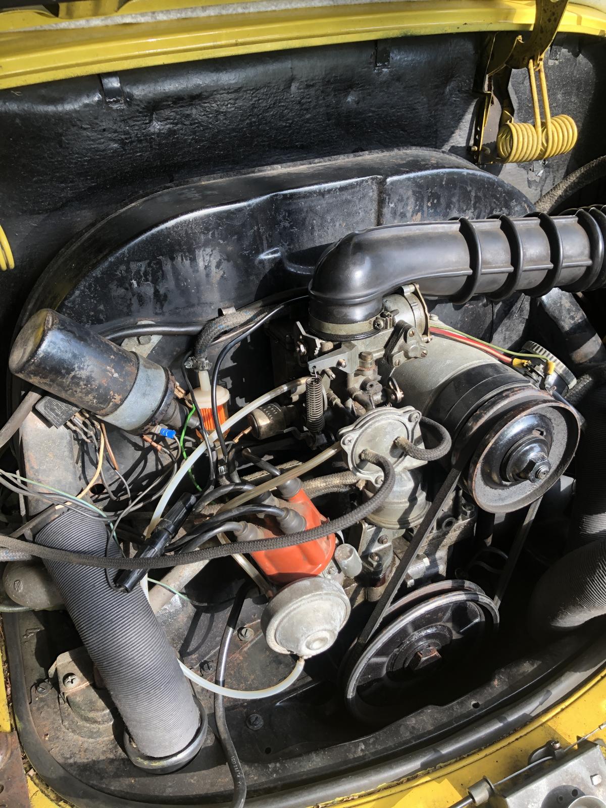

Unfortunately don't have great pics of the engine bay and the car is not with me at the moment. Will probably be some weeks before I catch a window to get it jacked up on stands again and have a chance to poke around.
Here's just one pic I had of the engine bay but really only showing one side where the air duct goes down to the heat exchanger.

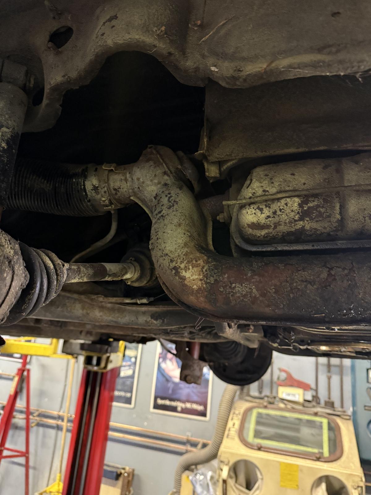

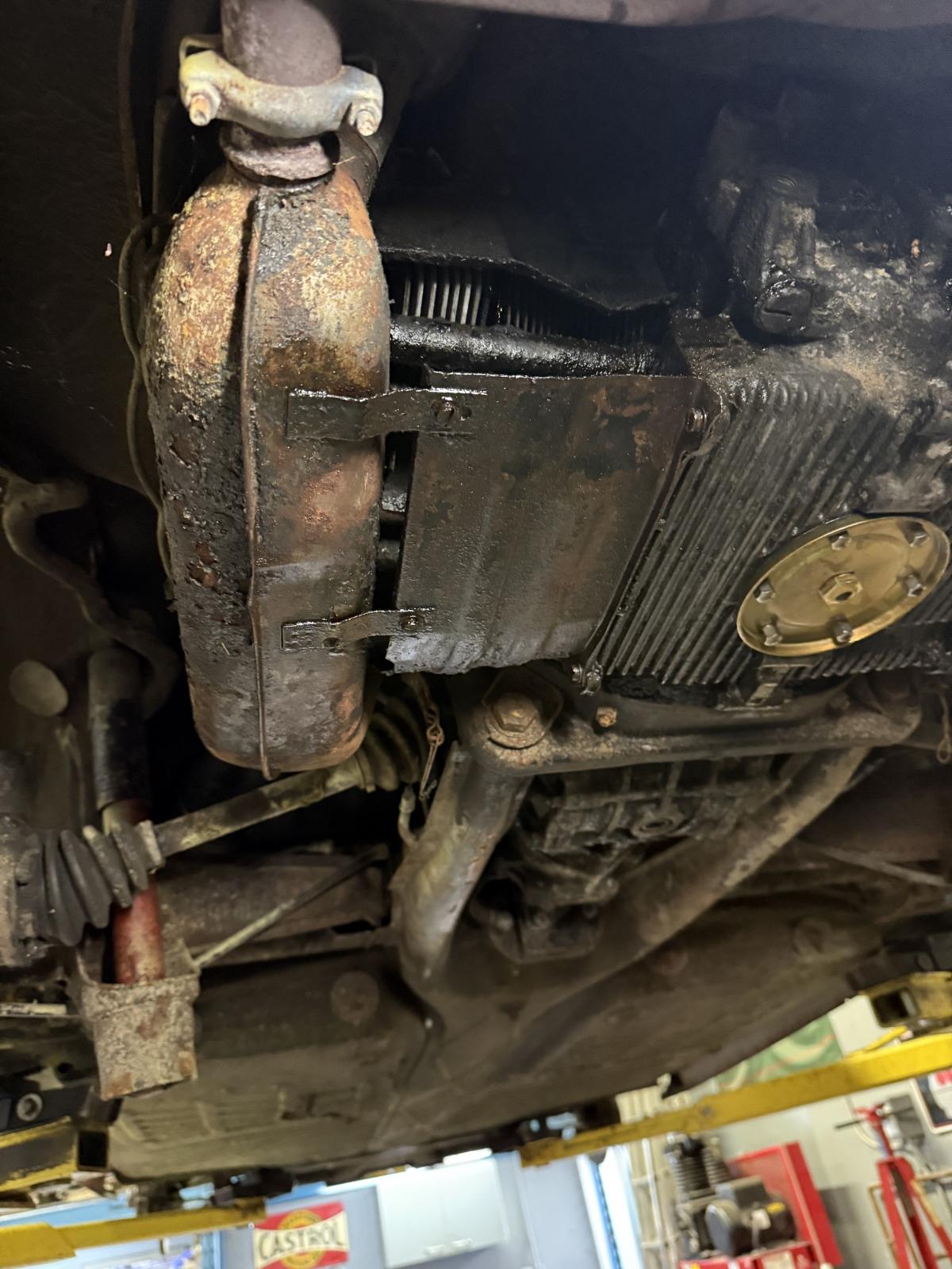

While I'm at it figured I'd include the rest of the heater box pics I took, from the sides and front in case that gives any more detail on what I'm working with.
Thanks again for taking a look!

PostPosted: Thu May 08, 2025 6:37 am    Post subject: Re: Heater box and CO questions Reply with quote
the manifold pre-heater pipe being rusted away completely would give a 'clue' to were the exhaust fumes are coming from

Damn! Good eye runamoc!!! All that black powdery exhaust soot should have been a big flag while under there.
Was going to say that we would suspect the muffler before the HEs.
Nice looking engine, but you do have some small problems.
1. The vacuum hose you now have is letting fuel from the carb to get down into the distributor vacuum advance, which will ruin the rubber diaphragm in that. Should have a metal line with a hump to send fuel vapor condensation back to the carb. Example below taken from the gallery.
2. Also you need to close up ALL HOLES in the engine tin, especially the rear tin in your image. Sure those are small fastener holes, but still they let hot air under the rear of the engine that has already passed thru the engine to cool it, back into the engine compartment.
3. Need hose clamps on the fresh air hoses from the fan shroud to the rear tin, on both ends of both hoses. Way back when we had one of those pop off! Engine temps shoot way up, enough to damage a head or the whole engine. Thankfully we run oil temp & pressure gauges so sudden changes in the engine show up right away to us.
4. Missing the spark plug cables plastic clips in the rear of the fan shroud. Spark plug cables right now are rubbing up against sheet metal and could drop down enough to get melted on the pre-heat pipes of the intake, and short out. PLUS you are loosing cooling air out of the fan shroud with those holes open.
When you do get back around to the Ghia, please do post more images of the engine. With those, all here can point out any problems you have and do not know of.

So all the other issues remain and trying to tackle them, but here's my most immediate issue now...
I started with tackling the missing screws in that tin sled beside the heater box so I removed it so I could clean it up and test the other screw sockets and the all seem good. But when I tried unscrewing the one side screw holding it to the cylinder case (if that's the right term?) the head just twisted off so now the rest of that screw is just embedded in the case metal.
So, two things, I need to get two more tin screws (as I only had the one) and wondering the size? 6x10mm?
And mainly what should I do now about this busted off screw? I could just put the tin back with 3 screws but without the one connecting to the block I assume it might be a bit rattly? I certainly don't have tools to bore out and re-thread that screw stud. Would it be a horrible idea to try getting a self tapping metal screw and twist it in there? (if that would even work?)
