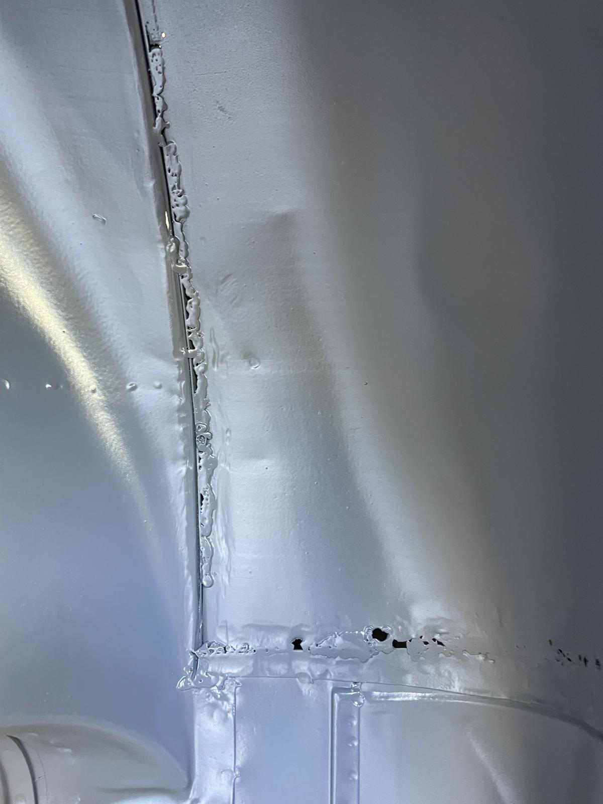

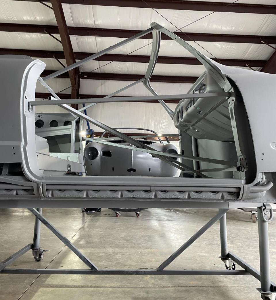

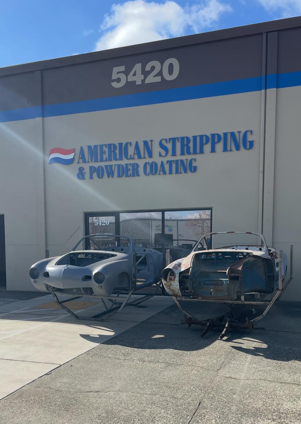

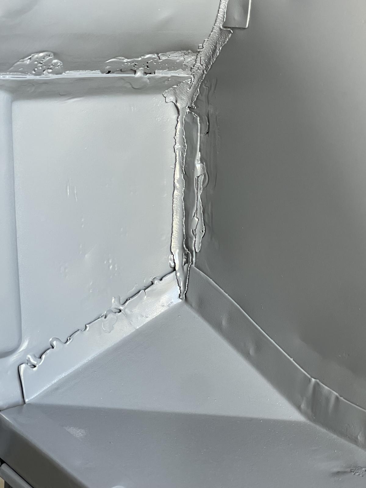

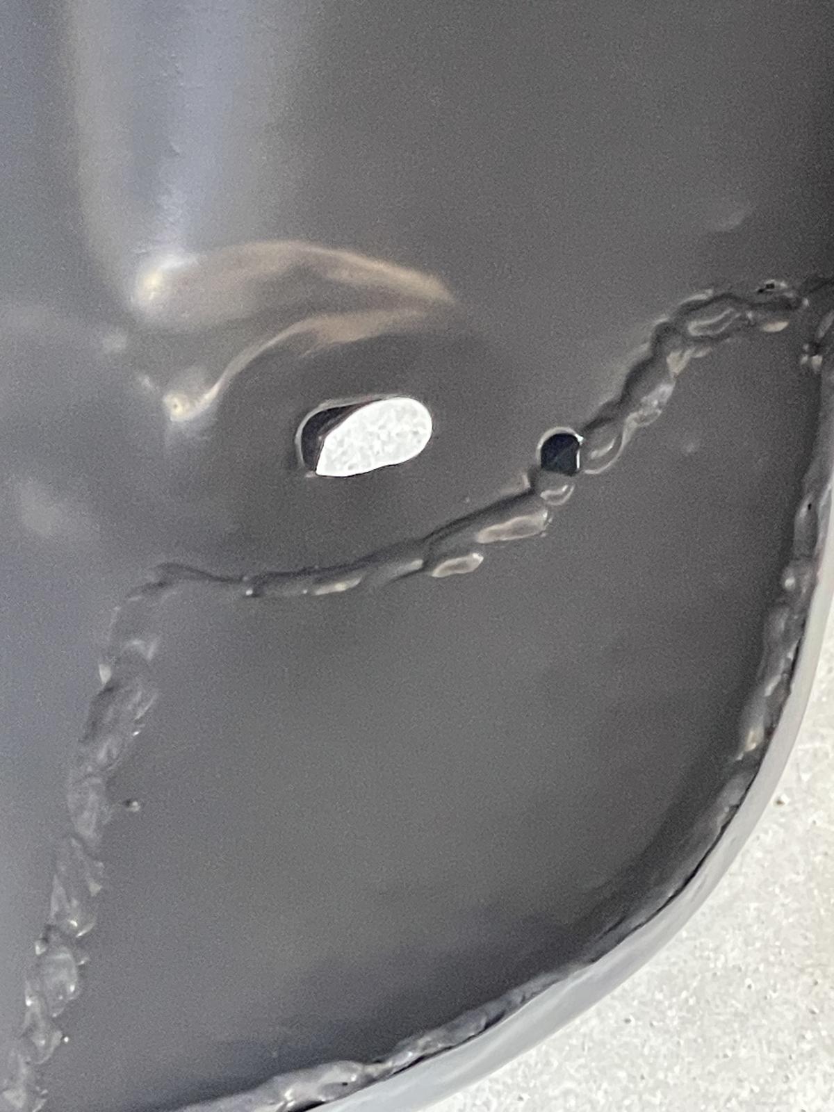

I think you be pleased with how nice this one will return. It will in fact be sealed inside and out. American Stripping does the job like no other outfit I have seen or used and I have used a lot. Their slogan is “ Start with the best finish “ Stay tuned to see the results when it returns.
Here are a few examples of what you cha expect

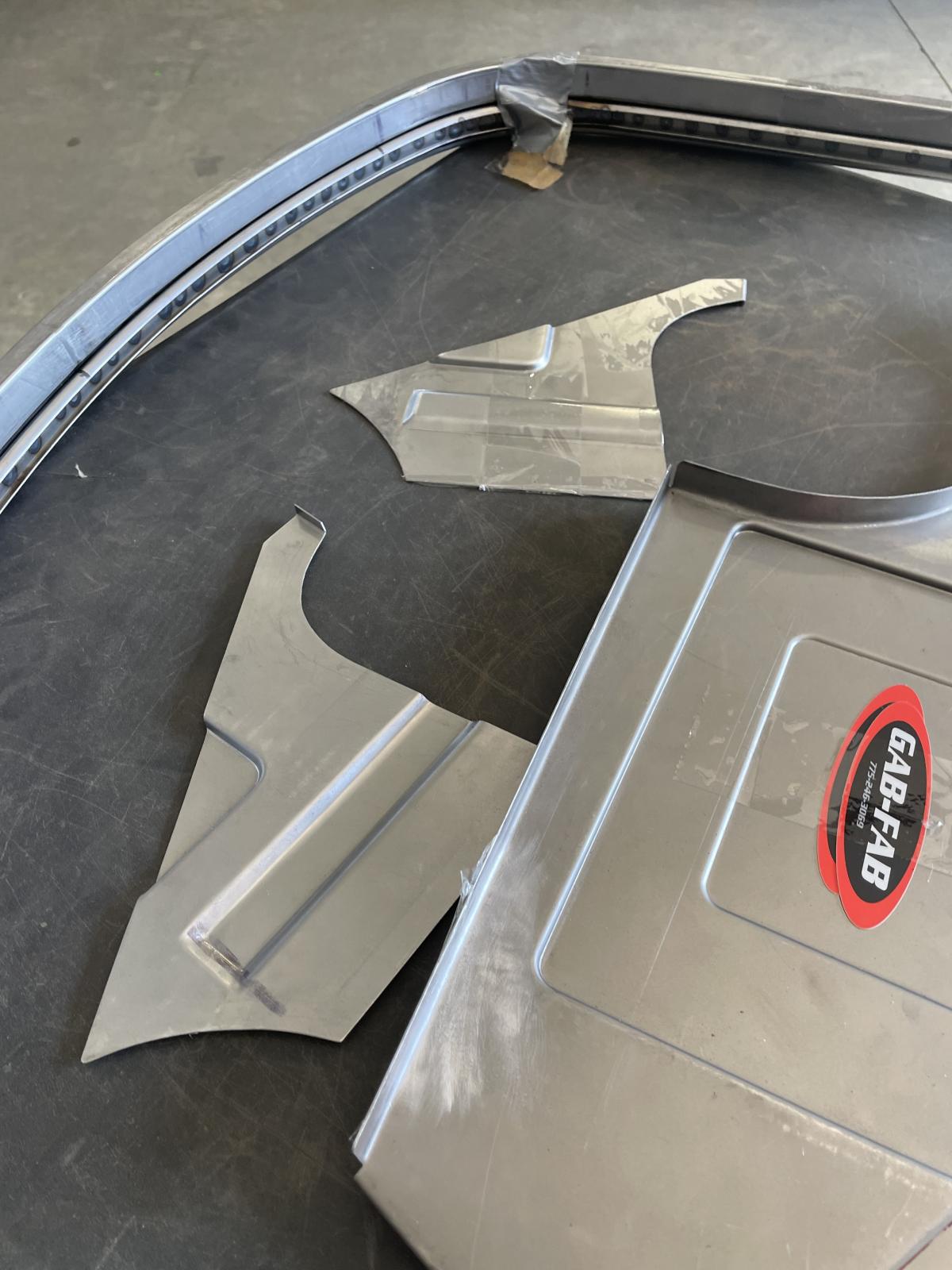

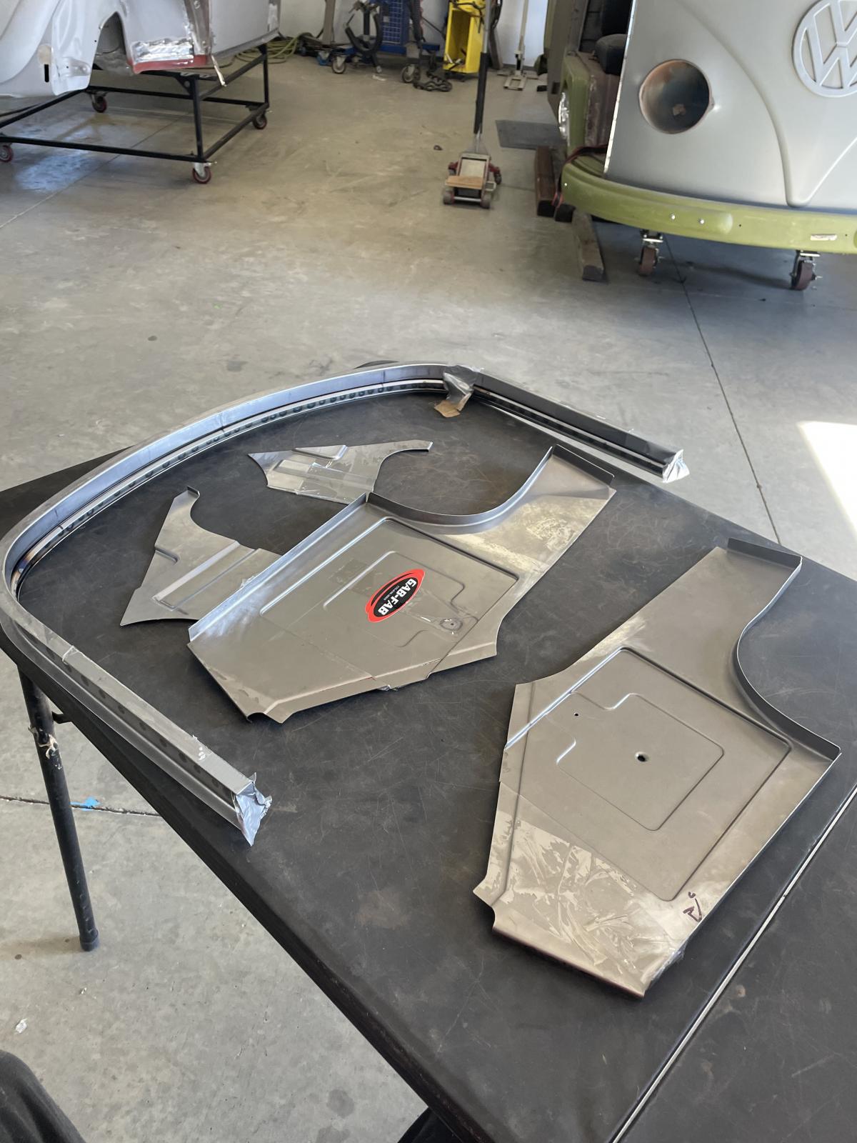

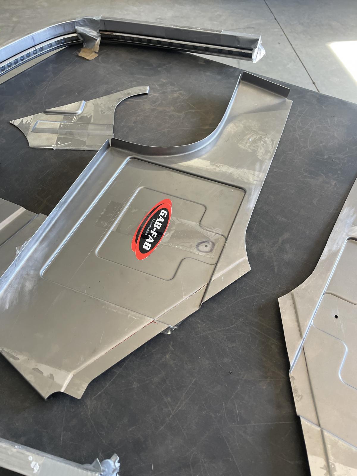

Got some very nice parts in from Gab Fab , these will be a huge help.

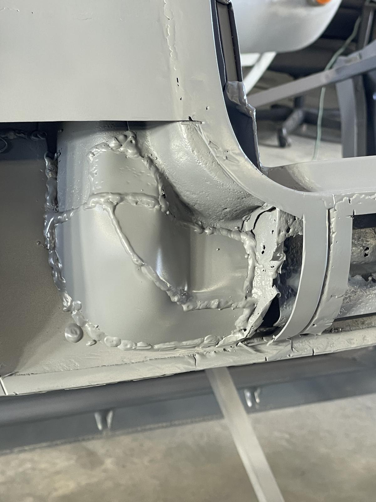

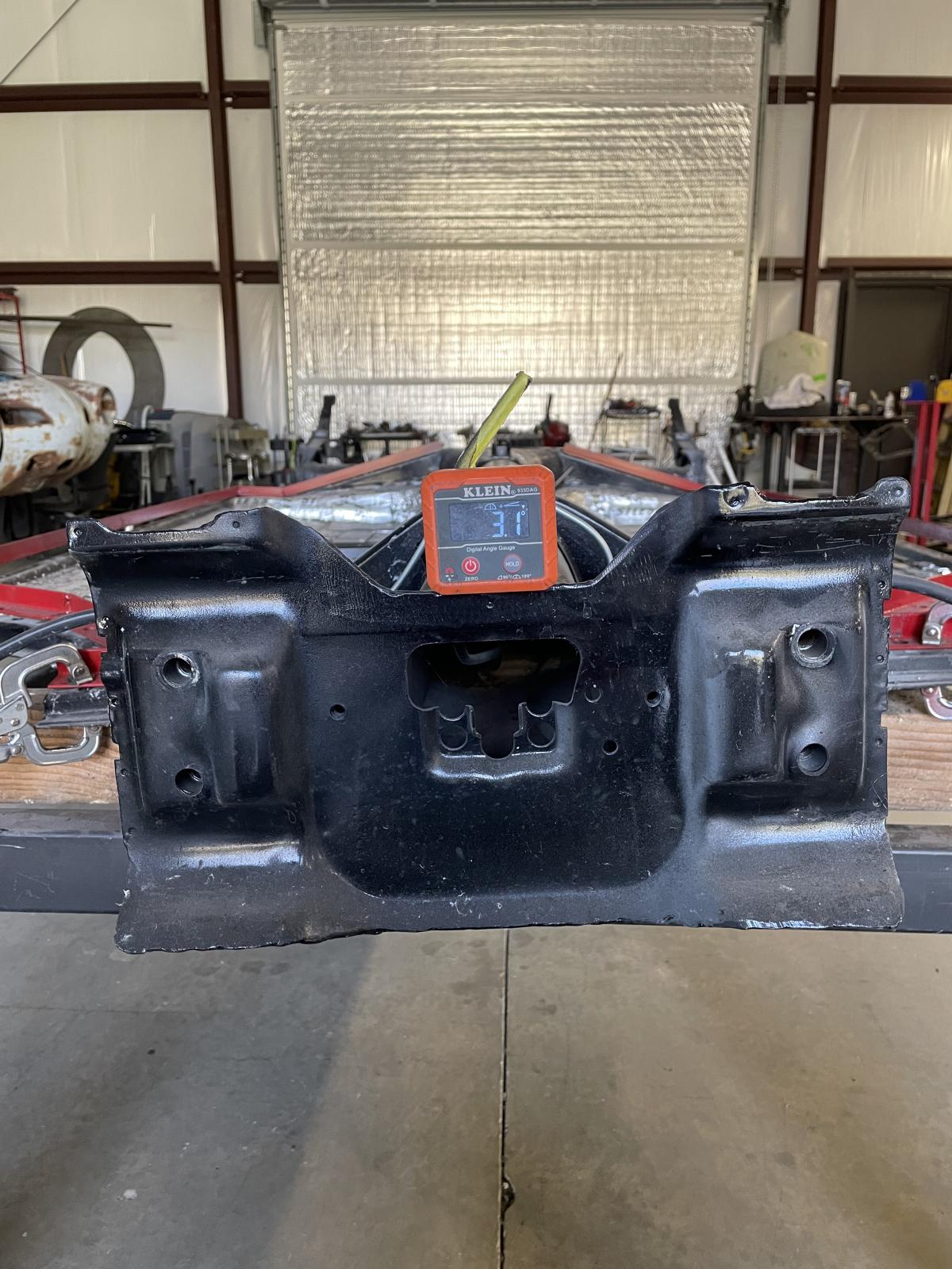

Also used my perimeter fixtures to discover the pan bolt holes do not line up to factory locations but the most alarming was how twisted the pan head is.

PostPosted: Sat Mar 15, 2025 5:55 pm    Post subject: Re: 57 Kab Reconstruction/Restoration Reply with quote
Yes, those are some very nice replacement panels made by Danny.

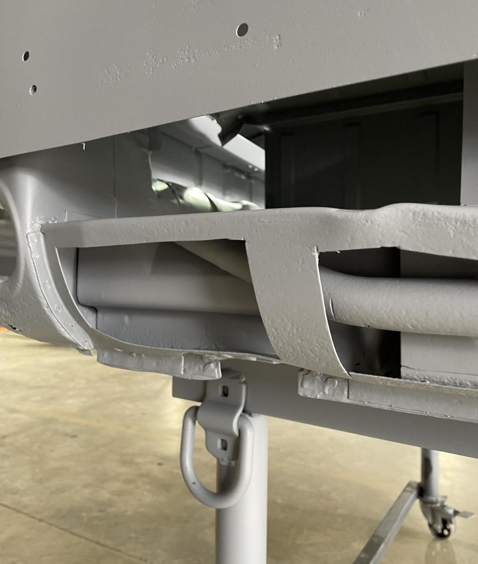

I thought I remembered that 1957 cabriolet being on a later IRS style chassis back when I saw it for sale quite a few years ago. Is that the IRS chassis or did the owner find a donor swing axle chassis?

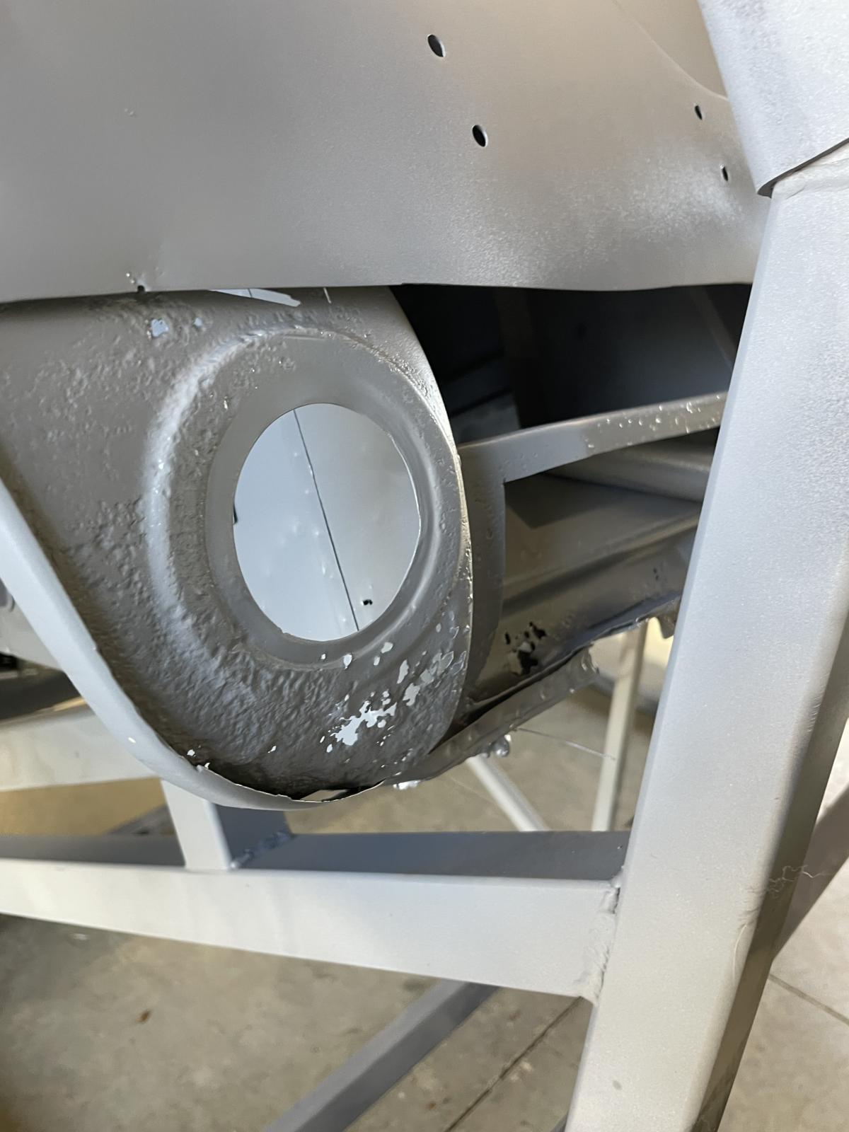

WrennMetallWerks
Joined: December 06, 2007
Posts: 3314
Location: Rescue ca
WrennMetallWerks is offline

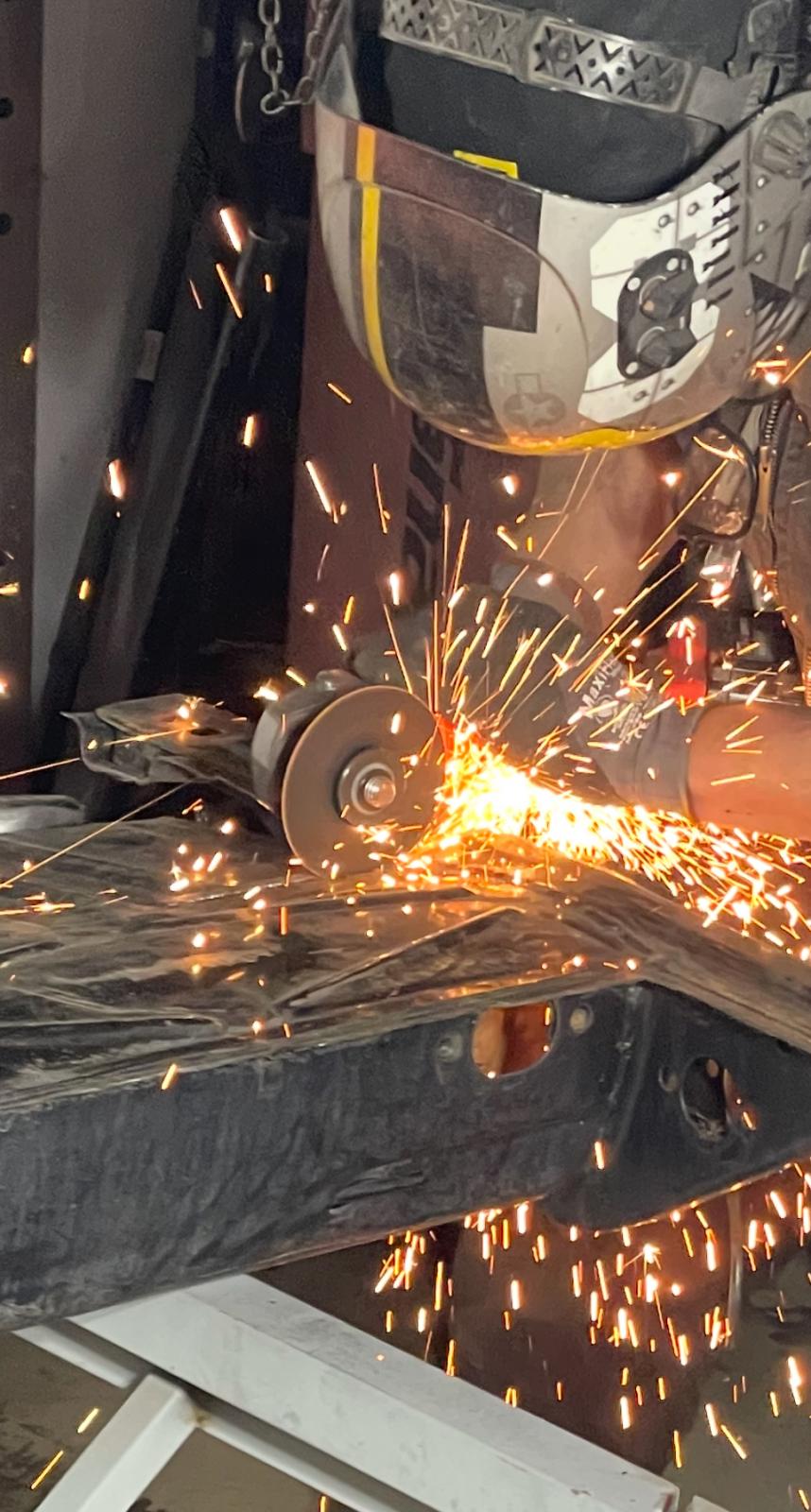

PostPosted: Sat Mar 22, 2025 7:21 pm    Post subject: Re: 57 Kab Reconstruction/Restoration Reply with quote

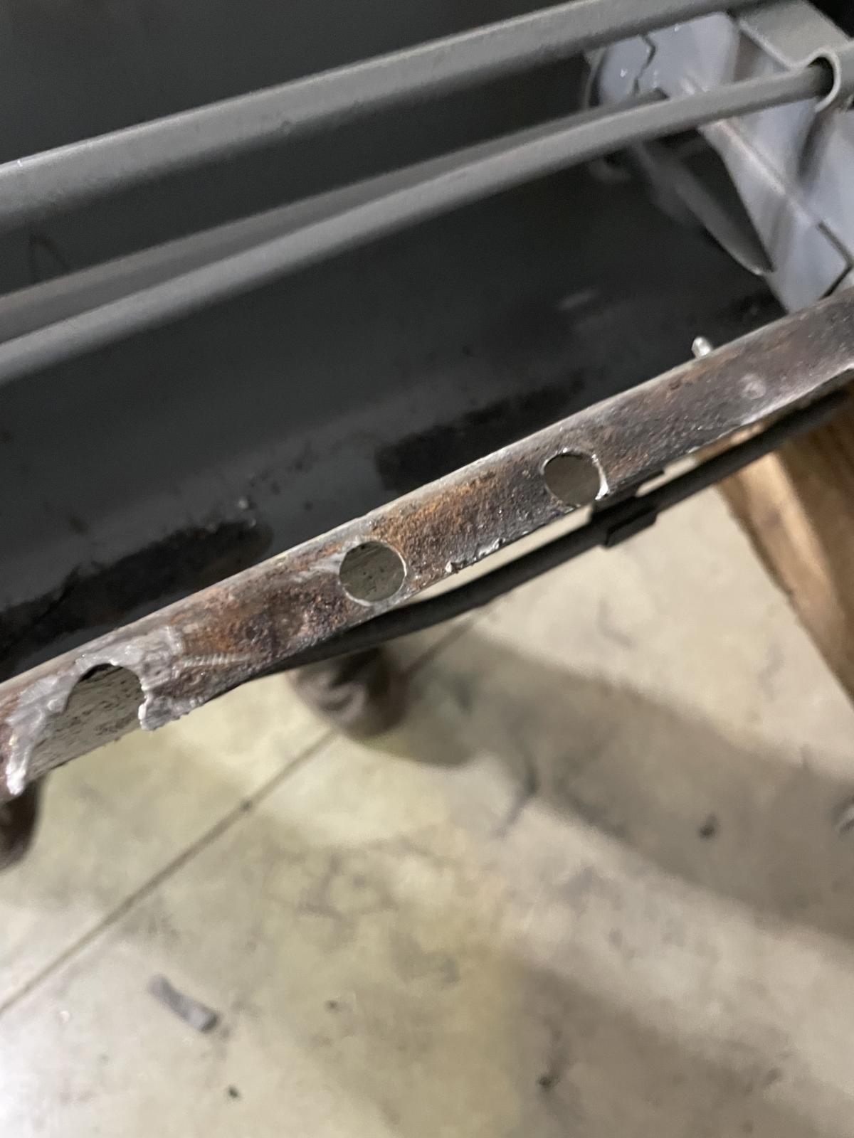

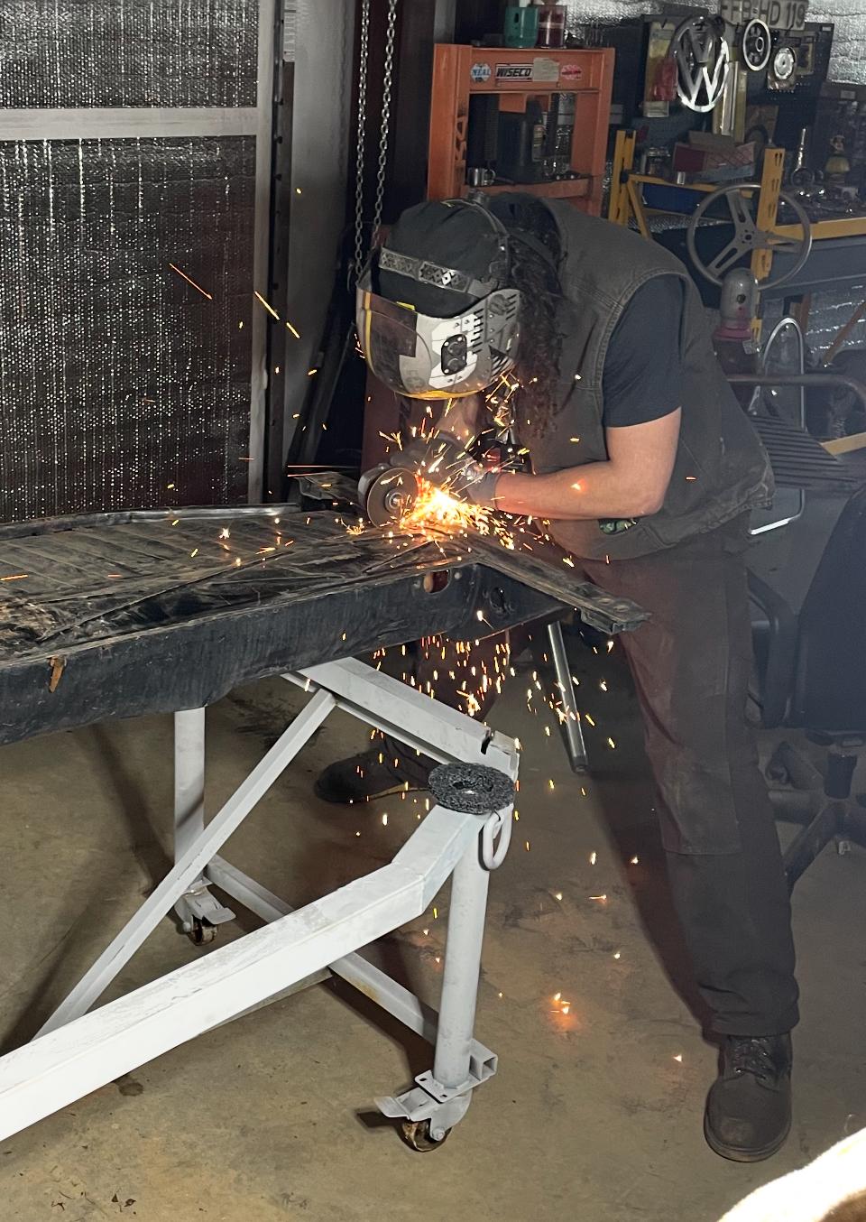

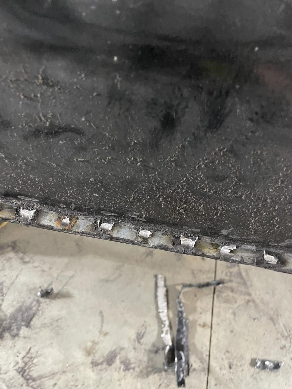

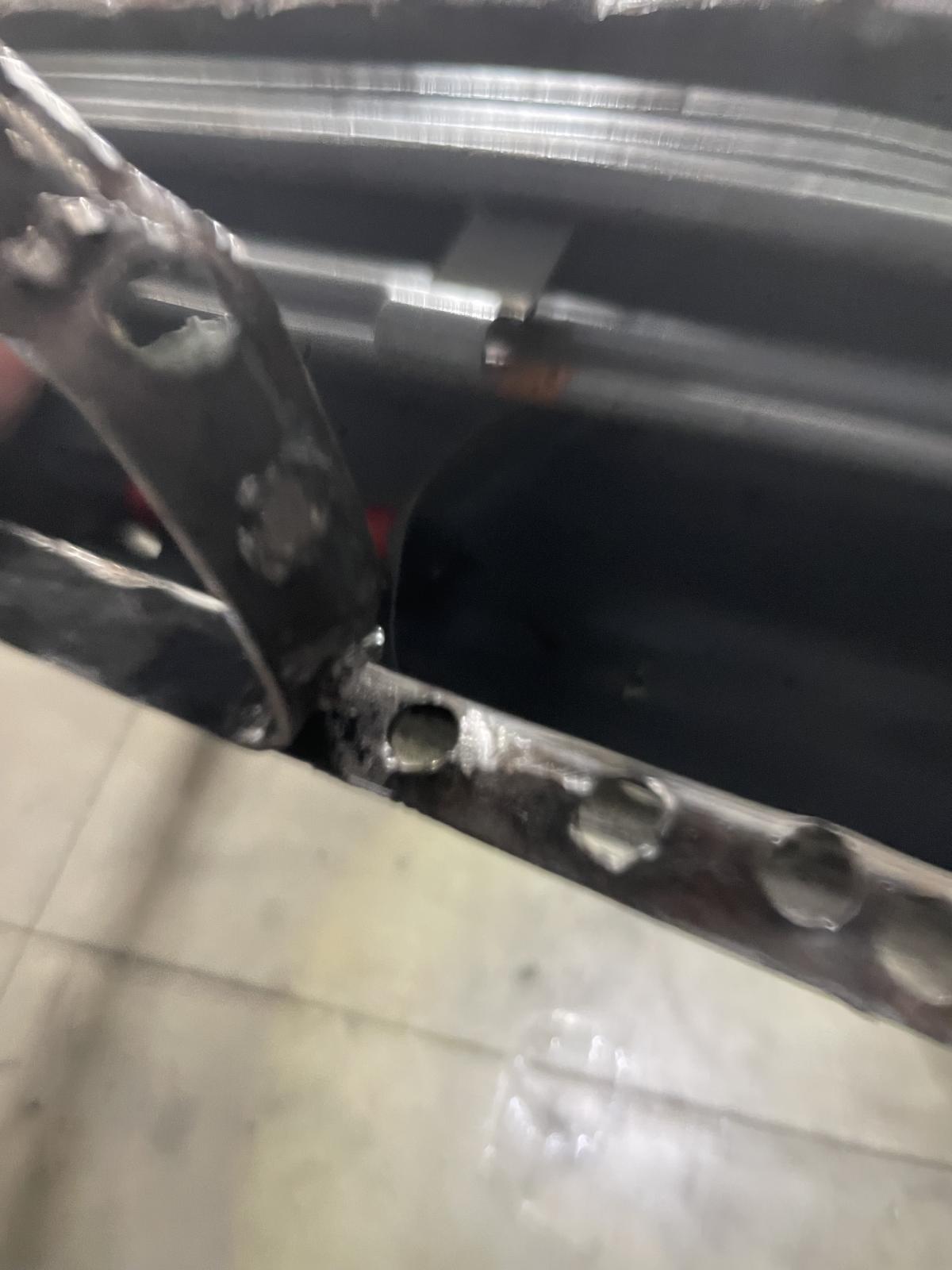

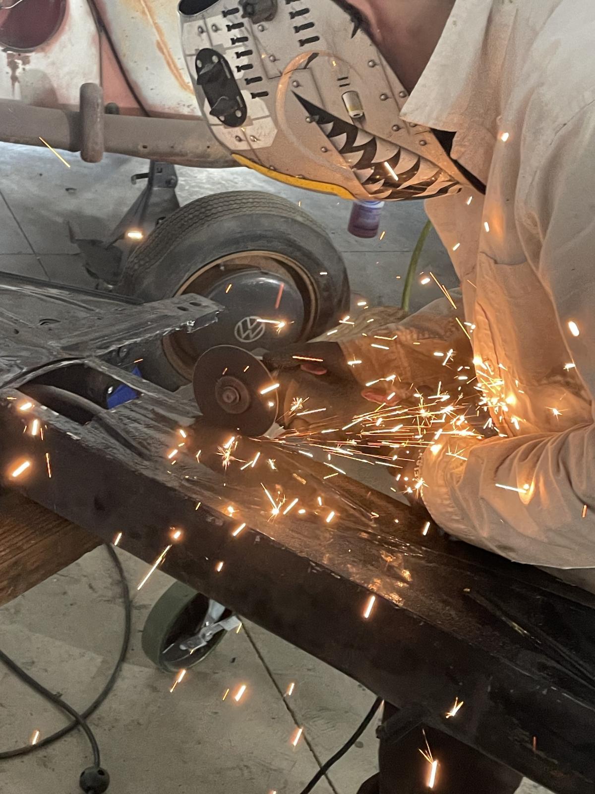

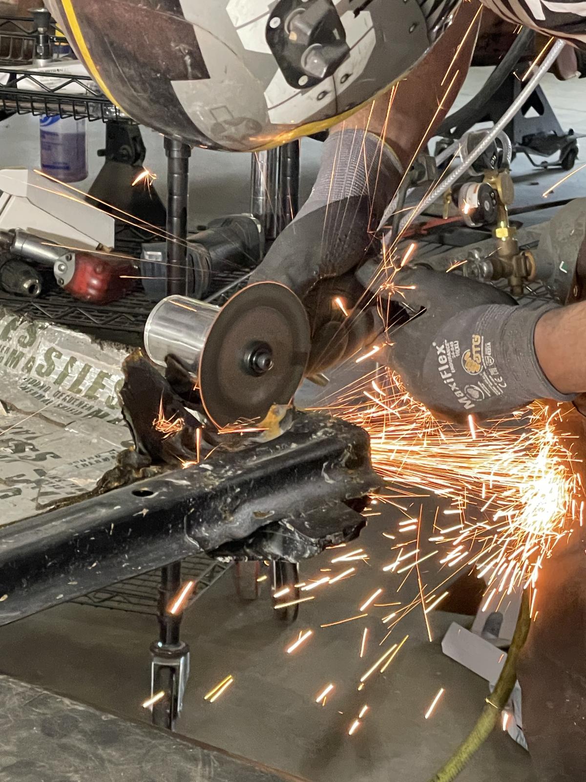

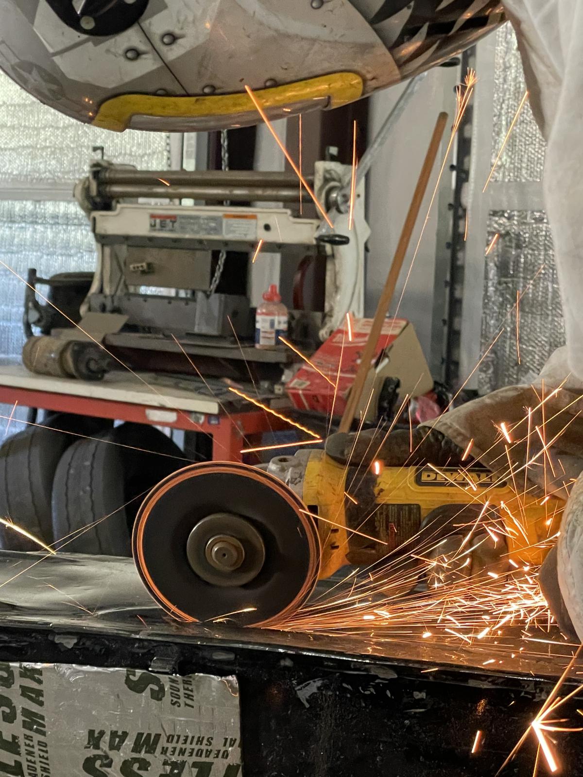

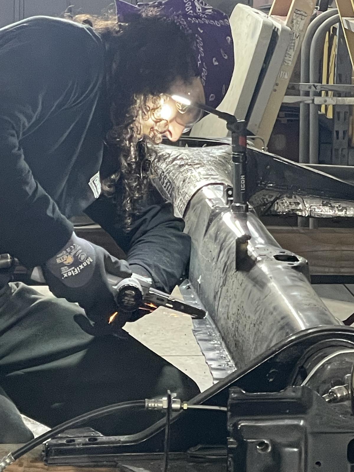

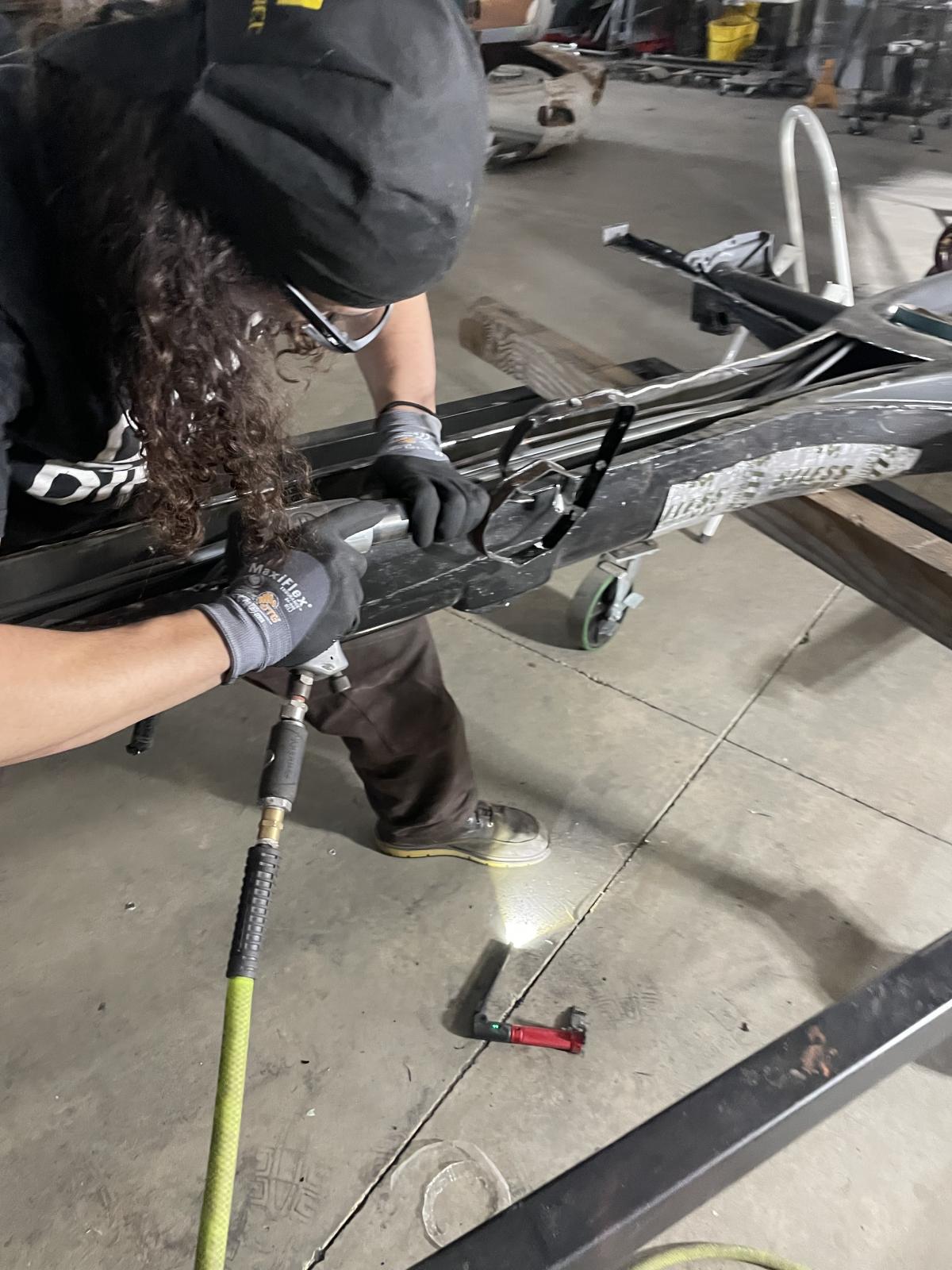

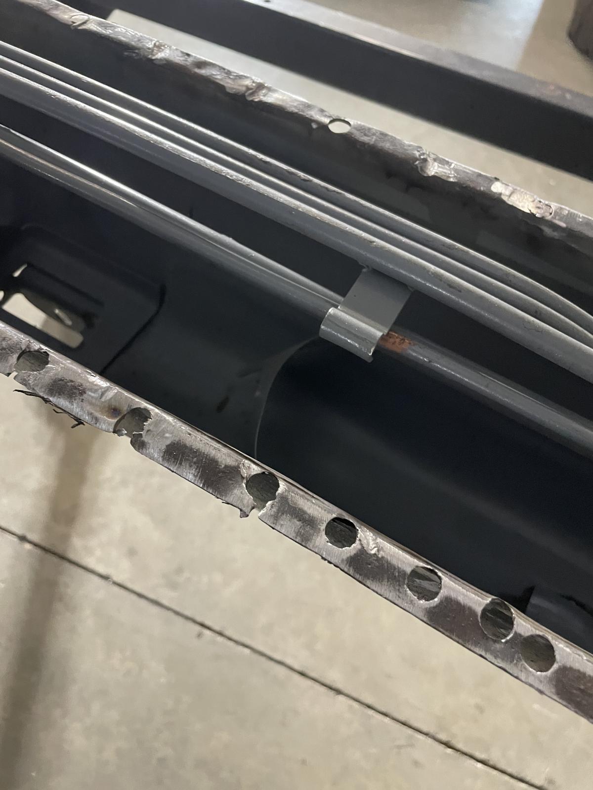

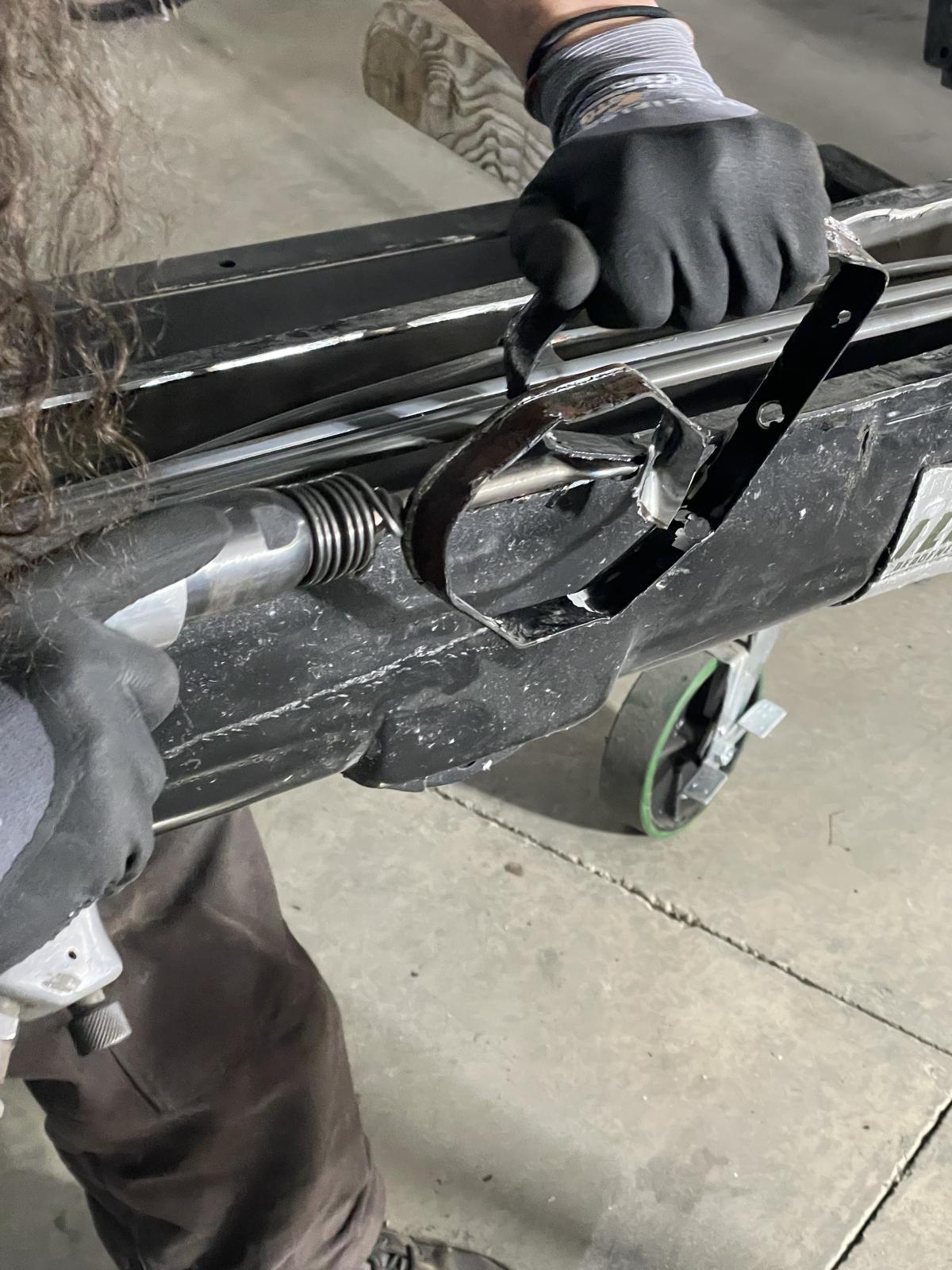

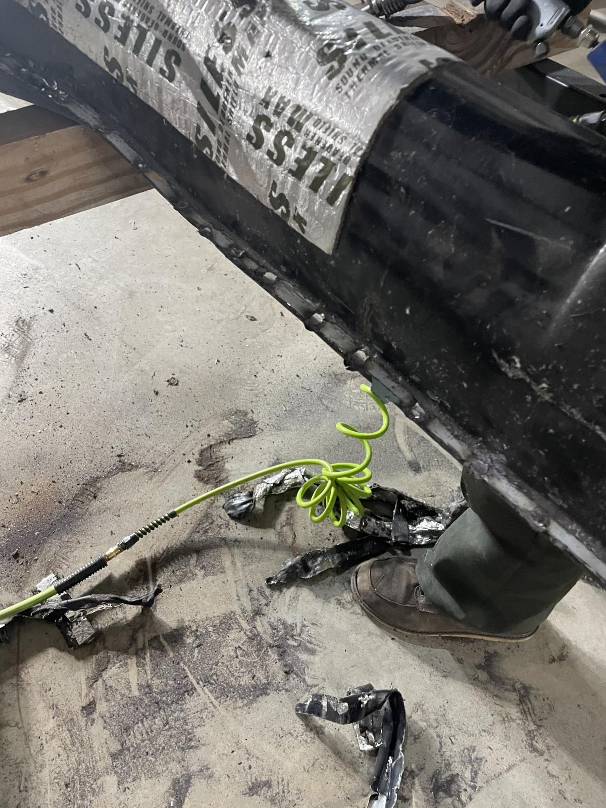

Started removing the old pans halves, larger Mig welds are so much more difficult then factory spot welds. At first we tried air hammering the halves
off the traditional way but no luck. My son had to painstakingly grind away each plug weld. He did a killer job.

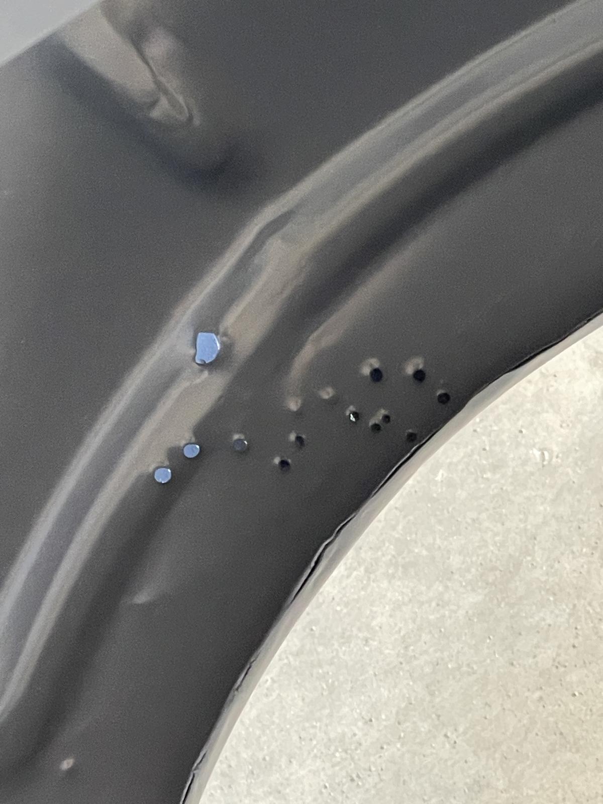

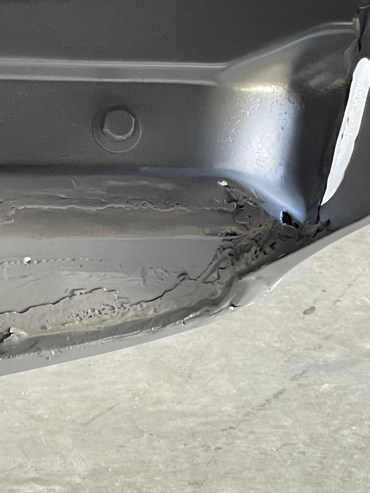

PostPosted: Tue Mar 25, 2025 6:08 pm    Post subject: Re: 57 Kab Reconstruction/Restoration Reply with quote

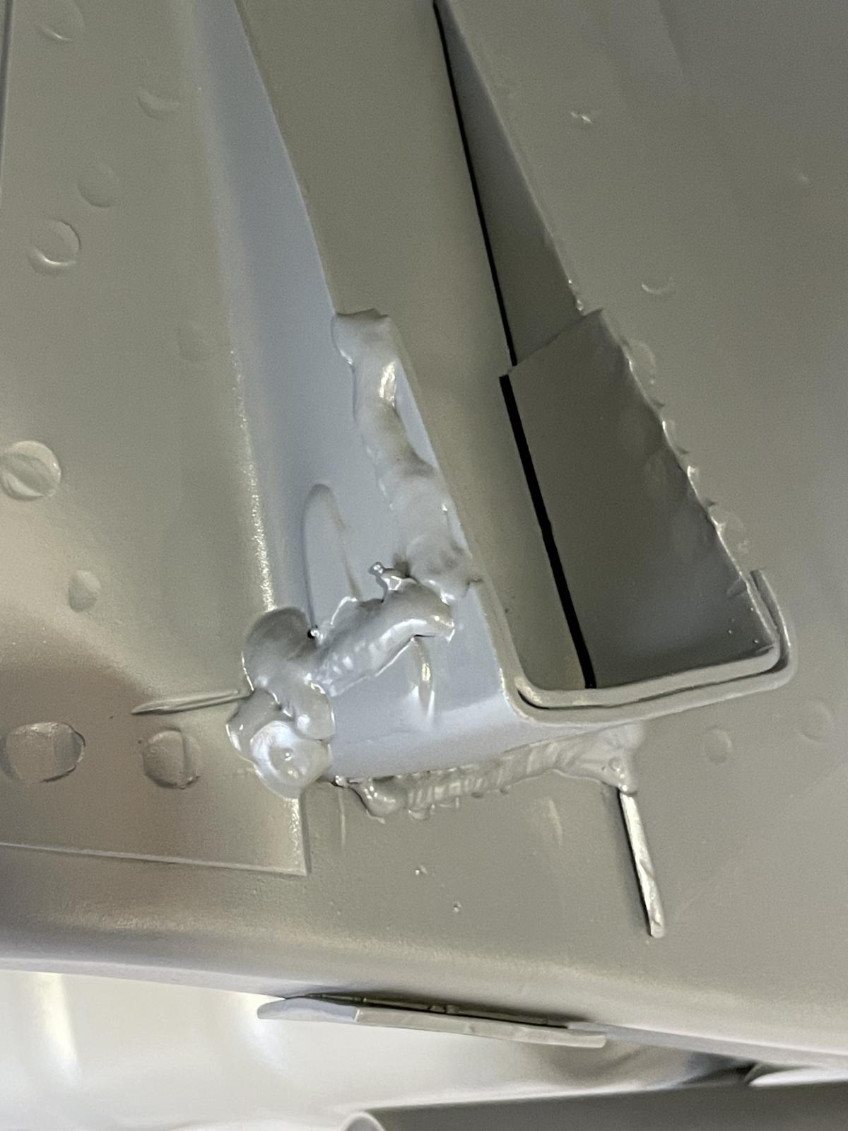

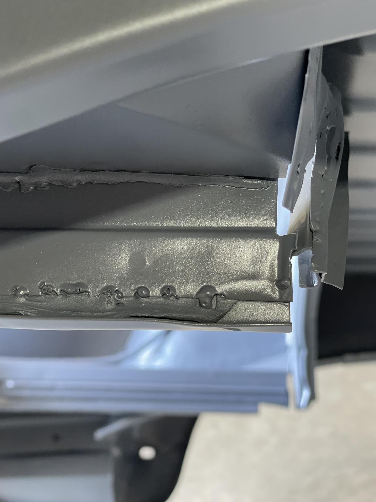

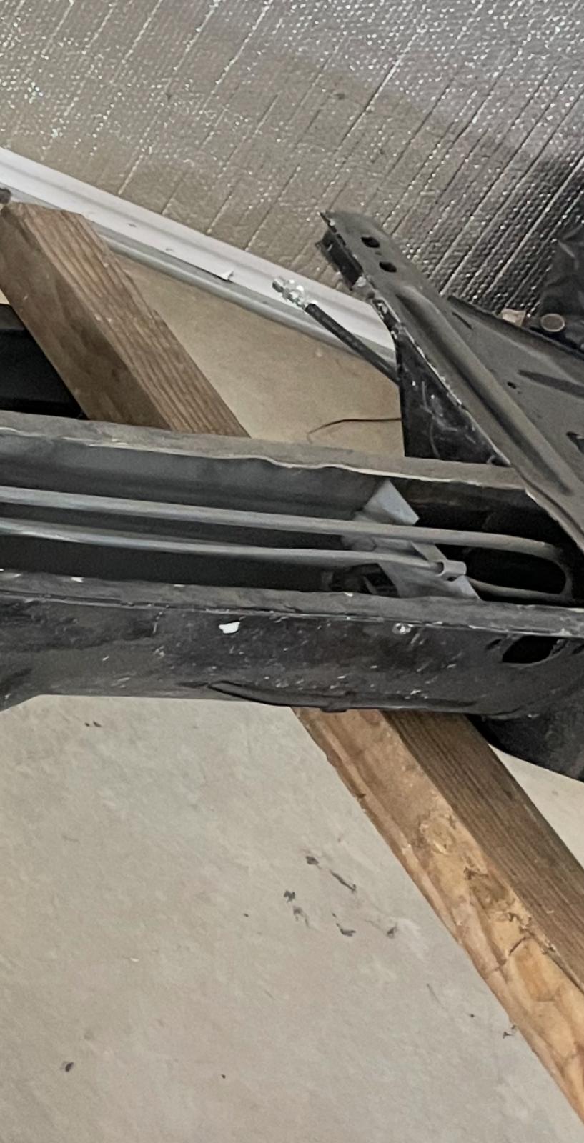

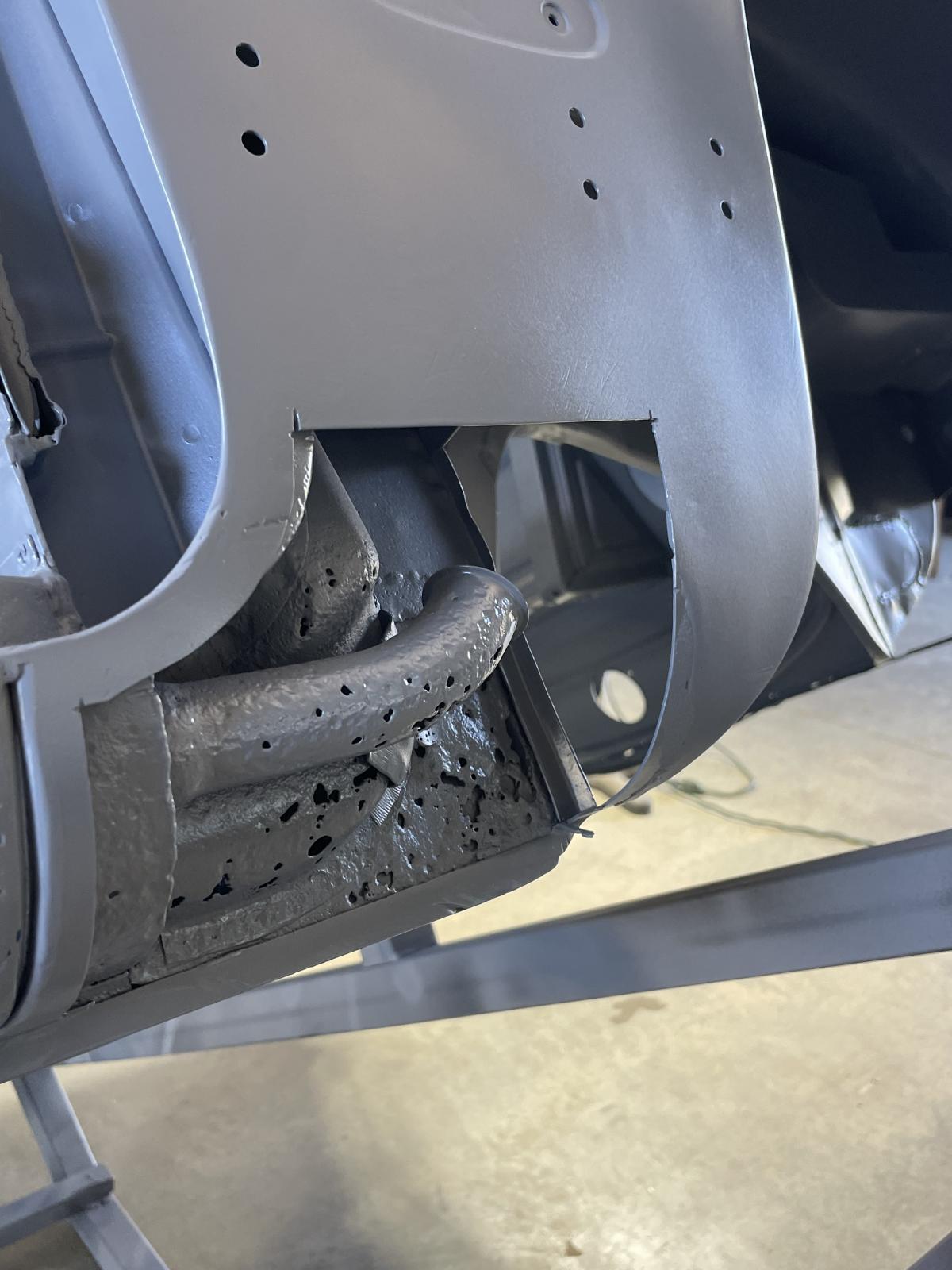

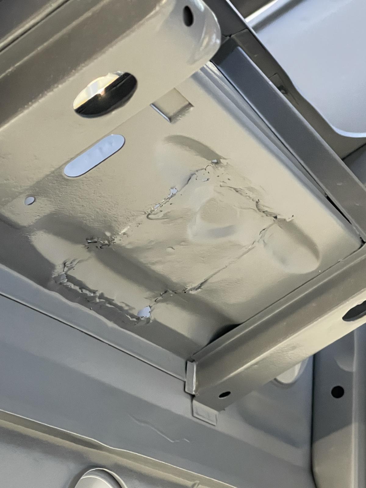

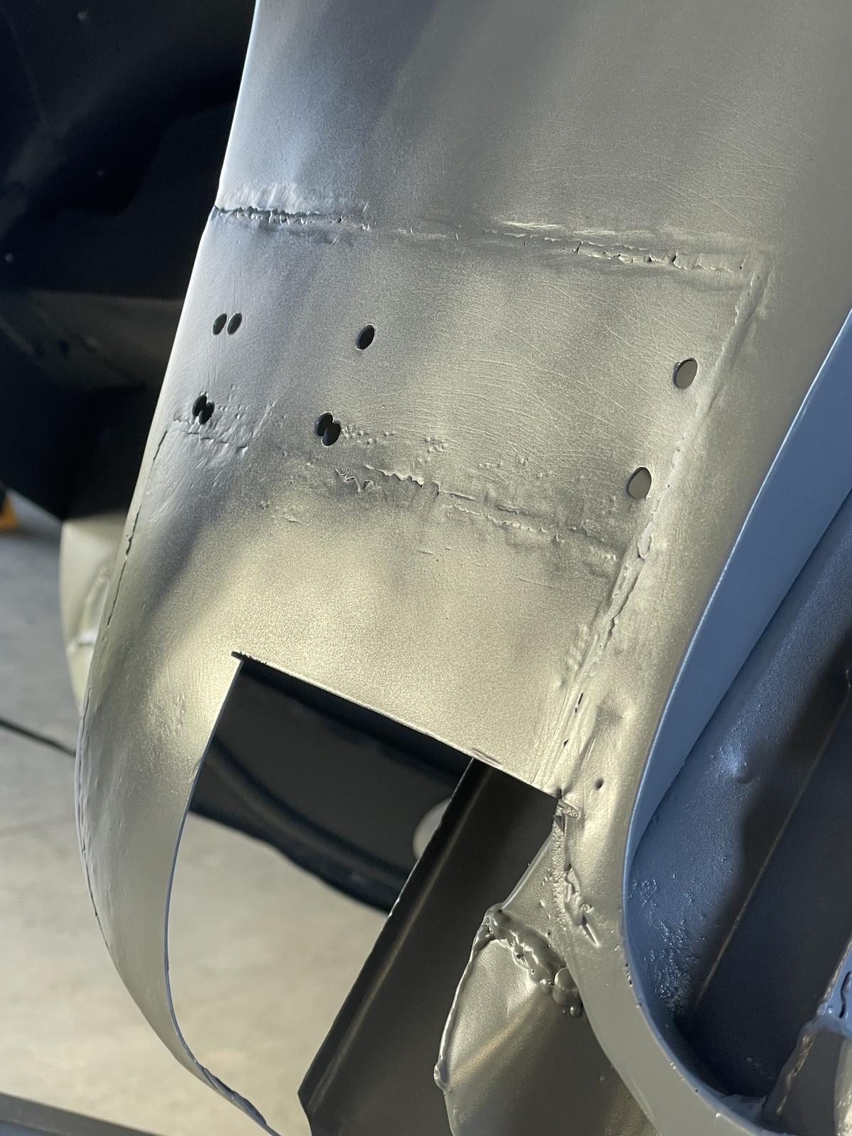

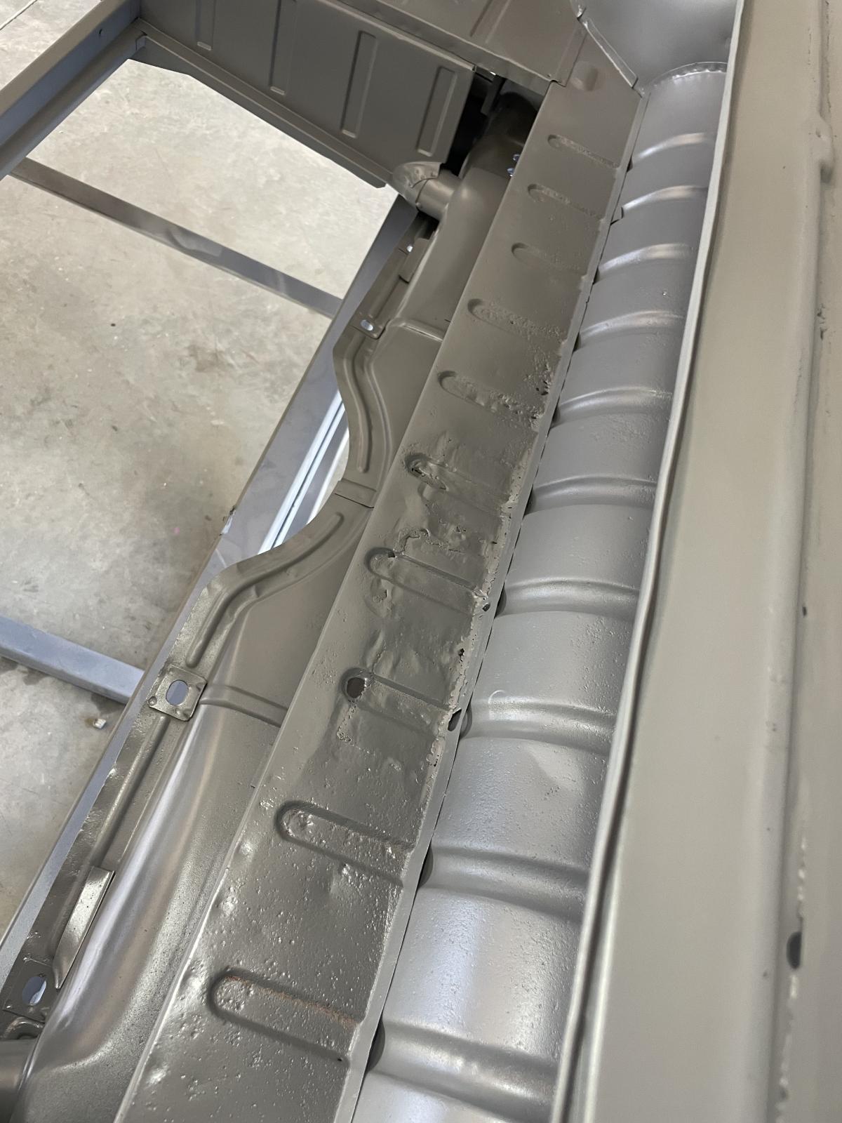

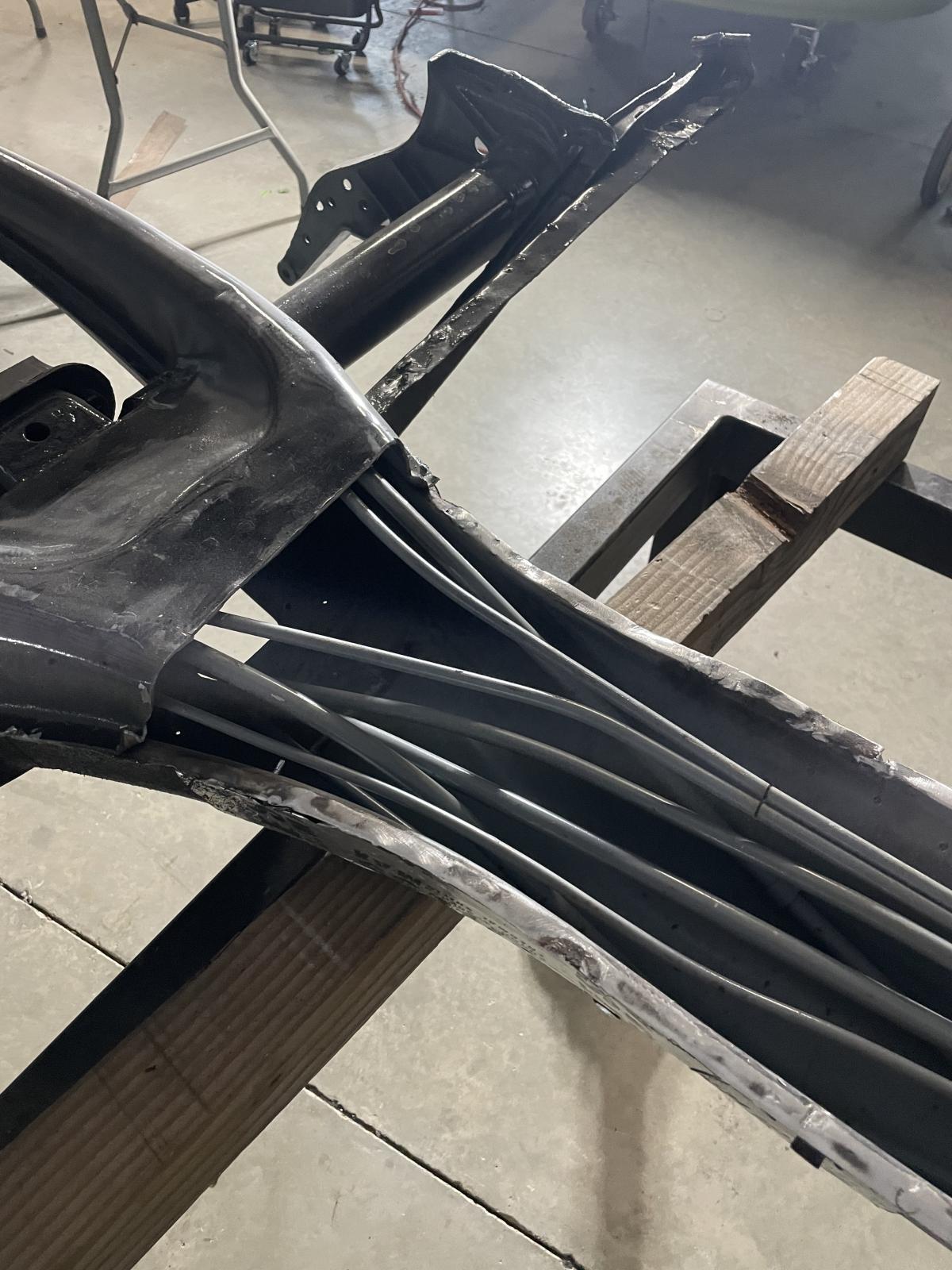

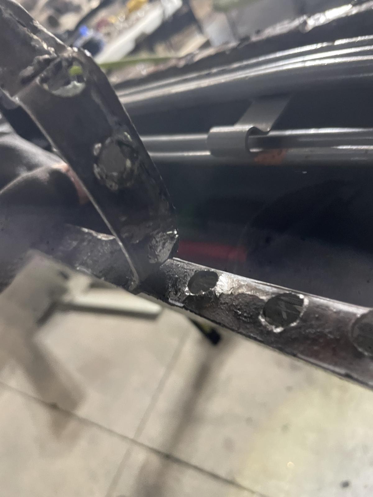

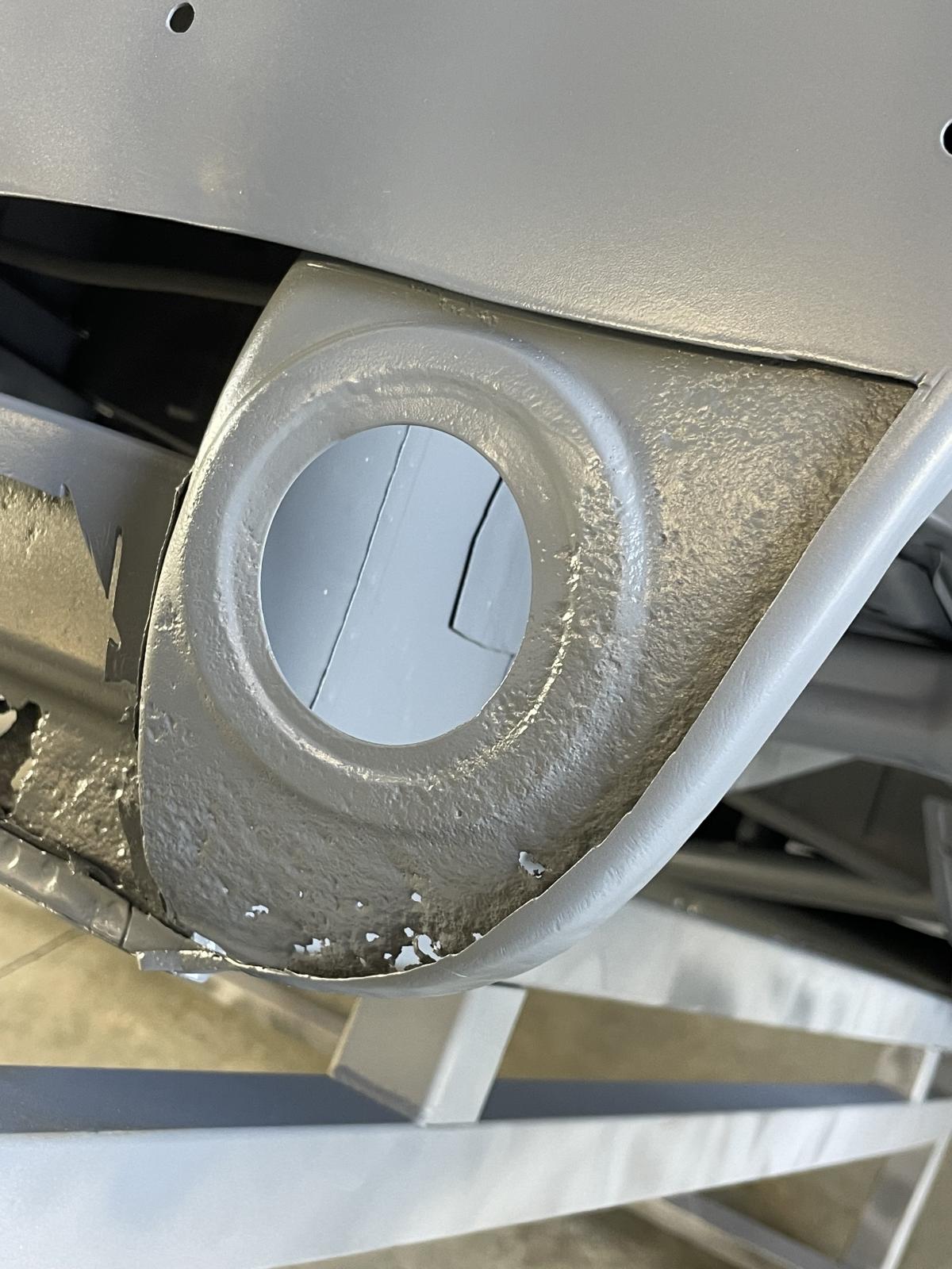

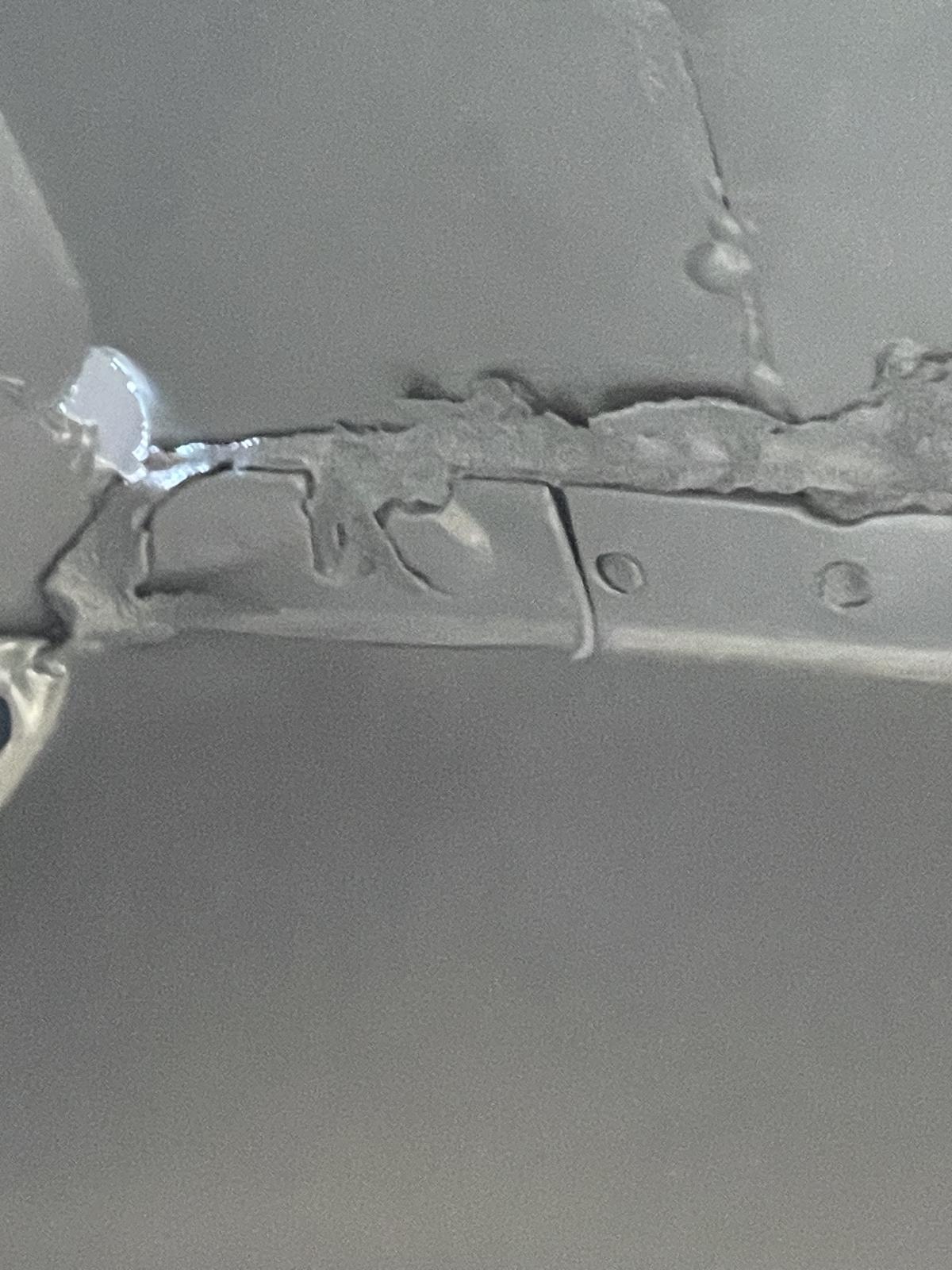

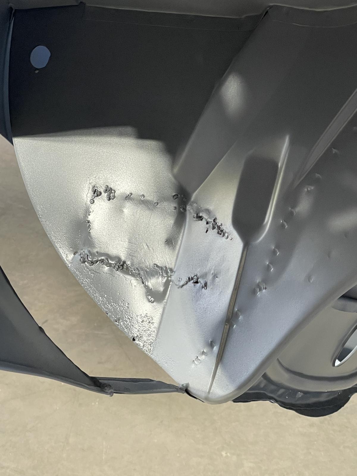

We continue to discover issues with the chassis. After looking close at the underside I saw that the cap was removed from the tunnel by cutting it off in the field away from the spot welds. We cut it off and found the fuel line just floating inside. I think it safe to safe that when it was welded back on this is when the big twist happened. We also removed the jack points in preparation to use them on the new pans.

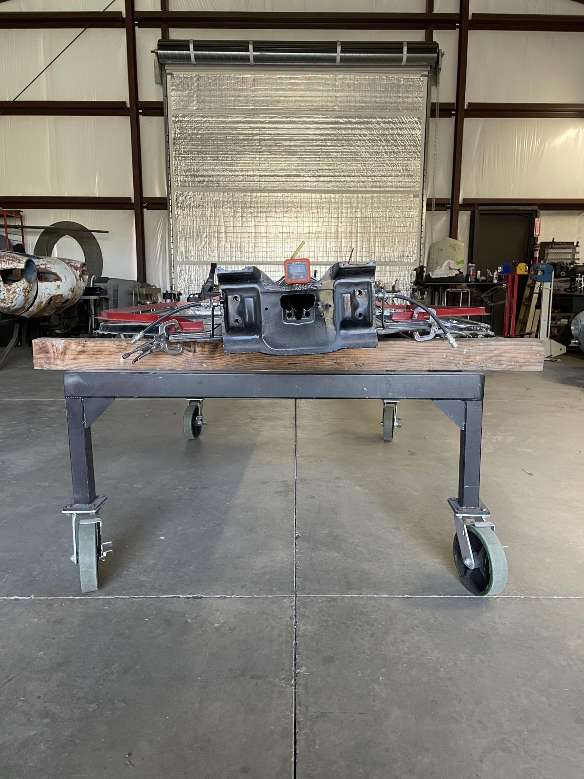

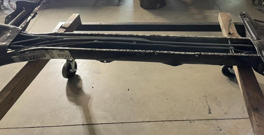

PostPosted: Tue Mar 25, 2025 8:15 pm    Post subject: Re: 57 Kab Reconstruction/Restoration Reply with quote

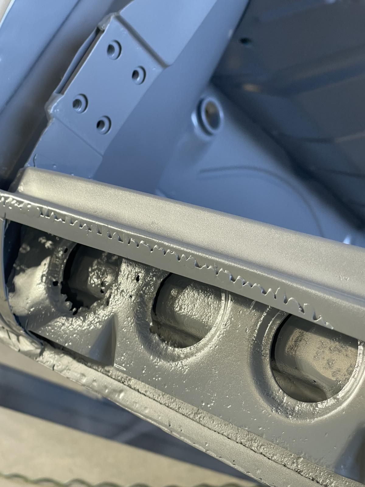

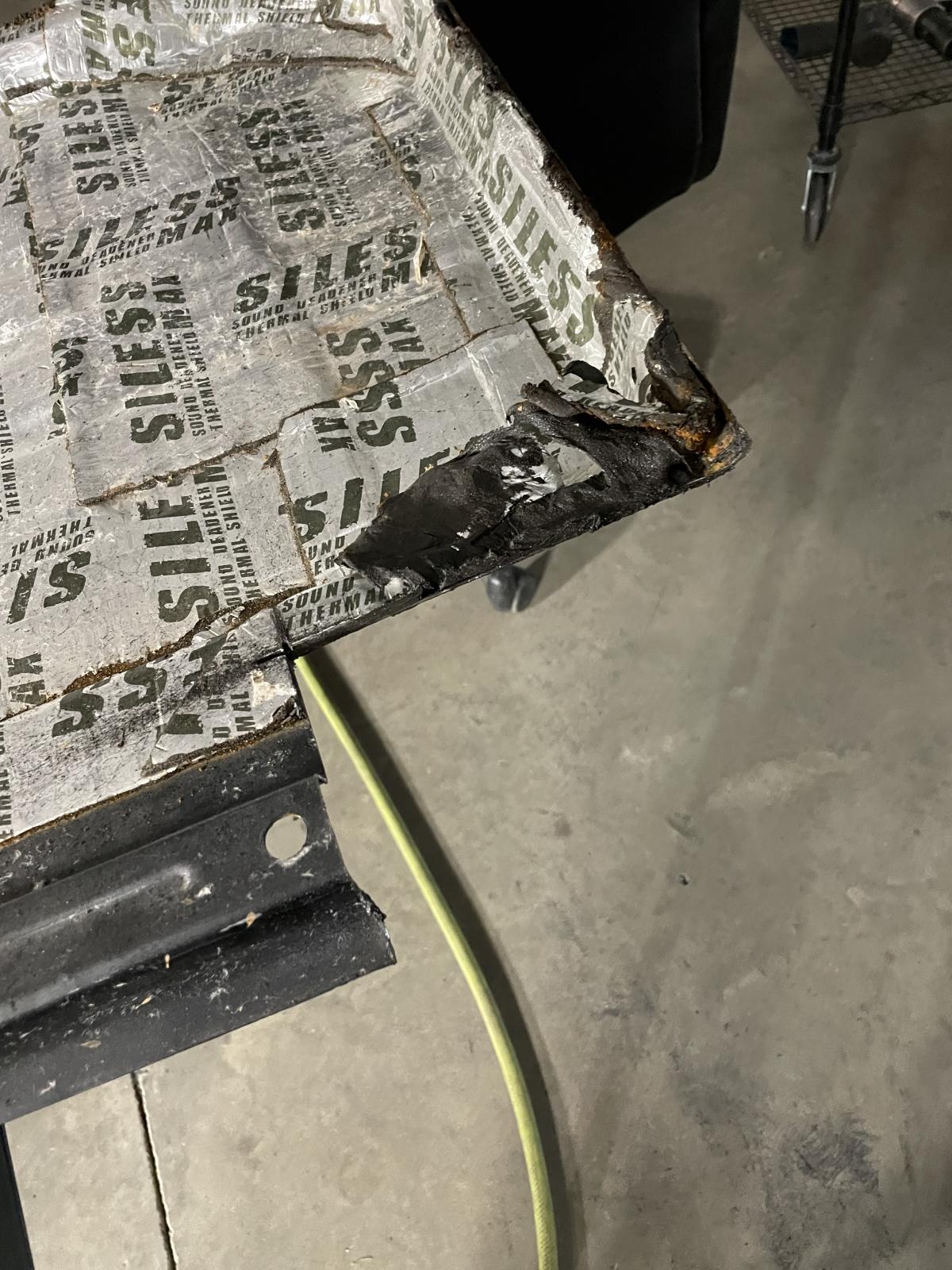

I’m going to get real technical with this chassis. I have a Strong Hand Tools 4x8 modular fab table that is designed to handle jobs like this. Using the table and accessories with the modular layout I will be able to pin it down accurately so we can begin to reconstruct it.
I have a donor pan that I’m going to carefully remove the tunnel cap from so we have a proper replacement. I will also be replacing the fuel line and reinforcing the clutch tube in multiple places.

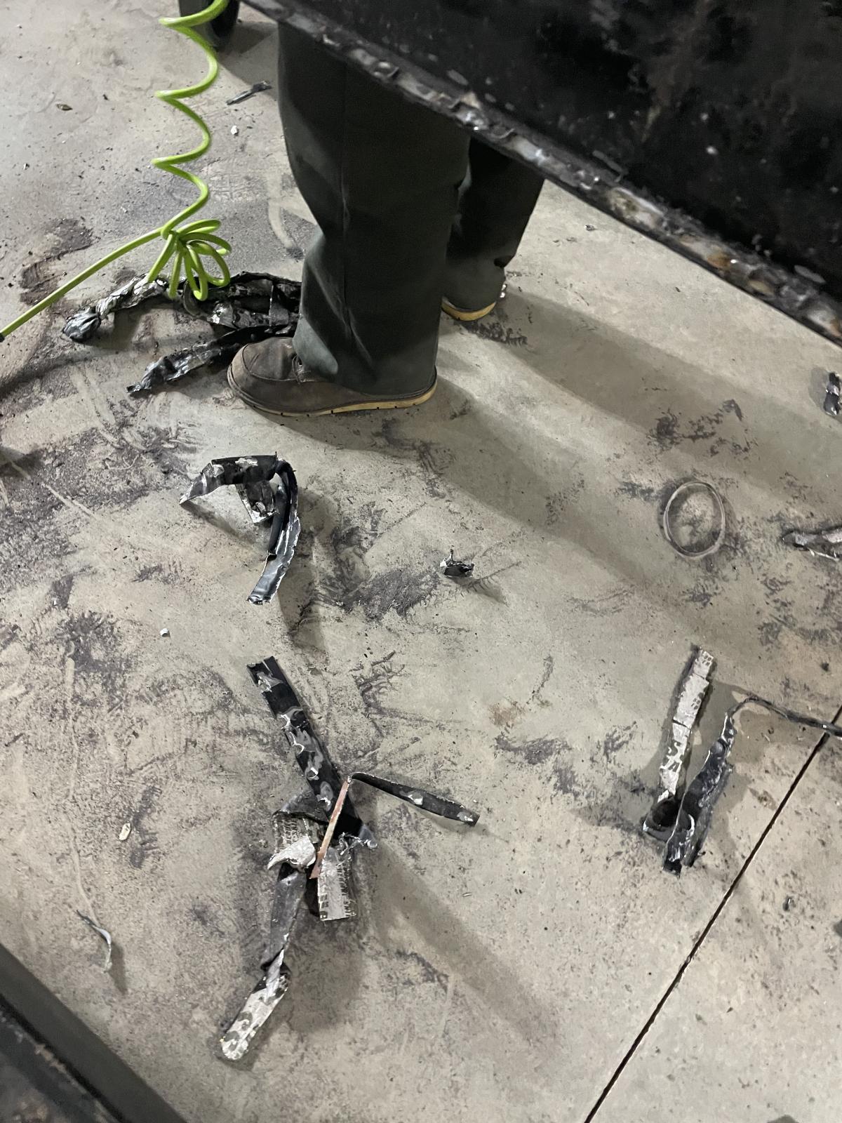

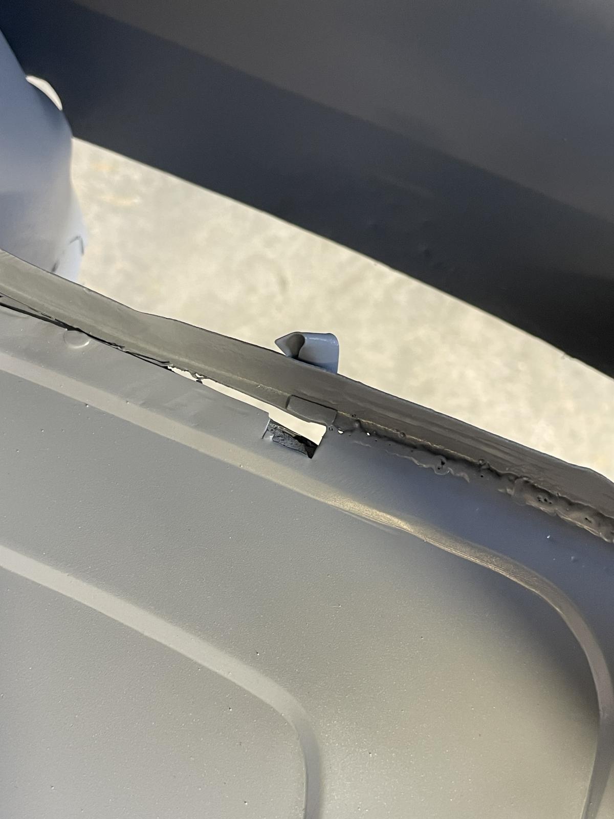

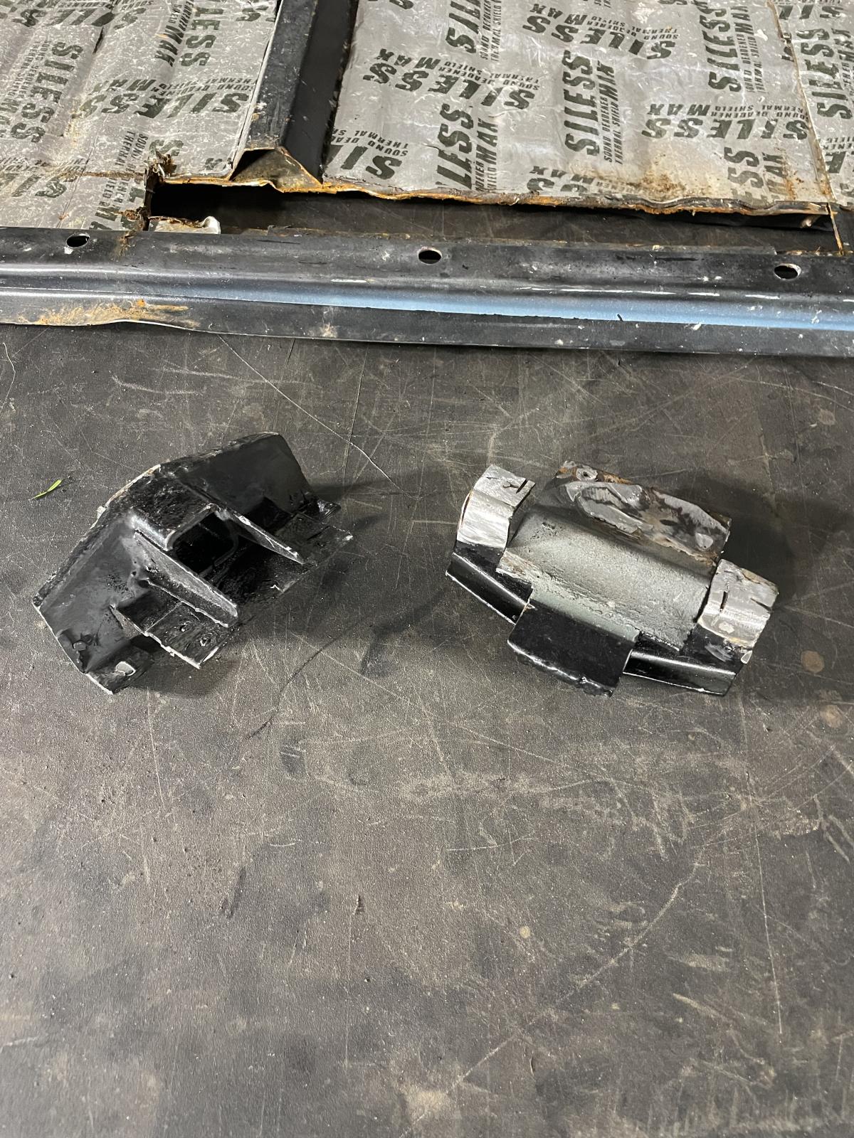

PostPosted: Fri Mar 28, 2025 7:13 pm    Post subject: Re: 57 Kab Reconstruction/Restoration Reply with quote

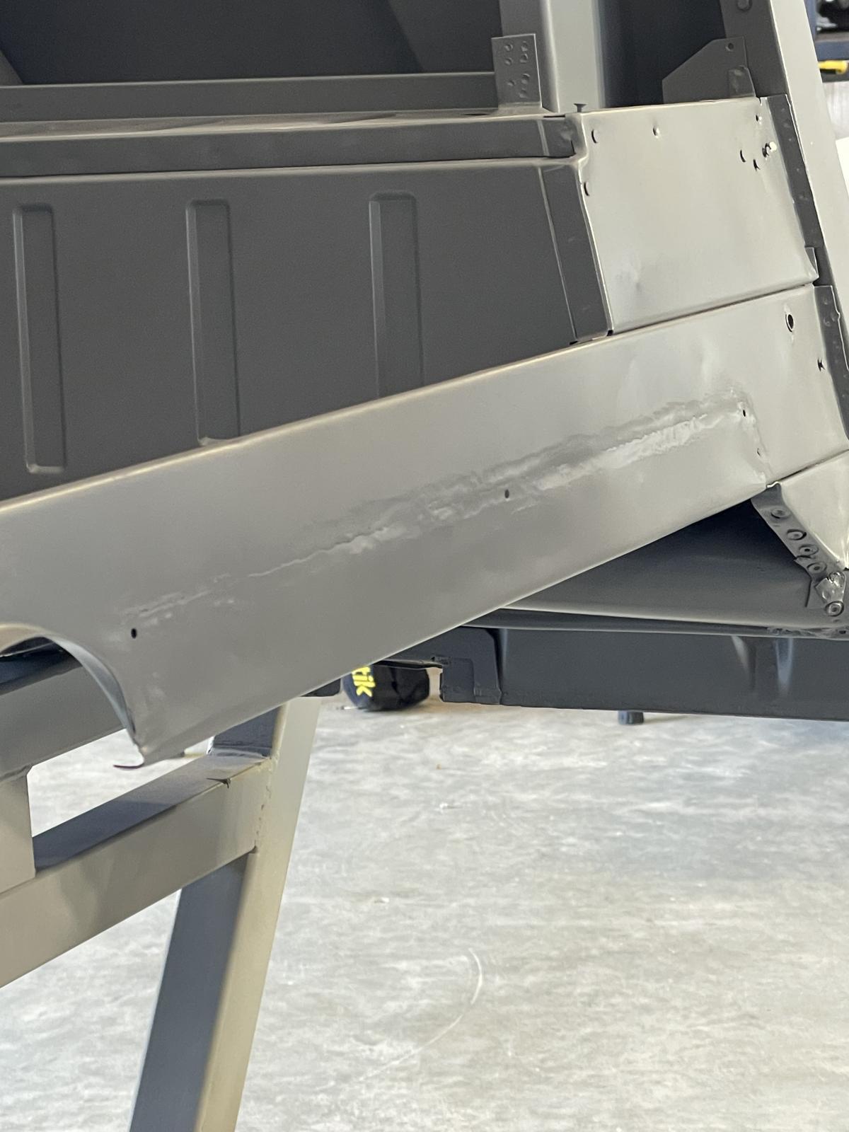

This poor pan….

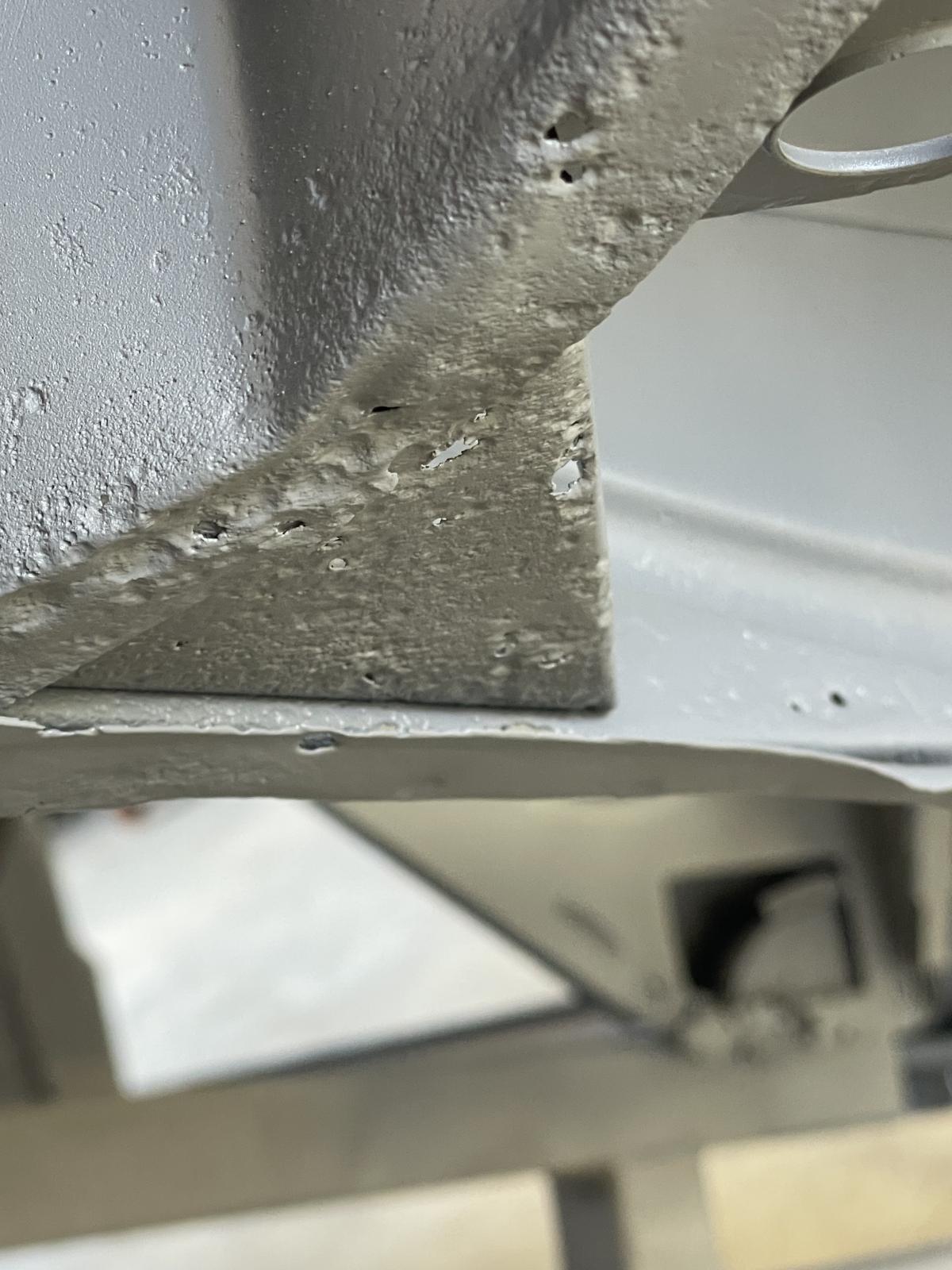

We finally got the remainder of the tunnel cap off. My son and I were trying to make sense of what the last shop was up to. The first side we got off without to much of a fuss with the air hammer. Then when got to the other side we quickly discovered they attempted to drill out the spot weld with a 3/8 bit. But somehow they missed almost every spot weld ,so I would assume that’s when they gave up and cut it off in the field. Using the air hammer on that side it would go through the factory spot welds but when it came to the hole they drilled and then tried to weld back up they weren’t connected, they failed to fuse the to materials back together. Rolling Eyes The next noticeable thing was that they failed to get the hump to the cap welded back without changing the shape, some areas where wider then factory. I told my son it looked like a small snake ate a rabbit…. anyhow… enough about all that , we got it to a point we can work with

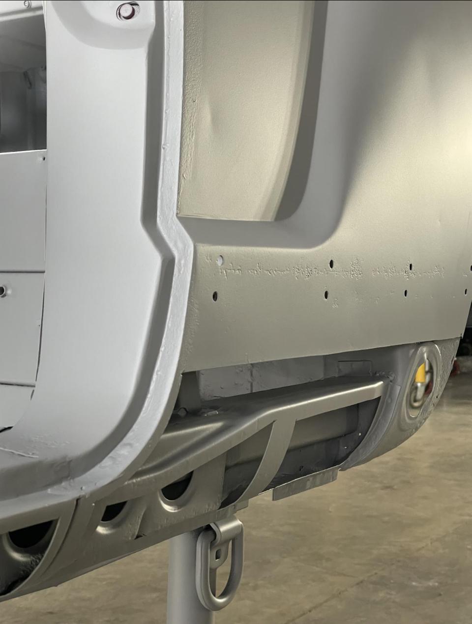

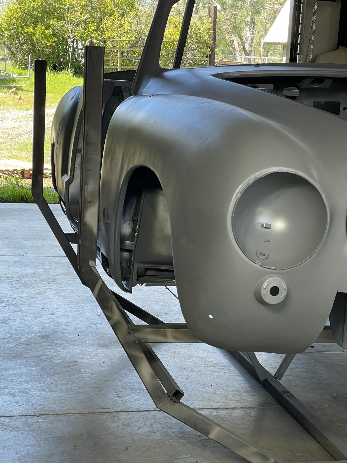

PostPosted: Mon Mar 31, 2025 5:14 pm    Post subject: Re: 57 Kab Reconstruction/Restoration Reply with quote

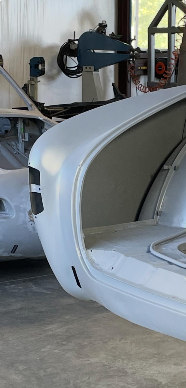

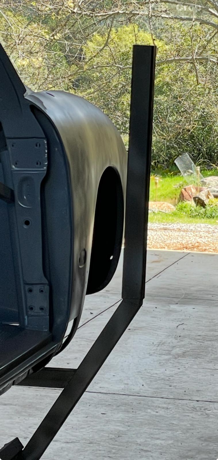

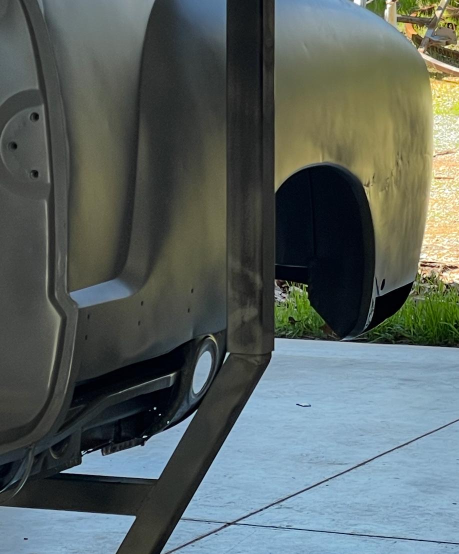

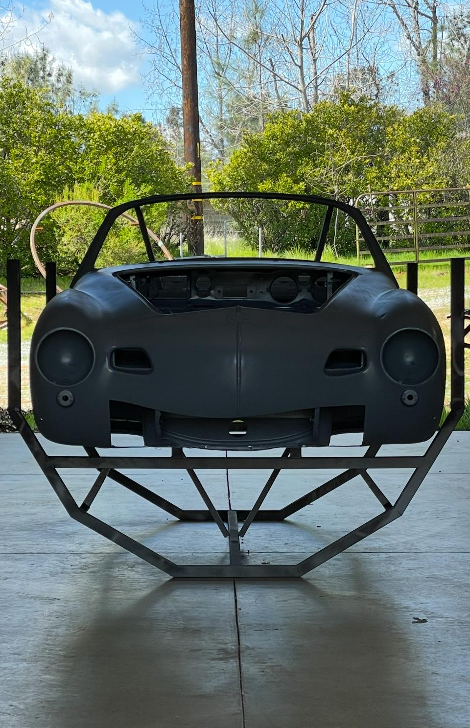

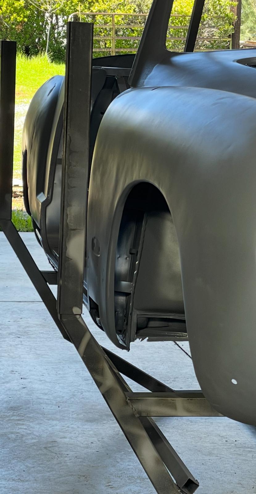

Ok folks. My son and I got my donor pan in and began to harvest the tunnel cap off, It is in amazing condition. We are going to cut the tunnel away and remove the unwanted flanges is such a way that the cap flanges themselves will be undisturbed and ready to marry to the other tunnel.
I just received word that the body is ready for pick up at the blaster so I will be going down Wednesday to bring it back to the Werkshop.
I will be sure to post up pictures.

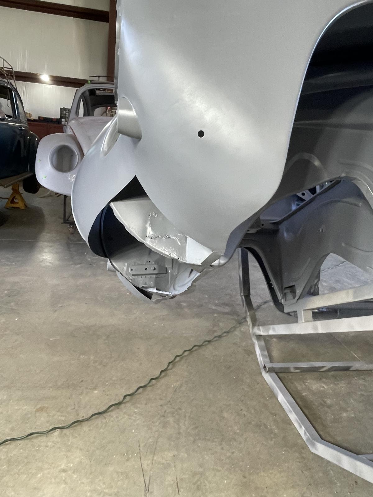

WrennMetallWerks
Posts: 3314
Location: Rescue ca

Poor car has had a rough life! It's in good hands now.

Loren Premium Member
Joined: January 10, 2004
Posts: 1810
Loren is offline

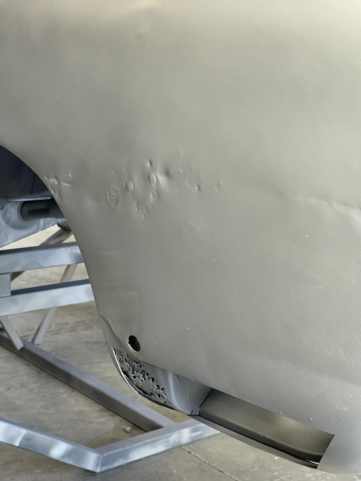

PostPosted: Wed Apr 02, 2025 4:37 pm    Post subject: Re: 57 Kab Reconstruction/Restoration Reply with quote

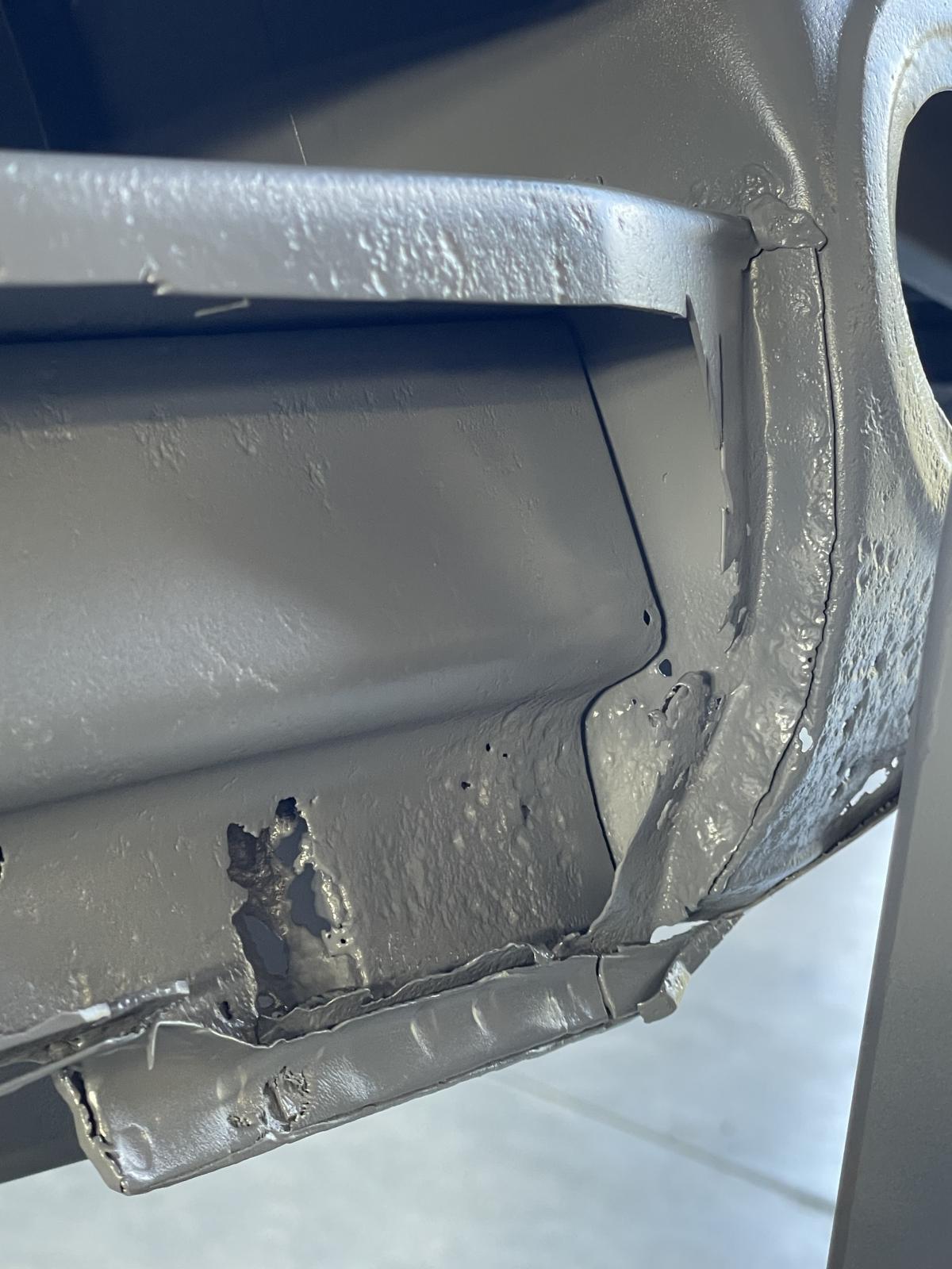

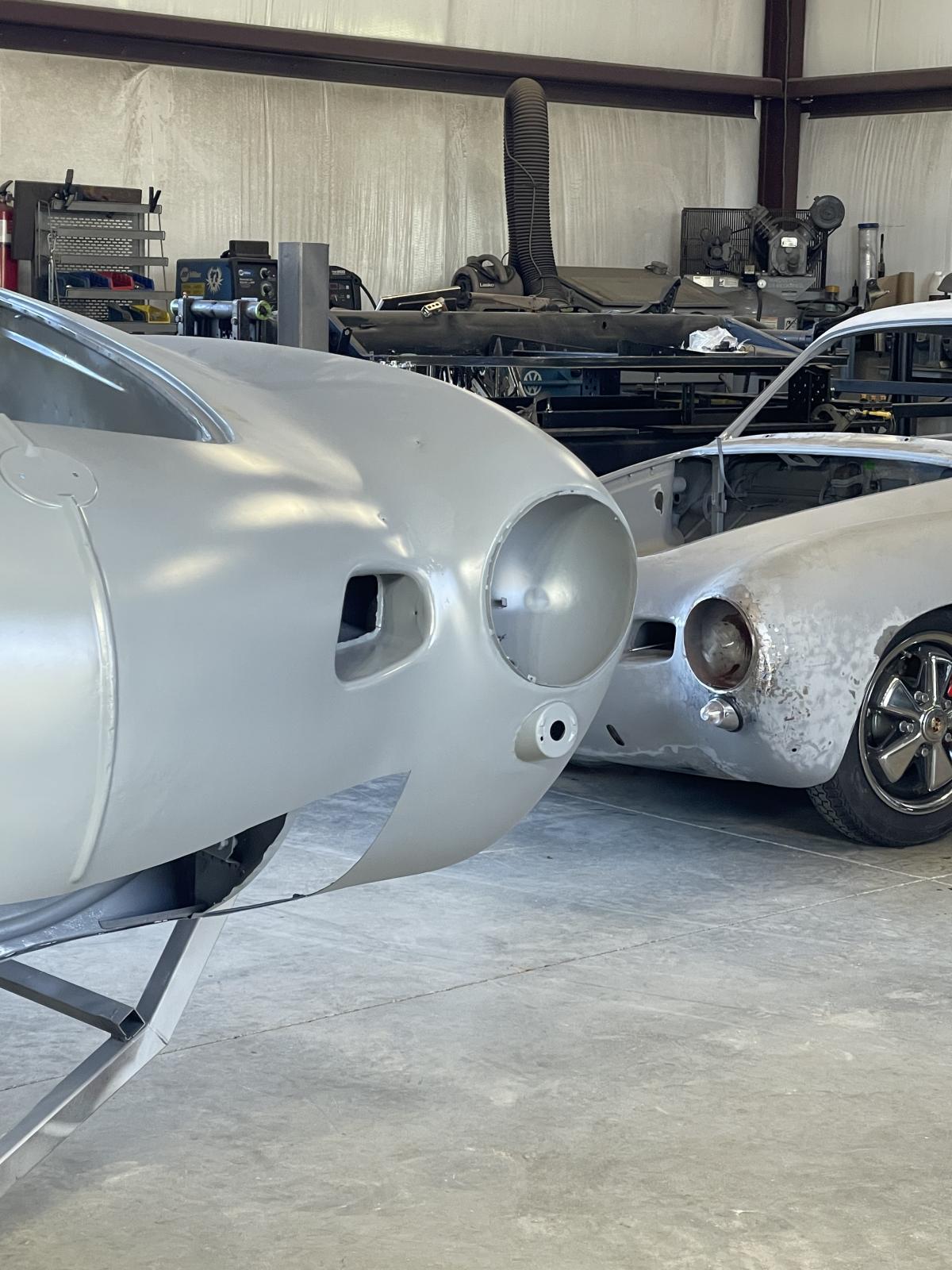

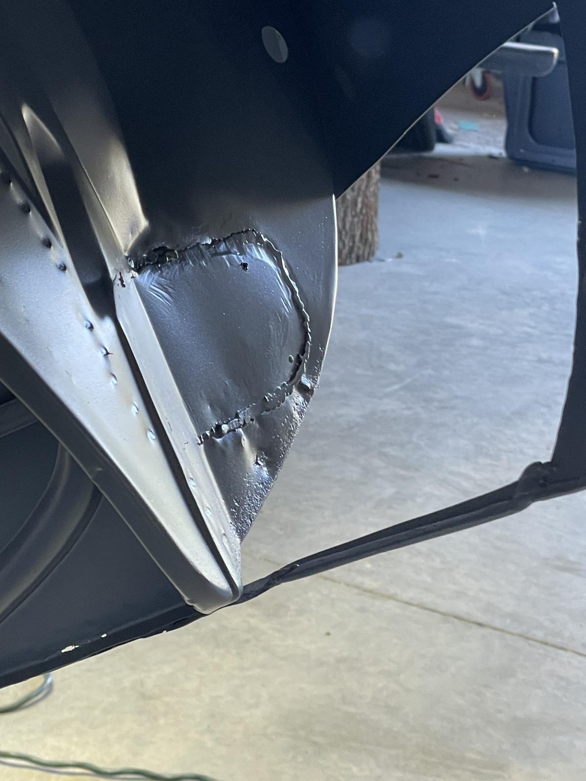

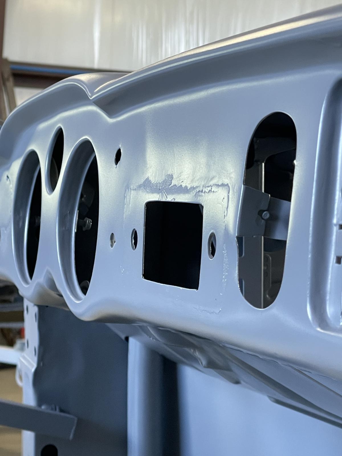

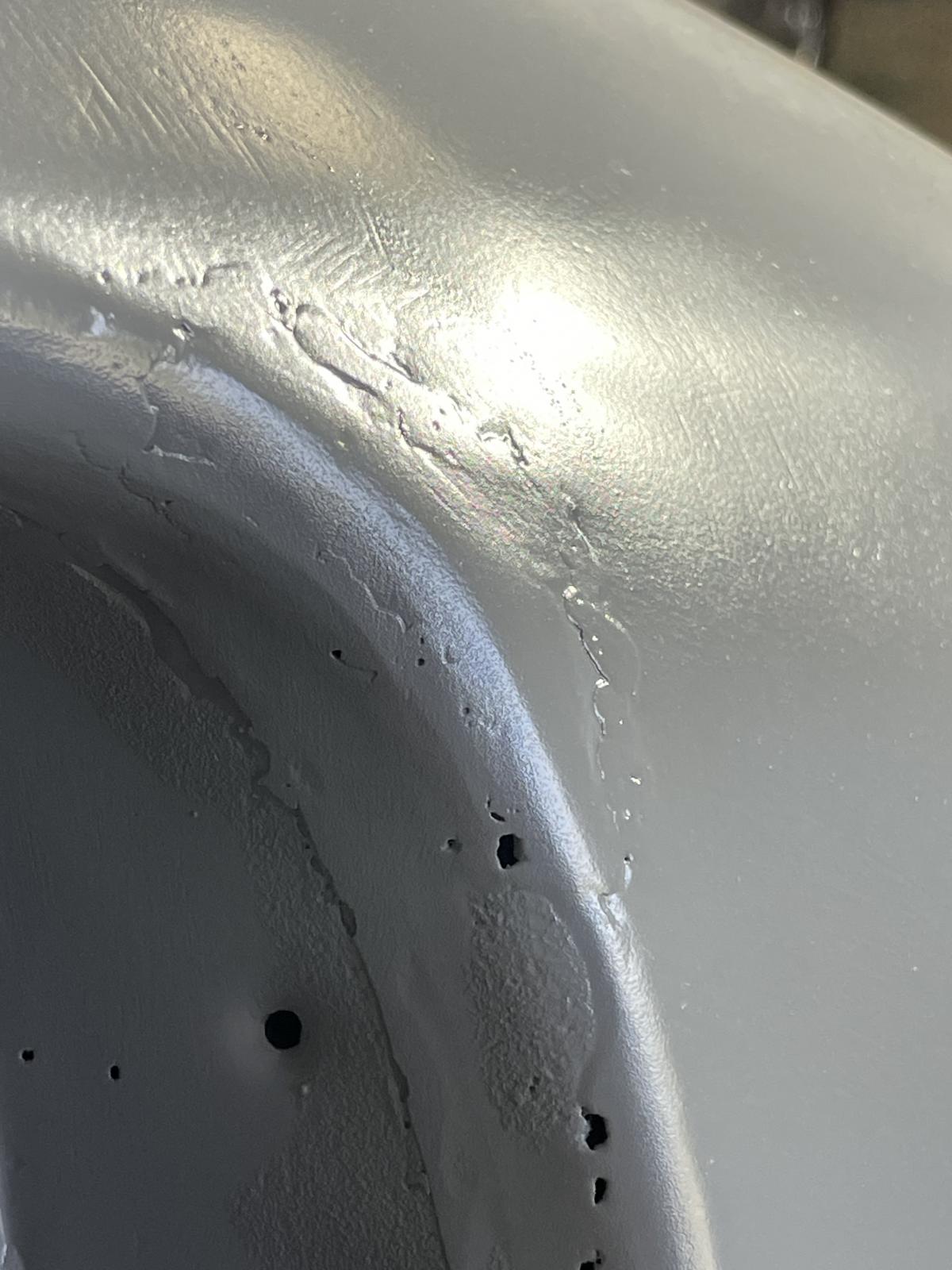

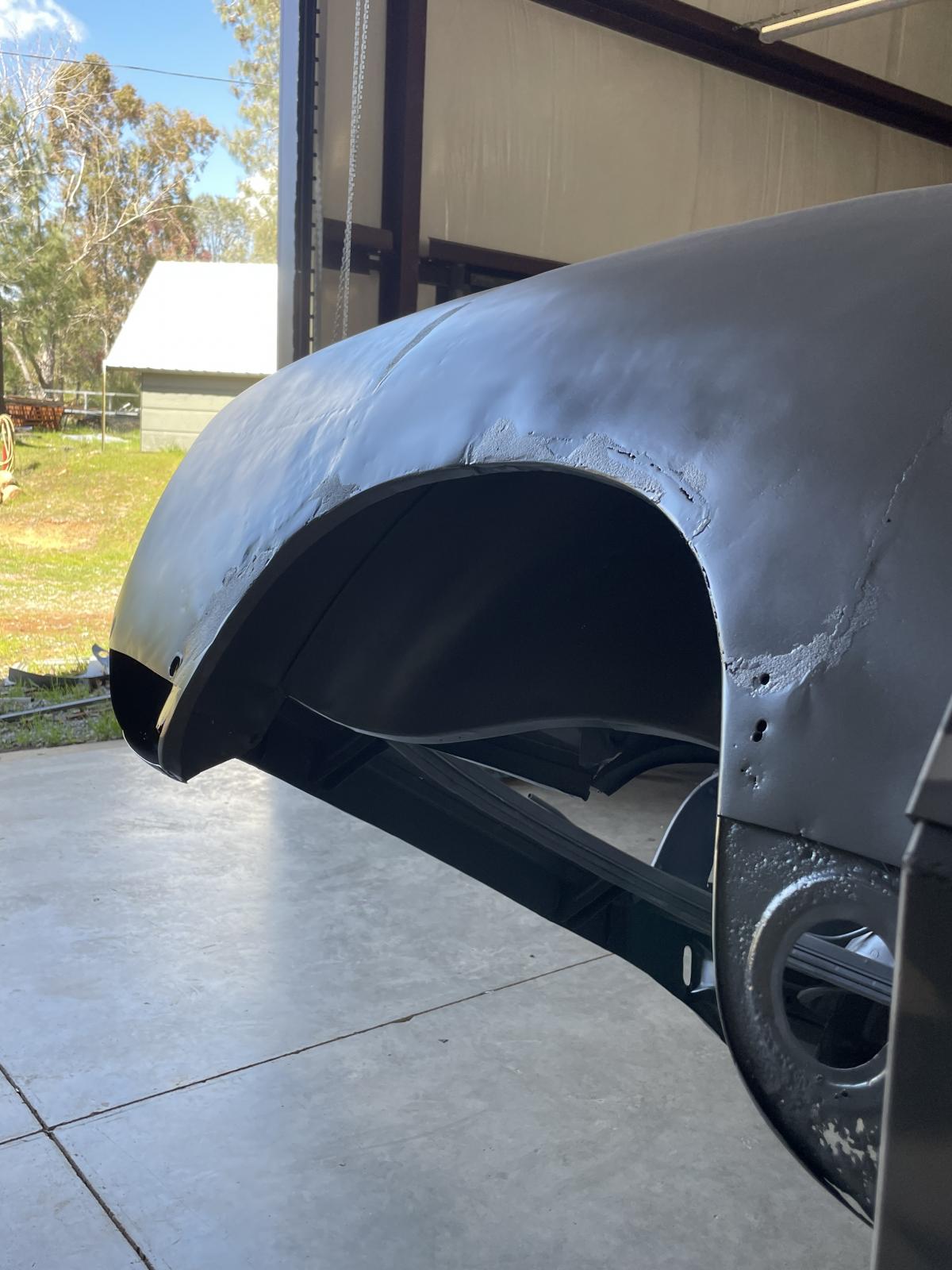

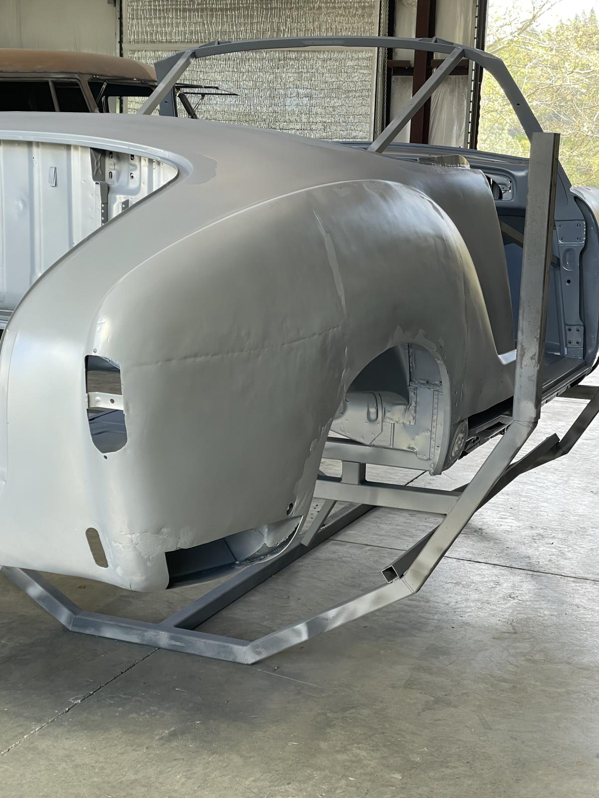

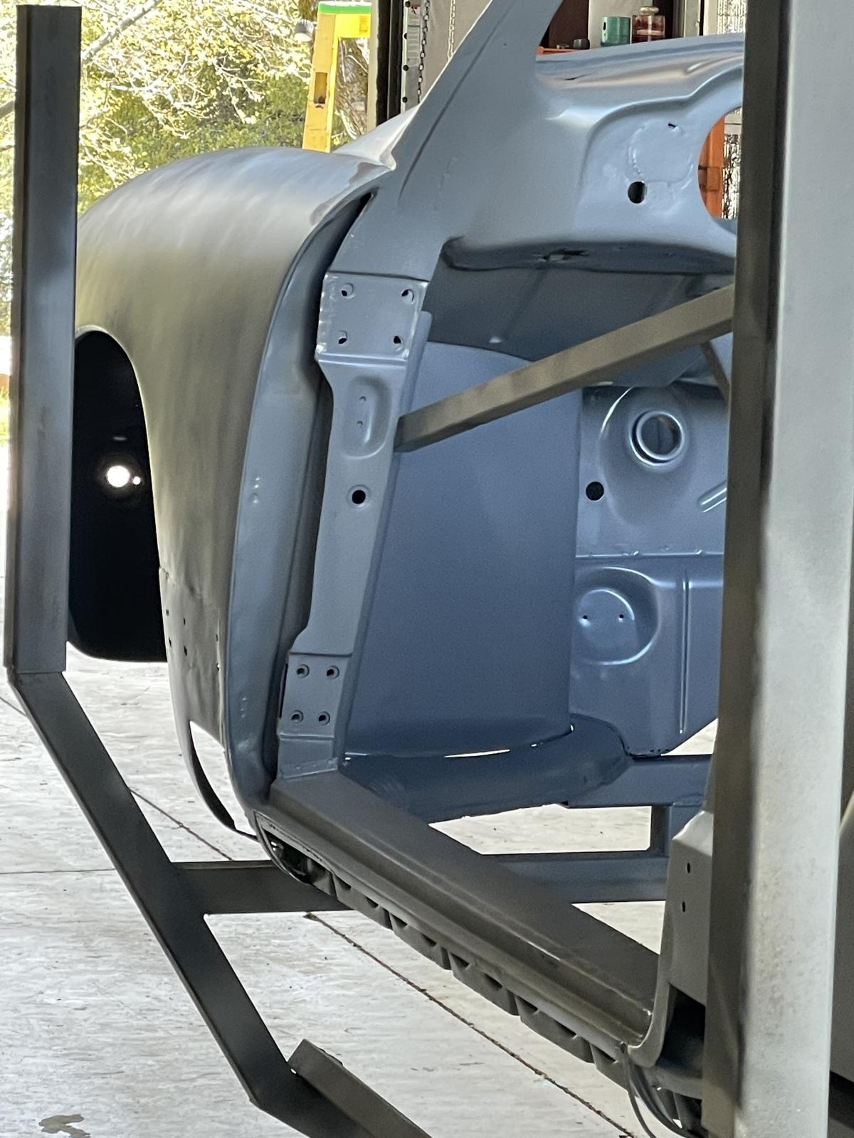

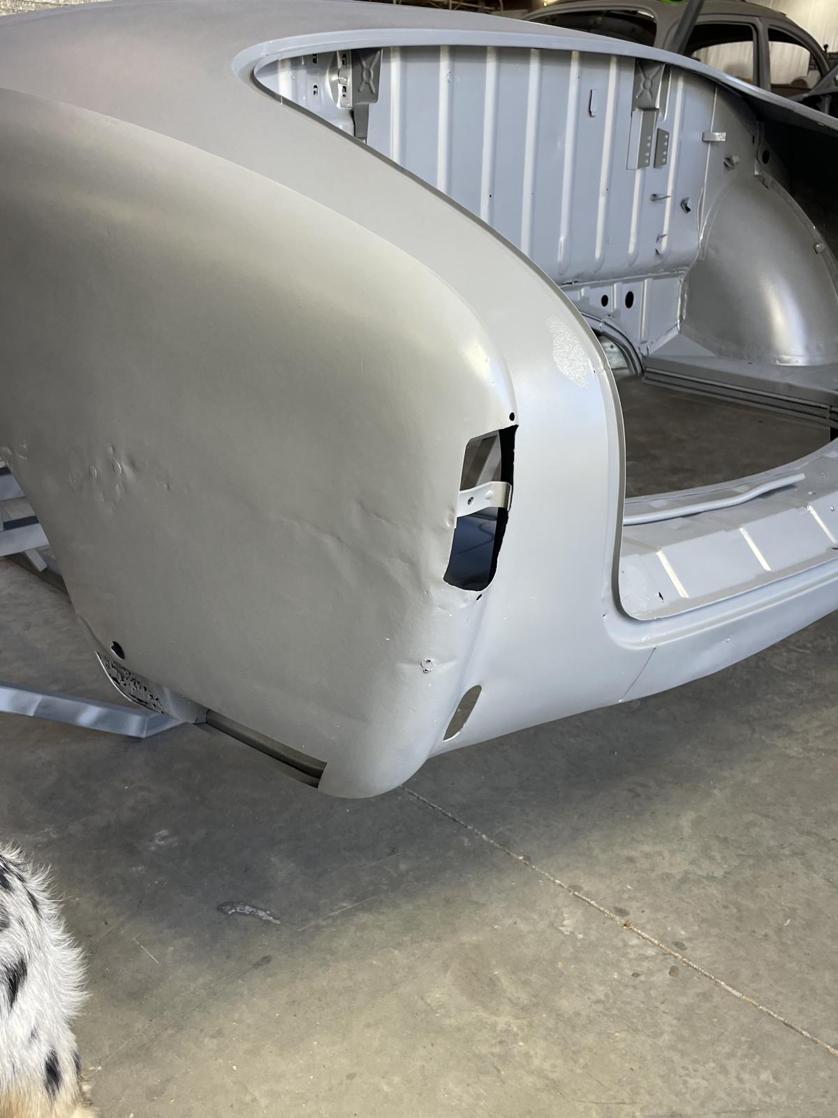

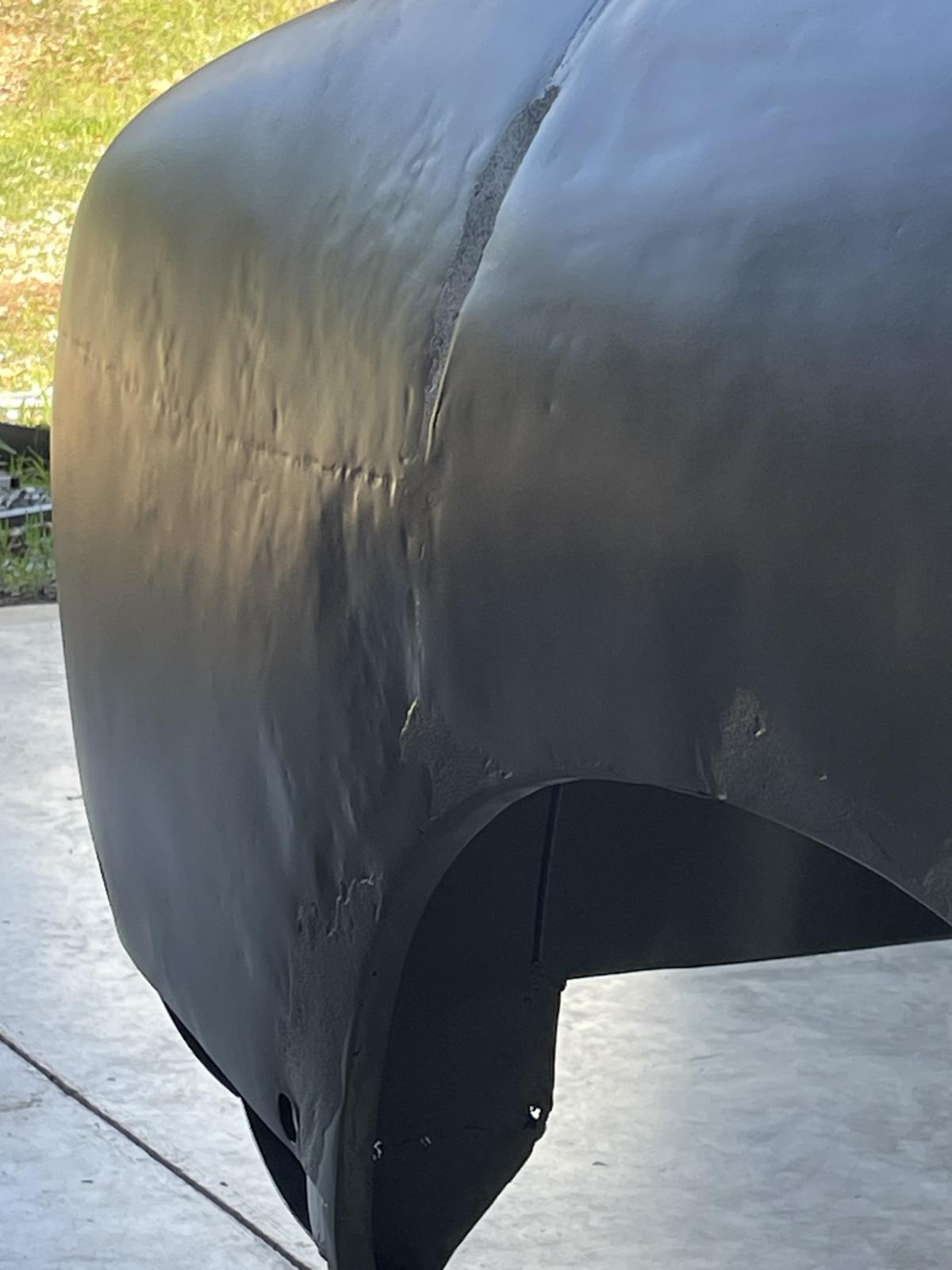

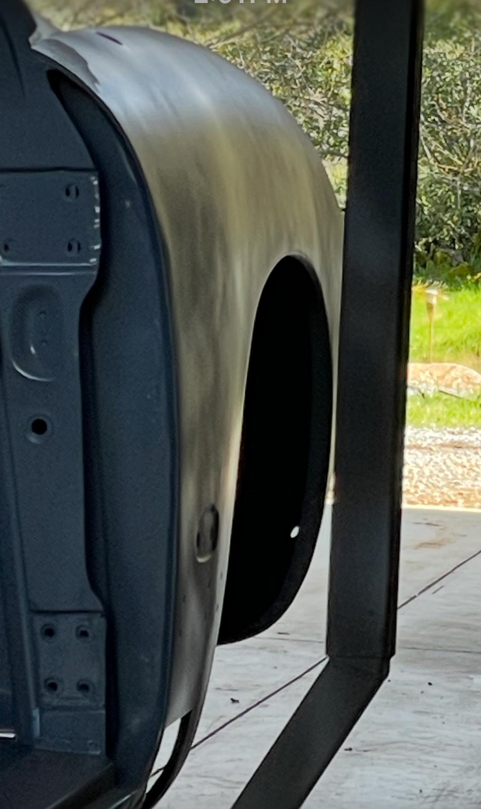

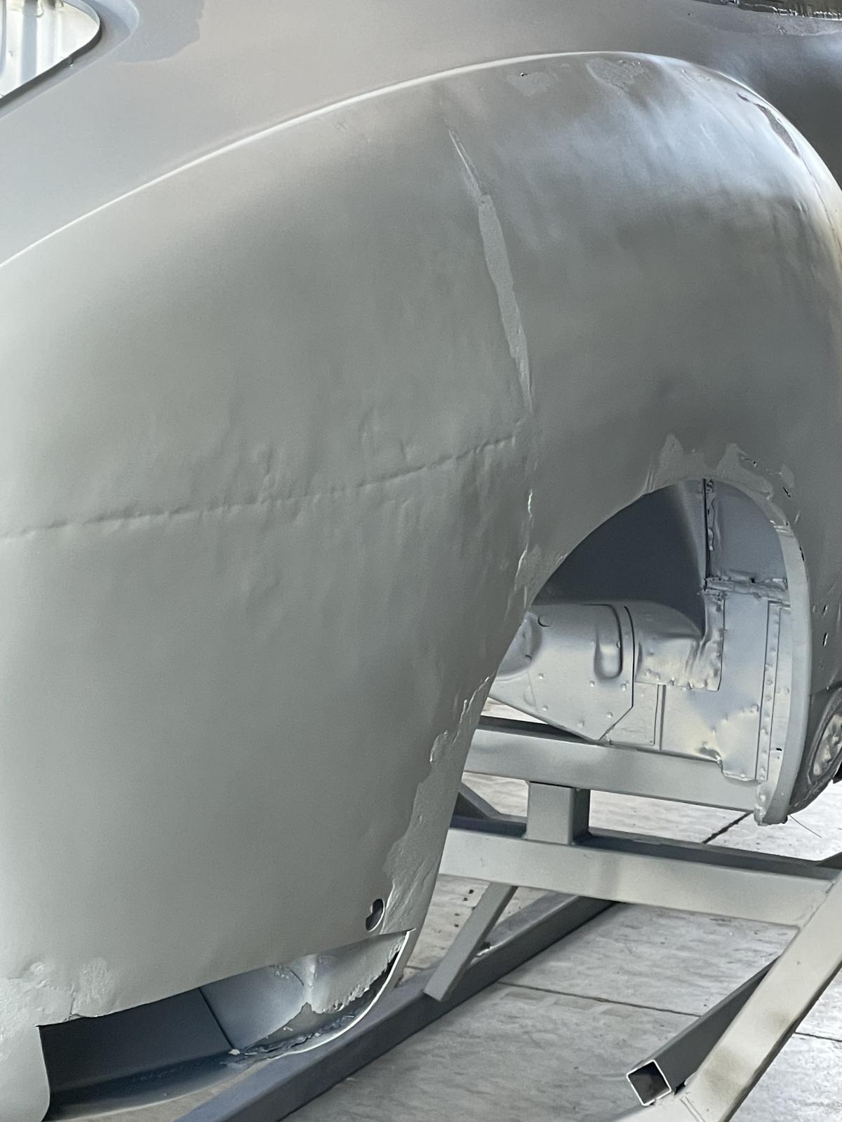

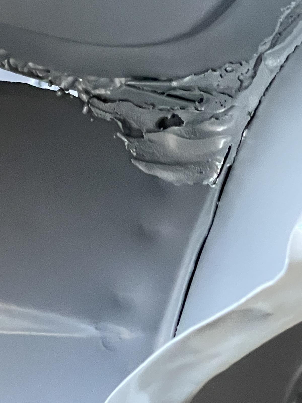

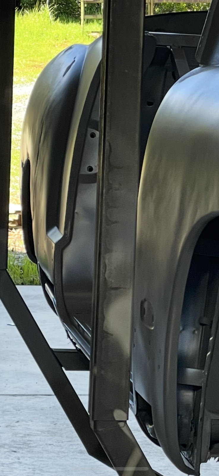

Wow! That is going to require a lot of repair work. I can't believe how lumpy the body panels look. It's going to be great to see this car put back together.
WrennMetallWerks
Posts: 3314
Location: Rescue ca

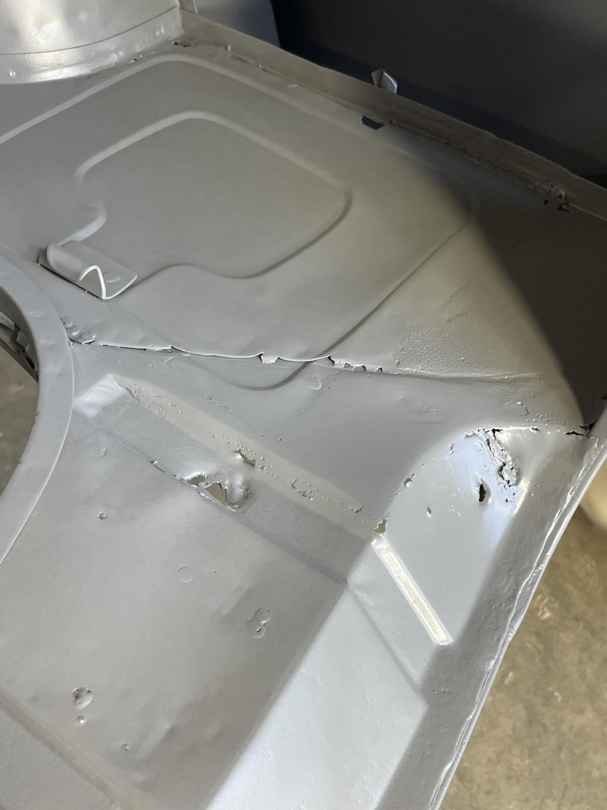

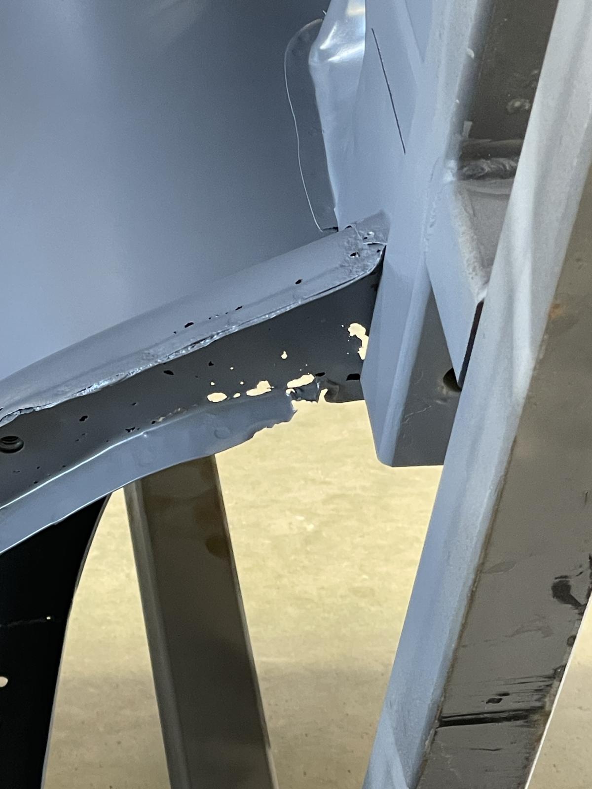

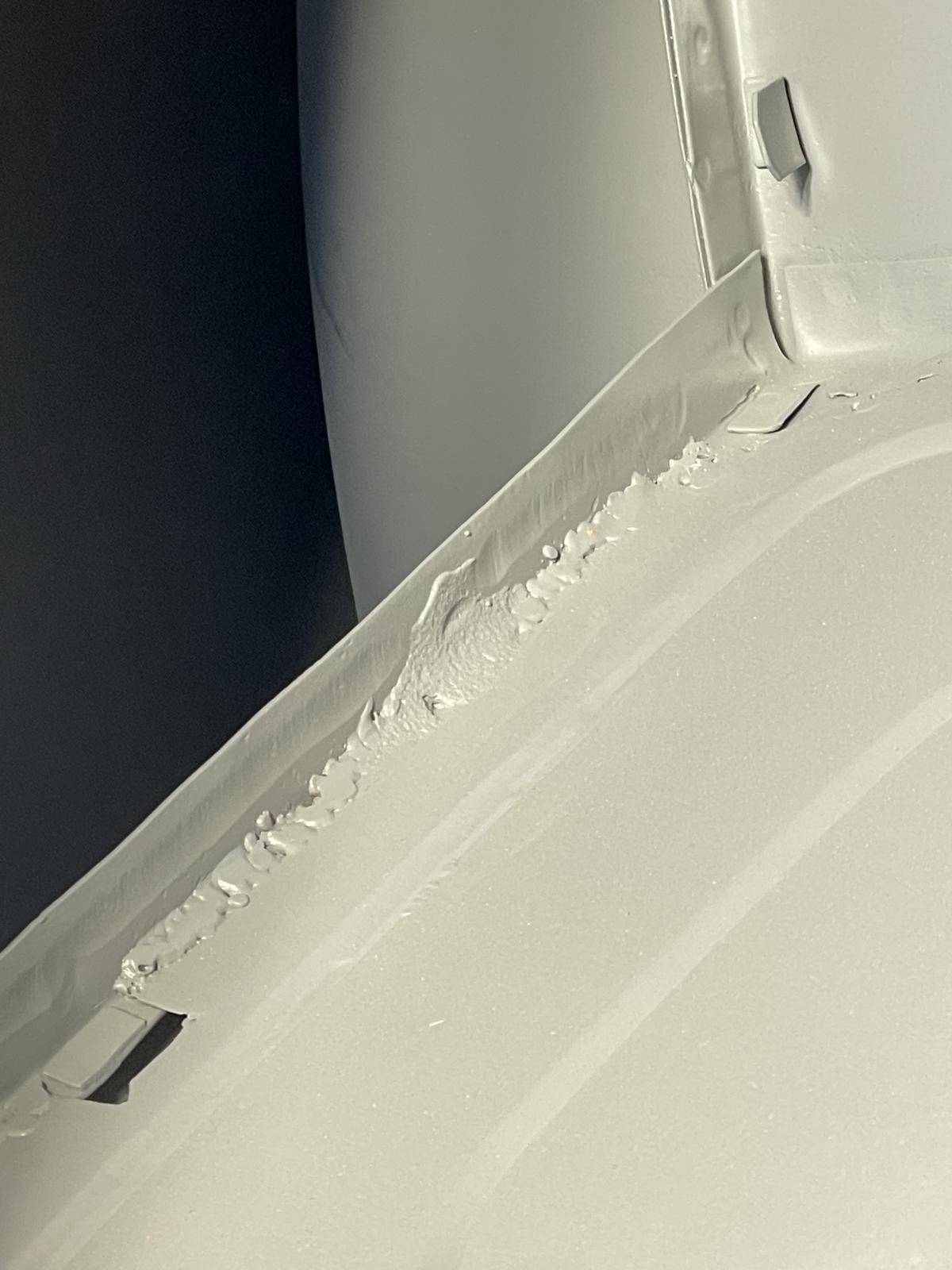

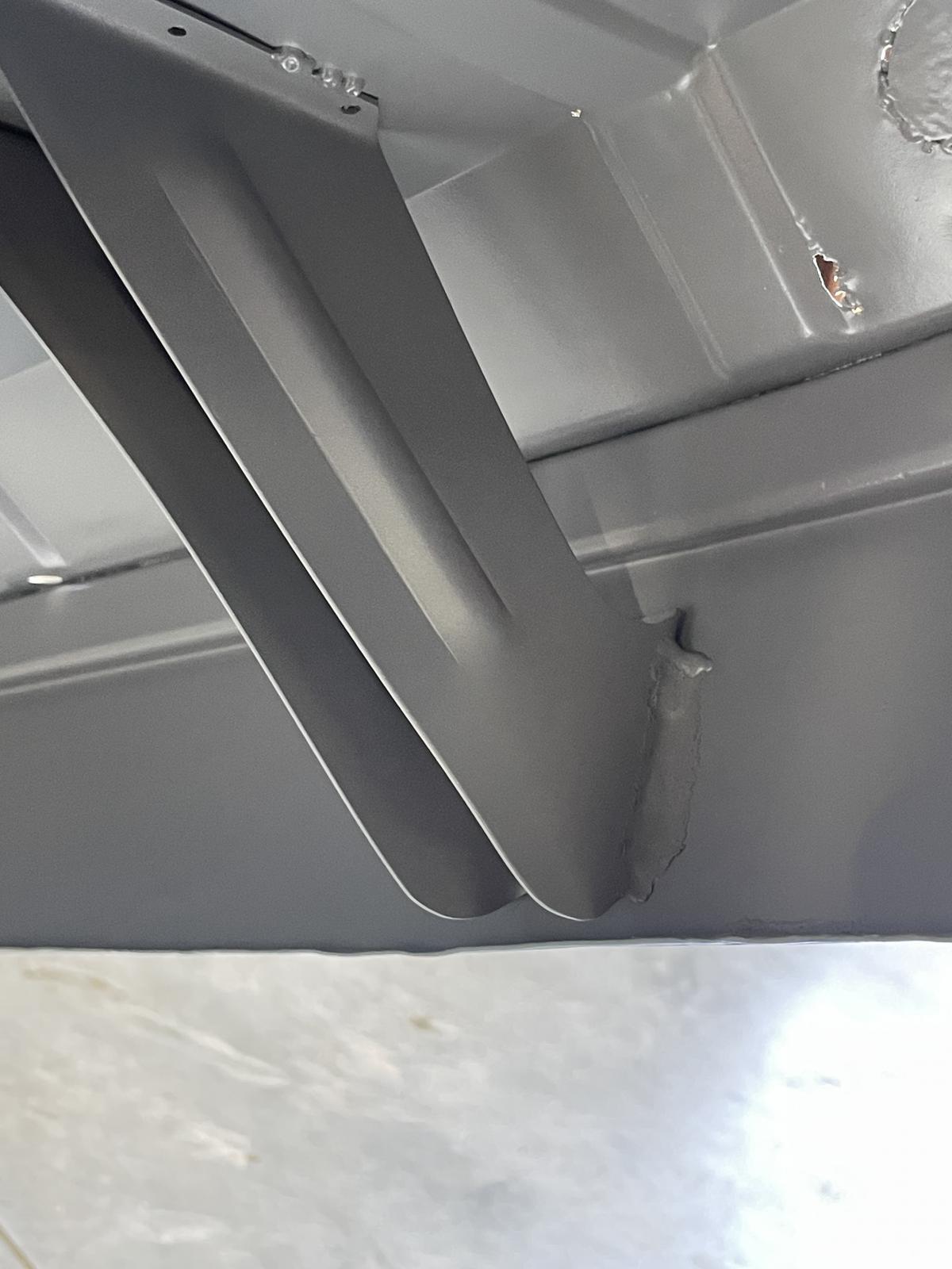

PostPosted: Wed Apr 02, 2025 5:24 pm    Post subject: Re: 57 Kab Reconstruction/Restoration Reply with quote
Hey Mr Loren.

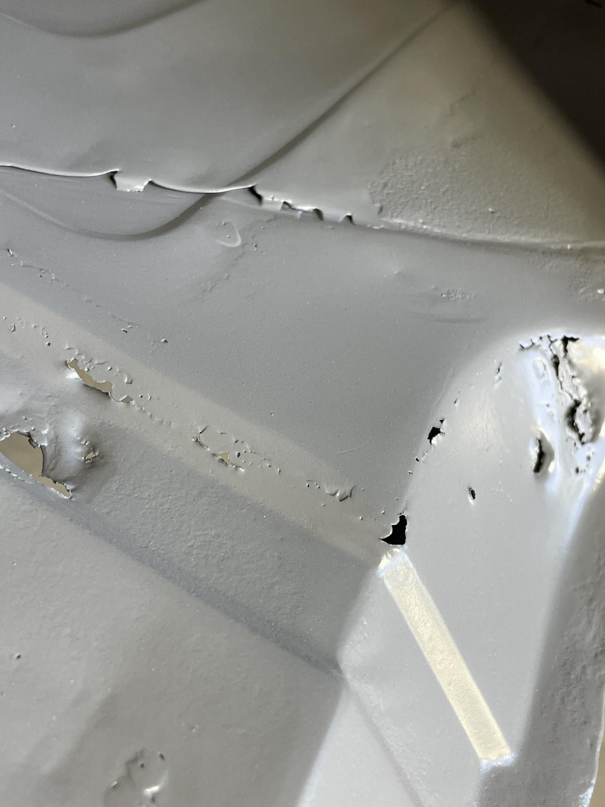

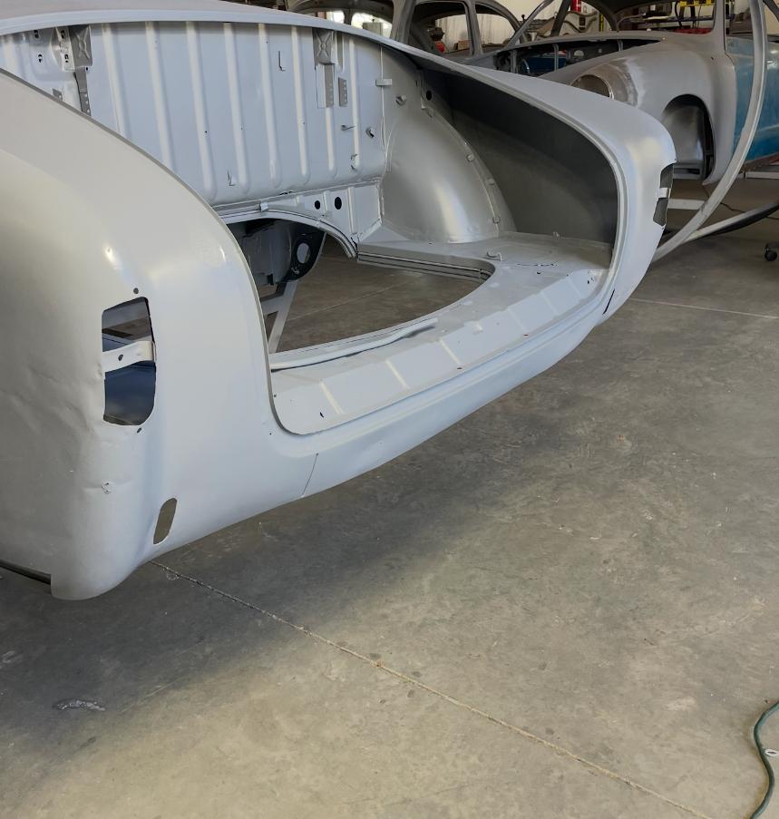

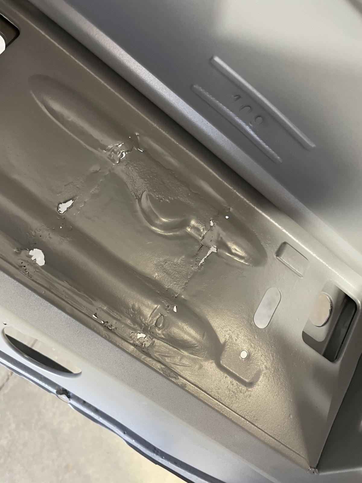

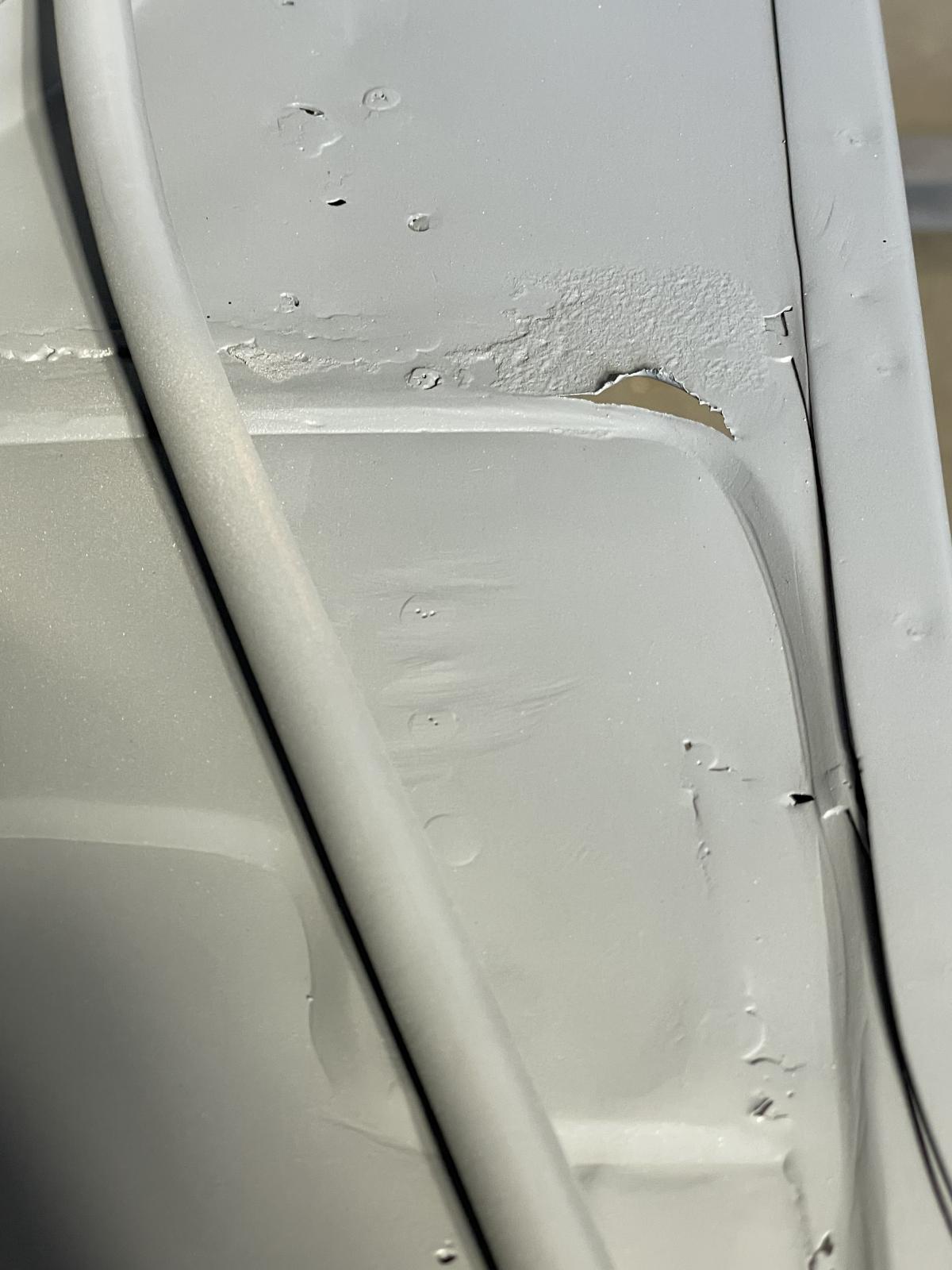

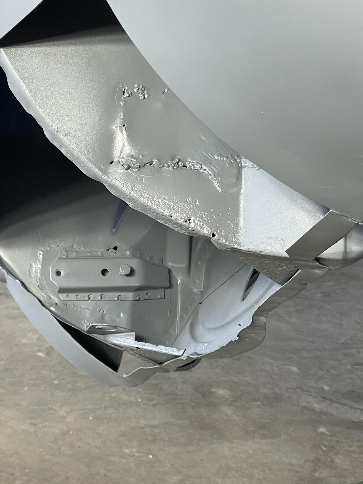

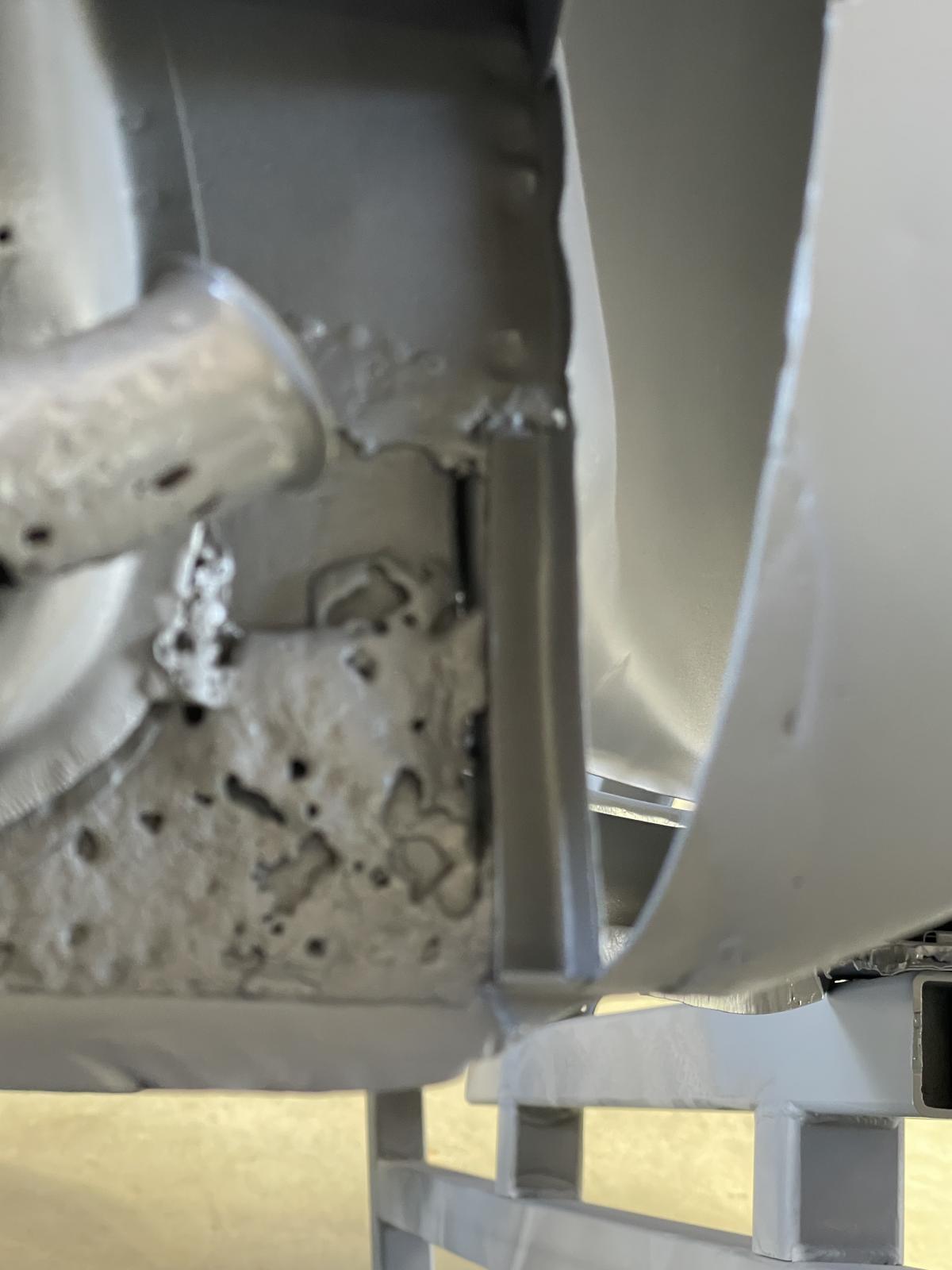

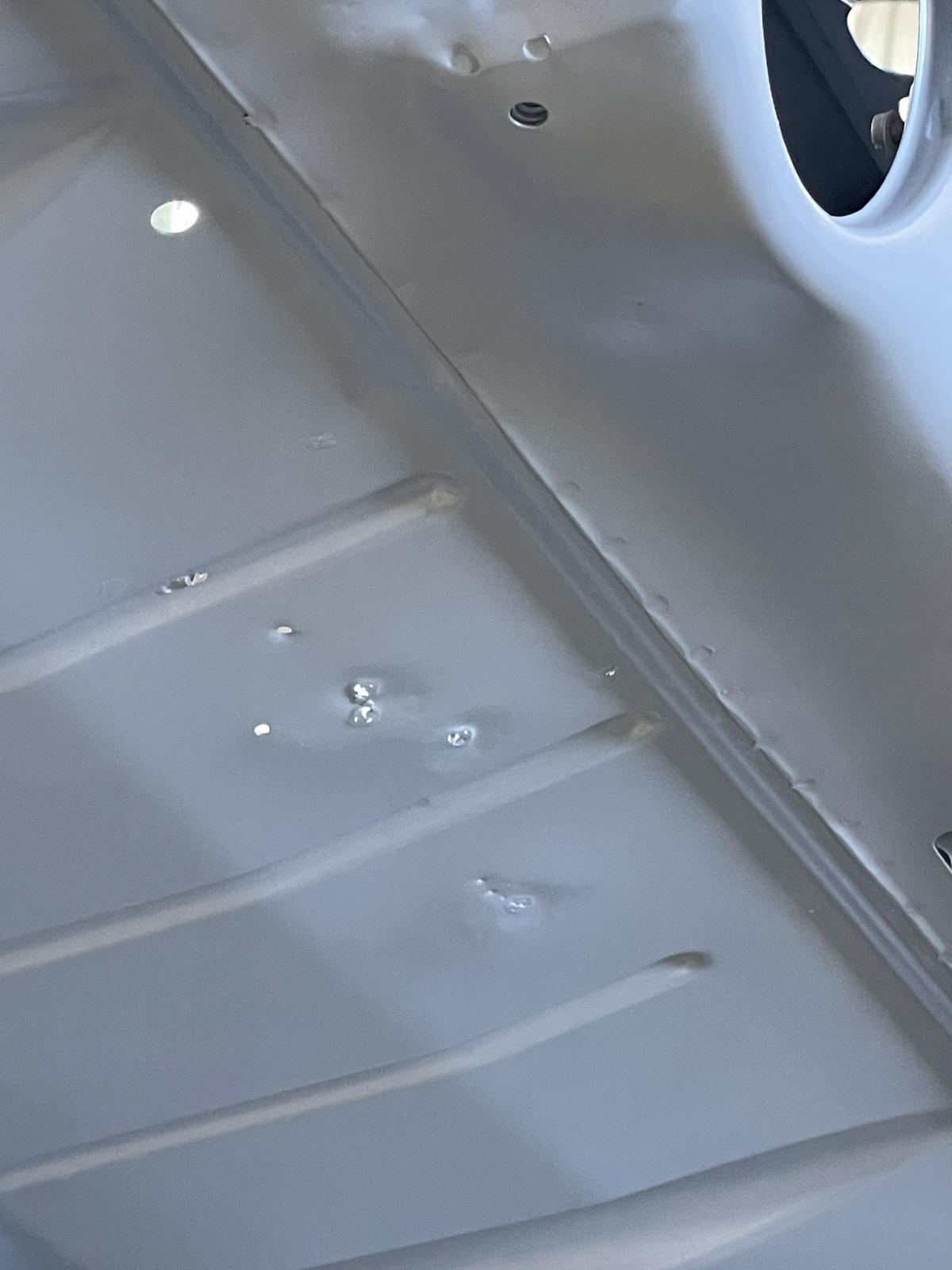

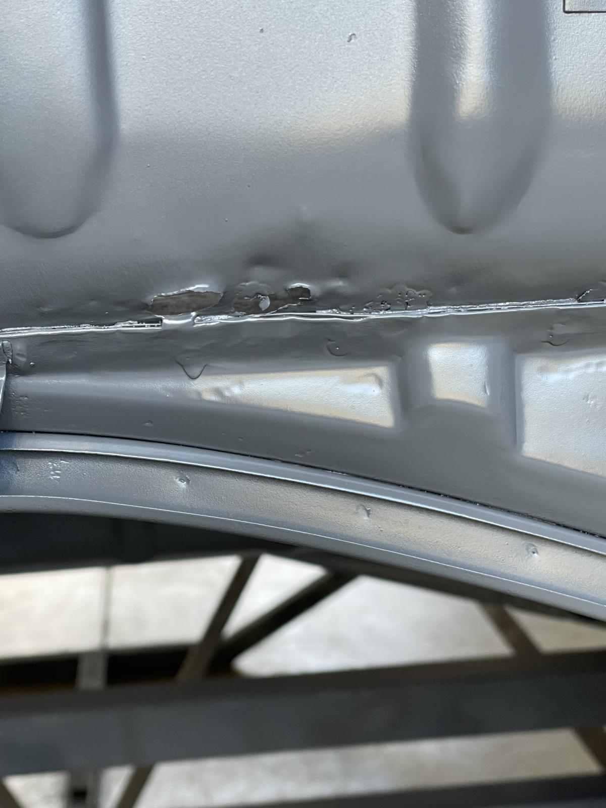

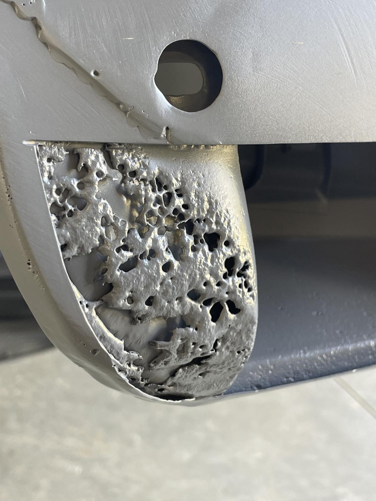

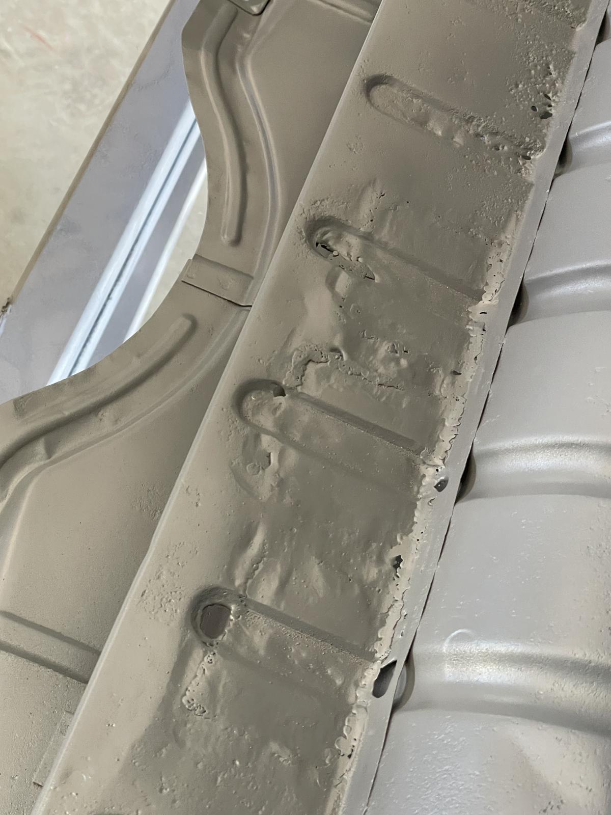

Talking with the guys today at American Stripping we both agreed that the body and the removables must have been previously blasted and unfortunately some of what we see here is warping from the heat of the sand. If extra care is not taken on a VW the sheet metal can warp fairly easy. I have seen this in my early days trying to go to the cheapest guy in the market.

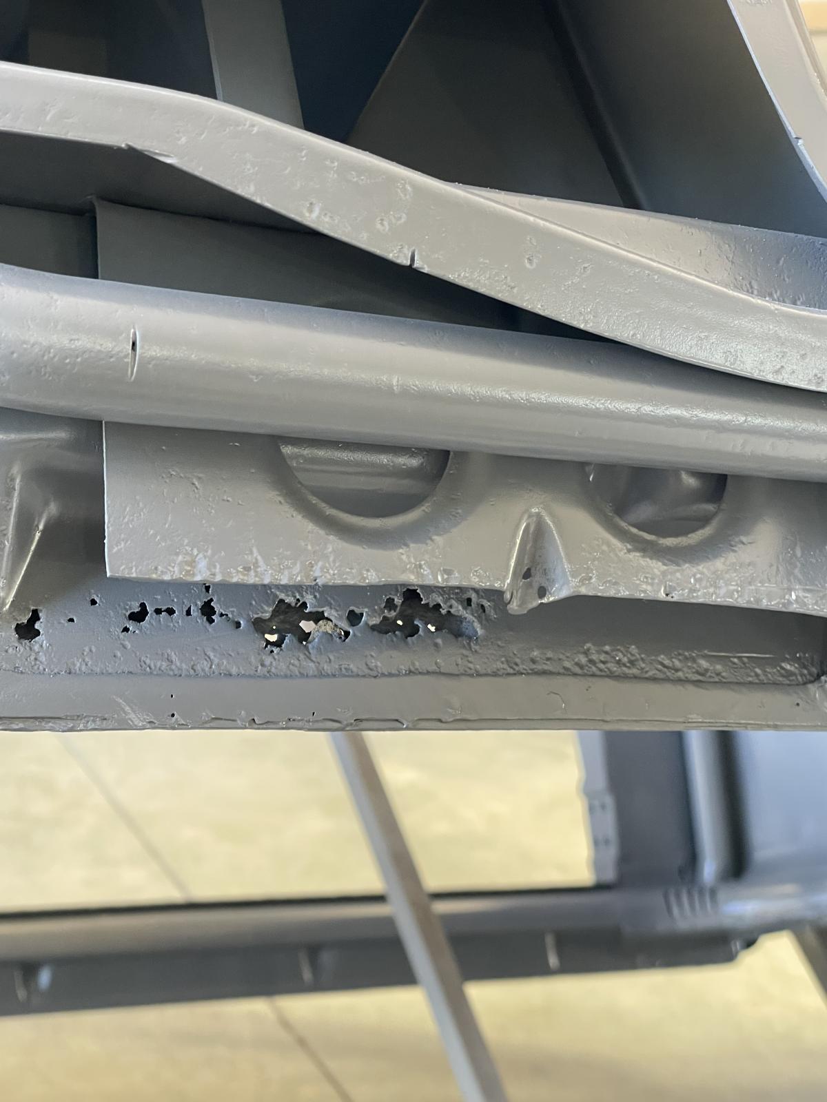

PostPosted: Wed Apr 02, 2025 9:21 pm    Post subject: Re: 57 Kab Reconstruction/Restoration Reply with quote
Dang, someone did that car dirty! That's alot to unfold... but you got it brother man!

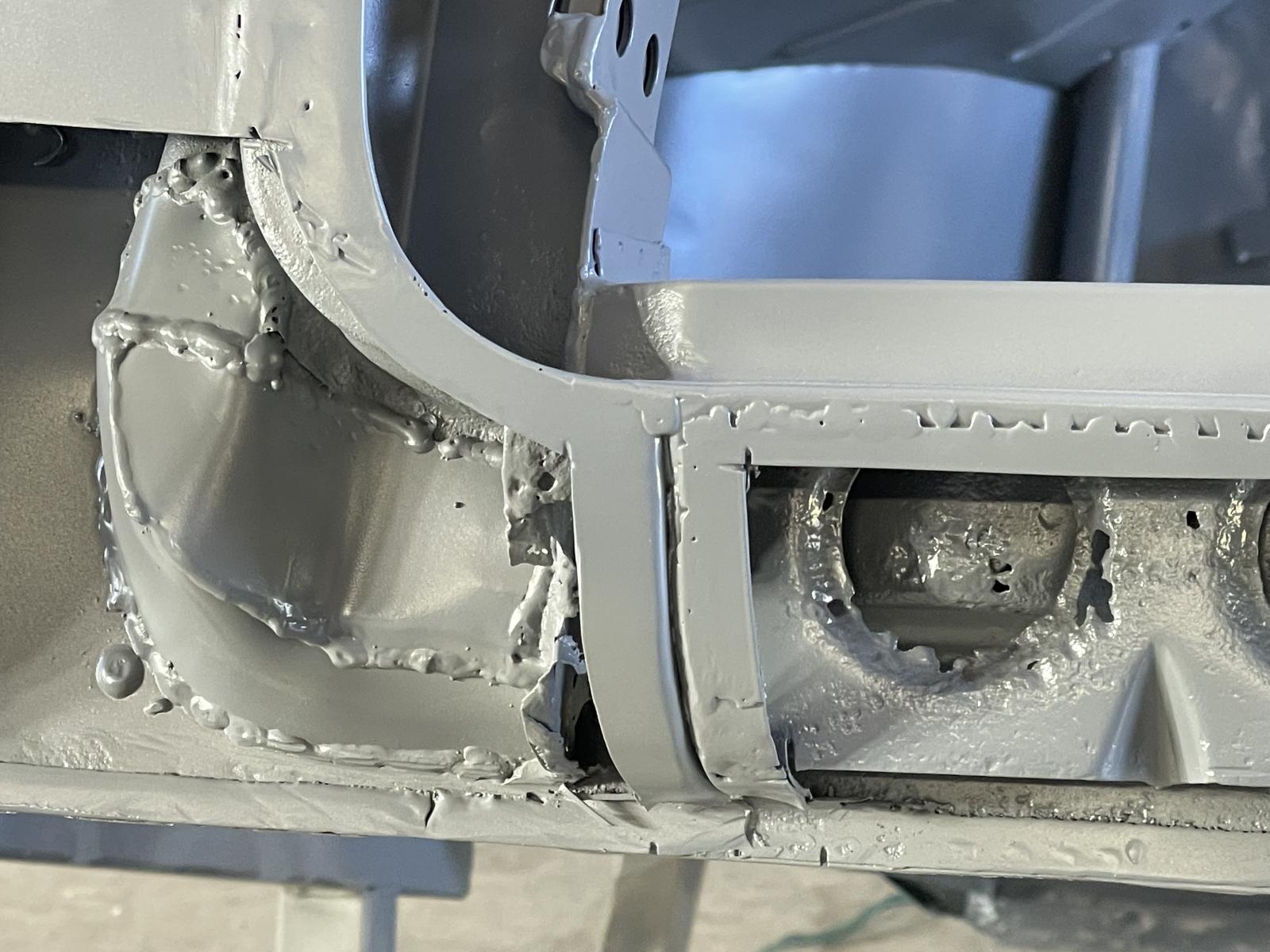

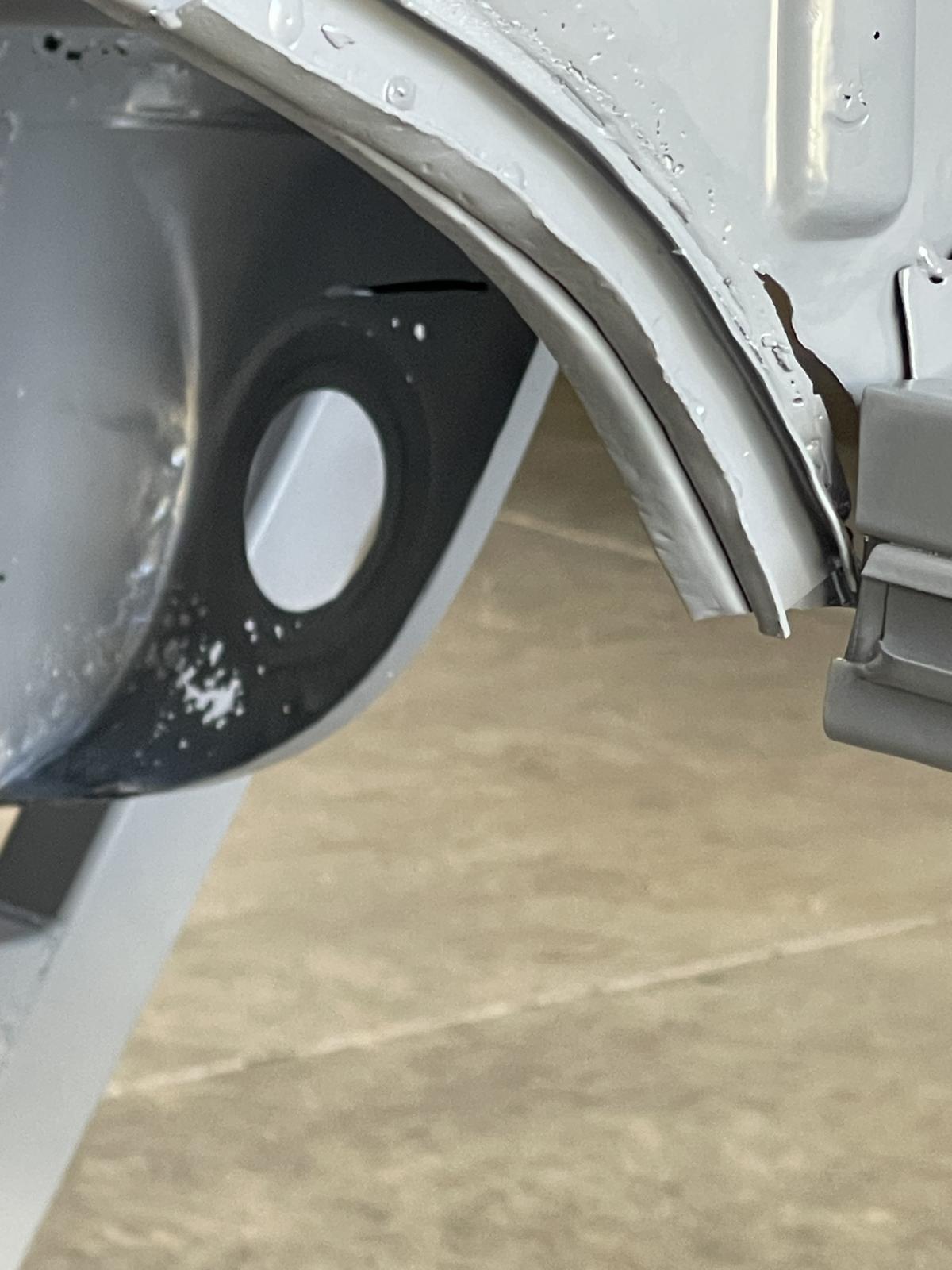

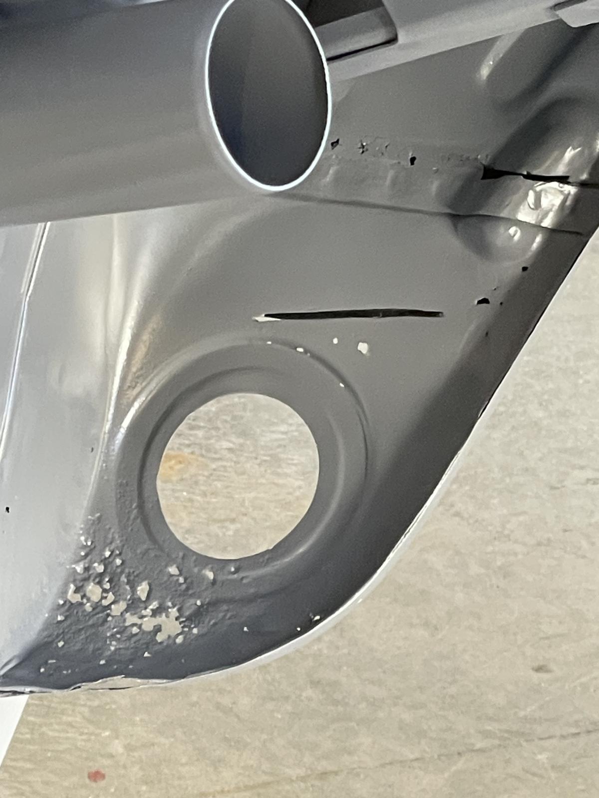

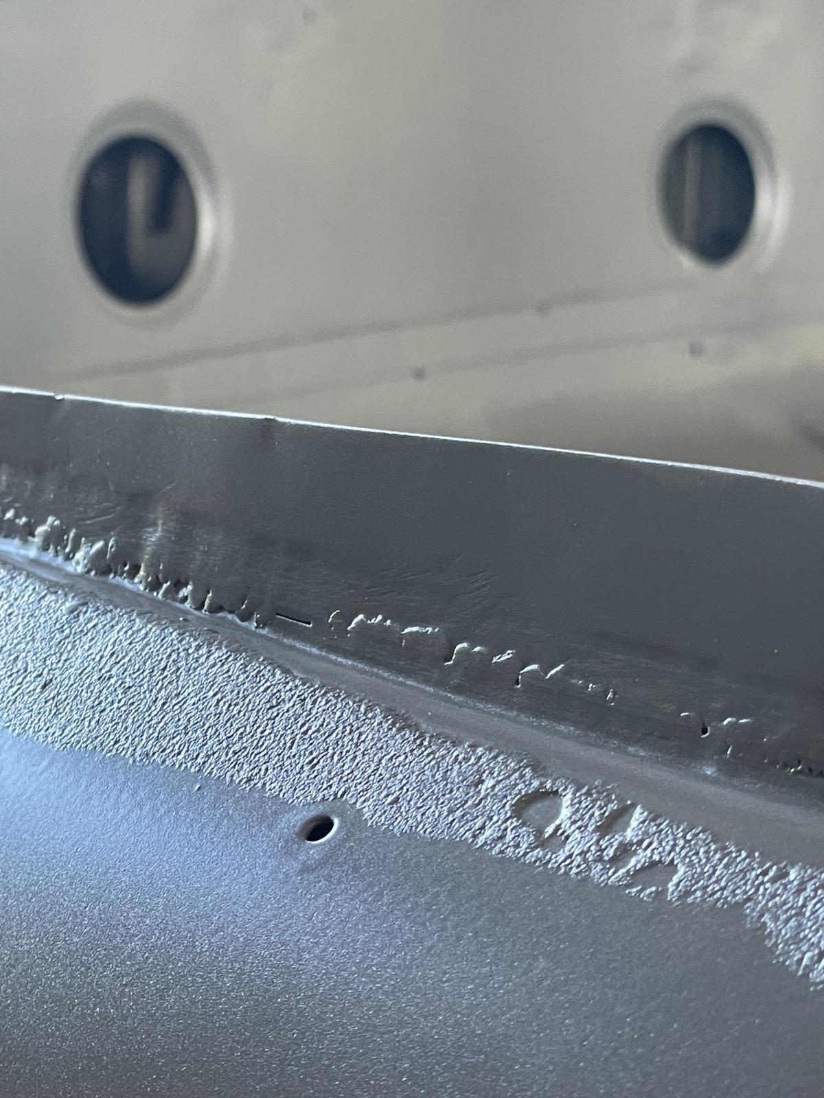

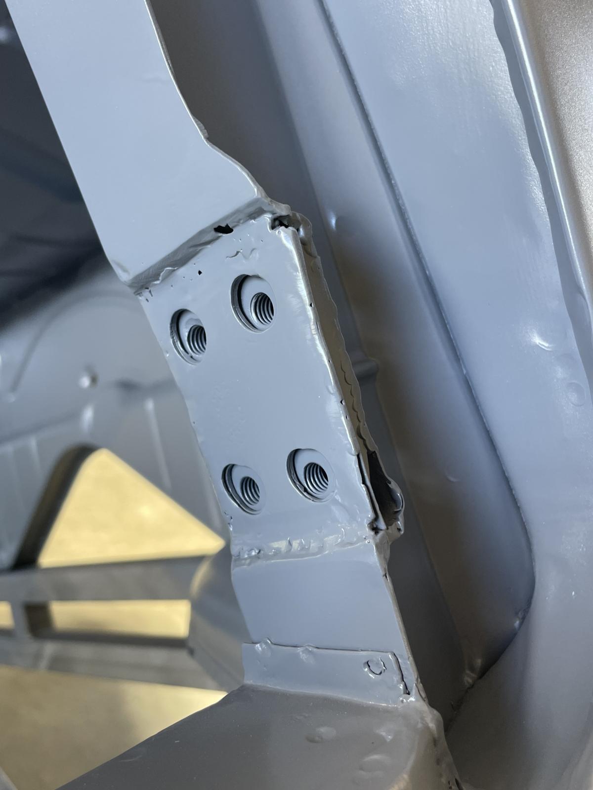

PostPosted: Thu Apr 03, 2025 6:18 am    Post subject: Re: 57 Kab Reconstruction/Restoration Reply with quote

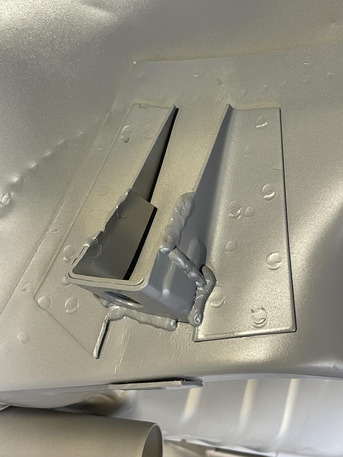

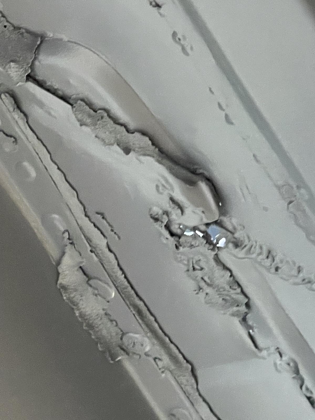

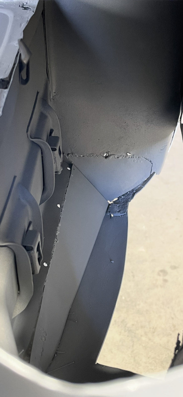

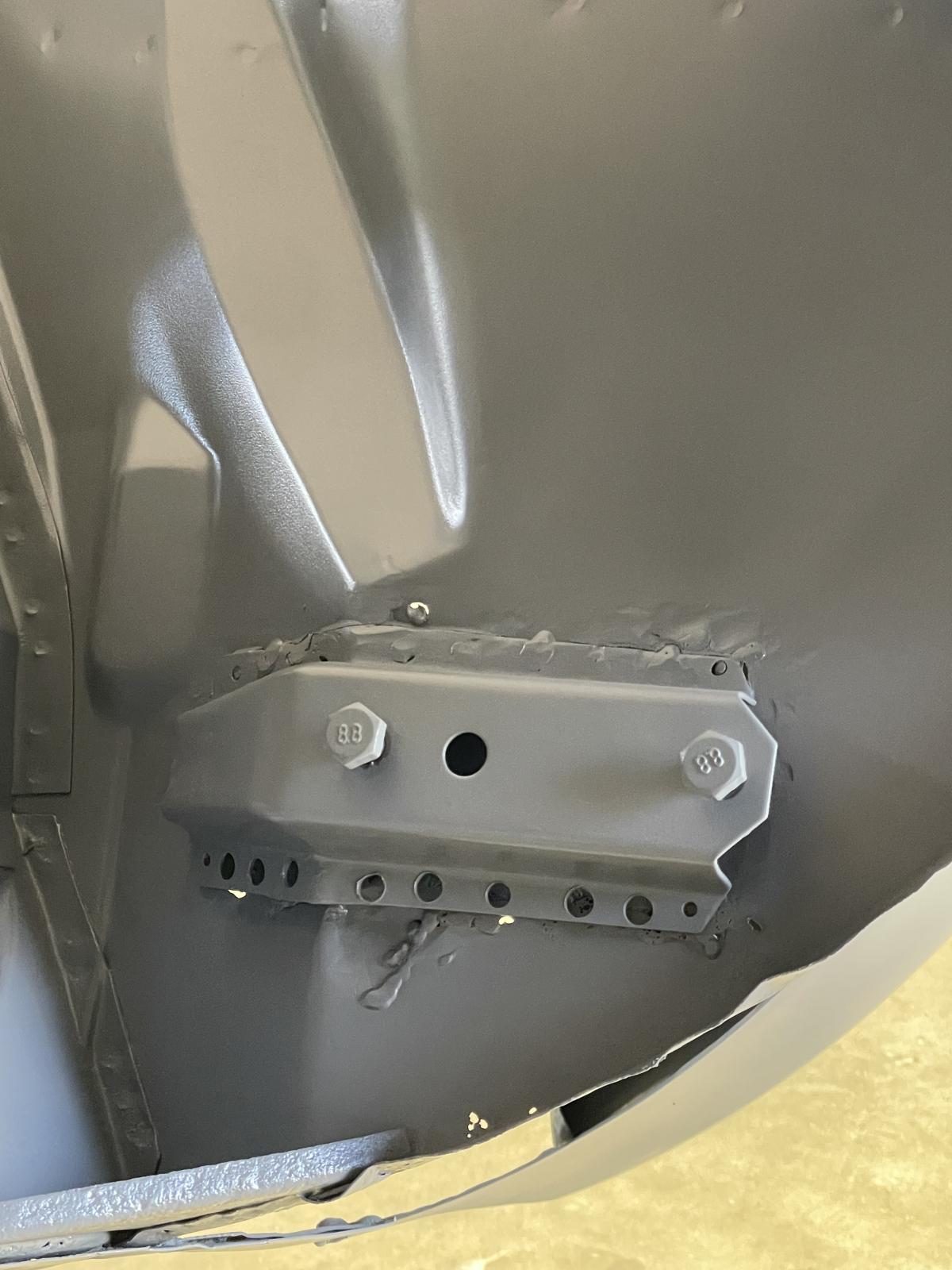

Looks like theghiagirl is right! The rear body mounts are hacked. Scary what you find under a "restored" cars paint!

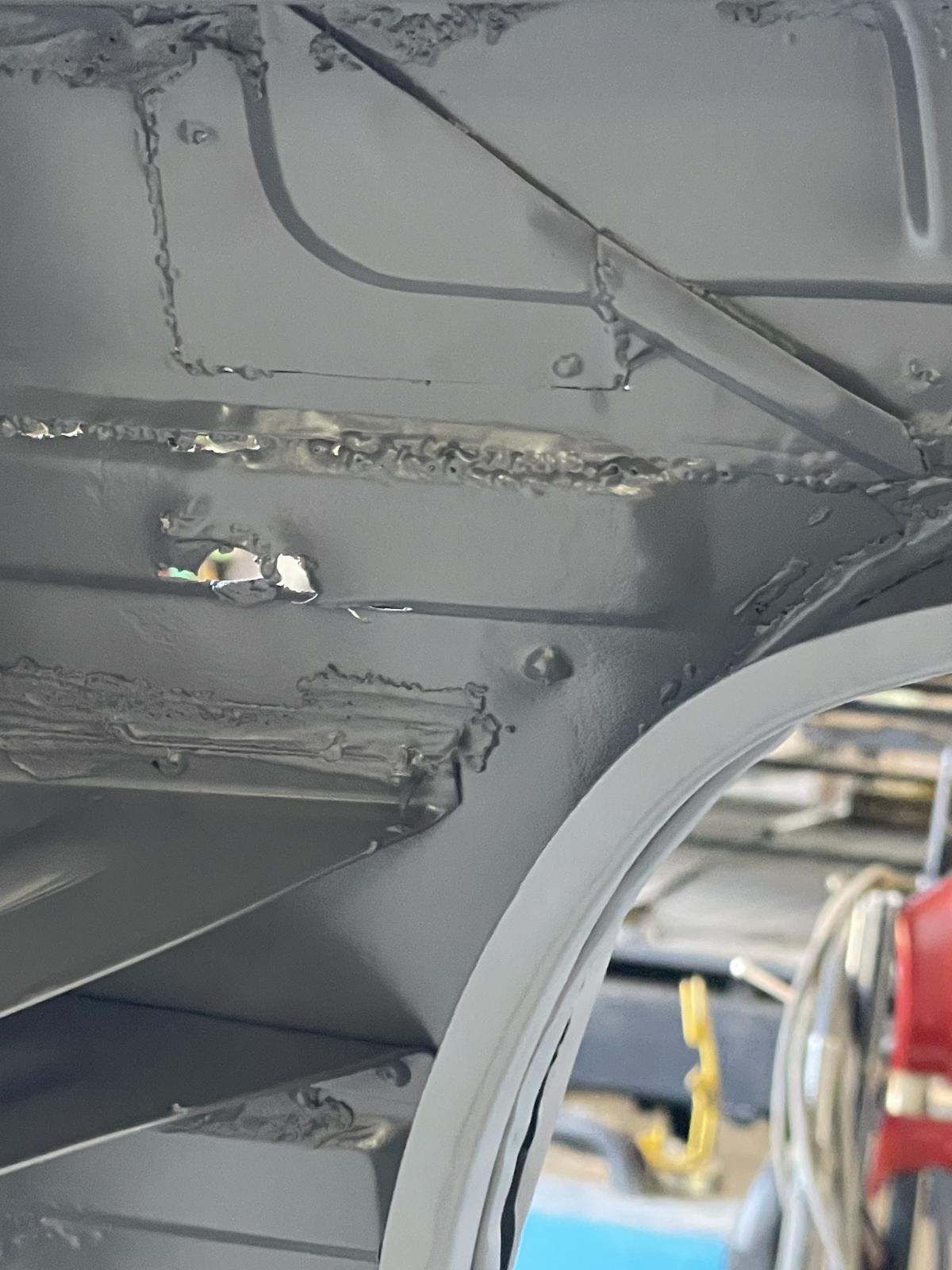

WrennMetallWerks
Posts: 3314
Location: Rescue ca
PostPosted: Thu Apr 03, 2025 7:29 am    Post subject: Re: 57 Kab Reconstruction/Restoration Reply with quote
Dirty Indeed….
It’s a drag to see first hand what some shops these days are willing to do to make money.
All I can do from here is try to stay positive and do my best to throughly rectify the situation and bring some Joy back into the life of this rare convertible.
