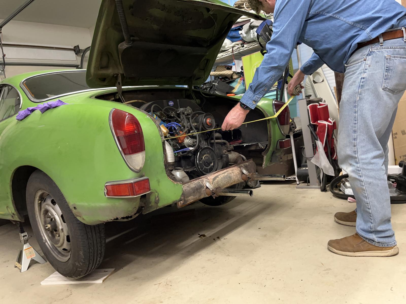

I have a 71 Ghia that I have to fix the back. It was hit. I lower the truck and the lid won't fit. The lid measures 38 1/4 inches. The opening is measuring 37 3/4.
When I look at the car's sides they are not bent in. I have cut the two pieces from the engine compartment that tie to the two tail lights together and it did not spring back. Rolling Eyes
Any ideas? What size should it be? Could you measure your car and let me know? Could the engine lid expand out with with the flattening from the impact? Could the sides have been bent in with the impact?
See photos.
Thanks.

The width of the opening on my '67 is 38 3/4", measured right about where you did in your photo.
Edit: That measurement is from outside-to-outside of the weatherstrip groove.

Just took some quick measurements on my '70.
'71 Dimensions are the same.
For the decklid i measure:
39 3/4" Width across the center of the vents.
39" at the start of the bend.
38 at the bottom of the bend just before it starts to curve inward.
For the opening I measure:
37 1/2" across below the center of the vents.
37" at the start of the bend.
36 1/2" at the bottom.
Measurements guaranteed by my Stanley 25' tape measure.

You say your car was hit before. Get on the ground and look up at the wheel housing (inner/outer), on both sides of the car. Are there any kinks to it ? Any bend there *may* pull your fender one way or another, without things looking too unnatural, since the fender is welded to the wheel housing.

I did what you suggested and the wheel housing was bent in towards the wheel on the drivers side about 3/4 of an inch. Because the piece that the bumper bracket mounts to was bent as well. I replaced it and was able to bend the wheel housing back to the original shape.
The drivers side kind of fits and it made a sound when I forced the new lower plate temporarily in place (pictured). The passenger side does not seem to move. It is more rigid and bends less because it has all the original pieces welded in. Take a look at the pictures. Any other suggestions would be great as I do not know what my next move is.

I didn't fool around measuring stuff, the cars hand built I stuck with that. Close the lid and move the sides till they fit right and has gaps that look good and straight, then weld it together. Cool
