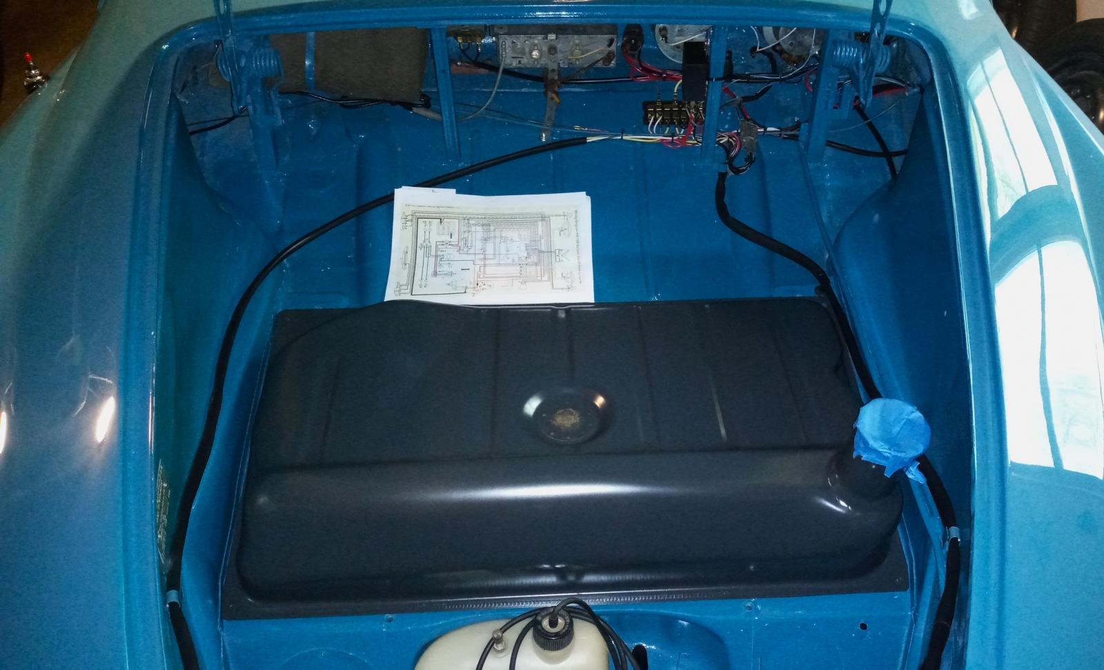

PostPosted: Tue May 07, 2024 3:25 pm    Post subject: Re: 1966 Ghia coupe restoration Reply with quote
Getting closer.
What's left on the to-do list:
-Buy and install alternator belt
-Small amount of electrical wiring left to do
-Decide if I'm going to install the electric rotary fuel pump I have, or buy a rebuilt Pierburg mechanical pump from Sparxwerks
-Buy and install battery
-Buy and install gas tank
-Install fuel gauge and sender
-Install bumpers
-Install side trim
-Install scraper seals and trim
-Install lower 1/4 window trim
-Install front trunk seal
-Install wipers and motor assembly
-Install throttle cable
-Buy and install front trunk liner
-Buy and install new tires
-Buy new hubcaps and beauty rings
I think that might be all that's left after 5 years!
Any recommendations on a fuel tank? I know there's some junk out there. I'd like to find a quality one that can use the factory gas cap if possible.

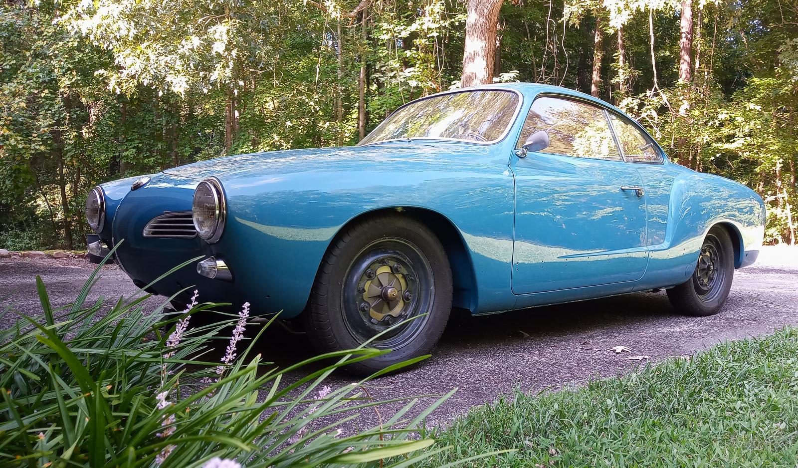

This beauty sure does look good out in the daylight. This is the first time it's been on 4 wheels, and not on jackstands, since I brought the car home from paint in Feb 2022. Unfortunately not for any reason as exciting as that it's running. While attempting to install the front bumper it became clear that the driver side front bumper mount was just a tad too off alignment to actually be able to mount the bumper. A tow truck is coming tomorrow to take the car back to the shop that did the bodywork. Thankfully they're an honest crew there, and they're fully taking care of the issue. Likely it just got off alignment during the rhinoplasty. You can really see my yard in the reflections Laughing

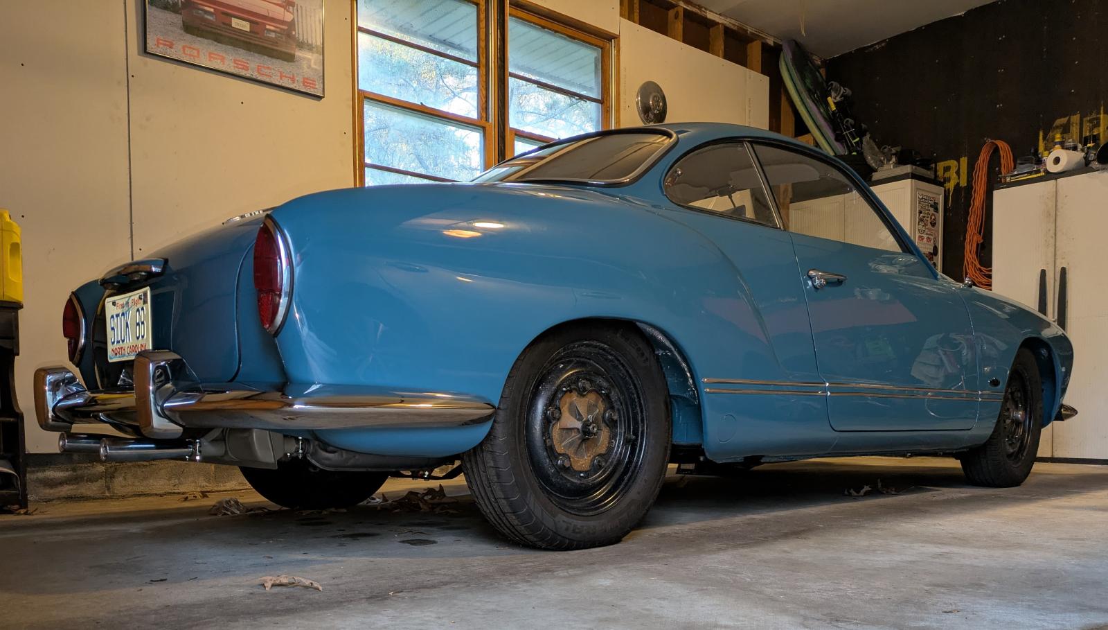

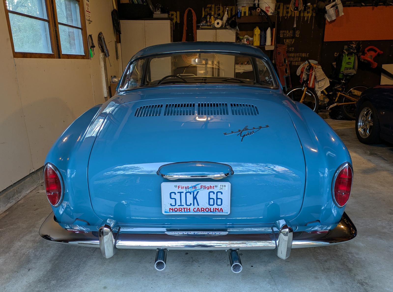

PostPosted: Fri Nov 15, 2024 3:05 pm    Post subject: Re: 1966 Ghia coupe restoration Reply with quote

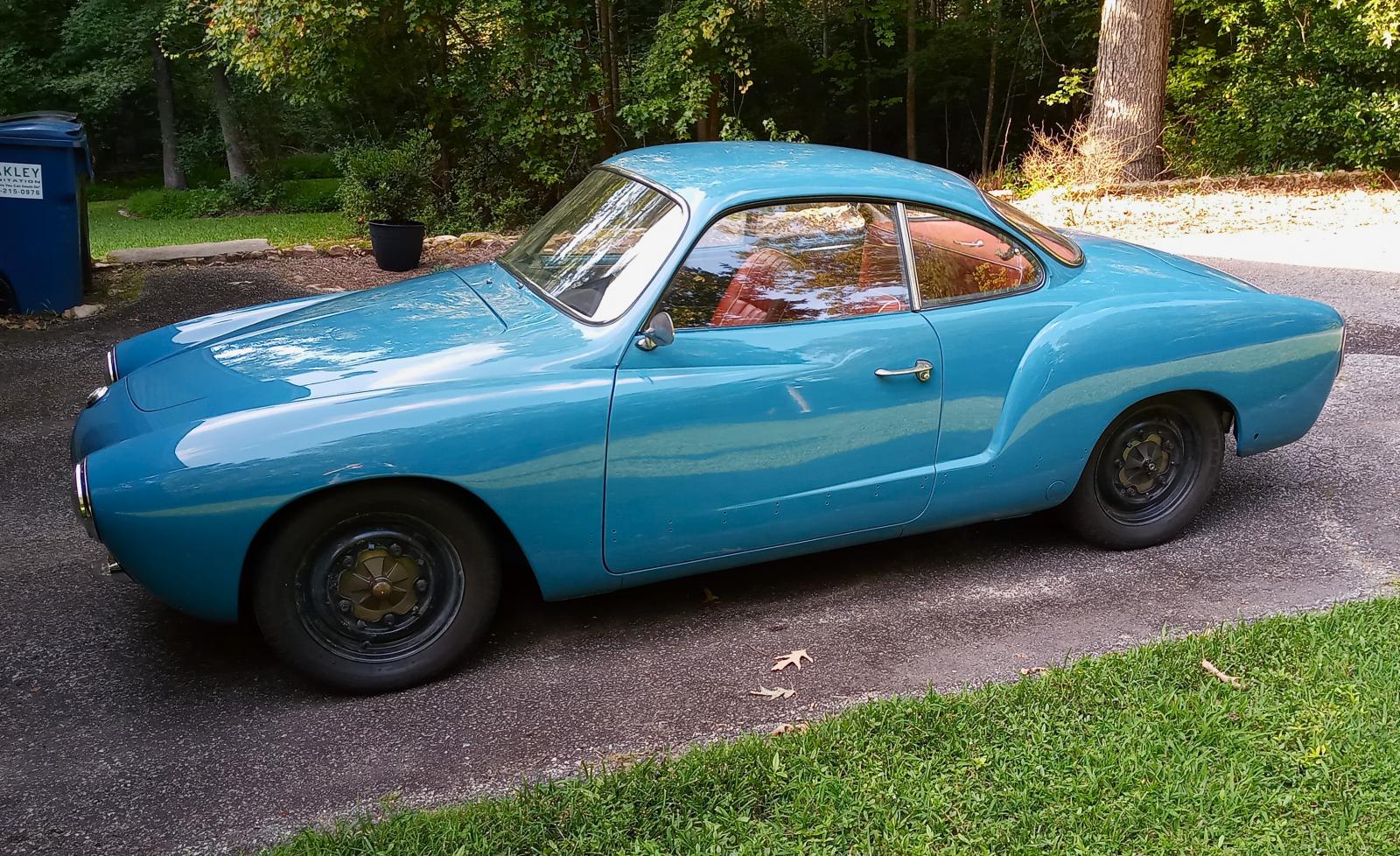

It only took like 3.5 hrs, but I got the rear bumper on Laughing
My first time doing this, and I initially tried installing it like everyone who posts pics of their install does, which is with the bumper fully assembled and with the brackets and bracket covers attached to the bumper. I found that to be quite impossible, mainly because the bracket cover seals kept falling off before I could get the brackets bolted to the body.
So instead I went in steps. Bracket covers onto brackets. Brackets onto body (much easier keeping the cover seal in place doing each bracket seperately). Then I put the bumper ends on one at a time (way easier to control and keep them from touching the fender). Then the bumper center piece. And lastly the over riders. Once it was all on, I straightened everything and tightened all the fasteners down. Would've only taken an hour if I'd done it that way from the start! Oh well, I'll know for next time now Cool

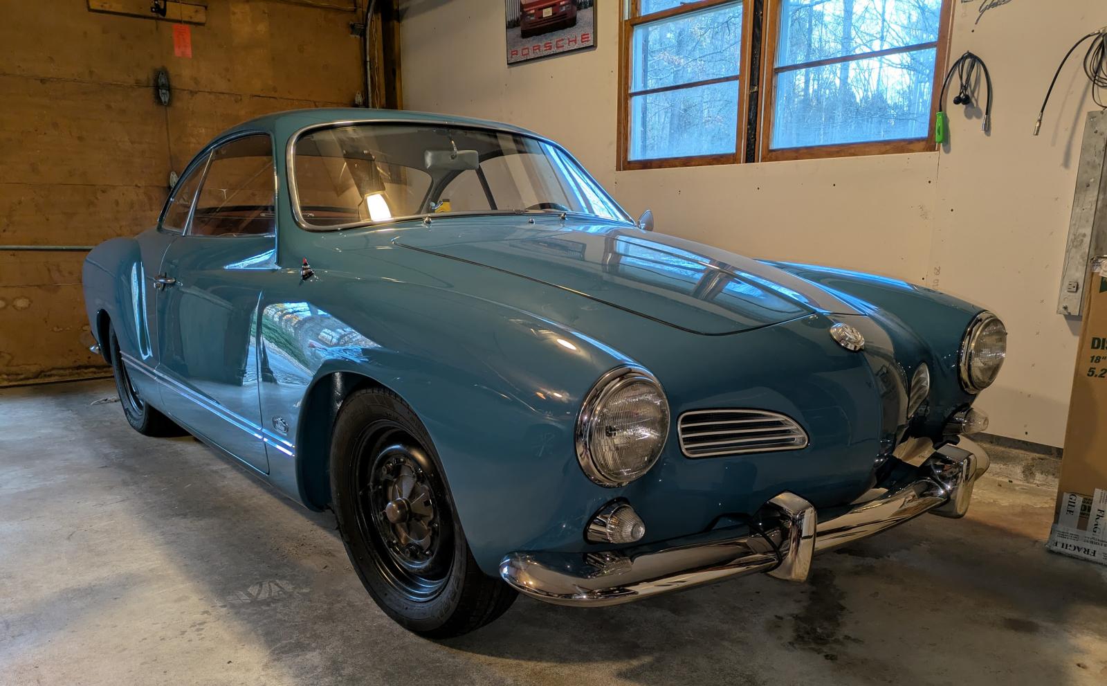

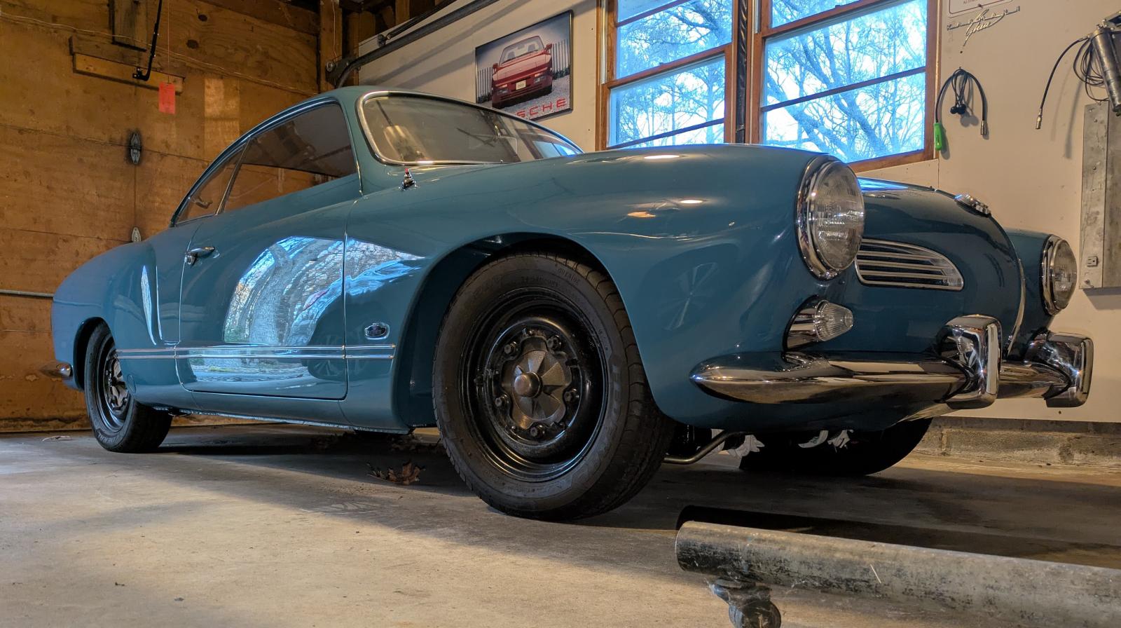

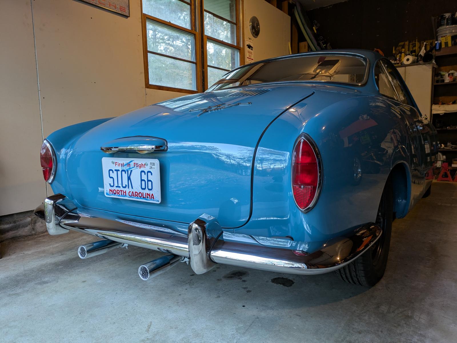

PostPosted: Thu Dec 12, 2024 3:00 pm    Post subject: Re: 1966 Ghia coupe restoration Reply with quote

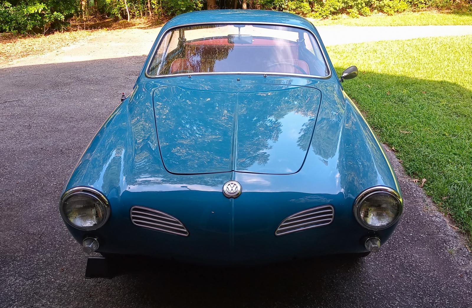

Front bumper and side trim is on. It's starting to really look like a Ghia! Cool
For the side trim, I used the MG Midget clips (part# AHA9447) that have M5 studs. I need to take some pics, and I'll make a separate post here detailing how those went on.
As I was loading this pic, I can see I need to better align the tailpipes. Funny how you don't see that when it's right in front of you.
