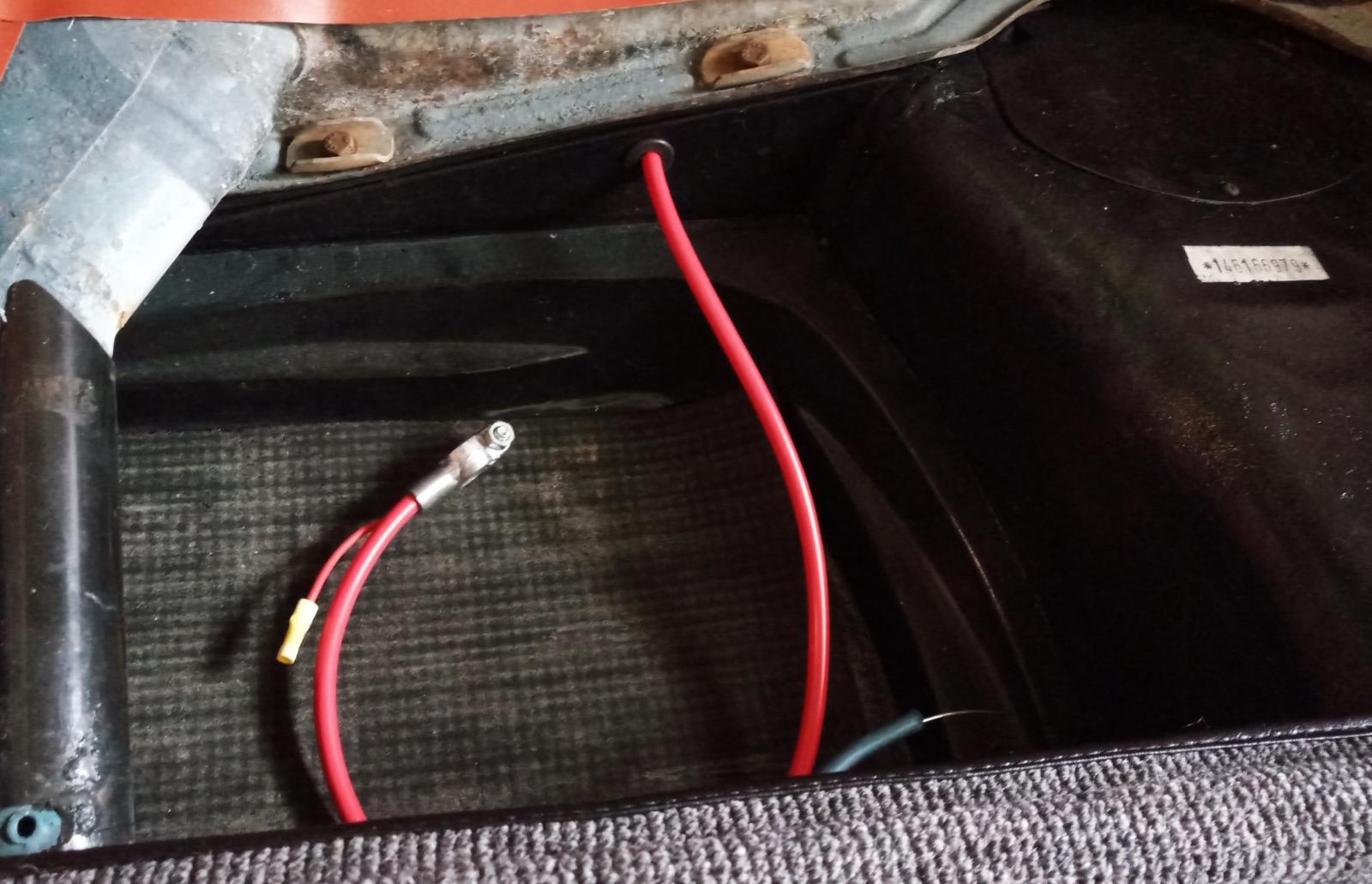

Prepping the under the rear seat battery location

PostPosted: Wed Apr 17, 2024 11:38 am    Post subject: Re: 1966 Ghia coupe restoration Reply with quote
My 72 coupe is at pretty much the same stage of resto as yours. I’m also putting the battery under the back seat. What battery you plan on running? The odyssey that I’ve seen folks use on here? And what are your thoughts on securing it?
I'm leaning towards the Odyssey PC925, but I'm still kind of researching if there are any other options. No idea yet on securing yet. I think the battery choice will dictate that. Likely I'll just tack weld some kind of bracket to the pan, but I'm not certain yet.

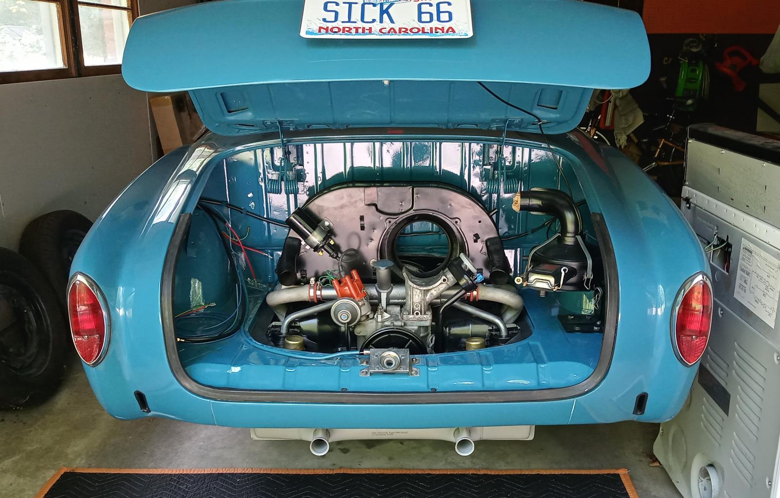

PostPosted: Fri Apr 26, 2024 12:35 pm    Post subject: Re: 1966 Ghia coupe restoration Reply with quote
A friend of mine stopped by last weekend to help me install the engine. I finished installing the muffler and heat exchangers today. I bought the Jopex muffler with the high temp paint. I know other folks have mentioned having an easier time installing it, but the one I got was a nightmare. Almost nothing lined up. I took me two days of massaging it with a rubber mallet, ratchet straps, clamps, etc to get it to fit. But it's on there now!
And yes, that is our old dryer, which has turned into an impromptu tool bench while it waits to go to the dump Laughing

PostPosted: Fri Apr 26, 2024 12:51 pm    Post subject: Re: 1966 Ghia coupe restoration Reply with quote
Wow! That looks great. You should be driving it in no time now. Are you going to add an insulation panel on the fire wall behind the engine?

PostPosted: Fri Apr 26, 2024 1:25 pm    Post subject: Re: 1966 Ghia coupe restoration Reply with quote
Thanks! Yeah, I really hope to be driving it later this summer.
No there won't be any insulation in the engine bay. I really like the painted engine bay look. It's just such a clean look. I did, however, fully cover the luggage area on the other side of the firewall with both dynamat and 40oz jute padding under all the carpet. I think that should compensate for the lack of tarboard in the engine bay. And if not, oh well. I enjoy hearing the engine anyway Cool
